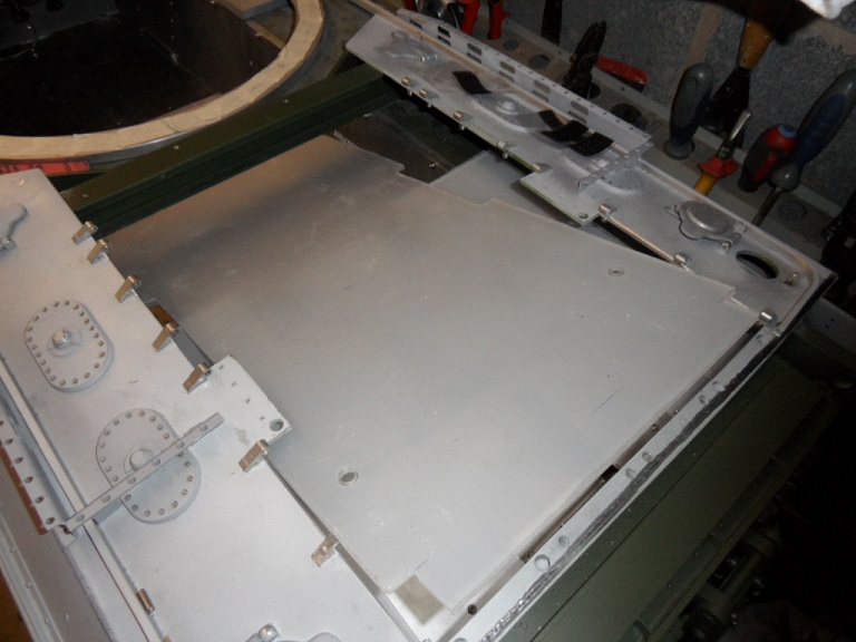

I'm hoping this is one of the last major changes I have to make, other than subtle mods to make the model as best I can.
One subtle mod I'm considering, is the inclusion of an original blank registration plate I picked up some years ago. Using it as a shelf to carry the Red box control gear in front of the rear speaker box.

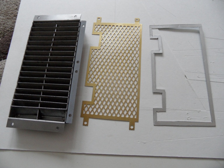

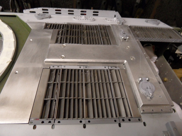

Dusted myself off, and did a little work on the extended triangle bin and started tinkering around with the rear deck Grill/Vents panels.
Quite pleasant and fun to put together. (don't forget to fit the center section piece)

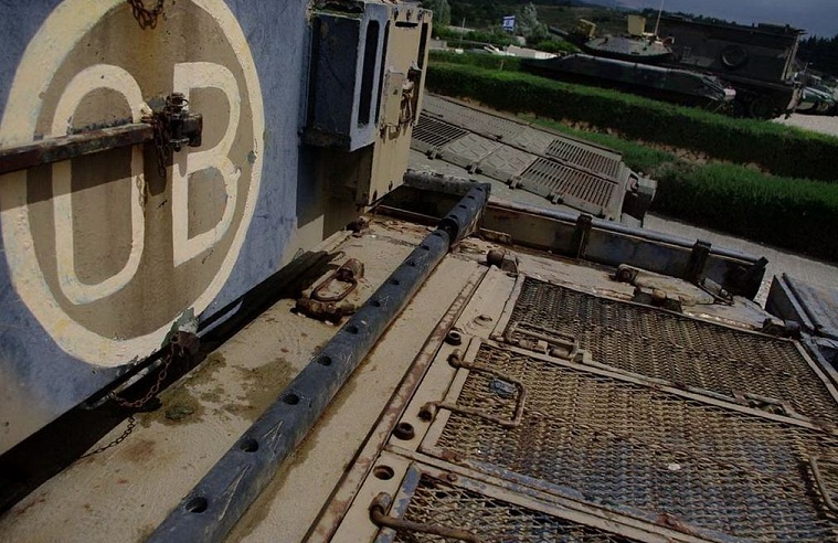

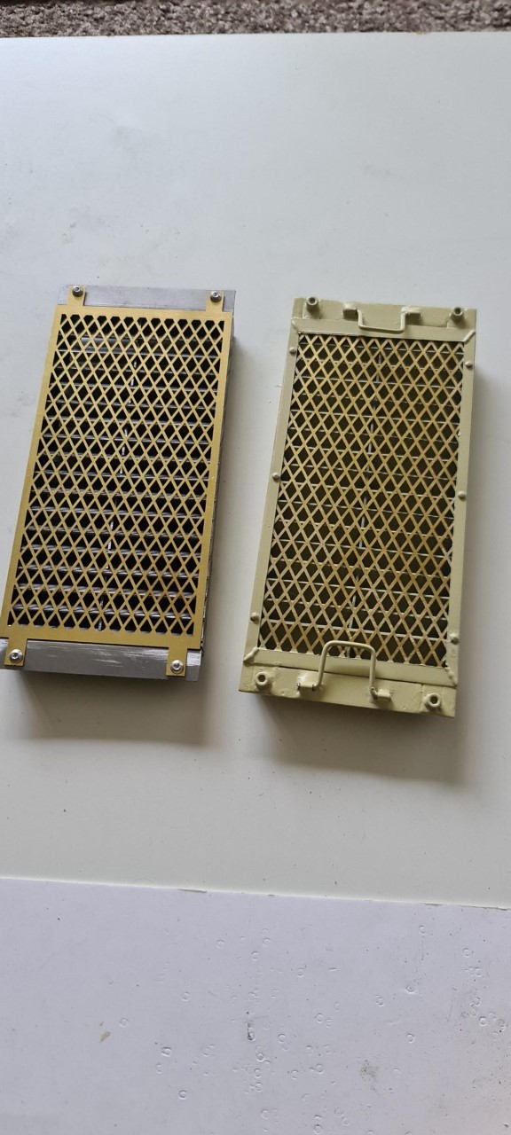

I believe four of the eight forward grills on the forward edge and rear edge of the array, have the louvers reversed, this compared to the original tank. These cannot be reversed like the mid section grills if required. It would be possible to remake, but hardly worth it, as once covered with the mesh. Hardly noticeable unless opened, especially when the rear of the turret and NBC pack covers a lot of the mid section rear deck when pointing forward.
Detailing so far, (well adding a bit more weight).

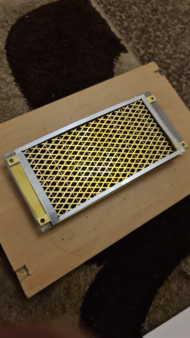

Starting with easy and the most accurate grills supplied. The two rear lift out center sections, I cut up some thin alloy sheet to frame the supplied mesh panels.
I thought of changing the mesh panels supplied for something more finely made, but I'm sure the supplied mesh panels will look ok when painted.
More importantly they add strength to the grill frame when fitted. I used the excess brass from the fret supplied with the mesh to build up and solder on the handles too, adding steel socket bolt heads for use with the magnet retainer and snail trail welds.
It will not so easy with the other grills as these are more "needy"

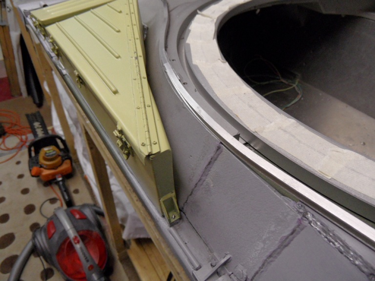

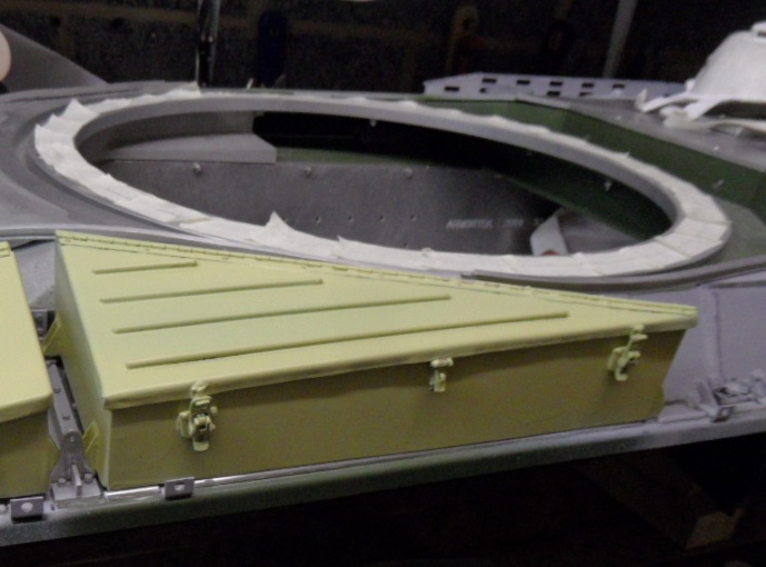

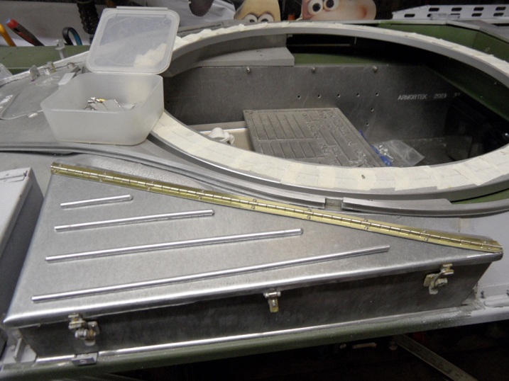

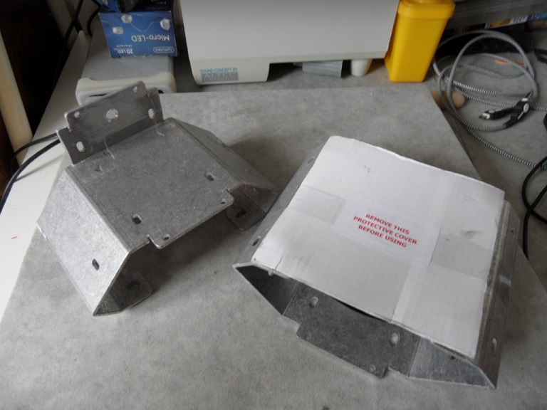

While i was taking pictures of the grills took a picture or two of the extended triangular bin in its new livery. Ribs need a little flattening to keep in keeping with square forward bin. maybe.
Roughed up the side armor end section to look a little like the second casting section.
Tripping hazards keeping me on my toes in the garage too.

Nicely done John, its come out really well although not sure about the colour
Could be worth considering a larger diameter rod for the ribs to give a bigger curve?

Nice set of grills John, certainly coming on.

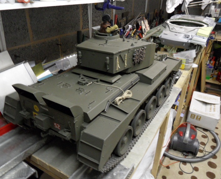

R&R, Nice. The Comet's on the bench with Chieftain for some twiddling.
Chieftain, Centurion, Comet hmmm a pattern is forming.
The Armortek British Tank owners club
The Comet went together really well and came with a nice detail kit.
Having driven a handful of Armortek models there is nothing sweeter than the Comet, fast, smooth and turns on a sixpence.

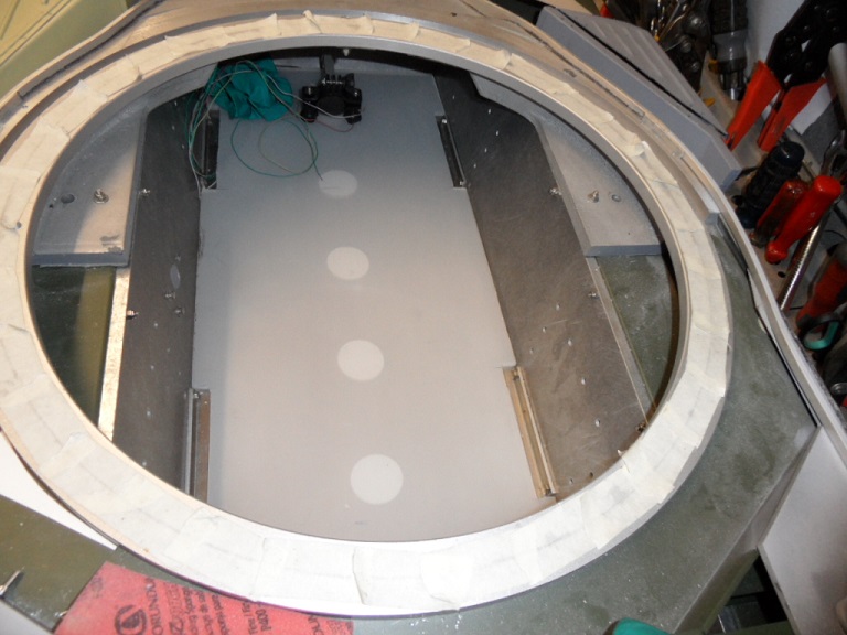

So I have a question for anyone with a built Chieftain recoil system.
Does the main 120mm gun recoil mechanism dip below the turret ring when the gun is fully elevated?

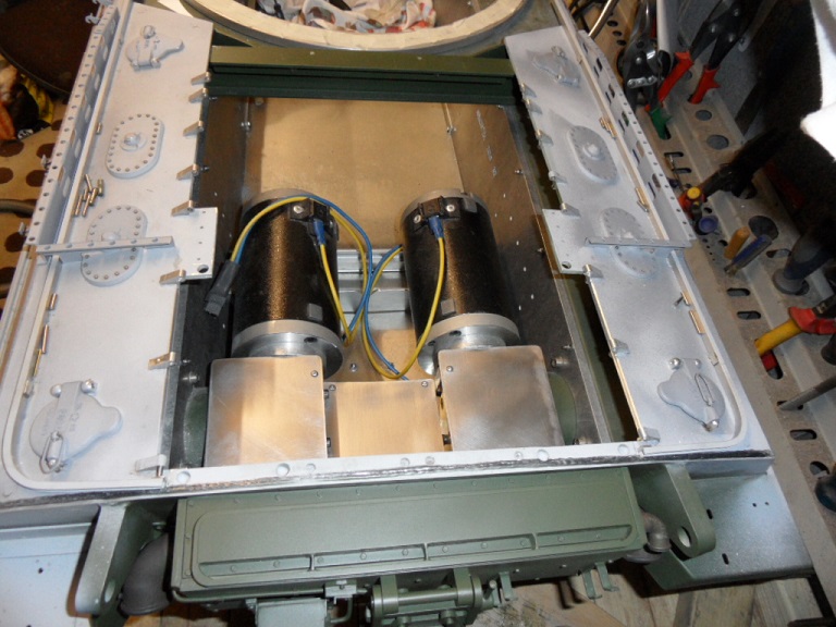

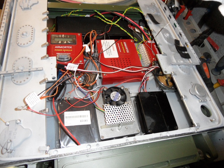

I ask because it would be nice know for battery positioning. I've fitted a false clear flat floor on the belly plate and would like to know if the standard 12v 22amp batteries will have to lay flat. (The poly carbonate protective covering is still on while I mess with it).
I've also built a shelf on top of the gearboxes to mount all those lovely red boxes, I'm still shuffling them round for the best fit and I have converted one of the original speaker brackets to support and raise the alternative speaker system. (Everyone's going to enjoy the marching band)
