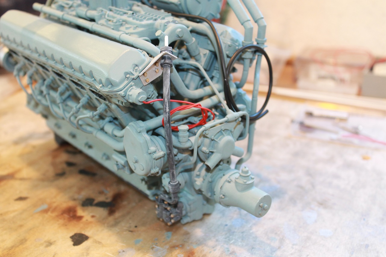

Here is my oil cooler design. The radiator fins are 804 brass washers (diameter 6 mm, thickness 0,5 mm).
I see no other choice.
All the best
Frank
All the best
Frank

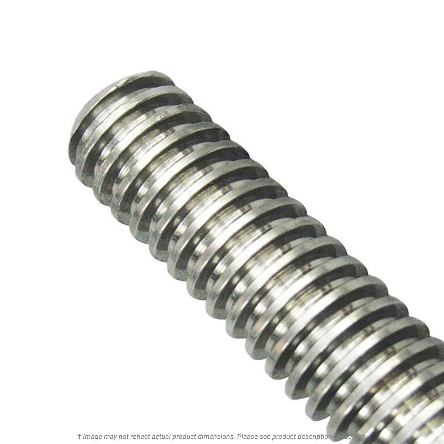

Frank, that's a lot of work. Have you considered using threaded rod? You could enhance the depth of the threads on a lathe. I would think that using washers would present the problem of making sure each was true and evenly spaced. Any irregularity would look very obvious. Either way, your model is superb. Congratulations.

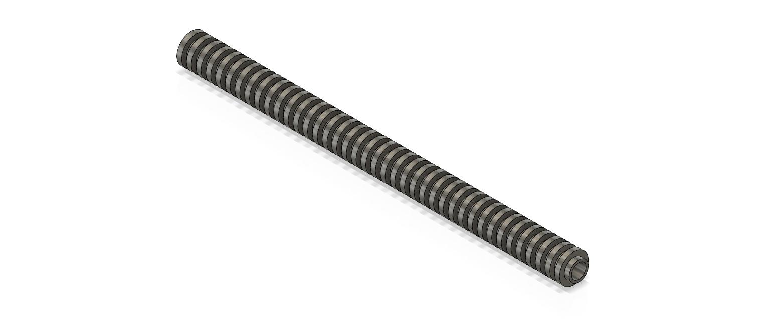

As acme threaded rod of 6mm diameter (or 0.25 inches) might be hard to get, another idea would be to 3D print short sections of the cooler with a hole in the middle.
Glue them together with a metal rod in the middle hole for support.

Now the oil cooler is ready. I hope you like it.
The soldering work was for someone how killed his hole family.
Frank
Frank

The next item are the exauster pipes. I believe than is the engine mostly ready, except the compartment and the aux. engine.
Today the pipes from the scavenge pump to the oil cooler.
Frank
Thanks for your comments.
Hello Stephen
Sascha have maybe a solution for the radiators wiht a resin printer.
Frank
