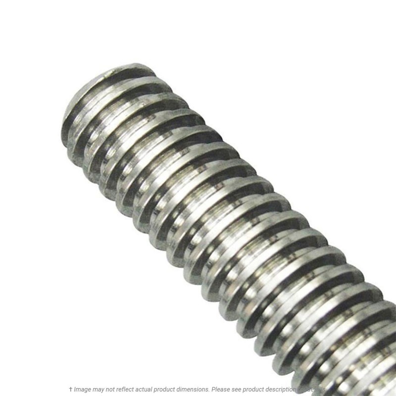

Re: A 47 years old love
Or maybe acme or square profile threaded rod.
Has liked: 1040 times
Like this:

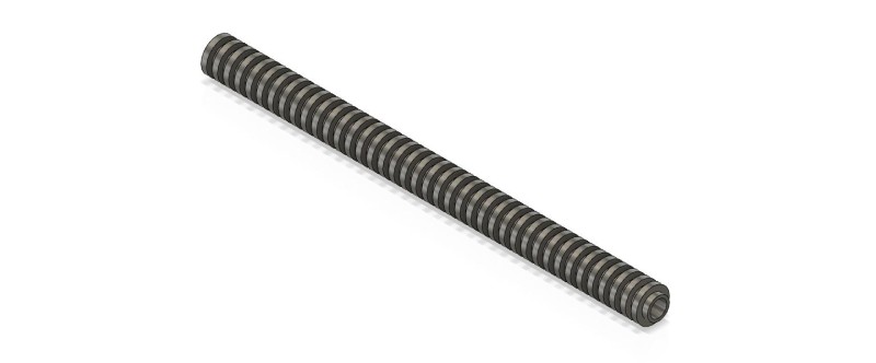

As acme threaded rod of 6mm diameter (or 0.25 inches) might be hard to get, another idea would be to 3D print short sections of the cooler with a hole in the middle.
Glue them together with a metal rod in the middle hole for support.
