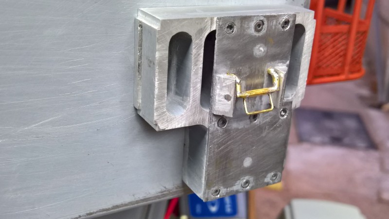

May I proffer this week's (actually2weeks) hacking and bashing: Yes, it's rough, but we are getting there. I present the NBC pack: -
Still some filing to do & a catch to do too.
For info I used M2x10 cap heads, M1.6/BA (?) an option possibly & replaced the AT plate & bolts, but I haven't squared off the inside of inlets.
Bolted to the NBC door by threading the existing hole, M4 and filling.
How's the plate hung on?
Tap(M2) the angles & super glue. At least one of screws though the angle will hold the plate in place, I hope.
Take care
Charles
PS Must remember it's a tank, rough is good

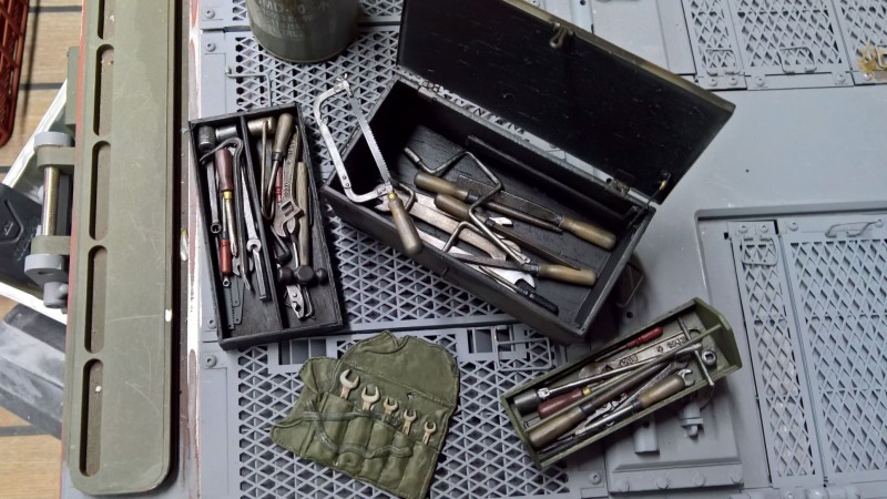

Cold & damp, therefore in the house, warmer, beer & snacks handy. As I said previously, I will pass on snippets of progress, so here is the latest.
The tools have been lying around for over a year, at least. Time to have a go: -
First the toolbox, based on one I acquired in the 1980's (the replacements were metal) before they went for "disposal".
We then added Armopax tools,
Any comments about "1943" dated adjustable spanners in the Chieftain tool kit, I will defend this, as I regularly use a 1954 WD spade (£21 years ago, bargain).

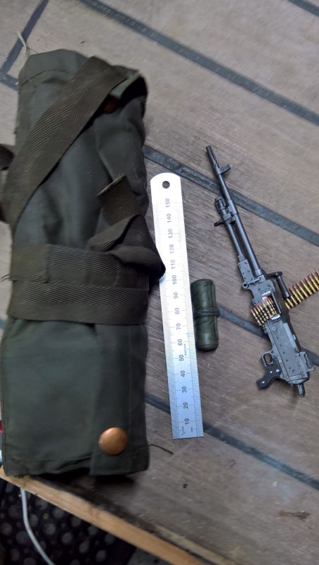

Last bit, the tool roll from Armopax will double as the GPMG cleaning tools.
Take care and compliments of the season to all.
Cheers Charles
Re: Chieftain No. 34
Posted: Tue Dec 06, 2022 6:30 pm
by David Battson
Hi Charles
The painting of those tools looks fantastic. I had to blow up the images to look for signs of photo shop trickery. The wood and metal effects are really very convincing.
