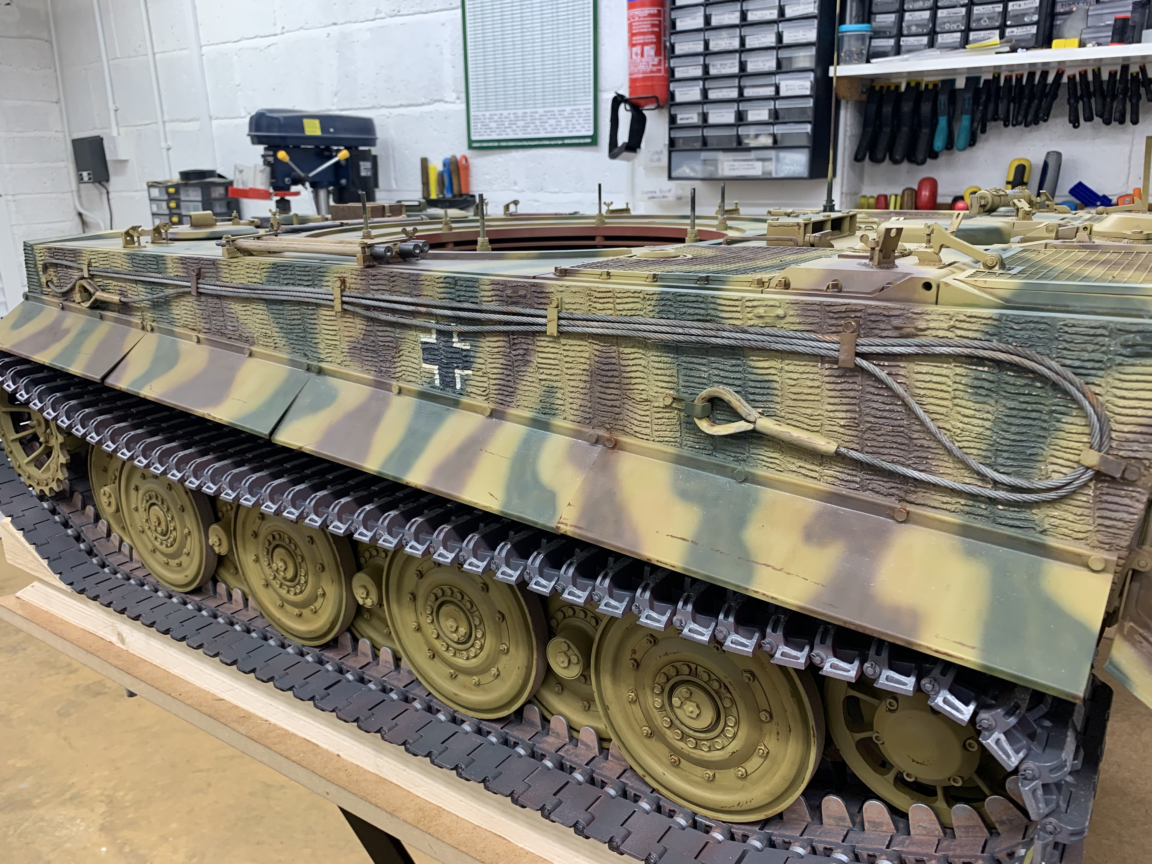

Hi Gary,
The cammo finish looks excellent.
Re the track tension, I'd say it looks a bit loose for a running model - better if the track was landing on the third road wheel in. You will find there will be a lot of early days 'bedding in' as paint and burs wear off the track pins/holes and suspension arm fixings bite down into the torsion bars etc. So regular re-tensioning will be required to start with.
- Posts: 597
- Location: Somerset
- Has liked: 787 times
- Been liked: 1878 times
Re: Tiger 1 2021 no. 13
Hi DavidDavid Battson wrote: ↑Wed Oct 19, 2022 8:18 pmHi Gary,
Thanks, I will take another link out of each track and re-tension as you suggested. I was surprised just how much adjustment was required after twenty minutes running time. I should have the barrel and turret bin fitted for the next test.
Gary

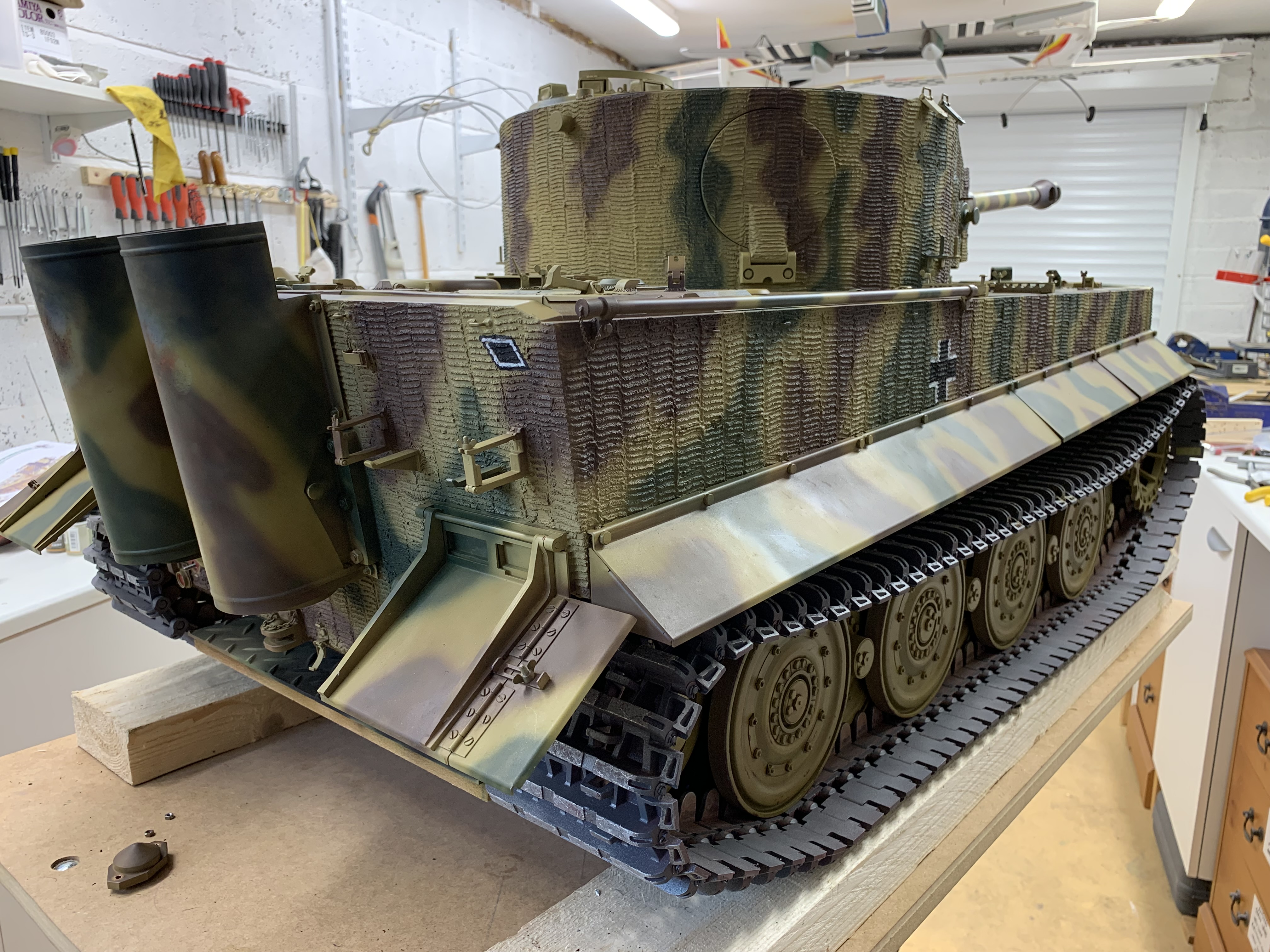

Good evening,
Thanks for the comments regarding the camouflage, I still need to add the numbers, rhomboid insignia then add dirt and dust layers. It still looks slightly glossy, but it is my first attempt using oils to do modulation and I am sure there is a way to get a matt finish. I haven't altered the zimmerited areas yet as I need to decide whether I do the numbers using stencils or freehand. I did try the Paynes grey oil paint on the exhaust guards and prefer it to the Tamiya smoke as it is duller.
Gary

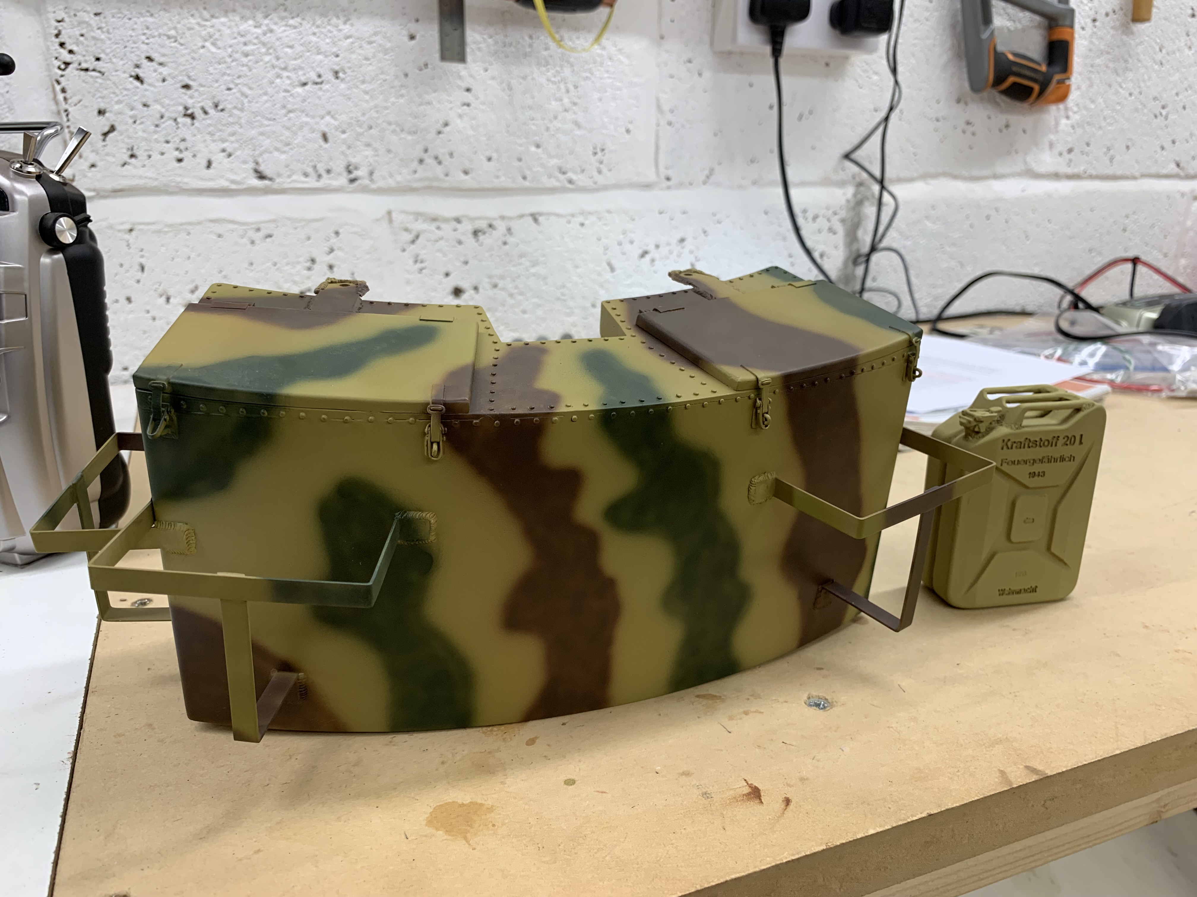

Just a quick update. I have started adding the crosses and rhomboids while I wait for the number stencil and jerrycans that Dave at Armorpax is sorting for me. This will allow me to start the modulation/wash on the Zimmerited areas. The turret bin will be fitted once I have added the numerals either 113 or 213 from Abteilung 301 (Funklenk).
Gary

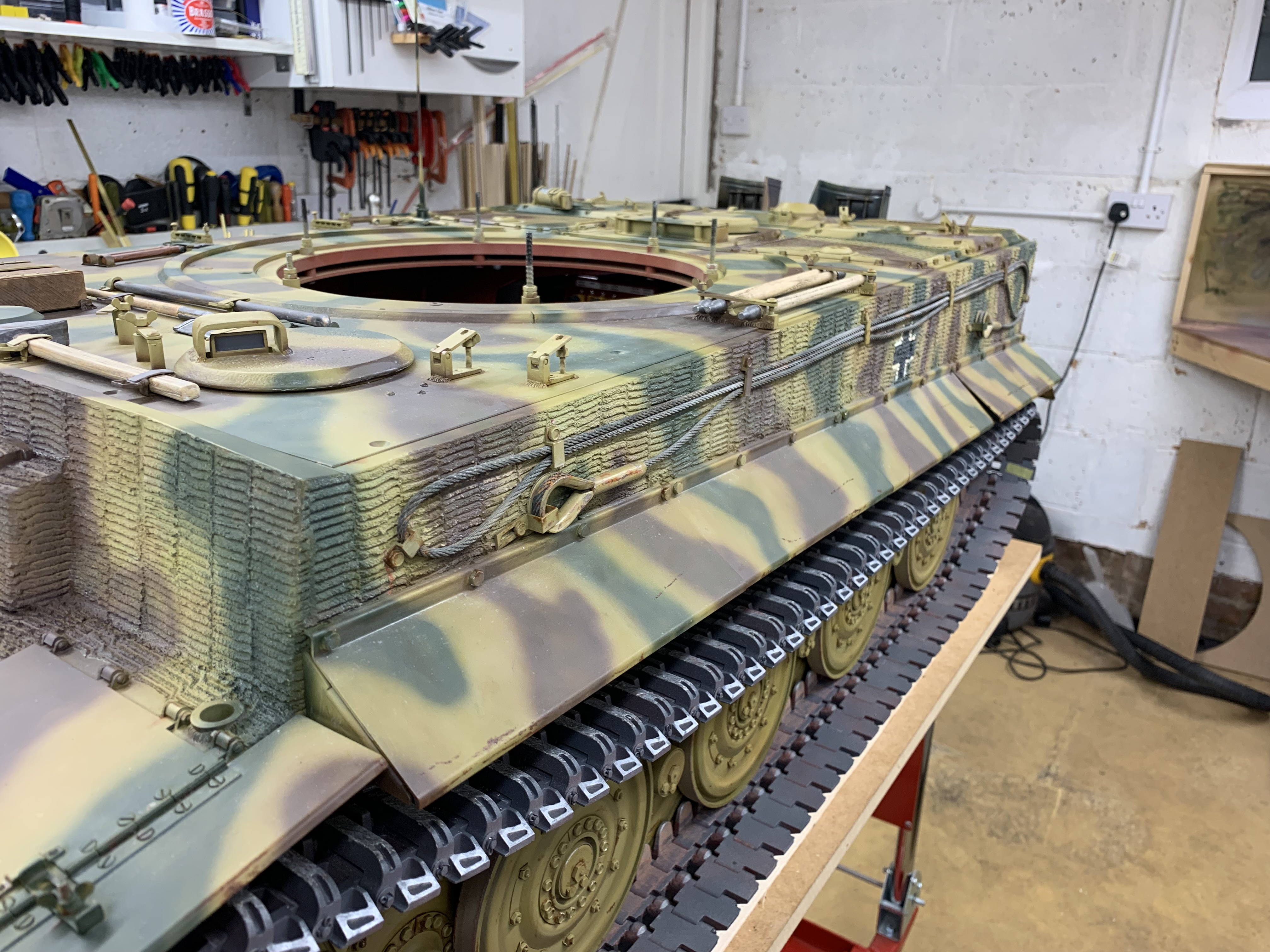

I have started adding details to the decks on the Tiger. I find this part very satisfying; I am using Abteilung 502 oils to do the rust marks, scratches etc, the only problem being the time it takes for the oils to dry, even with only a thin smear. I had a go at aging the Tetra fire extinguisher and quite like the result. I will add photos of the deck later as I spent yesterday measuring the Petard 29mm spigot mortar at the Cobbaton Collection as part of my Churchill research, my thanks to Preston who was very helpful.
So here is the photo of the fire extinguisher, it stills needs some dust effects. The label crazing was my mistake spraying to much Citadel varnish, the effect does make it look old and worn, so perhaps a bit lucky.
Gary
Gary

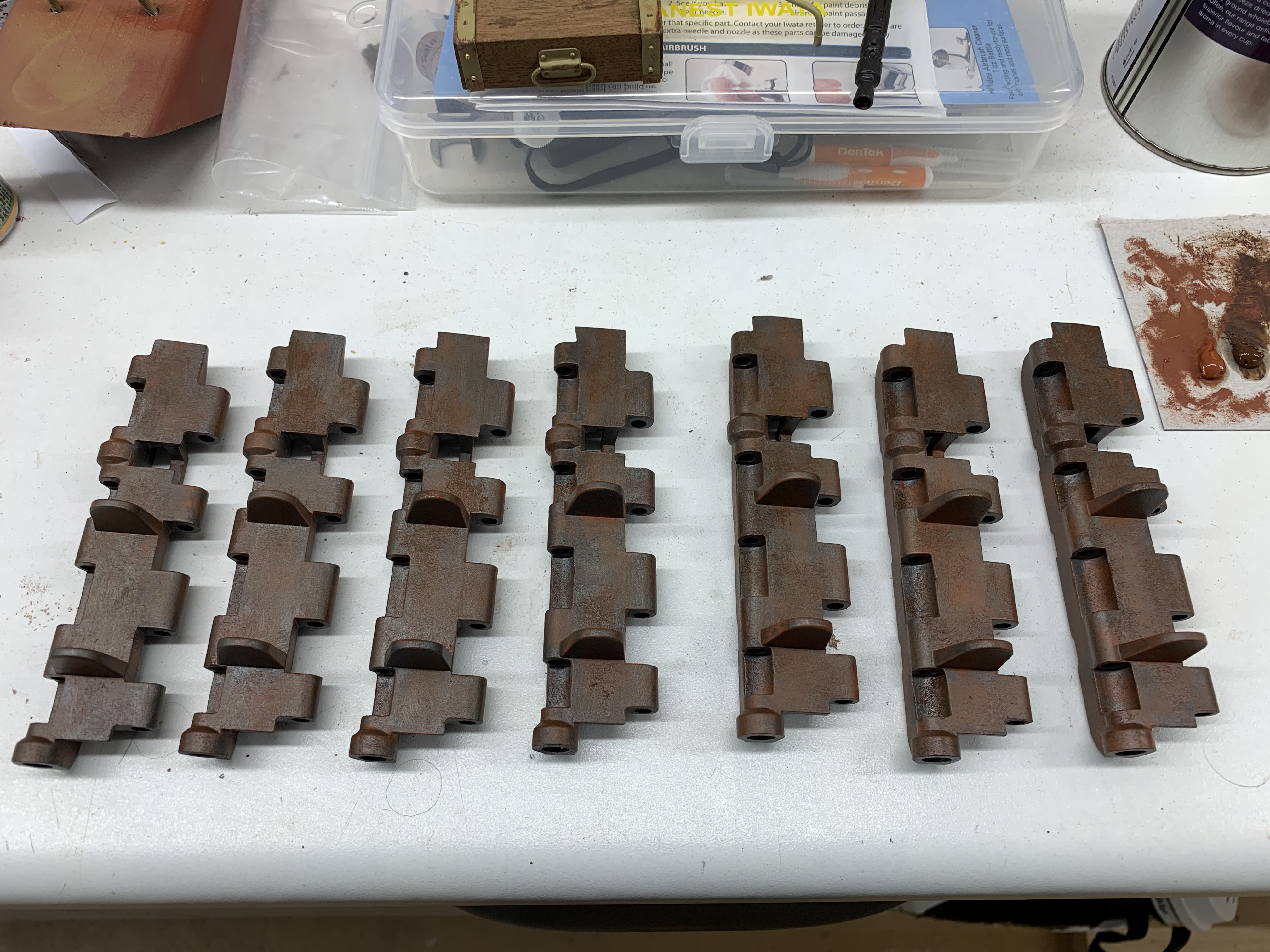

Yesterday was spent doing more detailing. I have used the dark and light rust oil paints to age the spare track links for the turret sides. They will also have a dust layer added later. The conduit from the headlight to the junction box was made using brass rod, I tried 2.25mm copper tube but it kept deforming even after I put multi strand wire inside and I haven't got a miniature pipe bender yet.
Gary

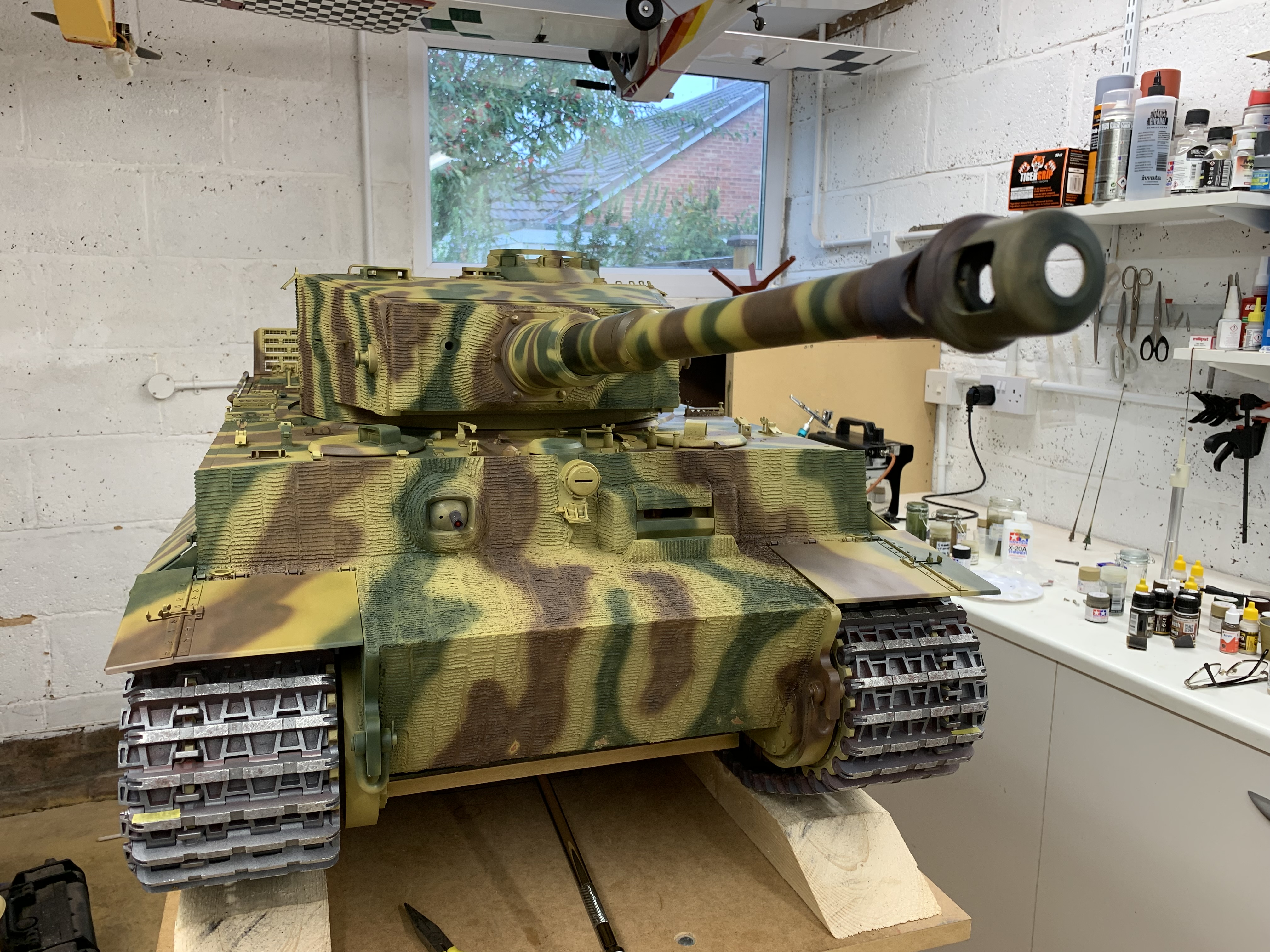

Hi
Just to let you know. The machinegun ball is mounted the wrong way. Machine gun to the right and vision port to left. It's a great build to follow.

Hallo Gary,
dir ist leider ein entscheidender Fehler passiert,
du hast die Deckel wo der Tiger betankt wird "zugeschweist",
das sind die Deckel mit dem dicken Pluszeichen, bring das bitte in Ordnung sonst
kann dein Tiger nicht fahren, da du ihn nicht betanken kannst.
Ansonsten ein schönes Modell
Gruss Klaus
Gruss Klaus

Hi RagnarRagnar Arntsen wrote: ↑Mon Oct 31, 2022 1:20 pmHi
Thanks for spotting that, I made a modification and put it back together the wrong way round
Gary
- Posts: 597
Hallo KlausKlaus Uschkurat wrote: ↑Mon Oct 31, 2022 5:30 pmHallo Gary,
Gruss Klaus
Die Schweißnähte verbinden sich nicht mit den Tankdeckeln und lösen sich. Die kreisförmigen Schweißnähte wie bei Tigern in voller Größe, von denen ich denke, dass der Einfüllstutzen verbunden ist.
Grüße
Gary
I hope Google translate got this right
