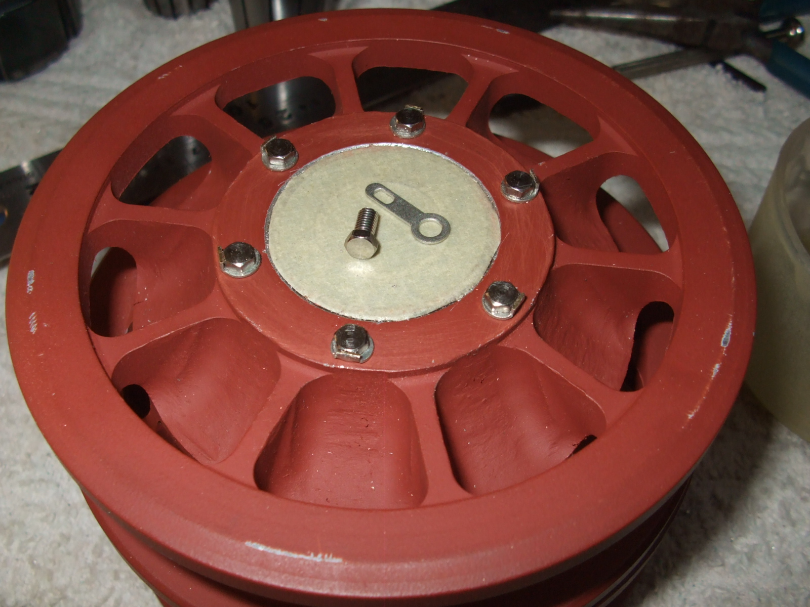

Some time ago I bought some 3mm bolts with a one size smaller hex head for the idler hubcaps.
I have seen photos of the inner face of the idler with six bolts and as I have a surplus of these bolts I thought I would also use them on the inner face of the idler.
I have also added some lock washers using solder lugs.

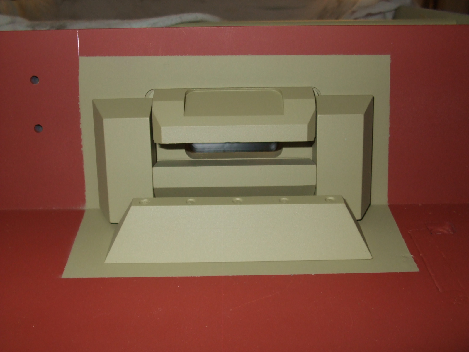

Started hacking the M/G mantlet (CE0124). Basically what I am attempting is opening up and rounding off the outer aperture. Even the item shown on page 5 looks better than what I have now. I suspect earlier Tigers had a better item. I haven't finished yet but it is all looking promising.
I also fitted all the visor armour bits and pieces.

Afternoon VinceVince Cutajar wrote: ↑Sun May 27, 2018 10:20 amStarted hacking the M/G mantlet (CE0124). Basically what I am attempting is opening up and rounding off the outer aperture. Even the item shown on page 5 looks better than what I have now. I suspect earlier Tigers had a better item. I haven't finished yet but it is all looking promising.
Lovely work, enjoying your build log. Don't worry my old 2010 Tiger kit needed the M/G mallet reworking too. I believe all the tiger kits need the same mod, just adds to the fun!
Keep up the good work
