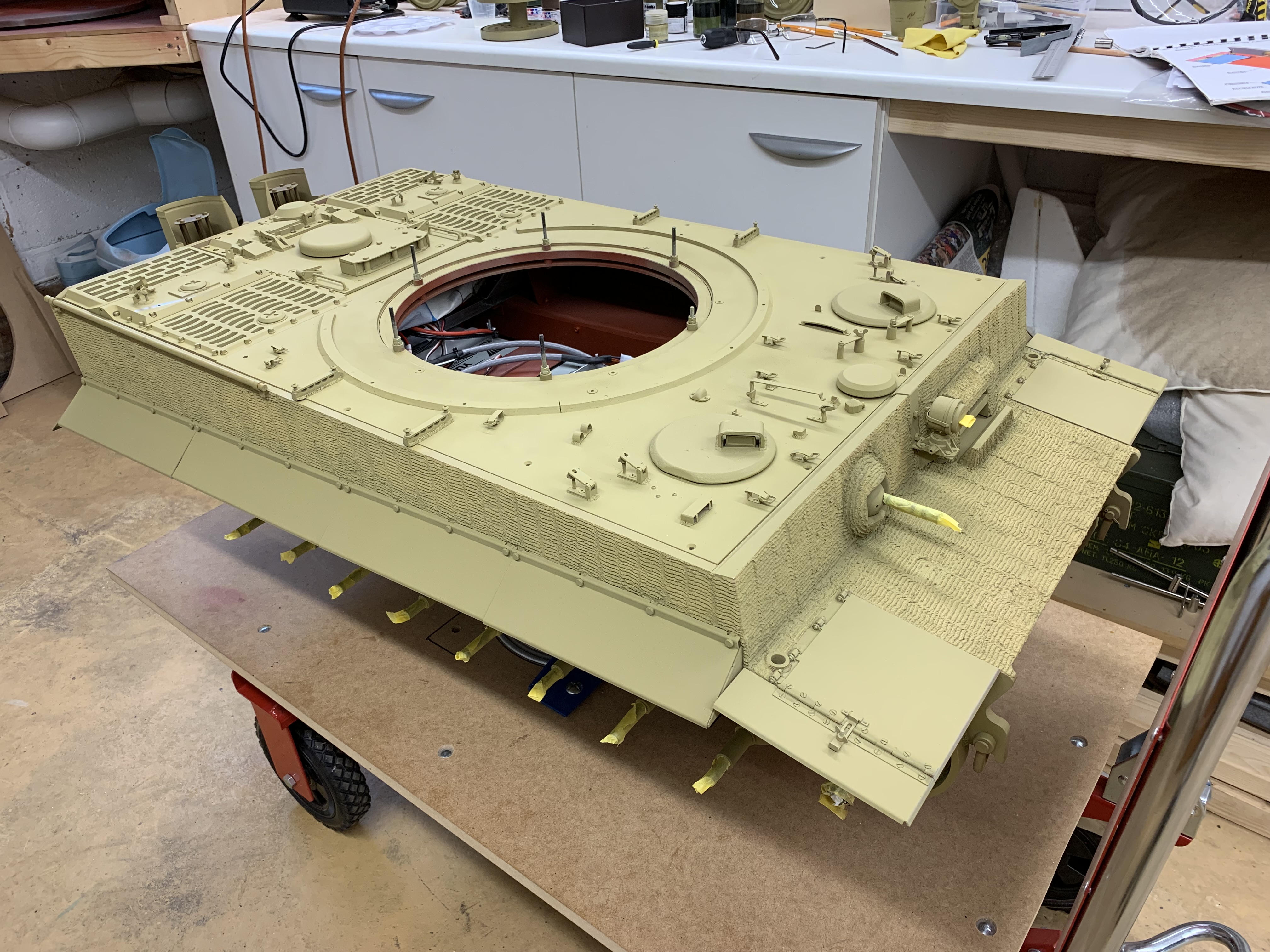

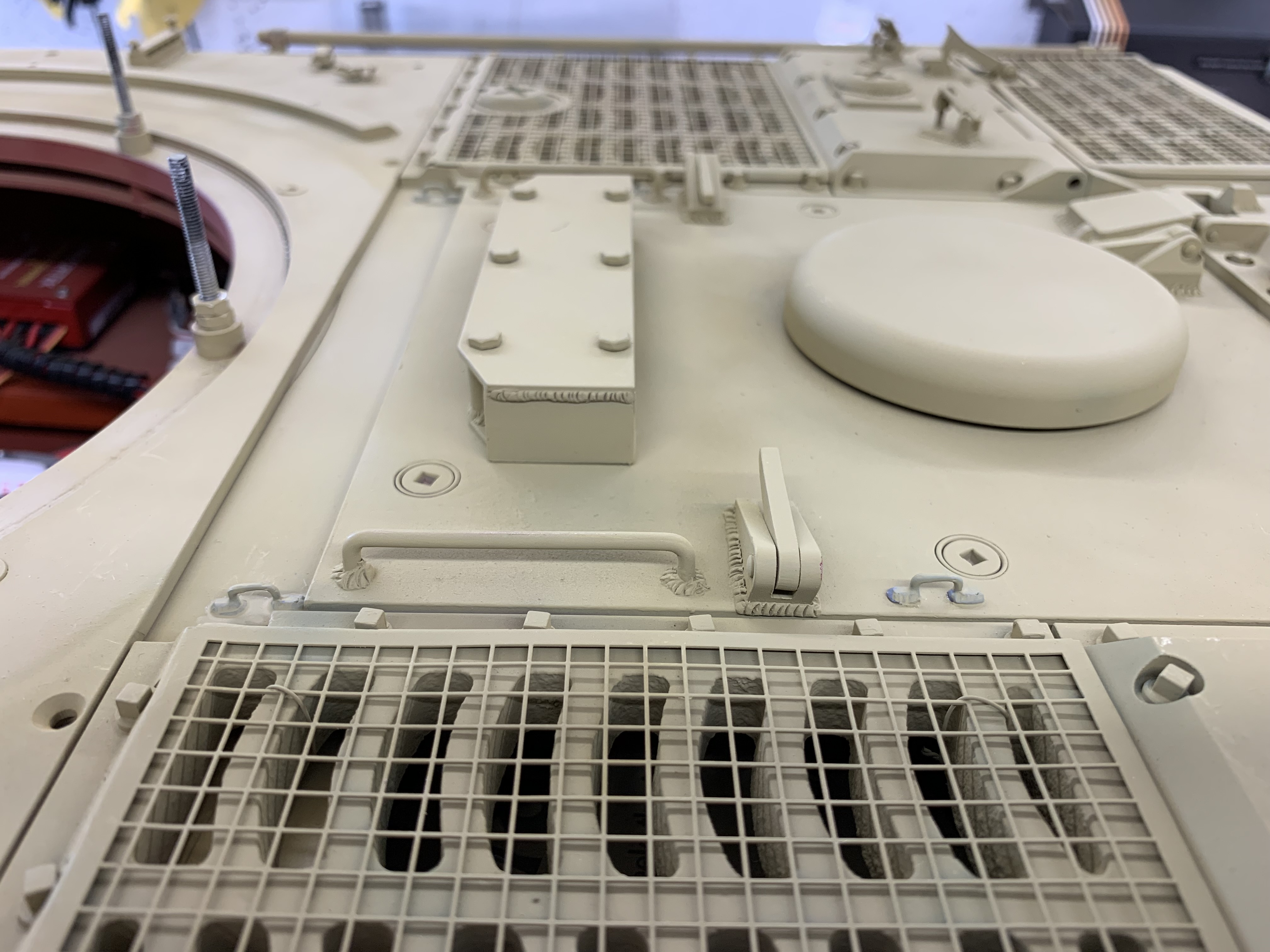

Hi all

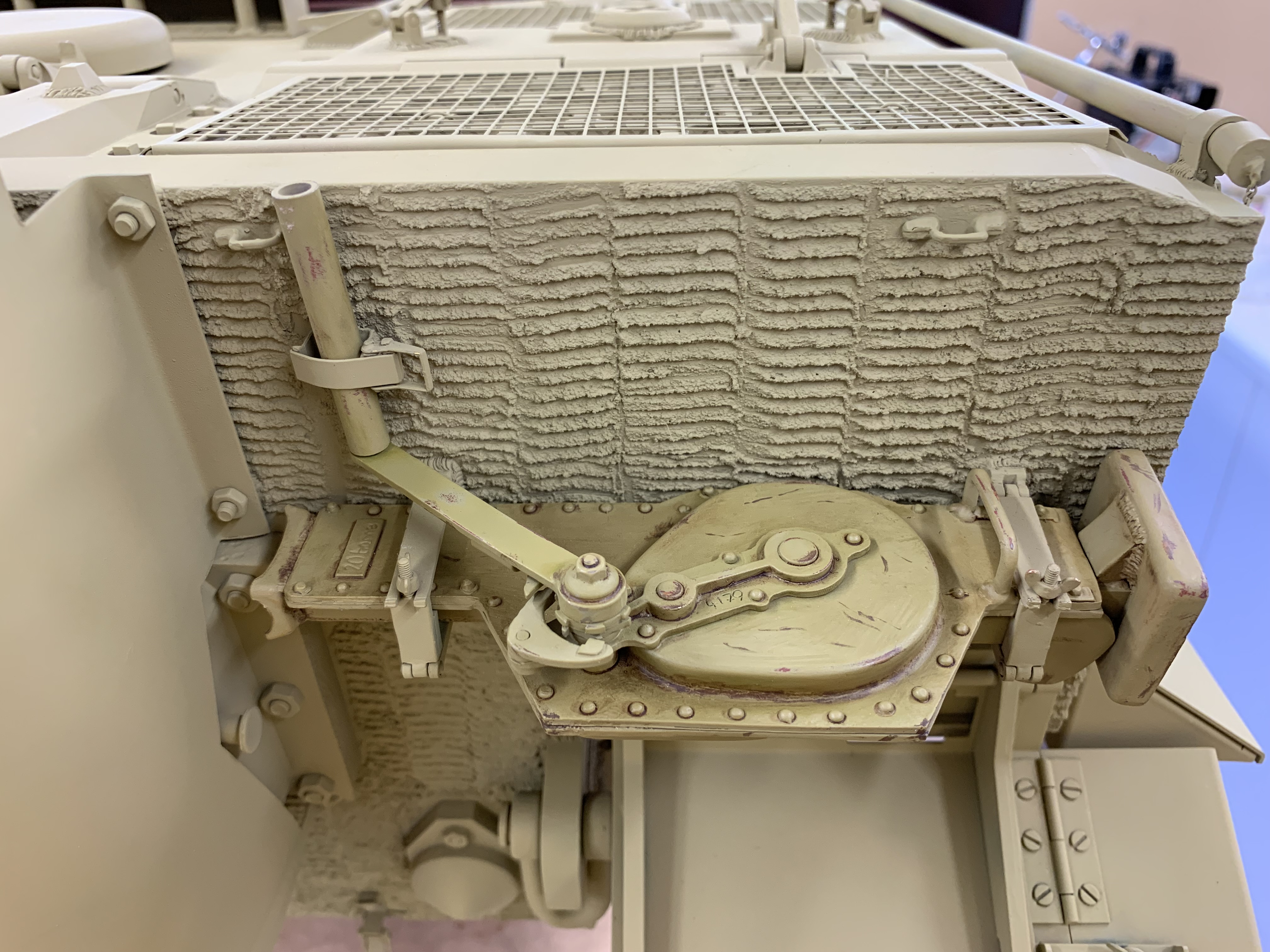

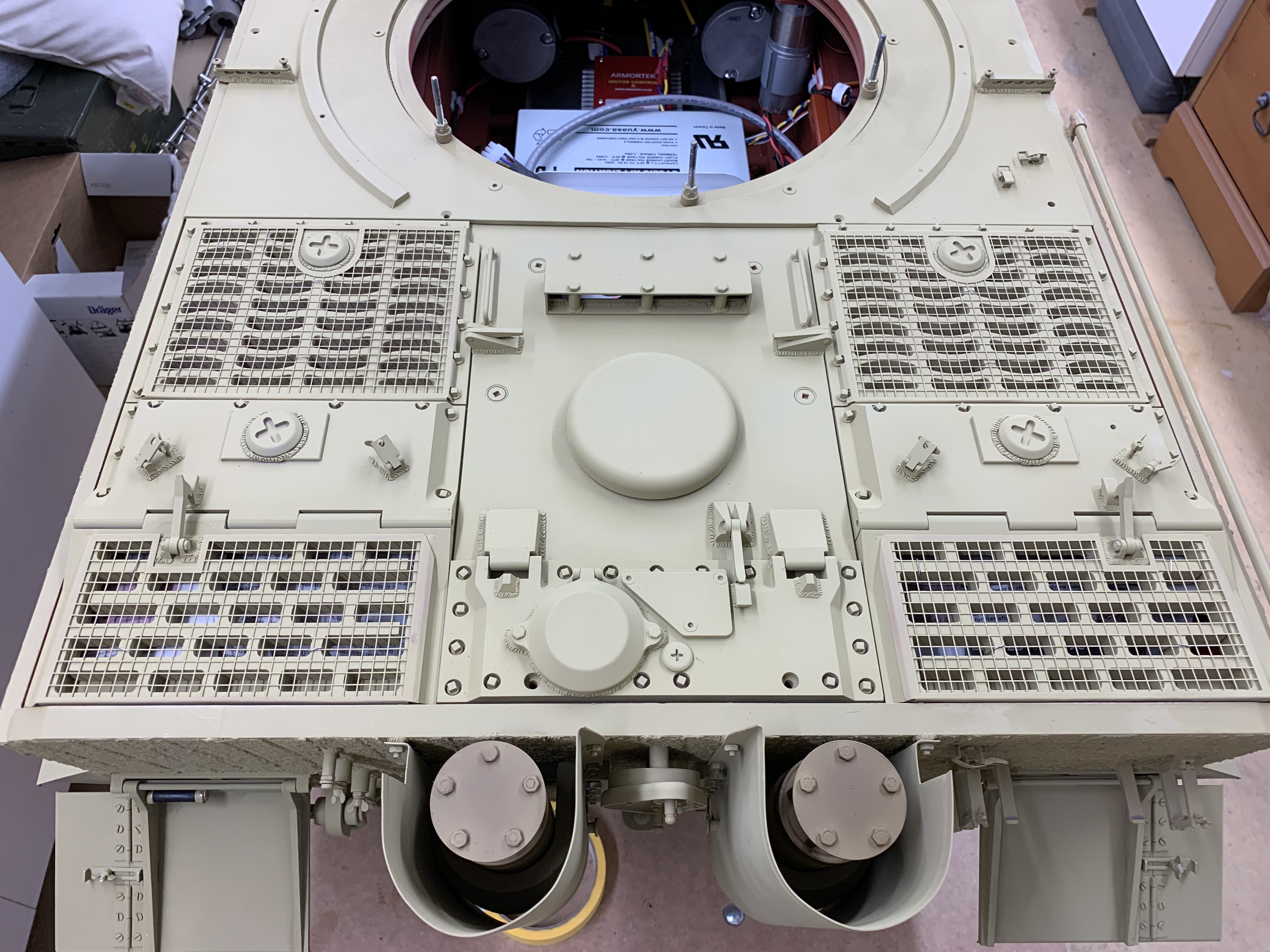

Today was spent getting the wire grills shaped and fixed. I was meant to be doing the camouflage but had forgotten to sort the grills out, they took a lot longer than expected and I had to file recesses on each side to allow them to fit around the square bolts. I have wired them in place as there seems to be a question mark over how they were held in place on the real Tigers and the few comments I could find mentioned spot welds or using wire.
At some point I may make a set of wire grills with proper frames, but they will do ok for now.
I have attached the mudguards and side skirts so that I can do the camouflage but intend to add more detail to the mudguards such as the rivets for the edge supports at a later date.
I had a go at paint modulation on the lower hull sides using tubes of acrylic paint, made a few mistakes, mainly using too much paint but eventually realised you only need a tiny spot of paint and a wide flat brush for it to work. It is difficult to see in the garage light hence no photos, but if it stops raining I will wheel the Tiger outside to see how it looks.
I am not sure how much progress I will make over the next couple of days as the car MOT is due and I have guide dog sitting to do. Hopefully I can get the camo done.

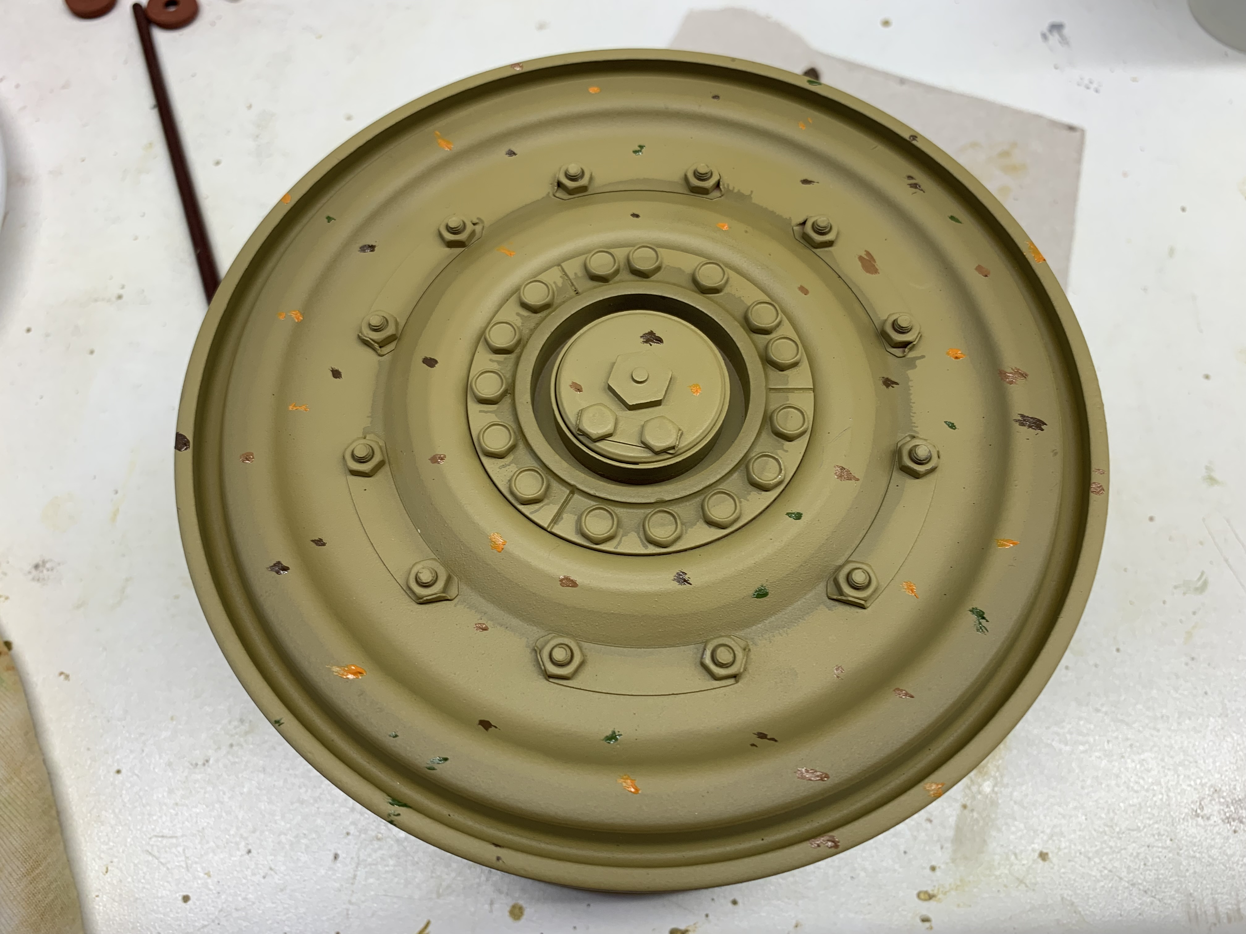

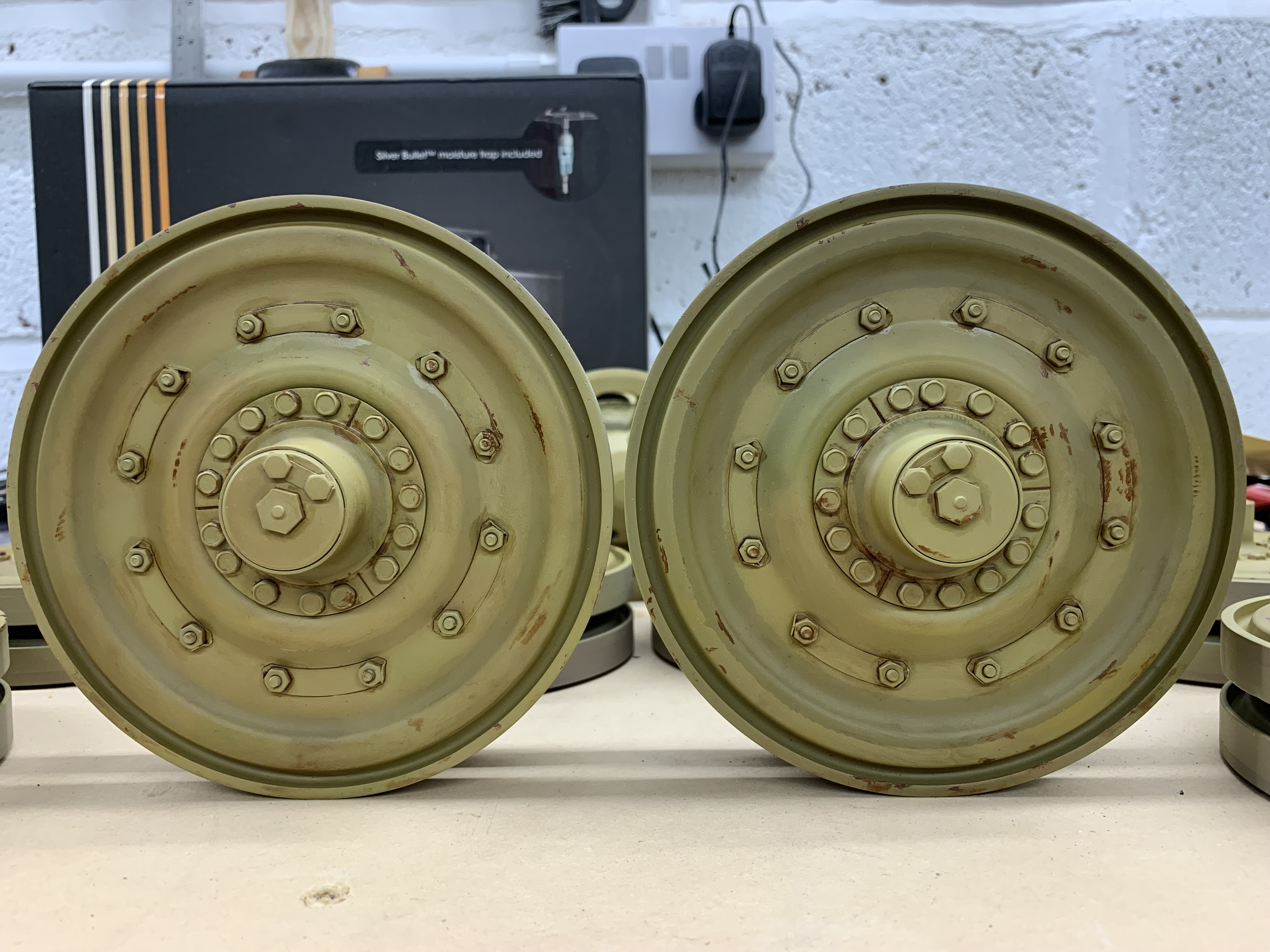

Re: Tiger 1 2021 no. 13

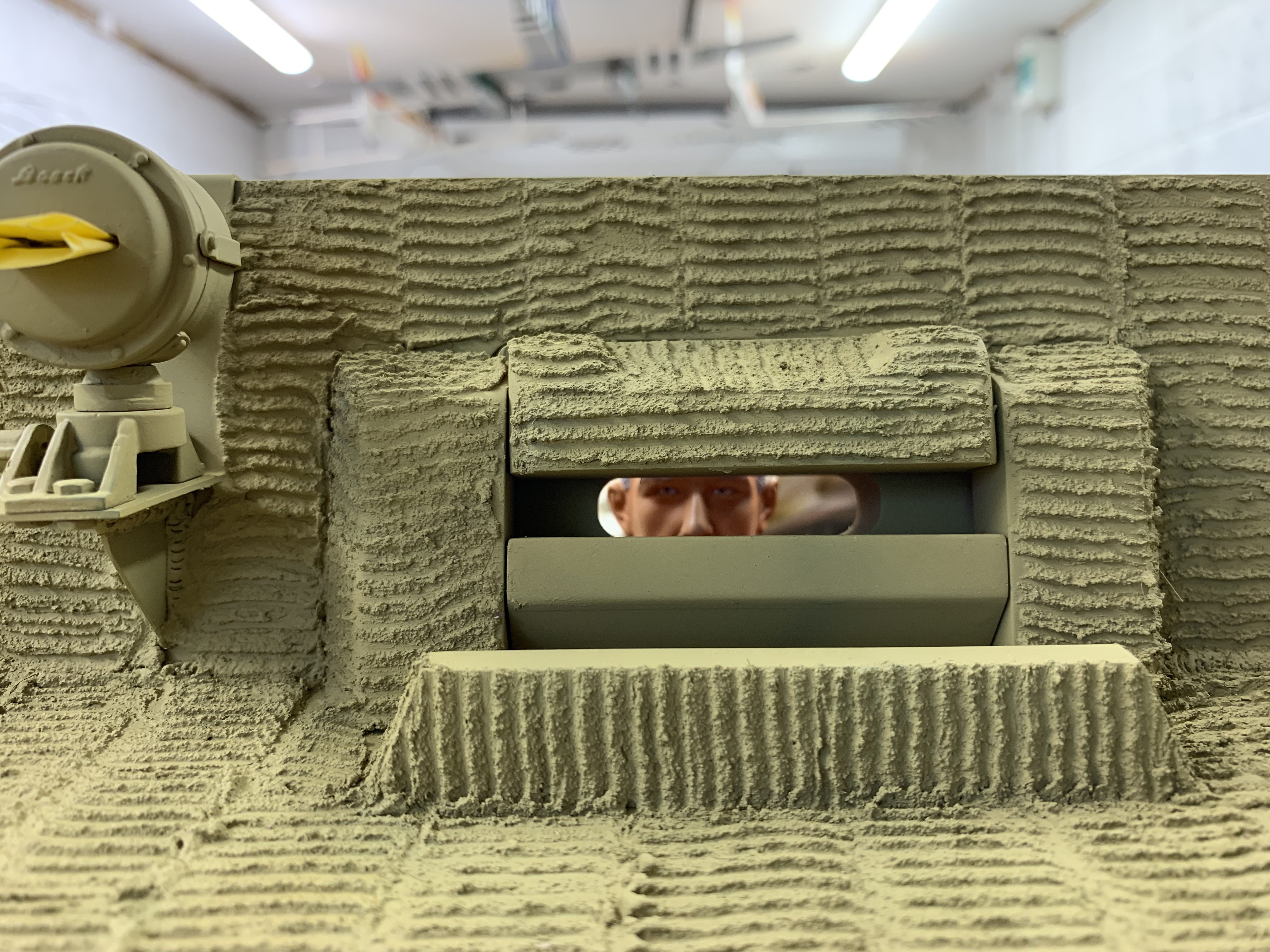

Good evening all
It's those wheels again...
This time I added some rust, scratches and dings to the wheels, again using oils.
The oils are easier to use than the tubes of acrylic and a small blob of paint is useable for two hours before it dries out. I will add some earth pigment in the nooks and crannies of the wheels then seal them with Citadel varnish and install them on the axles.
I think my driver enjoys crashing through buildings far too much judging by the state of the wheels.
Gary
Hi all
Sorry to ask this question today, no disrespect to our late Queen intended, but has anyone else used Abteilung 502 oils to add effects such as the rust I added to the wheels. The reason I ask is the paint is still wet/tacky after over 36 hours and a going over with a heat gun and being left in the airing cupboard overnight.
Is this normal for oil paints? The paint was put on cardboard for 20 minutes prior to use so soak up excess oils.
Gary
Gary
- Posts: 223
- Has liked: 551 times
- Been liked: 409 times
Hello Gary,
I have used oils for artists like Winsor & Newton. Therefore, I can not say anything about paints from Abteilung 502. But in general, oil paints dry much slower also when thinned with turpentine. I have therefore used isopropyl (alcohol) for thinning, which evaporates faster. The main purpose of laying the paint on cardboard is to make the paint more matte. The drying affects this only slightly. When weathering I have always worked in different places so that, depending on the thickness of the paint application, the colors could dry about one to one and a half weeks. You can also use special mediums that make oil paints dry faster.
Oliver
Oliver
Thanks Oliver.Oliver Brüninghaus wrote: ↑Mon Sep 19, 2022 12:47 pmHello Gary,
Oliver
Glad it's not something I have done wrong, I will just have to be patient and move onto the camouflage. I will get some isopropyl and try that.
Gary

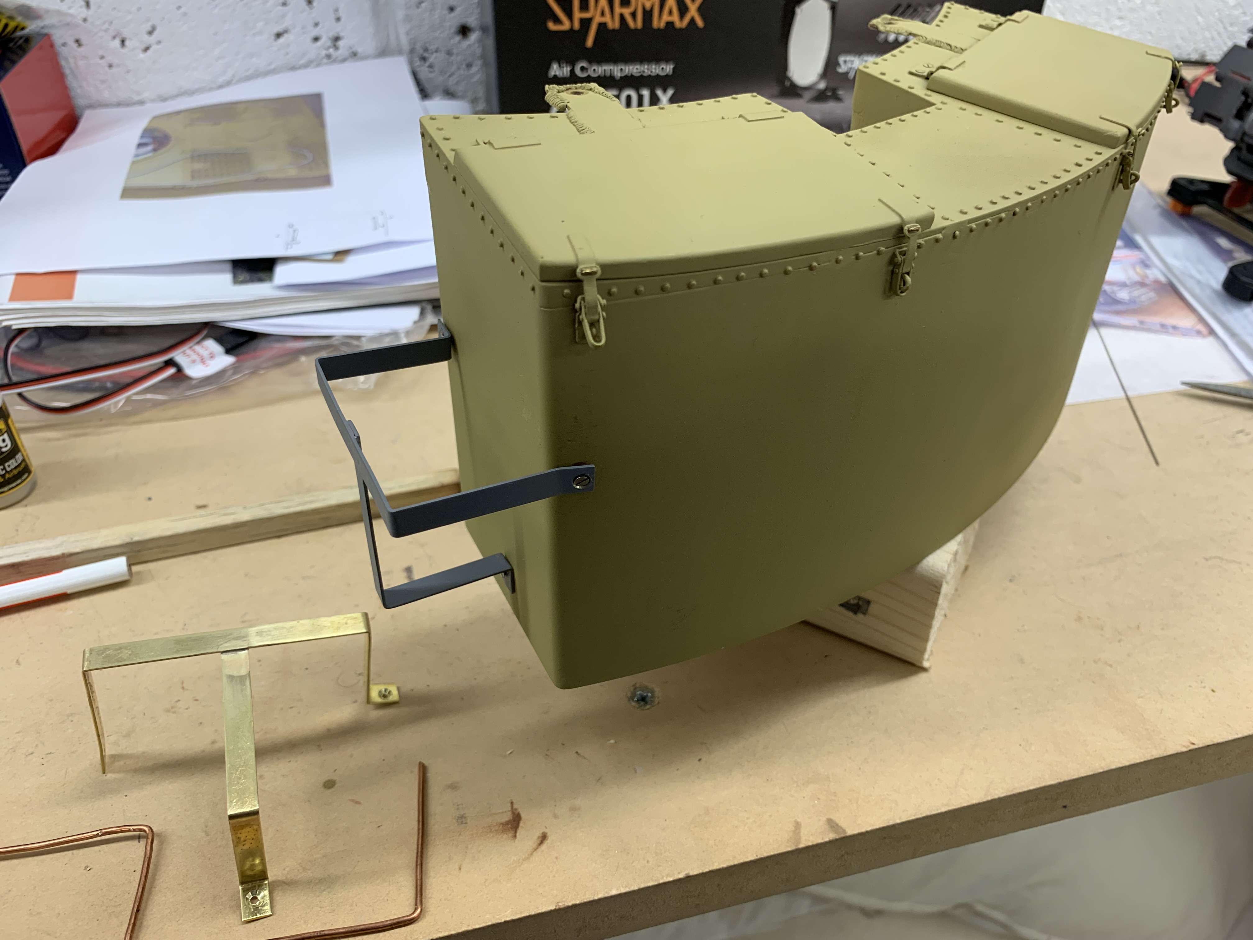

While waiting for the oil paint to dry on the wheels, I thought I would try and make the tracks look a bit more like steel. They have already had a coat of grey etch primer, then a sprinkling of red oxide and a light covering of dark grey. To get the effect I am after I used Tamiya XF56 metallic grey lightly sprayed over the dark grey, I have also highlighted the track edges and raised horns with platinum silver to give a worn effect.
Jerry Can Holders...
And now a question regarding the jerry can holders that the Panzer Abteilung 301 Funklenk Tigers had on the Rommelkiste. Were they individual racks each holding one jerry can or was it one large bracket from the front left corner of the bin to the rear right corner?
I have photos from Tigers on the Western Front pages 128 -129 but it is not particularly clear. I can see one jerry can was attached on the left bin side and it looks like there was one below each of the bin hatches.
If anyone has any information or photos they could share I would be very grateful. I would like to get the brackets done prior to spraying the camouflage effects and I will use 10BA countersunk screws to attach the brackets then add weld effects.

Re your jerry can holder query. Alost certainly individual brackets, ie one per can. Don't have my reference pics to hand at the moment, but below is how I believe they, were based on photo evidence. Note the step between the two holders on the LHS, rather than a continuation. Also only one on the back of the bin on the RHS. Hope this helps.
Now I have seen your photo it makes sense of what I could make out in the photos in the book. Glad you pointed out the step as that makes how to attach the brackets a lot clearer.

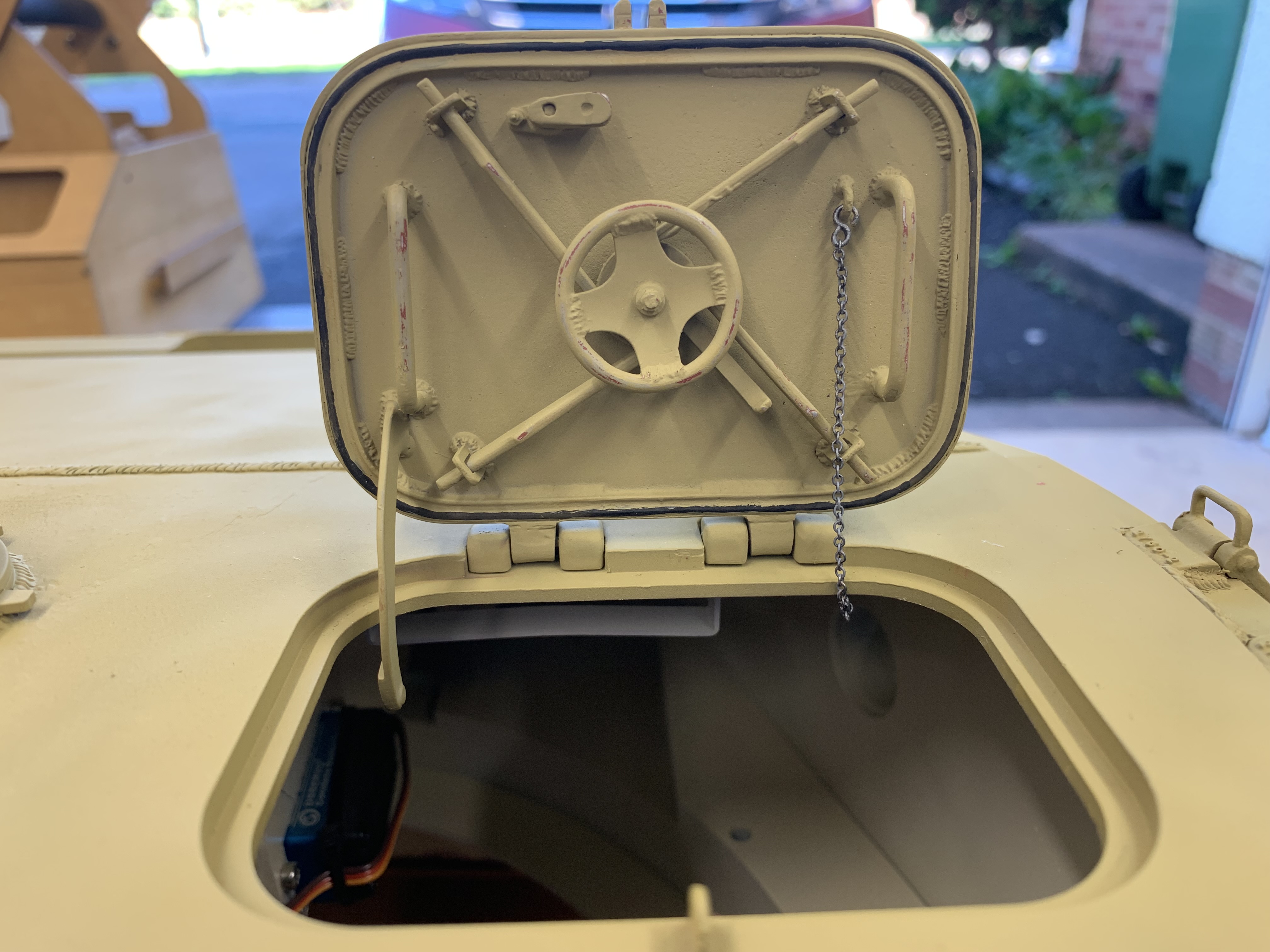

After a great day at Armortek and speaking to David about the jerry can holders on the turret bin, I got some brass strips and started fabricating the three holders. I made a simple jig to hold the two parts of each holder together which allowed me to silver solder the parts together. Each holder is different, so it took a while to get them just right. I drilled 1.6mm holes in each of the holder end and they will be attached to the bin using 1.6mm csk screws. The holes have been countersunk and the screwheads will be filled and the welds added prior to a final coat of paint.
I also added a small chain to the loaders hatch after seeing something similar, I think it was on Vinces's Tiger build so thanks to Vince for the inspiration.
The ties downs I picked up from Dave Dibbs at the open day have been liberally added to the rear deck and sides of my Tiger as I intend to add some sundry items for added interest.
I have been a bit distracted over the past week, mainly due to the Churchill I bought at the open day. I can feel an AVRE with Petard and fascine holder coming on......
Gary
Gary
