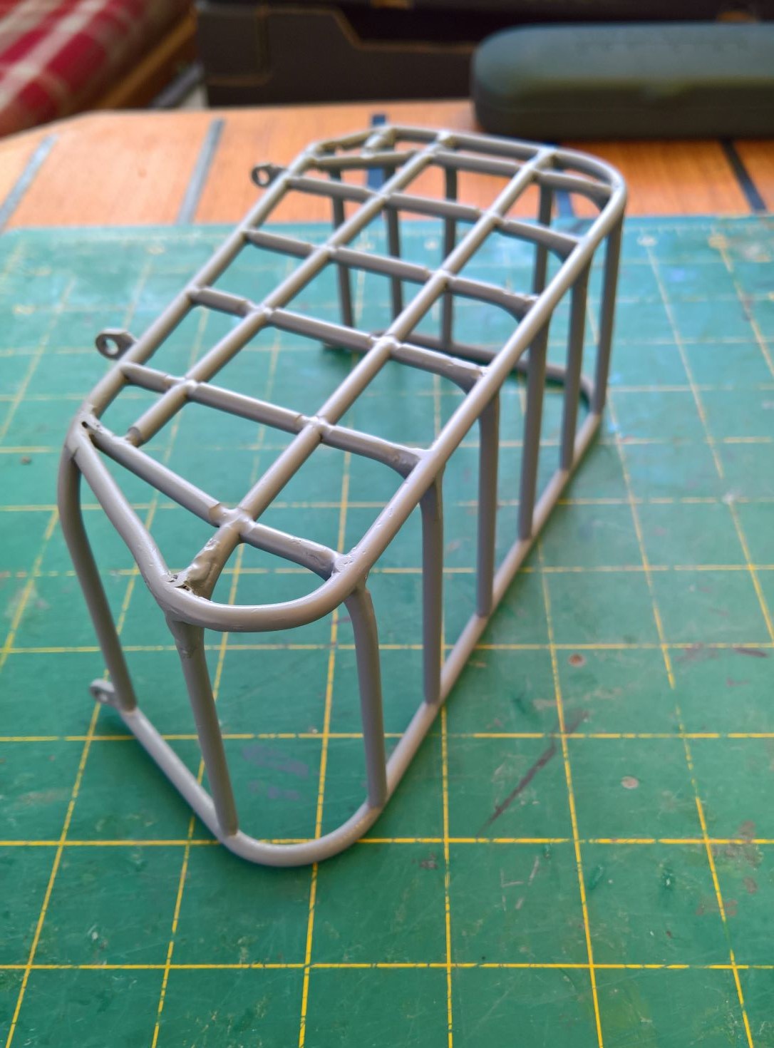

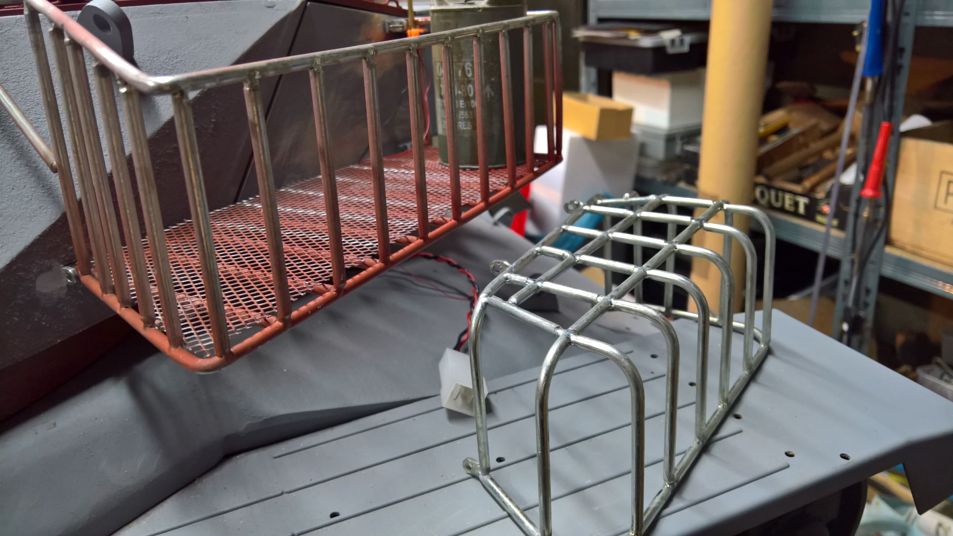

This means I have been able to tackle something that has bothered me for a while. I referenced a new build in a post or two ago, this, I have now avoided. It meant cutting up loads of 4mm wire and welding them together to form a new Commanders Basket. I hope the following will help reassure other Chieftain owners.
Real Commanders basket:-

Kit basket
Mod 1
Filling
Undercoat
There is some more filling to do to finish off. Thanks John for the Goo heads up, I was surprised how well it bonds.

Well worth the effort Charles, I'll be doing the same with mine. A bit of wire mesh, flat trim, jobs a gooden.
The original commanders basket supplied was alright, but it just did'nt match the left hand side, which with its squarer edge is far more realistic.

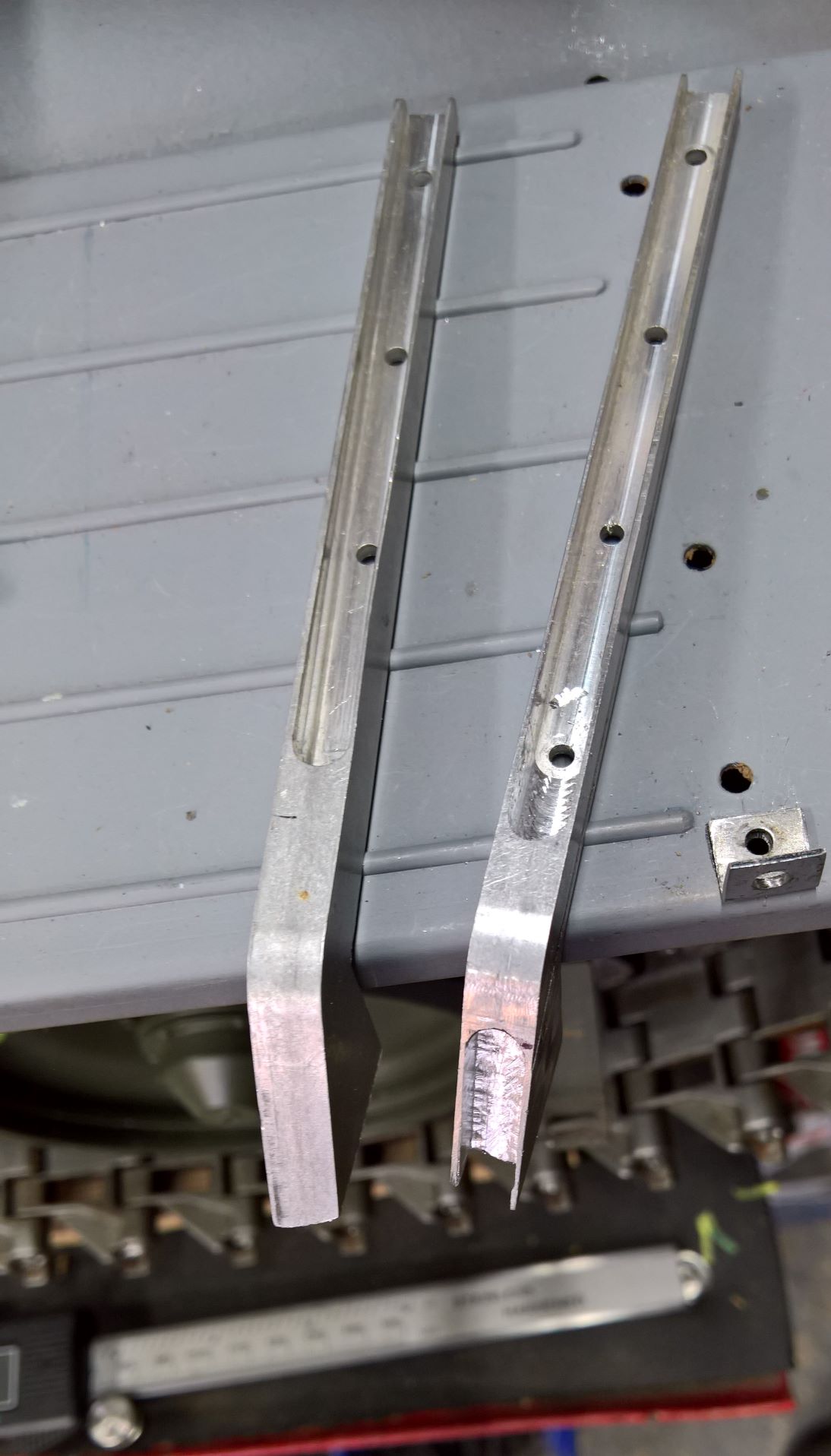

I have been bricking this next bit, trivial as it might seem, but I haven't done any milling since I had one go in metalwork at school in the 70's. I am using my la'al lathe and it appears to have worked :lol:

Nice work Charles,they look tricky little buggers! :mrgreen:

Nice job Charles. 8)
