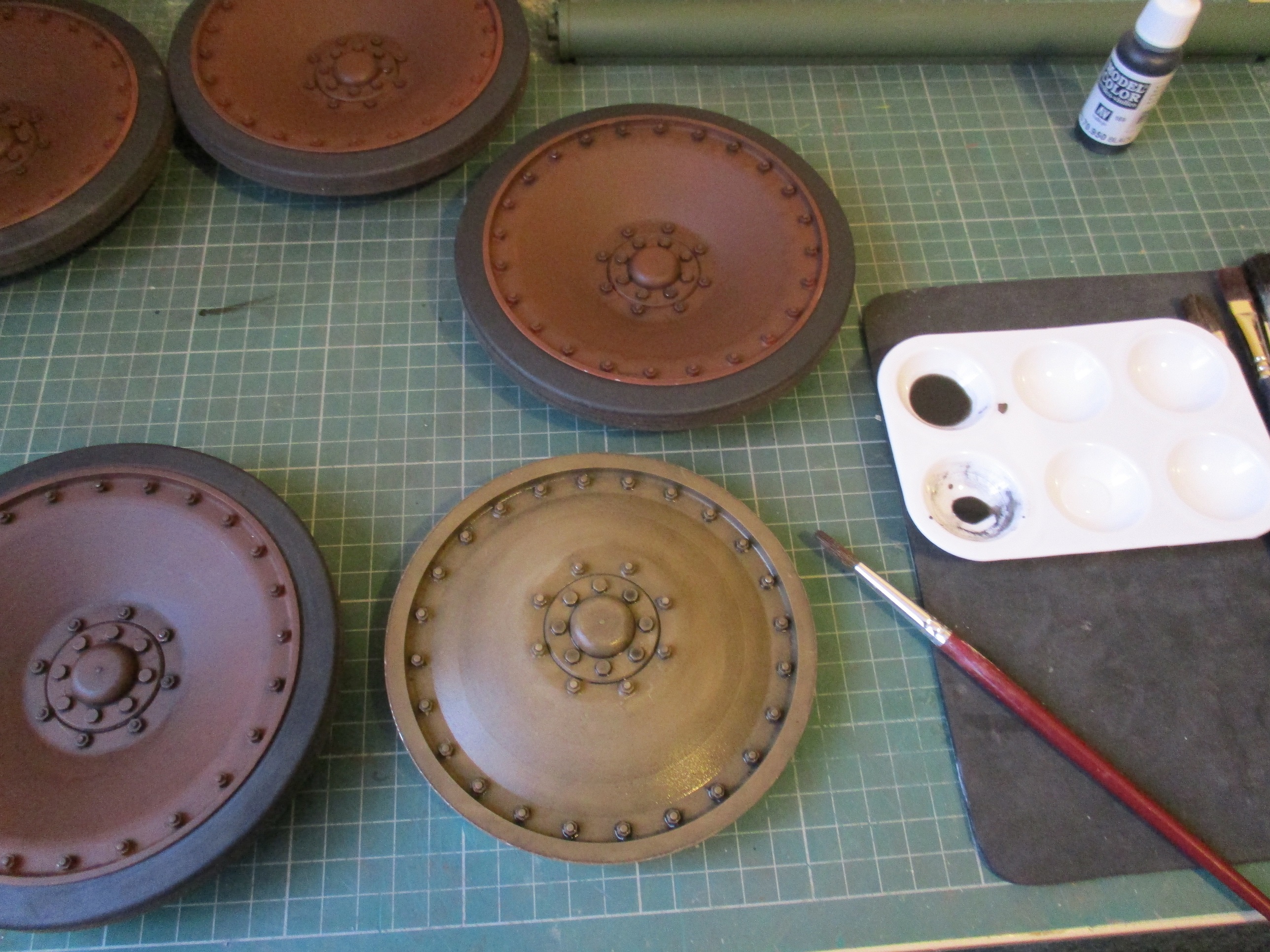

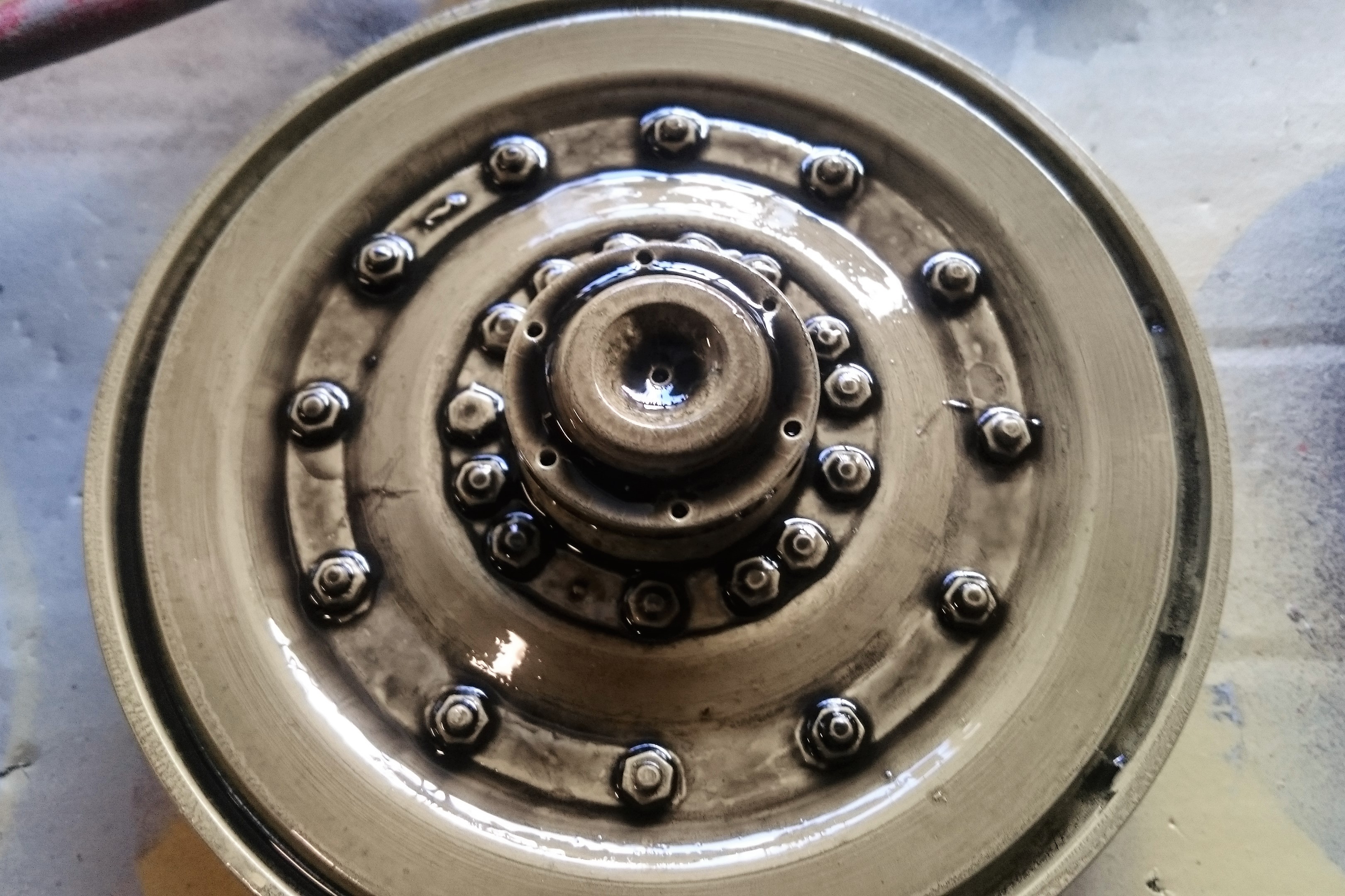

Morning Mick. some reference pics for the depth of wash, this can be built up with many or you could leave after just one application , it all depends how weathered you want it look . The darker red oxide wheels will need a tad more than the lighter dunkelgelb
how about applying the wash to one of the dark yellow wheels and see how that goes.
The wheel hubs need more pigment as this area would have often been wet with oil and grease, also turning more slowly being close to the center of the axle and so not throwing the muck off so much ....Phil.

Morning Phil, I can see what you mean, it's all in the eye of the beholder. To heavily weather or lightly weather. I'll go with the lighter shades at first ....I can always increase the depth as I progress. On my Panther, the 'muck' around the wheel nuts looks far more realistic in the flesh, than it does in the photograph. It's very interesting and I am enjoying the challenge....Mick

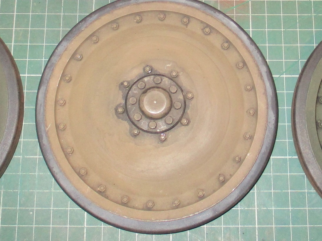

Never mind Phil, there's plenty of room on the Forum, I have weathered one of the Dunkelgelb wheels, see results in attachment, I rather like the look....The other darker wheels are Flecktarn Braun base paint, by the way I have wiped some of the black wash off the Dunkelgelb painted wheel... Mick

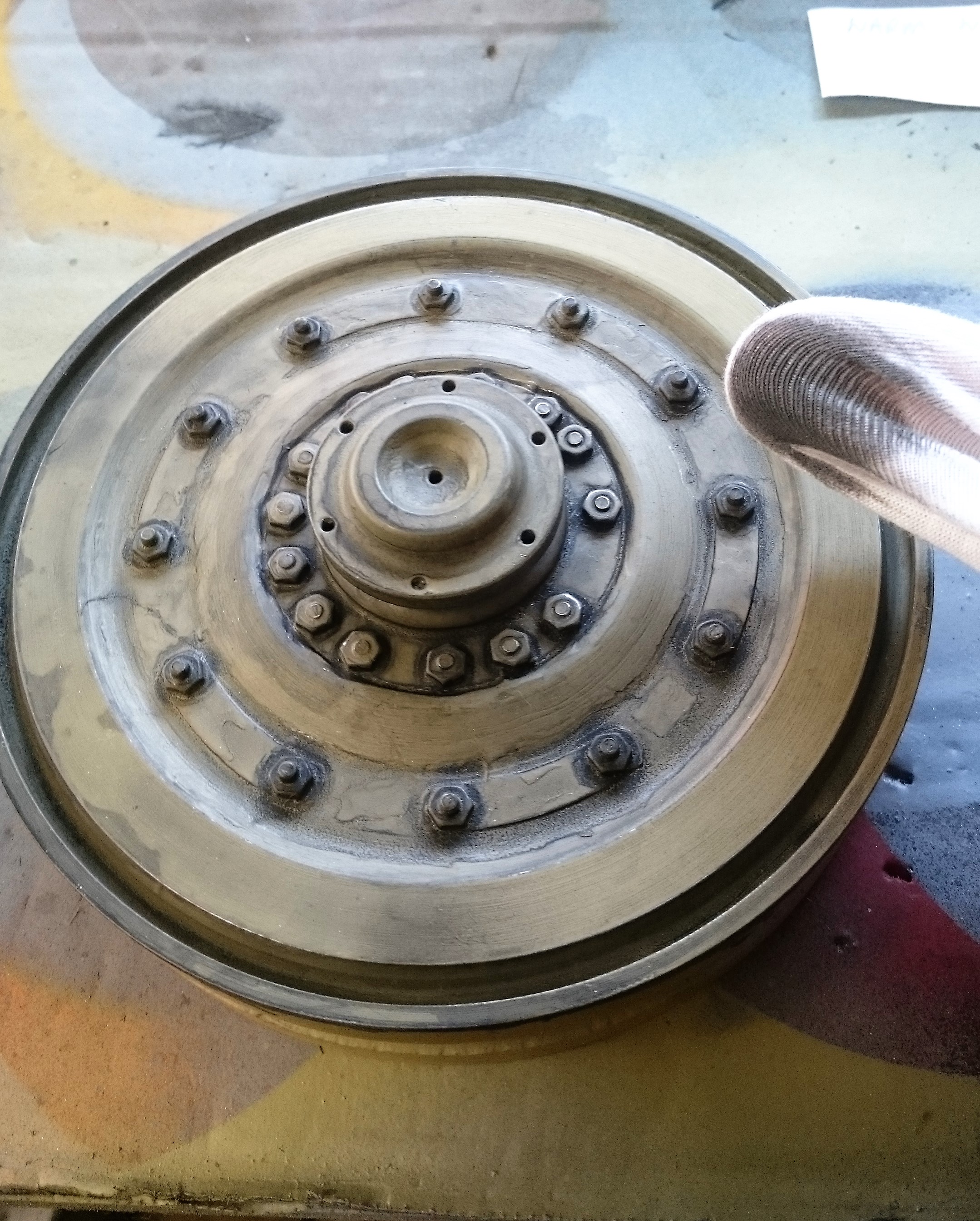

Looking Good Mick, the trick is developing the technique of removing the wash, sometimes from everywhere that you can get to, sometimes leaving areas and sometimes rubbing right through the whole lot to expose the underlying paint.
Try to make it random or it will look to clinical.
Applying just enough thinner to the rag is very important to, very very important . Too much and it's uncontrollable, it's a bit like dry brushing it needs to be damp not wet. More finger pressure will remove more paint. smaller scale modellers often use a Q tip or cotton bud but we have acres of the stuff to work off.
Don't rub the pointy bits like bolt heads to much or as much, also be careful with edges or you will easily rub right through.
With lighter colours like the yellow you will need to keep turning the rag as the dirty wash sticking to it will leave nasty streaks.
Just experiment, this will prepare you for the large plates on the Panther where more skill is needed to blend it all together, just think of the effort Stephen has put into that Cent, washes are just the easy part and relitivly quick and effective on thier own!

Hello Phil, this is a Dunklegelb wheel, heavy wash then wiped with Meths...first attempt....Mick

Well you have mastered that! Very satisfying init, from a factory fresh to a been about for a while wheel , now delve through the yellow with some rubbing on the big flat surface as if it's lost a bit of paint in the mud but keep it random though just here and there and maybe rub them nuts a bit ( no pun intended ), then you can try some gentle scratches , just a couple mind that can look false if your not careful.
Remember we can paint over it all if your not happy with it

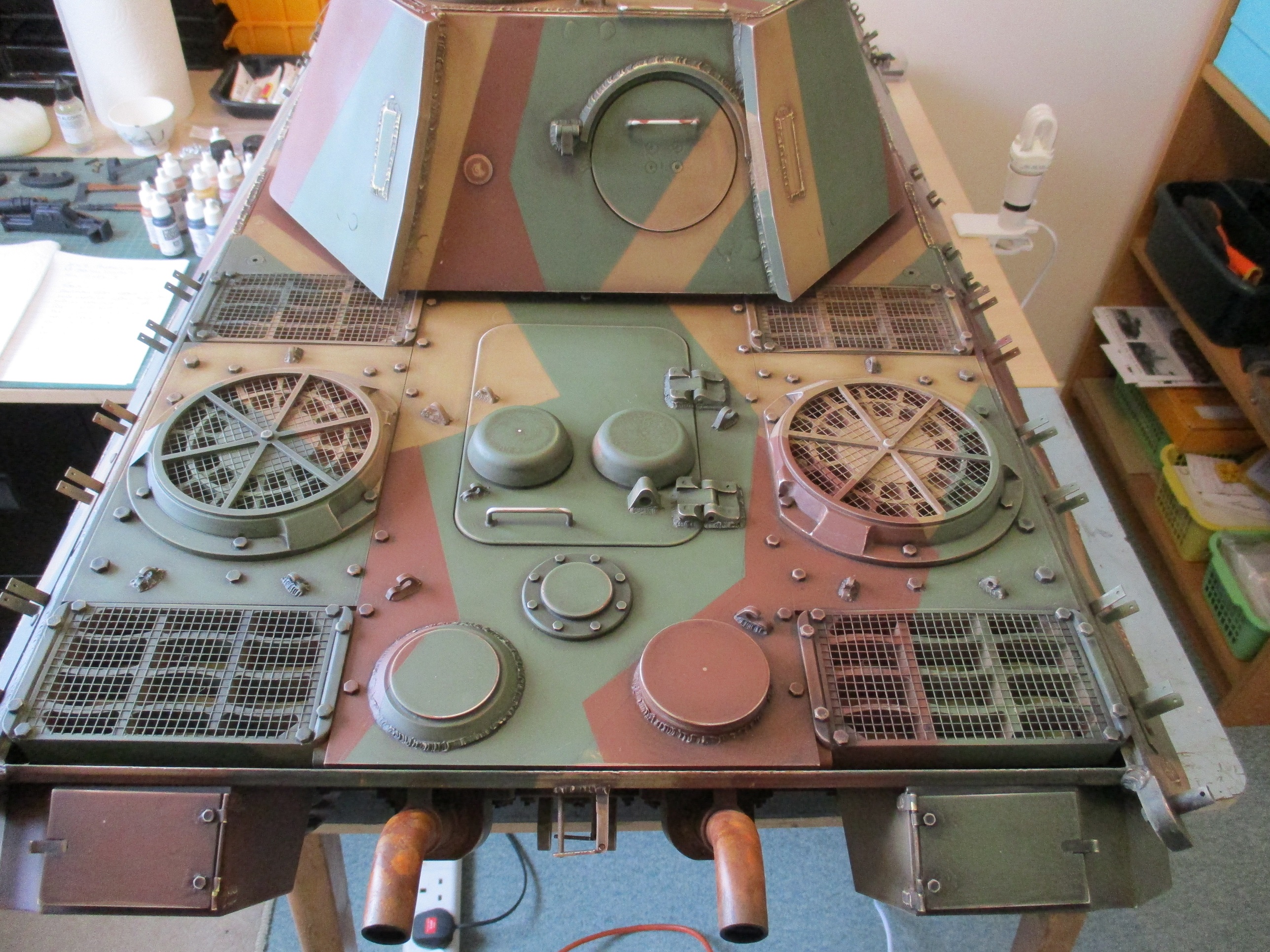

Brrrr, lovely morning this cold and frosty morning, bring it on, 1947, now that was a deep mid winter, I still had to go to school though. Progress with the weathering of 'me Panther', thanks to Phil, Stephen and the Knowledge Base. It's difficult to know when to put down the brushes and leave well alone. I think I am nearly there, it is pleasing to the eye, so I must be close. All acrylics and brush painting with copious thinning and careful use of kitchen tissue to remove the excess paint. Time for the bacon and egg....Mick

I was beginning to wonder where you were Mick but I can see you have been busy!
That's a nice tidy job Mick, she looks new but not that new, been in service for a few months in the summer time maybe.(but not seen the front line as yet)
I would say that's a mild to mid weathering and is unique to you, she will develop some nice natural wear on the running gear as it's used.
Very very nice you should be well chuffed , regards Phil.
