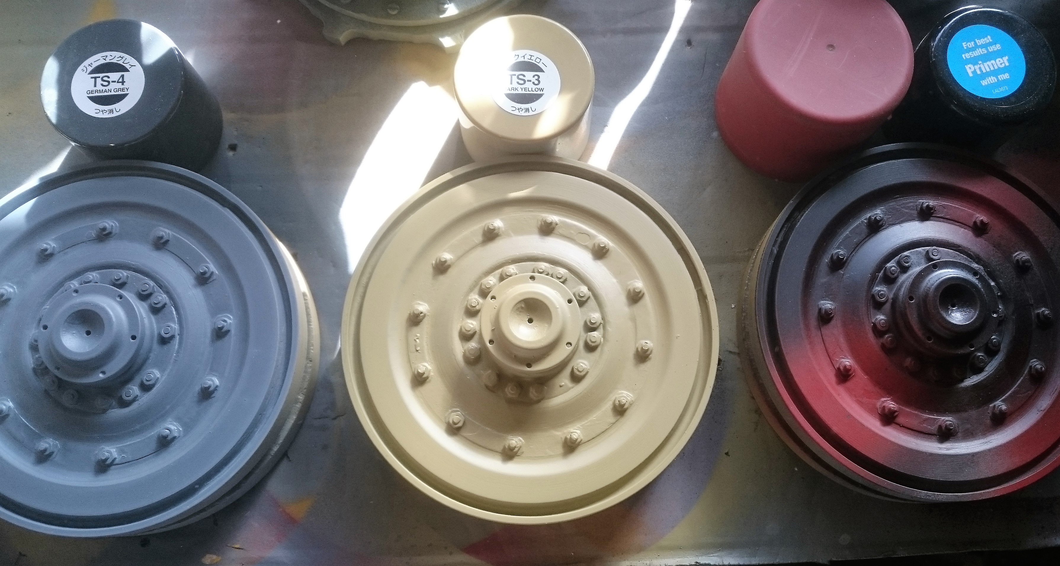

Hi Mick, I have painted around 3 KT wheels in various Wehrmacht colours and will apply a coat of wash and post some pics in a bit with before and after shots, have you applied the wash Mick and if so is it dry? Can we have a pic please. It's so exciting init
You will need some of the thinner that you have used for the wash (or meths) and a nice clean cotton rag (lint free ) oh and your finger.
As you have used NATO spec paint for the Panther I feel that we won't have any trouble with that coat being affected, if we want to cut through that as well to reach your undercoats we will need Acetone or Petroleum Spirit and a rag and finger......Phil.

Some pics of what you need to start with Mick.
When you have mastered this really easy method we can then move onto the large armour plates, we have a way to go as yet though, so lets learn to walk before we can run.
Phil.
Phil.
