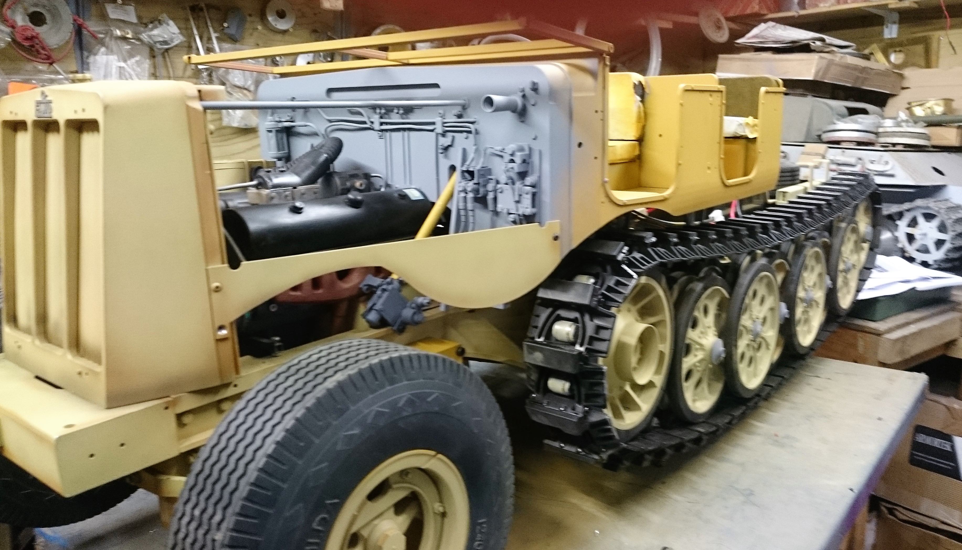

Your work is truly spectacular! Is there any chance that you might offer some of your custom parts for sale to the rest of us (there are MANY) that you have created for your Famo? Especially the engine i the engine bay. What do you think?

Hi Jim, thanks for the Kind words, I don't think I'll be offering custom parts as that would be a whole new ball game for me. I'm happy building armortek models and adding that bit extra. It sure does go down well, and if it benefits armortek and they keep producing interesting subject matter then I'm happy .

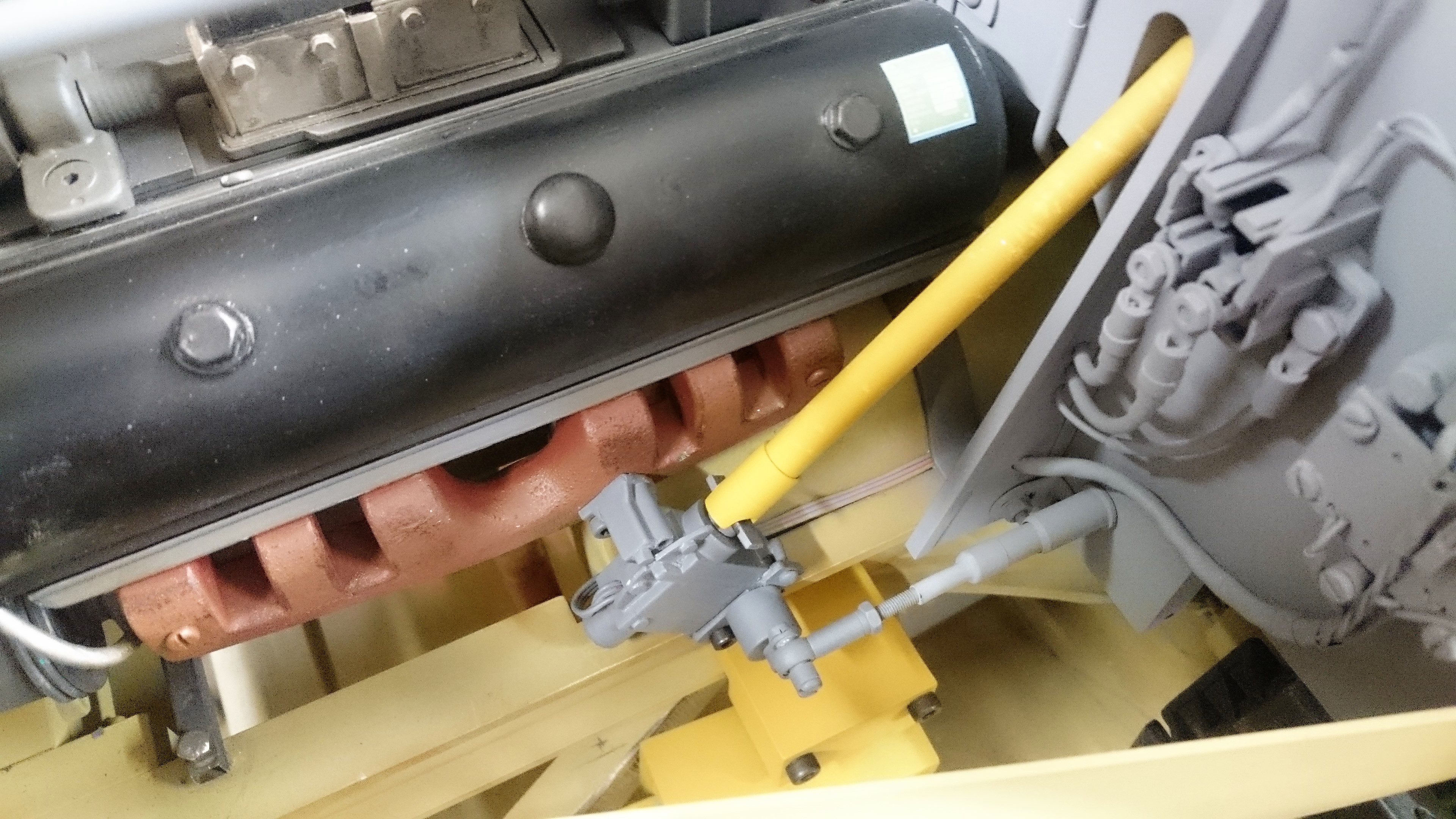

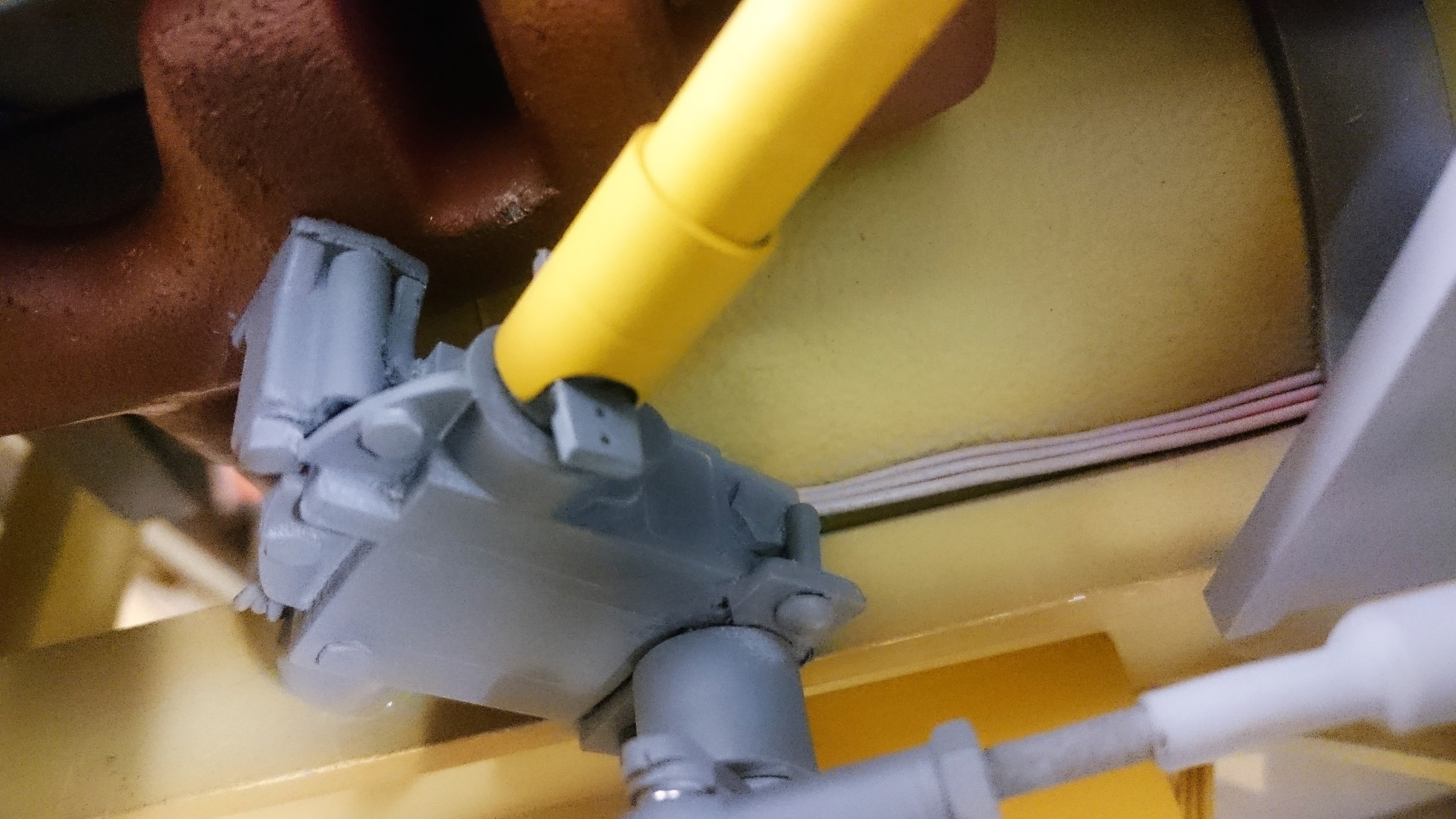

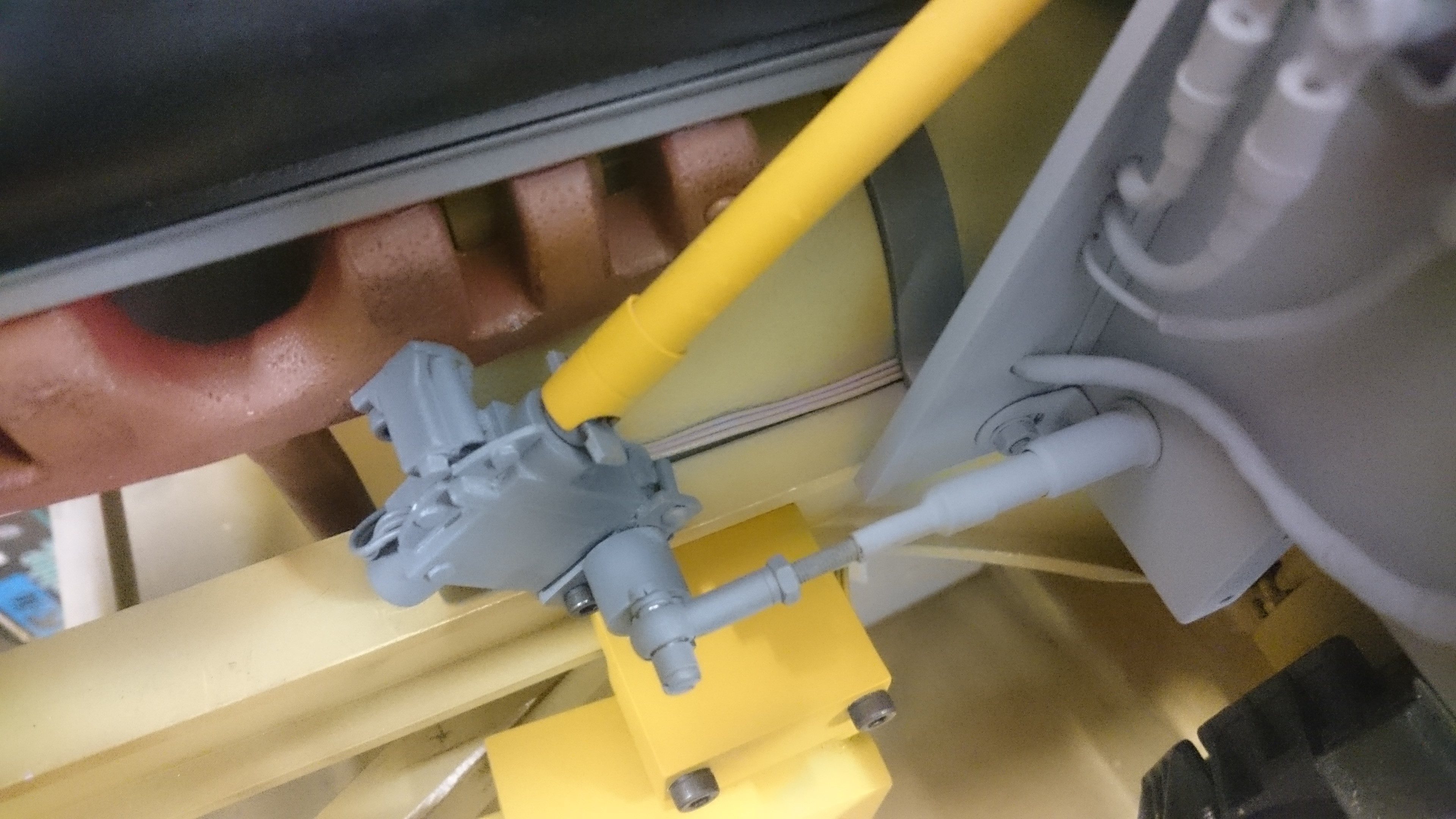

The steering box and power steering ram added.
Last edited by Phil Woollard on Sat Dec 15, 2018 7:56 pm, edited 4 times in total.

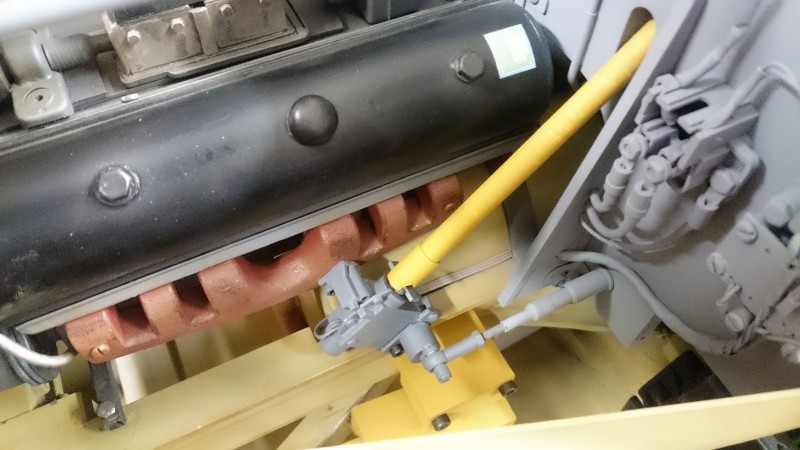

Motion and sound now fitted and working nicely. The steering actuator is working beautifully and I think you can see in conjunction with the steering wheel, it reacts just like the power assisted steering would, a very nice smooth and powerful operation with a realistic hydraulic pump valve lag, no not lag that's the wrong word, response... valve response.

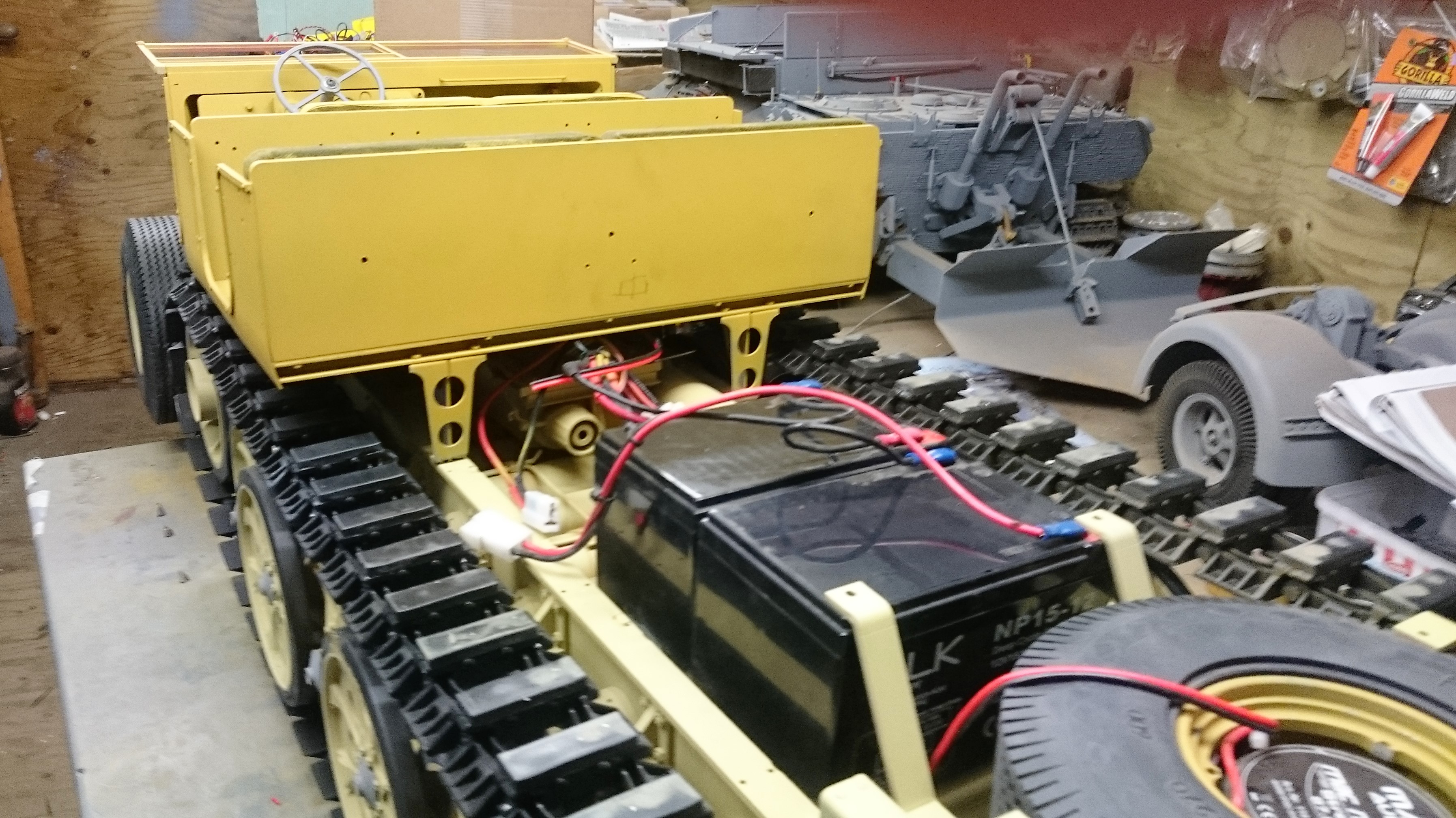

You take the lead gel battery like Armortek? -
I use the LiFeP04 battery. They have more power, capacity, and longer run... In my 251 I have 10Ah and drive a hole meeting weekend without loading.
Also the weight is only 3kg. Unfortunatly they cost about 200€.
Take this one...
