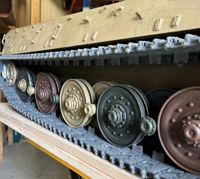

I'm sure you've already done the fundamentals however just for completeness I would check:Michael Allen wrote: ↑Mon Mar 25, 2024 7:32 pmHi Derek
Thanks for this - I will certainly check it yesterday but I’m fairly sure I matched up the dimples when assembling the sprockets . I’ll drop you a note tomorrow.
Appreciate your thoughts
Mick
- make certain the sprockets are running true; simple to test, just run the model without tracks mounted and observe the sprocket's rotation. better if you can set up an object near as a reference point
- ensure the spacing between the sprocket rings is consistent and spaced to engage the track sprocket holes exactly
Also the shaft on which the sprocket runs must be absolutely true. Also the alignment of the sprocket must be parallel to the center-line of the running gear and hull side; in the same vein ensure all of your road wheels are aligned properly- it doesn't take much for the road wheels to cause the tracks to jump. A loose track doesn't help- it accentuates other problems.
It's clear that something is interfering with the smooth accurate running of your tracks; there's only so many possibilities.
Ensure that there are no screws or any parts mounted incorrectly so that they might interfere with the track's running. The track under a load is a completely different environment versus running with the model raised. Even if you were able to remove a link pair the track would likely still run irregularly and you'd likely hear it 'catch' briefly before the track settled onto a sprocket tooth.
You will find the cause

I’ll go through your note and check everything again later today. I have already replaced both sprocket shafts with AM supplied shafts. I think I will swop the LHS and RHS sprockets over to see if the issue swops sides.
I cannot understand why the track on one side looks to be so much looser than the track on the other but I’ll keep working through it.

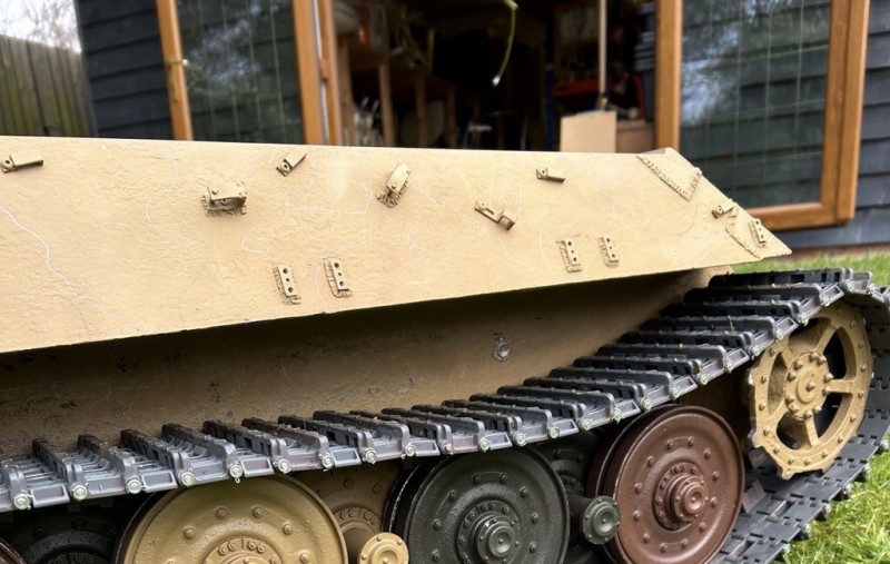

Hi Mick, From running a KT for over 10 years now with no track issues, I can say that the track tension on your pic is way too much. The higher the tdnsion, the more likely the tendency to throw the track. I run mine with the tracks resting on the wheels up to the third one, seen from the front.... If it helps, I will be over in the UK end of June. I could bring a complete setof run in tracks with me and you could try them.. Let me know what you think.Michael Allen wrote: ↑Tue Mar 26, 2024 4:06 pmHi Tim

Sounds good. When you take the track off and Layout it out straight on the ground, does it run straight, or is it curved?

Peter, they both lay absolutely flat.

Read through this thread back and forth a few times , found that the gap distance between hull and inner sprocket had been quoted as 20mm or even 21~22mm on your and/or other builders' KT /JT.
The gap distance on my 2009 KT (now with Liam) and 2019 (2020?) JT , according the building manual , is always 19mm.
Is there such an increasing of gap distance in newer batch that I have missed?
If not , try reduce it to 19mm. Maybe it helps a bit. Good luck.

The sprocket rings themselves look fine, both sets of dimples line up and all the teeth are in line. The sprocket wheels are another issue which I will go into later.
Re: yours dated 03/36
The LHS sprocket wheel certainly is not running very true. I have already replaced both sprocket shafts. The RHS sprocket is not absolutely perfect but it is certainly a lot better than the one on the LHS. I have a brief video but cannot post it on this forum. I have sent the video by email to Kian and look forward to his valued views. One more thing of interest regards the sprockets is the paint being removed from them through bench running. The RHS (good side) pretty much has all the paint removed from the teeth on both sides of the wheel. The LHS (problem side) has all the paint removed from the outside teeth whilst the internal teeth are largely untouched!
The road wheels look OK - not totally perfect - but not more than 1mm/2mm difference. I am able to run a metal rule easily through the gaps with no issues at all but I do intend to revisit them all over the weekend as I’m keen to get this sorted.
No screws or other parts look to be incorrect.
On Kians advice I have tried very hard to take one link set out but the track just will not close up sufficiently to put the pin back even with 2 g clamps trying to persuade it.
I intend to put the missing link back, re visit the wheel alignment, swop the two sprocket wheels over, reinstall the tracks, keep all the weight off the hull and run the tank. Unfortunately the weather has prevented me doing this for the last few days and doesn’t look great for the weekend.
