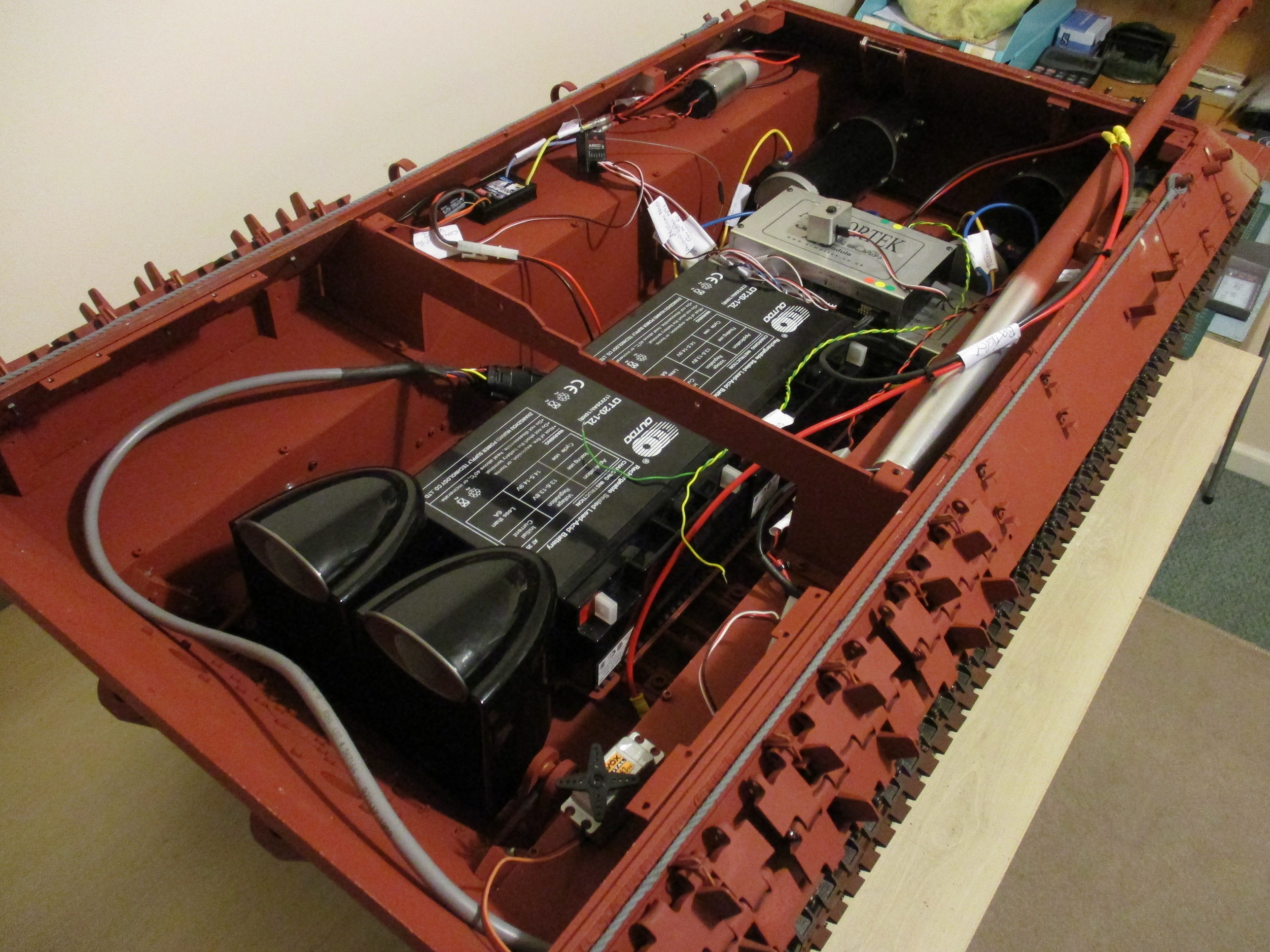

Hello Dennis, and thank you Phil for the advice. I have had a general tidy up and move around, I was tripping over myself. The motion pack, audio and motors are located in the hull, just to get a feel for it. I will test the system over the next few days before the final bolt down...'mount up, move out', time to watch 'Fury' again

Re: Mick's Panther A
Looking good Mick, you got tons of room, if you can point those speakers up towards the cooling vents in the rear deck or it wont seem loud enough , regards Phil.
Hi Mick,
By putting the audio module up the front will you will able to access the volume control if needed, just a thought.
Dennis.
Hello Dennis, I noted your comment. I have arranged both rear and front deck to be easily removable, also the top of the turret. Not the final fit however, most of the electrical modules are in place. Best wishes for the New Year to you and your family, and thanks for all your help....Mick

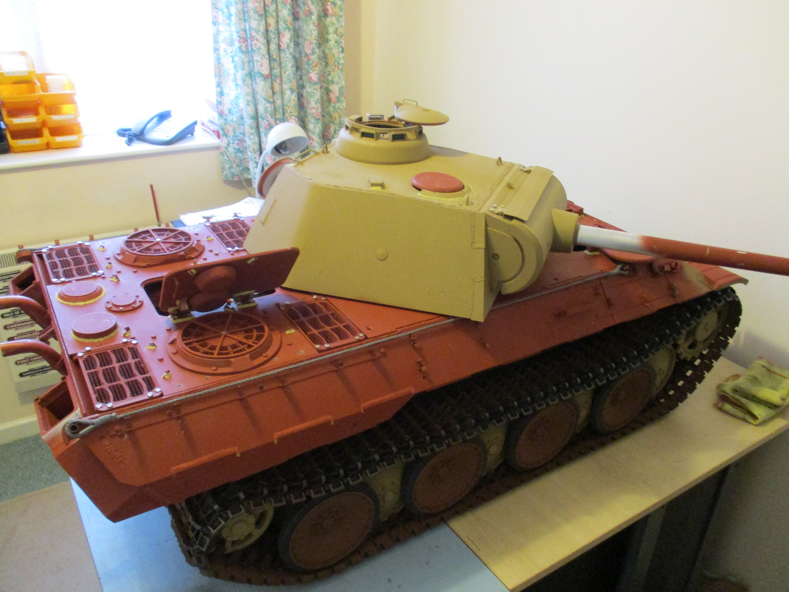

Good morning my hero's, thought I would post a couple of photographs just to keep the pot boiling, so to speak. If you want 'tight' this is it. Testing the recoil shot a shell straight through the bedroom wall

Morning each, lots of activity on the Forum, I am enjoying all the builds, especially Phil's Quad. Here is my penny worth. I am pushing on with the final parts fit. Had to turn the old girl around to gain access to her rear
. I used the radio and motion control. You do need a very light touch on the 'sticks' while manoeuvring the Panther in a confined space. One wrong move and it's half a day in A and E....I have the remote start and smoker switch finally fixed, access through the rear deck hatch cover. I'm itching to make a start on the Linear Splinter camouflage making full use of my stock of rattle cans.....Mick.
