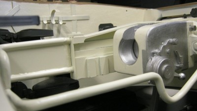

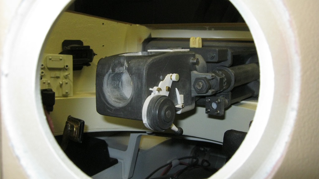

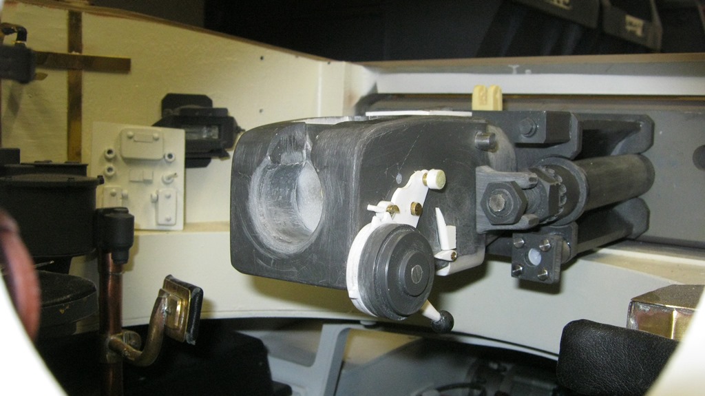

Hi All,
Well I think I have gone as far as I am going with the breach, I just have to paint it all and refit it back in the turret. I couldnt resist taking some photos tonight.
Paul.
Paul.
- Posts: 4279
- Has liked: 2280 times
- Been liked: 7192 times
Re: Tiger 1321 rebuild
Nice photography Paul, through the looking glass.....had to look twice ,now I want one ! Regards Phil.

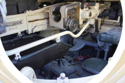

Thanks Phil, I got the idea from the last two photos, these were taken by Harvey Black of 131 last tiger day. The set of photos on his web page have been very helpful, and just a thought, If anyone was thinking about buying books to help them with an early tiger The two books I have found most valuable have been the Haynes Tiger tank manual and The Research Squad (Tiger) had the most detailed photos I have seen so far.

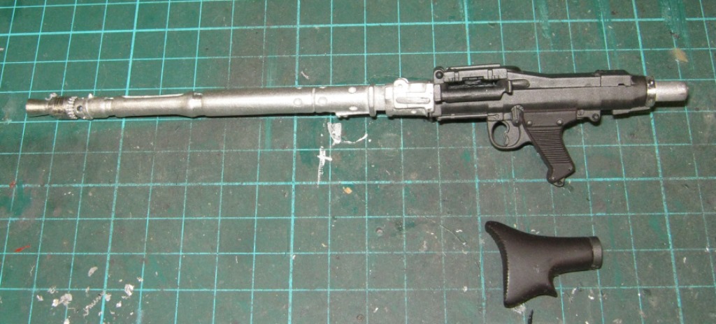

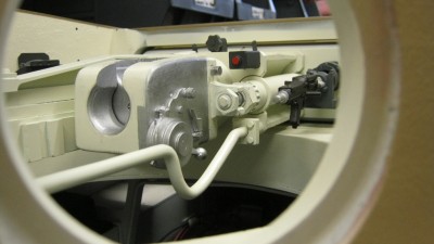

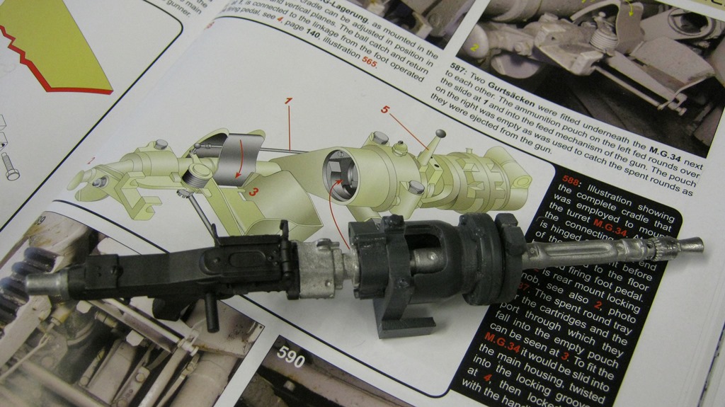

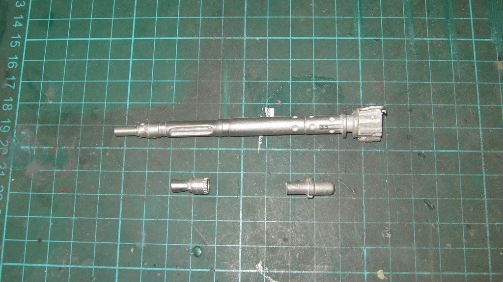

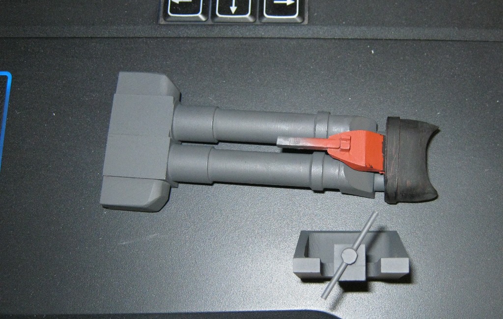

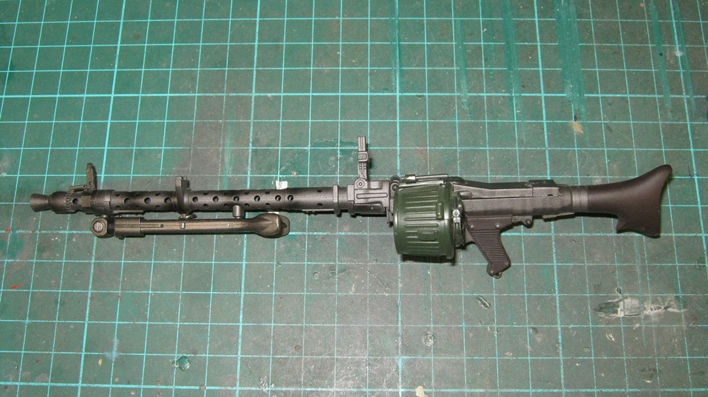

Hi All,
Just a few photos of the breach after painting, and the eagle eyed among you will see I have started on the MG34 mount.
Can anyone help with some information on the MG34 mount. How far should it project through the from of the mantlet, is this about right? I cannot find any info in my books! Paul.
- Posts: 4279
Lovely lovely work, the mg from what I have seen protrudes just a tad more basically level with the narrow part of the barrel cone, flush with the mantet. Then you have the binocular sight to sort on the other side of the breach, and the counter balance arm ! Can't wait to see it finished

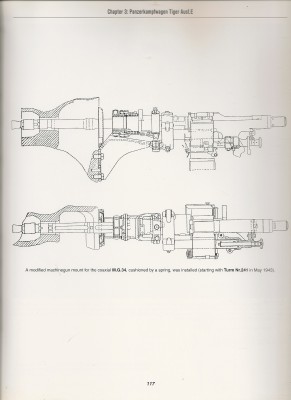

Paul
Although this shows a later modified coax mount, I don't believe the relationship between the MG and the turret/mantlet changed compared with the earlier version. As you can see, the muzzle isn't flush with the mantlet, it protrudes to the depth of the flash eliminator. Isn't it Sod's Law that the majority of photos of the Tiger turret show the other side? As ever, the Museum examples have to be treated with care but these drawings by Jentz are based on the original documents. I haven't found a decent close up contemporary shot which would help but this should be enough to go on. I'm taking a close interest as my Cent comes to completion because I've a hybrid Tiger on the line after the Comet. Fear Naught. Stephen

Thanks for the reply, I thought is should project the other side of the mantlet but I just couldn't find a good drawing or photo. I am a step ahead of you with the binocular sight. it's a FOA early offering that I have modified. Loic now offers a new high quality version, its a shame I didn't know about it earlier or I would have bought it, but I had committed to this one when I bought the breach. You can find his new ones here, they also now do early to late versions FOA TIGER 1 GUN Sights
Hi Stephen,
Thanks for the drawings they are just what I was looking for. They give me a bit of a different view of the mounting bracket as well which is an added bonus. So its back to the drawing board with this MG bracket
I know you like to scratch build all your parts but as I said to Phil, I would look at the FOA sights, they may have something you can work with when you start your Tiger build. I will be watching out for you to start that.
Thanks again.
Paul.
