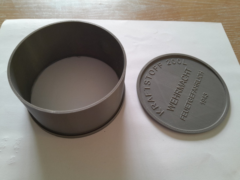

Loved the cradle thingy for the drum so Martin, I copied the idea, and here is the result:
Why did I do it? Absolutely no idea. I guess I am starting to get bored with the cats as my only company.
Am I happy with the final result? Yes I am really happy. It's that satisfied feeling one gets when you do something yourself. Having said that it does not compare to the metal drum model. The metal model is far superior than my plastic model.

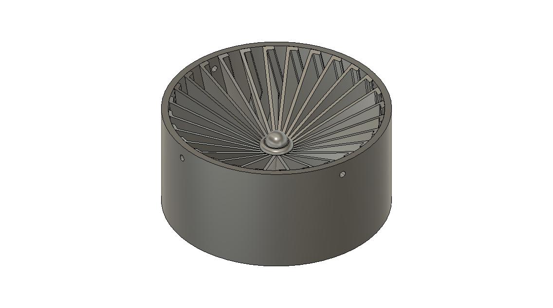

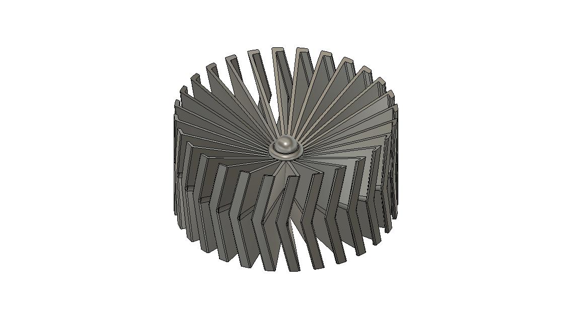

So lately I've been itching to 3d model something. Something which gives me a challenge but not something which takes too long to do. Some time ago I tried to do the "Flammenvernichter" which is found on the late Panthers. Unfortunately I could not find any information on it on the internet so the exercise was scrapped.
Yesterday I decided to try again and do a deeper search. Managed to find the outside diameter of this insert and the number of slats used. Also found a small line drawing showing the profile of the slats. The rest was eye-ball from photos and some assumptions.
Finished it this morning and was going to make a change to the thickness of the slats as they looked too thick.

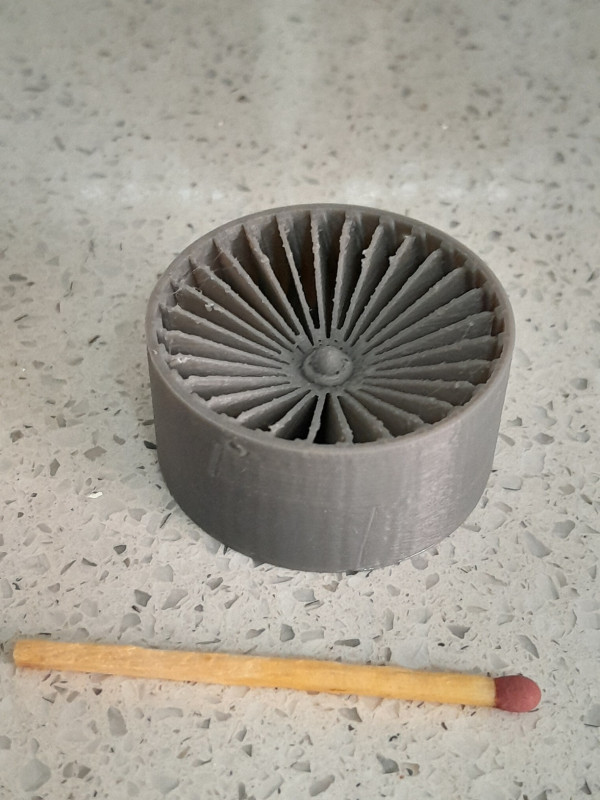

This was never meant to be 3d printed but but a thought crossed my mind. If I leave the thickness of the slats as is and scale it down to 1/6th scale then the thickness of the slats would become 0.5mm. Will it work with a filament printer? Decided to give it a try. If worse comes to worse I will end up with a spaghetti mess on the print bed.
I was really surprised that it managed to print.
I believe that Armortek will be including this part in this summer's Jadgpanther release. Curious to see how they go about it.
The aftermarket ones I have seen are a simple disc of brass, sliced part way through into segments and then twisted to give the effect. I think two discs placed on top of each other and interleaved would probably give enough vanes to be passable.

If it's only an insert, resin print will be more than fine for those perfect details, and it doesn't need to be able to withstand any force, right?

Hi Marco
I am worried that the warmth of the air being generated by the smoke generator would deform those thin slats.

Good point!
Worth a try, resin is cheap.

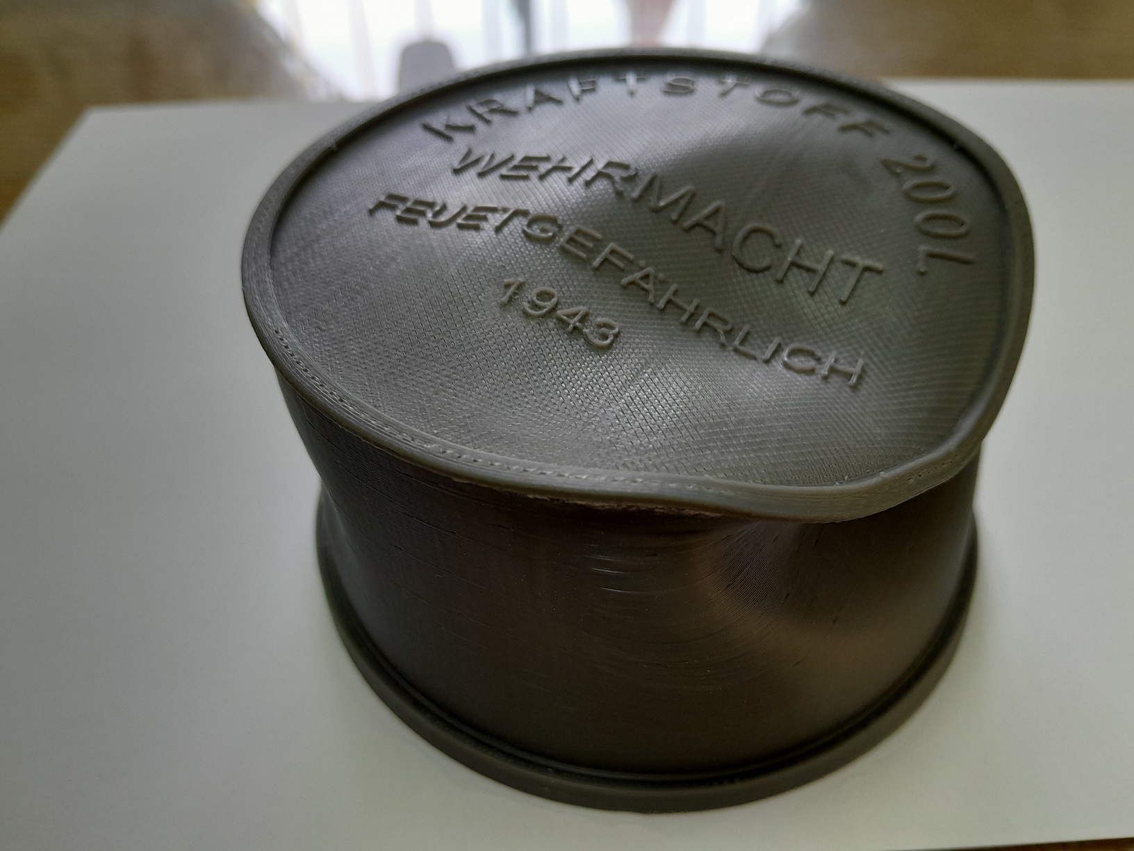

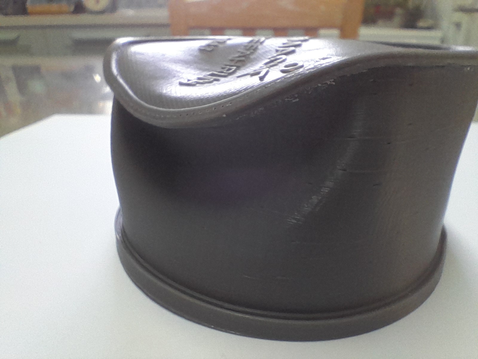

Ever since I made that 200L fuel drum with some minor dents I was always curious how I could simulate a major dent on the edge as if it fell from the back of a truck and hit the ground.
But how do I do it and keep things simple. I am not sure if I can do it with my CAD. I guess it would be above my experience level. I am sure that the model could be exported to some other software like Blender and deformed there. But that means installing new software on an already stretched out laptop and learning how to use it. Definitely not a simple solution.
A couple of days ago I had a crazy idea. Printed a lid and a part of the drum as I had already thrown away the two defective drums I had already made and glued them together.
I then 'borrowed' a powerful hairdryer and applied heat to the edge I wanted to deform. I did not take too long to soften the PLA. Then stared pressing with my fingers to deform the edge. Simples.

Yes! Just try! Fiddle around, destroy stuff, find out, 9 out of 10 the result is either surprisingly cool or at least you learned something!

Sounds like you found the solution, hot air gun like used for heat strink would work too! That's one smashed barrel.

As resin is not a thermoplastic, it should not deform by heat. I encourage you to try!Vince Cutajar wrote: ↑Wed May 08, 2024 4:15 amI am worried that the warmth of the air being generated by the smoke generator would deform those thin slats.
