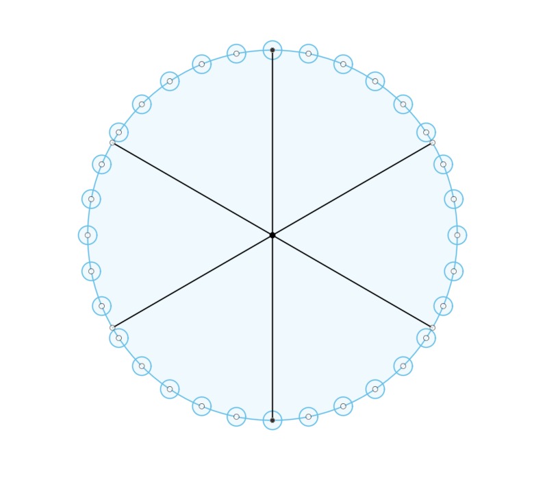

It looks to me as though the timing marks line up with a bolt hole on each of the sprocket rings.
There are six webs in the sprocket to which the front sprocket ring will attach, and 32 mounting holes in the sprocket rings, so there are only two webs which line up with mounting holes in such a way that the teeth in the rings will line up correctly.
You need to remove the sprocket rings and then find the webs in CH3150 which line up exactly with a mounting hole in the rear flange. If you mount the sprocket rings so the timing marks align with either of these two webs, then the rings should line up correctly.

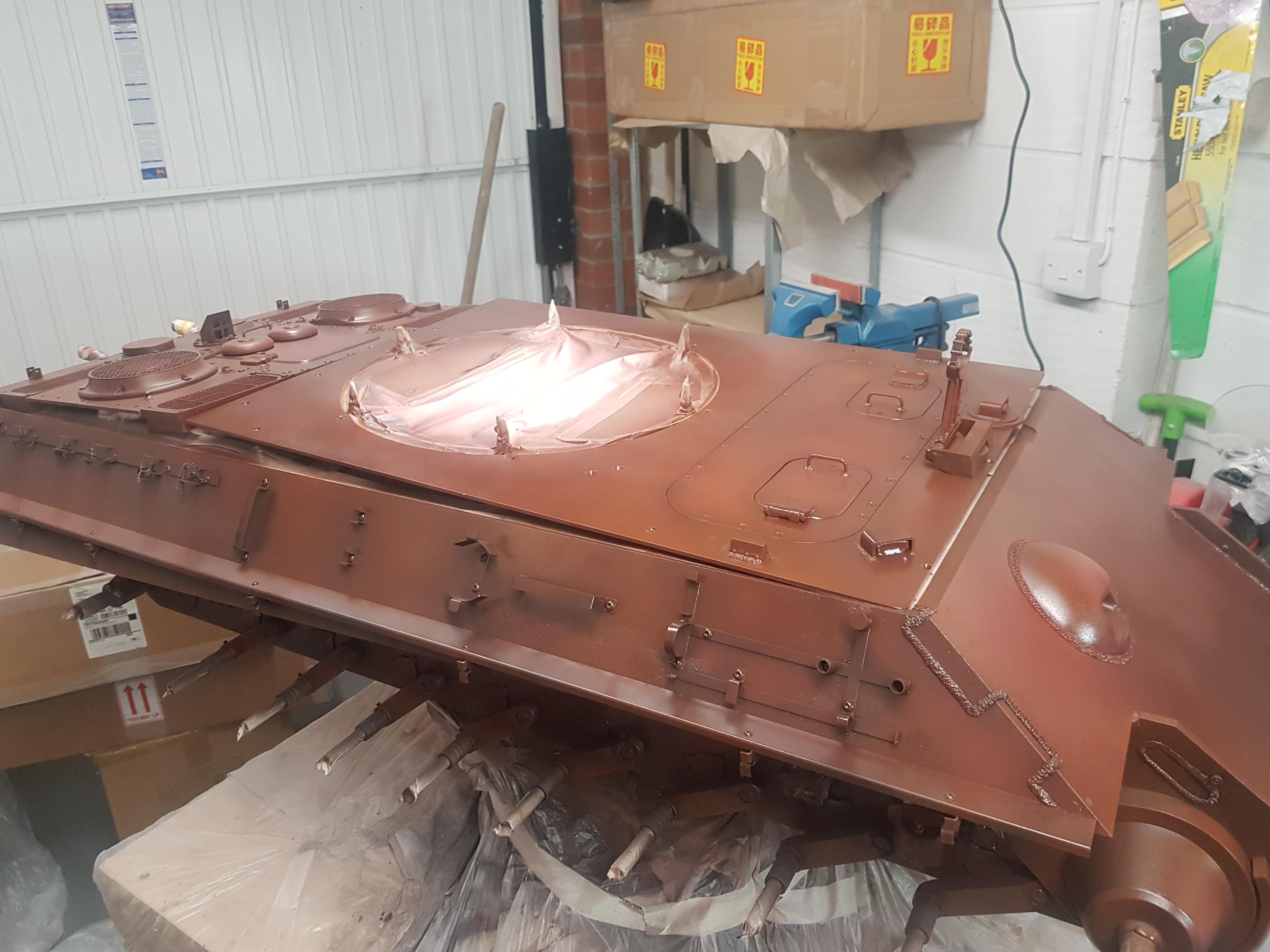

How frustrating is Zim!....2 previous attempts.... put on ...scraped off...let one attempt set ....hit that with the orbital sander after a week of looking at it in total disappointment...Ahhhhhhhhhhhhhhhhhhhh

Brought out the secret weapon....hope you like the nail varnish colour!....but the lovely Jools wearing it has loads more patience than me
- 20231101_202549.jpg (63.77 KiB) Viewed 7760 times
- 20231101_202541.jpg (68.45 KiB) Viewed 7760 times
- 20231101_193854.jpg (39.9 KiB) Viewed 7760 times

Previous 2 attempts I had gone to all the effort of mixing up the tile adhesive in a super Zim colour....but by attempt 3 I had lost the will to live...I think this performance went on over 3 consecutive weekends and I had lost the will to live...Jools had taken pity on me by then....
Hence the turrets getting Zim..AND THATS IT...I'm Done guys! sorry ha ha ha

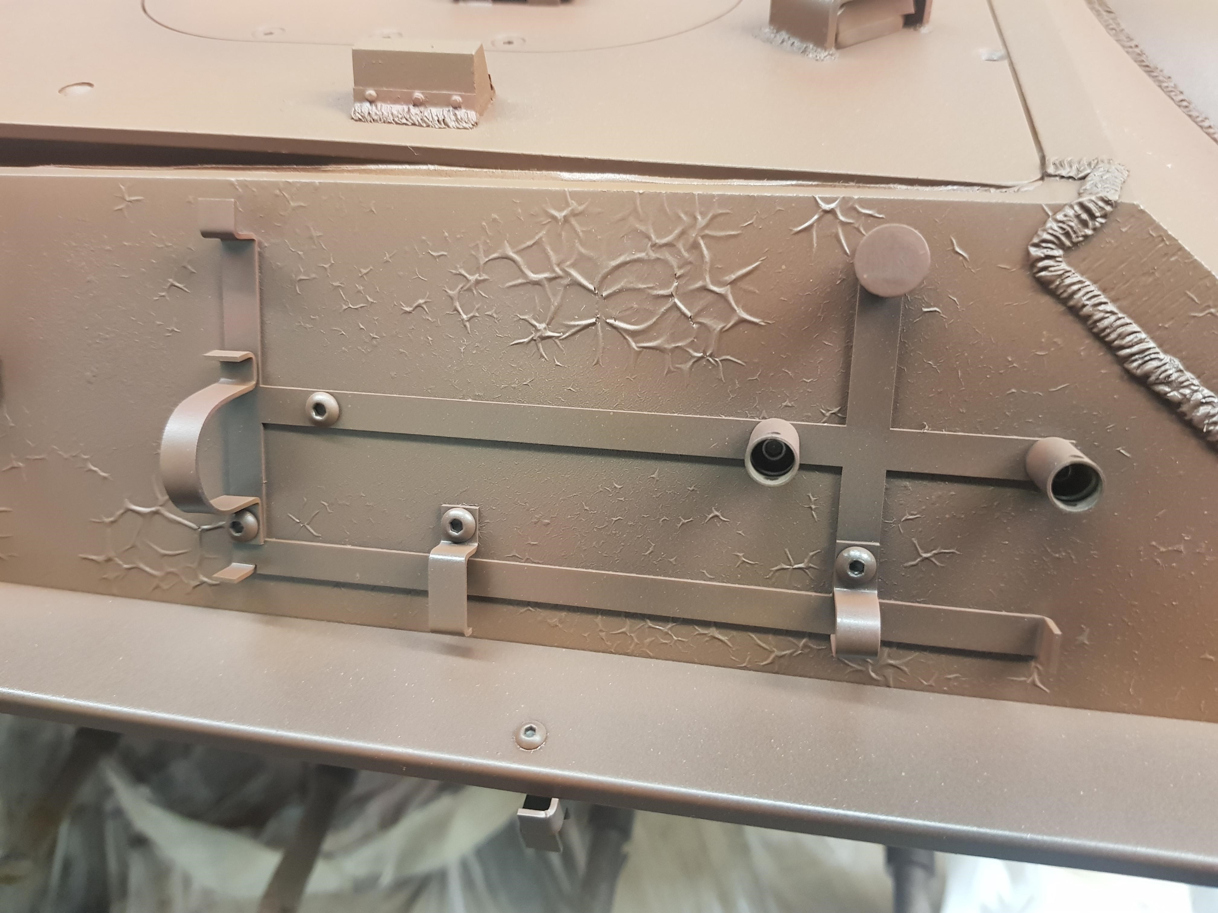

Re: Panther #42
This is why you should always do a little test of your lacquer....I didn't obviously, by the time it started to react it was too late....so out with the sanding sticks and had to perform some ...errr...heavy weathering !...Good Grief !
Both sides had this reaction, guessing it was moisture under the paint as the weather had been damp, but a bit of a bummer as it covered both sides in under skin aliens
