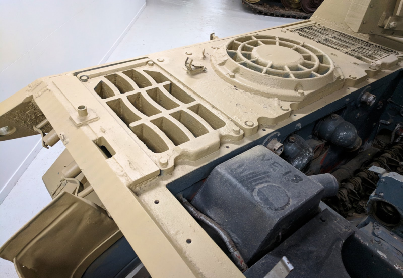

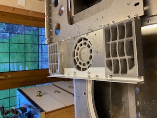

Hi Mick
The rear should look like this once assembled correctly, your cast grills should be fitted as pictured, and a insert fills the gap, the rear plate would need adjustment to close the small gap - maybe file or clamp in position then fasten together

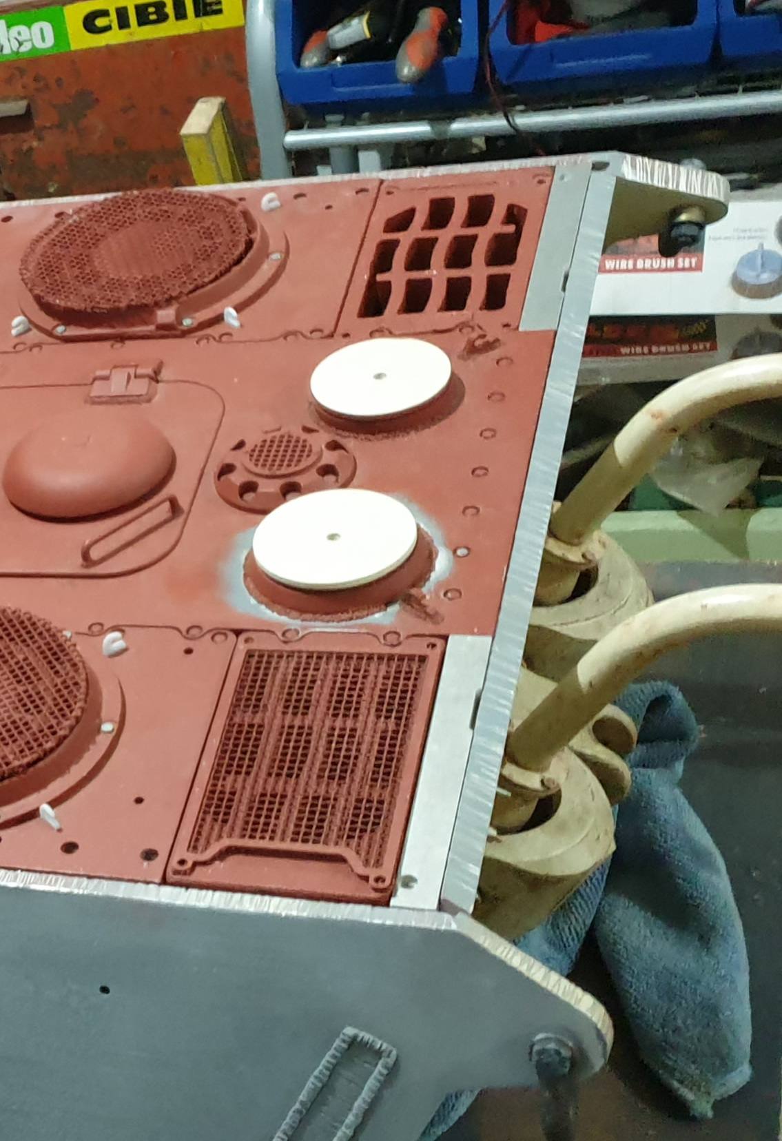

Re: KT 2019 #29
Having spent all weekend filing and fettling

Re: KT 2019 #29
Hi Mick,
A way to fix this would be open up the brackets that fix the rear plate and move inwards - you may need to file/open up the interlocking slot... or you could just live with the Gap.

Re: KT 2019 #29
Hi Mick,
Welcome to the world of Armortek tank building.
Re the apparent gap problem, as David says you could try easing a couple of the joints elsewhere to shuffle things along and help close the gap - the joint between engine deck and turret plate looks a good start. I find that with bolted plates such as on an engine deck it's worth exaggerating the gaps slightly anyhow where possible to accentuate the construction method and stop the joints being 'lost' and covered over when you paint it.
Also you need to consider the construction of the real thing and whether there should actually be a gap. It's clear that there were sizable gaps on real thing and the close up of the JT at Bovington shows why. The inner face of the rear plate is sloped, so the top edge of the deck will never butt up fully. Also the gap has been widened to allow for a decent build up of weld which wouldn't be possible if the plates were pushed closely together.
Looking at the real thing and your build, I'd say it's really the thickness of the rear plate upstand that could do with improving. My solution would be to add a strip of alloy or even plastic card say 2mm thick to the upstand to thicken it up and close the gap a little. Just a thought.

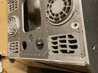

Re: KT 2019 #29
I have just completed my first (intentional!) modification.

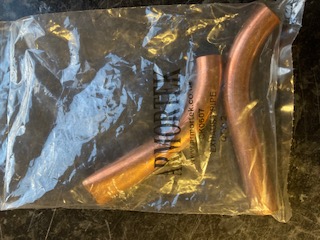

Re: KT 2019 #29

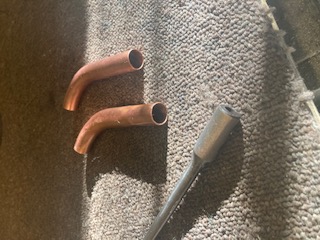

Can anyone offer advice as to how I can repair one of my exhaust pipes that has been damaged in transit
MANY THANKS- John Clarke
- Posts: 1693
Re: KT 2019 #29
If it cannot be sent back or get a replacement, then try to open the tube from the inside out. Its difficult to see the extent of the flatten area, But I'd heat the damaged area with a modelers butane torch to soften the copper metal. Allow to cool slowly, then with the use of a small thin pair of long nose pliers (closed) insert into opening and gently open the damaged area out from the inside. Reheat the copper to soften if needed. Once opened up you should be able to use a round Phillips screwdriver of the appropriate diameter to gently ease open up the hole in the pipe, again you may have to heat up to soften the copper. Be careful how you grip or hold the out side of the tube as deep marks may not polish out.
It will be difficult to get perfect but you should be able to get most of the crease out.
Battle damage and clumsy driving could also cause damage like this too on the real thing, not that that helps.

Hi Mike
I'd go for battle damage, as is shown in previous
photo.
Charles
photo.
Charles

Happy enough with this
[attachment=0]76D3A5DE-8666-431F-864E-4A20B7456D9E.jpeg[/attachment

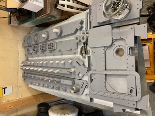

ARMORTEK have very generously agreed to replace the rear plate so I have dismantled the hull and started to etch spray
Many thanks to ARMORTEK
