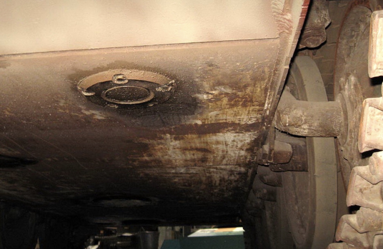

Charles A Stewart wrote:
Sun Dec 24, 2023 5:40 pm
Does anyone out there have a decent picture/photo of fittings "1" in the above?
This photo might help.
Those are hull drain plugs.
Merry Xmas!
It´s all in the details!
Charles A Stewart
Posts: 576
Location: Cumbria
Has liked: 504 times
Been liked: 915 times
Re: Panther 18
Post by Charles A Stewart »
Merry Christmas Kent.
Thanks for photo, helps a lot.
Charles

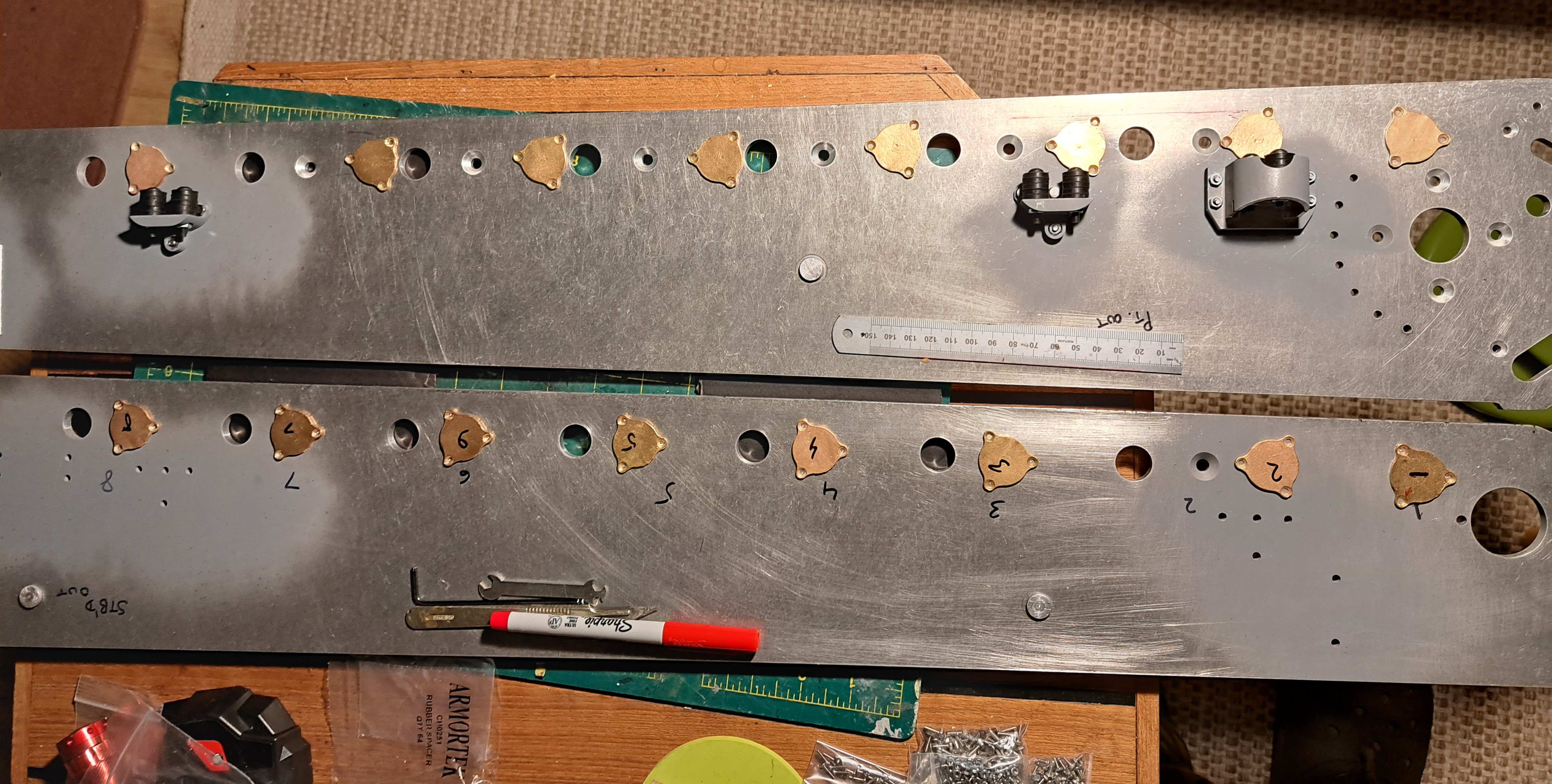

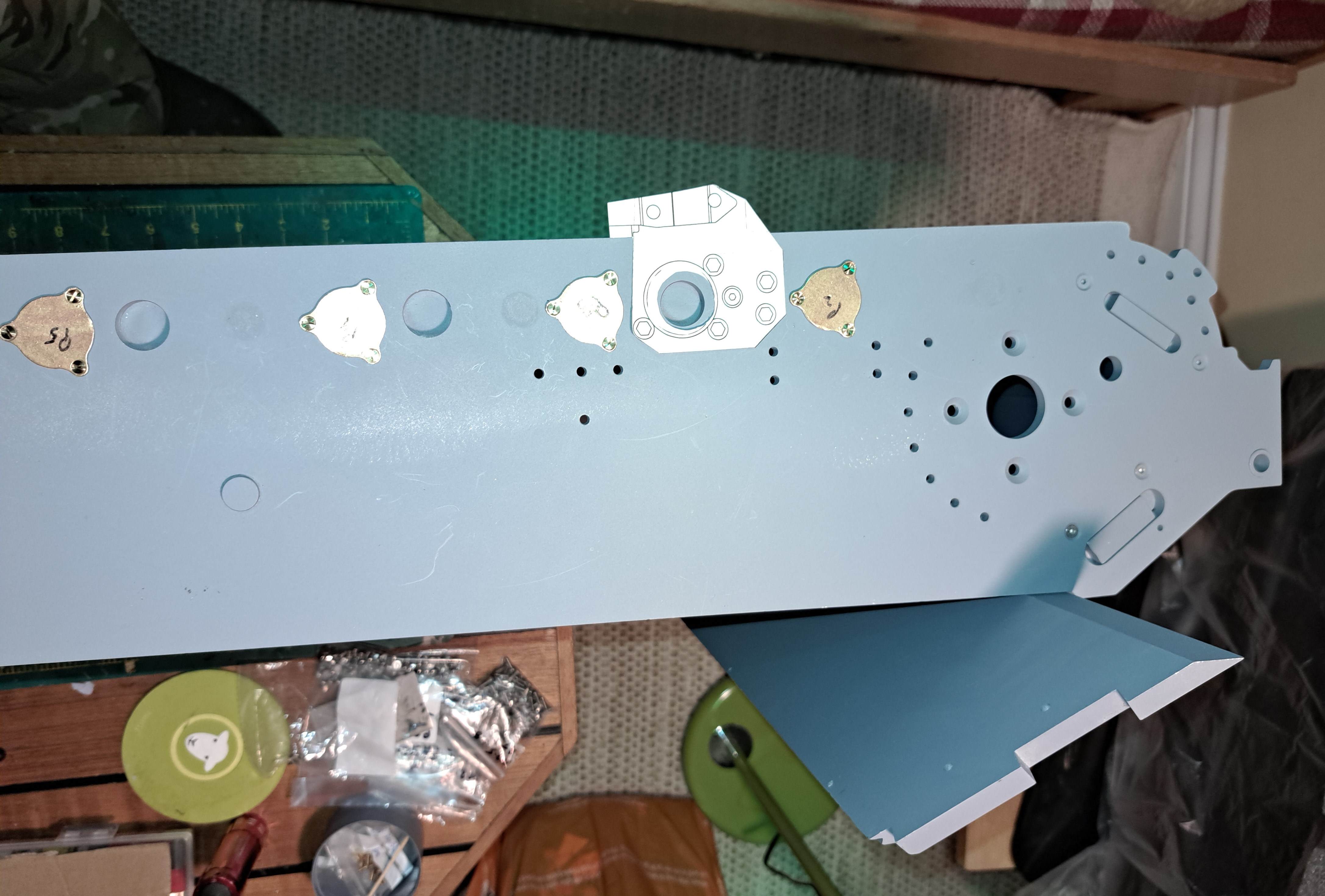

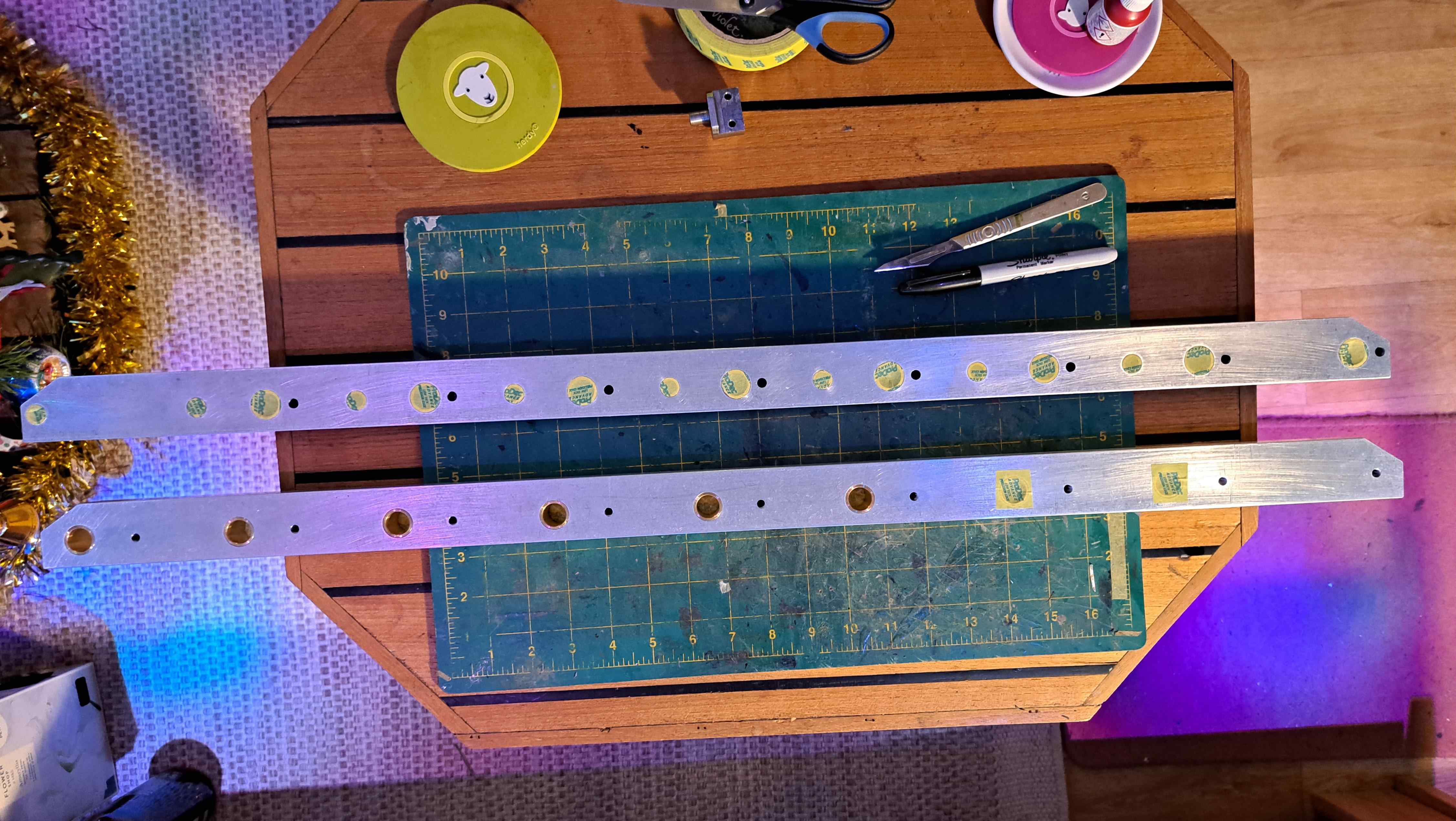

Hi Folks.
Just a small update, to wet to do outside stuff, so I am doing jobs on the Panther that an be "safely" done in the house. Here is one such task, fitting the brass bushes and masking the suspension housing.
Brass bits masked off.
Question time (you're are not getting of that lightly). On one of the above bars the smaller brass bushes fitted flush, on the other bar they stick up between a 0.5-1mm. Anyone else found this and is it/will it be an issue?
And no, I did not hammer any of them home :twisted: :roll:
Cheers for now, looks dry tomorrow so some painting, maybe. Happy New year to you all, take care.
Charles
Malcolm.Plumb
Posts: 235
Has liked: 430 times
Been liked: 893 times
Re: Panther 18
Post by Malcolm.Plumb »
Yes Charles
I had the same problem with a few of my holes.
Just used a 12mm reamer to clean the holes out a bit.
Only the larger holes though.

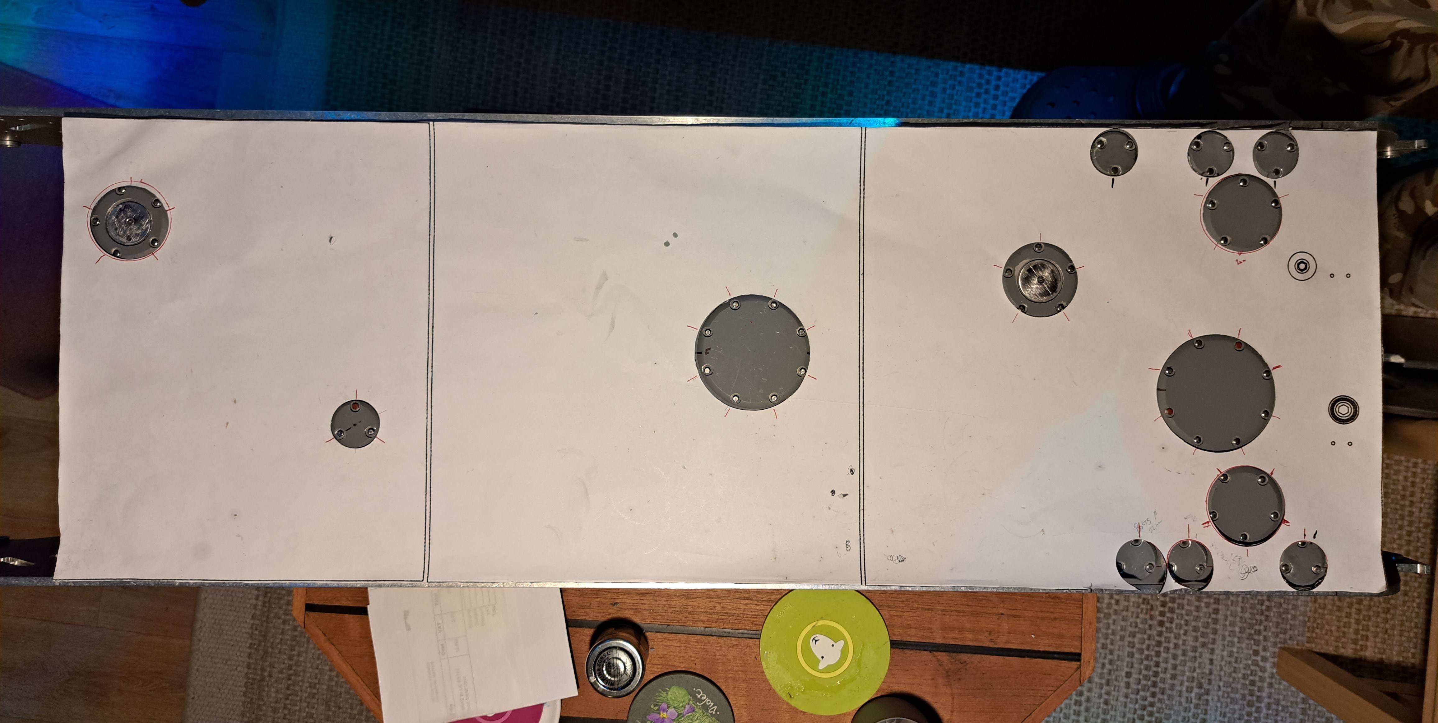

Evening all.

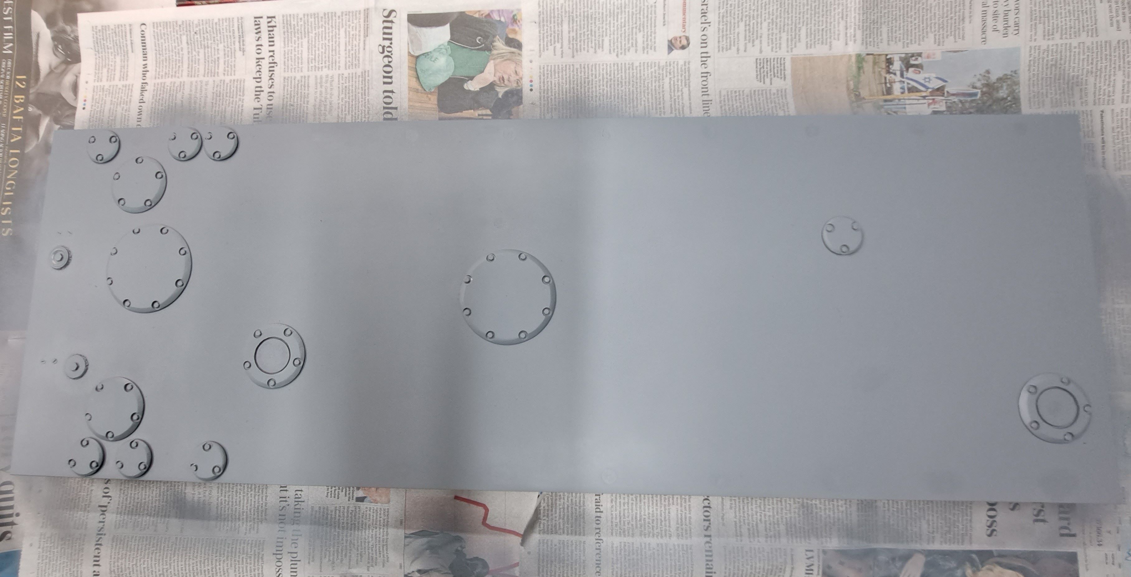

On and off, spent the week fixing the access hatches in place onto the belly plate using my home made template:-
Cut out template in place, some adjustments were required.
So far so good (well by my standards, anyway).
Will add the drain hole fittings next, once they are done I need to clean up the paintwork, touch up with filler as needed :-D
Take care all.
Charles

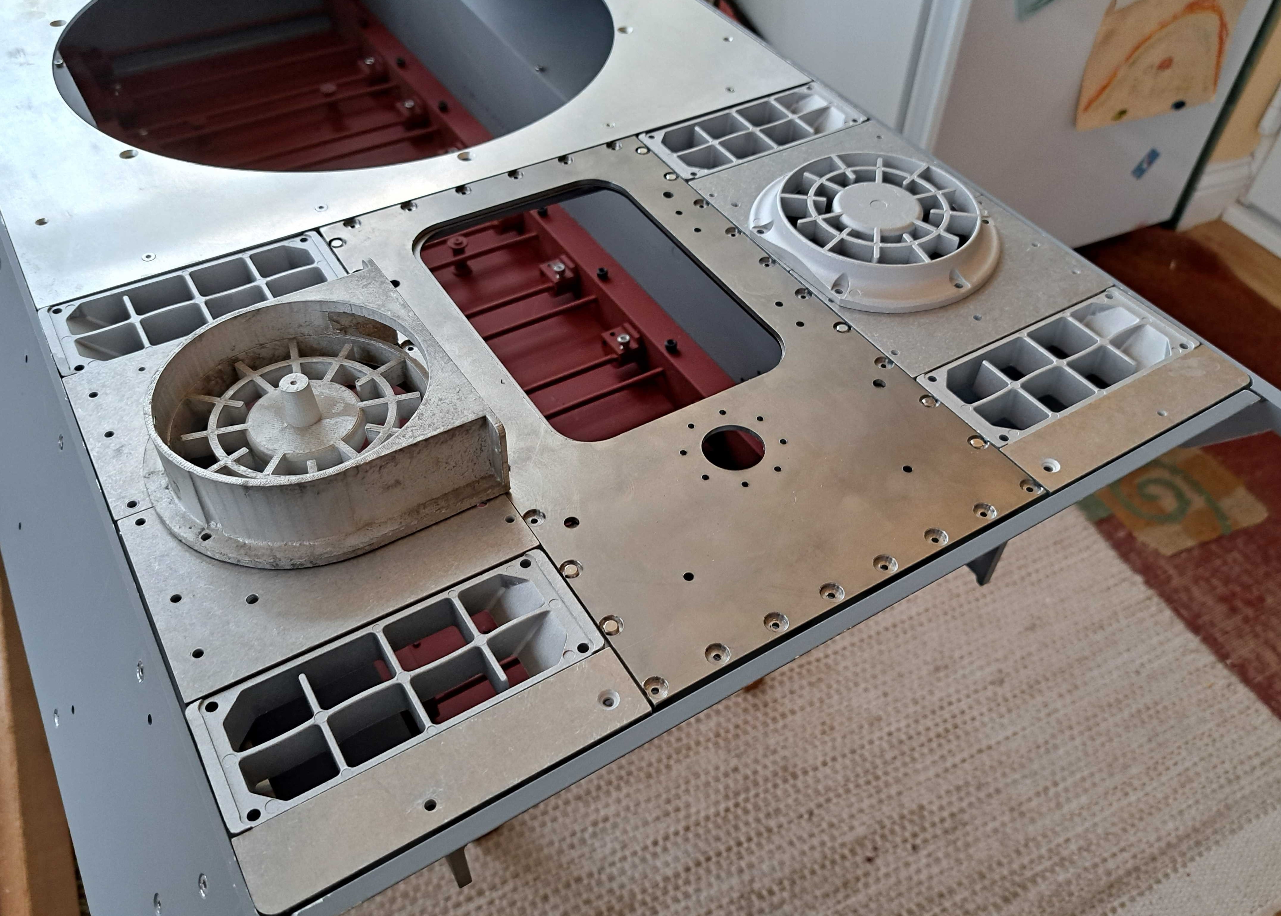

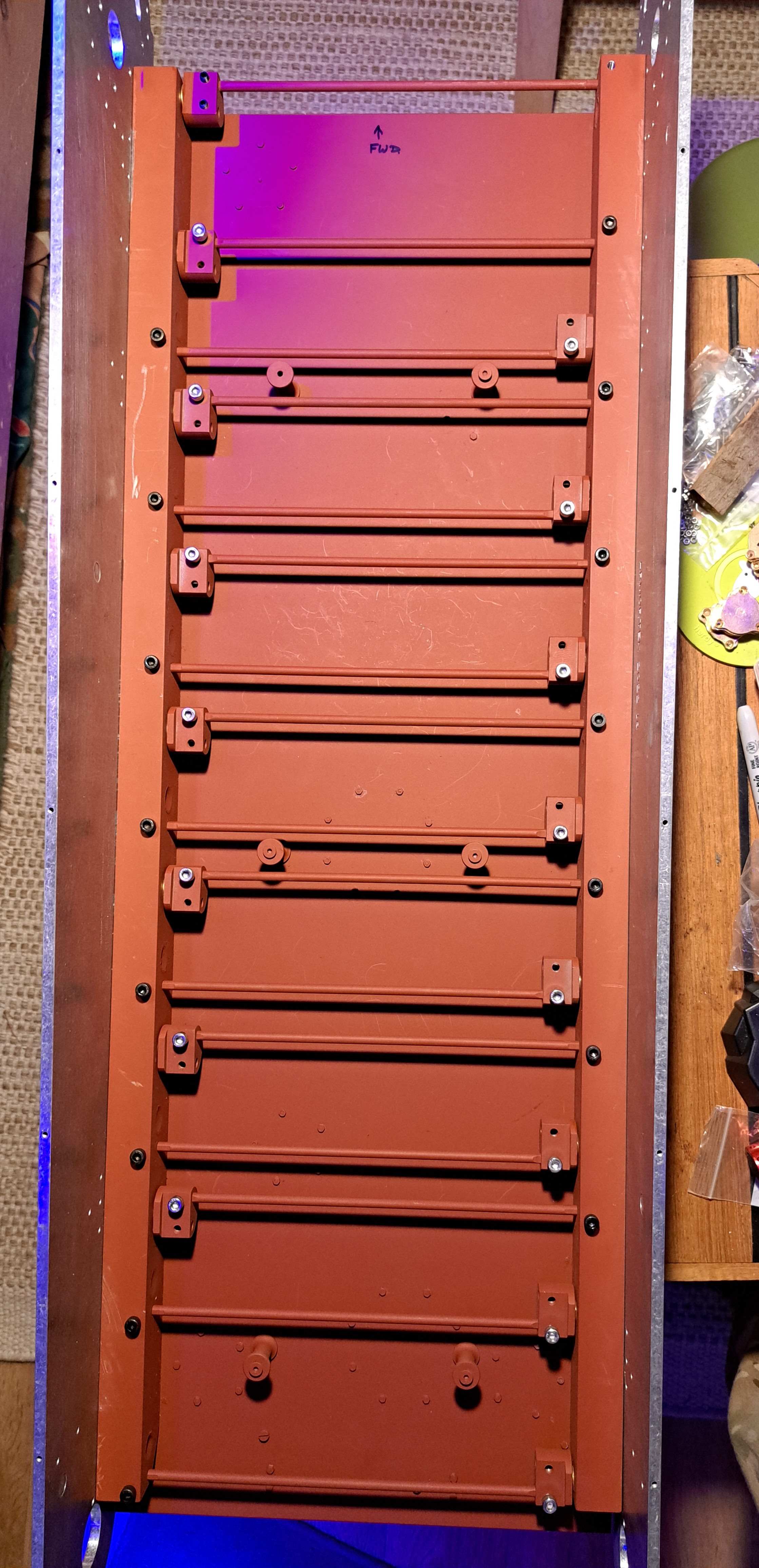

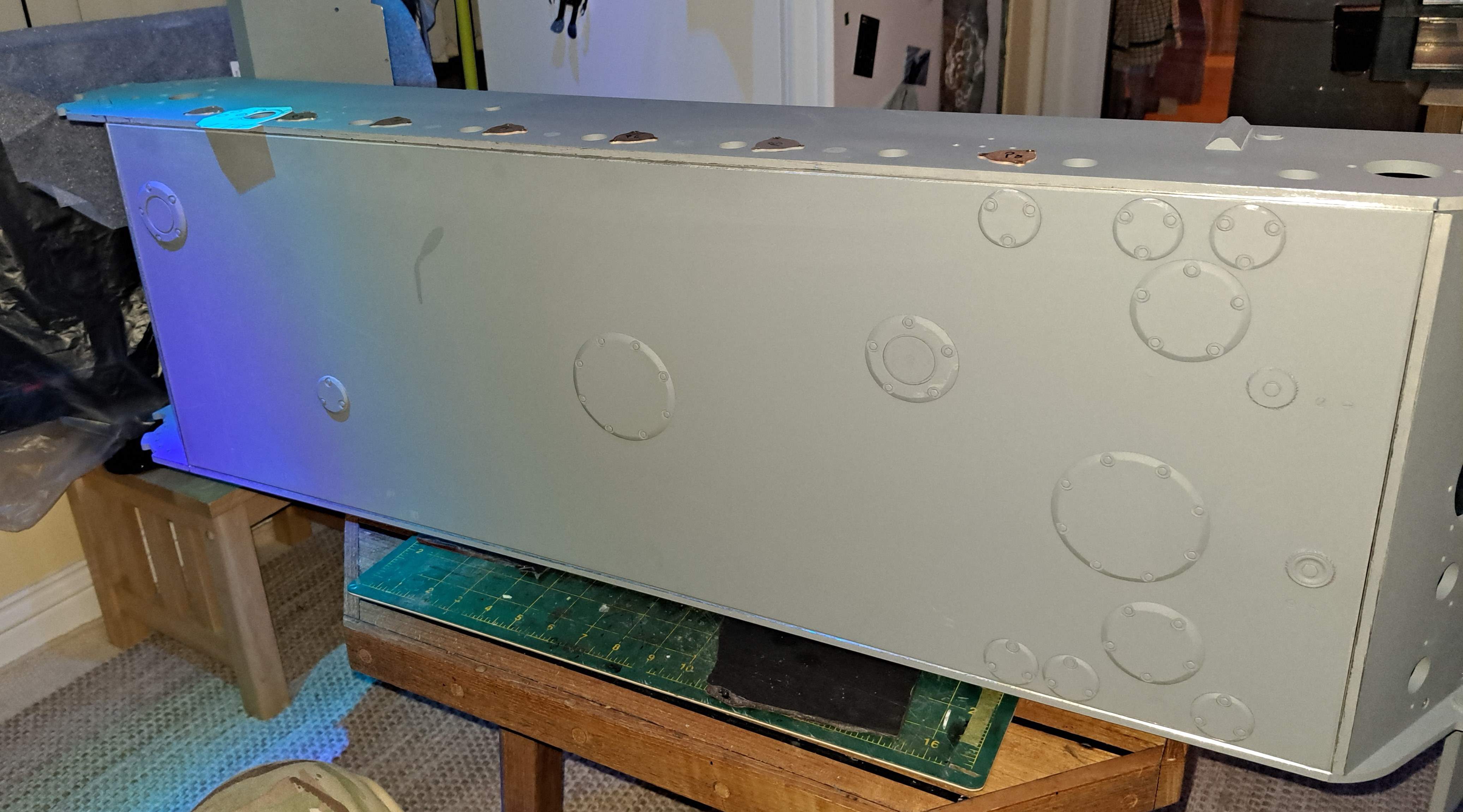

Hi Folks.
Hope one and all are enjoying the weekend.
Not so bad this end, only 1x tap broken in the pursuit of installing the smaller(x6) "Torsion Bar Adjustment" covers, please correct me if I have the definition wrong, always keen to learn 8)
Still here we are at last, I hope, all the underneath stuff fitted & filled :-
Nice coat of paint too.(Sorry about the shadow)
We now look to move on to section 08 of the build manual.
Take care and have a good week.
Charles

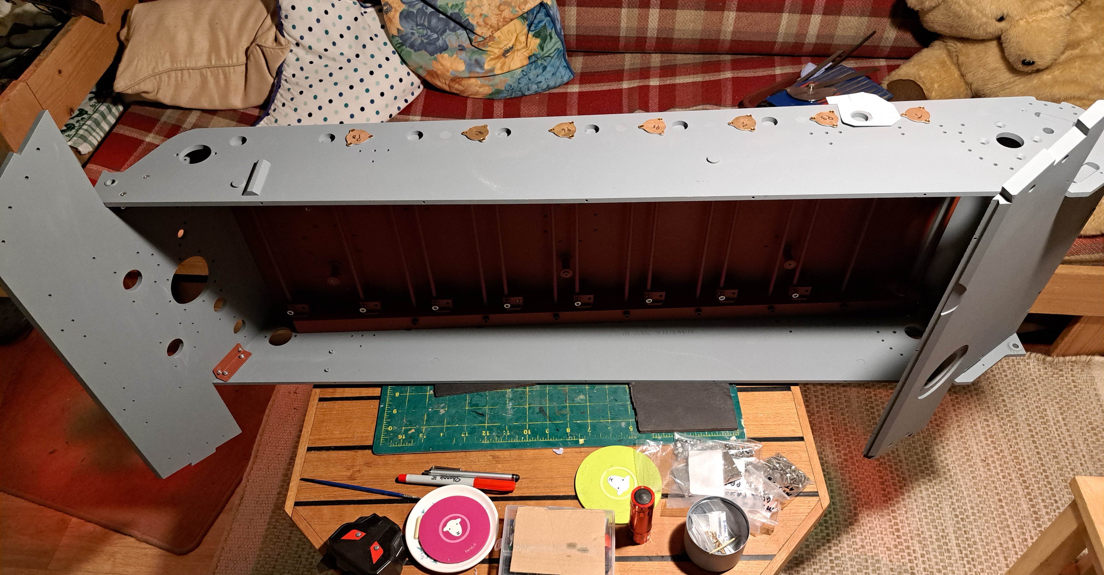

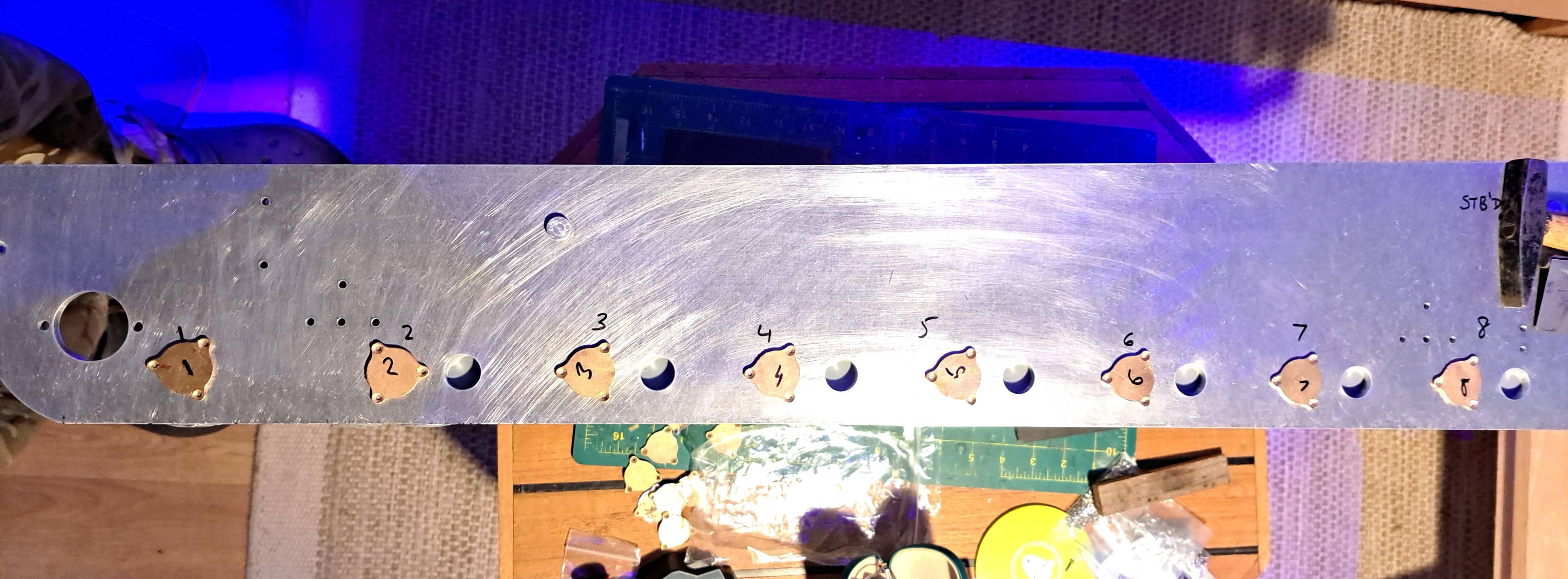

Hi Folks.
Hiding inside the house again, I know "wimp", still its warm and dry. :-D
Now the suspension bars are in place I can look at the hull sides. Today I made a template(which seems to have worked) and have marked out the RHS covers.
Next job drill & tap for the screws
I hope I have got the covers the right way round, could be :oops: :oops: :oops: if not.
Cheers all.
Charles
Malcolm.Plumb
Posts: 235
Re: Panther 18
Nice Charles :)
You will find that you won't be able to put all the covers on in the same orientation as per historic photos. Only a couple will be in the wrong direction I think.
They will foul the bump stops.
You did find the same I take it?
2022 Panther G #15
Charles A Stewart
Posts: 576
Location: Cumbria
Re: Panther 18
Thanks for the heads up Malcolm, I will dry fit those units and take it from there.
Charles

Evening all.
Taking cover "again" as another area of low pressure moves over us, We haven't suffered too much save a broken fence here. Touch wood(pun).
Thank you Malcolm, I place the bump stops on the left/port side and an see where you mean.
I am going to keep the covers on the right/st'bd side as is, except disc 2, they cover the screw heads. That left/port side though, I think will need work and some filler :roll:
Still, that's the joy of adding extras.

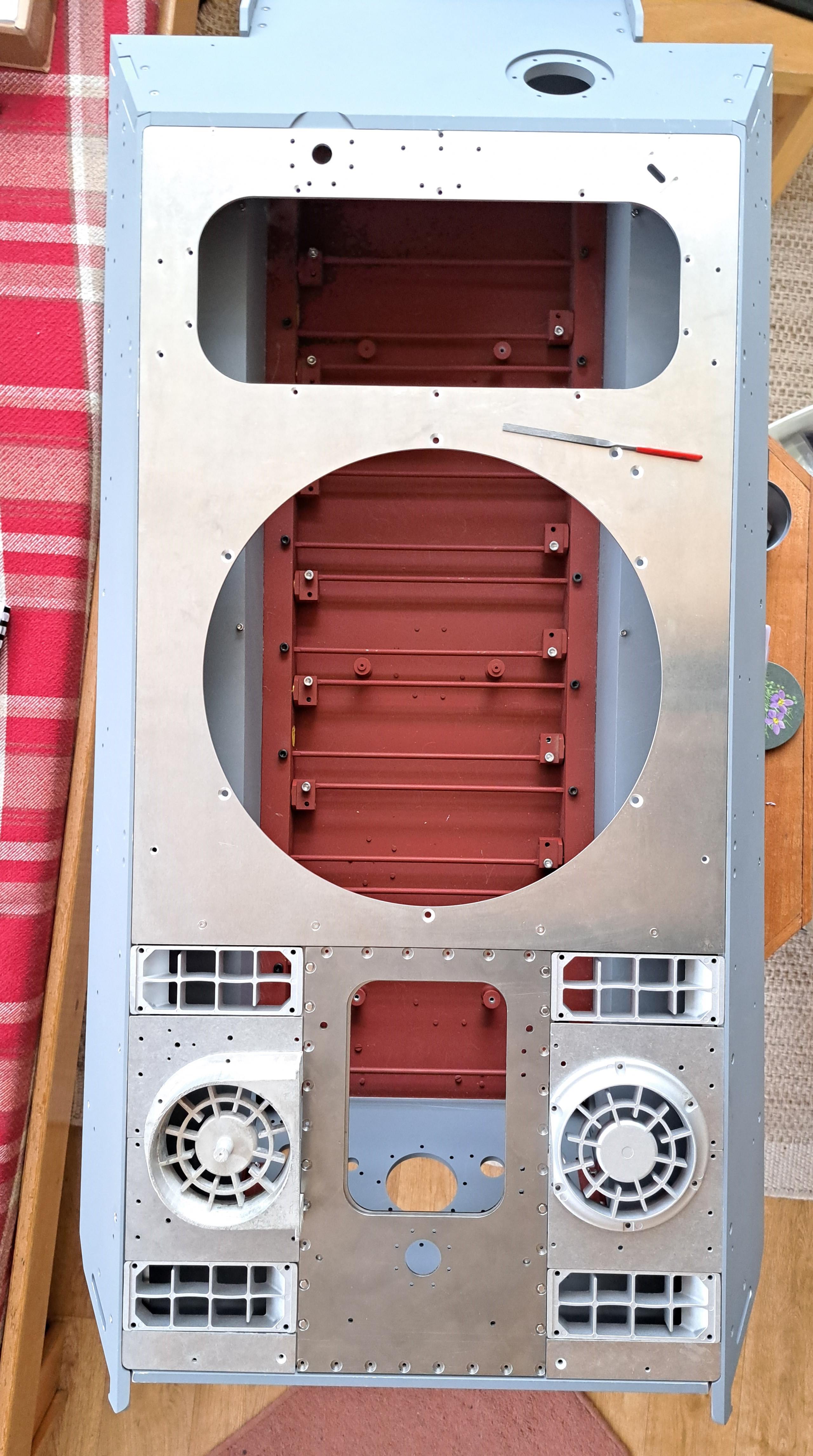

Just a short update. After fettling the upper half of the hull and getting to fit, not to bad in the end. I added the deck to check that it fits OK and it does.
Birds eye view, screws fit holes, which is nice.
