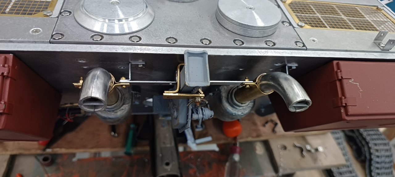

After this stage, other distinctive detail parts such as early version exhaust pipe with bracket work and 20t jack holder is fitted.
I have also noticed the bracket design is different depends on rear pipe's design and period. (Early and late one) (well I didn't know until a few days ago though I did the Panther research extensively :? )
Convoy lights and engine starter handle bracket were also fitted. Beautiful details of the rear part!

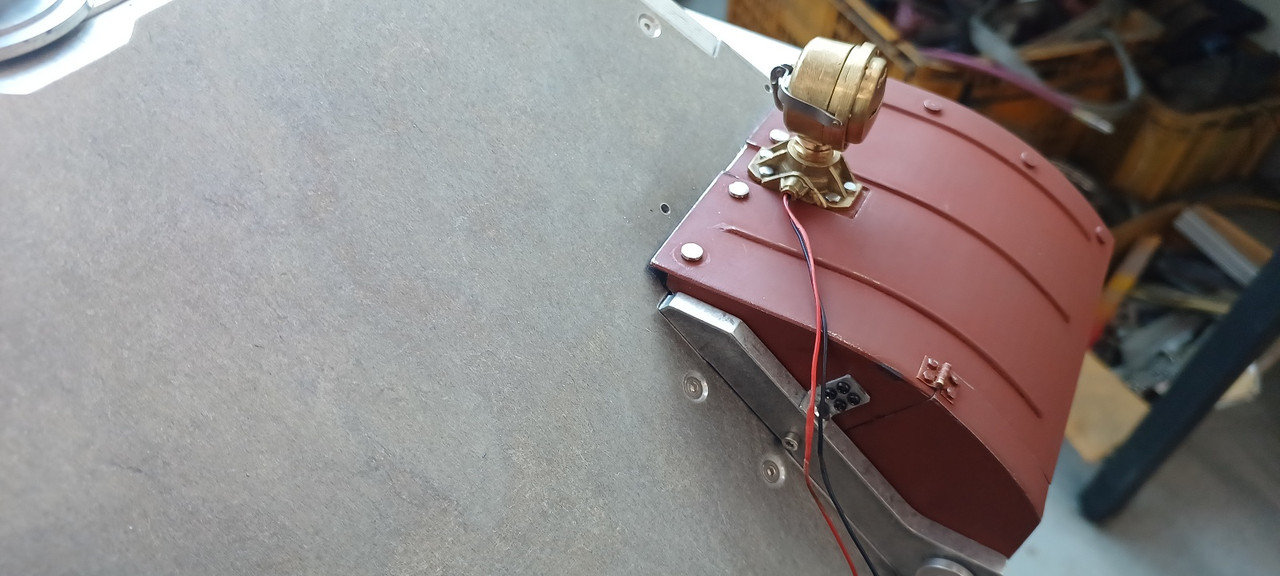

Also fitting Steve's bosch light and wire arrangement and also putting wire into brass tube.
Finally done Bosch light wiring properly! very satisfied!

Put the Bosch light wire into the brass tube and the outcome is very satisfied!
