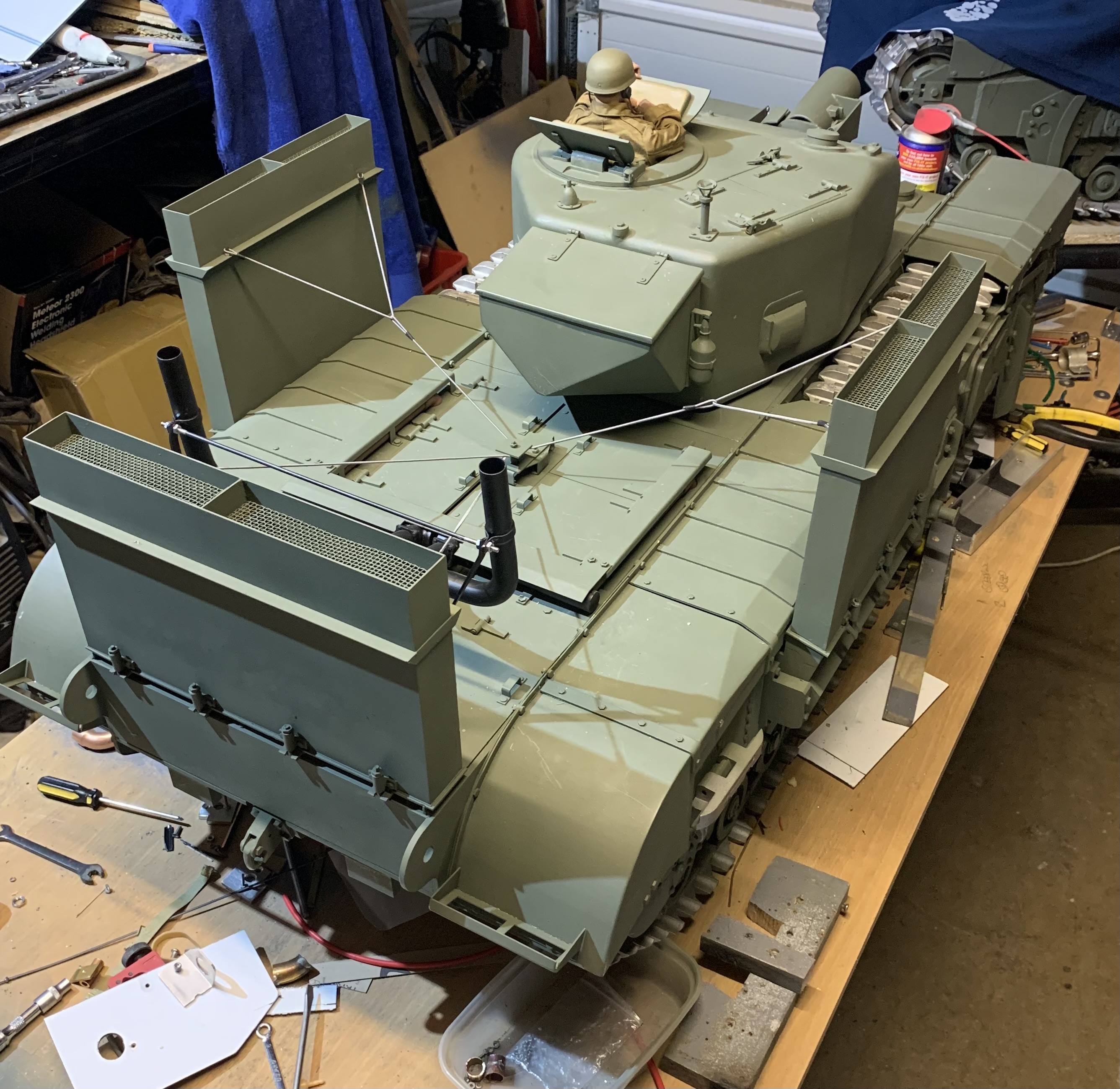

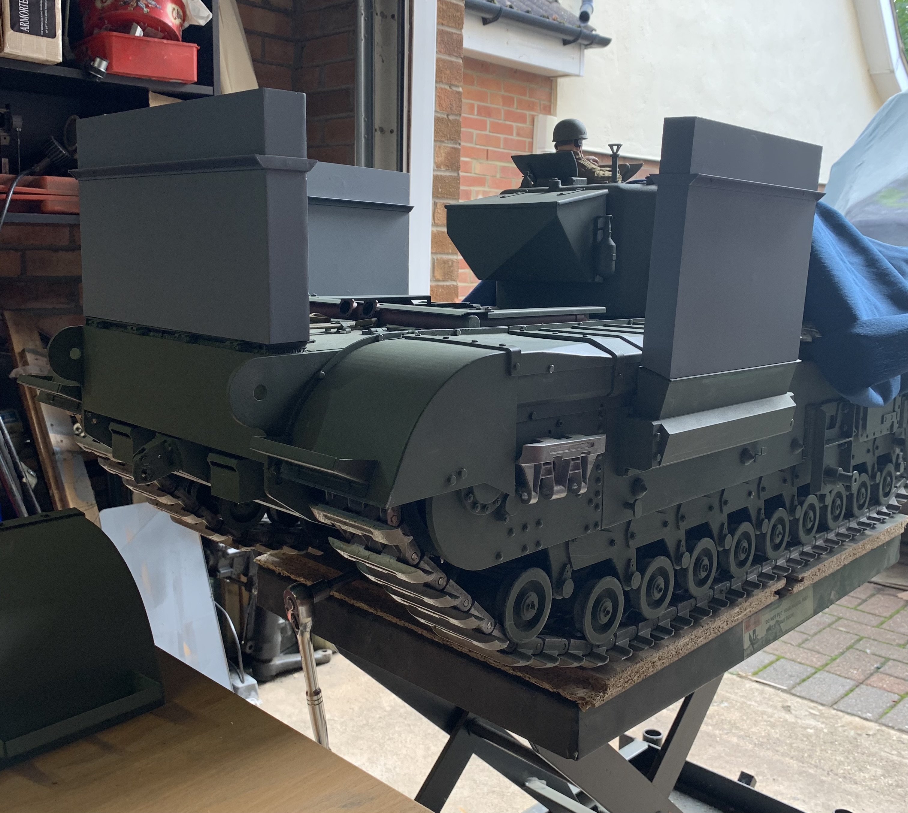

Re: Churchill AVRE
Hi David
I like your latest addition of the wading trunks, what material did you use and what fastenings are you using to hold them in place?
Gary
Gary
- Posts: 235
- Location: Herts
- Has liked: 33 times
- Been liked: 312 times
Re: Churchill AVRE
Hi,
They are 1mm steel, they will be bolted on semi permanent as doing it as if they were fitted originally would be too fragile and make access into the engine bay awkward. But it will be possible to use original fixings so if at some time I wish to have them fall off like the real ones I can do so.
