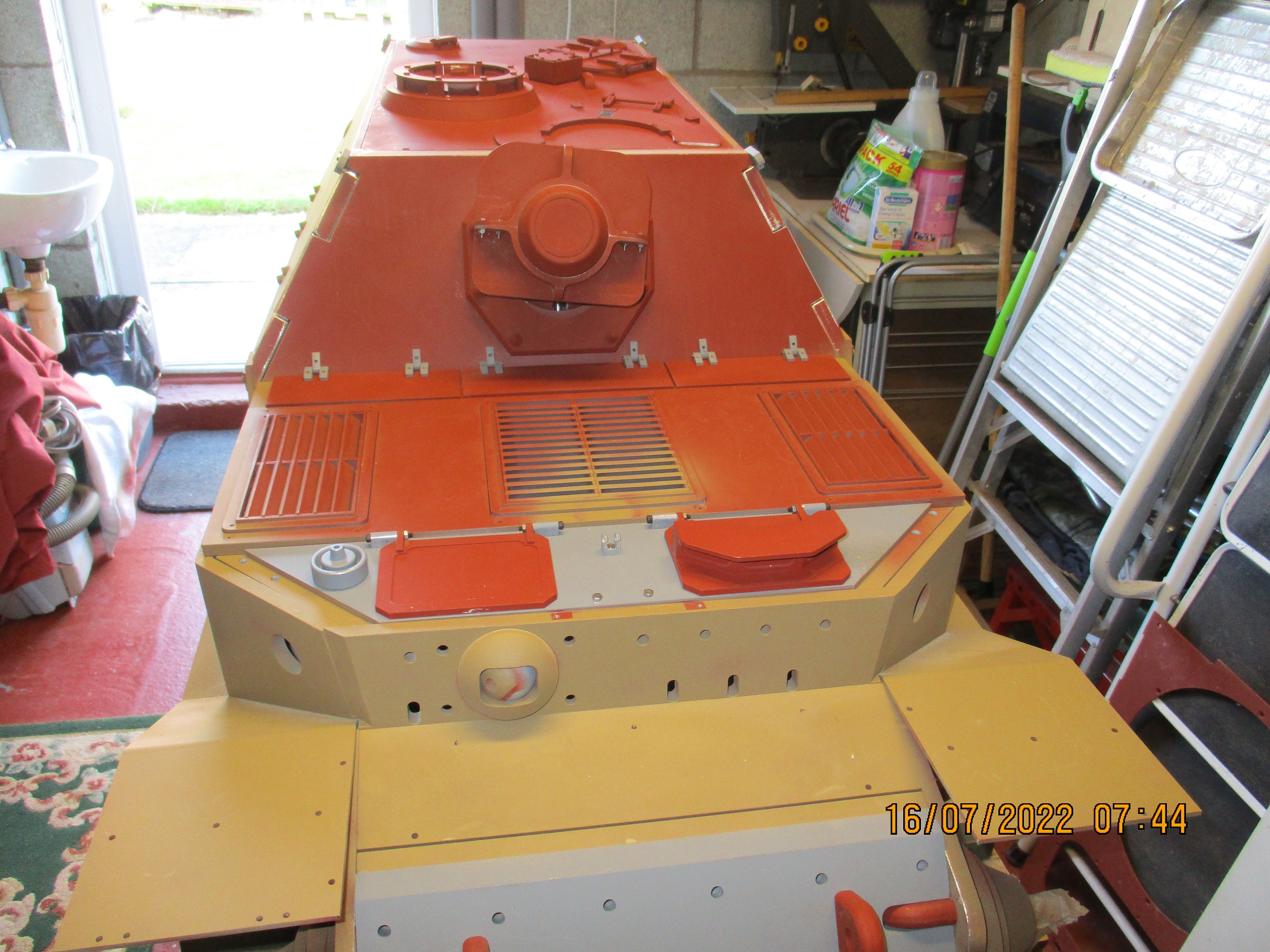

Thank you guys for your likes and replies. Trevor, the Elephant kit although heavy... is an easy build. On the Forum you will find a whole parade of many fine Elefants builds with loads of information. I have dry fitted the upper hull, just needs showing the file....

Good morning everyone, another hot day forecast, I am advised to stay indoors....Progressing with the build, I am pleasantly satisfied with the amount of available space within the hull. I recall the game I had squeezing the batteries/motion etc, inside my Comet, the Elefant looks to be a doddle.
Coming to the end of the 'track' assembly, much cleaner links and only two piercings.....
Looking forward now to the gubbins that bring these wonderful models to life. On the home front, although not so active, I do read and follow the various Forum builds, Some very fine and experienced modellers out there, a pleasure to follow.....Mick

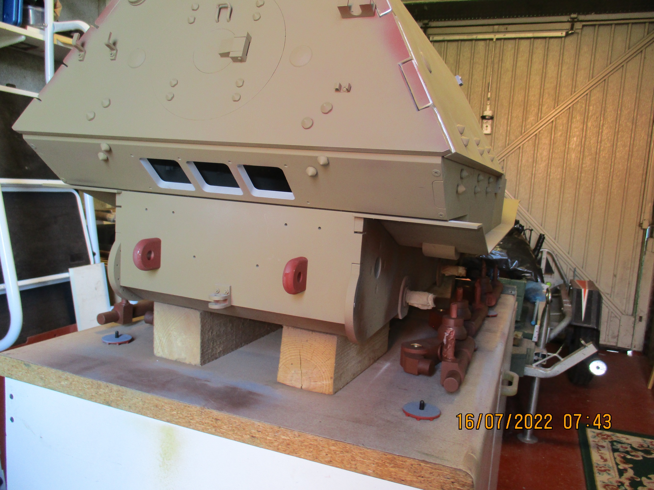

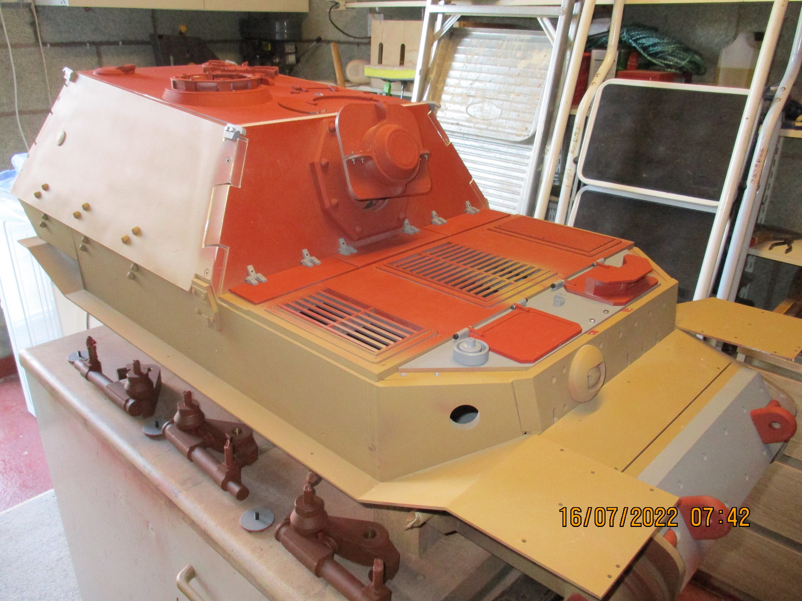

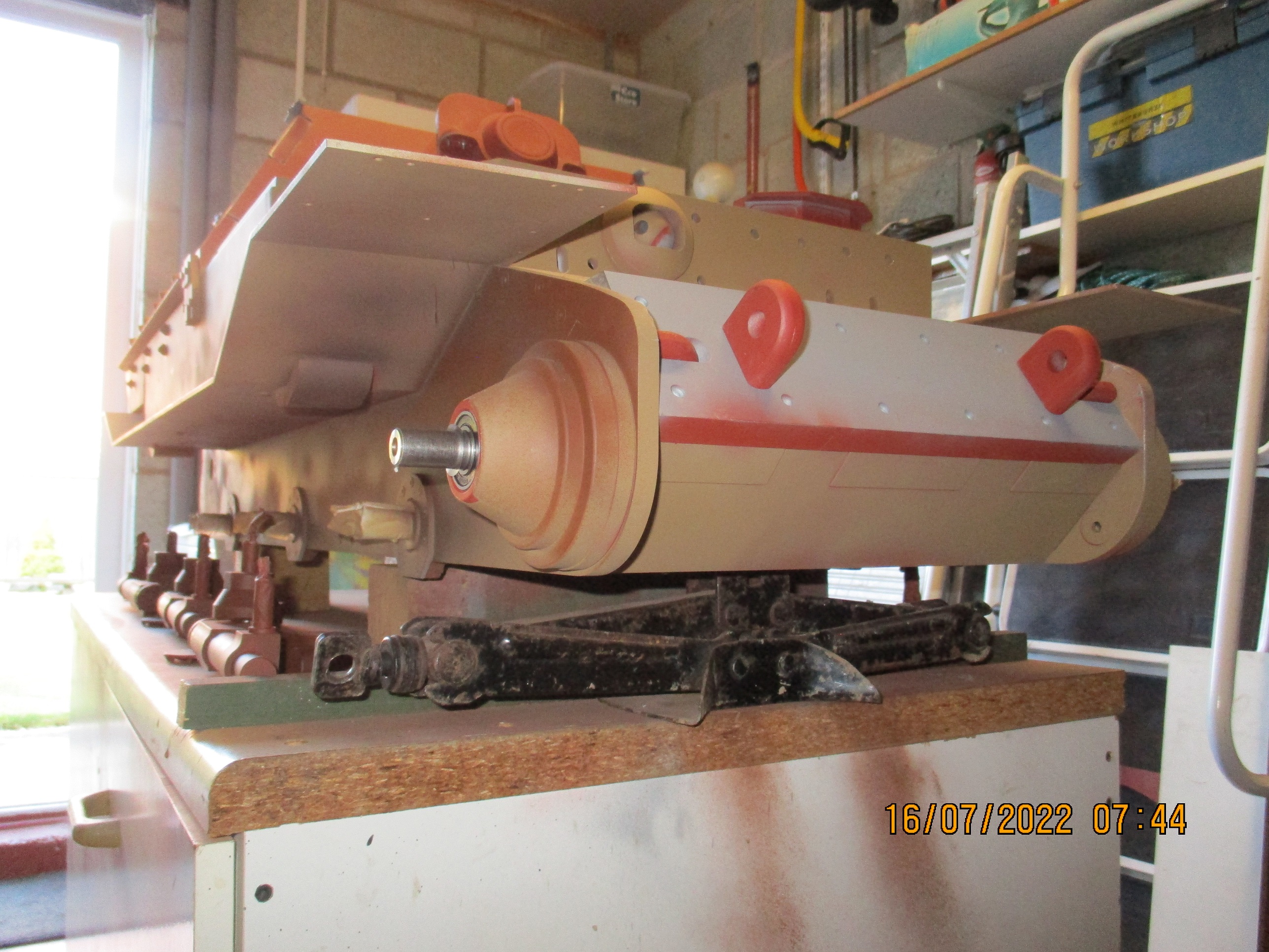

Good morning everyone, just a few photographs to show my progress. Spent this morning making up the tool/towrope brackets, a real test from my failing eyes and rickety fingers...

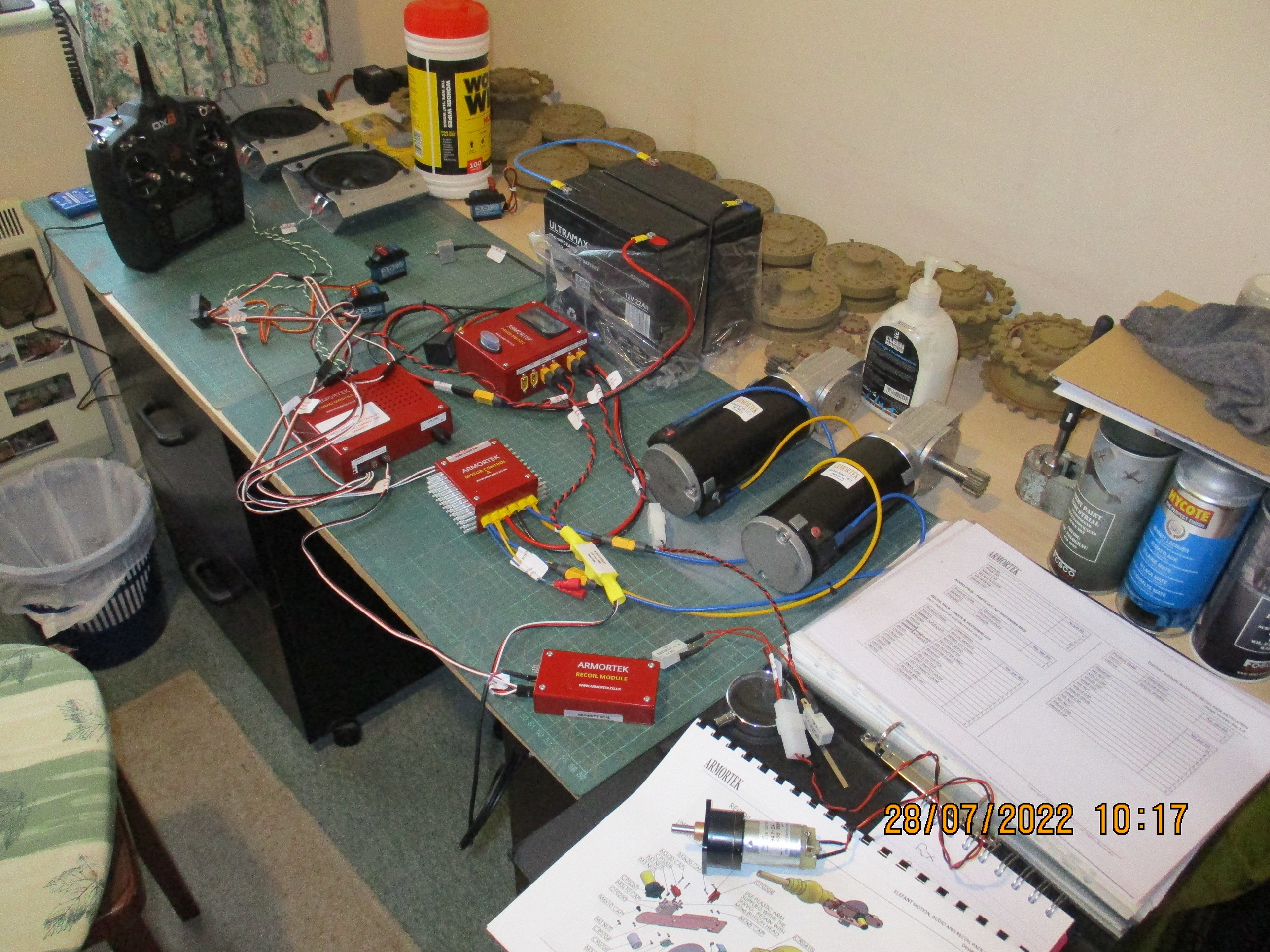

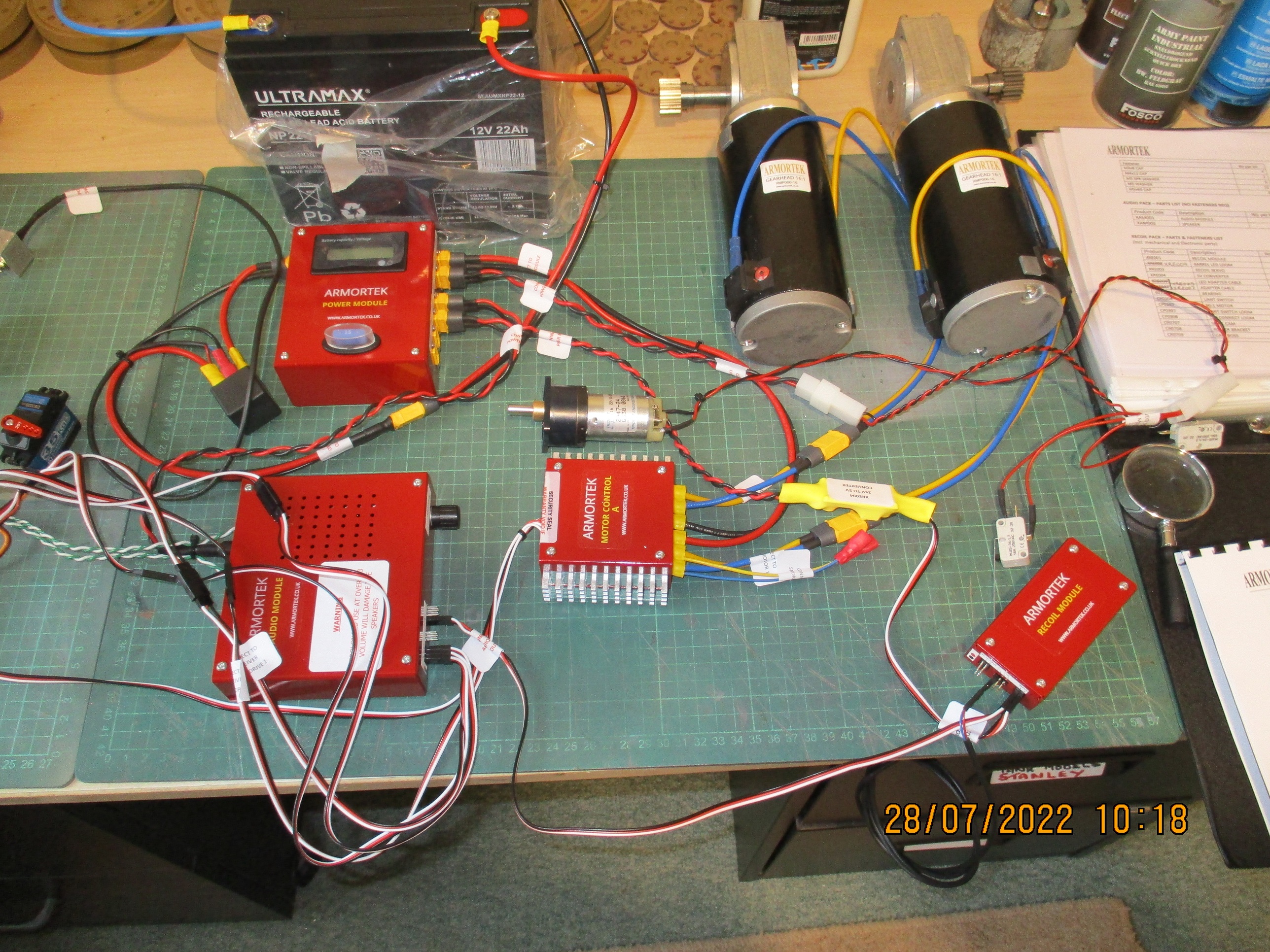

Good morning ladies and gentlemen, a question regarding the 'recoil' system. I have searched the Forum and Knowledge Base for an answer. I have completed the Bench Setup prior to fitting the motors and smoke unit in the Elefant.
All went well up to the point where I tested the recoil motor.....once the on/off switch is activated 'on' the power module which is connected to the recoil motor through the limit switches....the motor, runs continuously.
Is this recoil motor dependent on the limit switches being switched off, once the recoil system is fitted ?....Mick
PS, I posted the photos because love Red Boxes... 8)
Posts: 5132
Has liked: 1485 times
Been liked: 1695 times
Re: Mick's Elefant
Yes, the recoil system relies on the interaction of two microswitches.
When all installed, one is held closed by the recoil servo, and the other by the sliding arm on the bracket.
It can be tricky to get to work reliably and it's a bit like juggling scissors when it's whizzing round and not stopping correctly, so mind your fingers!
