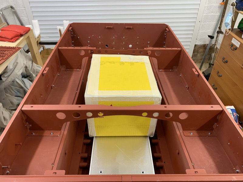

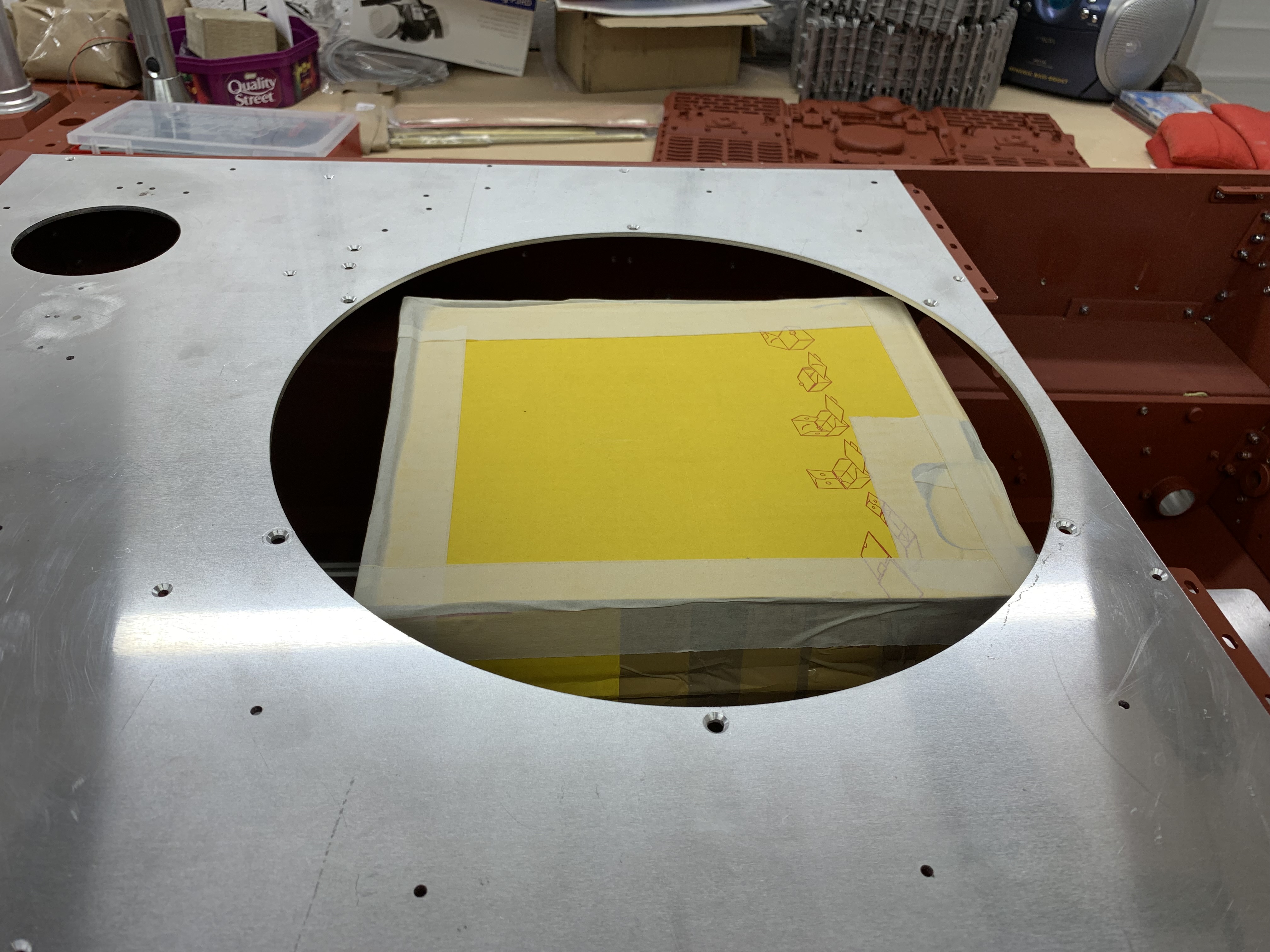

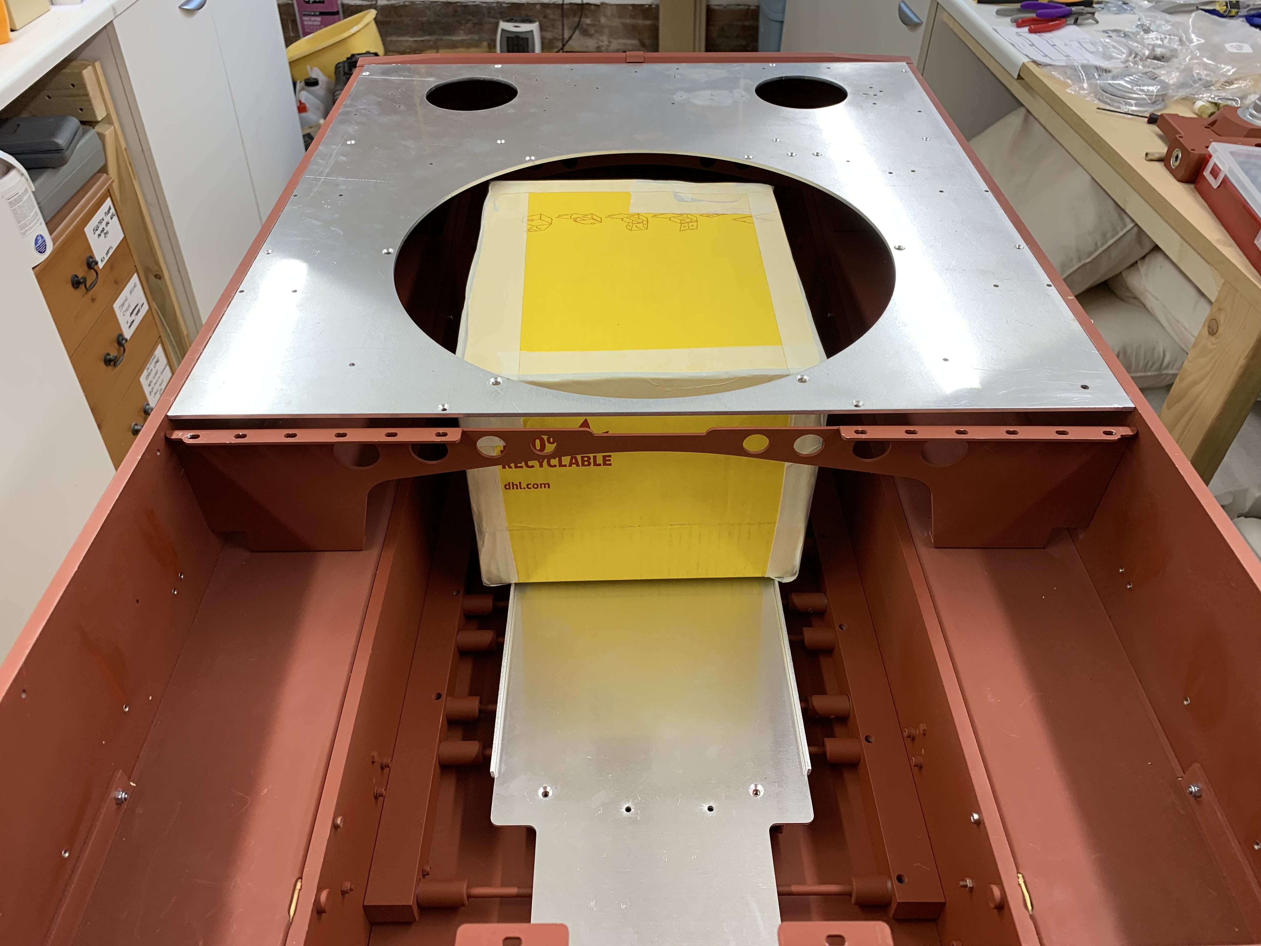

I made the mock up of the Ultramax 24V 36A LiFePO4 battery out of cardboard and took the following photos. There is very little clearance and I although I have not assembled the turret rings and associated parts yet I doubt if there is going to be enough room to have the battery beneath the turret area. I am assuming the best place for any battery is central to the floor of the tank and not at the rear which is the only other place it may fit, again it would be tight and the smoke unit would have to go elsewhere.
I hope the photos help others who are pondering which battery to use.

Gary - that's a foul for elevation. The Tracer module is much thinner but as you say, expensive. I don't consider battery position that critical, I've got my LiFePO4 front left beside the driver's position on my Cent and it doesn't adversely affect running. On your Tiger, you might consider moving it backwards into the engine compartment? The smoker can be relocated easily enough.
Incidentally, that goes to show why British tank design has largely avoided torsion bar suspension because of the impact on interior space.
