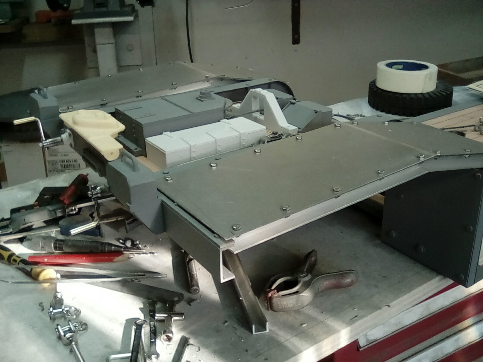

To be honest, your main beams seem a bit weak to me. But that can also come across incorrectly in the pictures.
Of course I don't know which vehicle you want to transport with it. Real were transported with the Sd.Ah.115 at most to PZII.
The future Hetzer would of course also do very well on the trailer, even if a bit too heavy at "16t". :D
Regards Michael

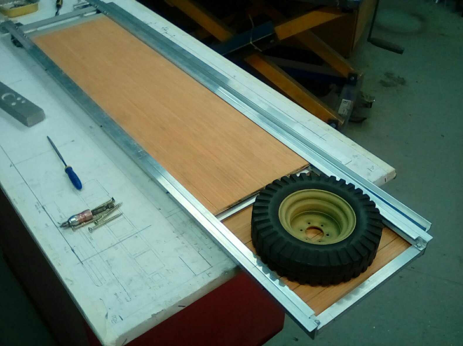

Re: The Sonderanhanger 115 10 ton trailer.
Hi Michael, the beams that you refer to are just part of the spine, there's more than 5mtrs gone into that already and doubled up to include "u" beams and angle, that's difficult to see in the photos, I can't go into to much detail as this is not an Armortek build. The large "I" beams are yet to be cut out and fitted, they take all the weight. Then there's the bed plank frames that also add support, I would like it to be able to support a Armortek panzer 111 but for now it will be a resin panzer 11 which should arrive friday. 8)

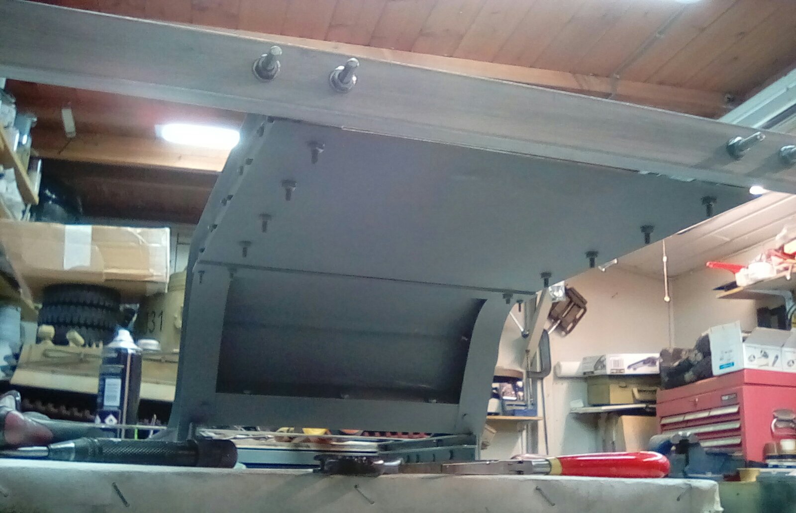

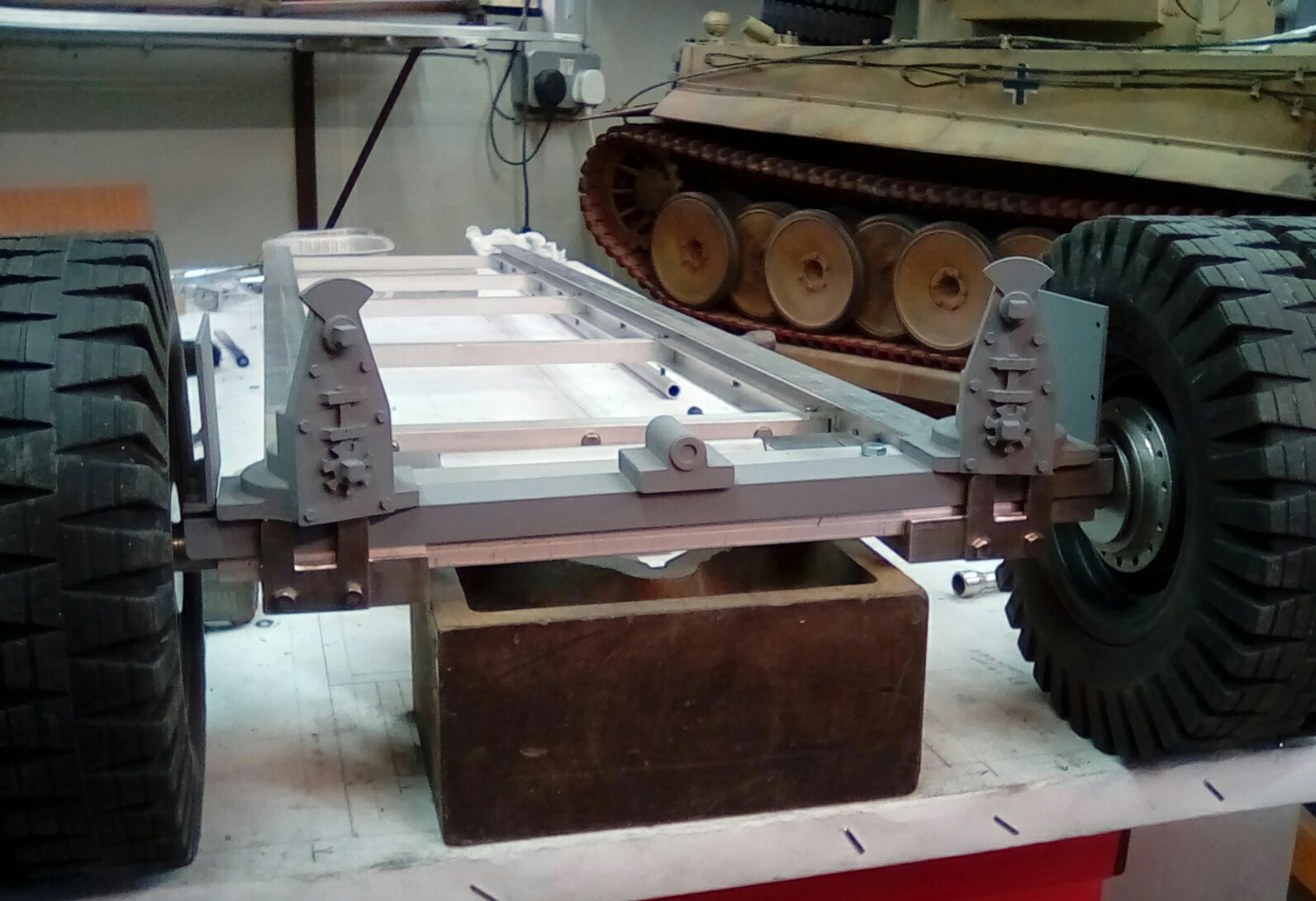

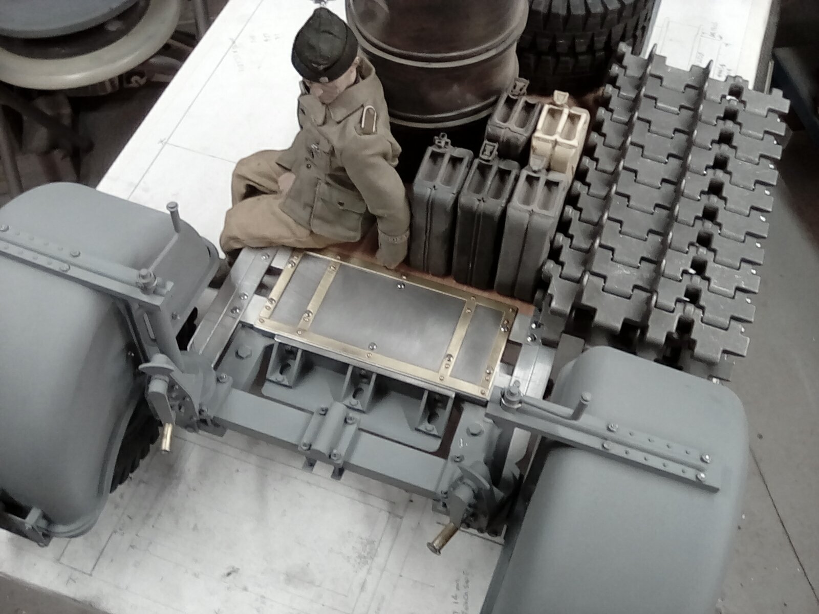

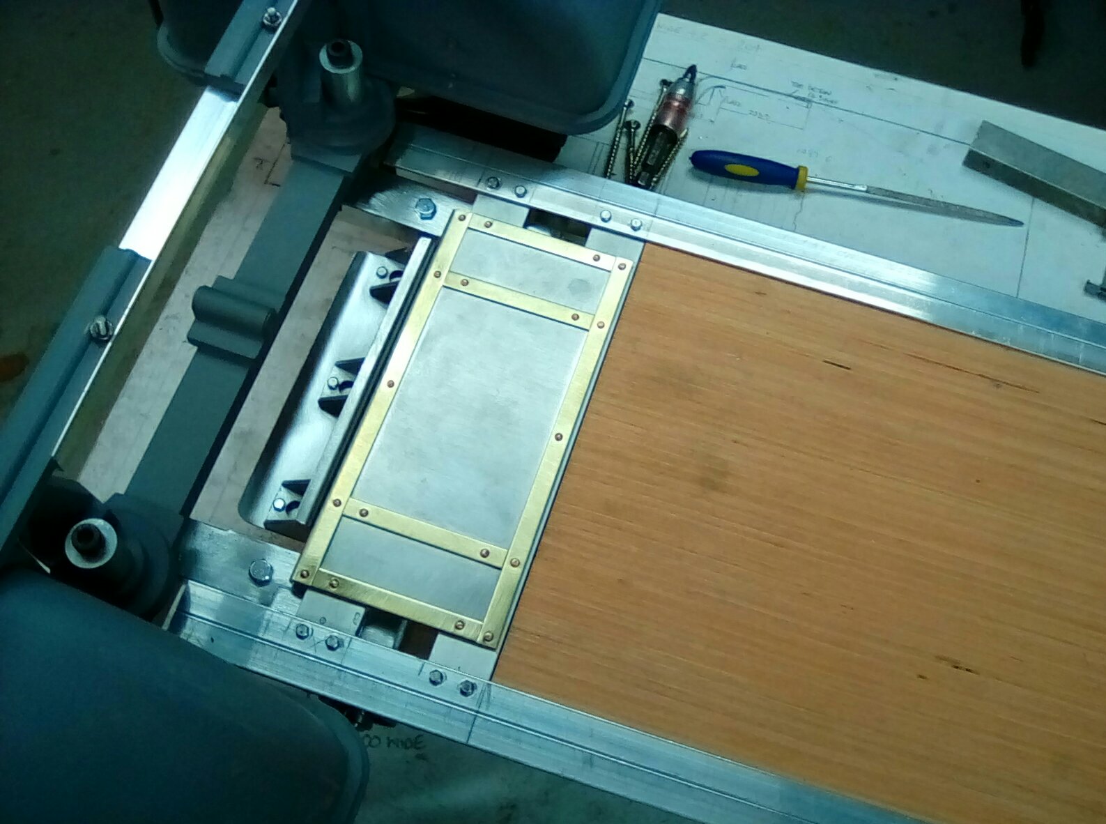

Another quick update on the 115. 8)
The floating axle lowering jacks. Each side lowers independently of the other, the axle assembly then just rolls back out the way for loading.

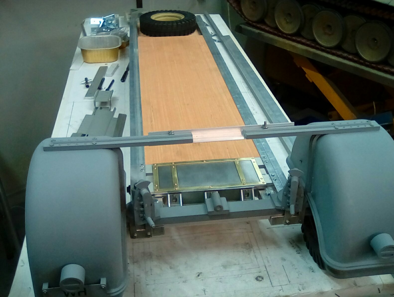

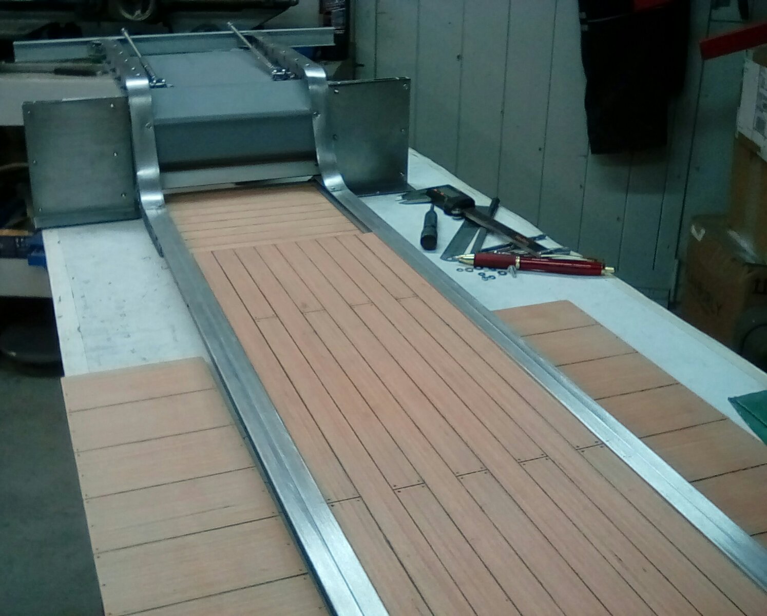

I couldn't resist getting started on some of the wood work.
It's going to be another .5 of a metre longer than what you see here.

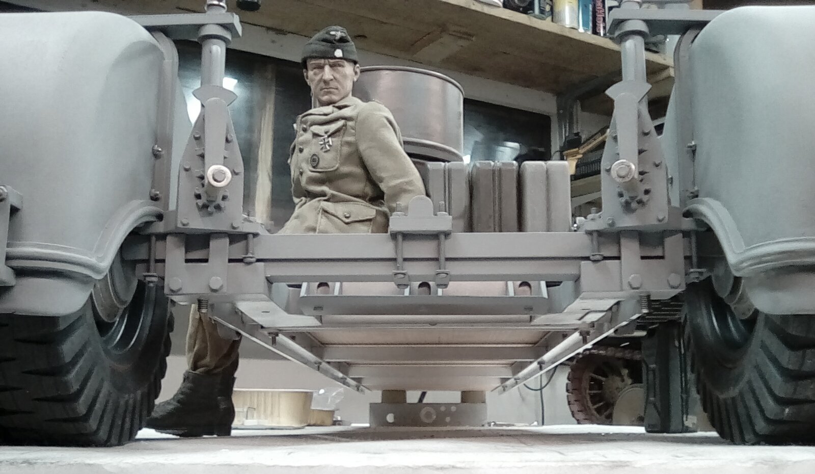

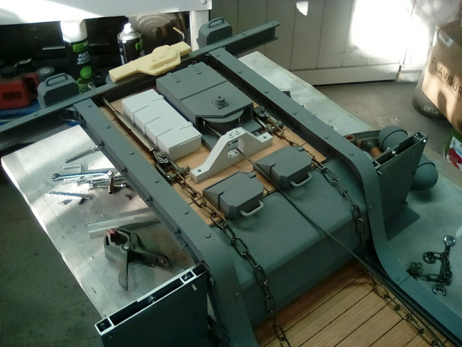

The floating axle suspension box just about done.

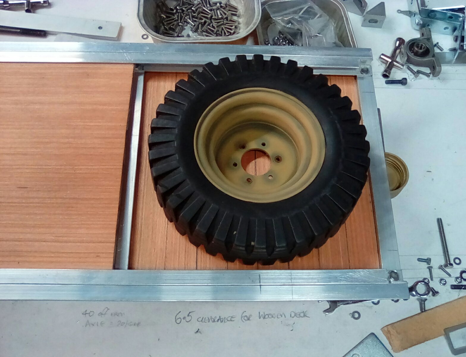

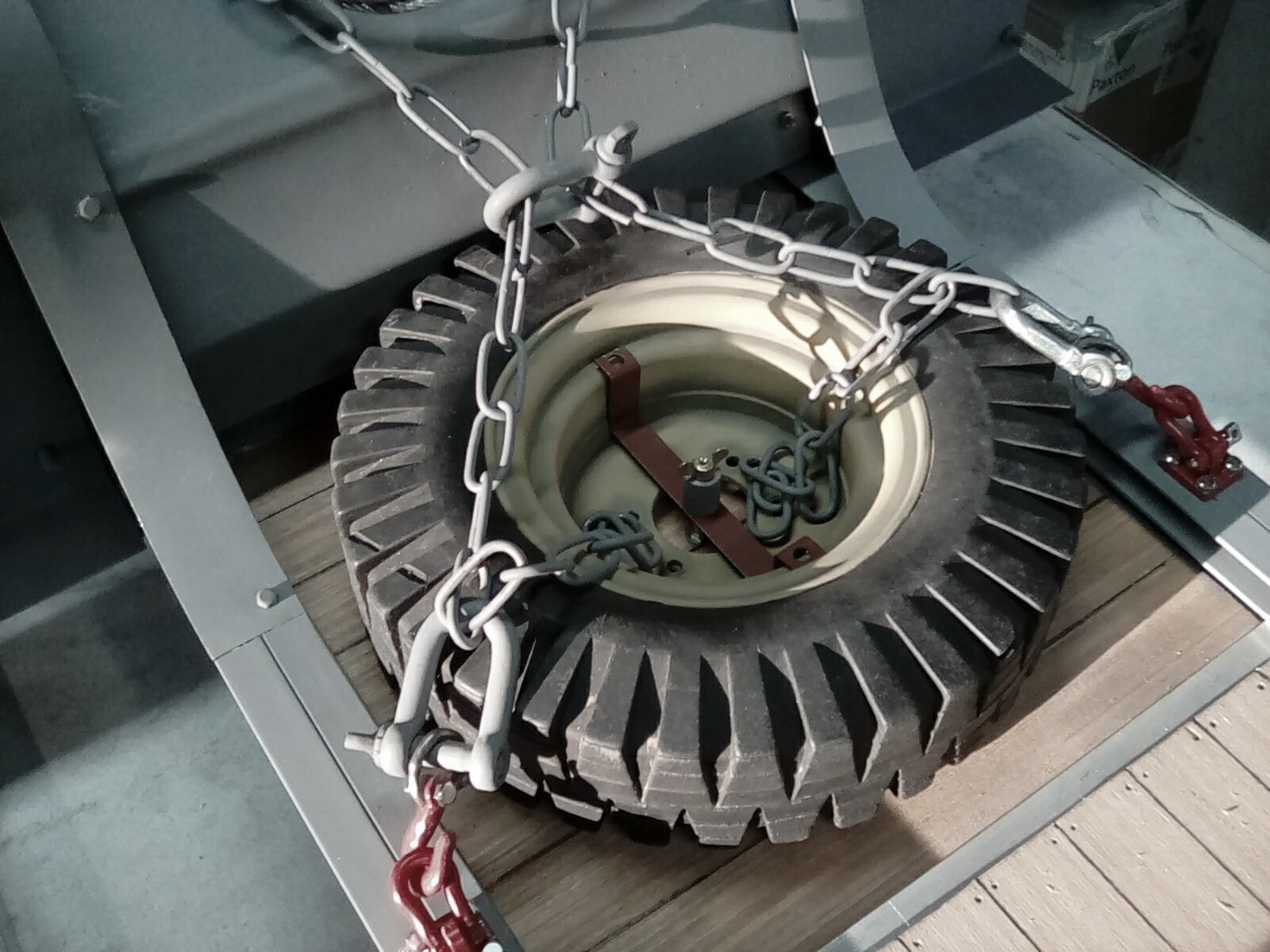

The spare wheel lives in this area here, I have done the planking  detail in the spare wheel box but not the many fixings as yet.
There's a long way to go yet.

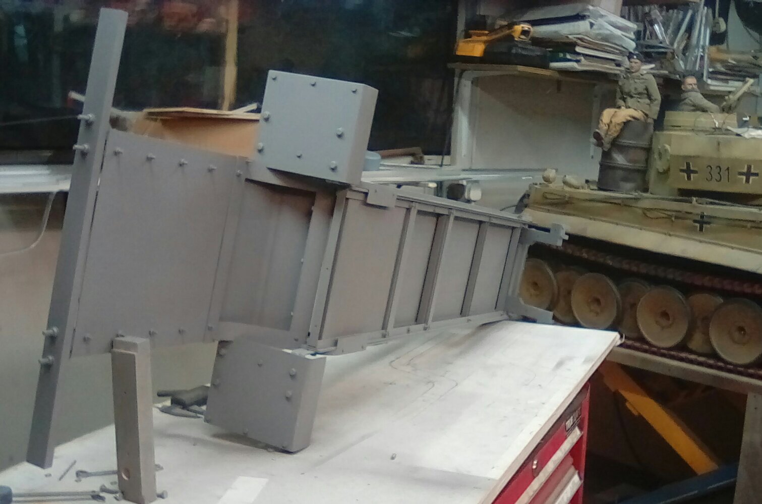

As it's fairly quiet, a quick update. 8)
Lots of parts to make from scratch.

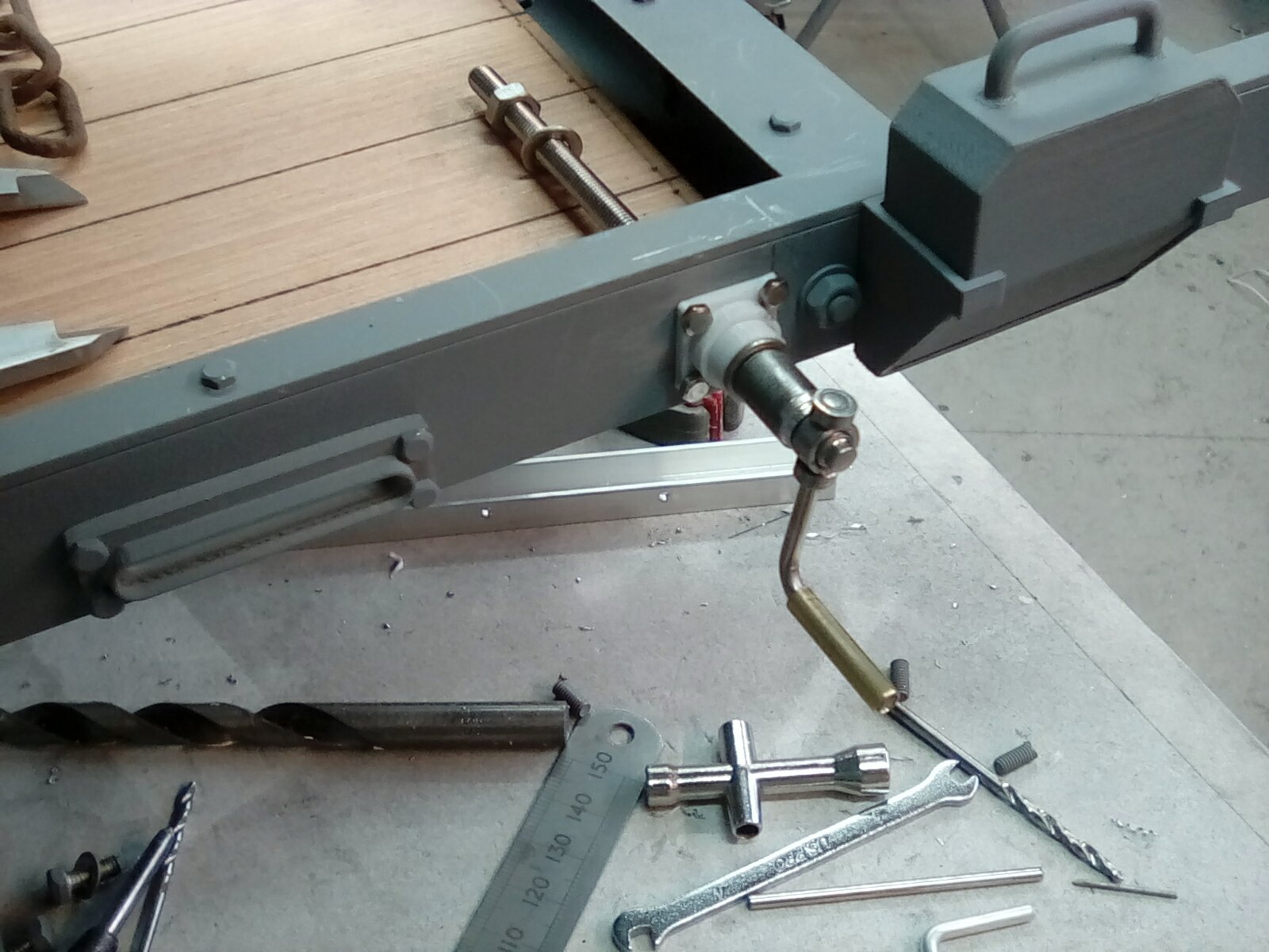

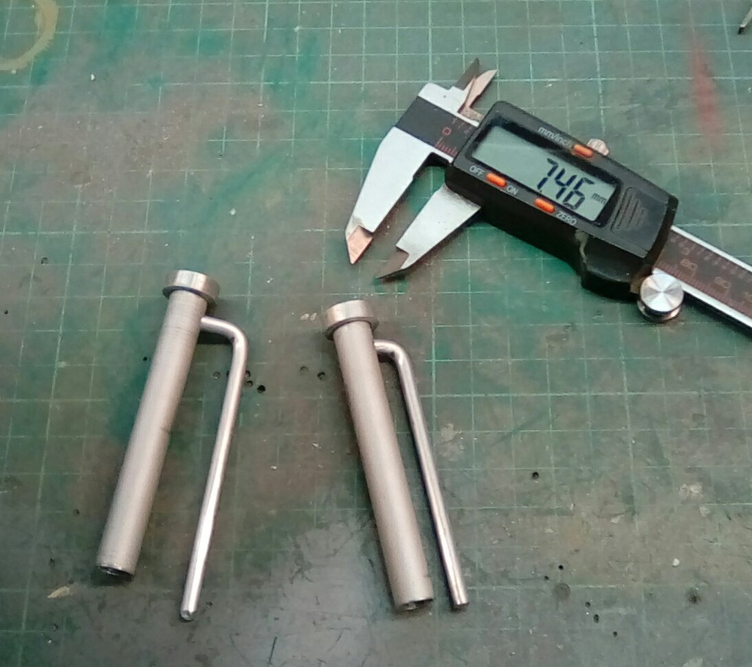

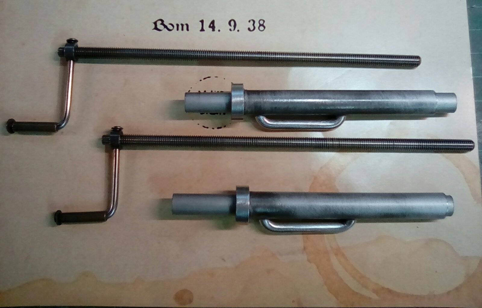

The lowering jack screws.
I have added more convenient lowering Jack handles.

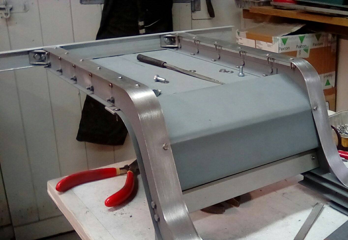

One side of the floating axle lowered.

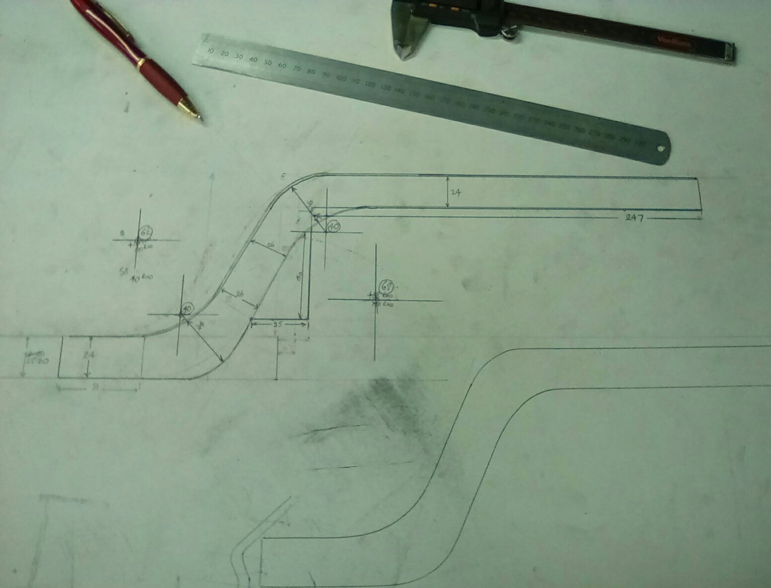

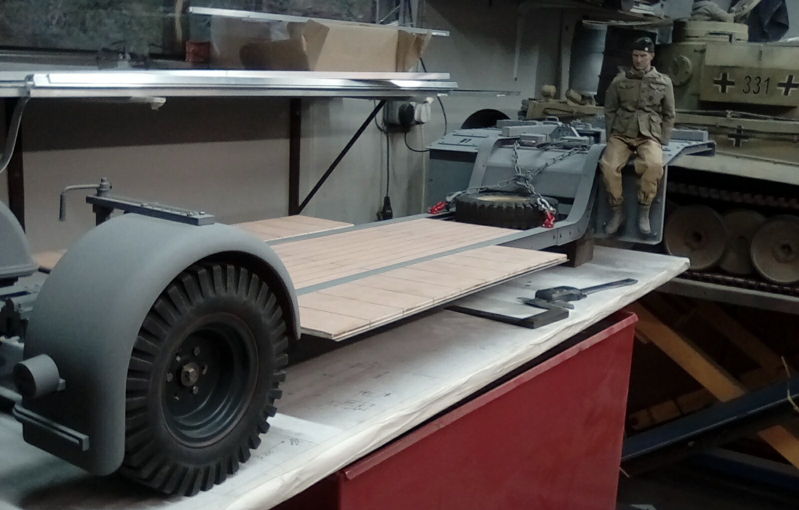

I've been very busy with the 115, just a couple of days off over the festive period. It's a lot of work! 8)

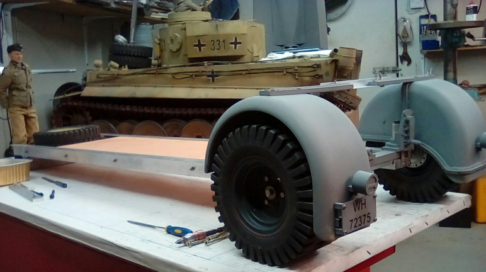

Lots of this malarkey to make patterns and check that my scaling looks correct.
Its going to be heavy but not as heavy as it could have been!

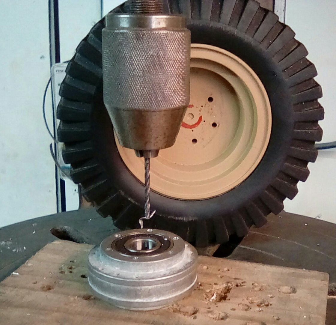

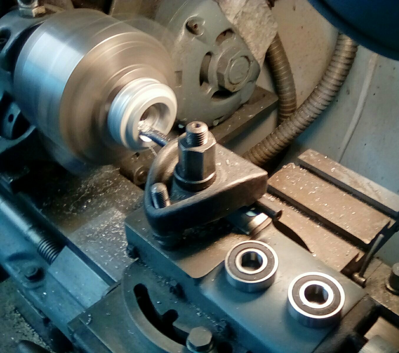

Boring the hubs out to accept larger bearings.
Drilling and tapping the elefant hubs to join the double wheel sets together.
I will soon be onto the front axle and then the turn table.
Now do I paint the timber planks?

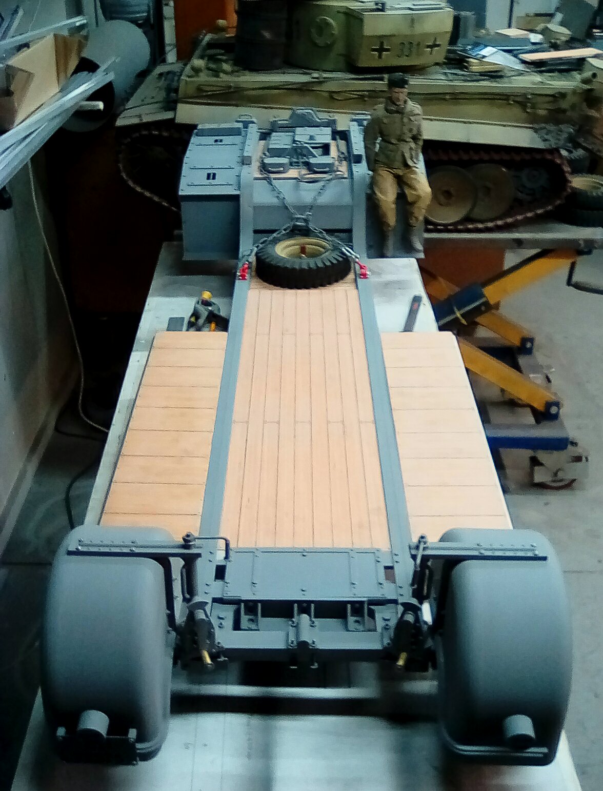

It's very big
It's very big

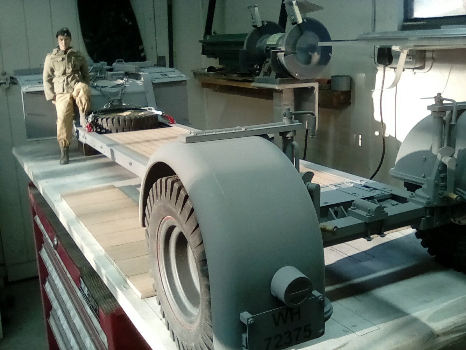

Look how big it is in relation to the tiger!

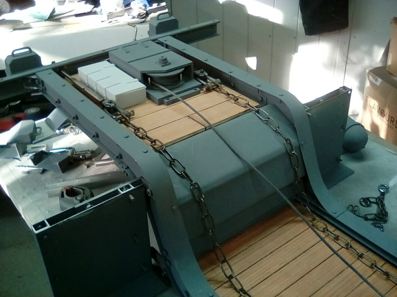

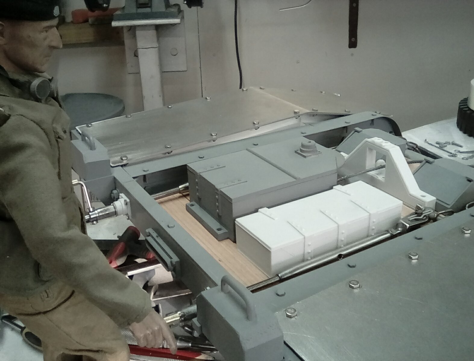

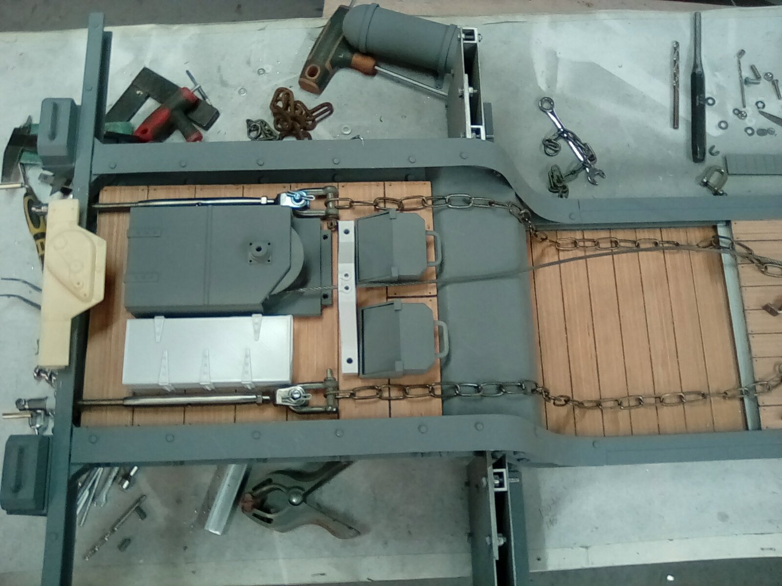

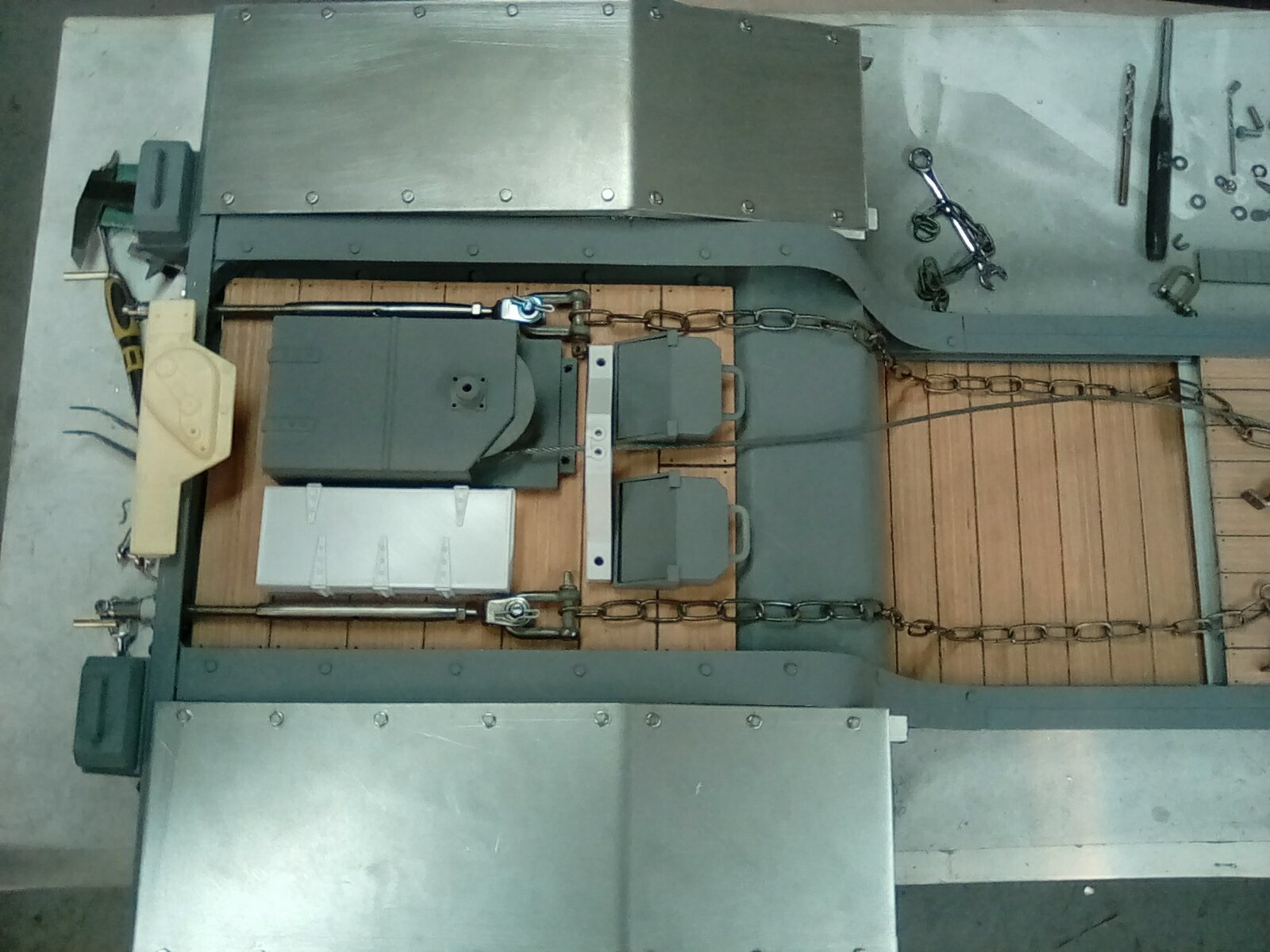

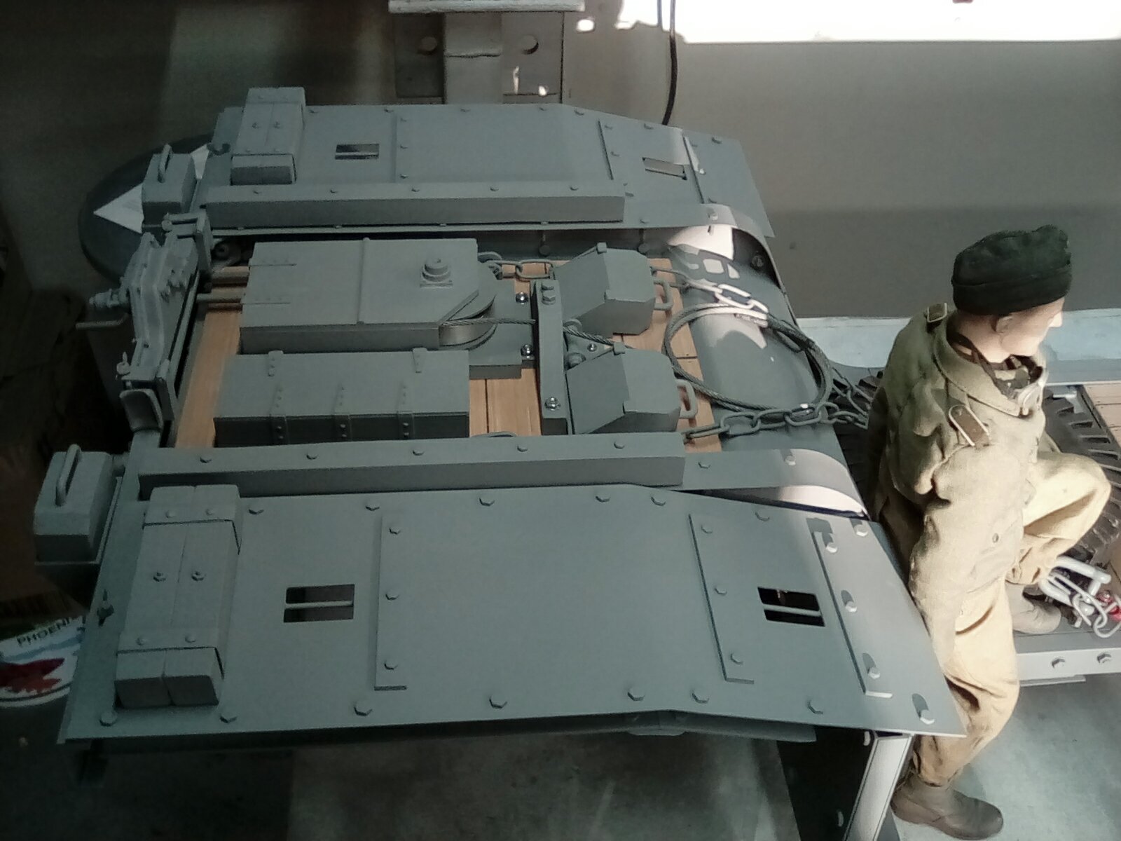

A quick update on the 115 progress. 8) This trailer is crying out for the new Hetzer model. 8)
A big thank you to Vince for making sense of my parts drawings, and to Steve lewington who's building the panzer 11 for me.

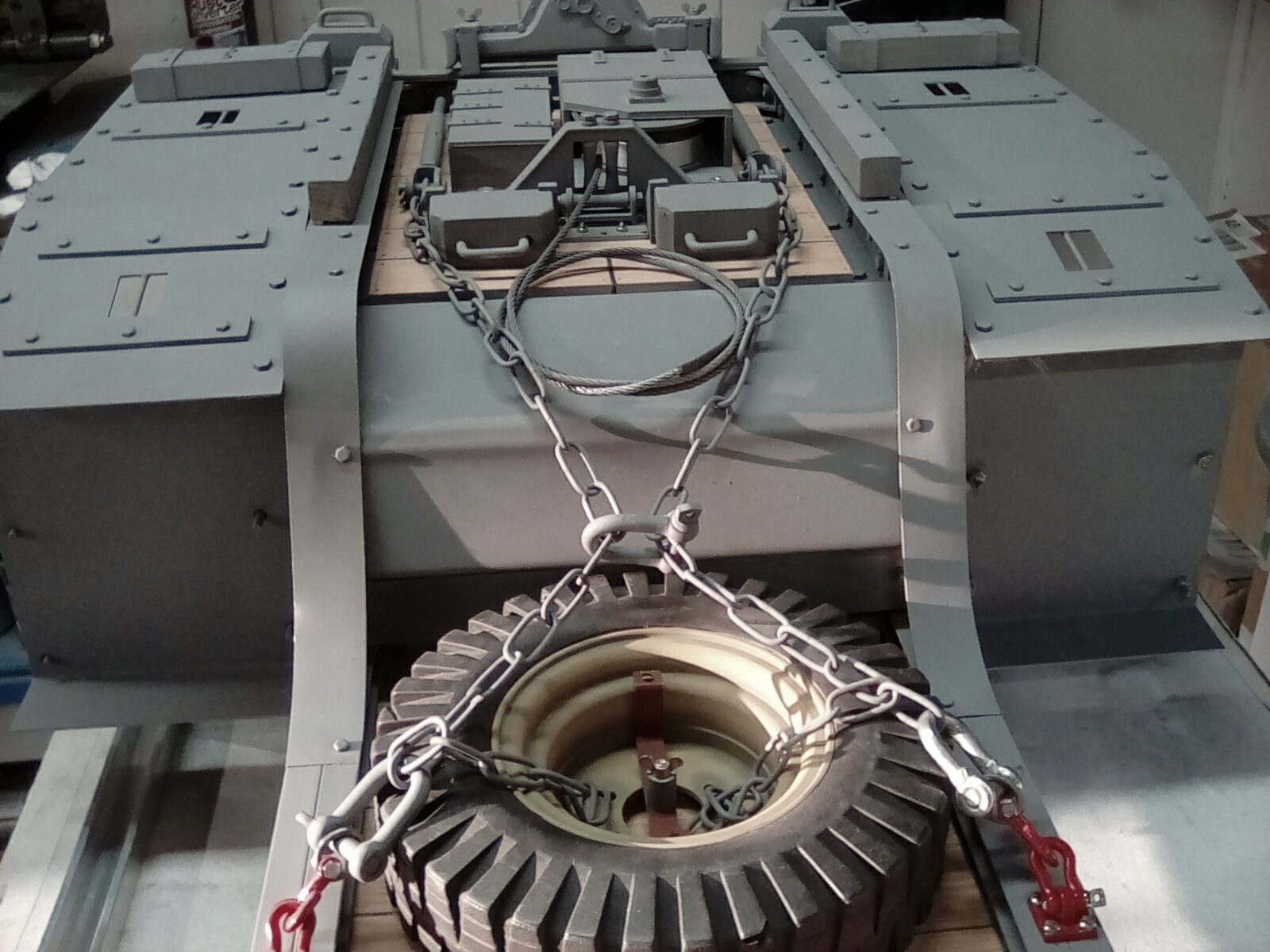

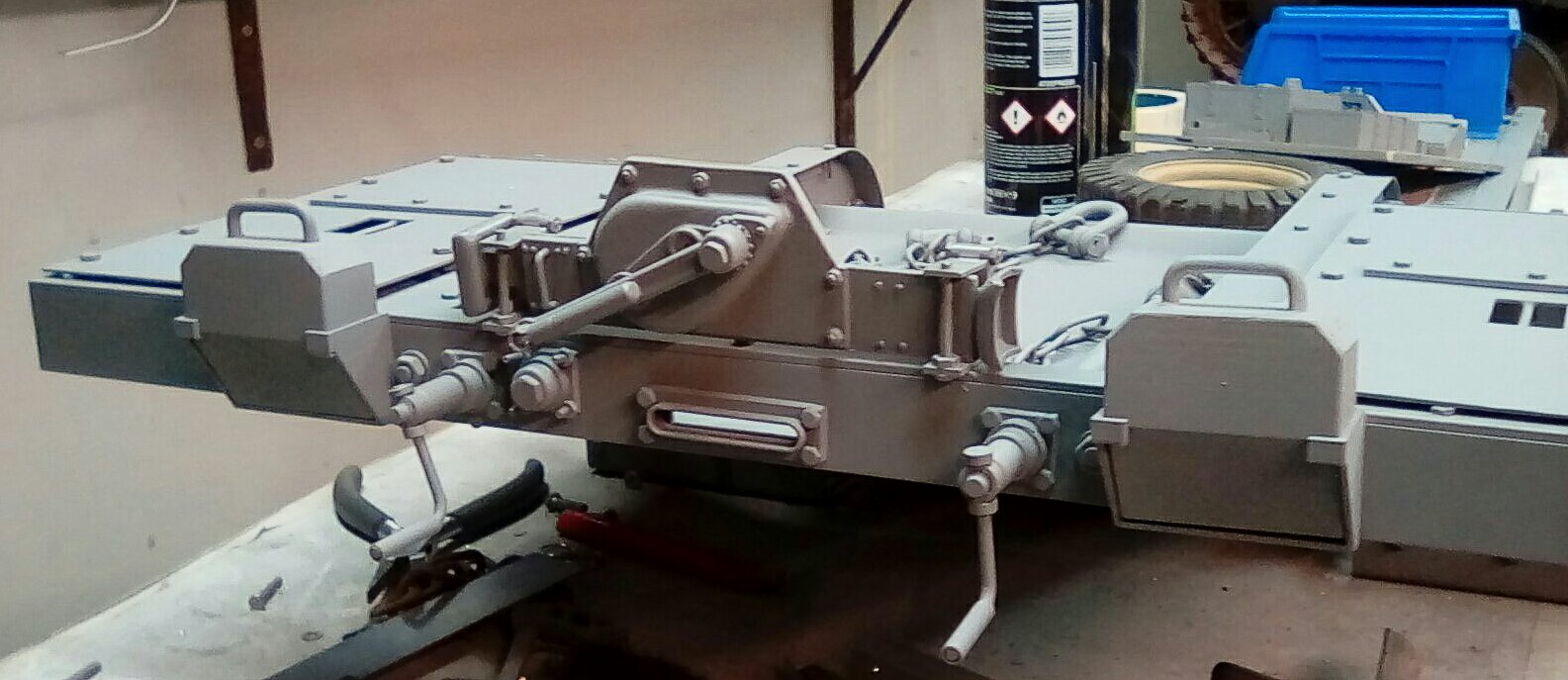

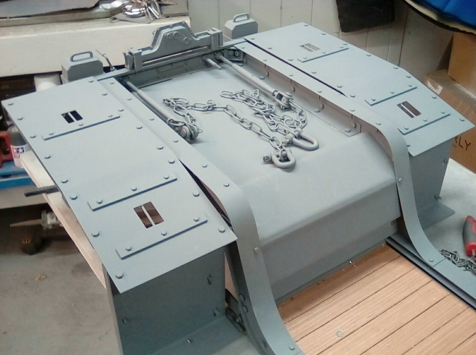

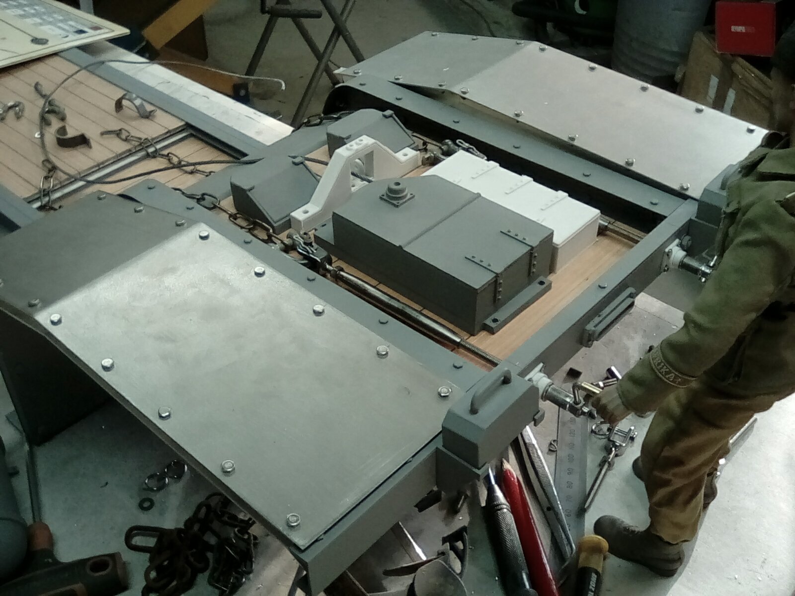

The cargo tensioners are fully functional.

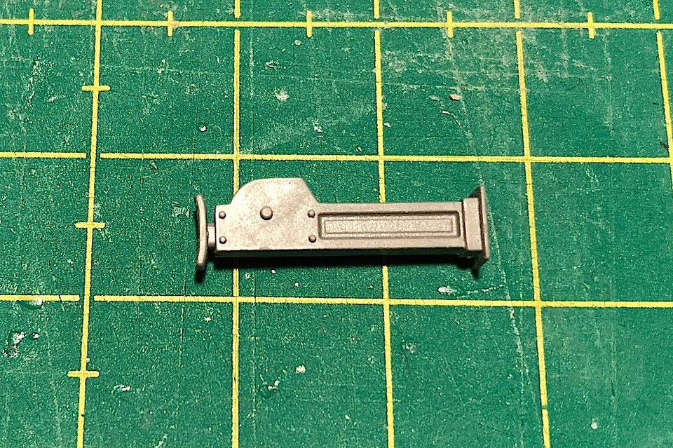

As it's quiet. 8) I could do with some information on the jack used on the 115, some photos would be great.
This is the best photo I have of the correct jack.
Who would of thought that there was so much detail in a panzer trailer ?

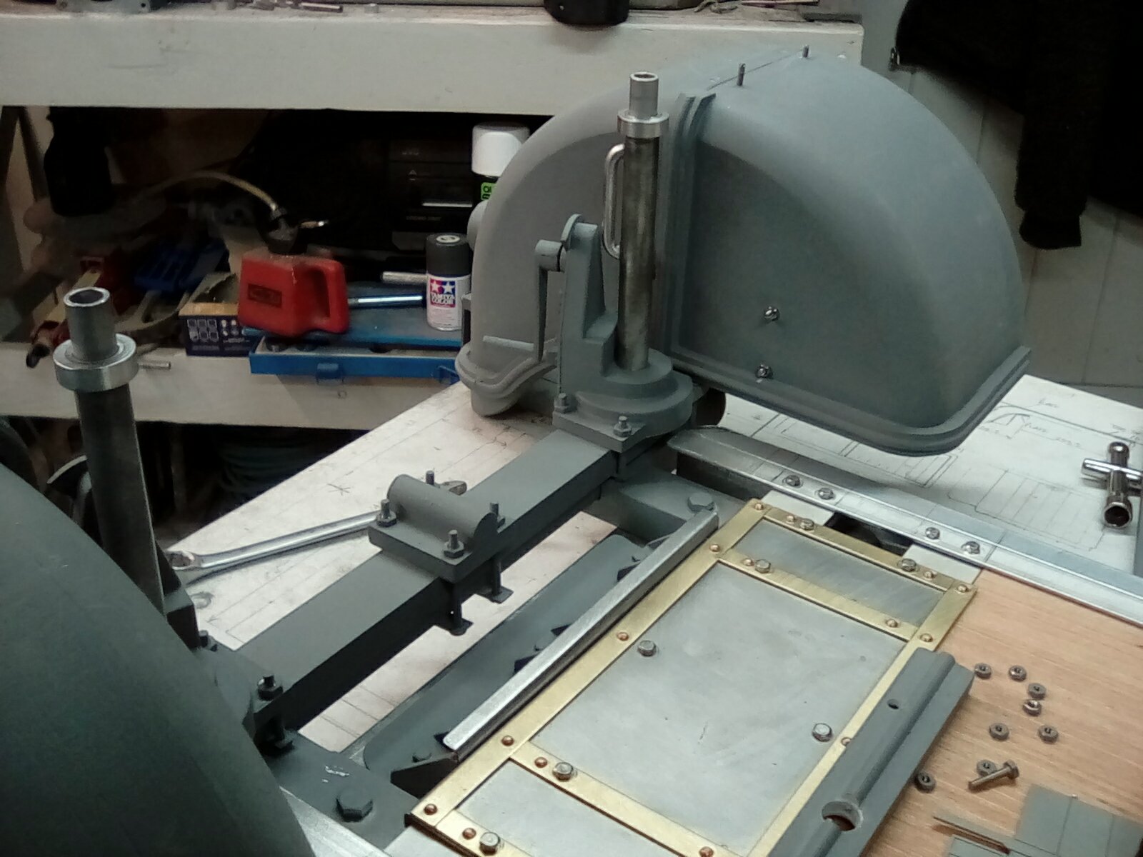

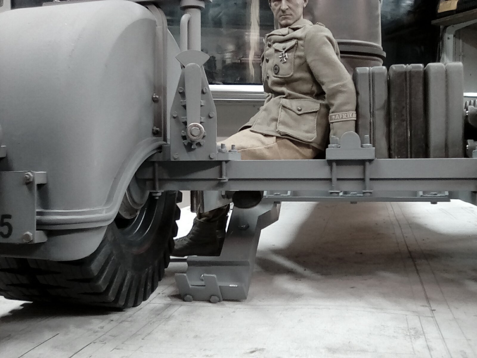

I've made a start on the out riggers but more about that in the next installment.
