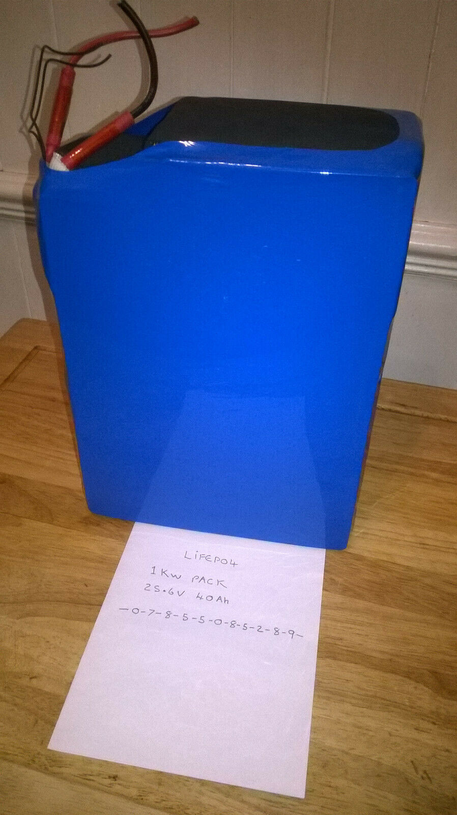

I've come across used battery packs before on the bay, details see below.
They are a sealed unit reasonably priced. If as you say these things have a good life expectancy would this package be suitable for the tanks.
I cannot make my mind up on the size of the batteries you have pictured on your bench.
They look like they've been swagged from a U boat/Boot :lol:
lifepo4 battery packs 24v 1kw 40ah with 20 amp 8s bms lithium iron phosphate
they are used but all are above 95% capacity
size is 21cm x 9cm x 30cm

The 20A BMS might be a snag if that's all the current drain it will allow.
The one I use in the T-34 is rated at 30A continuous discharge and that's the smallest tank I own.
I would also say the packs I have also use the Headway individual cells - think huge AA batteries - so individual cells can be monitored and replaced as and when they become tired.

Capacity is not the issue then, but a 20amp BMS may not have enough poke.

40 Ah cells with a 20 amps BMS are not suitable for a tank in my eyes. I don't own a Chieftain, but my NH Königstiger with steel tracks, about 160 kgs and a very strong traction consumes up to 55 amps when operating under rough conditions like logging a tree or towing a full sized car. This is the reason why I don't like a BMS because a perhaps 100 amps BMS is rather expensive and fully oversized in 99 % of driving conditions. Without a BMS there is no problem to consume very high currents for a vew seconds when using an ESC with 2 x 100 amps constant current like mine.
