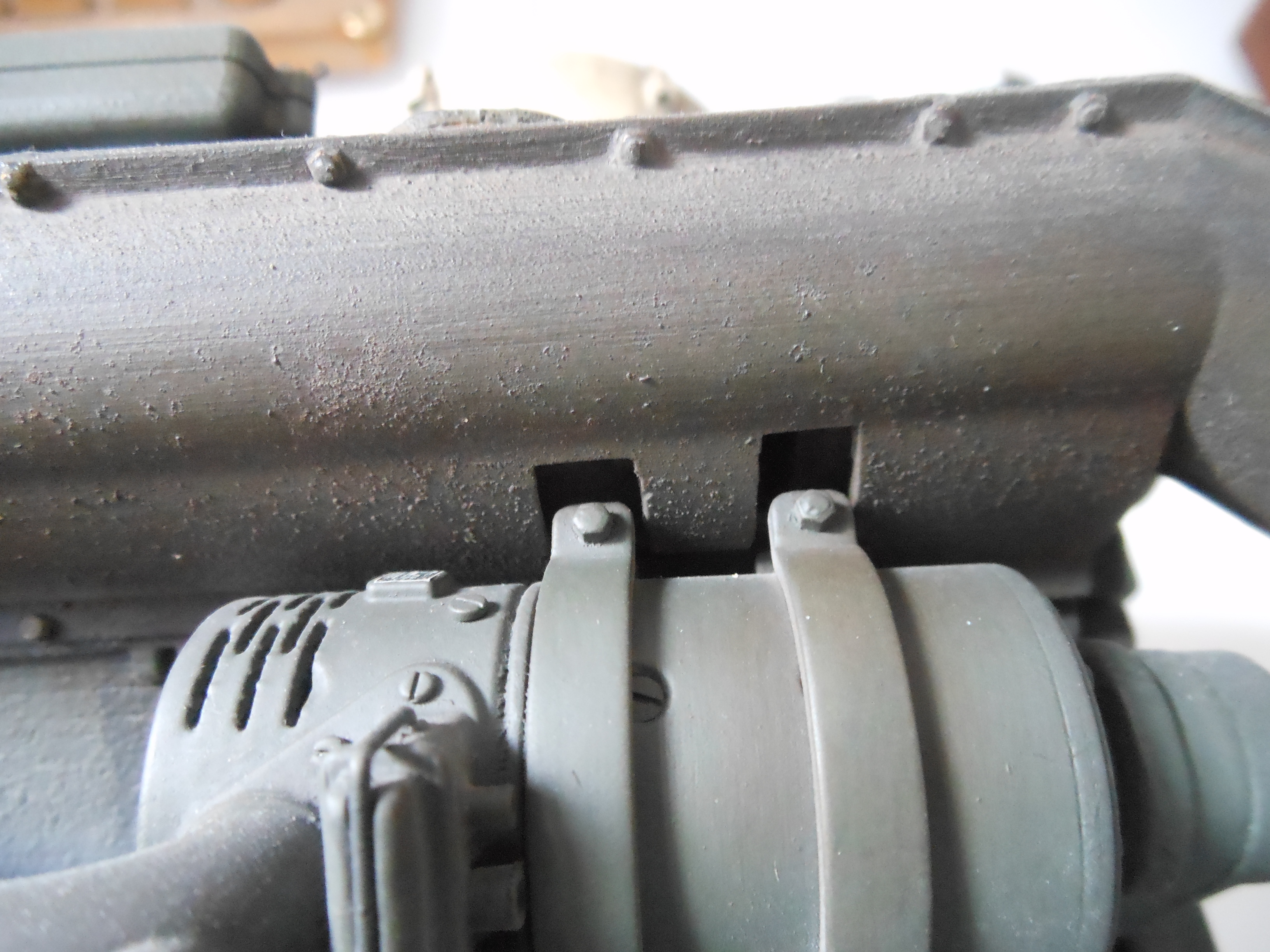

Left side:
i'll show you what you should never do, I've always said and keep saying that before gluing you always have to check many times that everything is aligned. I didn't do it and that's the result
also, I forgot to insert the pins !! ??<br />what are you up to Ivano?
I have not correctly aligned the four brackets, and the cylinder does not rest correctly
the oil cooler supports are almost perfect, just a small change in circumference, careful not to damage the holes

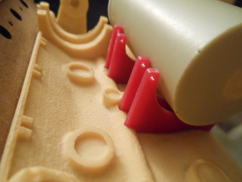

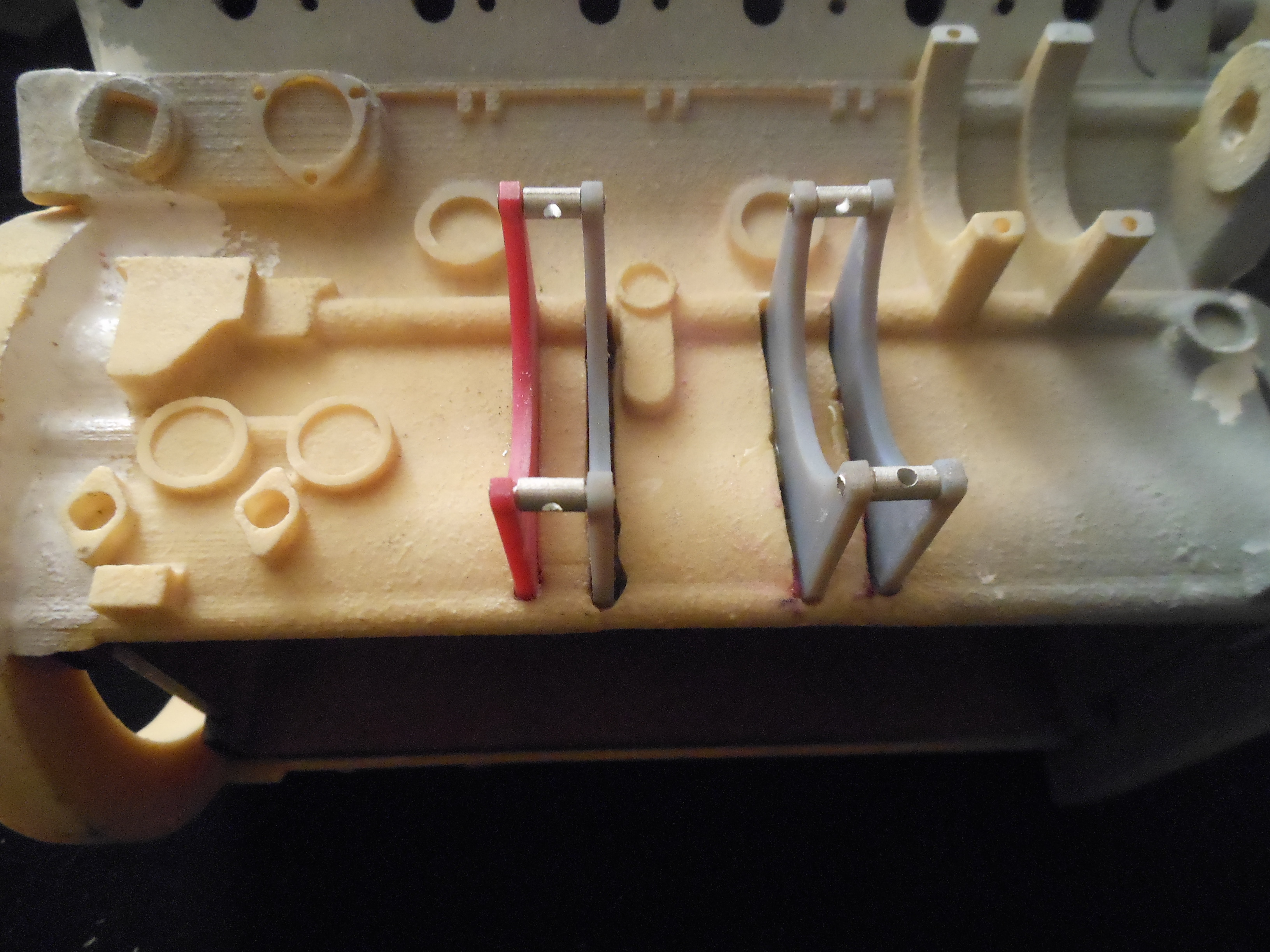

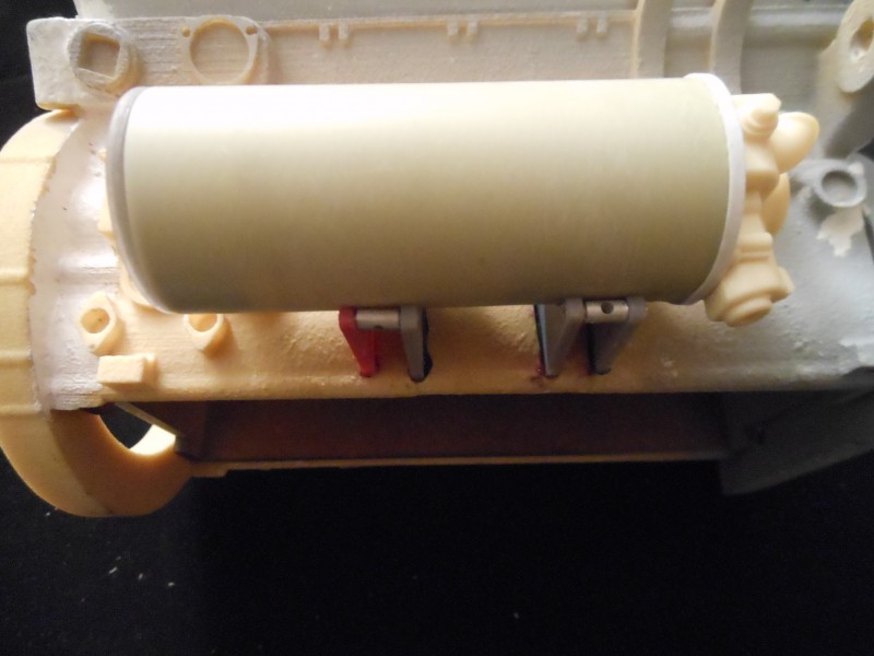

The correct assembly sequence is as follows:
mount the pins on the brackets, do not glue
oil cooler, large cylinder
DSCN2517 (2).JPG (40.3 KiB) Viewed 2111 times
DSCN2516 (2).JPG (32.05 KiB) Viewed 2111 times
rest the brackets and align with the help of the cylinder<br />only when everything is perfect, paste

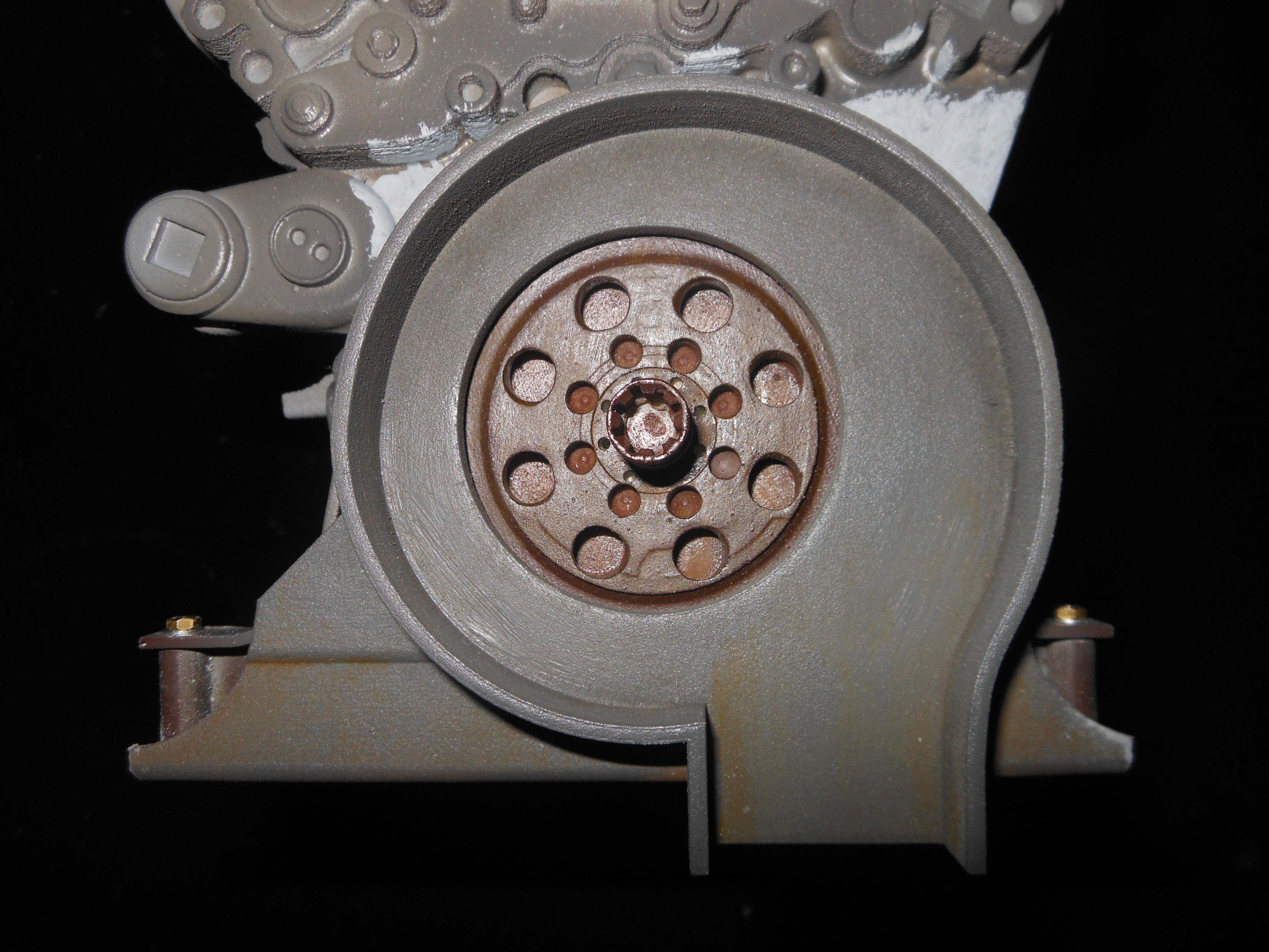

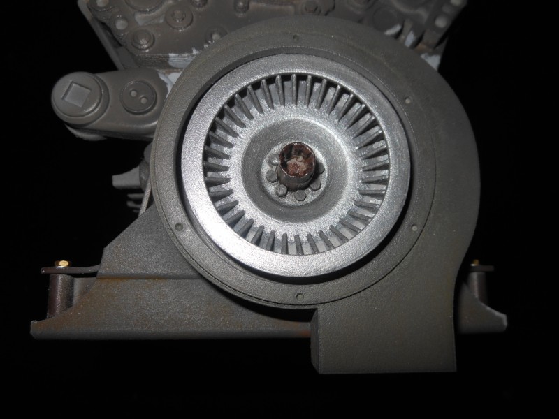

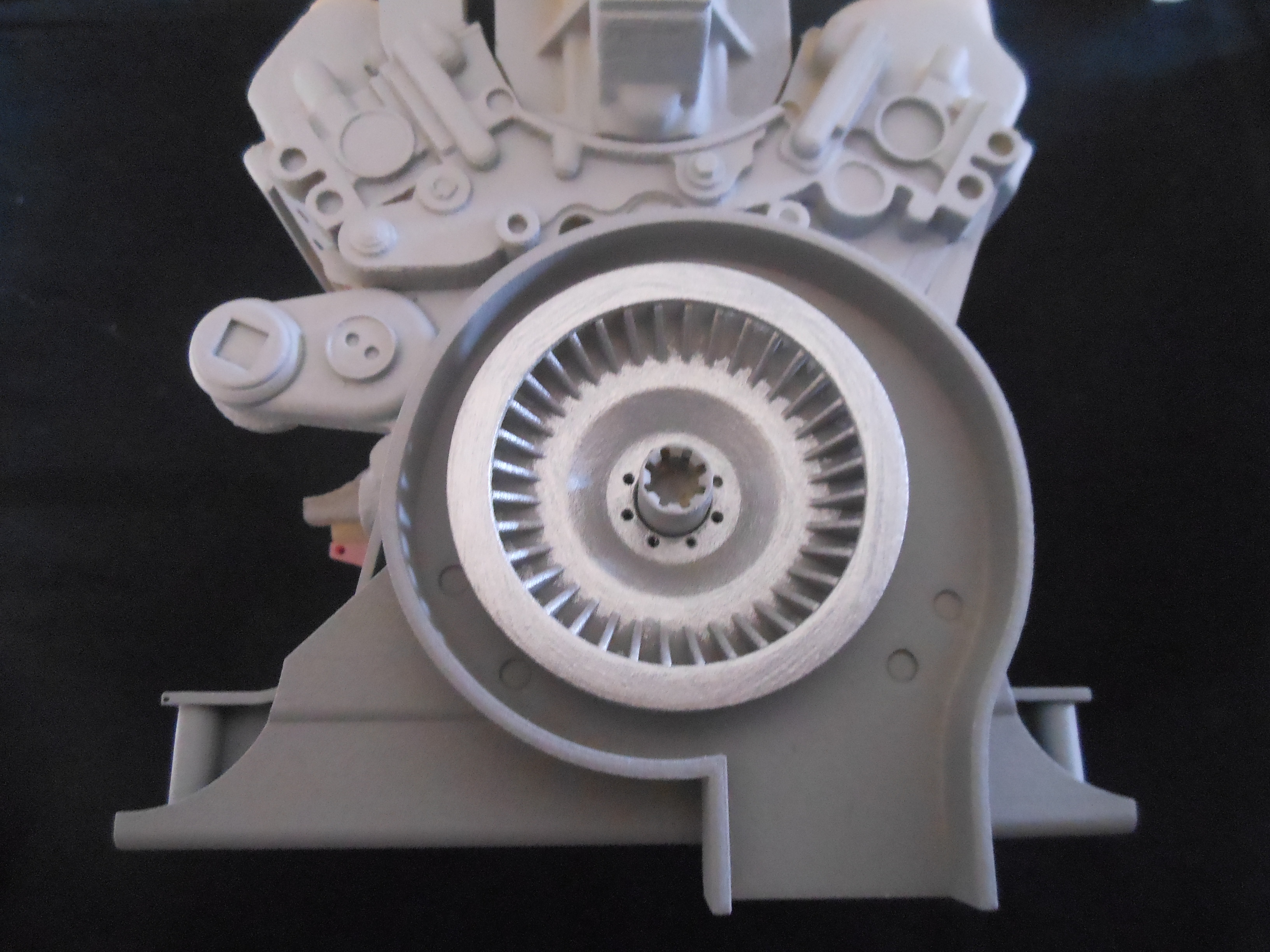

The sirocco fan is almost finished, I will complete it later.
Now, I will skip the assembly stages of those engine components that have no particular difficulty in assembling. It is very difficult to make mistakes because all the pieces are packed with their respective bolts. Anyway, if you have doubts, ask me.
Try to center the flywheel well with the fan and cover.<br />Mine is not perfect, but once finished and closed, you will not see anything.
I haven't put the bolts on the lid yet

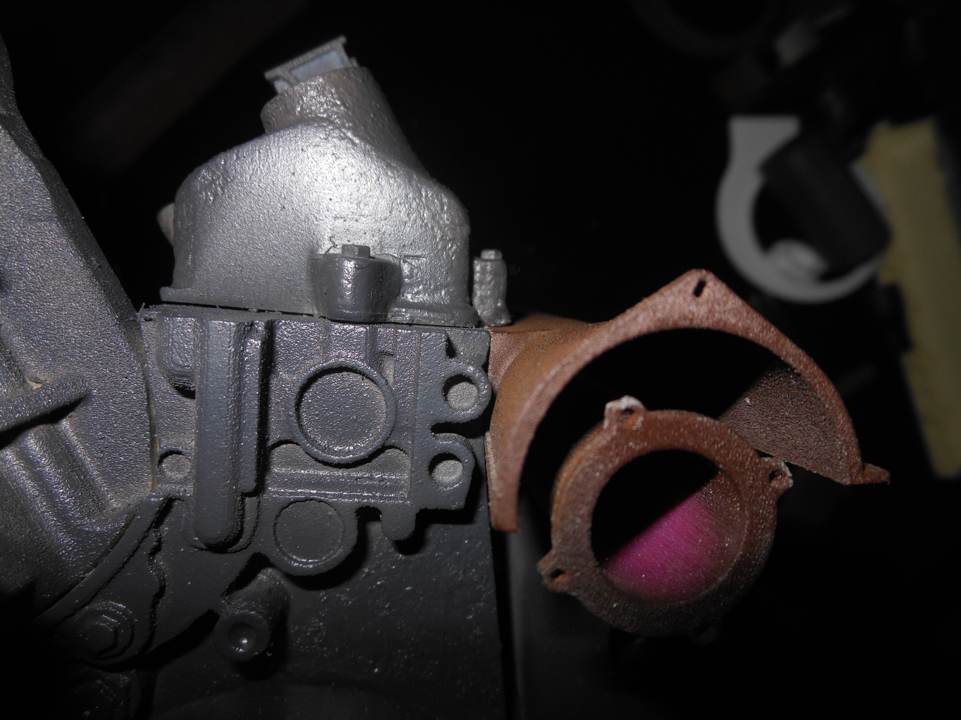

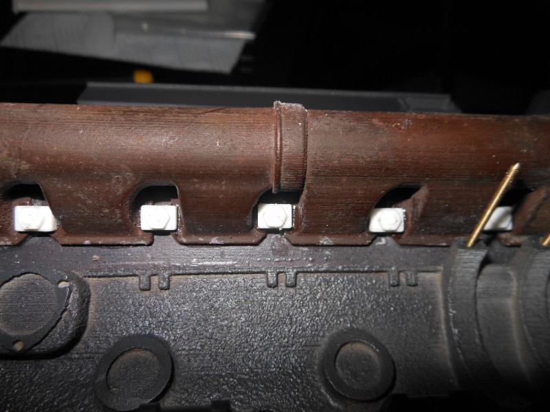

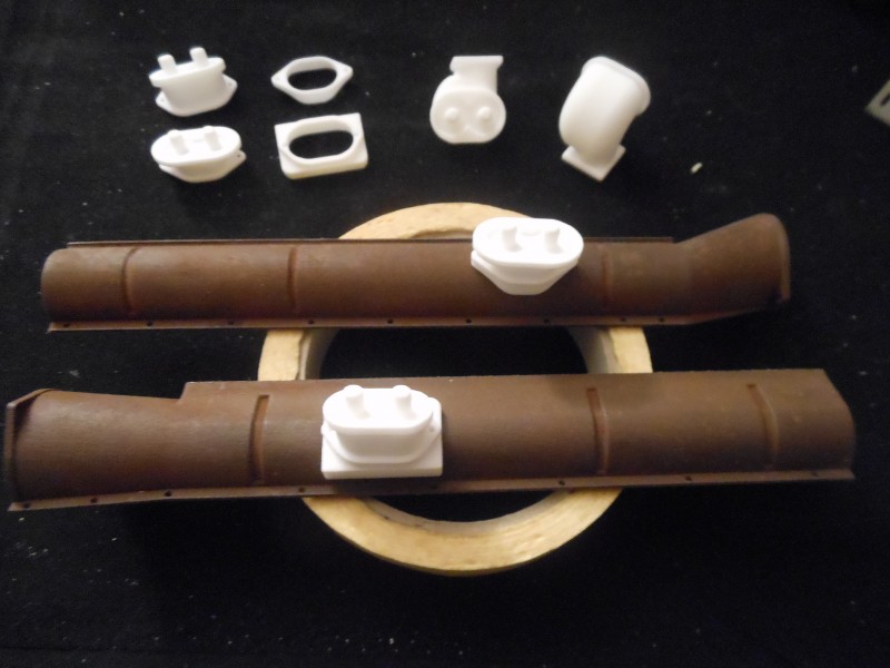

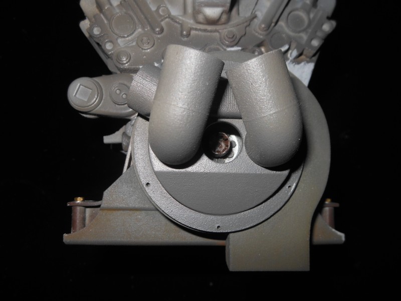

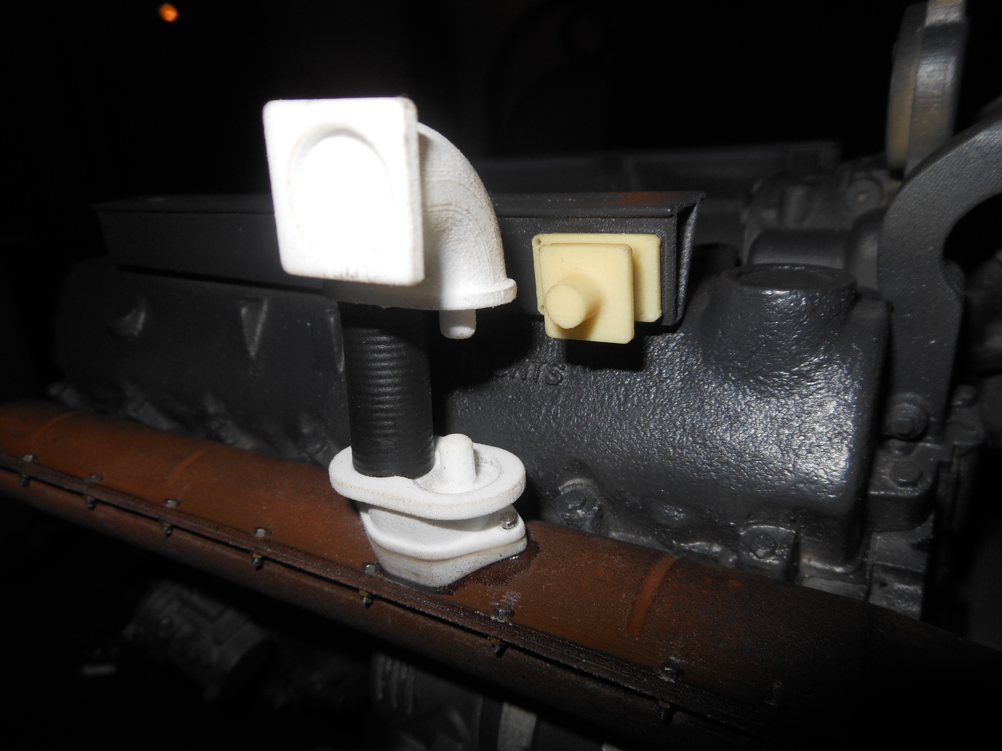

One thing that differentiates the P45 from the P30 are the vertical collectors of the exhaust pipes. Here are the main pieces that make them up, only the corrugated pipes are missing. They came out well, I like them, what do you say?
Ivano Costantini
Posts: 533
Been liked: 735 times
Re: New engine for King Tiger and Jagdtiger
Post by Ivano Costantini »

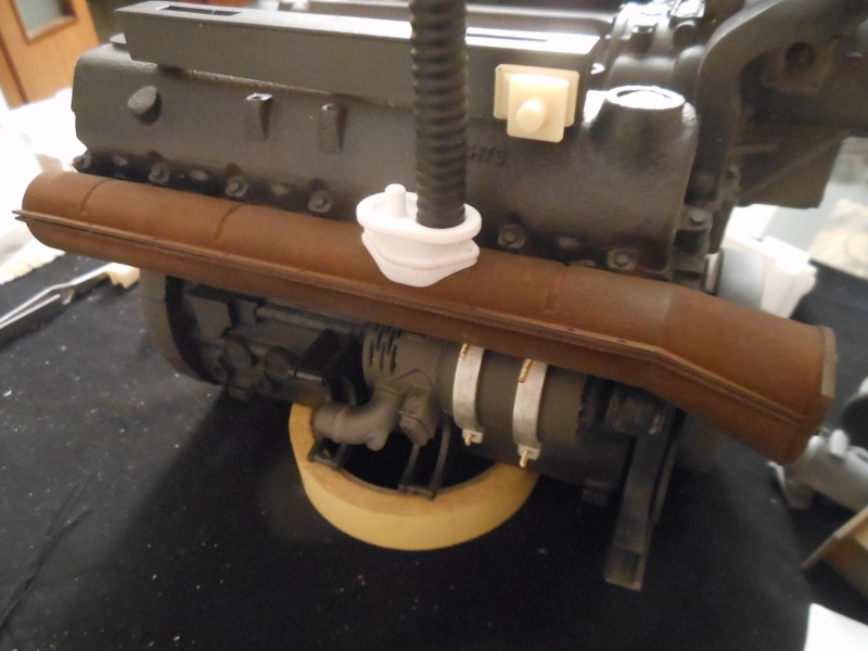

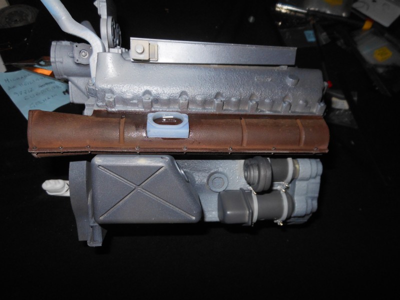

Here's how it looks mounted.
If you think that's not good, make comments.
Thank!

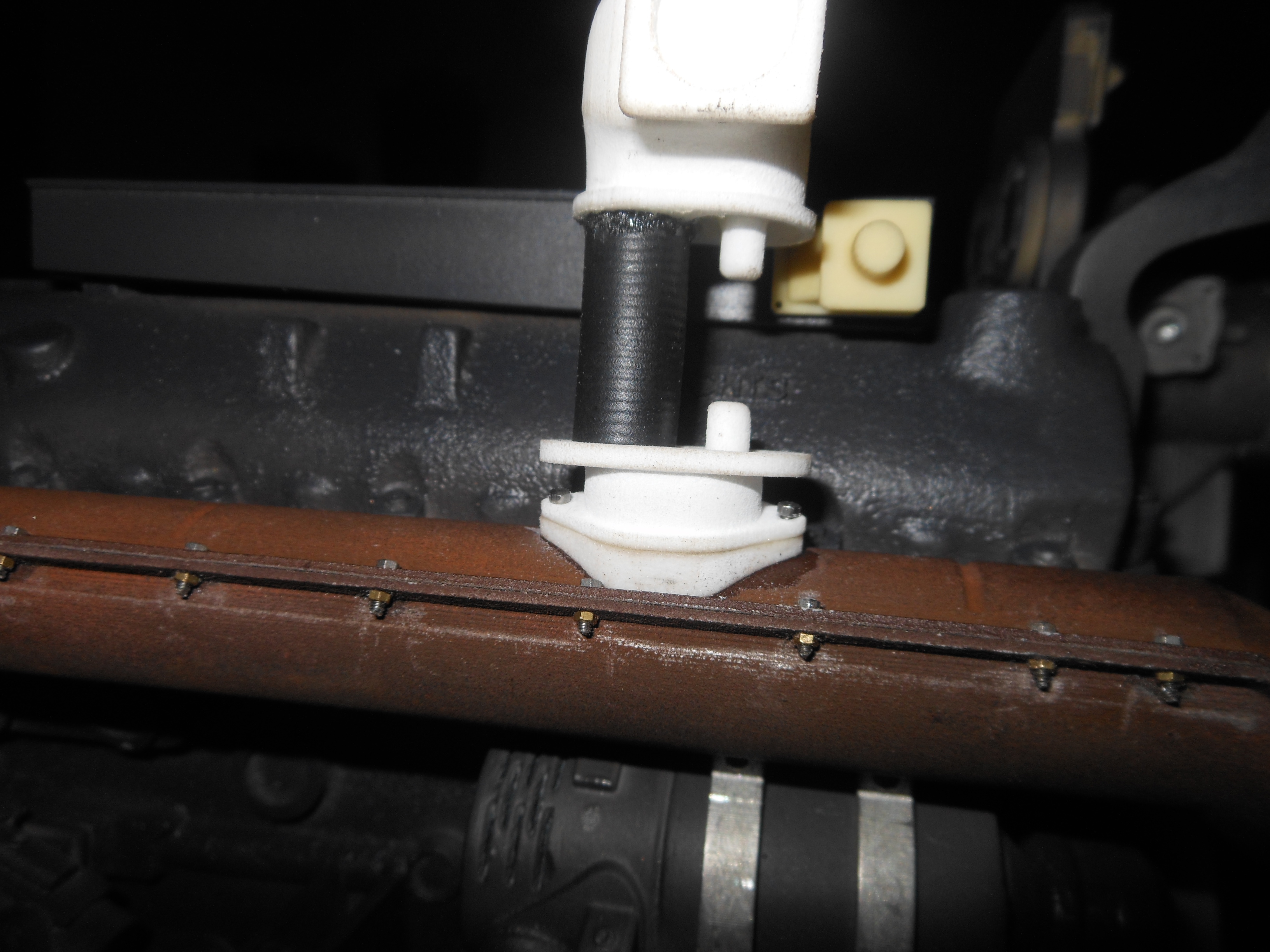

this is the top of the tube

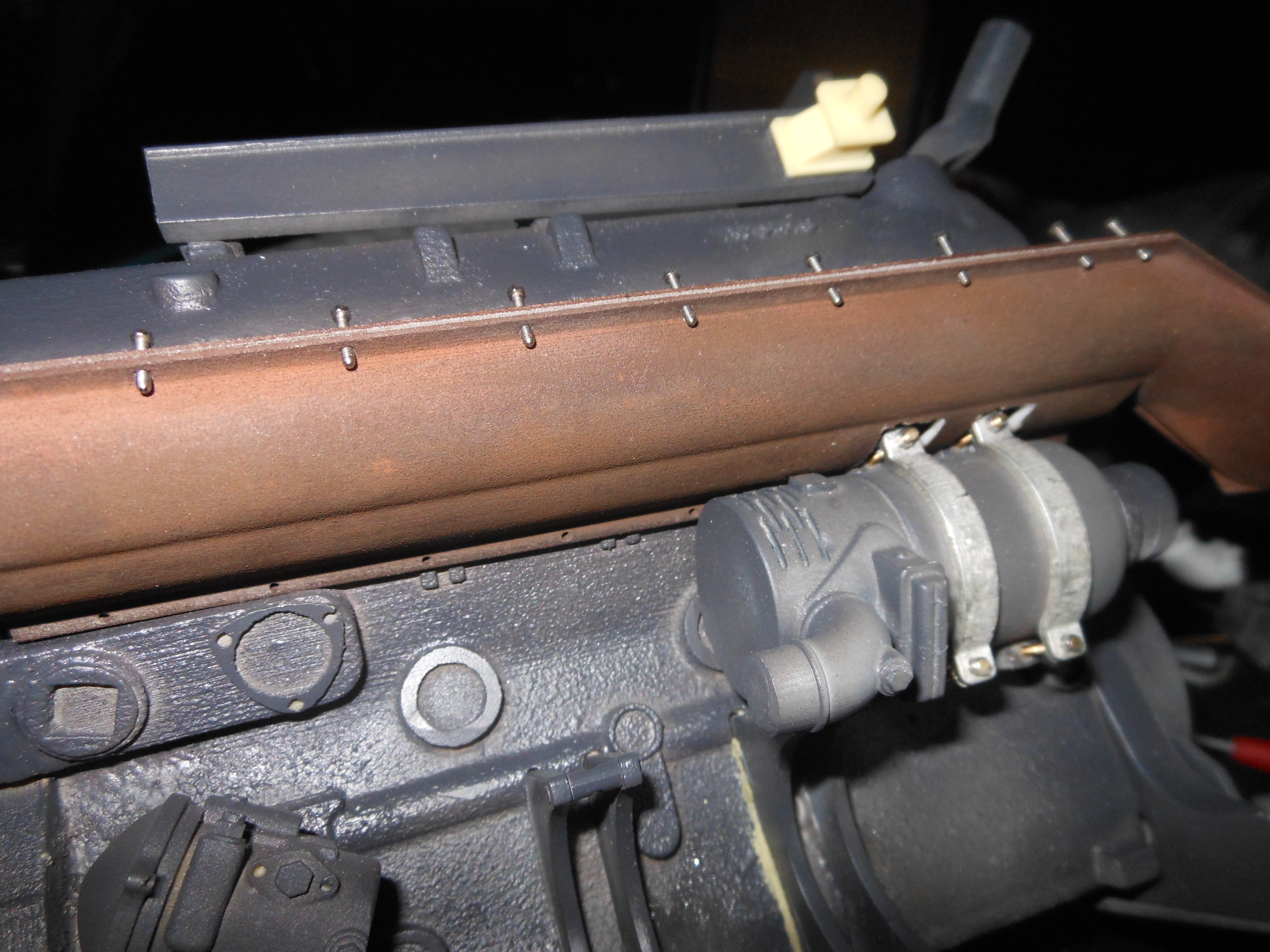

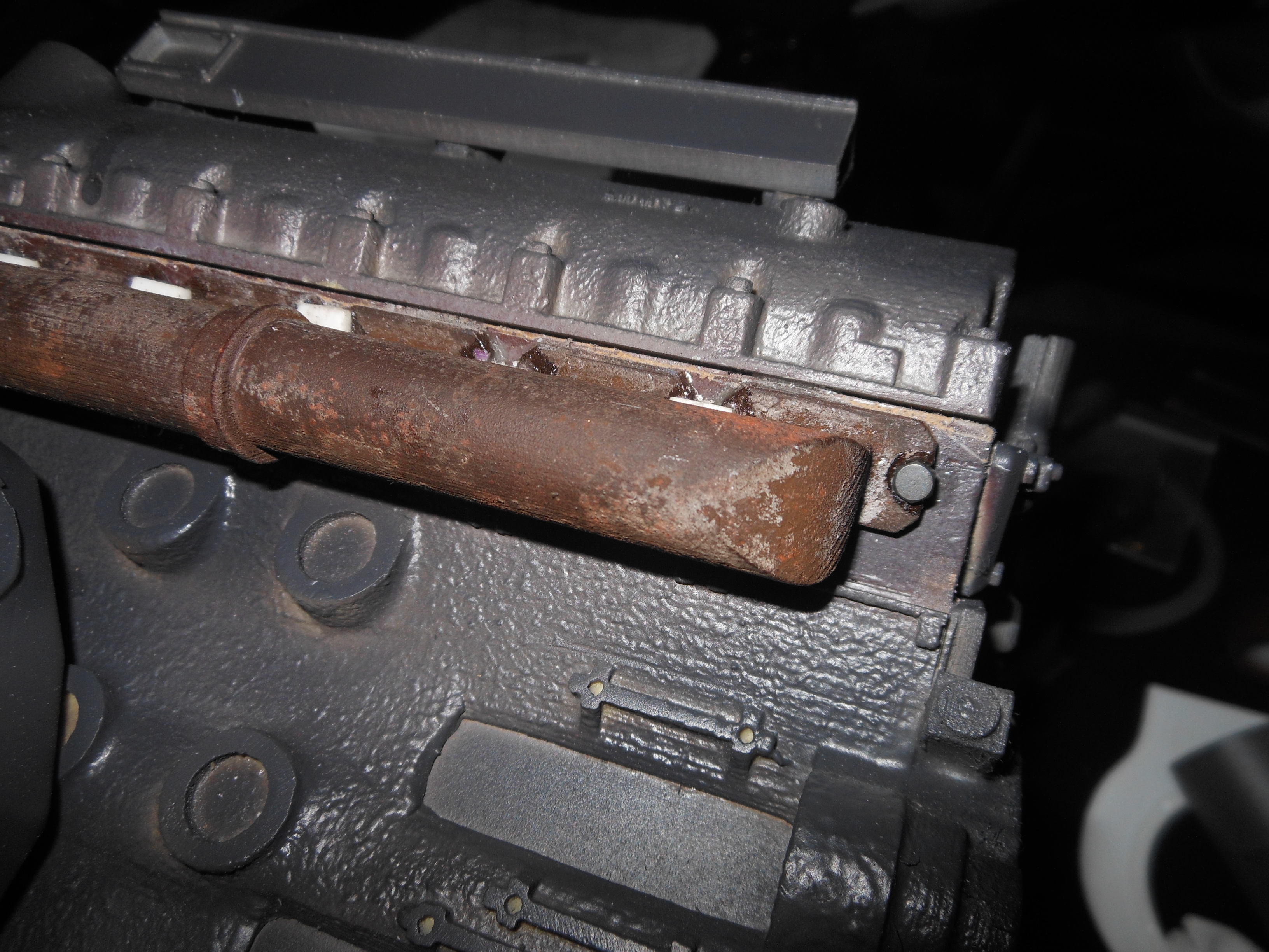

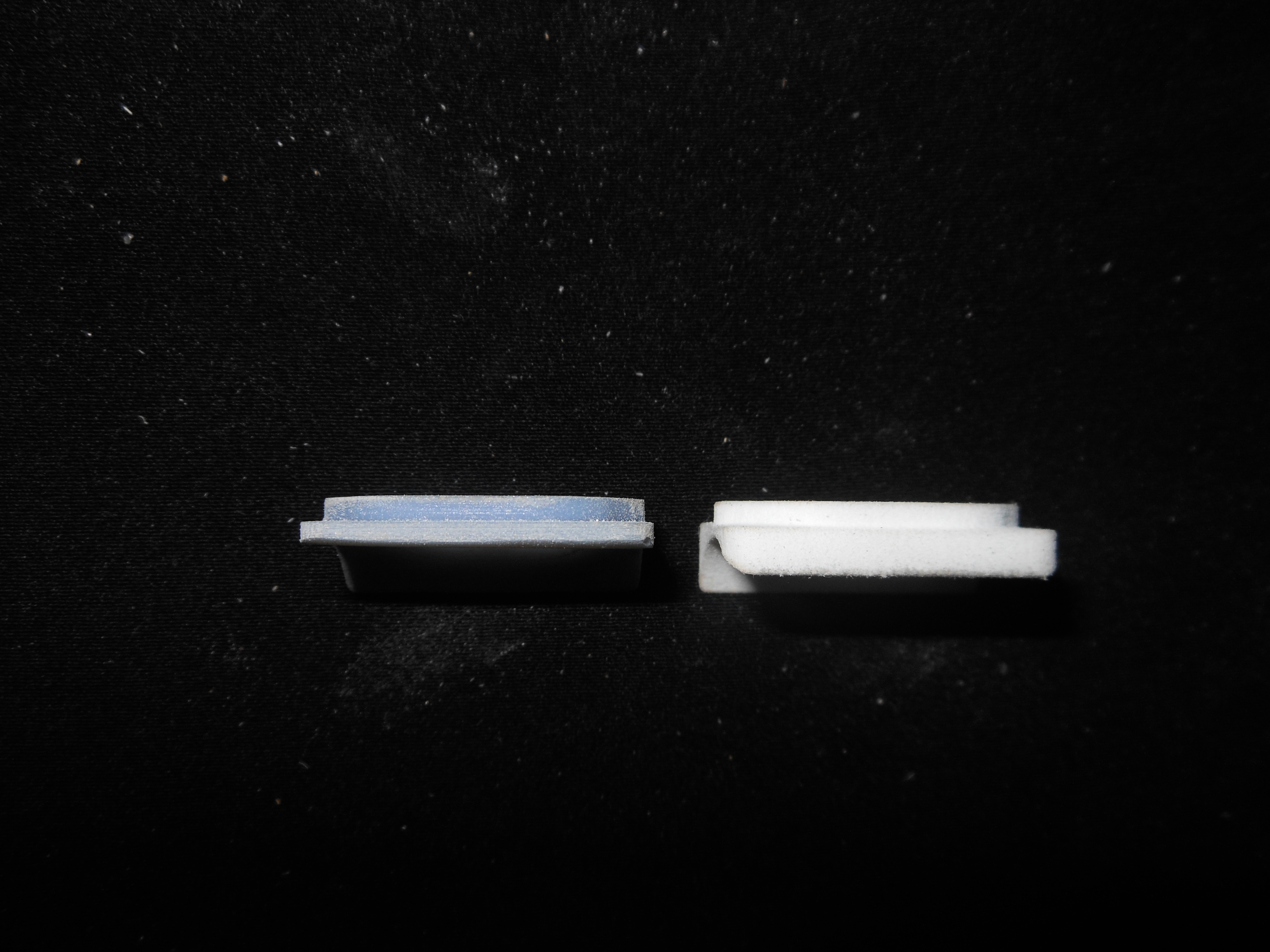

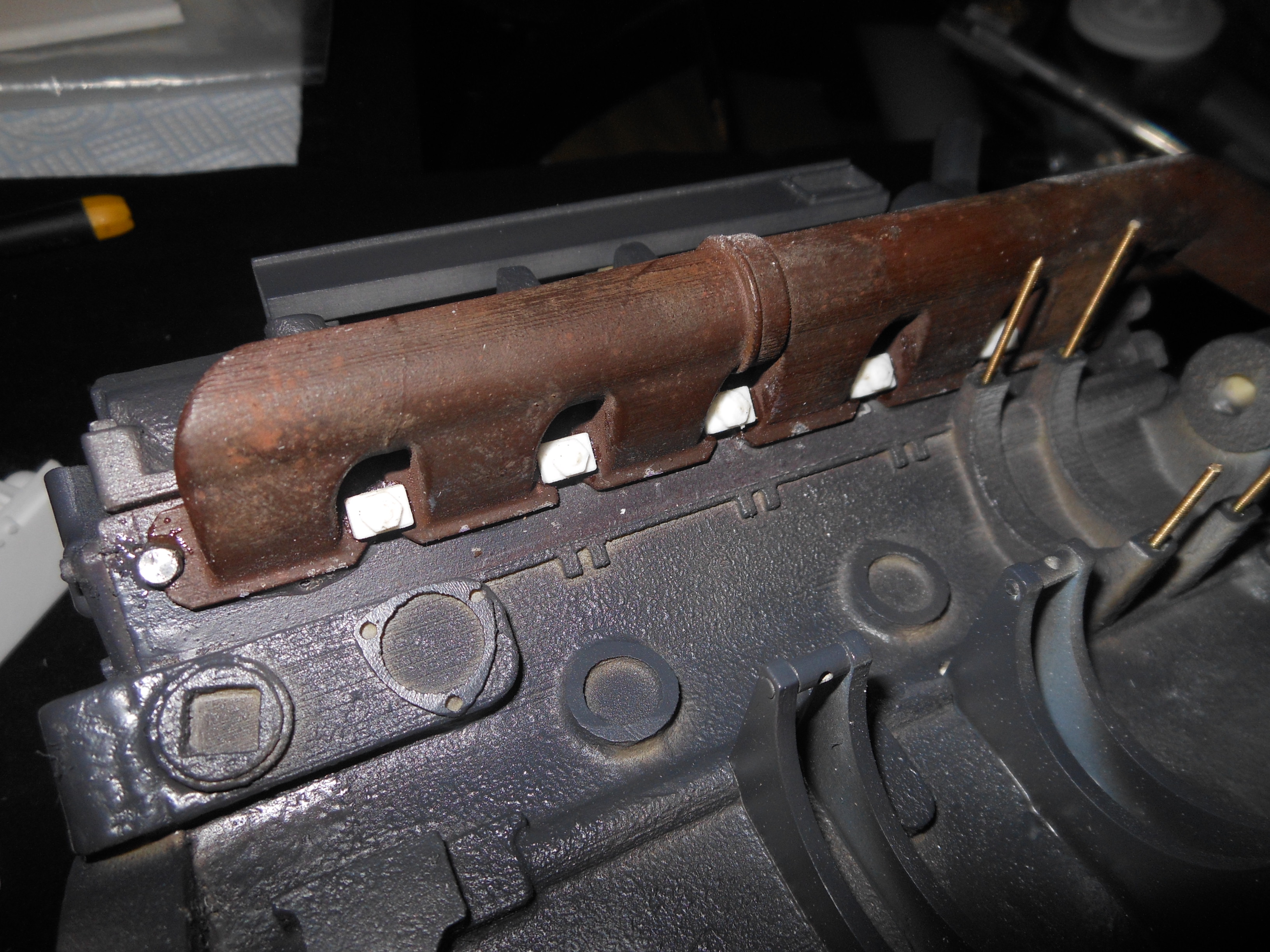

Before placing the drain pipes, I preferred to paint them. Before joining them, check that everything is aligned, check that the false support brackets enter the holes and housings. Also check that the covers have space to slide both above and below. Before gluing, test the entire assembly. Pay attention to the covers, they are thin, therefore a little fragile. Before putting the covers on, put the pipe ends.
The lower left cover must be cut in this way.
Ivano Costantini
Posts: 533

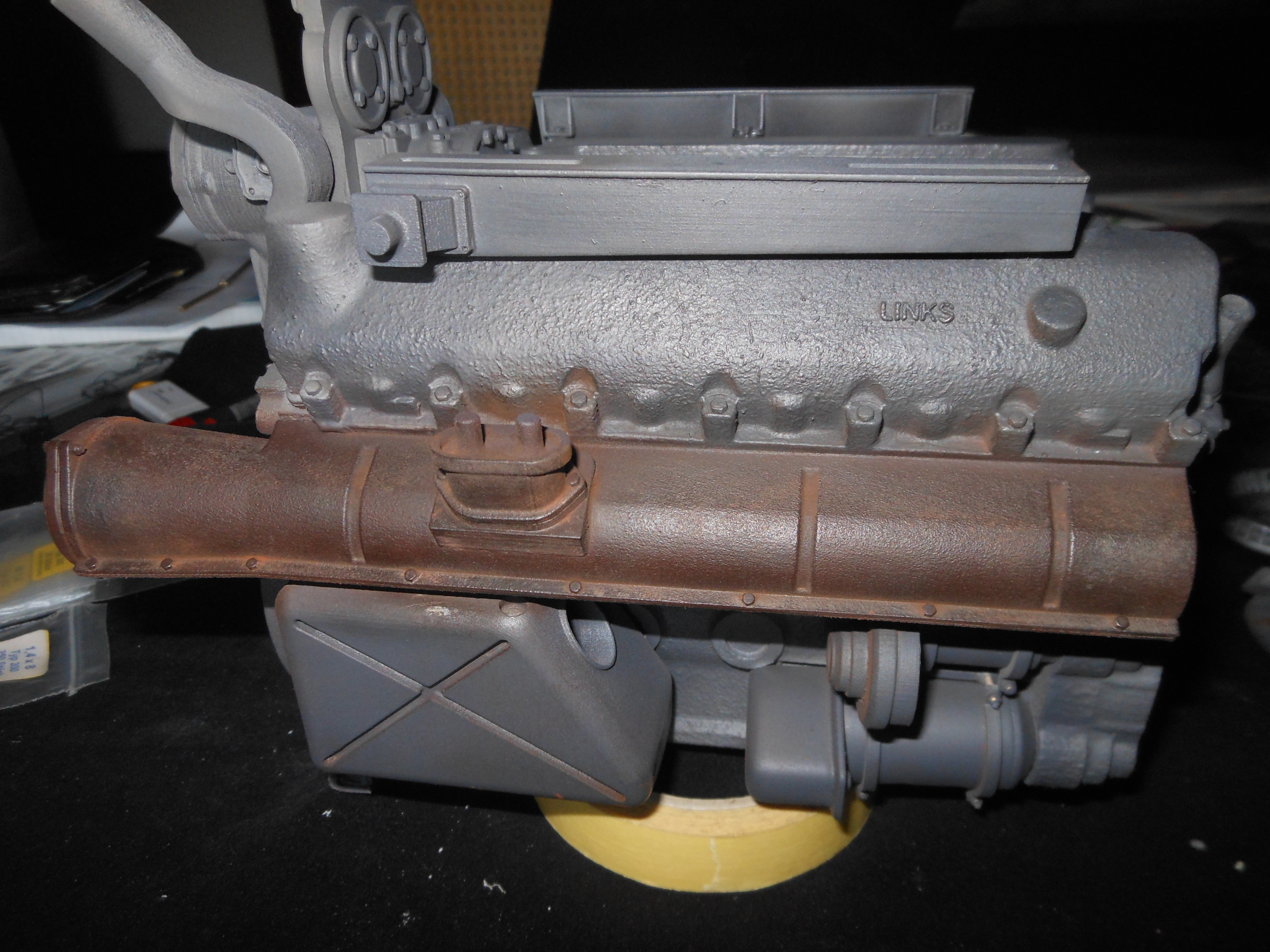

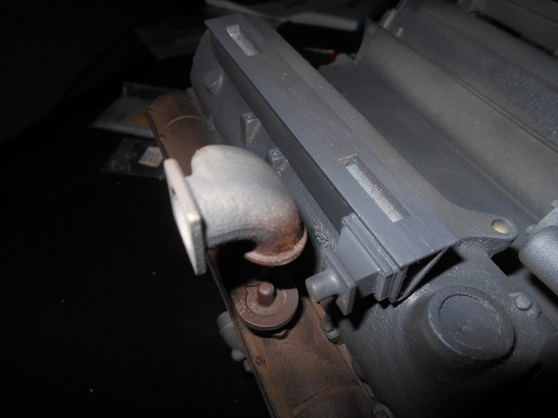

Left exhaust, I don't have the tank, therefore I don't know the length of the vertical pipes, each one will have to cut them as required by the engine compartment.
Ivano Costantini
Posts: 533

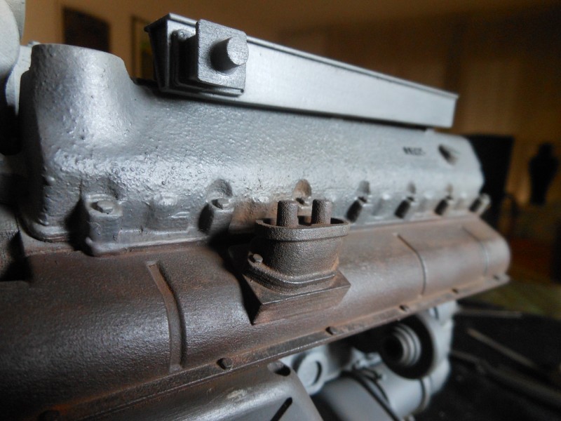

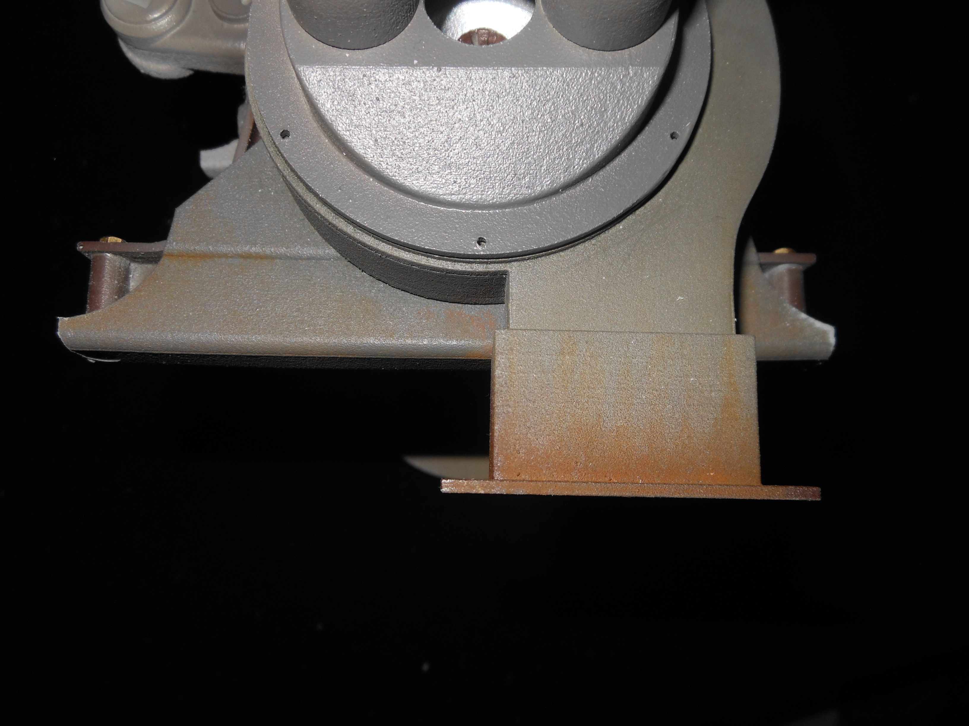

The right drain is also positioned.
It is necessary to slightly lower the upper side from the flange.

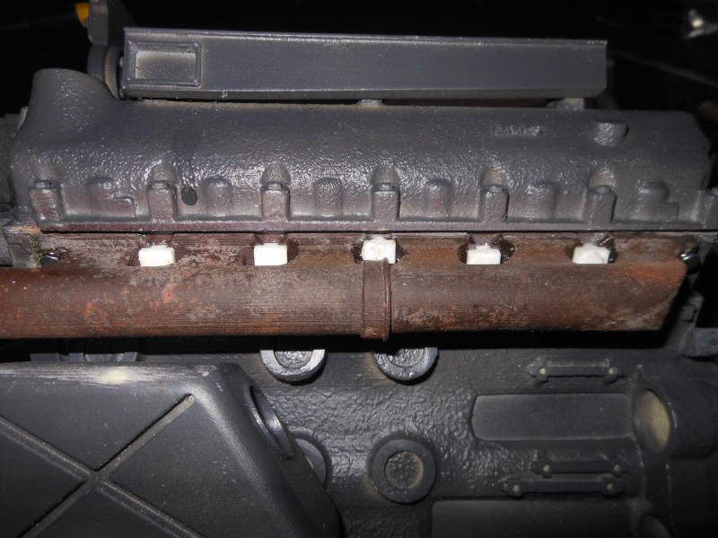

Ivano Costantini
Posts: 533

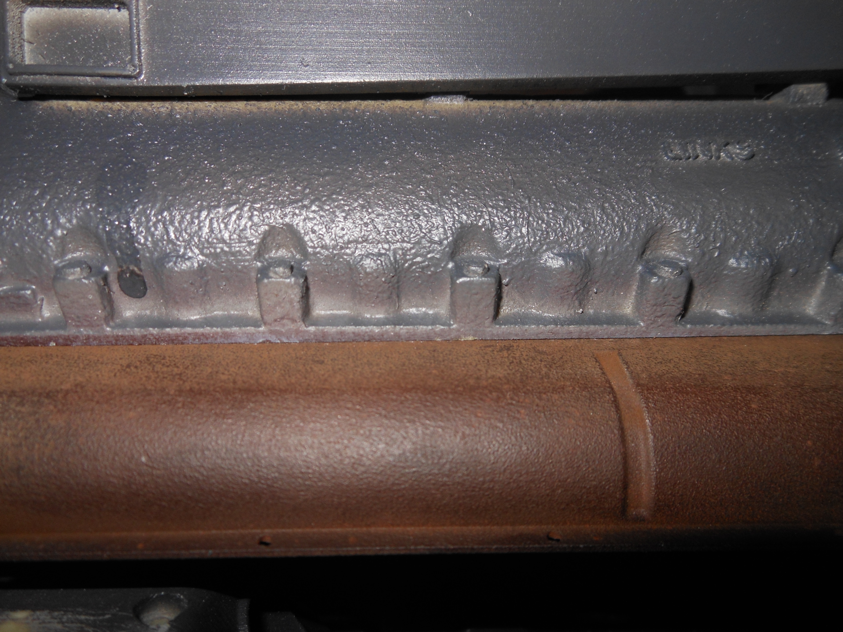

Completed and painted with wear and aging.
How do they seem to you?
