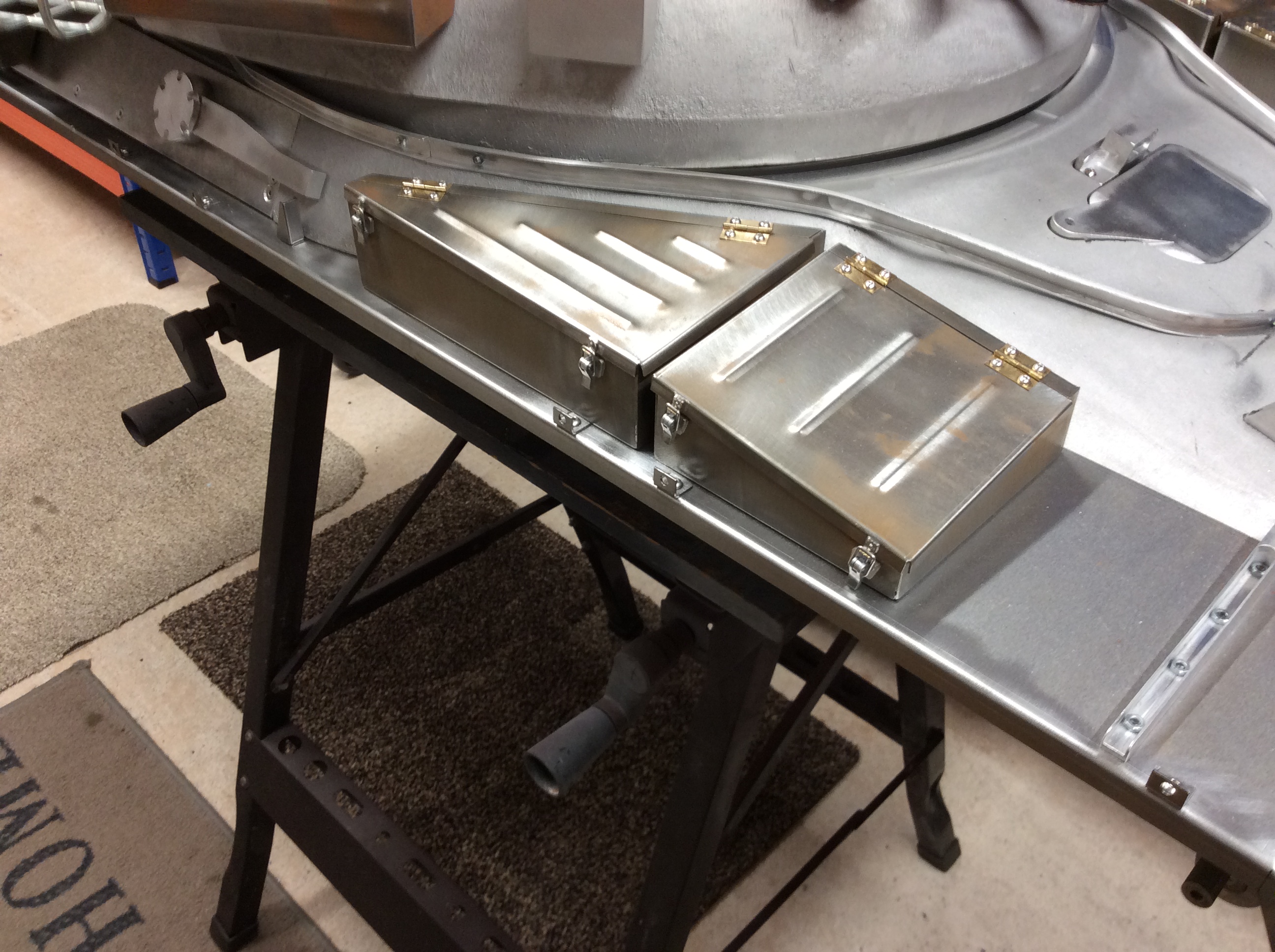

Hi a bit more progress on the Chieftain. I thought that I would try soft soldering the mudguards/fenders and I am quite pleased with the results. Plus a few pics of progress elsewhere. It’s coming along slowly but surely.

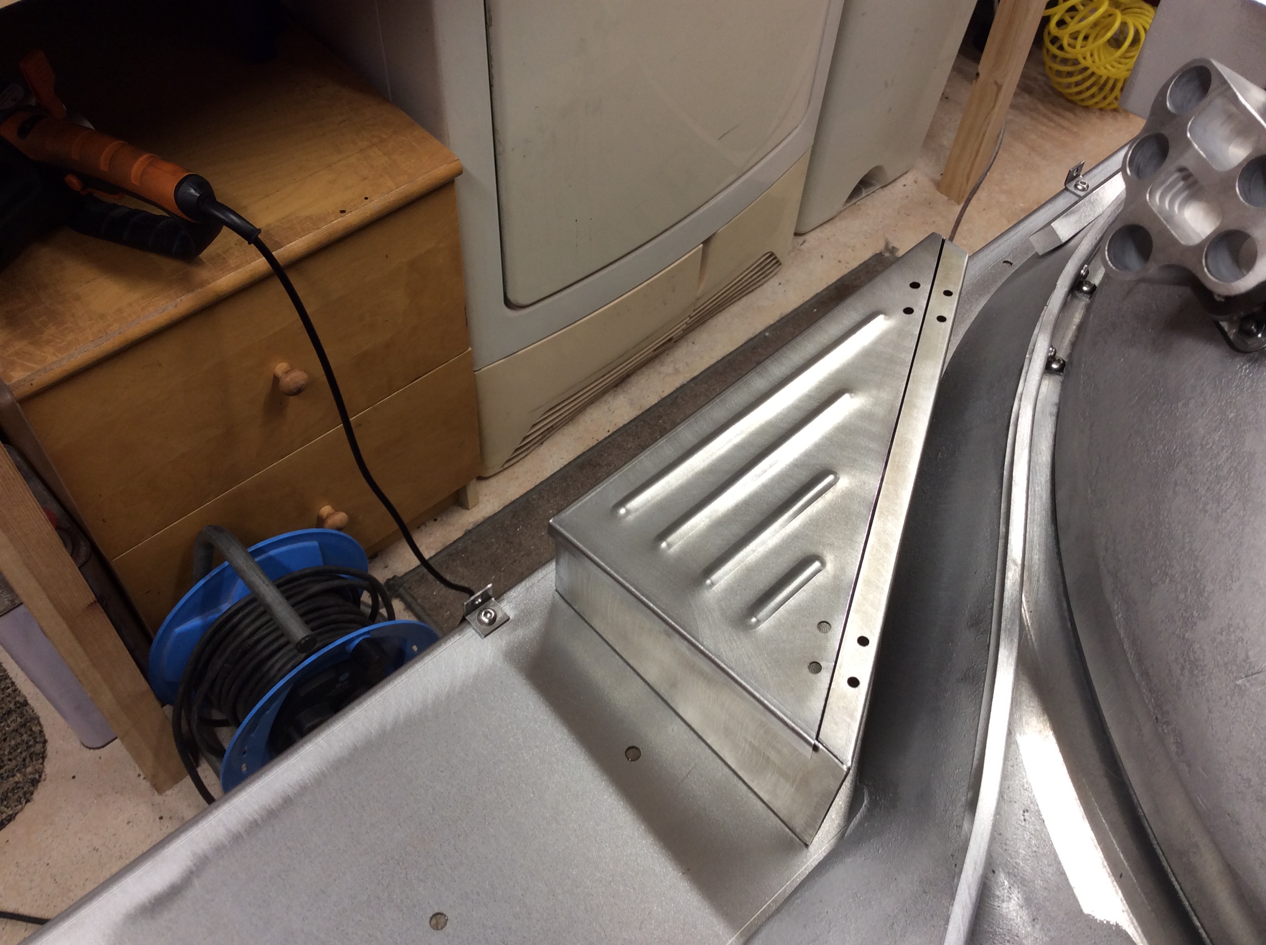

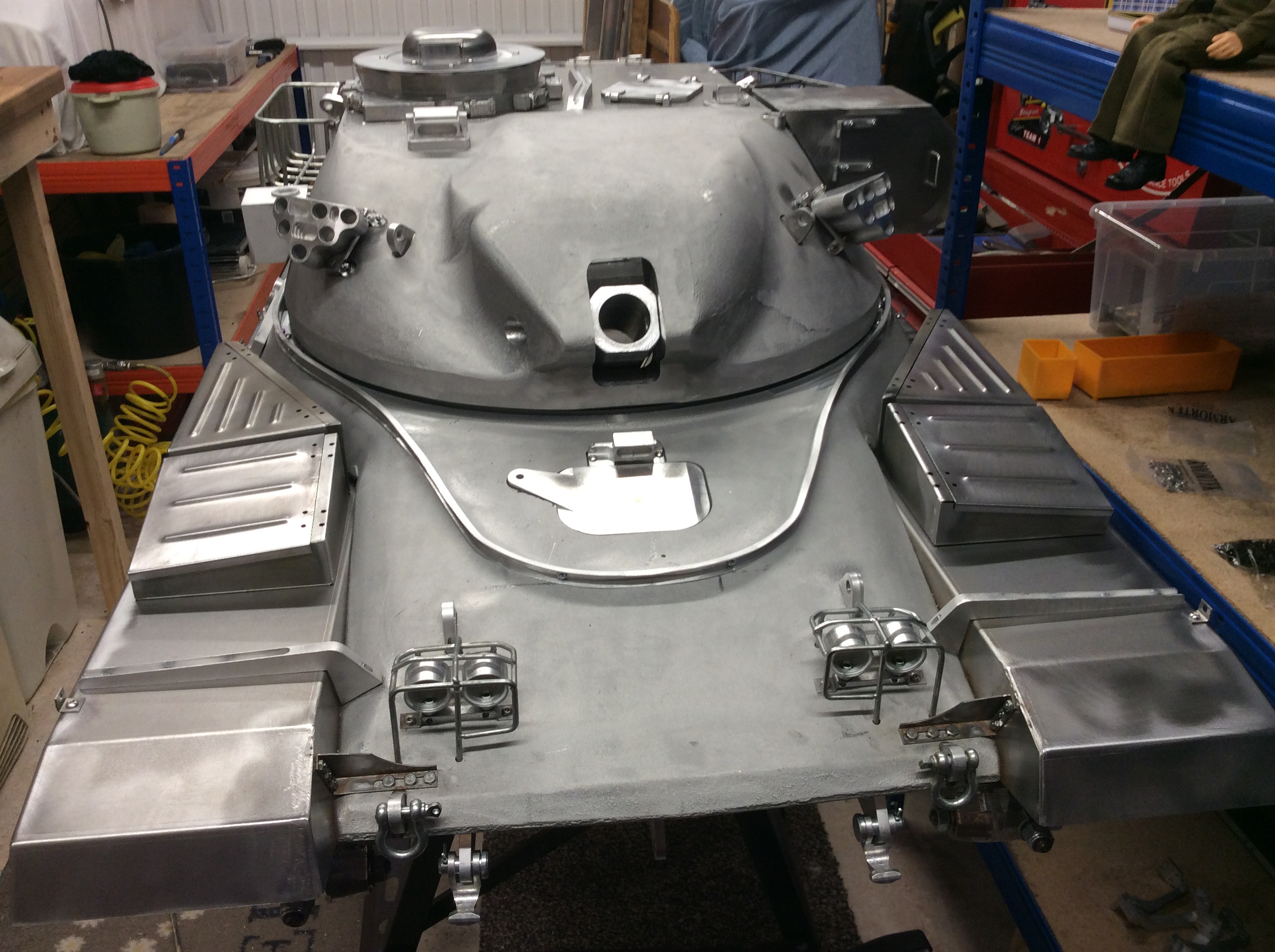

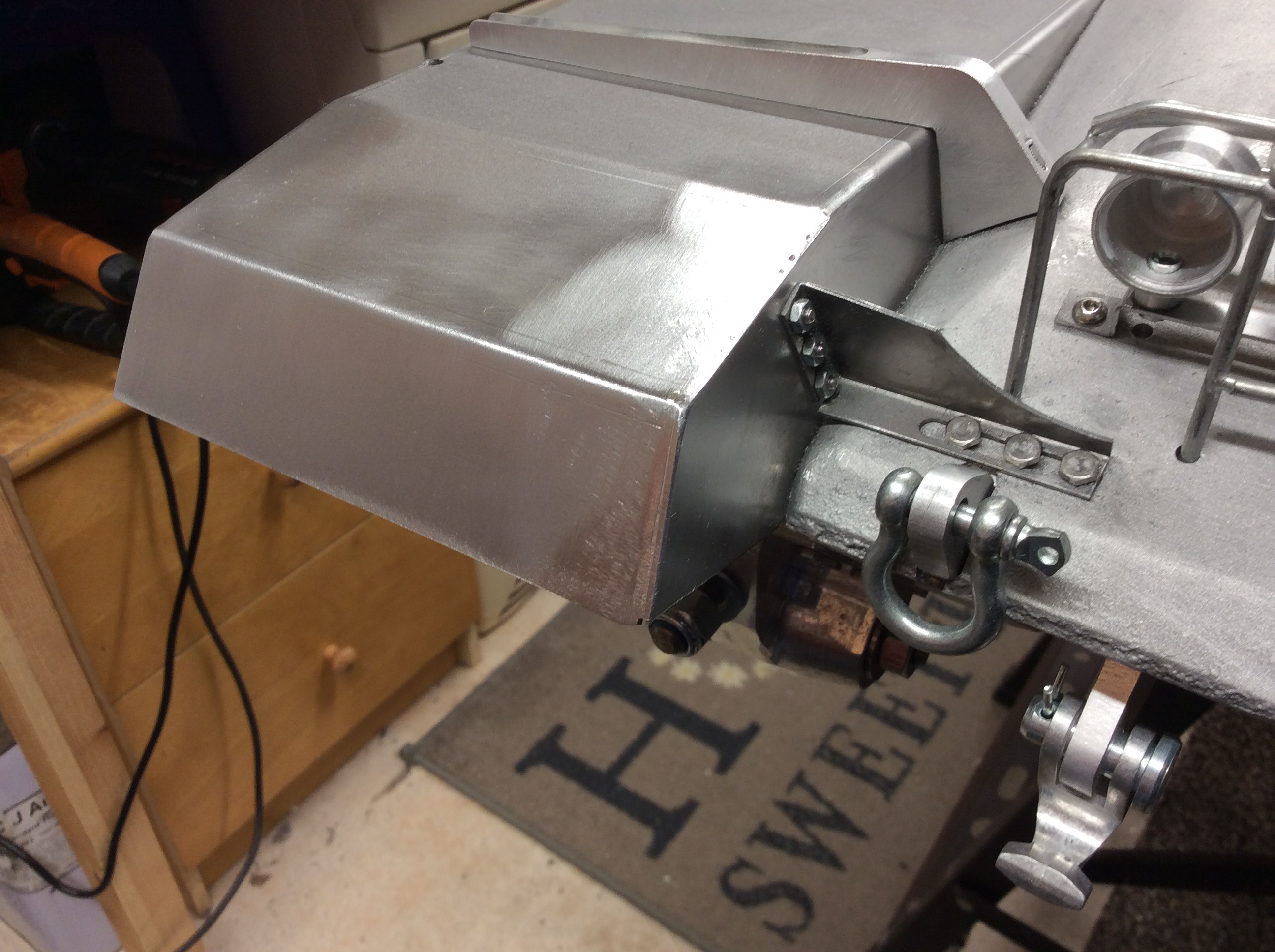

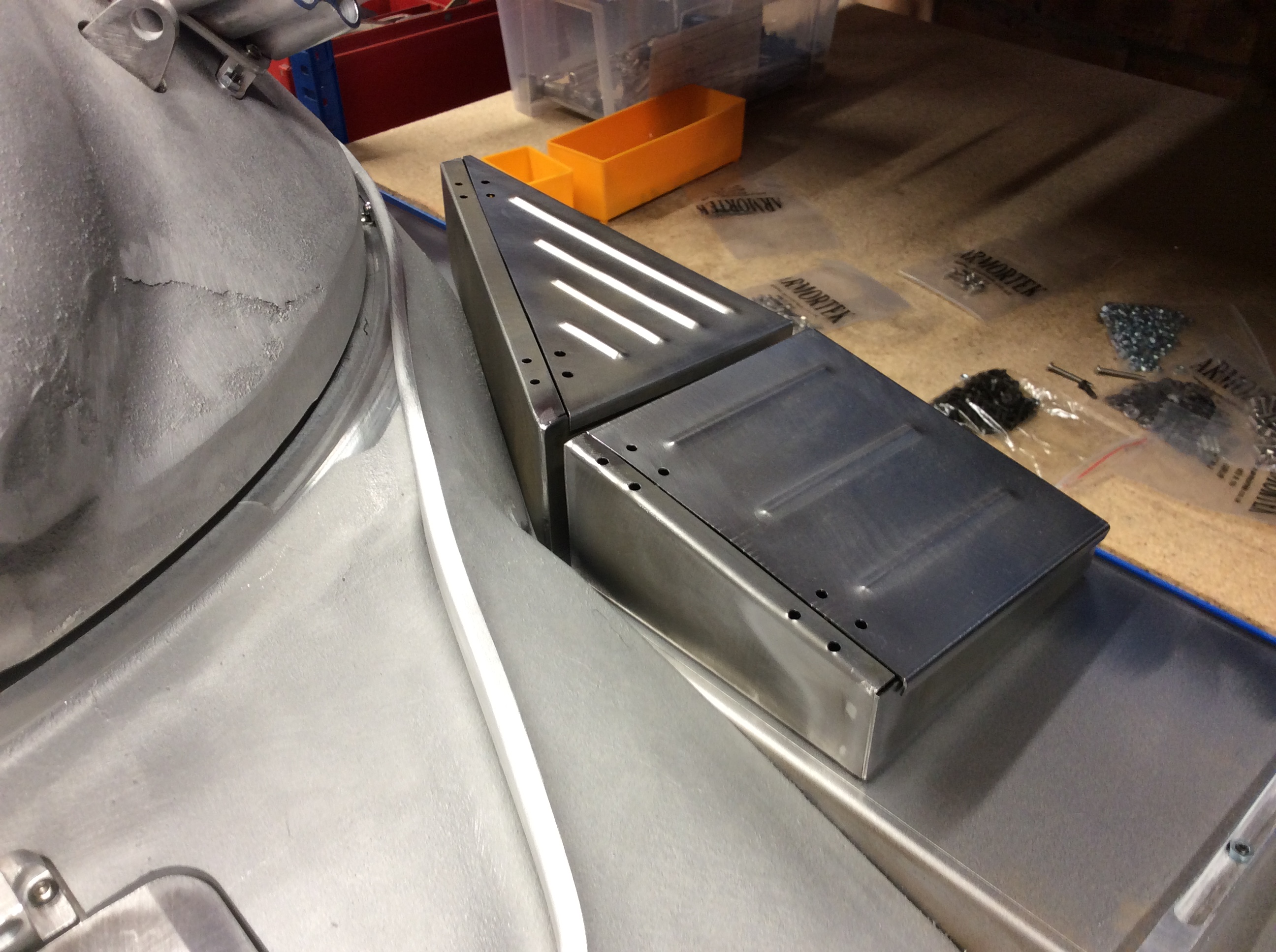

Spent all day today modifying the triangular bins by removing the odd end piece and then soldering all of the joints. Also added sone more detailing to the rear deck and turret. Getting the knack of soldering the steel bins now! Also added the wading strip, man that took some fettling but got there in the end I think!

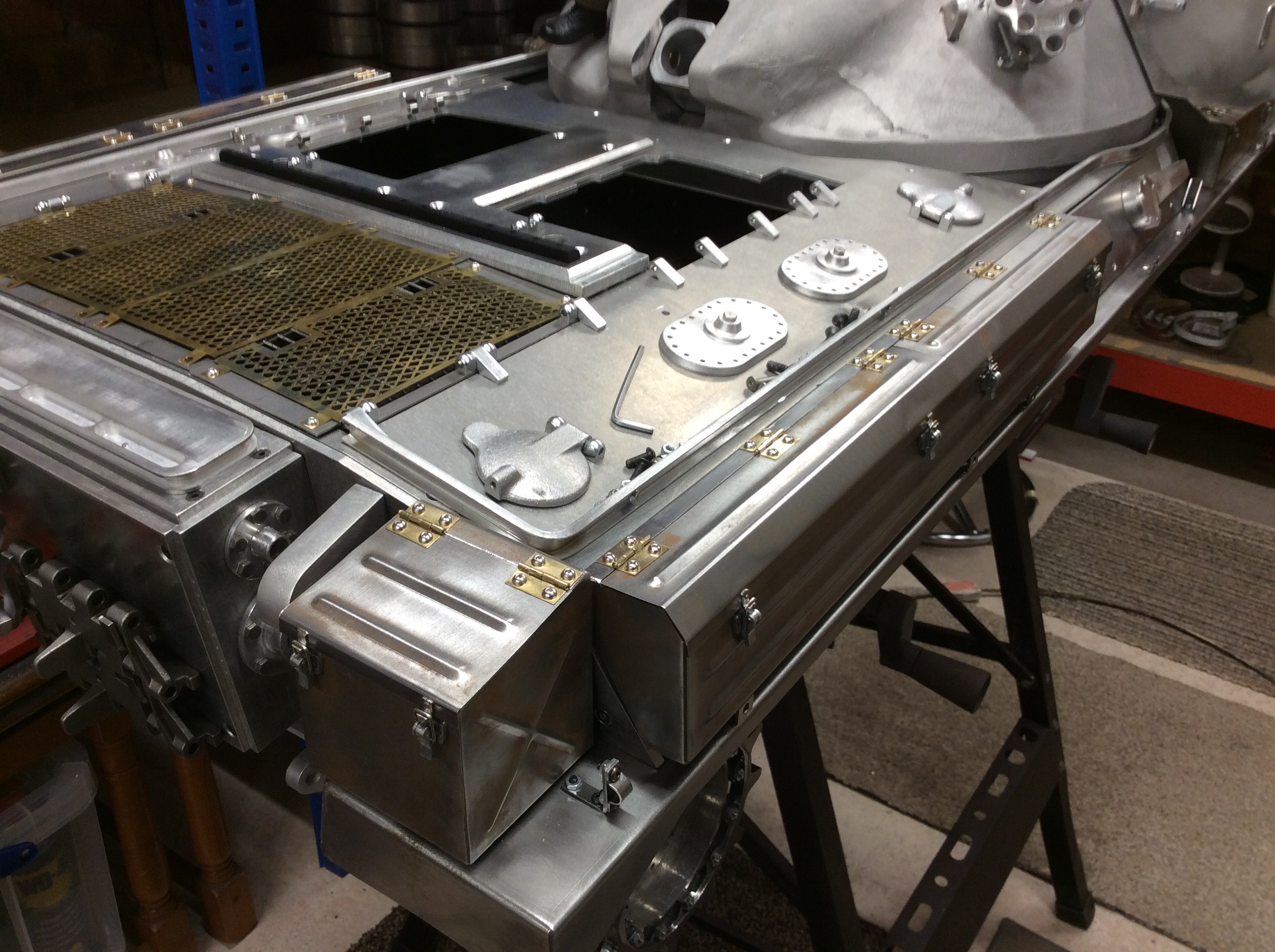

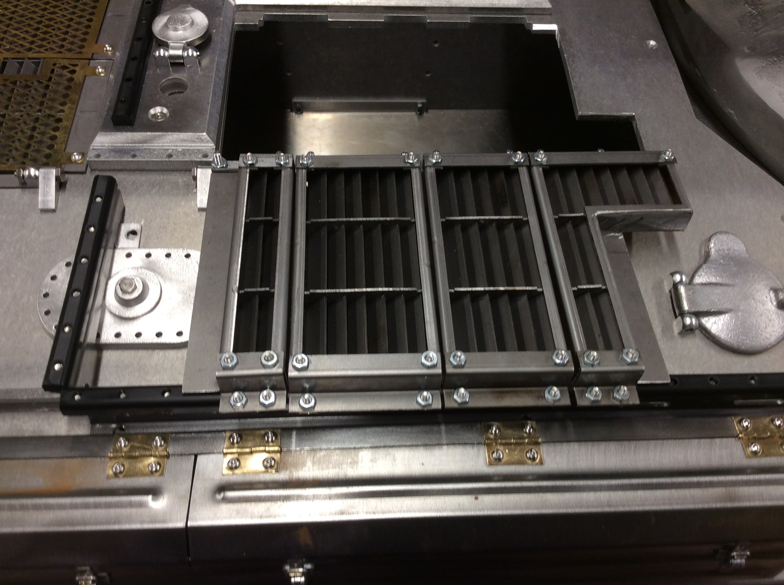

A bit more progress made a start on the rear deck engine vents. A bit fiddly but getting there. Going to make the rear middle two such that they just lift on and off as I can’t get enough clearance for the LH and RH vents to open with the middle ones still in place. Plus it will give easier access to the internals.

Spent all day working on the rear engine deck vents and hinges in order to ensure that they all operate with clearance and without clashing. The hinges needed a little fettling in order to ensure smooth operation. Also modified the smaller filler caps to make them operational.

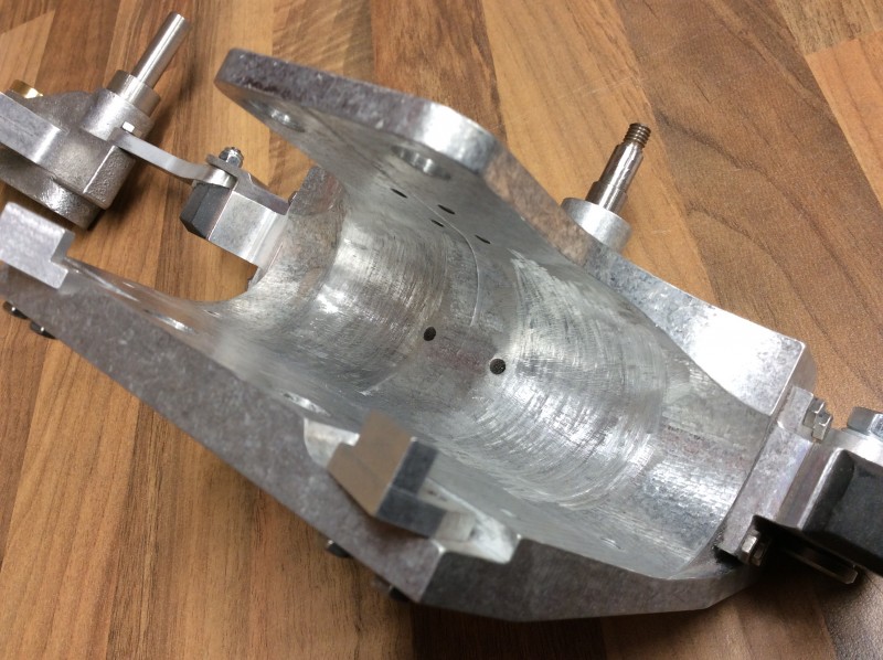

Hard work this the mod to the suspension carriers to enable full travel. You need to remove around 3mm good job I have a power file.
