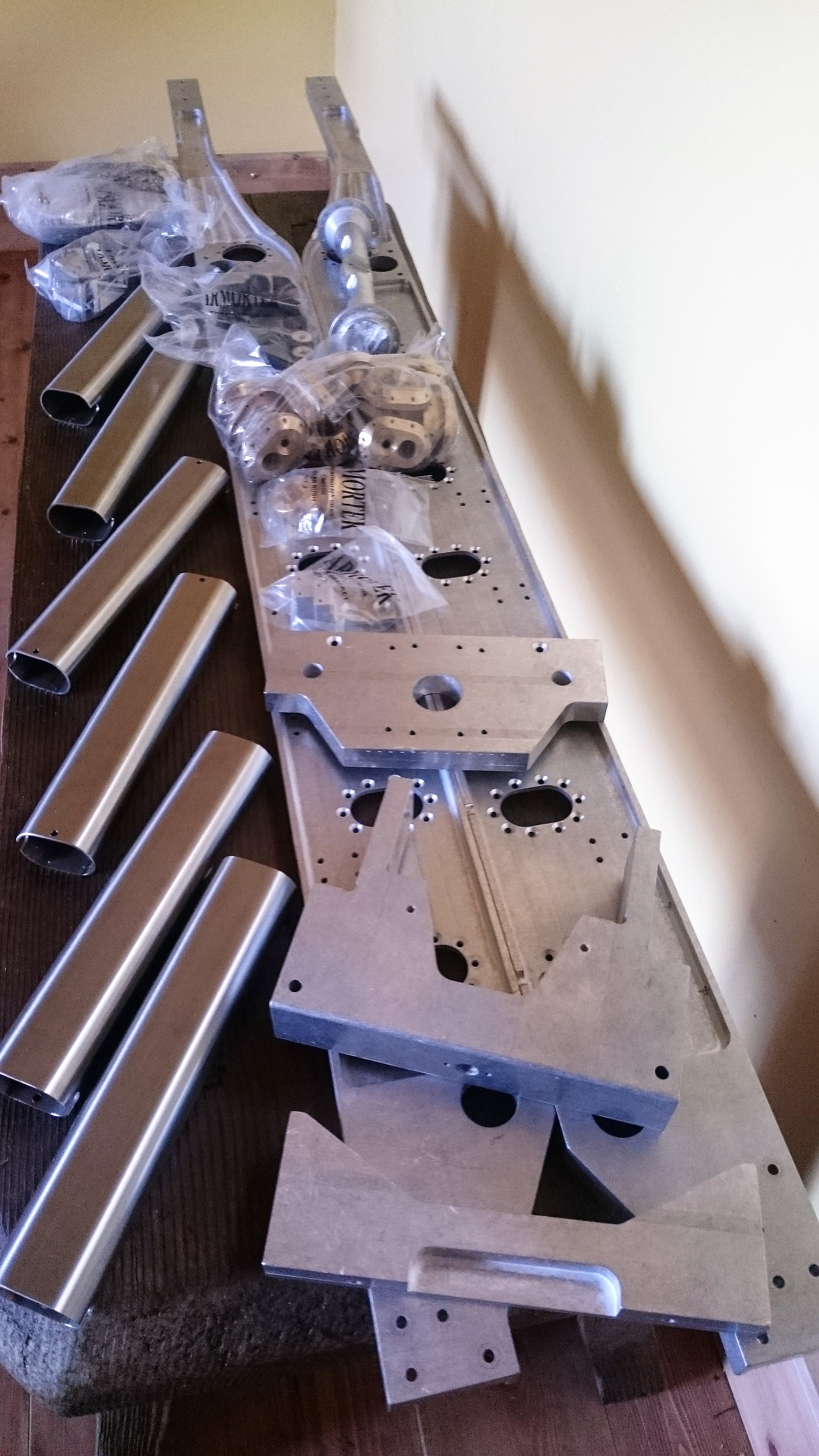

I have picked all the parts for assembly page 1 and sorted all the fixings, if all goes well I will assemble this little lot tomorrow, Im not sure whether the machining tool marks on the angled areas of the chassis ladders will show or not yet so this will be a good look see.
The finish on the parts is very good

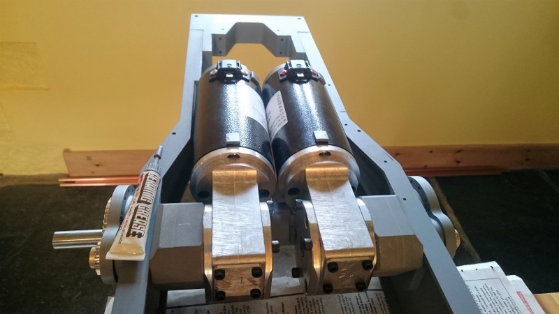

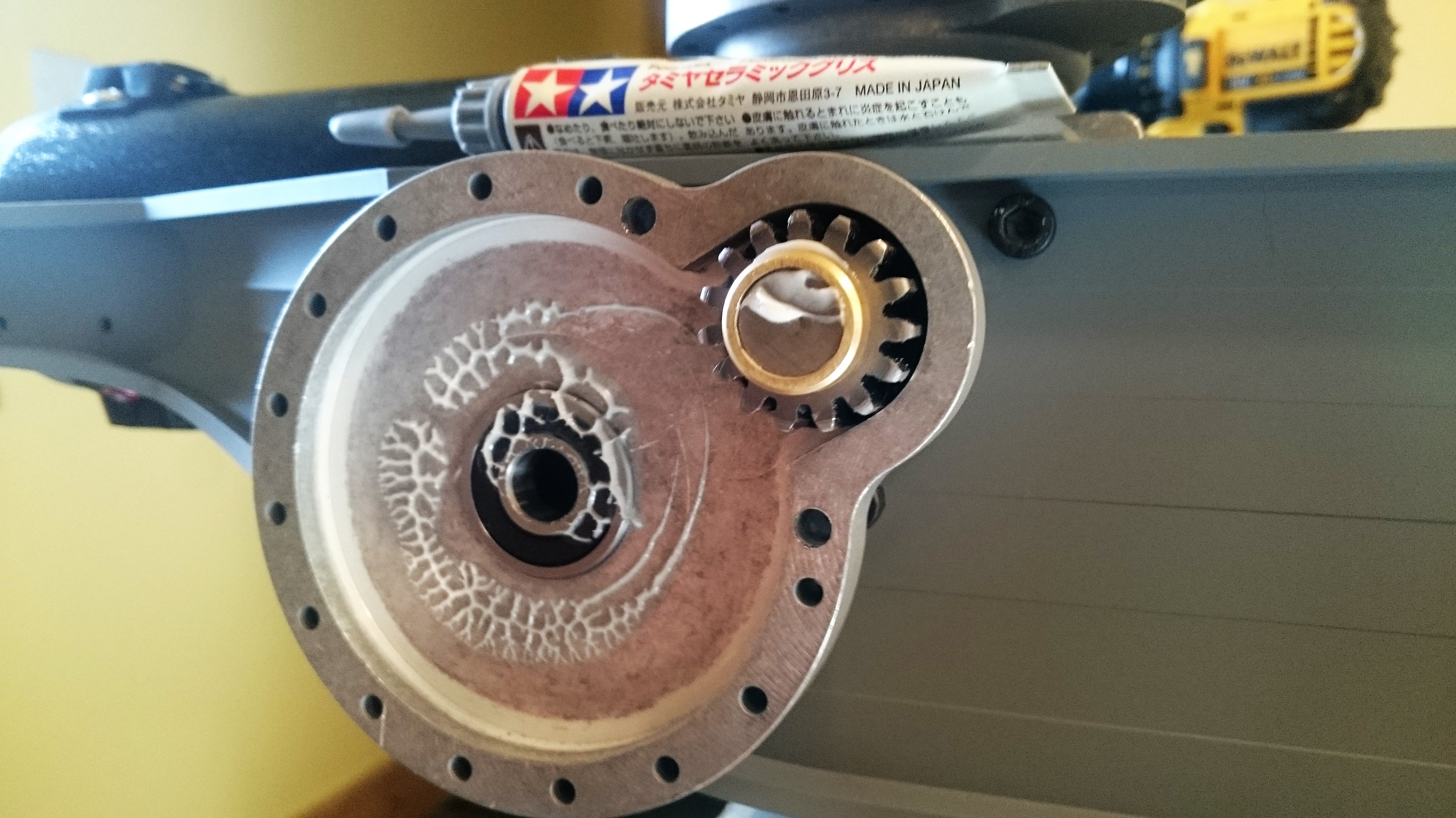

Todays work, all etched primed, gears greased with grease gaskets, it's all very tight but nicely thought out,
Please note, the large chassis end piece shown here is up the wrong way, the m3 hole on the side needs to be towards the top, this being part of the fender fixing

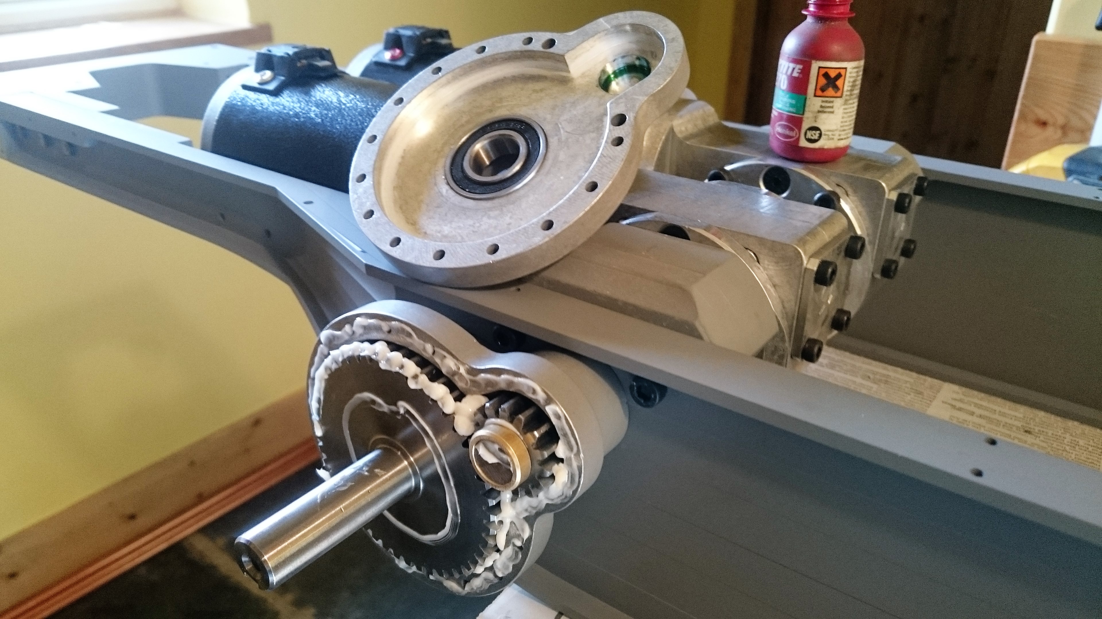

how it works with the screw tithening from the front cros axel under the gears? - Its a bit tricky right?
Re: Phils Famo build
Hi florian, your quite right it's a bugger but so long as you do it in the right order its not to bad, Armortek give good advice but leave a lot to work out for yourself, which I think is good as less is more, too many complicated instructions can confuse idiots like me! I used big HT cap heads to bolt the motors in place where Armortek use button heads, the latter giving you a bit more room to squeeze the motor and gearbox in position, and I do mean squeeze because there isn't much room. Ive said it before, Mr Mark is a clever guy I couldn't in a month of Sundays have designed that lot. 8)

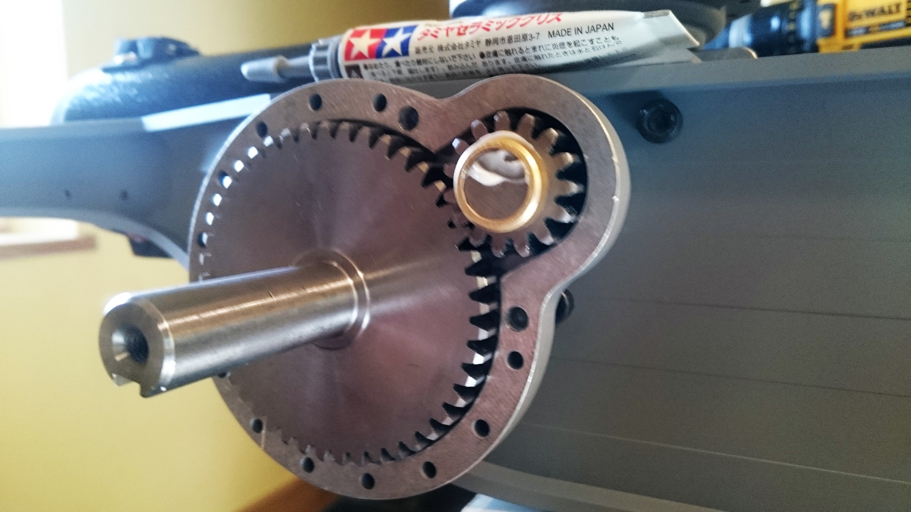

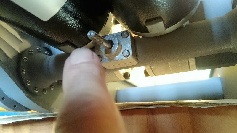

As usual all the photos are arse backwards, the thread locking of the idler shaft.
Another exciting instalment of the Famo build, Im enjoying this build.
The idler thread needed tapping again as the shaft thread was particularly tight.

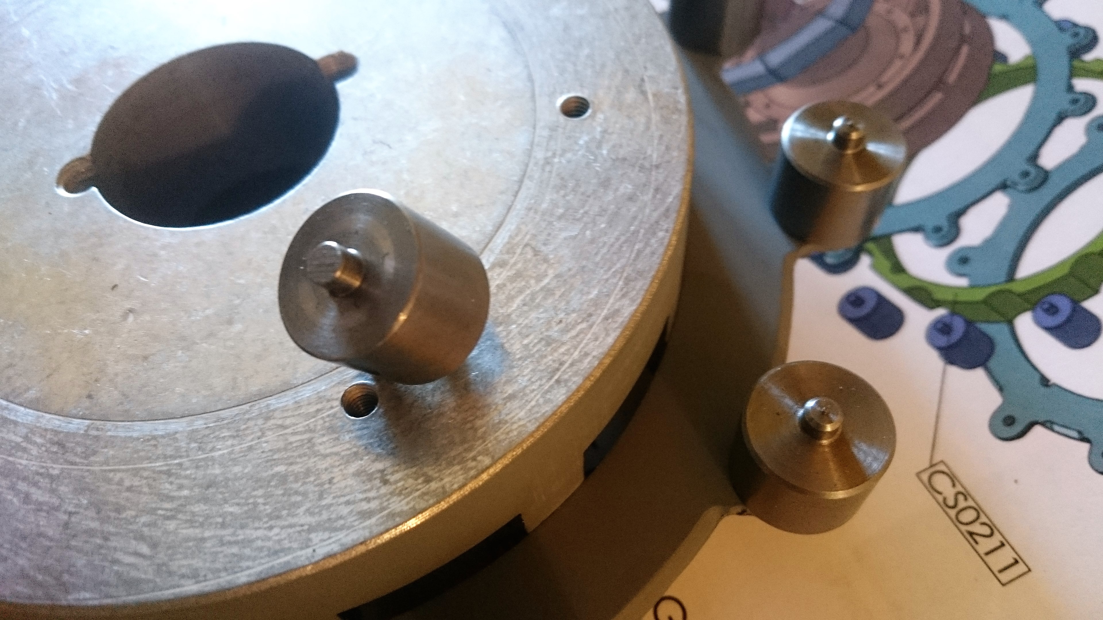

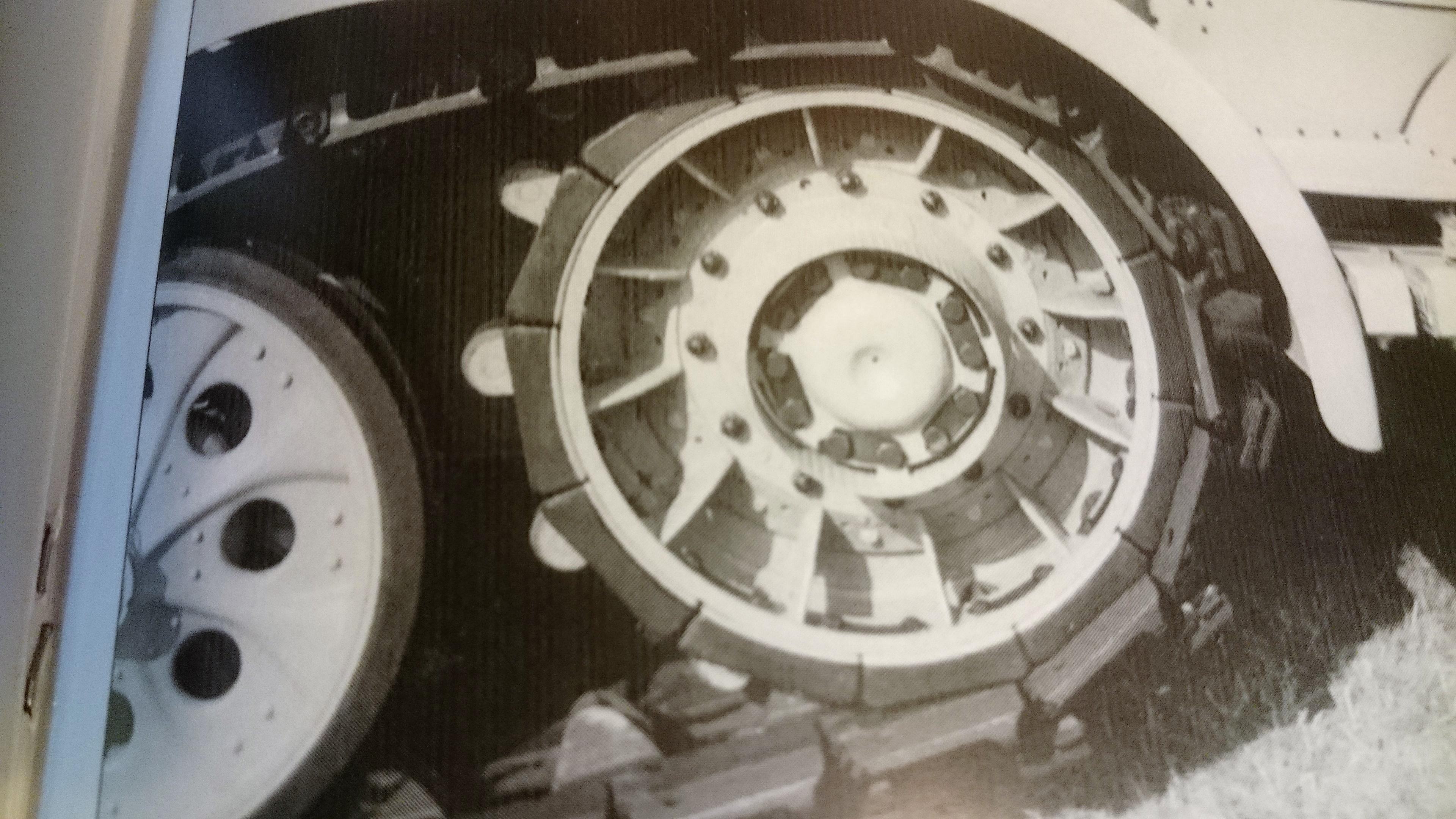

The sprocket rollers have a taper on one side to help locate the pins when pressing the pieces together, this needs to be taper on the inside, see original photo of the Famo
The square non taper side is showing like the original
