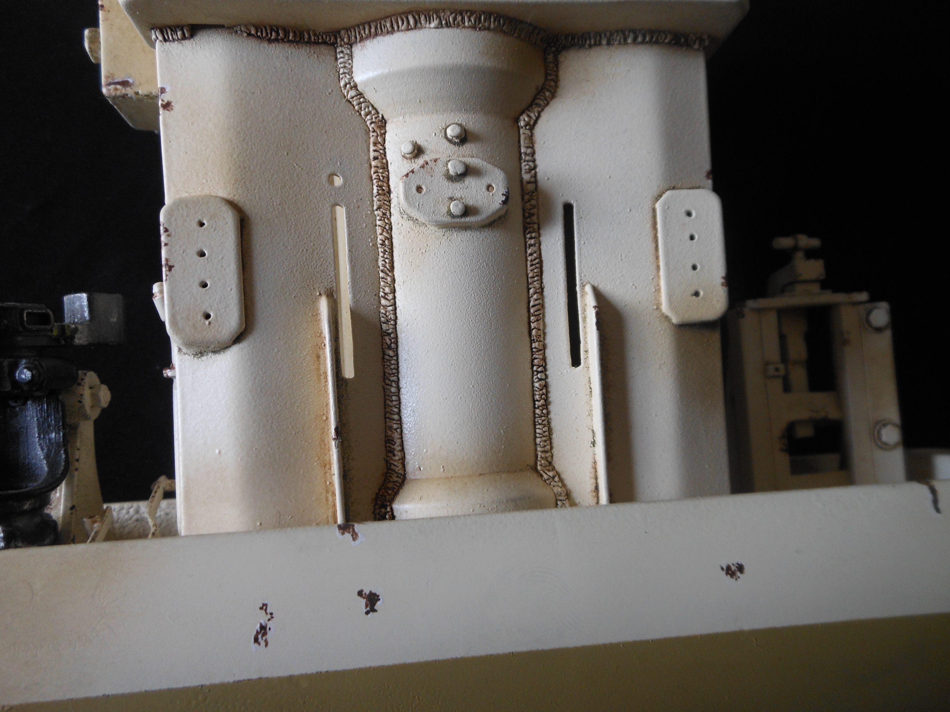

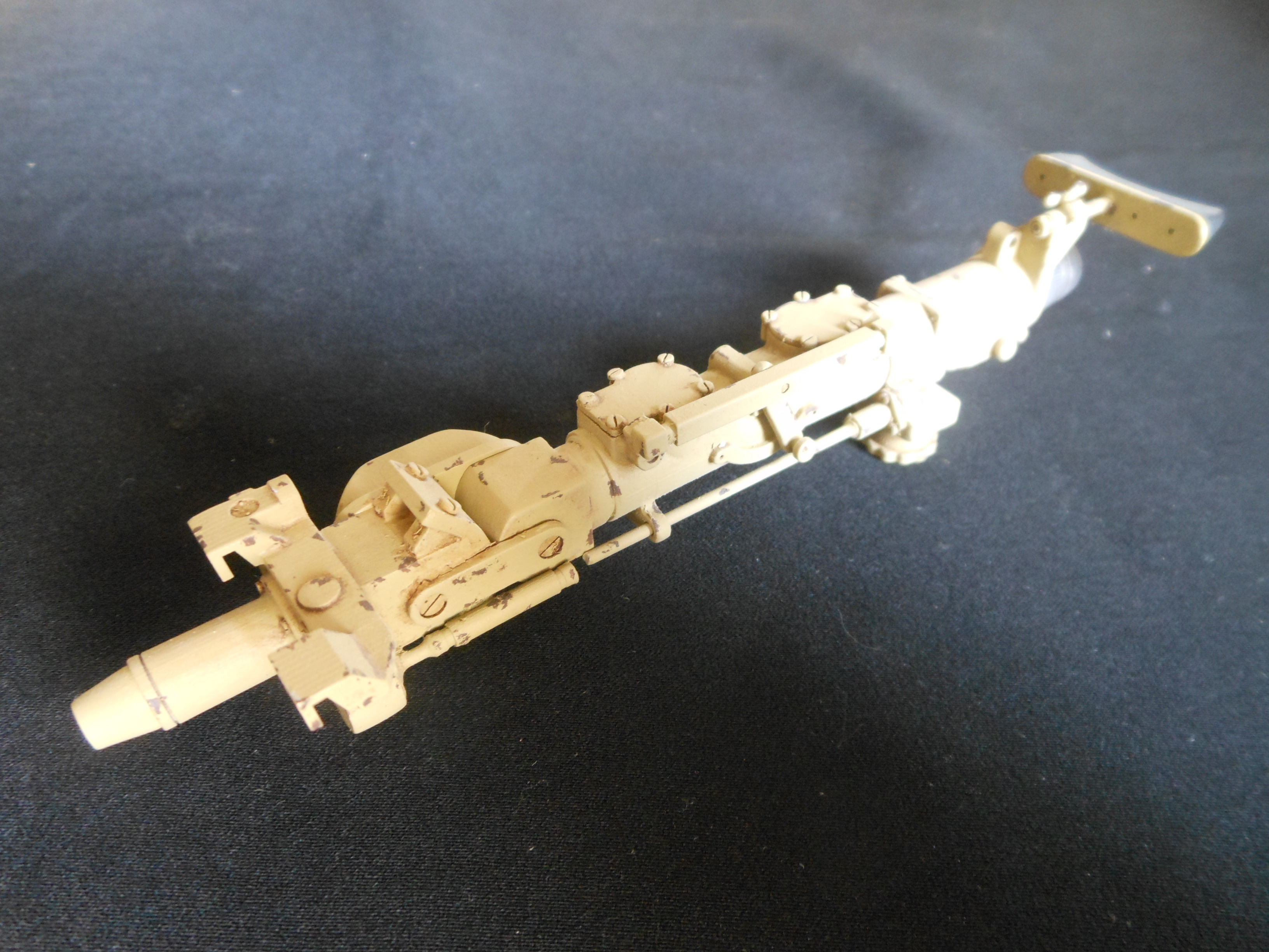

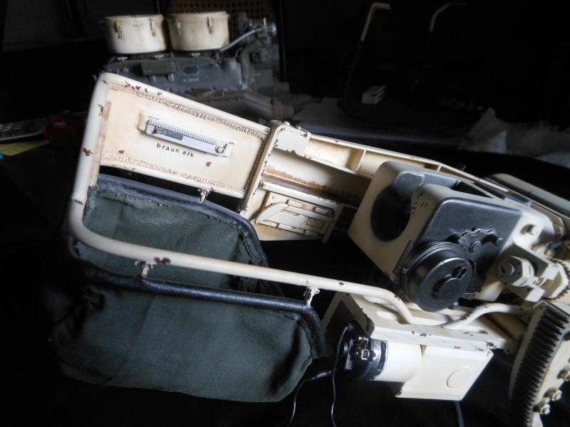

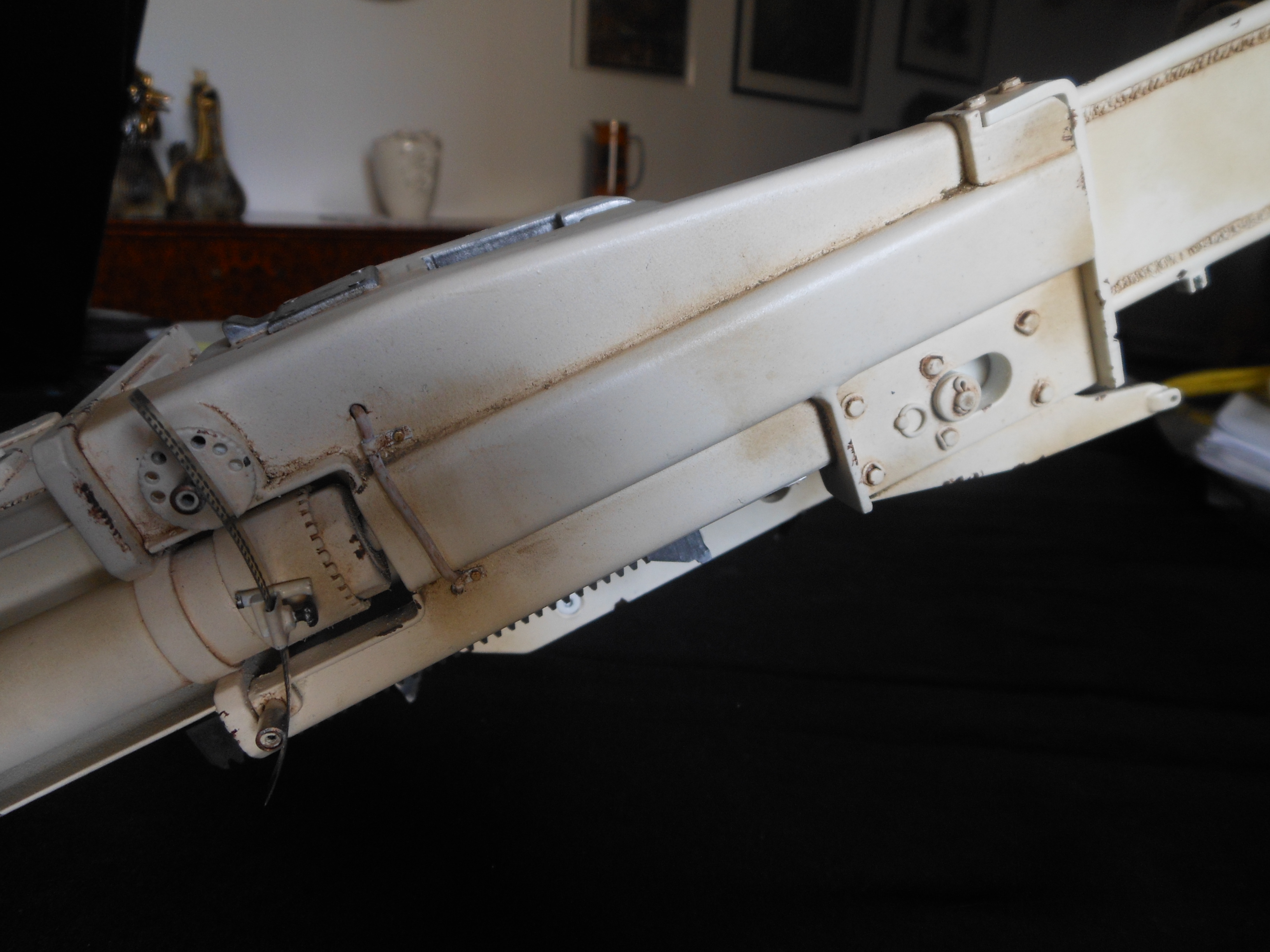

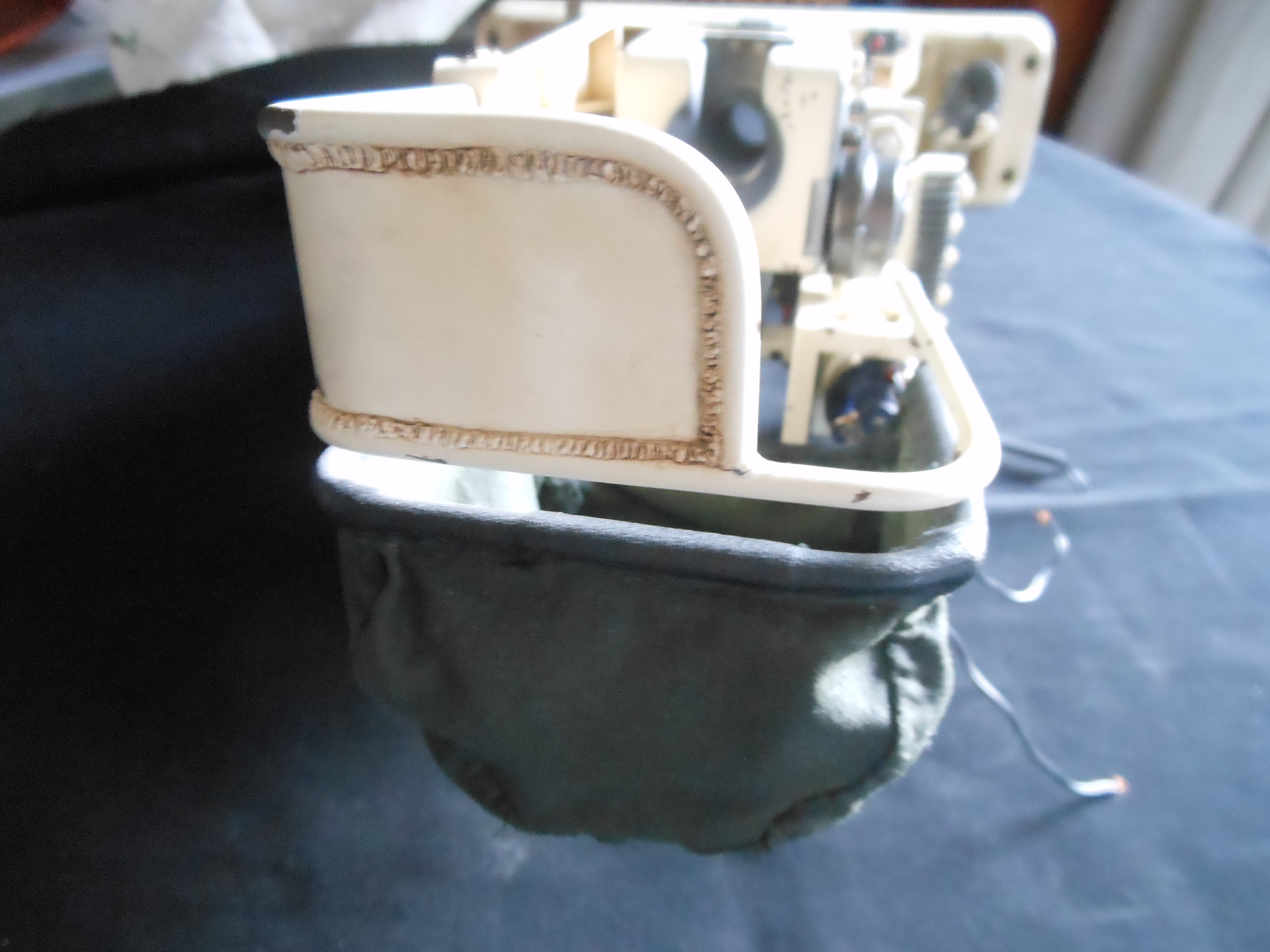

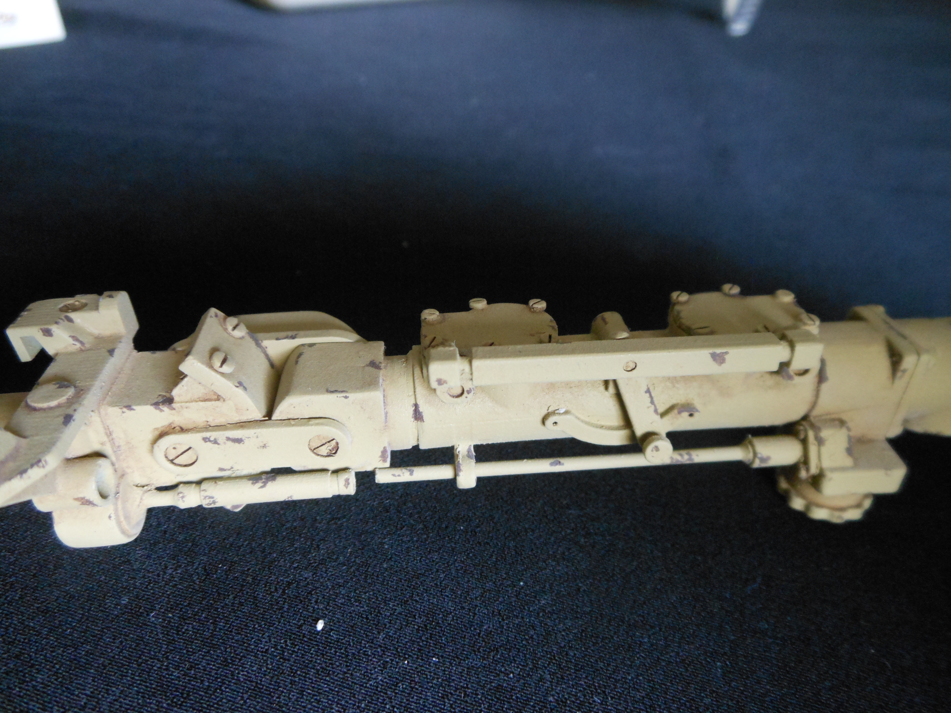

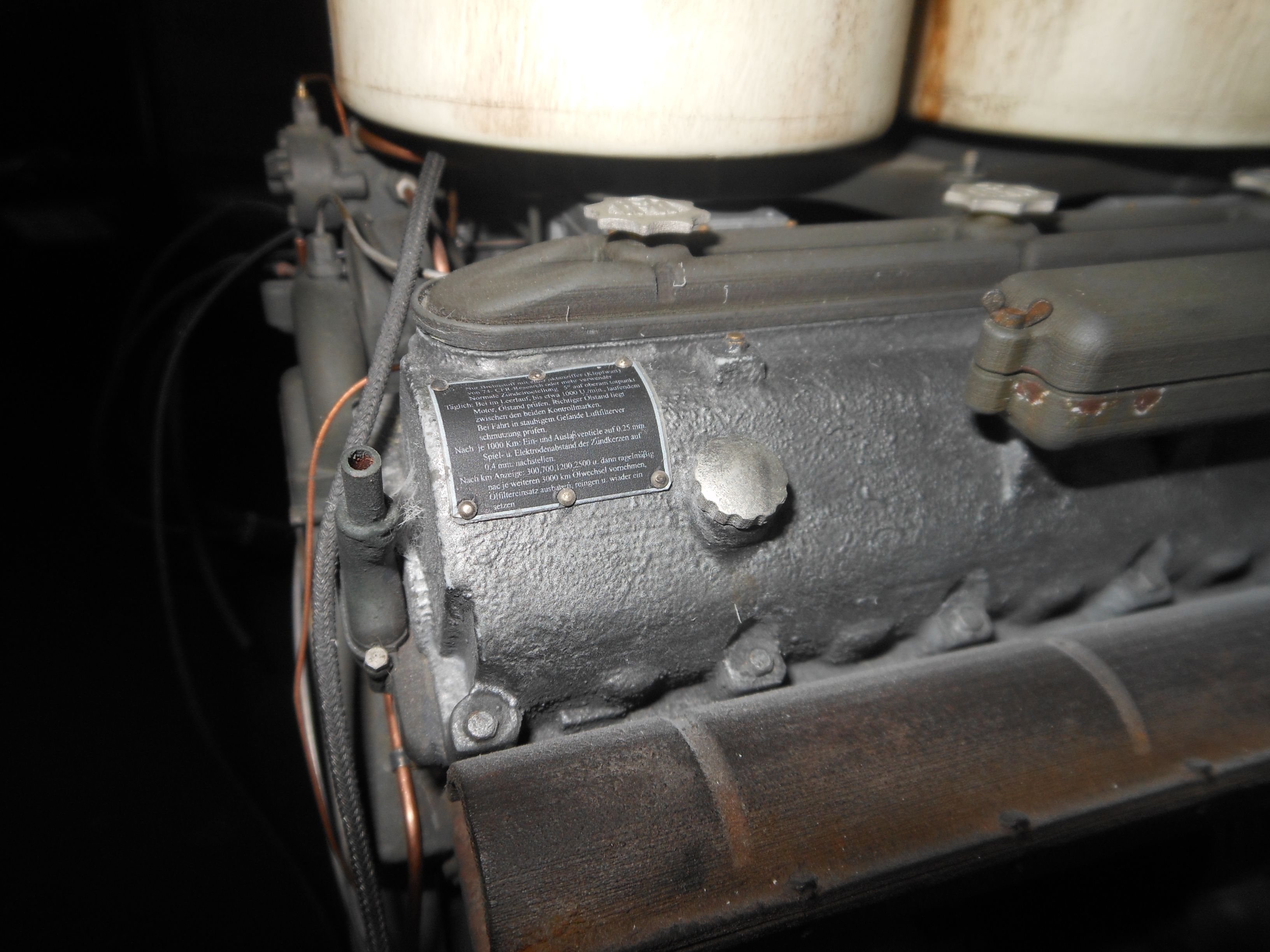

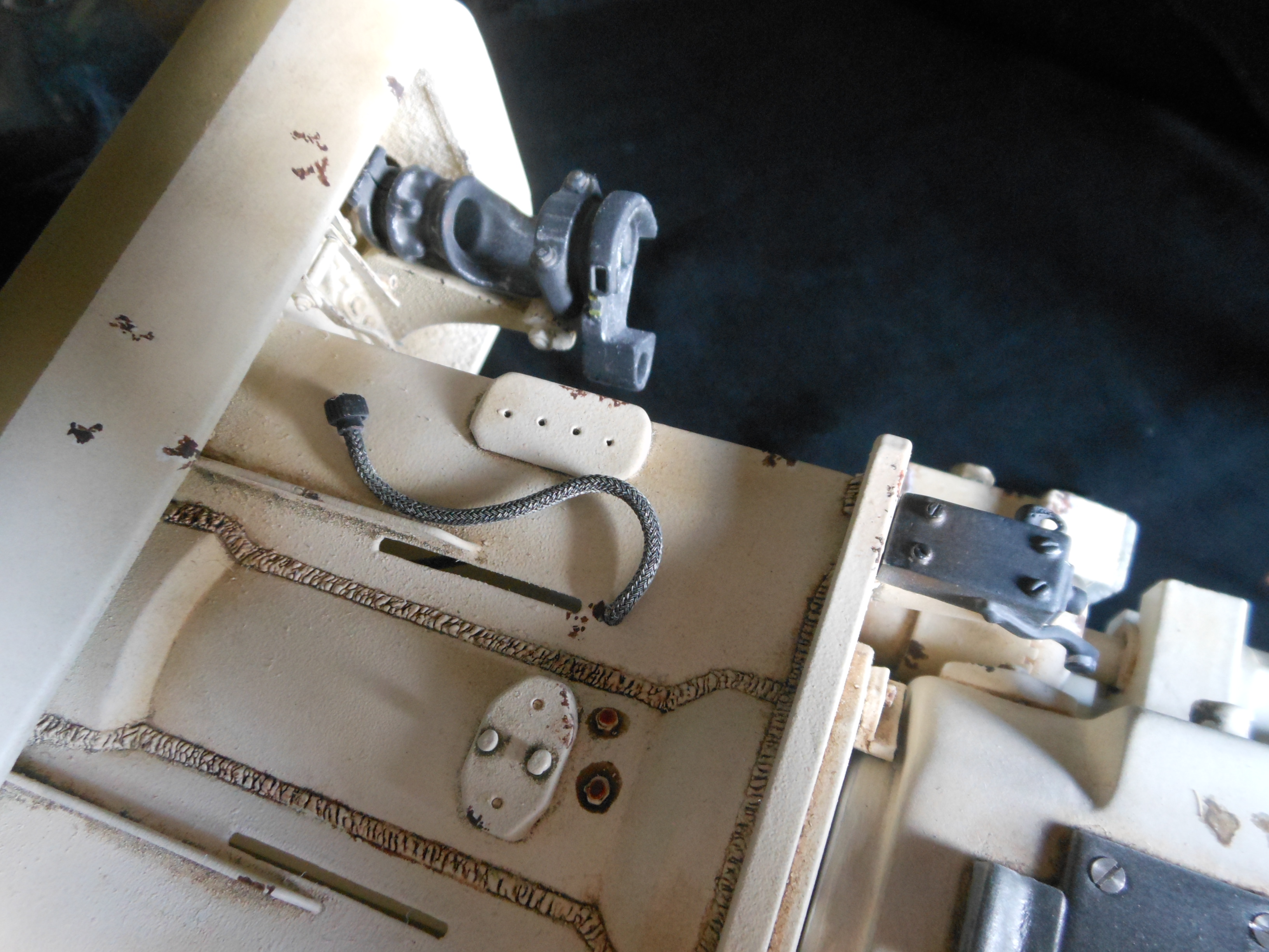

Another small progress in detail work

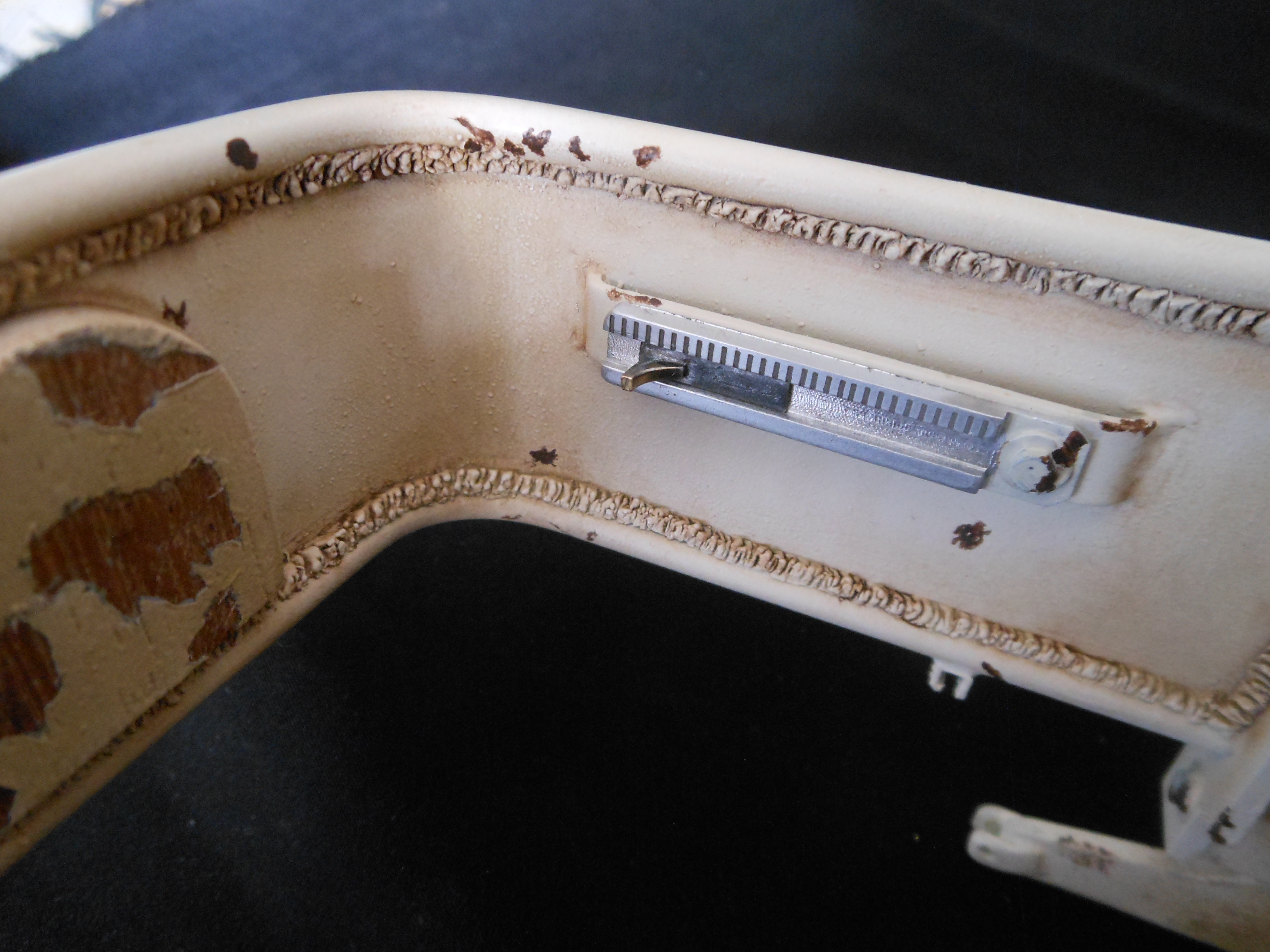

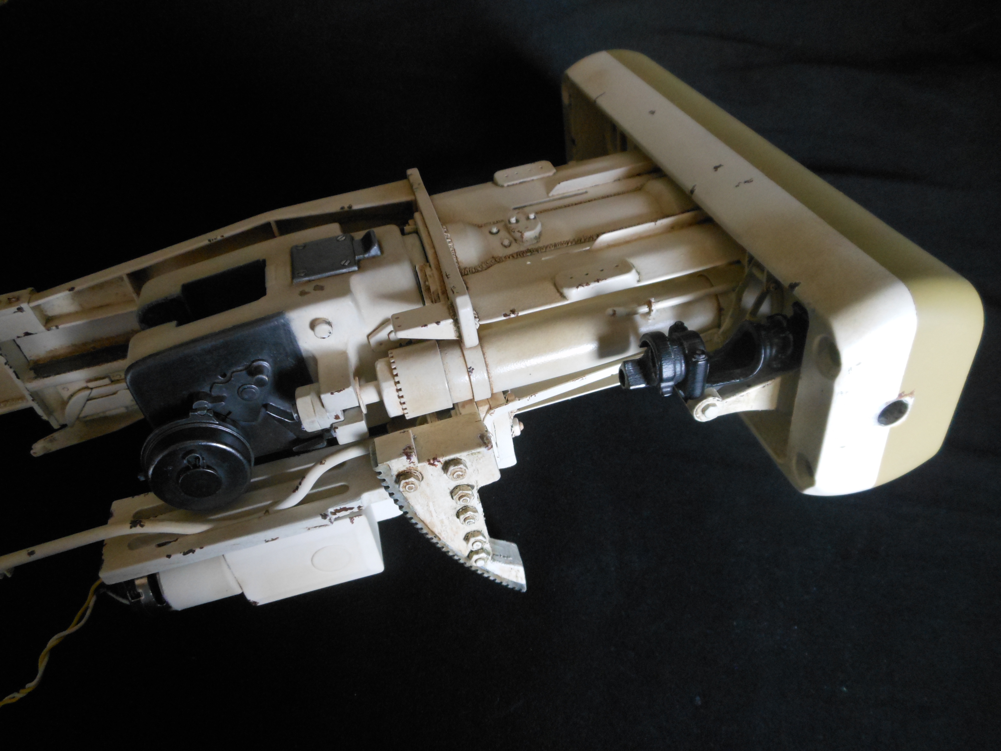

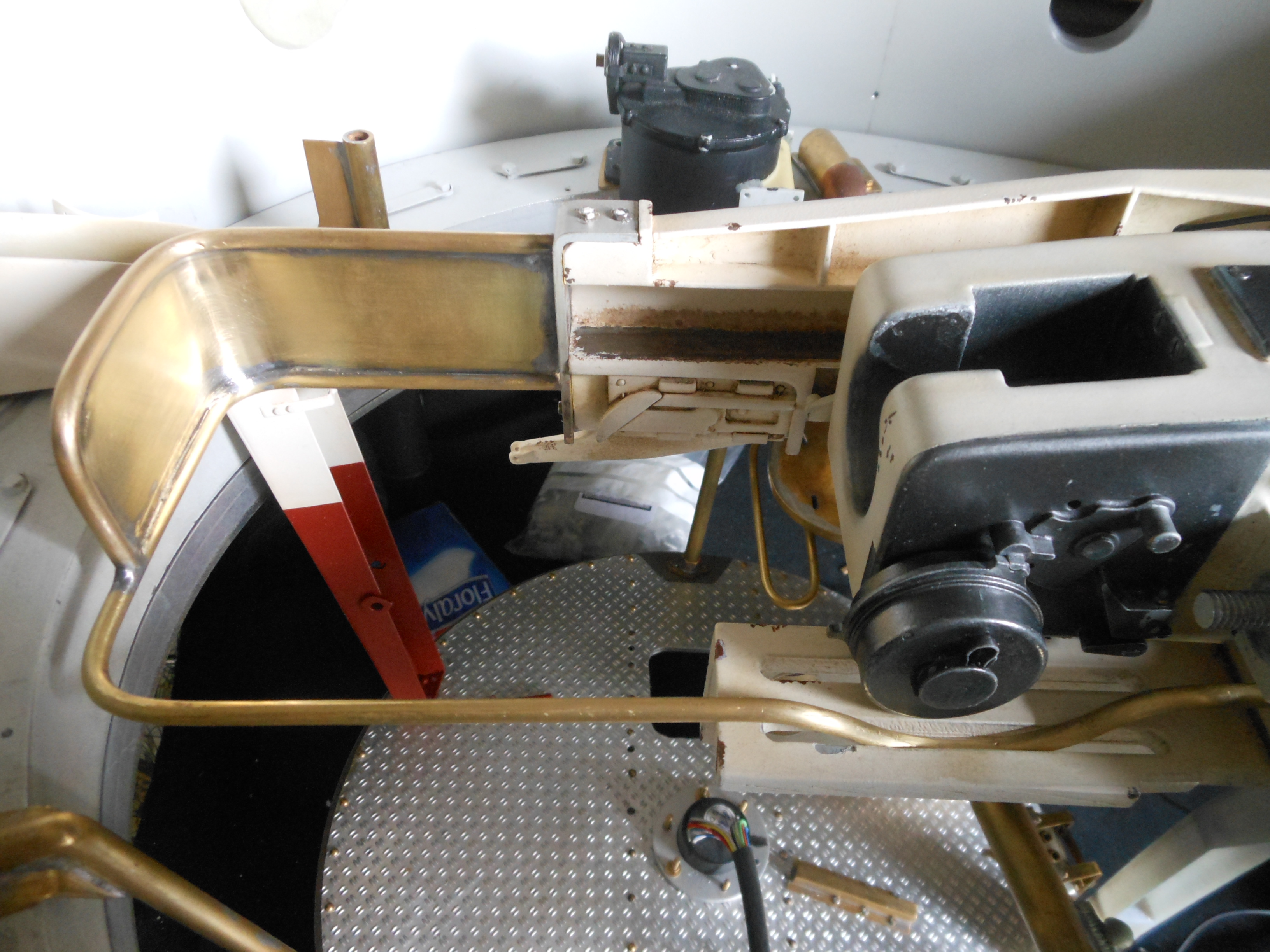

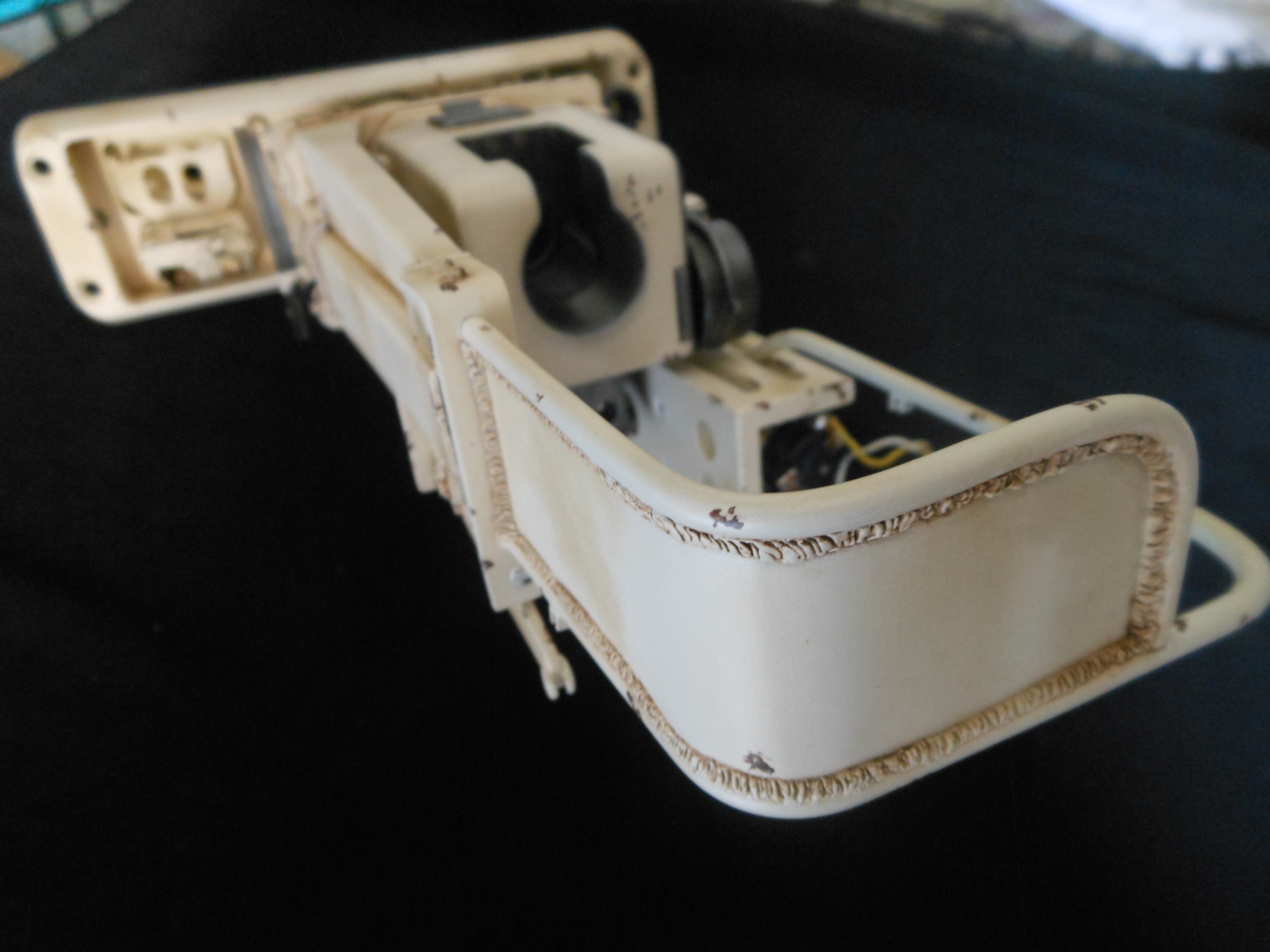

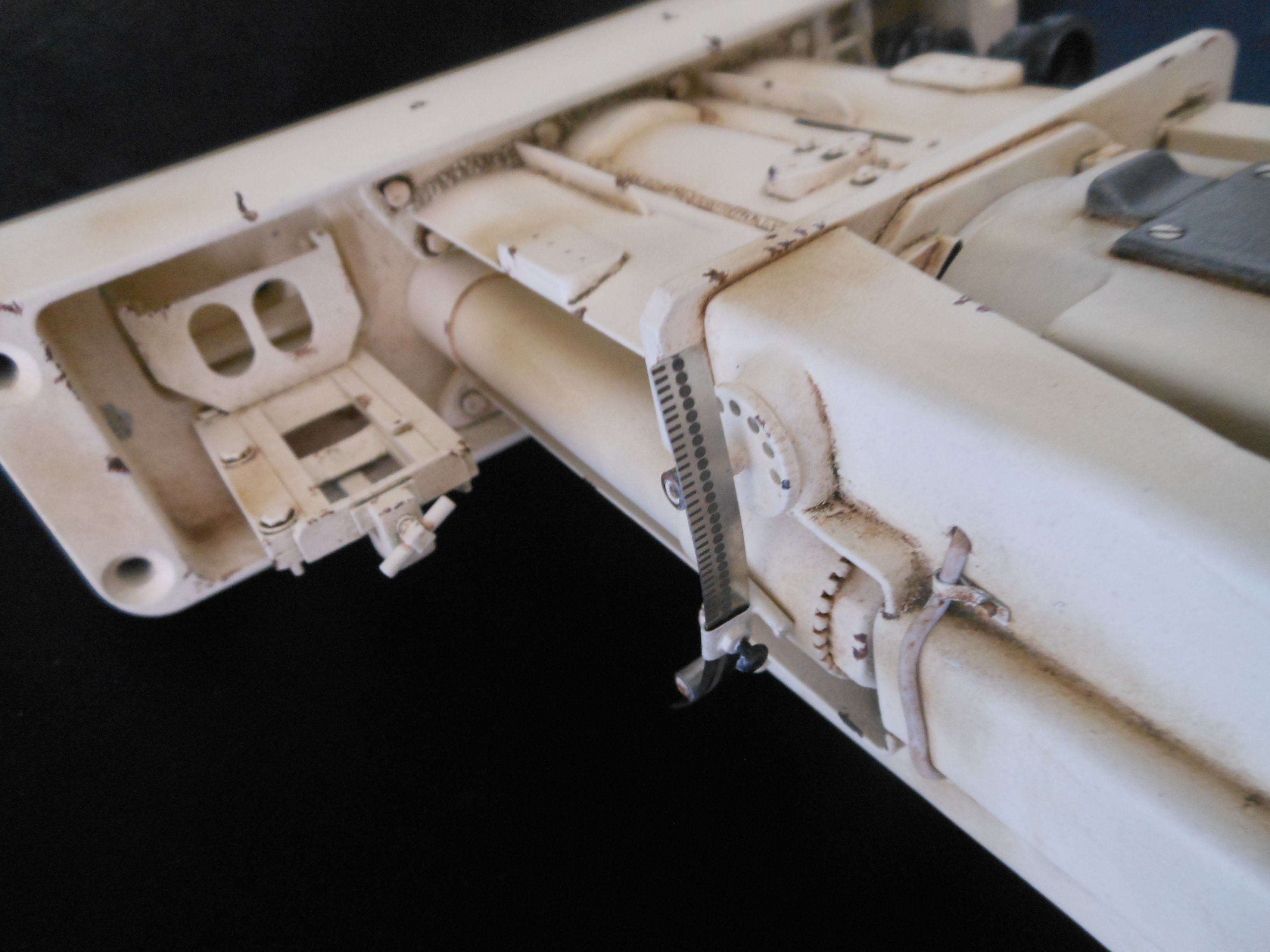

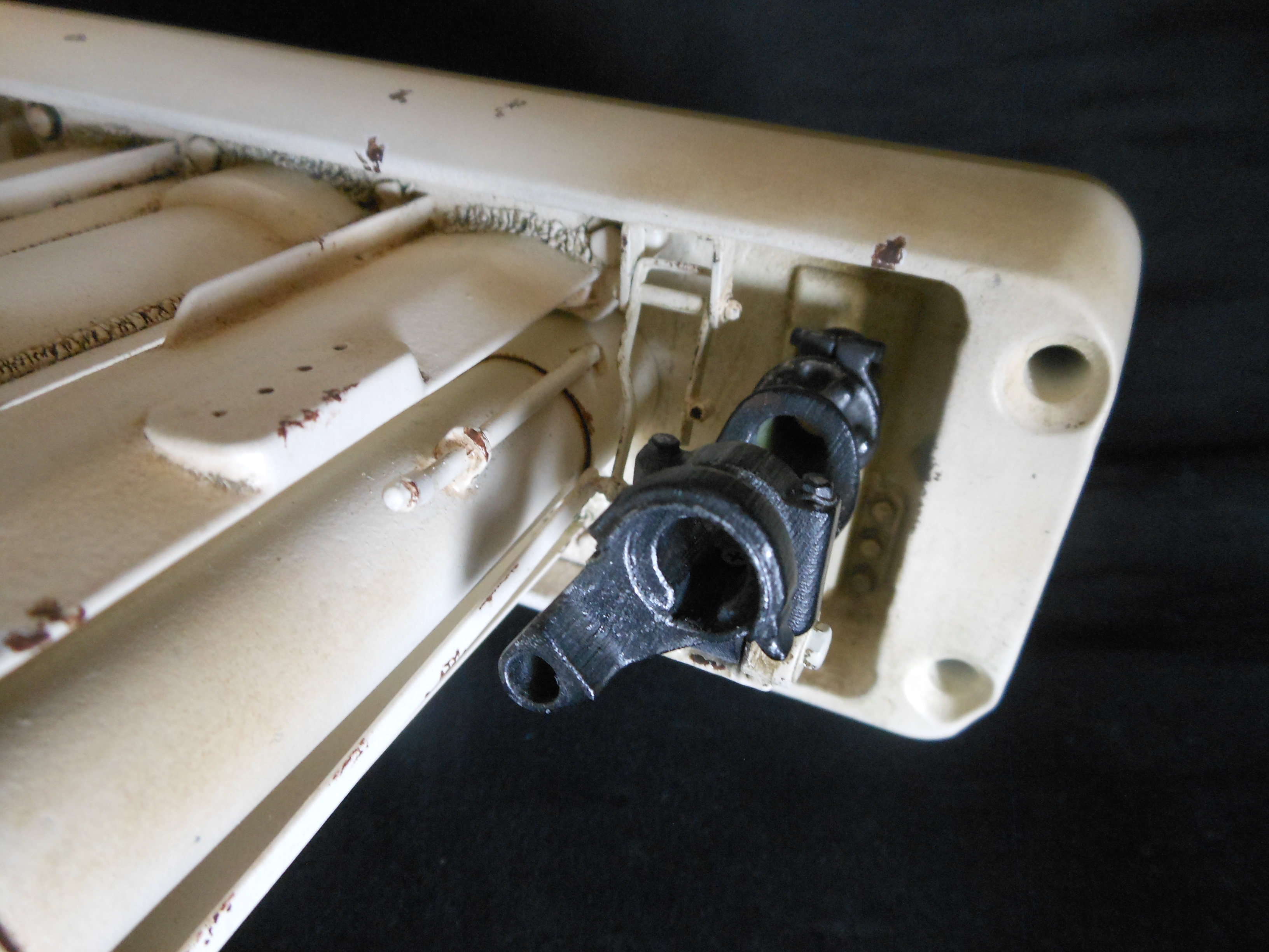

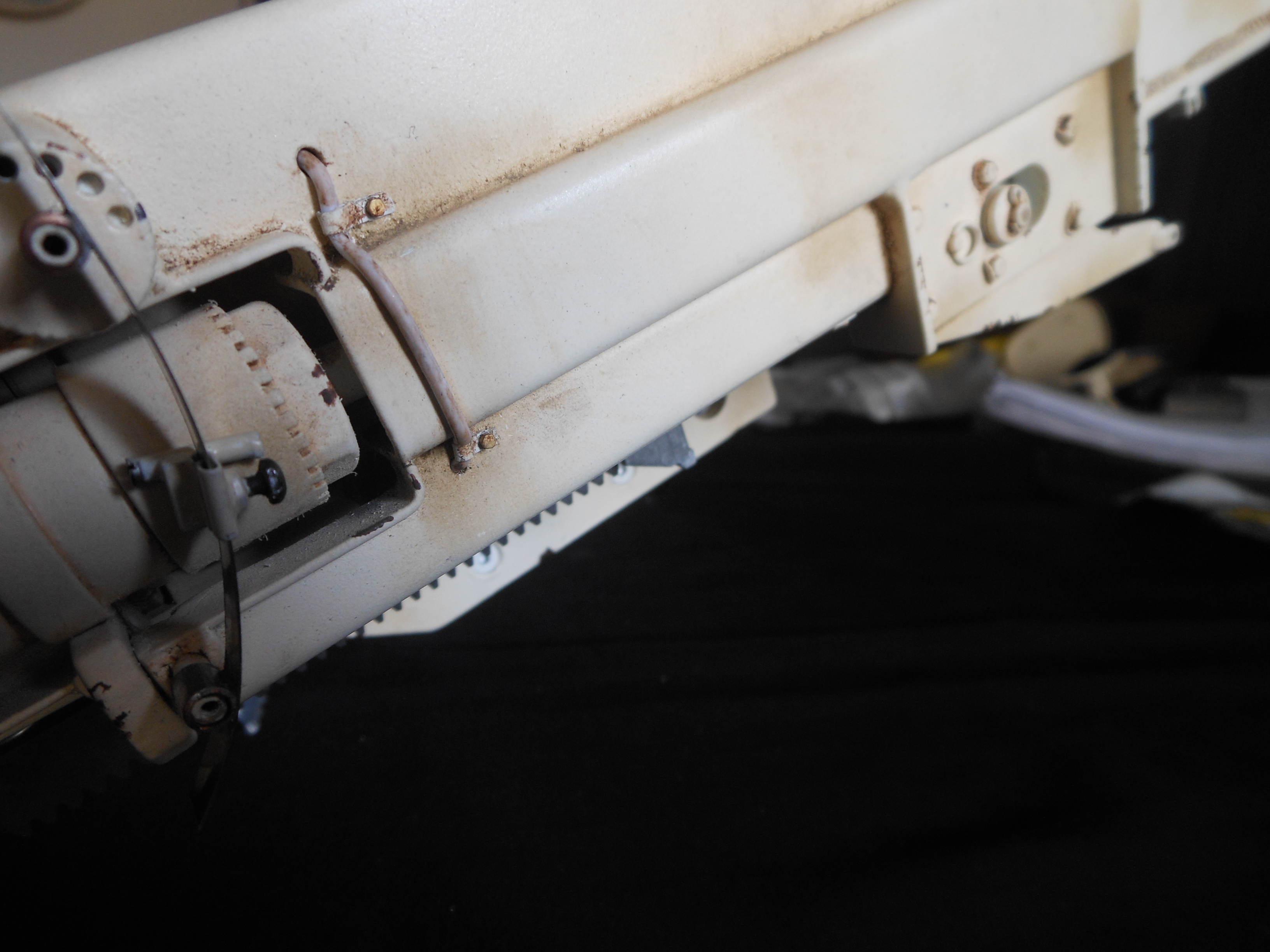

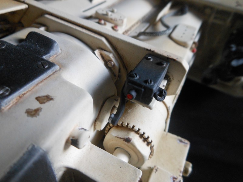

other photos

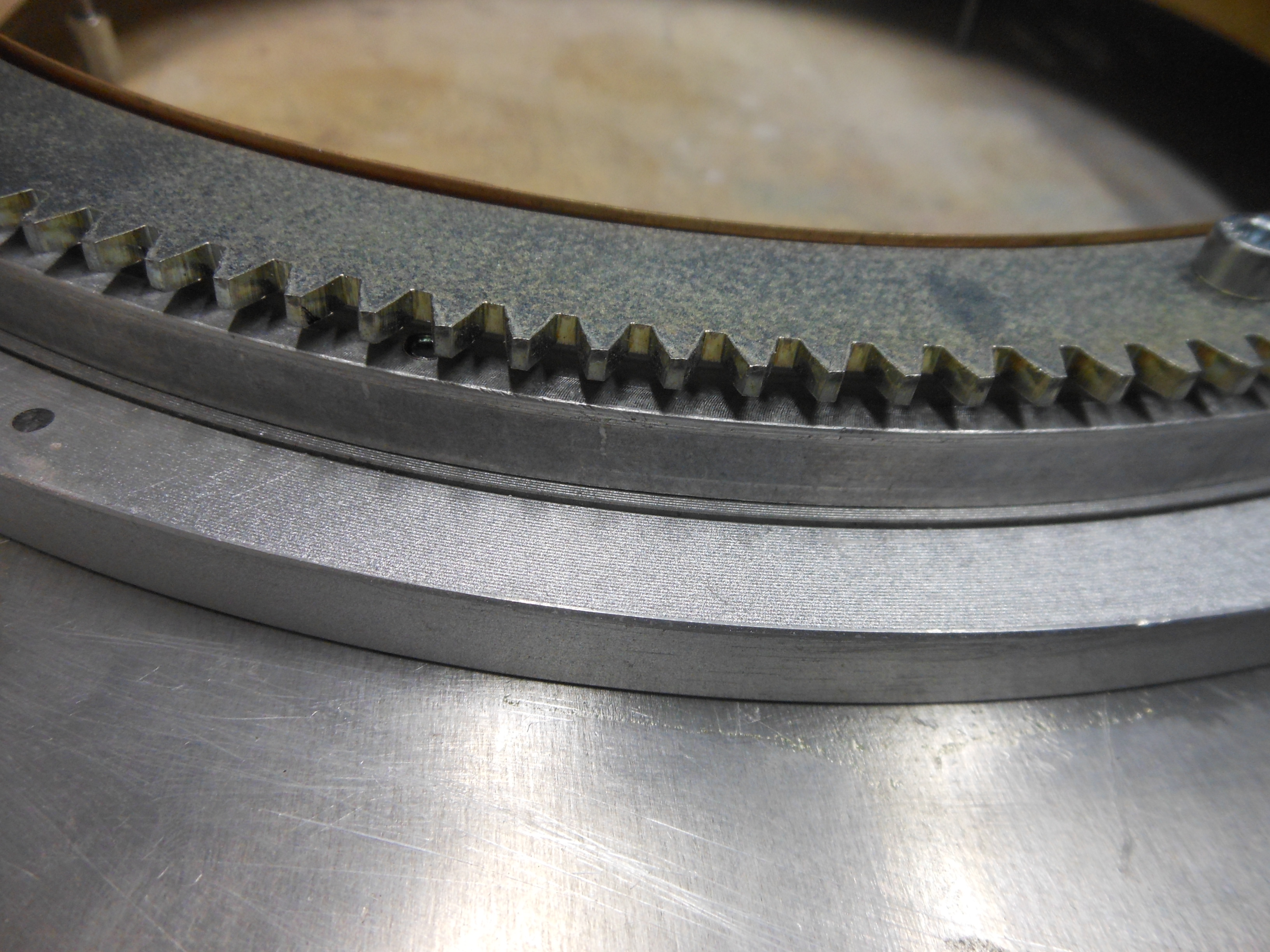

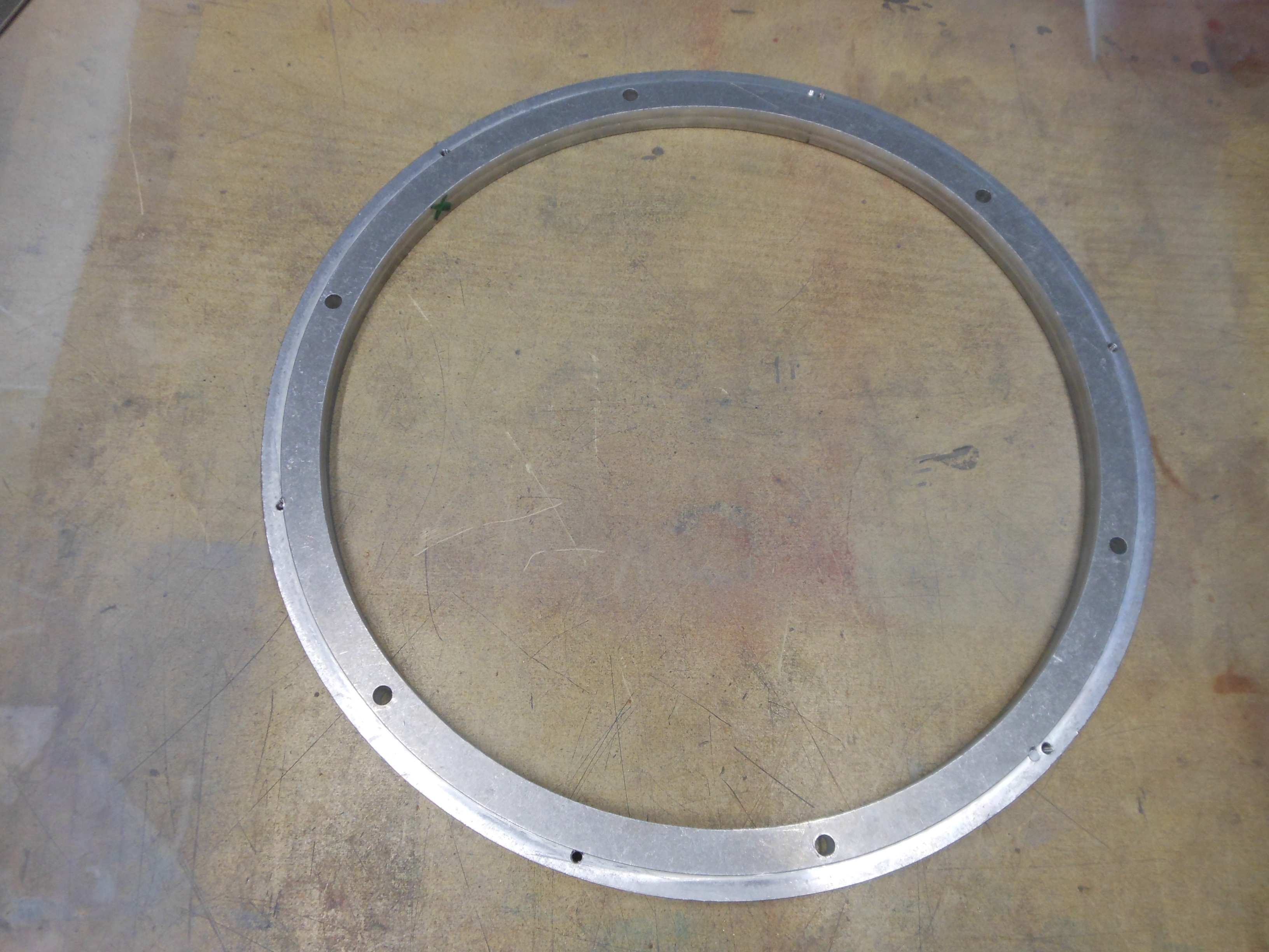

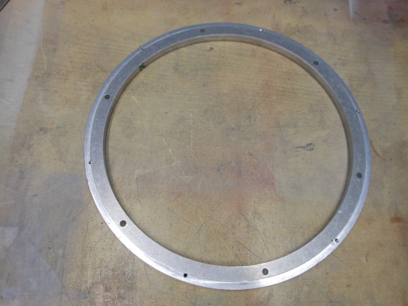

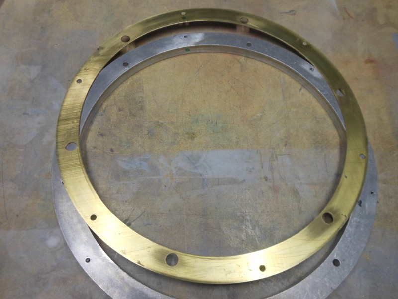

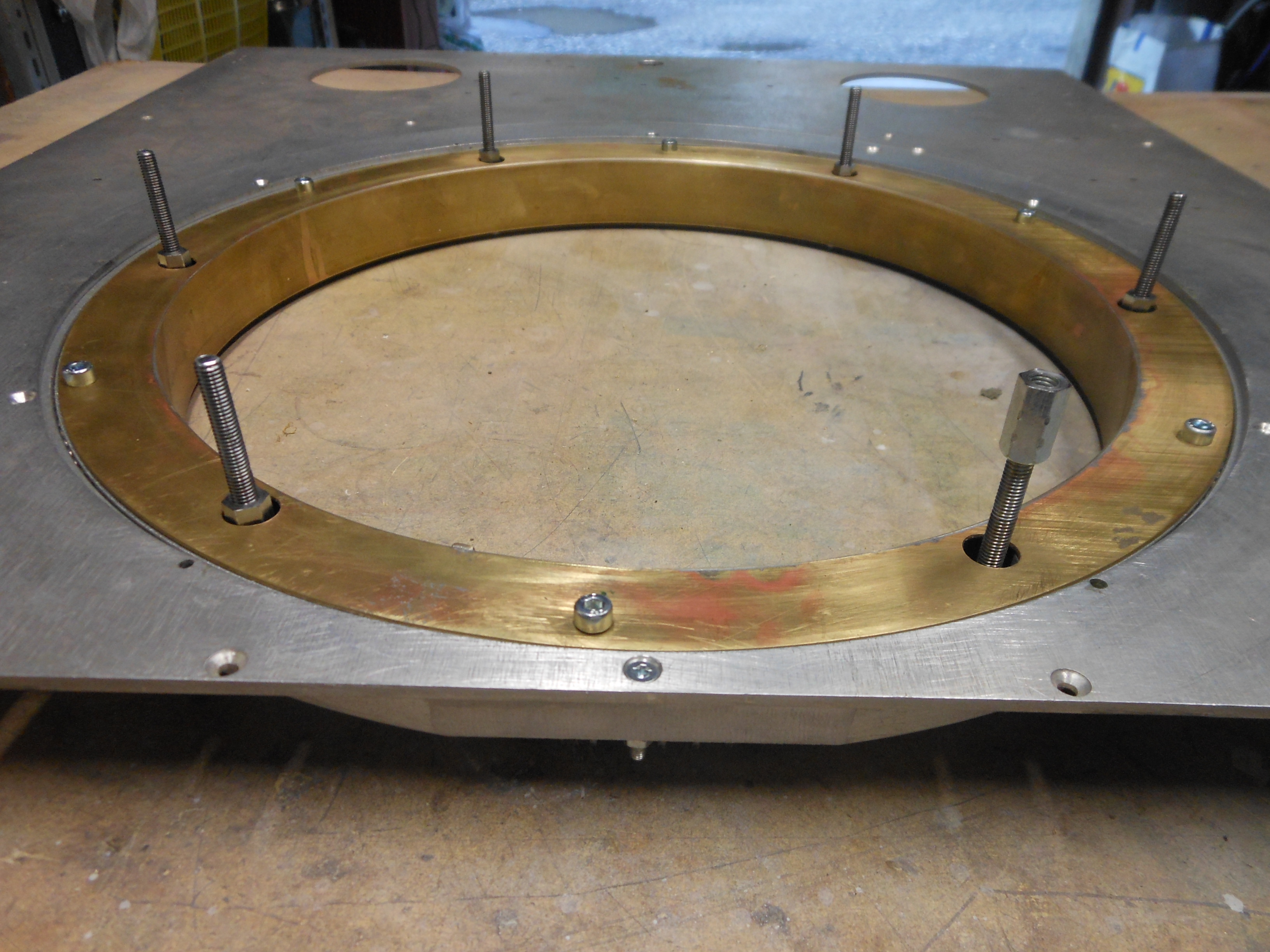

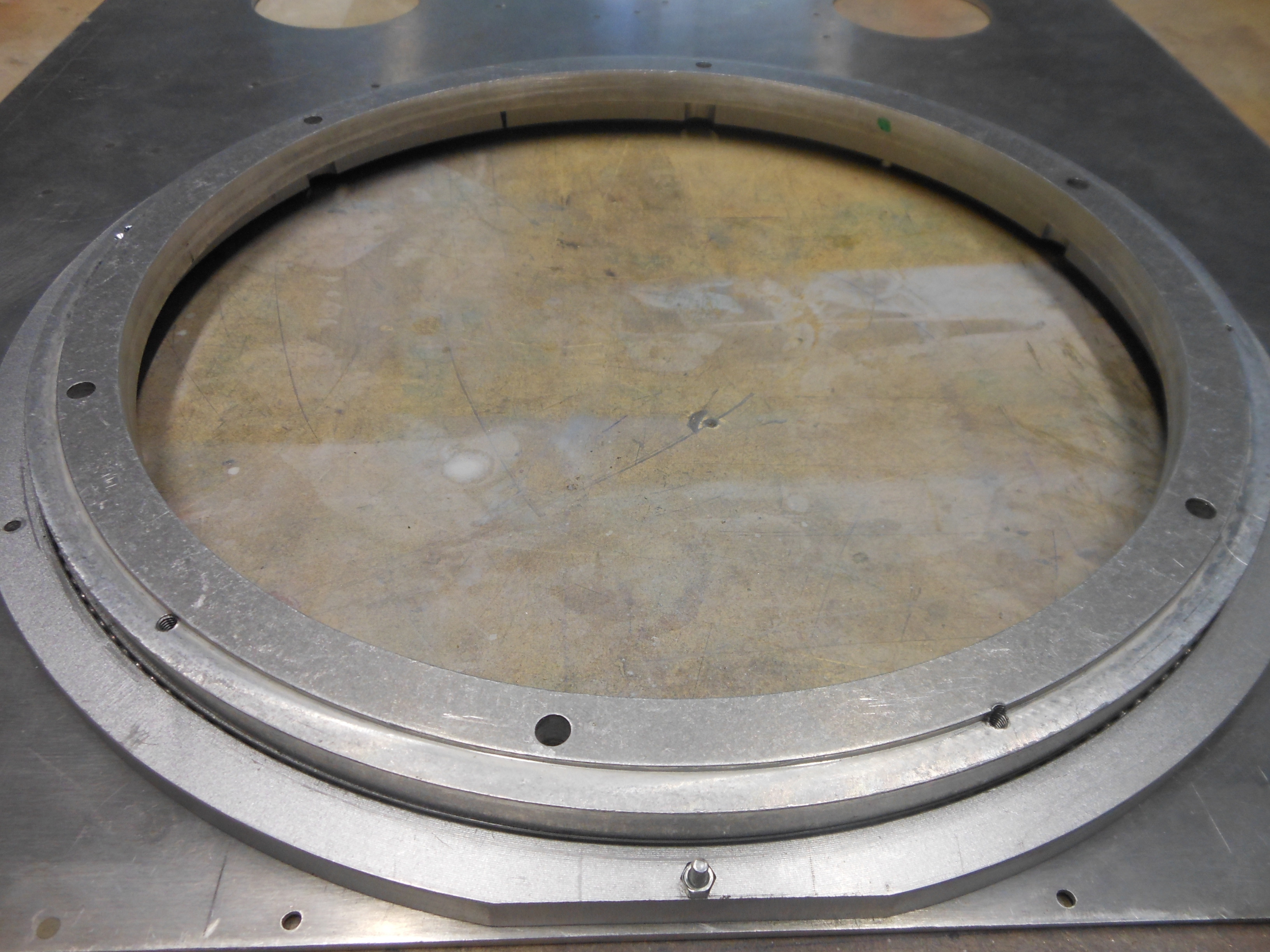

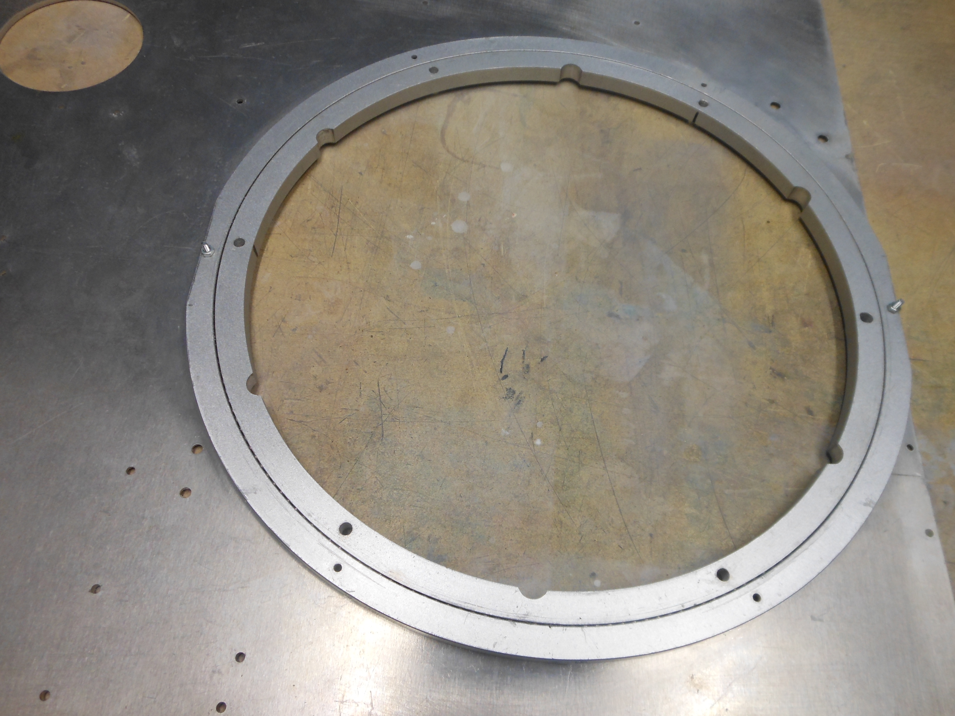

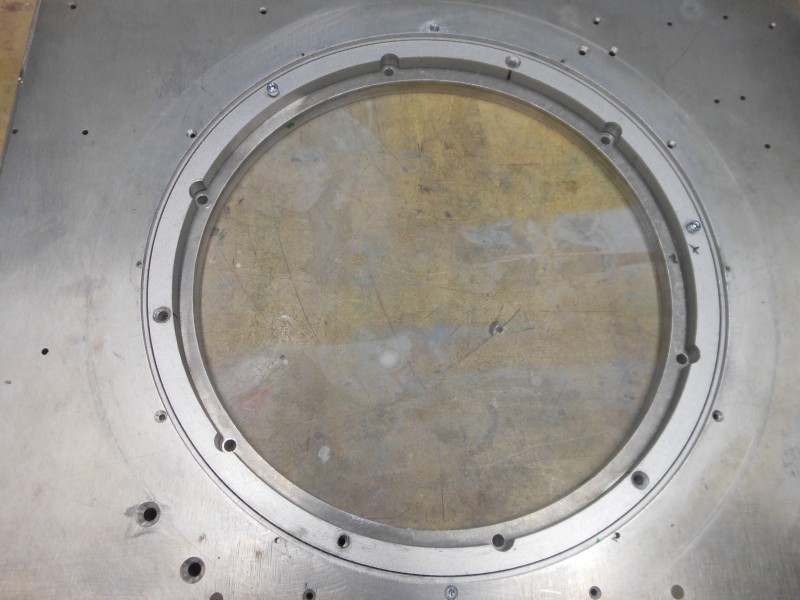

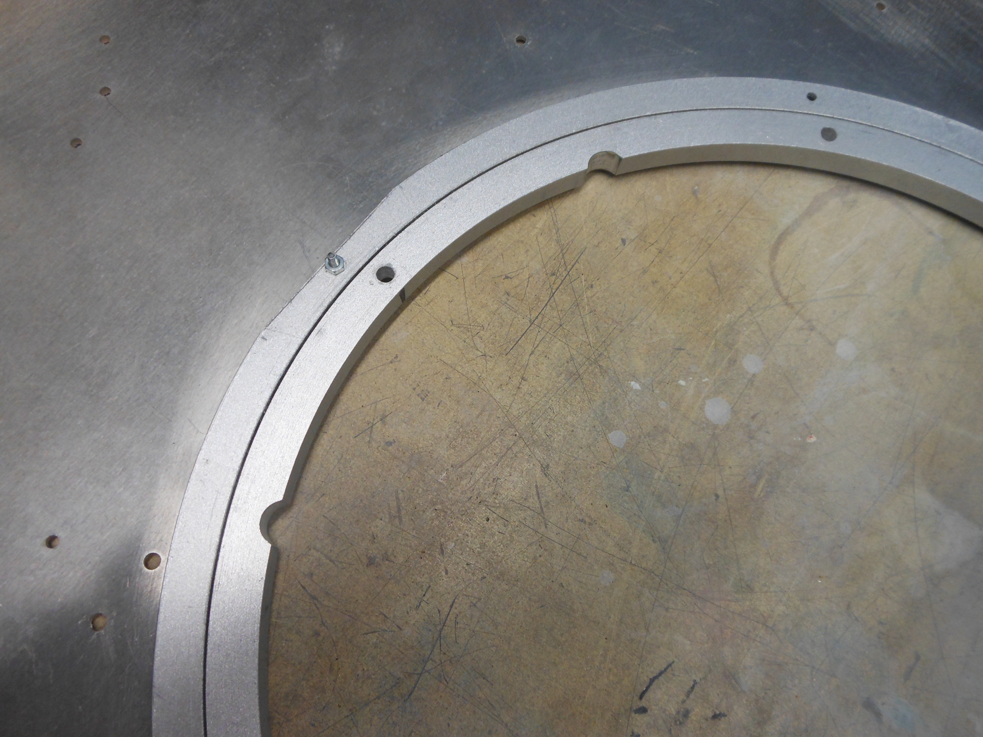

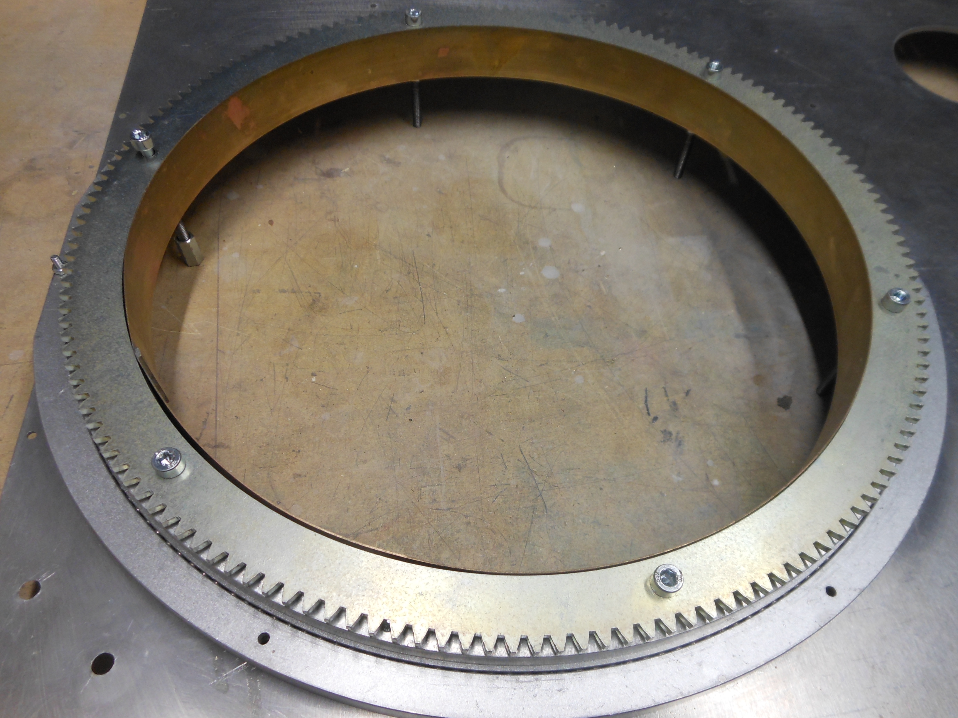

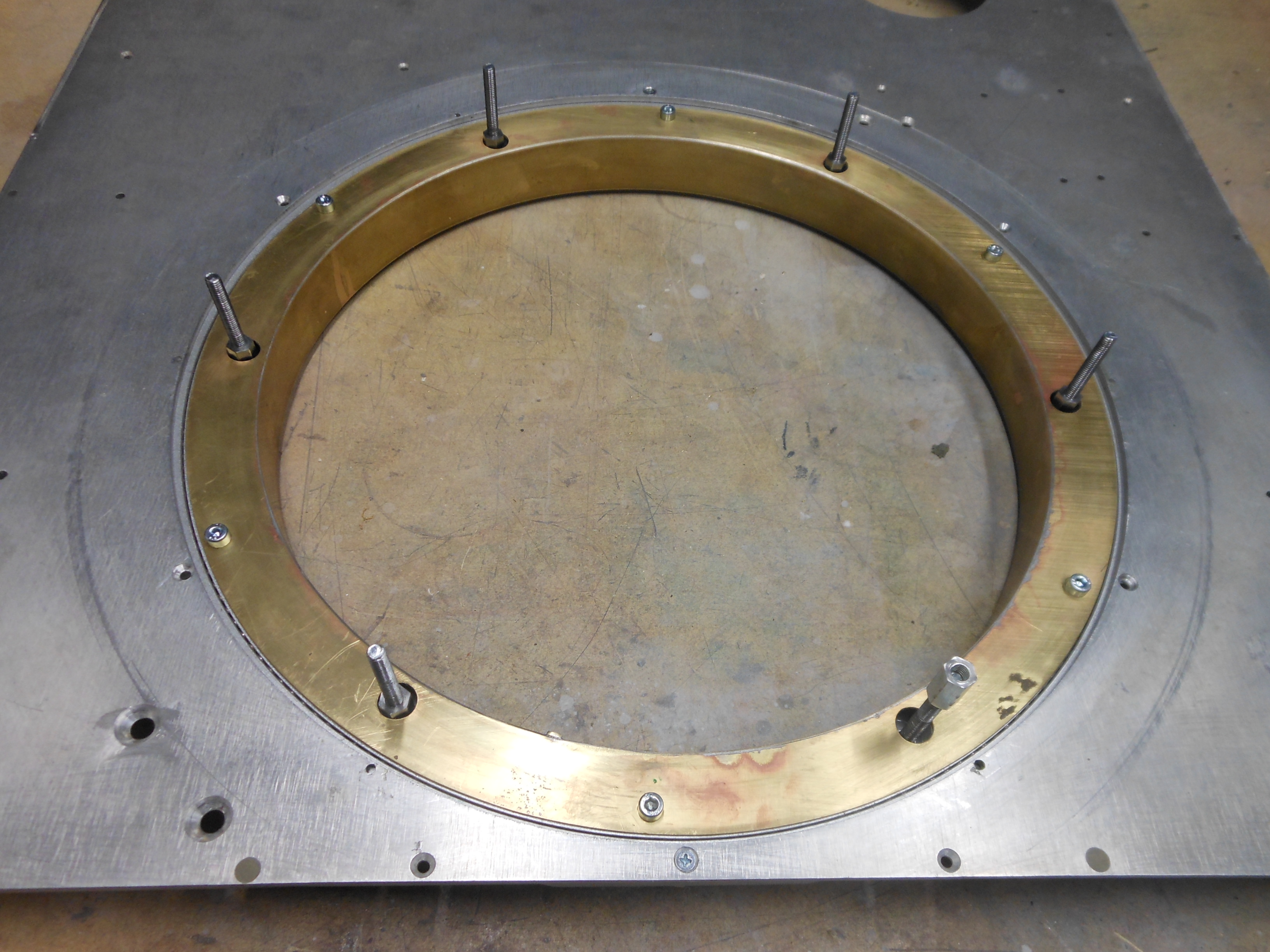

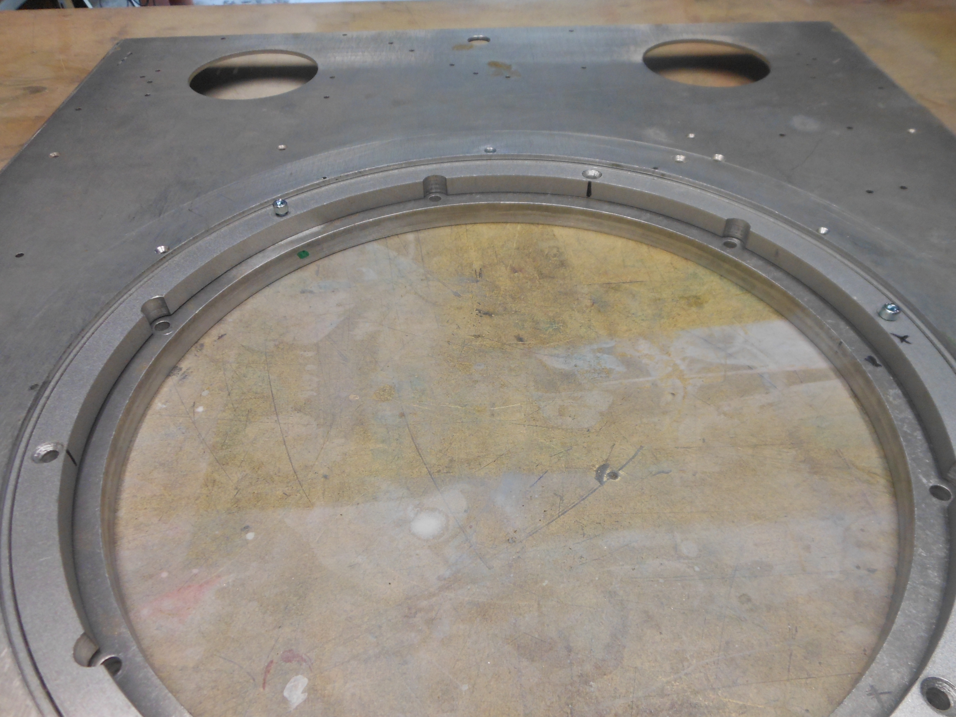

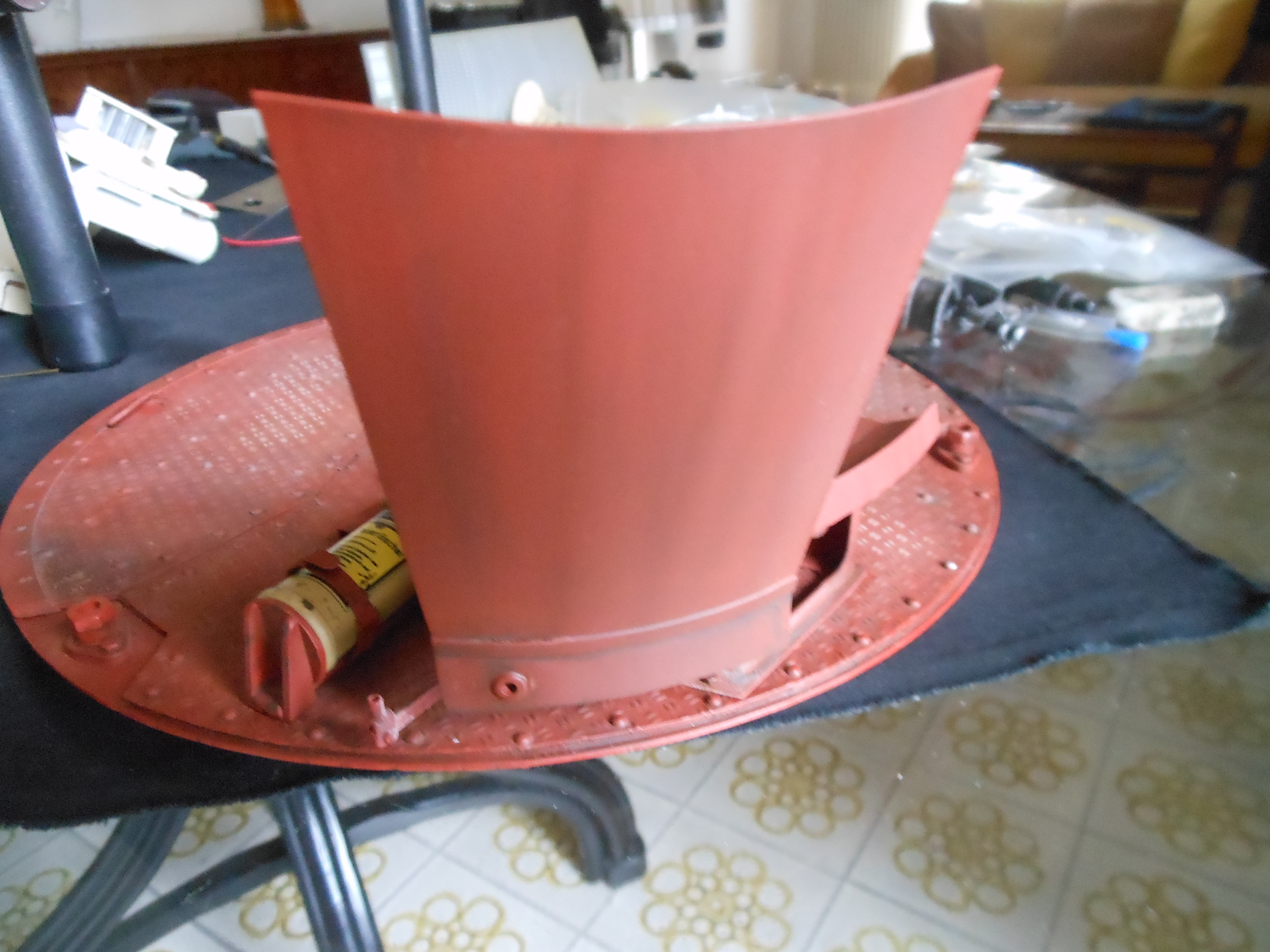

Greetings to all the friends of the forum.
Armortek has exhausted the parts of the Tiger1.

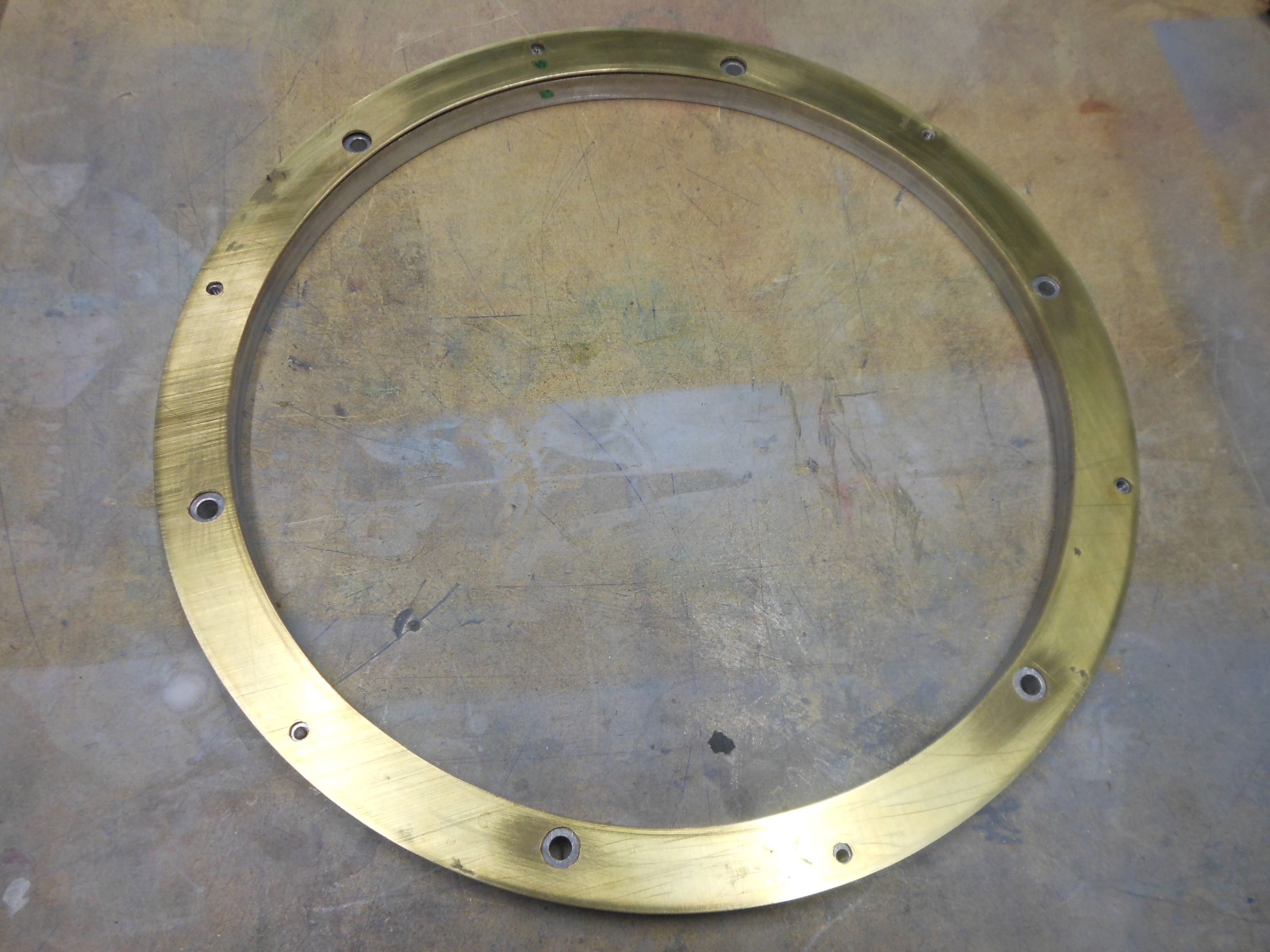

To update the rotation of the turret with a bearing, I did everything by recovering the original parts of my Tiger1 2010. Quick and easy work. Only one bearing must be purchased, the one used for Chinese restaurant tables, a few euros and a few changes. I also made a brass ring for aesthetic purposes, but it's not necessary. I hope you understand what I wrote and the photographs are clear.
brass ring 1 mm
brass ring 1 mm
I made a frame for the ring
original crown wheel
Ivano Costantini
Posts: 533
Been liked: 735 times
Re: Tiger1 " tard-mid" !!??
Post by Ivano Costantini »
For me, the most complicated thing was to align the pieces with the holes.
Ivano Costantini
Posts: 533
Completed!

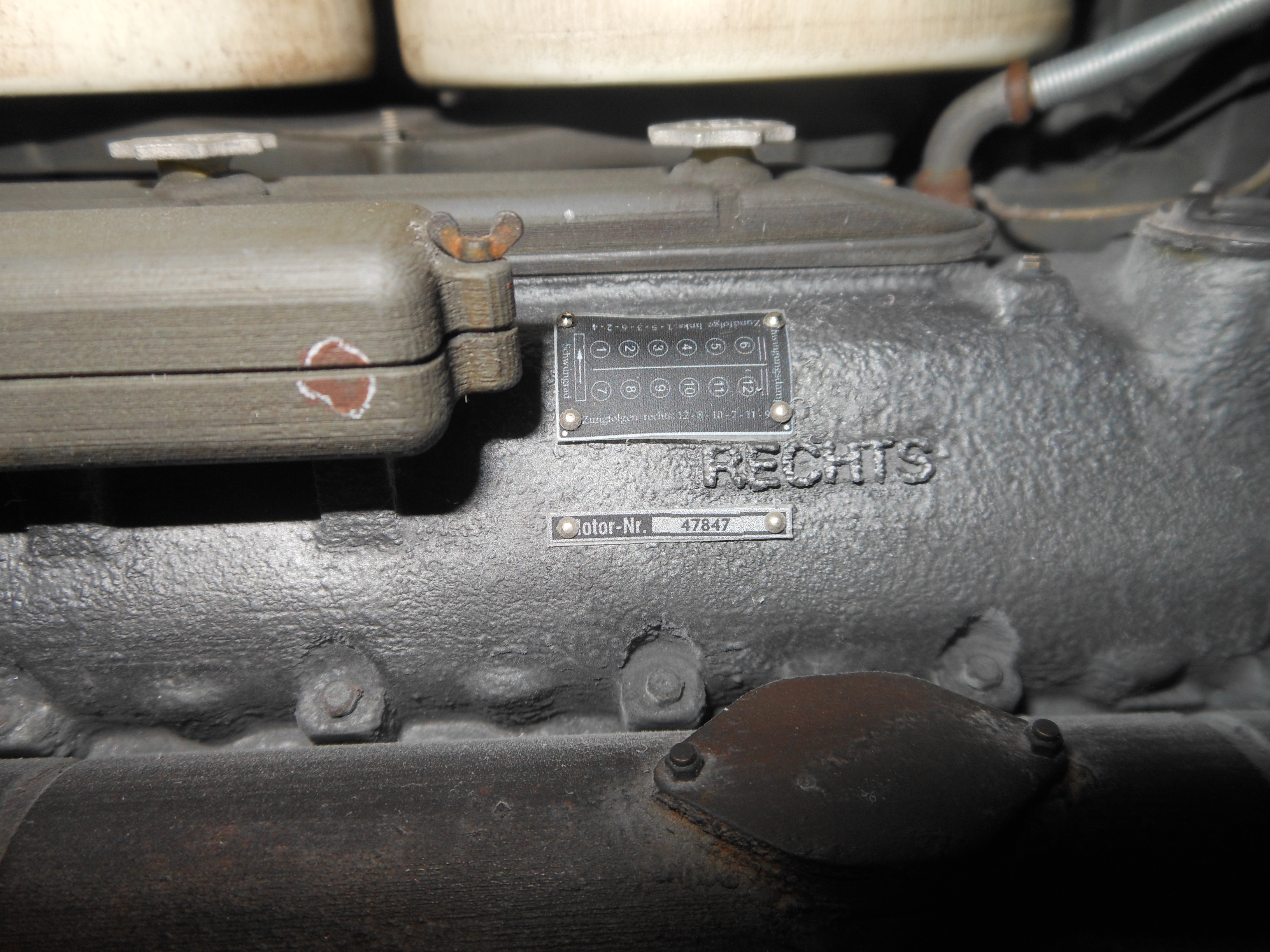

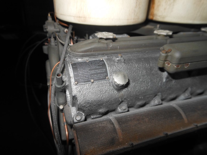

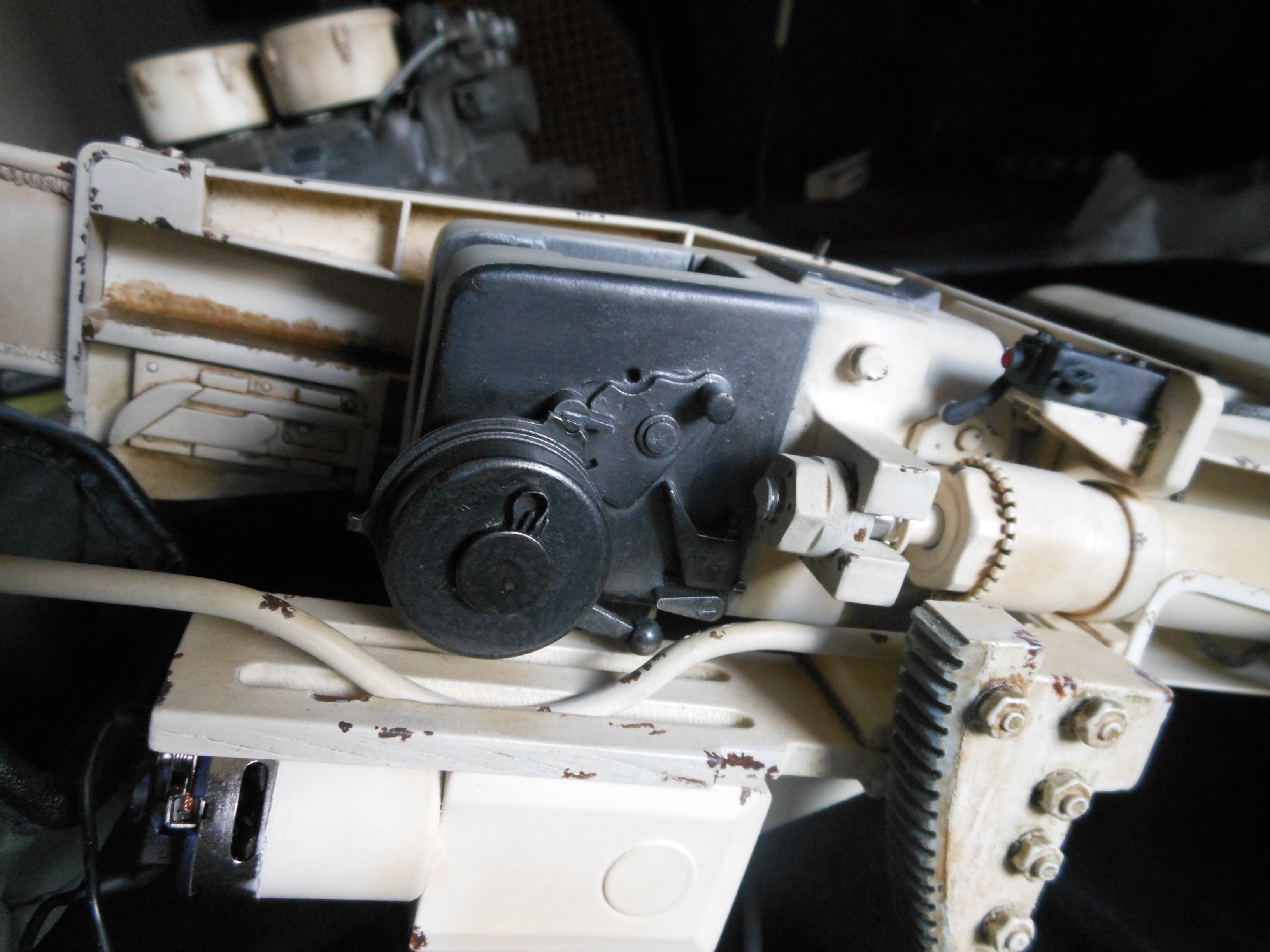

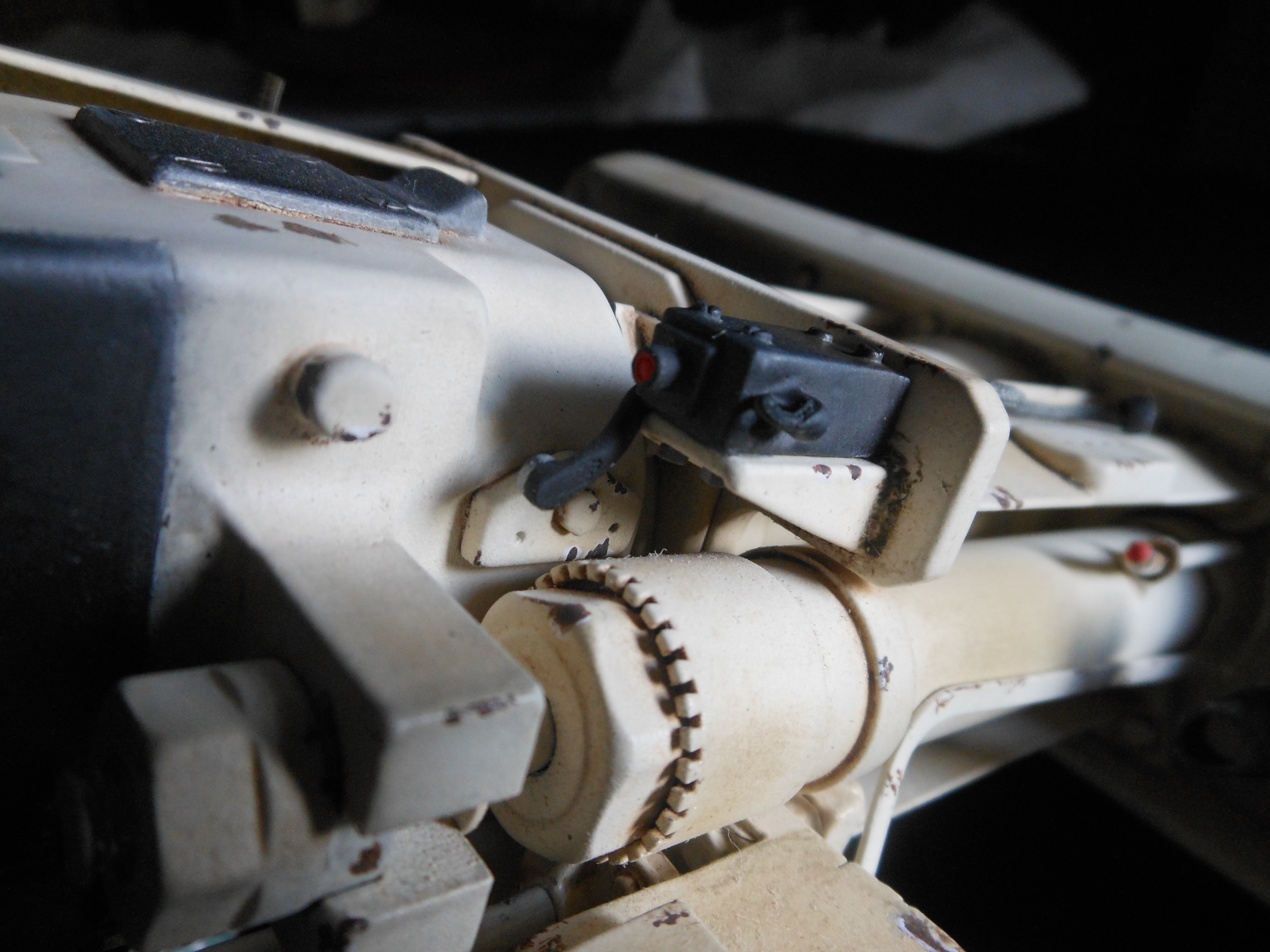

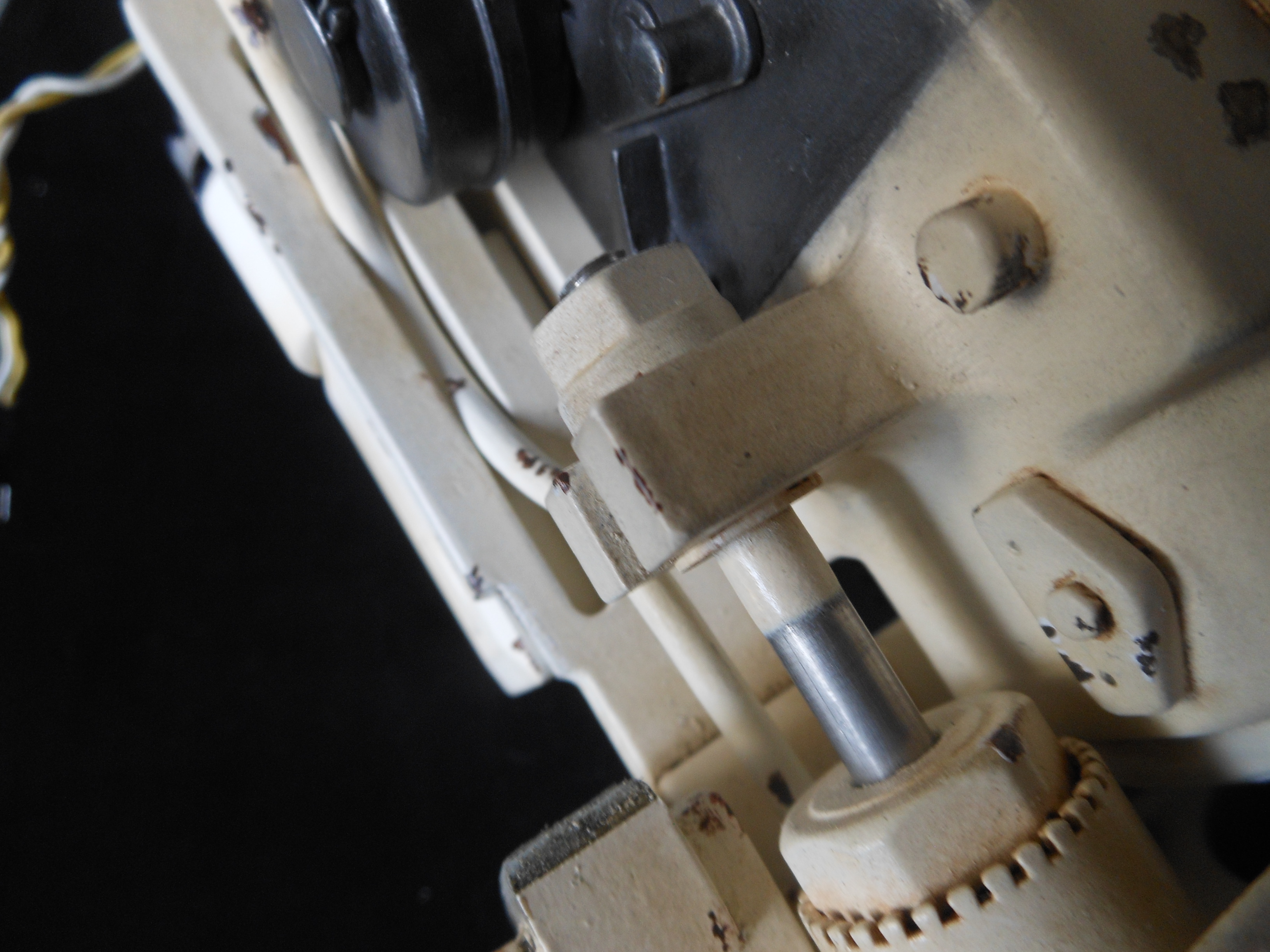

Also reposition the decals on the engine.

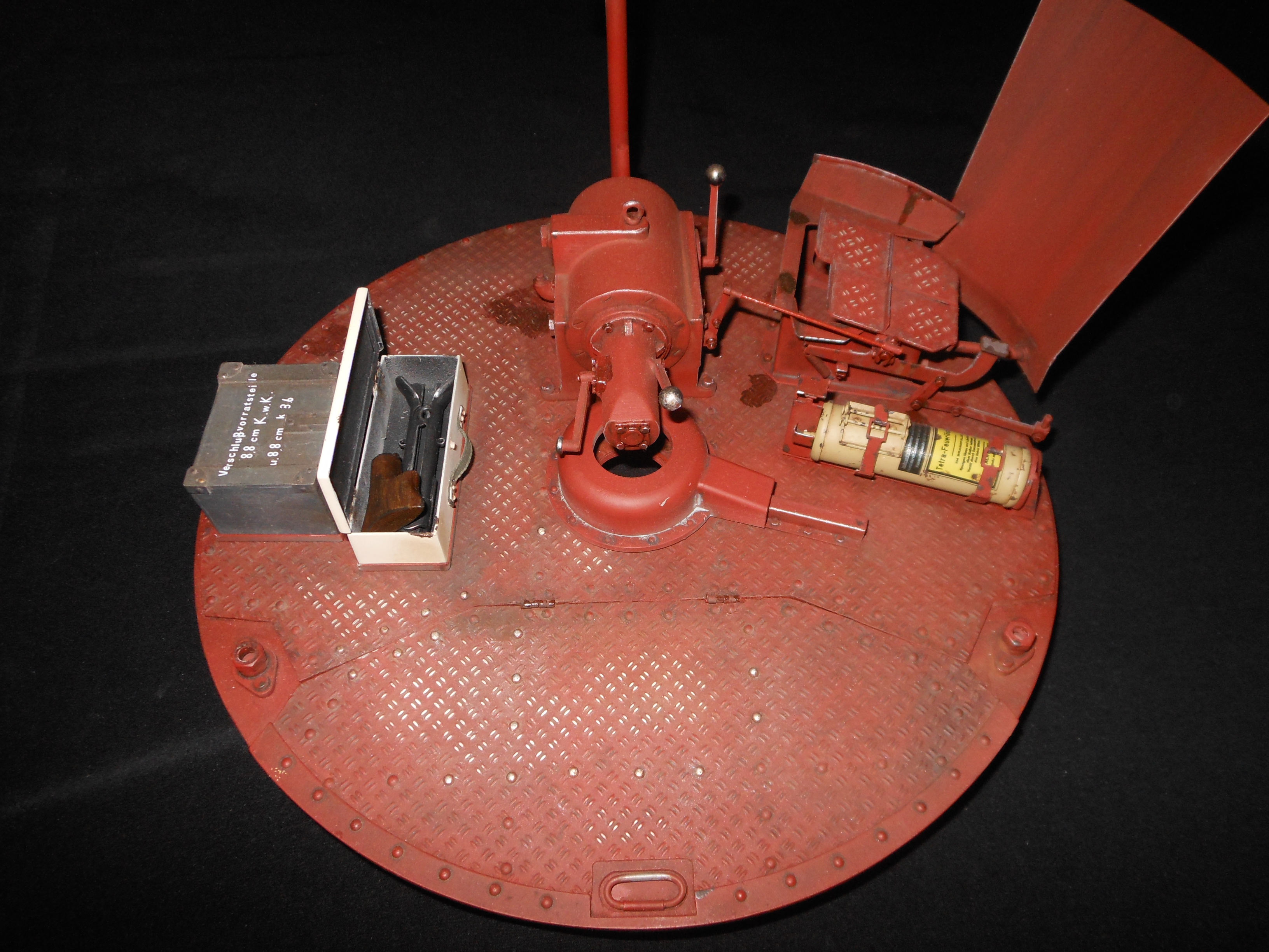

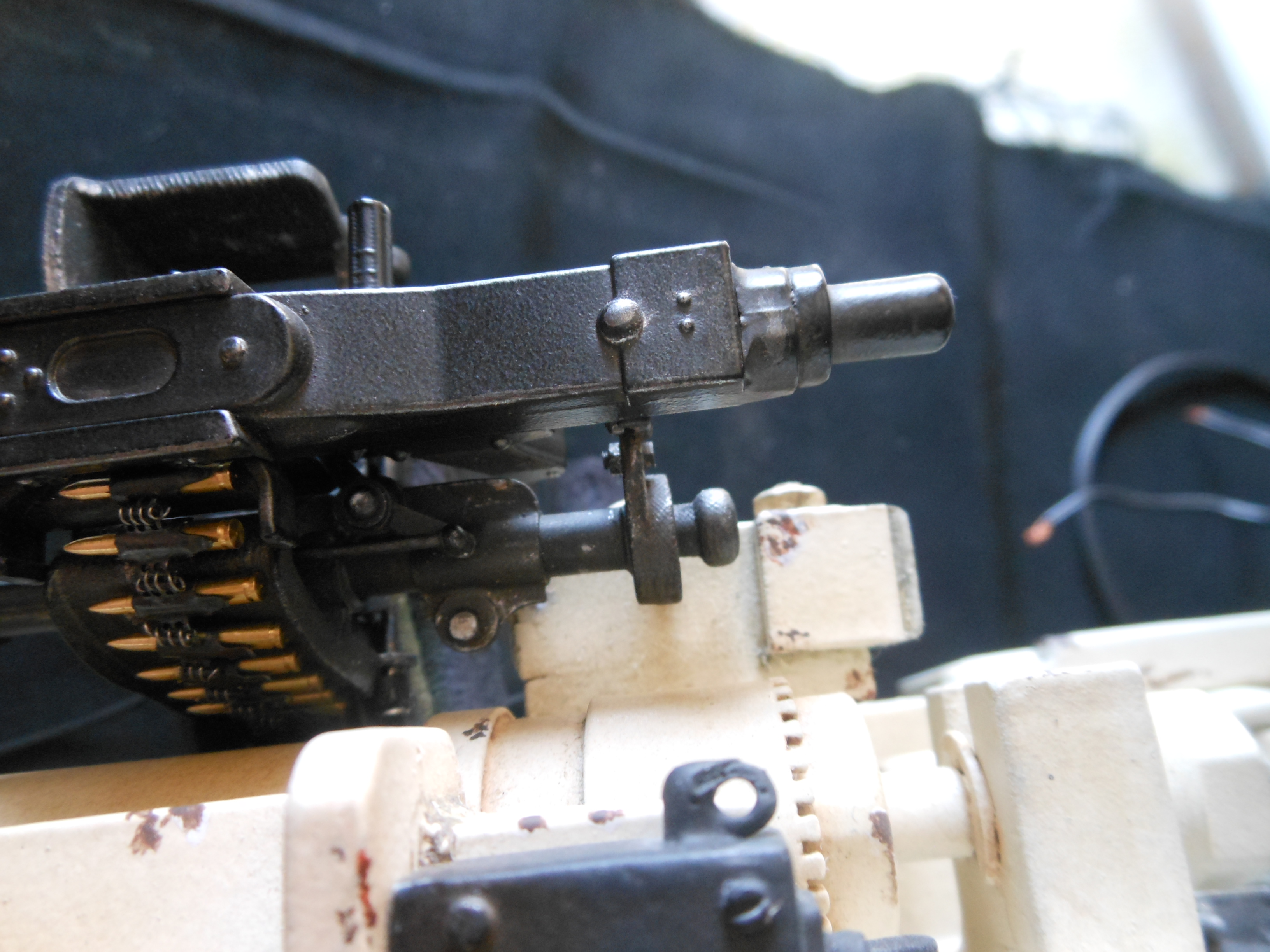

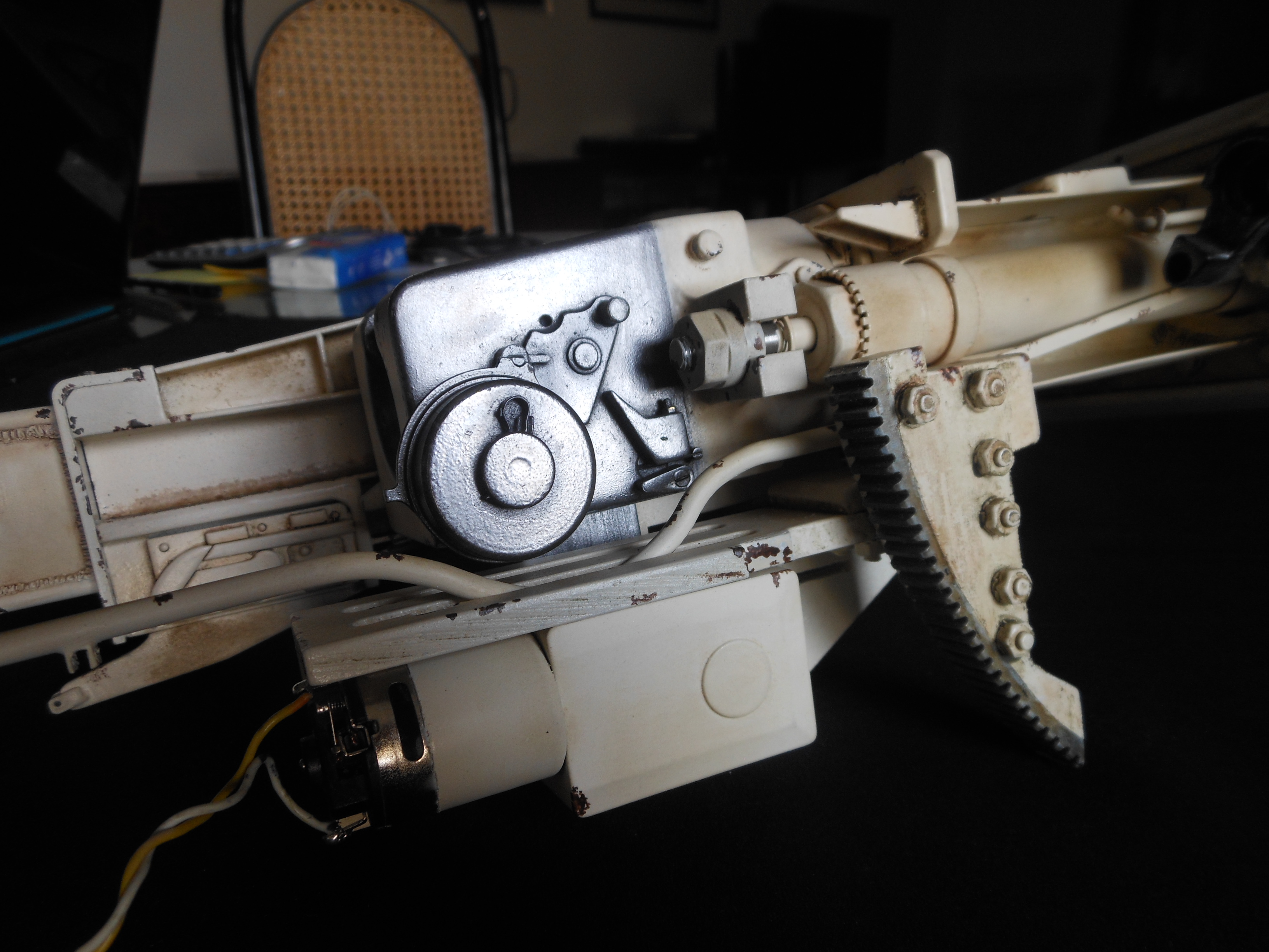

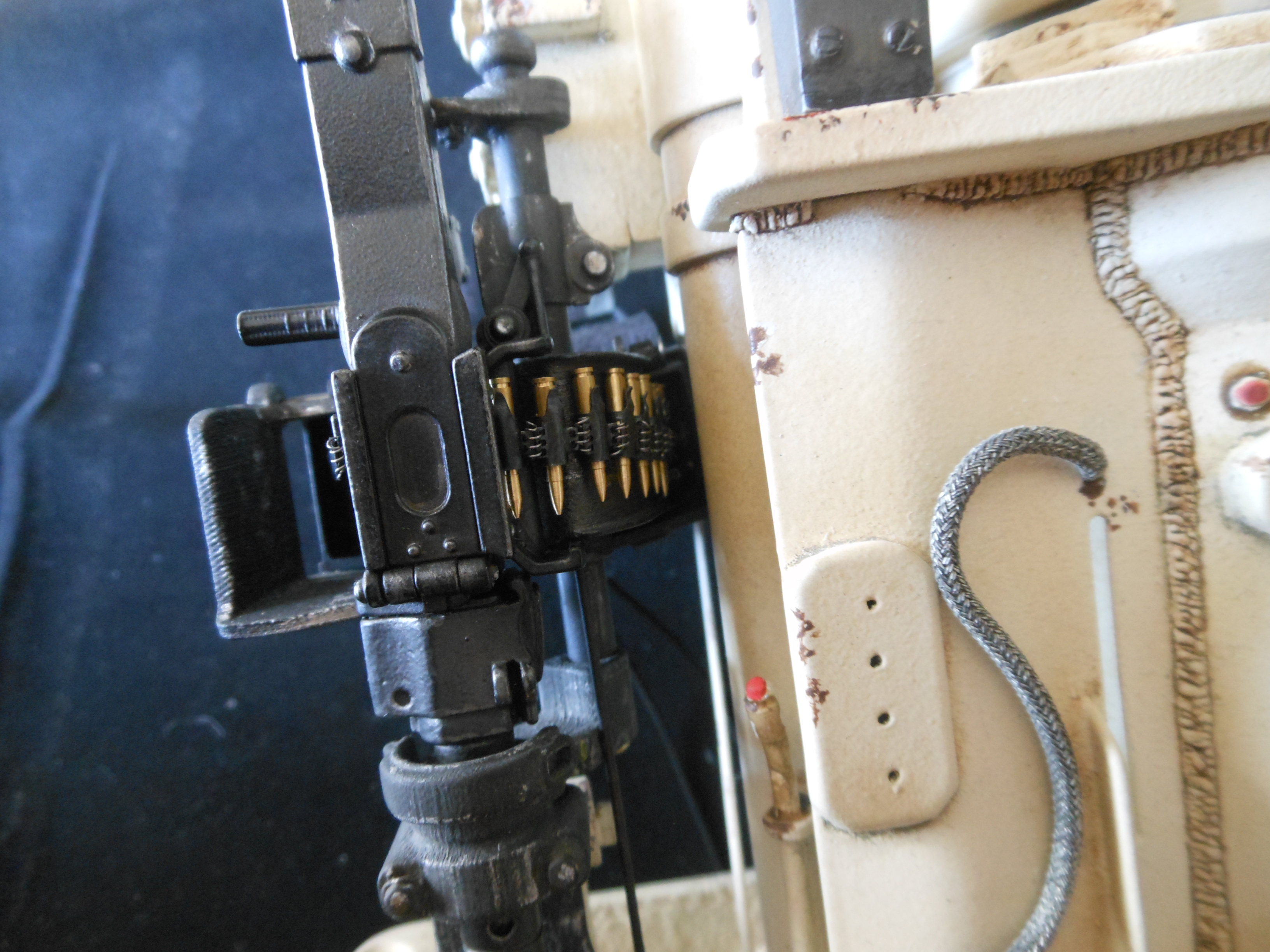

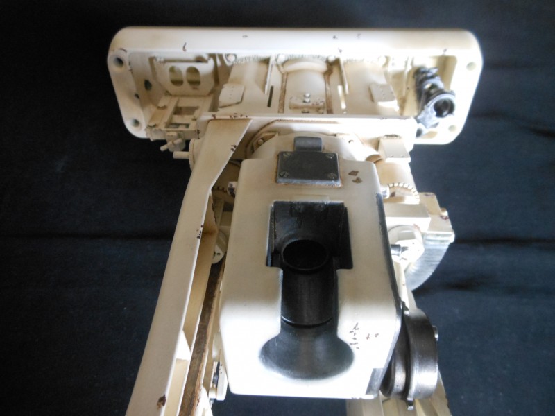

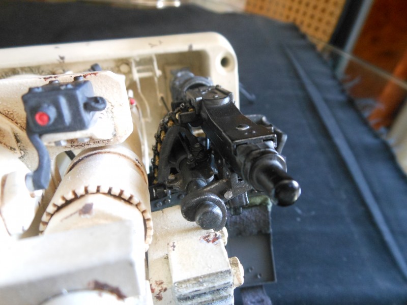

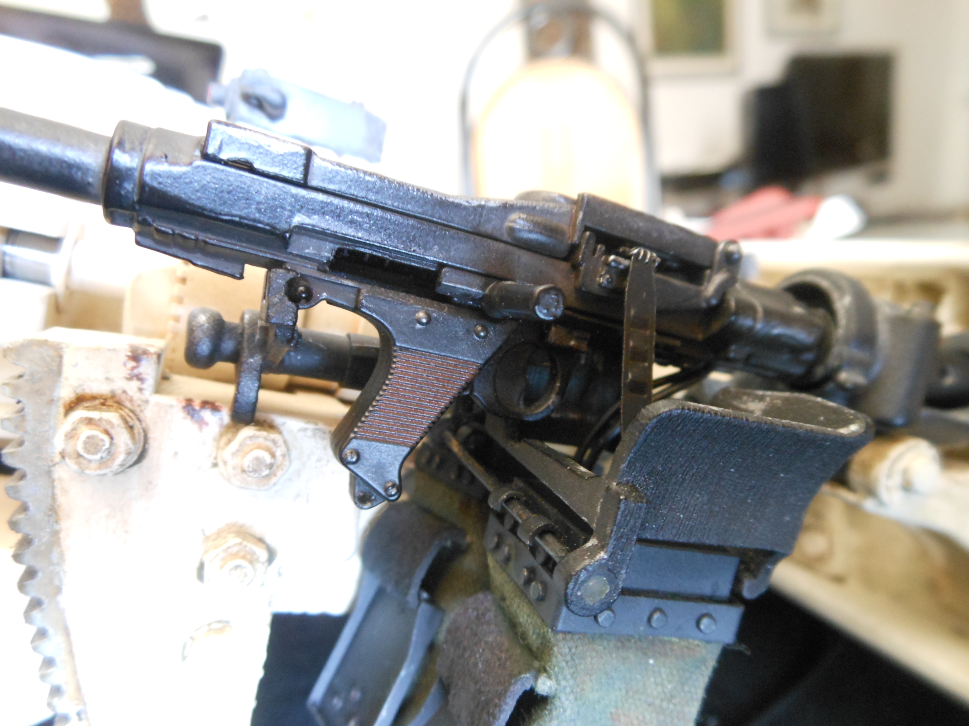

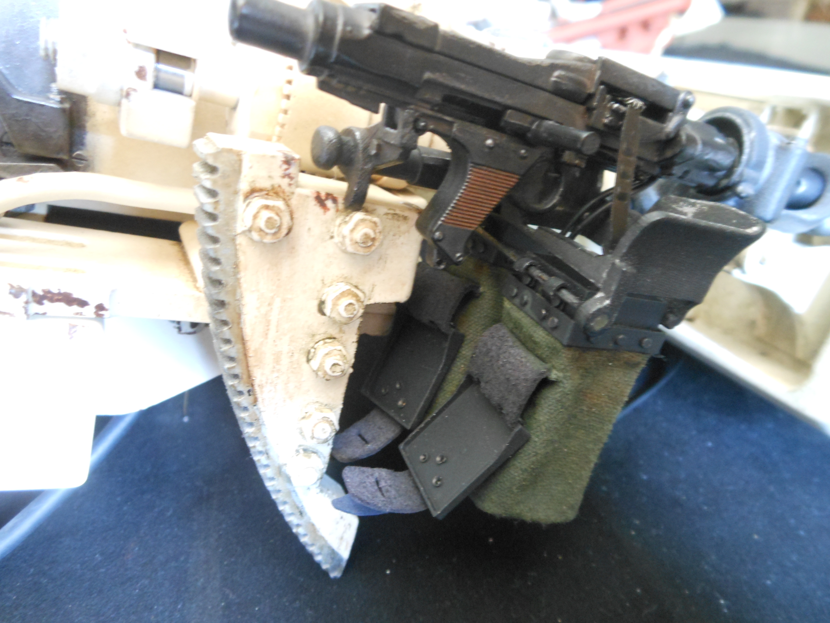

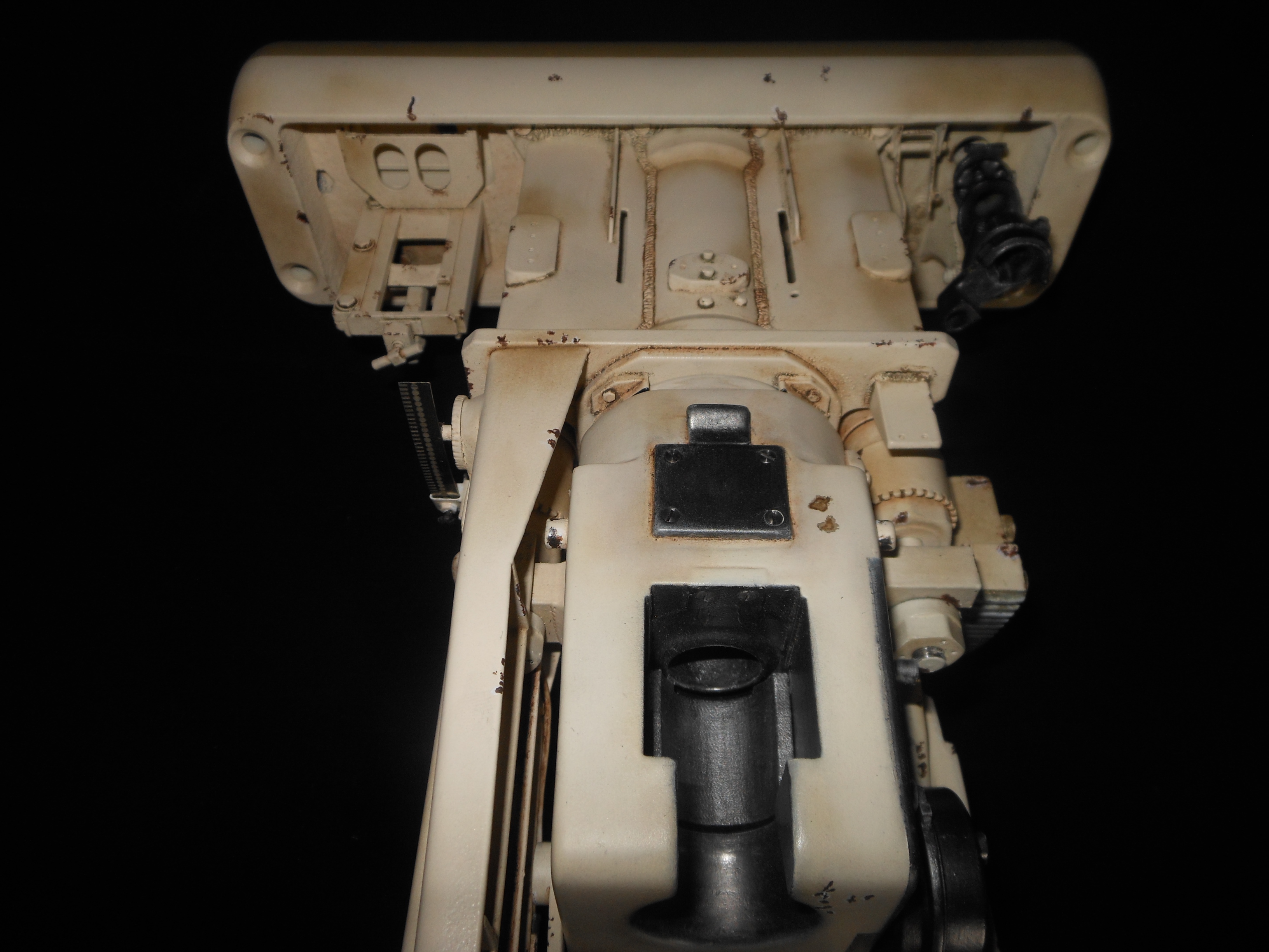

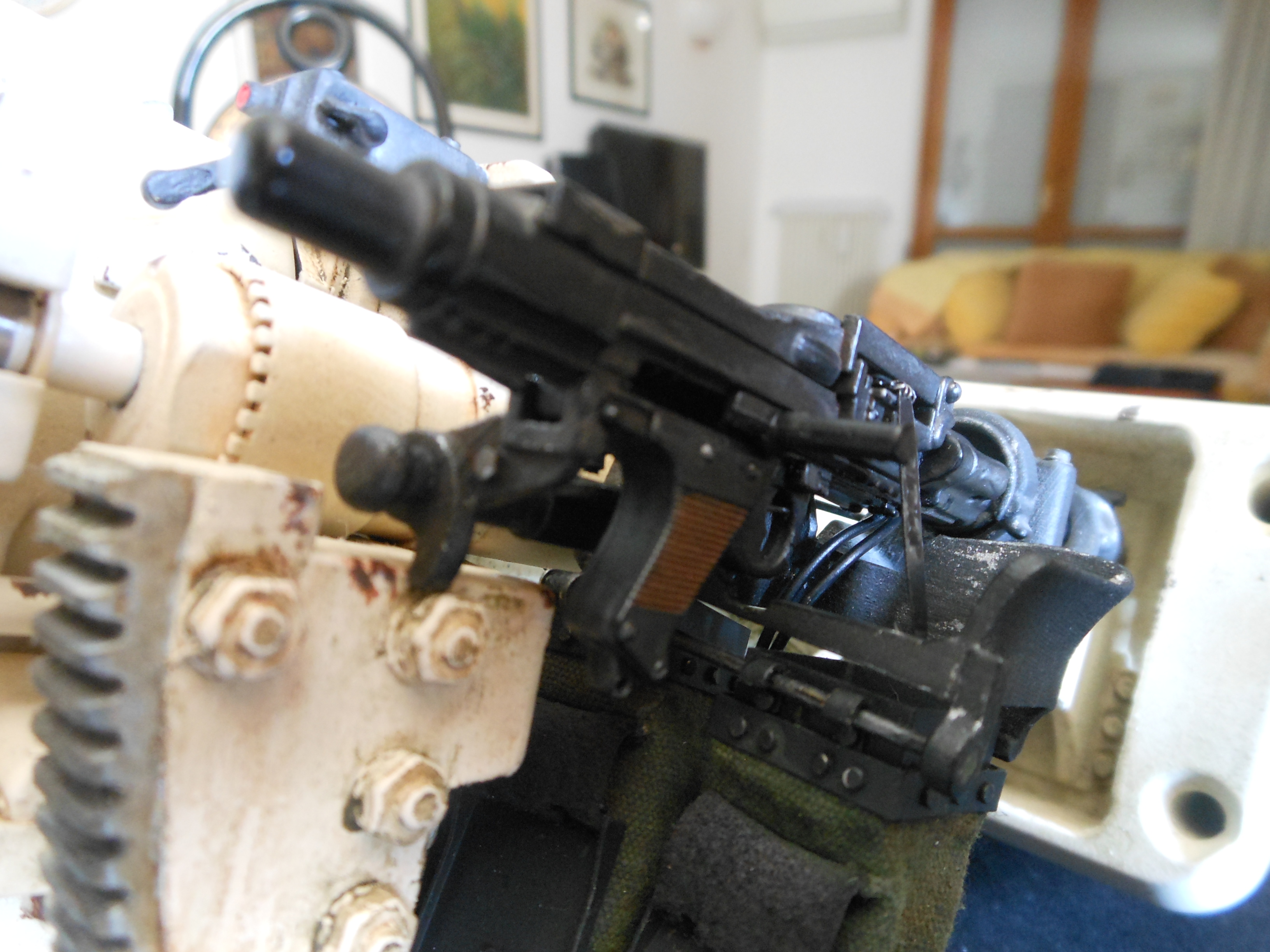

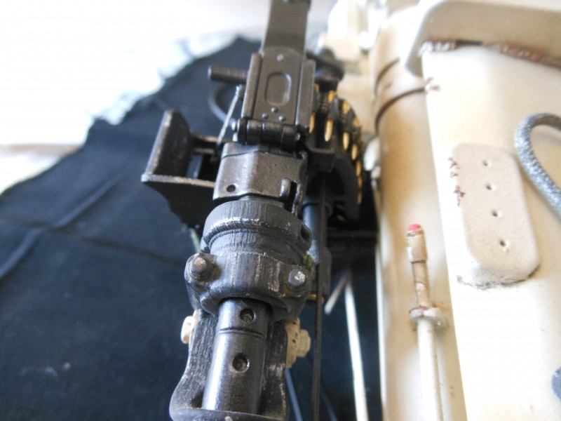

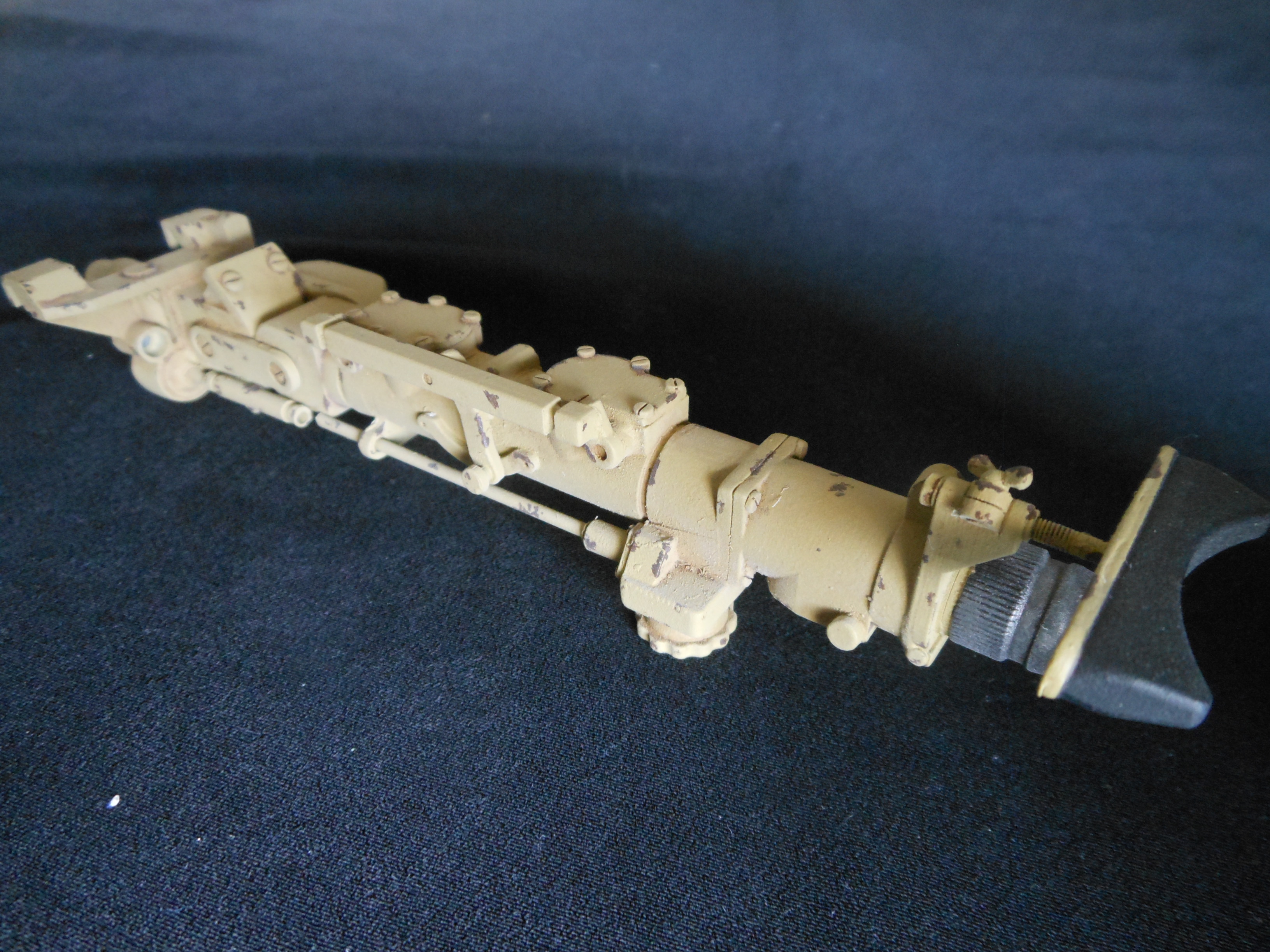

Mounted MG 34 with double gurtsack
Ivano Costantini
Posts: 533

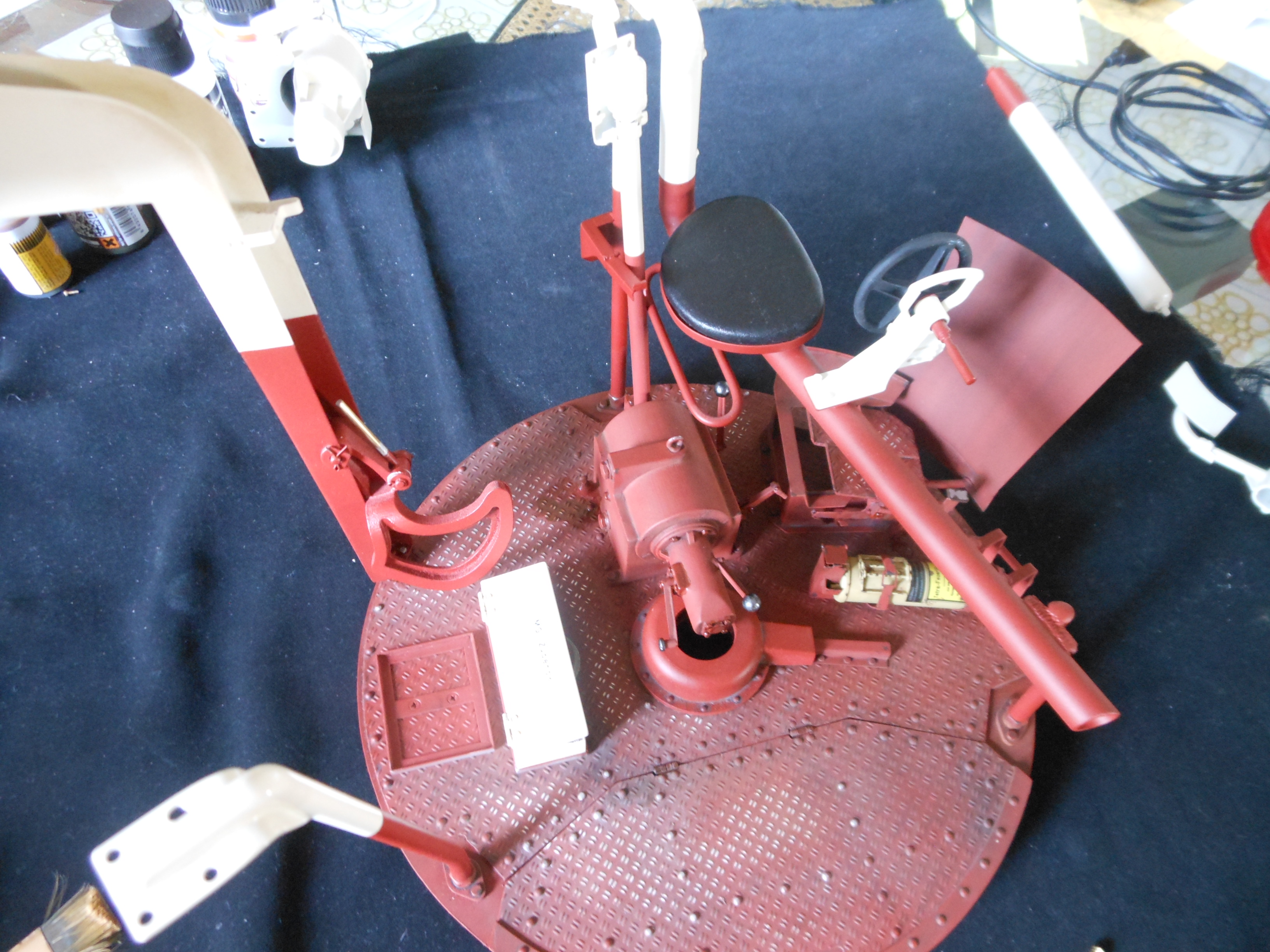

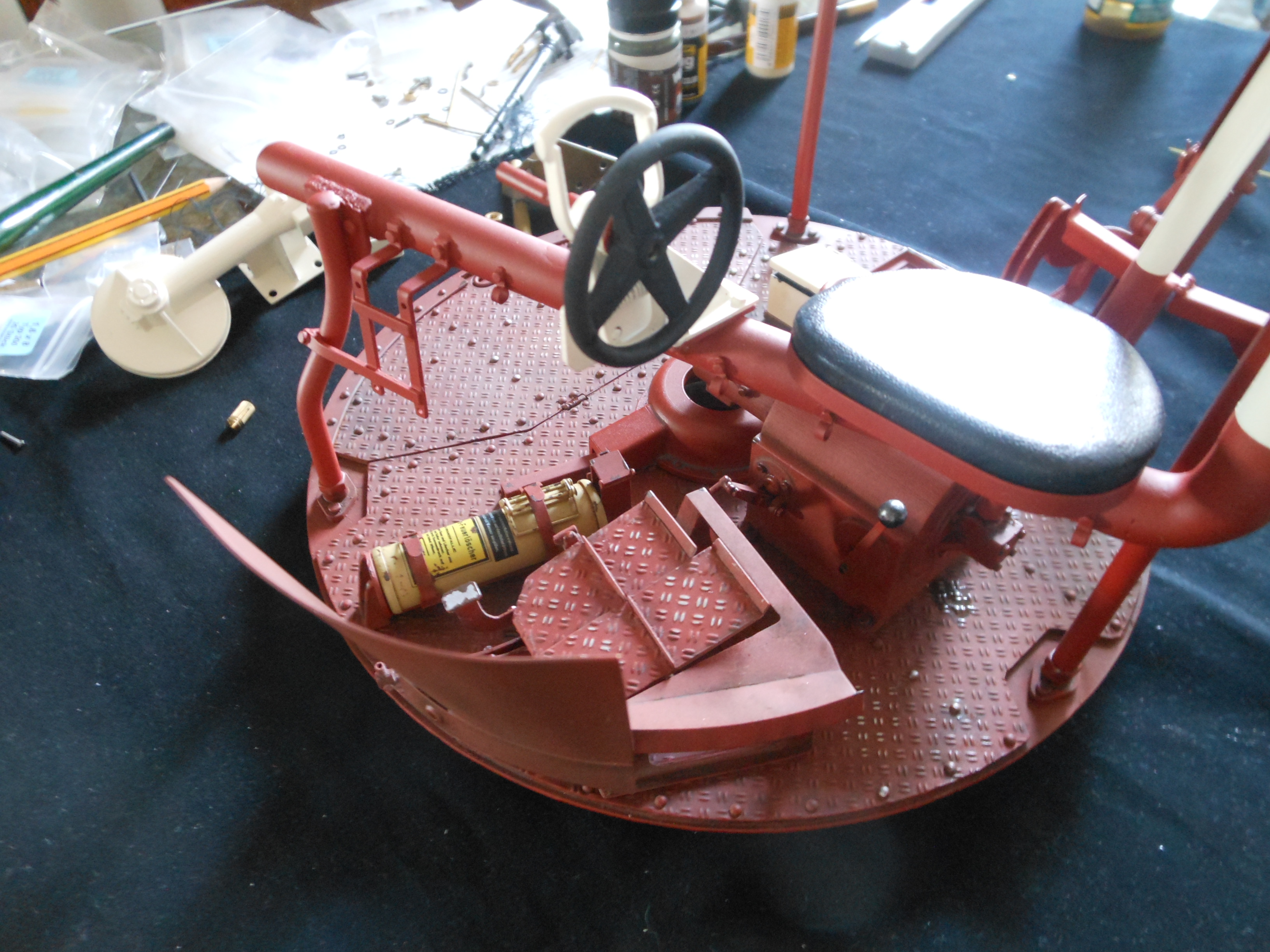

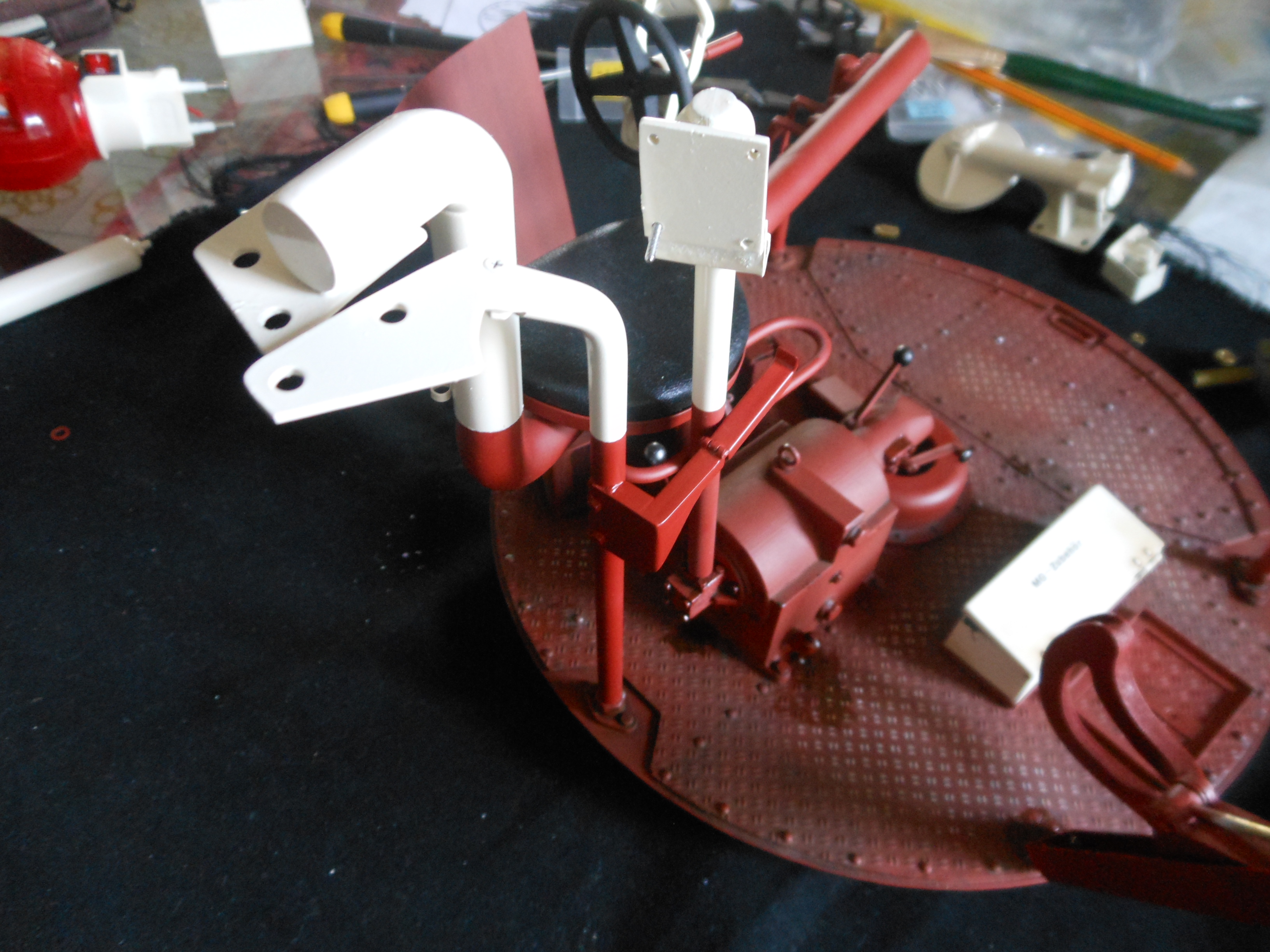

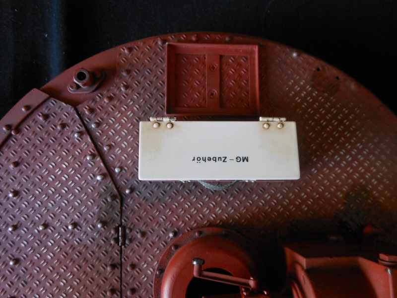

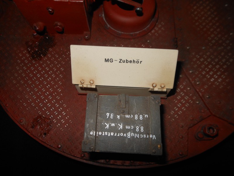

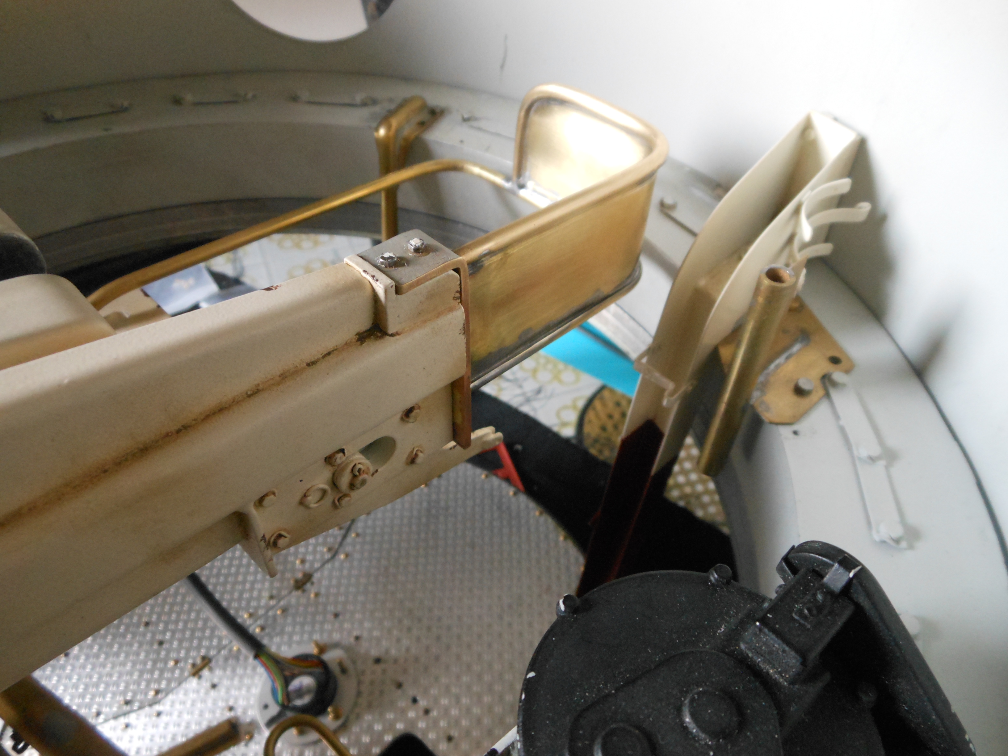

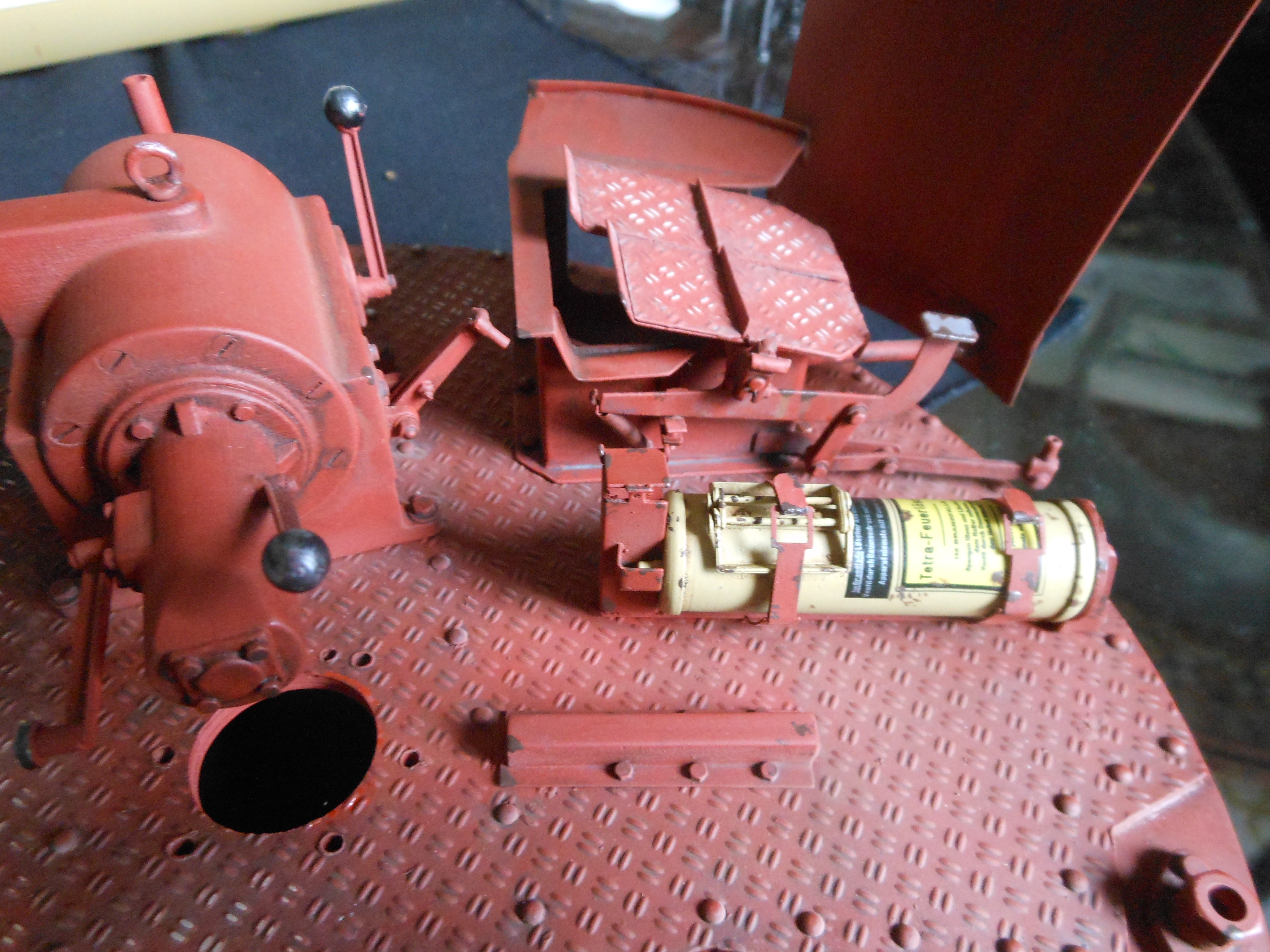

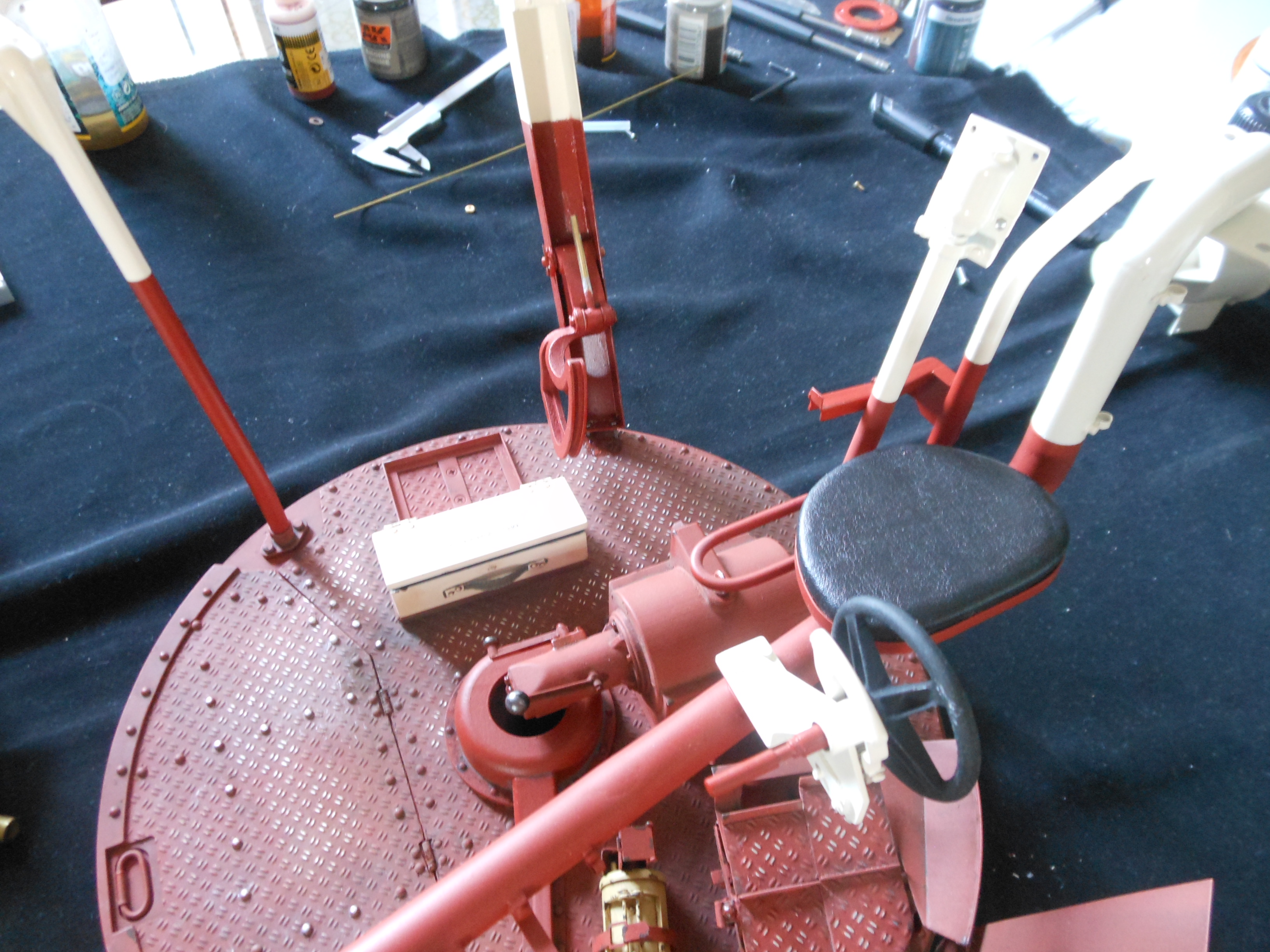

some photos of my turret floor
