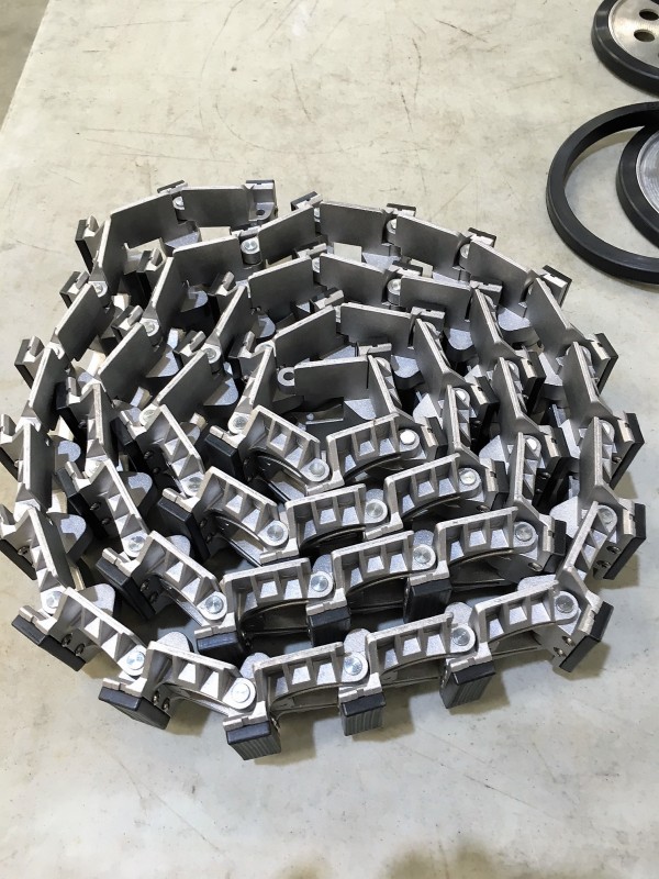

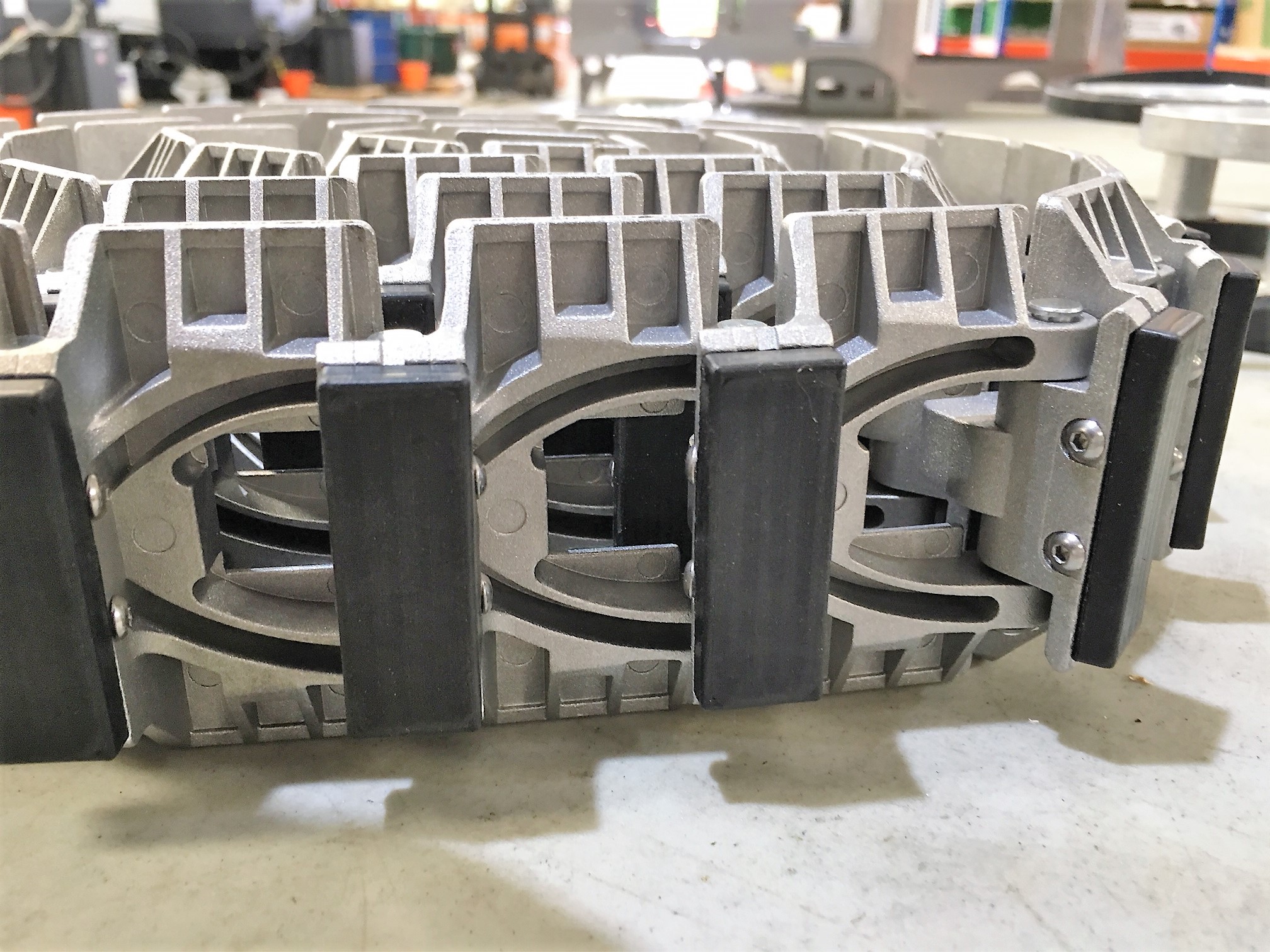

I’m not an engineer but I do believe strength to weight ratio is very high at this size. Cheers!Simon Peck wrote: ↑Wed Jun 20, 2018 5:16 amI meant will the links themselves be strong enough? Perhaps they are cnc’d steel?

Steel would put too much weight and stress onto the running gear - the links are cast aluminium.Simon Peck wrote: ↑Wed Jun 20, 2018 5:16 amI meant will the links themselves be strong enough? Perhaps they are cnc’d steel?

Reference the track query, I'm sure Armortek will have thought about the narrower tracks being under considerable load and adjusted the design and material accordingly, it would be a bugger to have ordered 60 pairs plus of track links that may break when towing a disabled Panther!

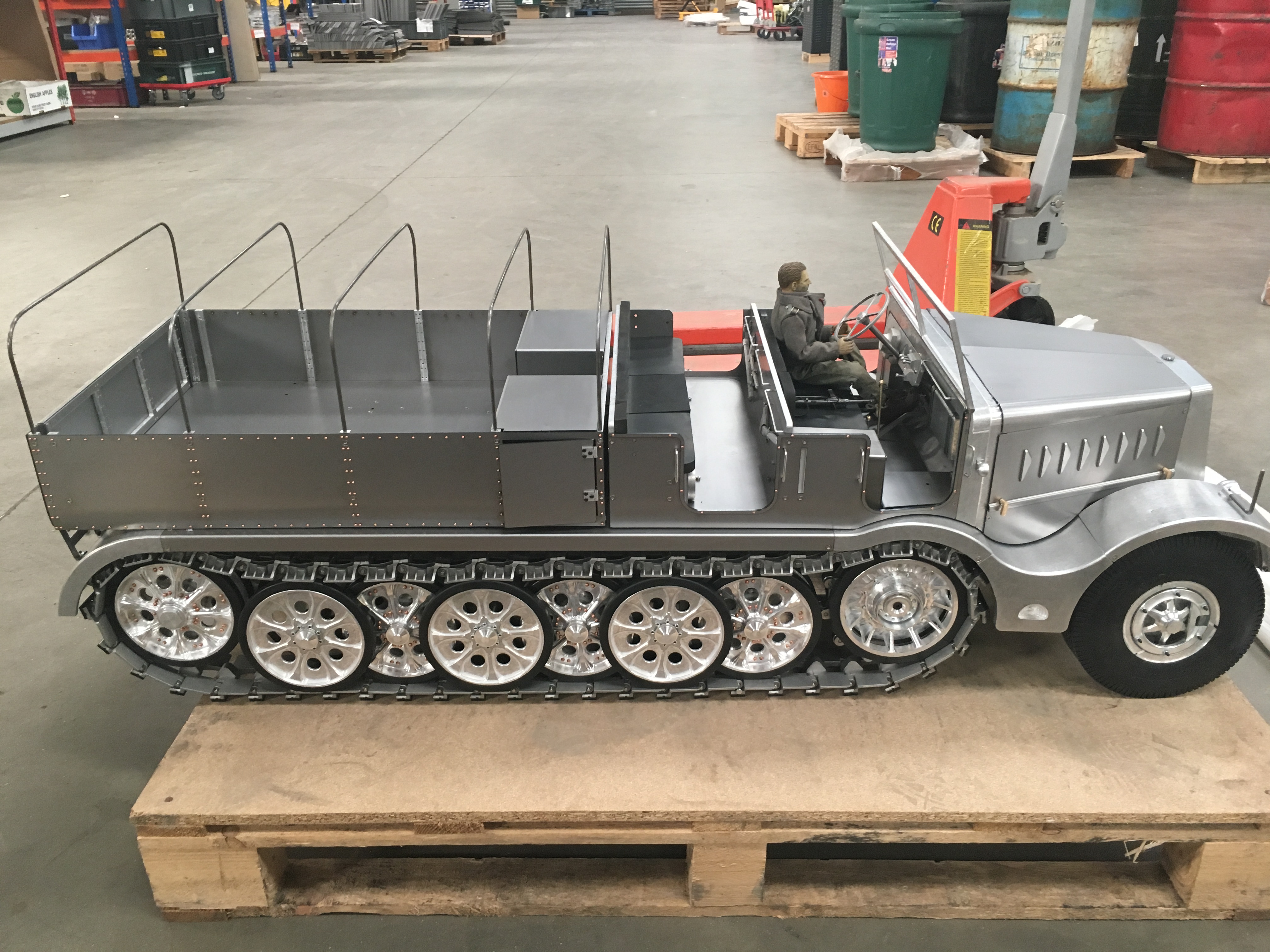

This will probably be the last photo until we show the Famo off at TankFest next weekend ...

Just some thoughts to track links:
In the last 5 years we unfortunately saw at least one broken track link in Hausen every year. Track links are highly loaded parts of a tank model, because they get a strong strain if they try to get out of the guideway slots of road wheels and idlers when curving. Aluminium track links may break under this load. (Sorry for my english using a translation program; I hope you understand what I mean.)
Track links made of steel may perhaps be a suitable option; this show my three models which are equipped with. They make no trouble till now; the oldest modification since 2010. But steel track links need some precautions at the whole drive train to prevent it from excessive wearout by using harder materials for road wheels, idlers and sprockets.
My Armortek Jagdpanther got severe wearout of the drive train in a very short time by using steel track links. OK, they did't fit exactly, but the bigger issue was the extreme traction of this track links which prevented the model from curving on non-slipping grounds and caused the drive train getting out of the track links.

Prototype 90% complete and on its way to TankFest at the Tank Museum in the UK.
