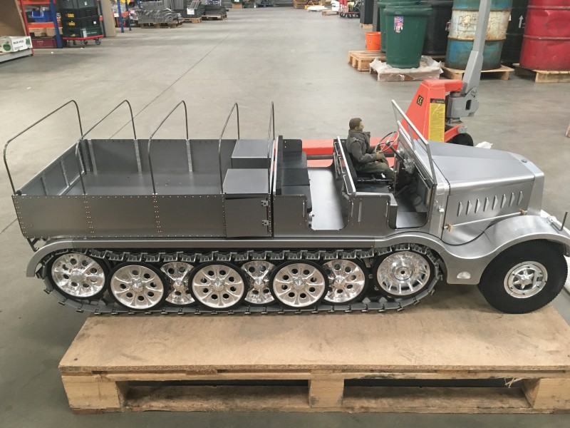

This will probably be the last photo until we show the Famo off at TankFest next weekend ...

Prototype 90% complete and on its way to TankFest at the Tank Museum in the UK.

Re: Famo prototype build
Wow!
Looks great, happy to say I am now on board
Can I ask what may be a dumb question though, how will the "X" reinforcing be repressed on all the side panels?
Pretty sure I read in one of my three reference books (went a bit nuts and got them first) that they "Punched" this impression into the metal plate to stop warping?
