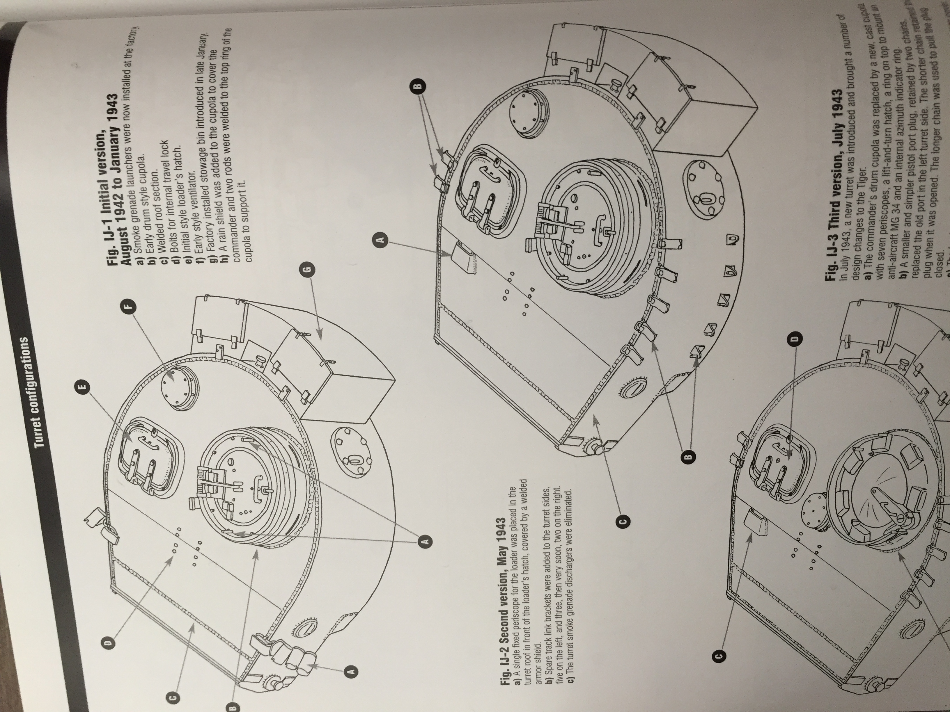

Post by Simon Peck »
I stand to be corrected; the ventilator (inlet fan) is under a armoured cover on the forward hull roof, between the driver and radio operator hatches. The extract on an ‘early’ Tiger is towards the rear of the turret roof. It was later moved to abovevthe gun breach, but that’s a later version of Tiger than yours. The pic should help.

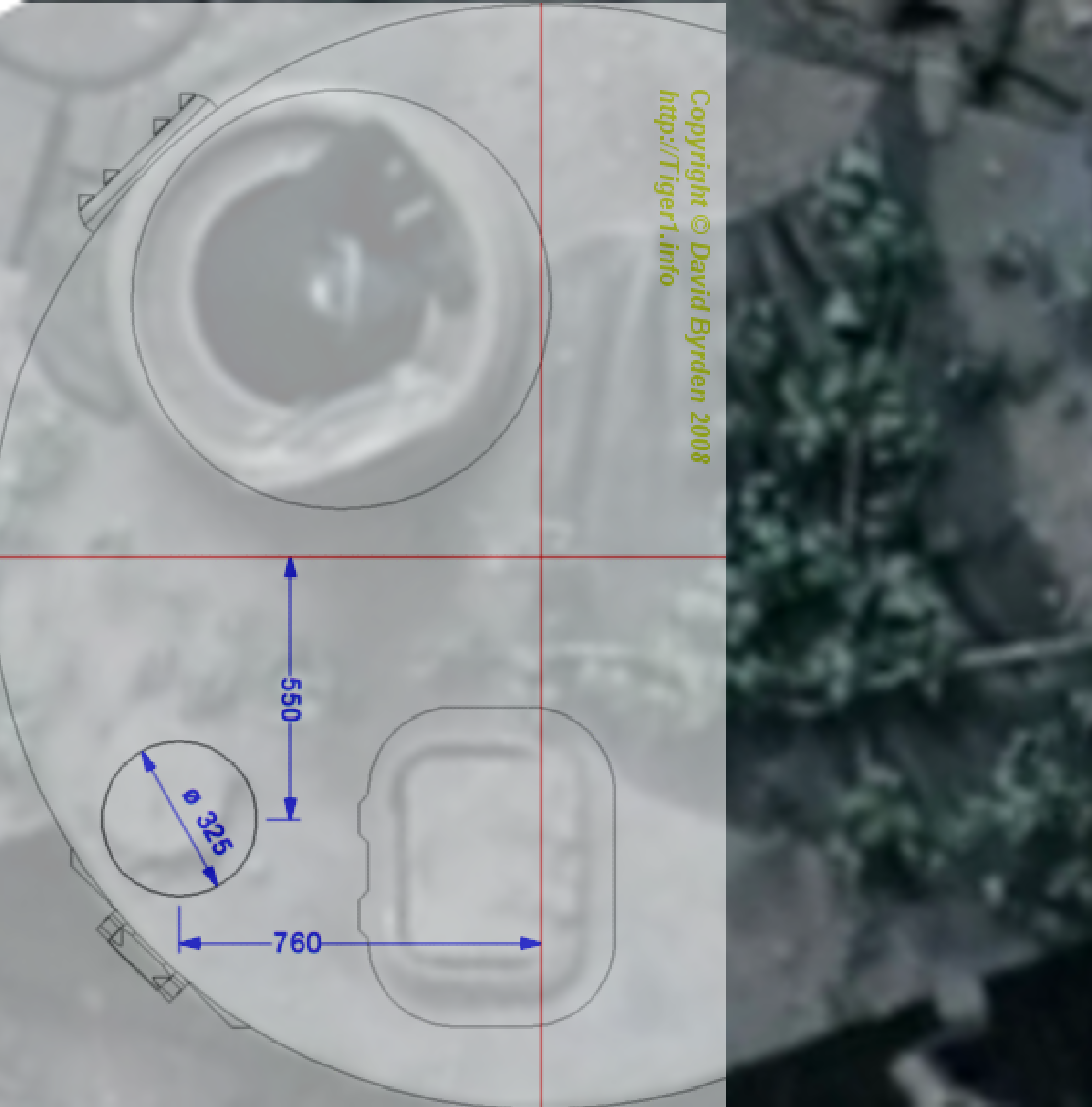

I did mean the ventilator fan. The bit I'm stuck on now is that if I follow the position given in http://tiger1.info/EN/First-turret-fan.html the fan seems to be too far forward and to the right.

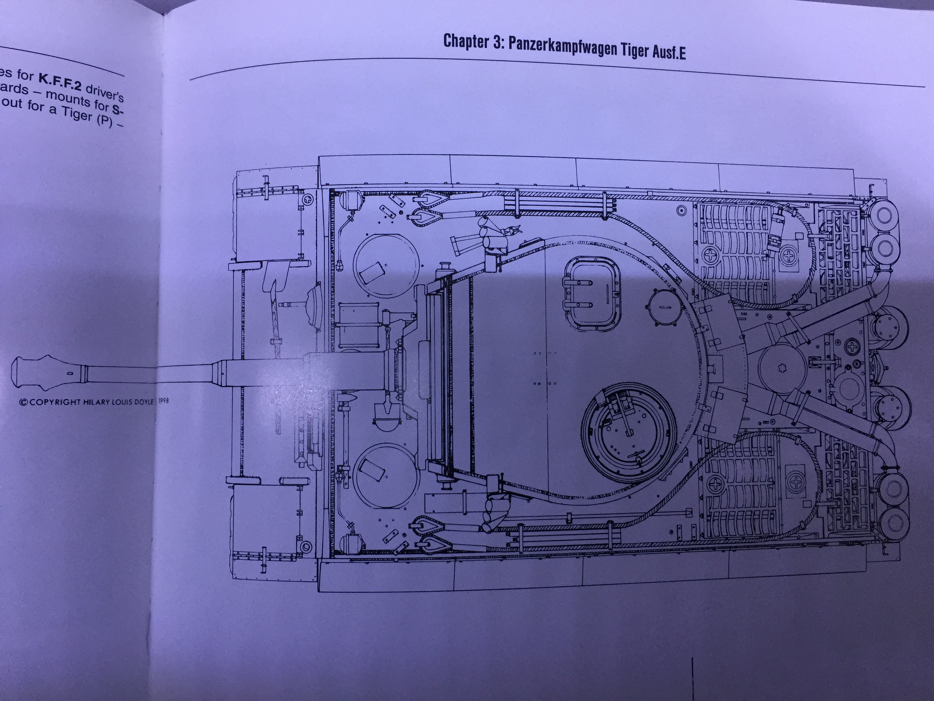

All the other photos/diagrams I can find including:
seem to show the side of the stowage box "pointing" near to the centre of the fan.
Looks like a good book, which one is it?

Re: Early Tiger 1 - 2003 vintage - turret deck bend
Allowing for some distortion because the photo isn't directly overhead, the diagram and the photo line up quite well, which means there may be an error in the dimensions.

Thanks Adrian,
Great minds.. I've spent the weekend going crazy comparing eight different images fading them in and out.
Even more pronounced against Fury/131/(CGI?)
All the other sources I have seem to align. I might lift the position from the diagram in the Tamiya 1/16th instructions.
NB I checked and the numbers match the image proportions in the image from tiger1.info
Sam
