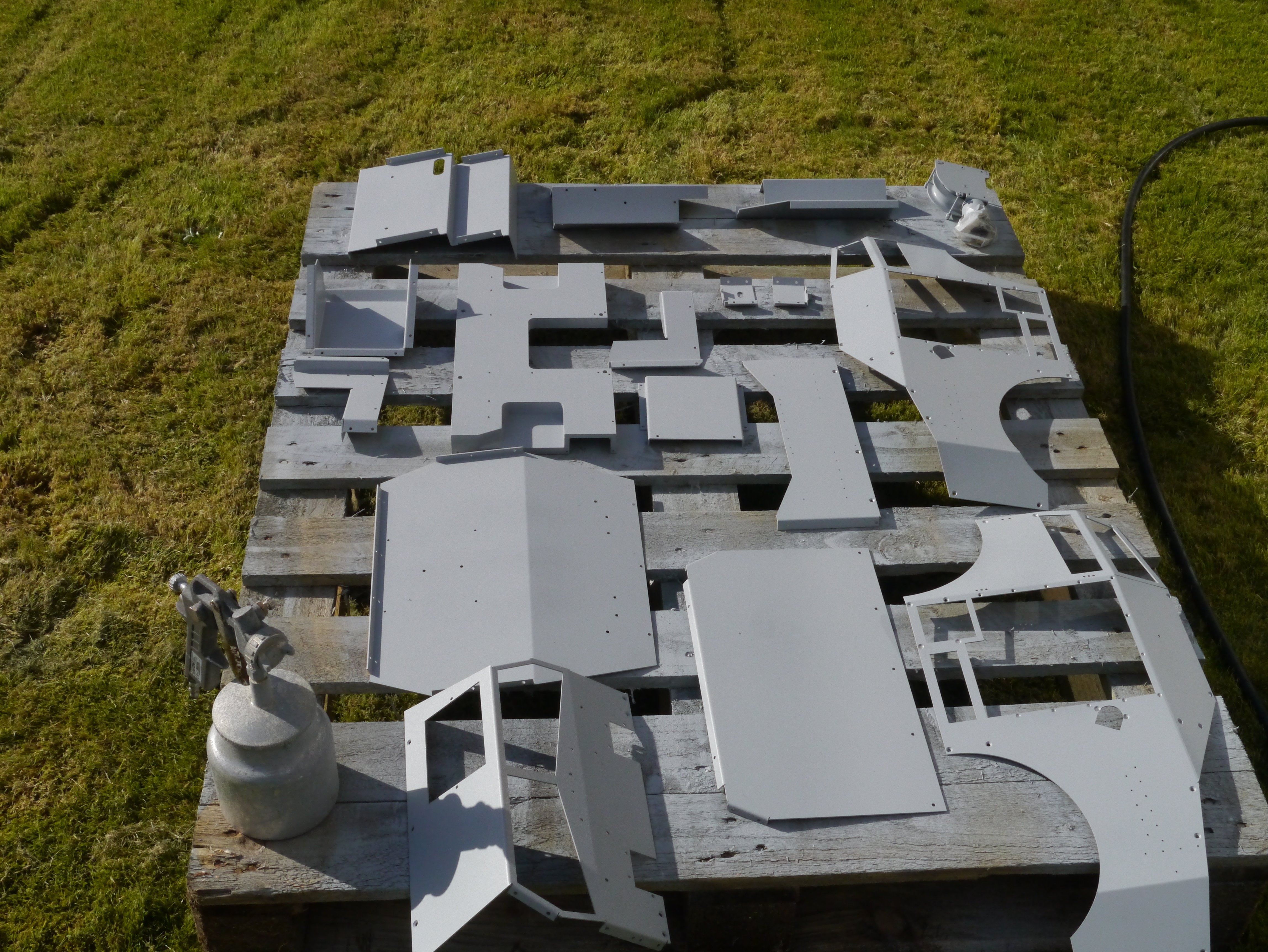

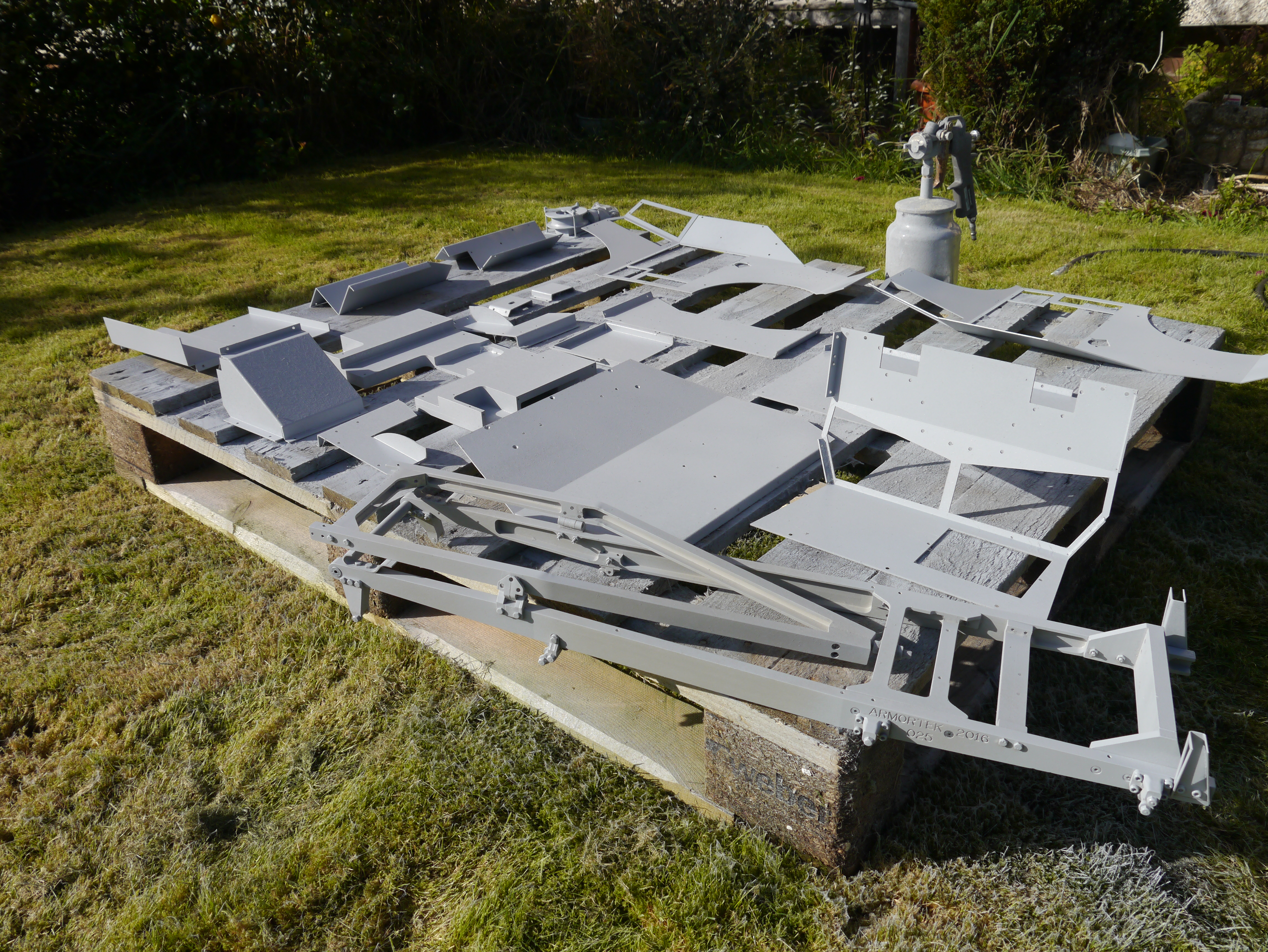

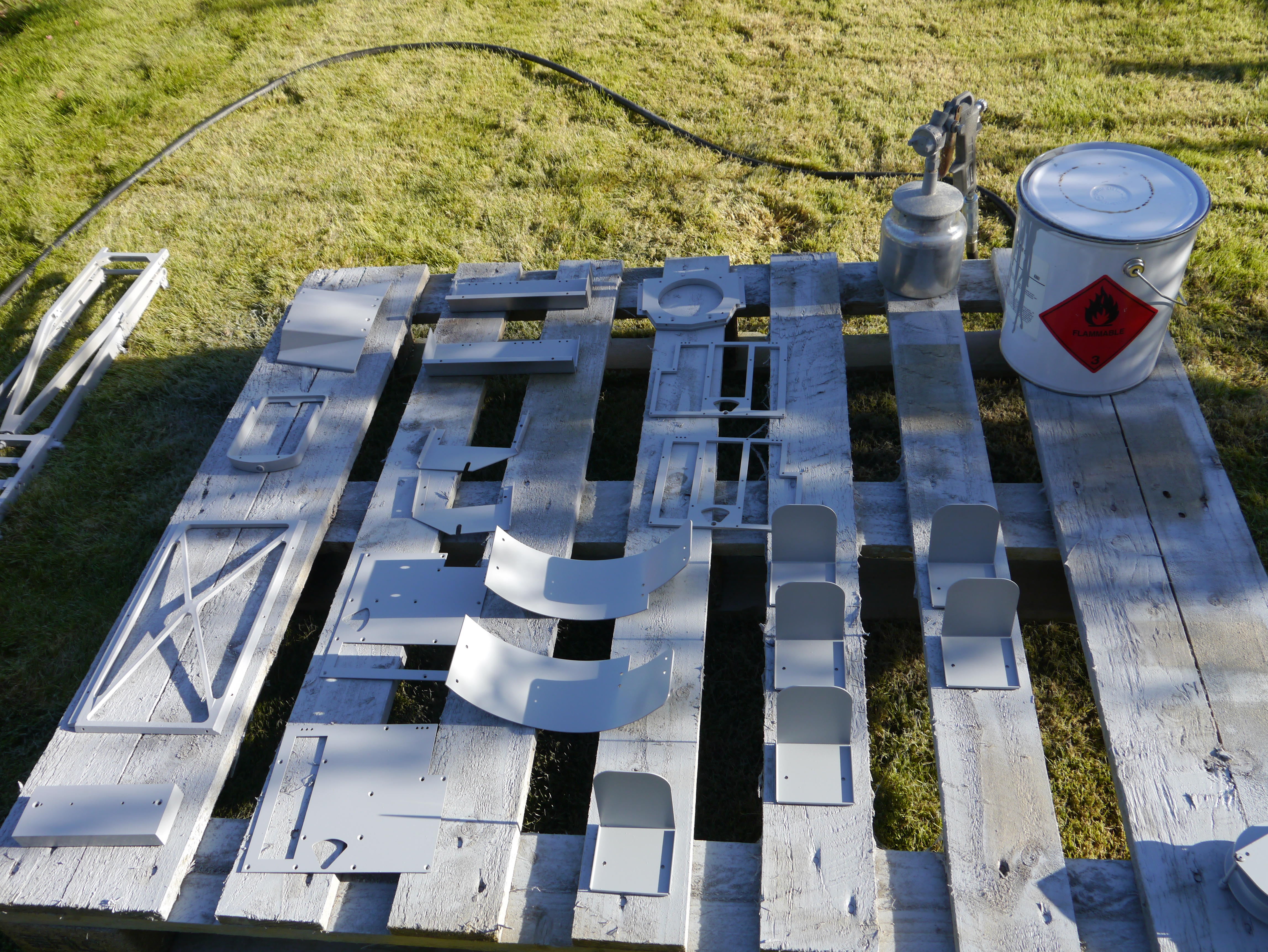

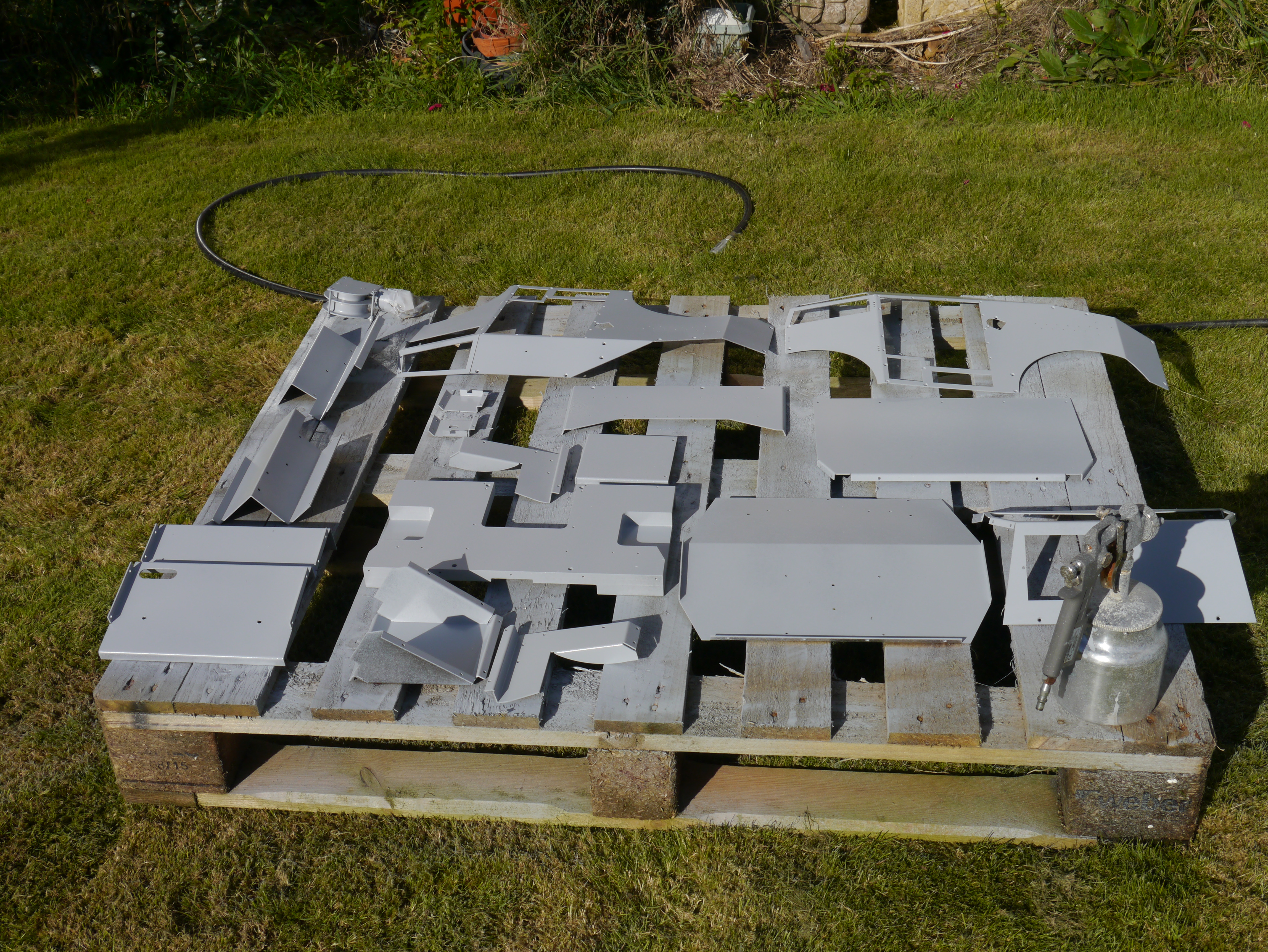

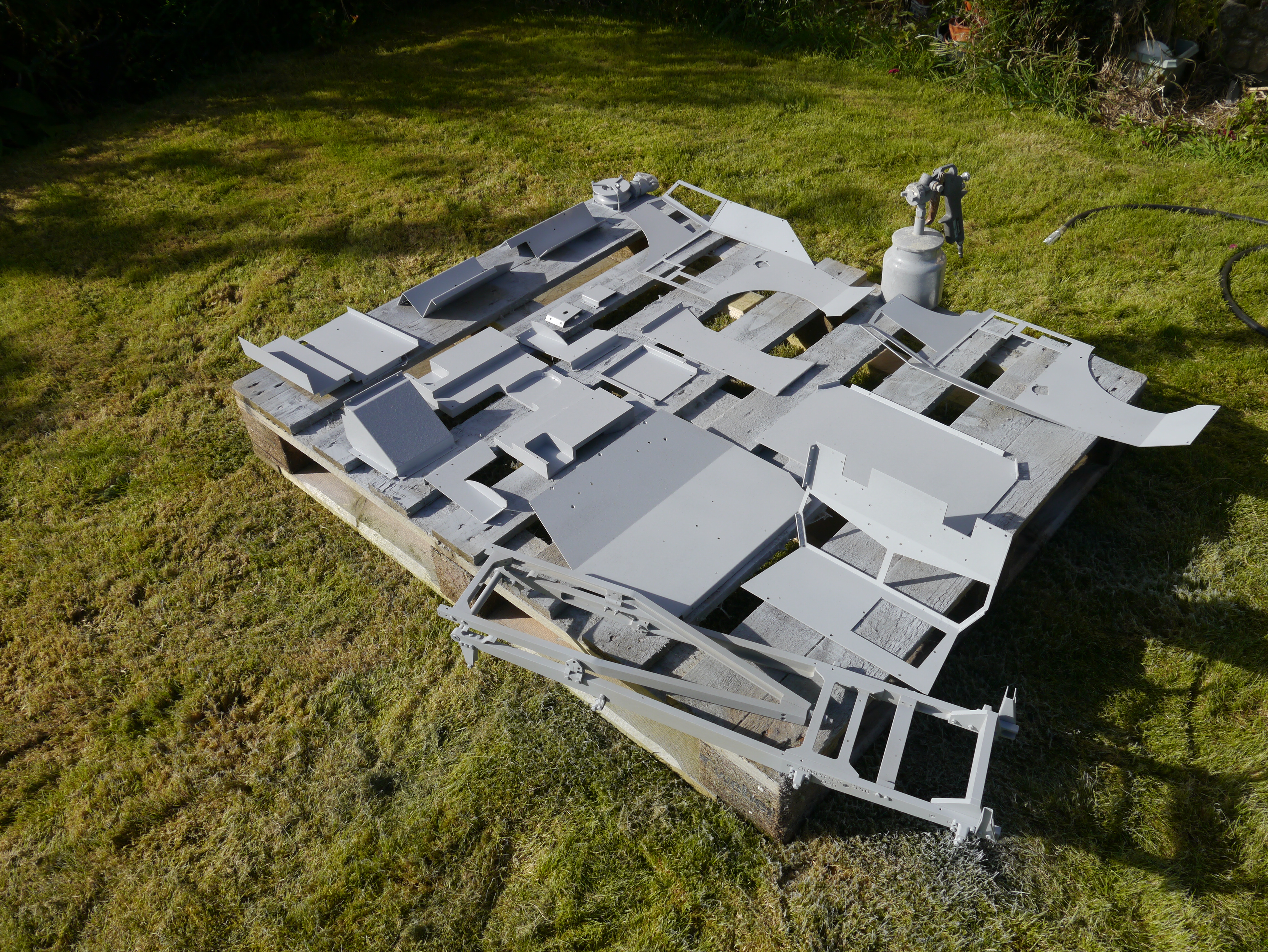

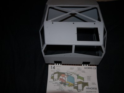

Decided to clean and etch prime the body work as it was a nice day.

Hello Walter, you are well on the way with your build, watching with interest. It is useful to follow a build....irons out any unforeseen problems.....best wishes.....Mick

Re: First Quad's arrive with customers
Hi all
Done well to day. Now time for a rest, tomorrow is another day.
Regards Walter.
Regards Walter.

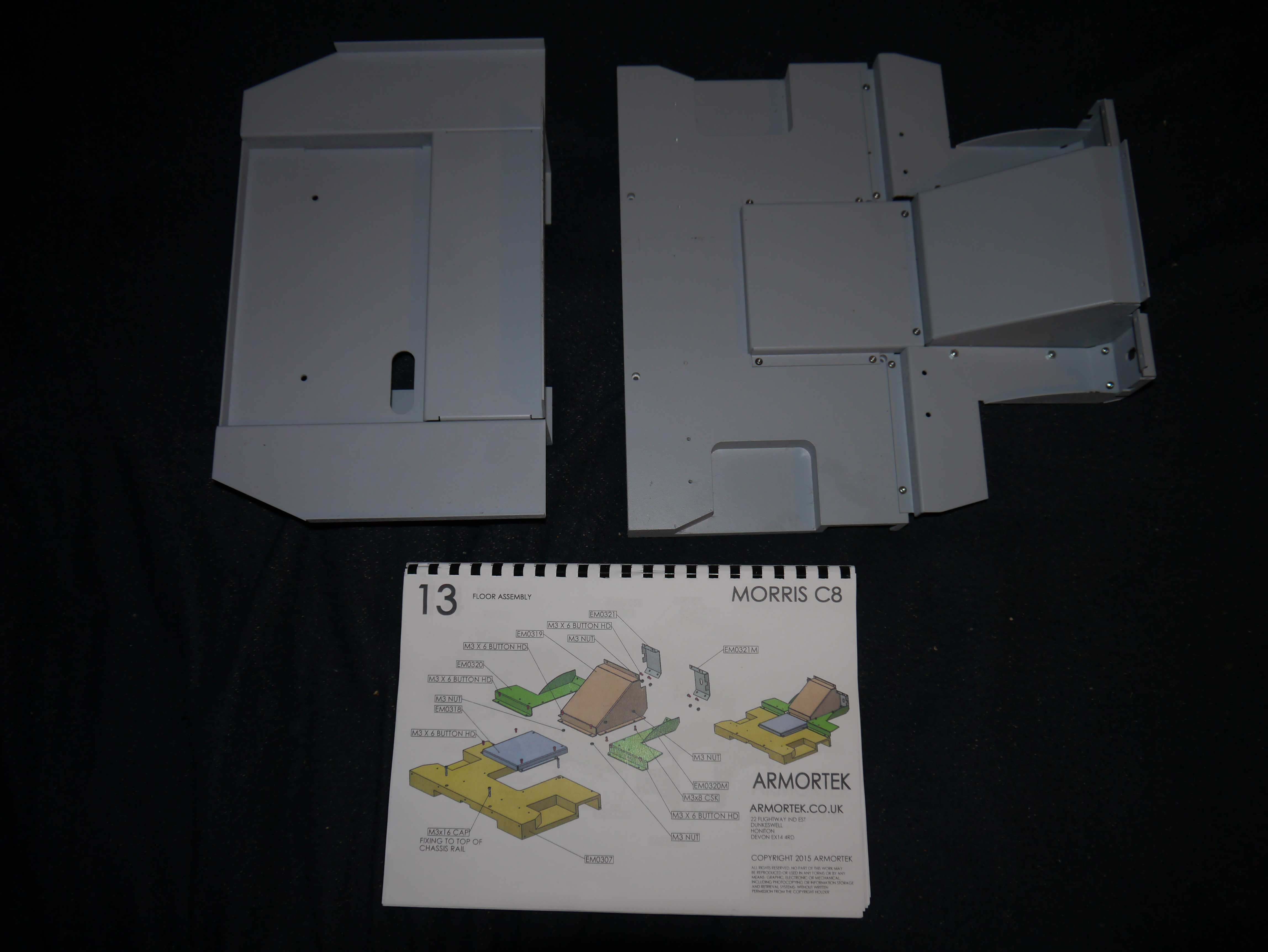

Number 14 arrived in Holland nice part's, now priming with temperatures above 15 and in the winter building.
Regards William
Regards William
