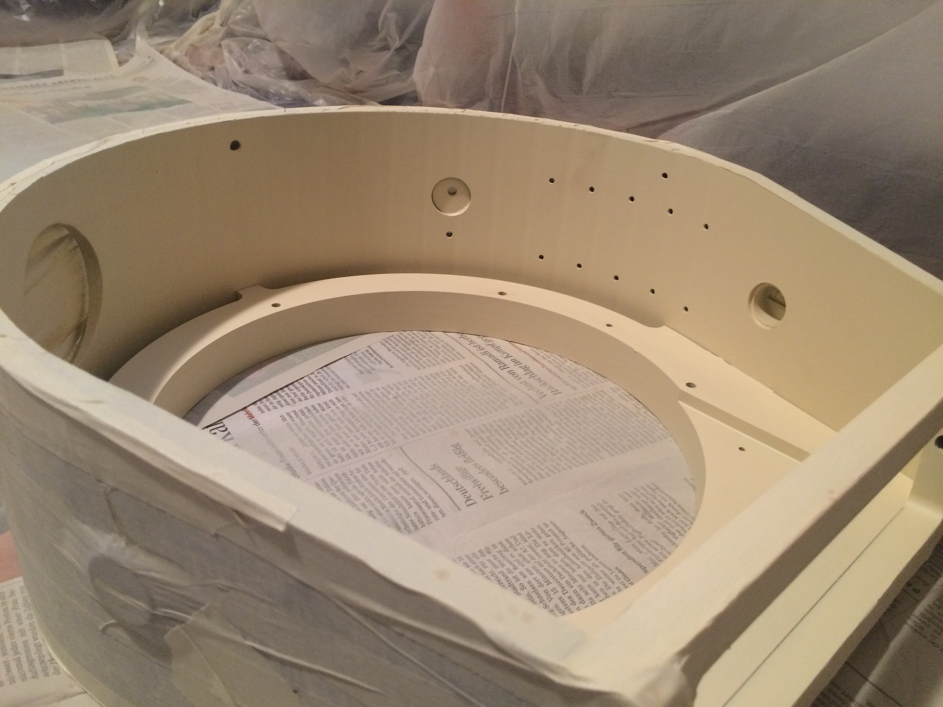

Hallo Kent,
I thought that the inside of all covers had the colour "Elfenbein" ?
Hello Kent,
I am not able to heck anything here in this forum or anything else.
I am very happy to play and fight with my ipad.
Regards Martin

Post by mark lawson »
Martin no the inside of the hatches was to be painted the same as the outside this is so when the hatches are open they don’t stand out from a distance with the potential of drawing fire.
Which abteilung will you assign your Tiger when completed.

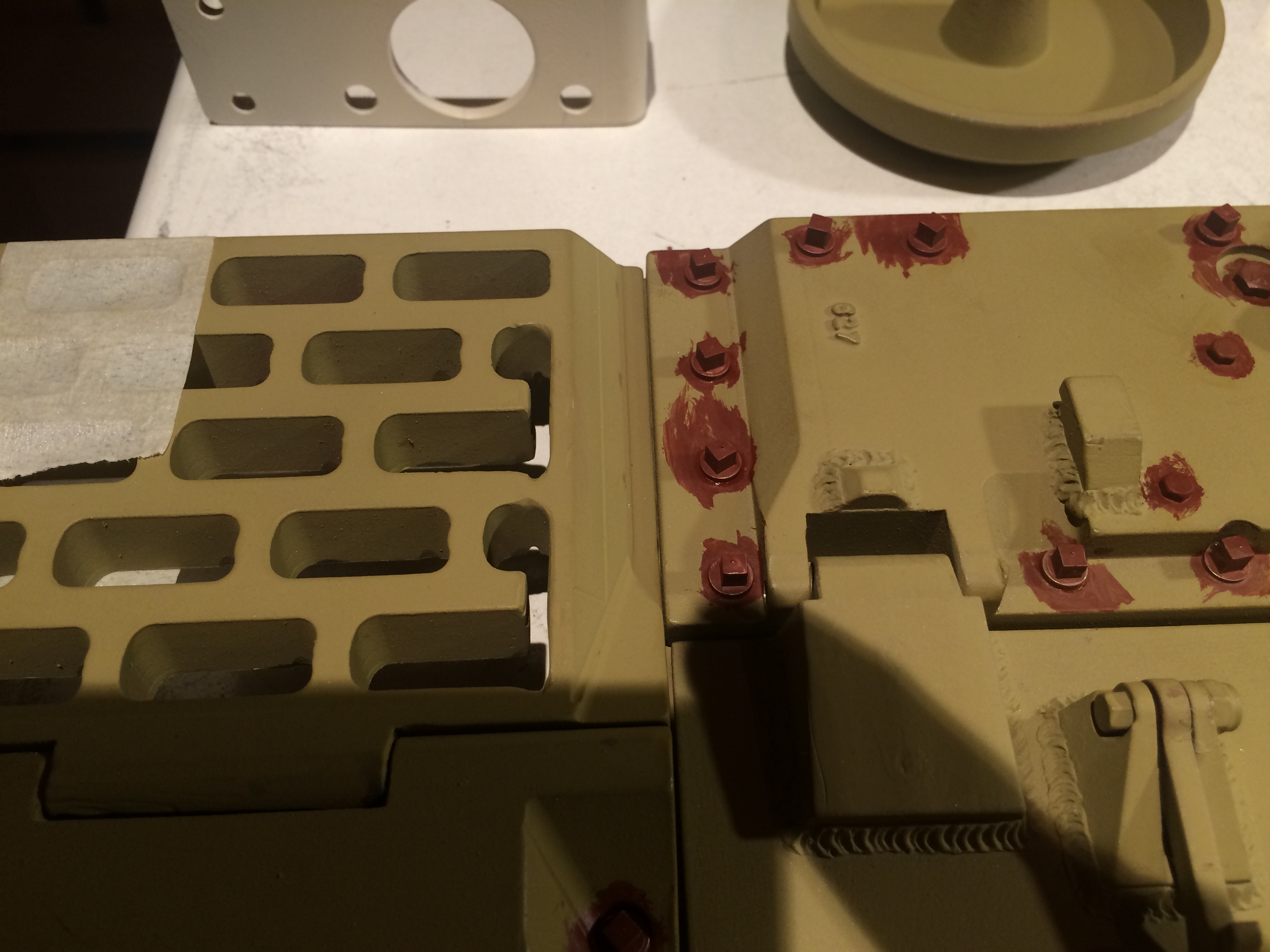

Hello Mark,
i don't know exactly which abteilung she goes.

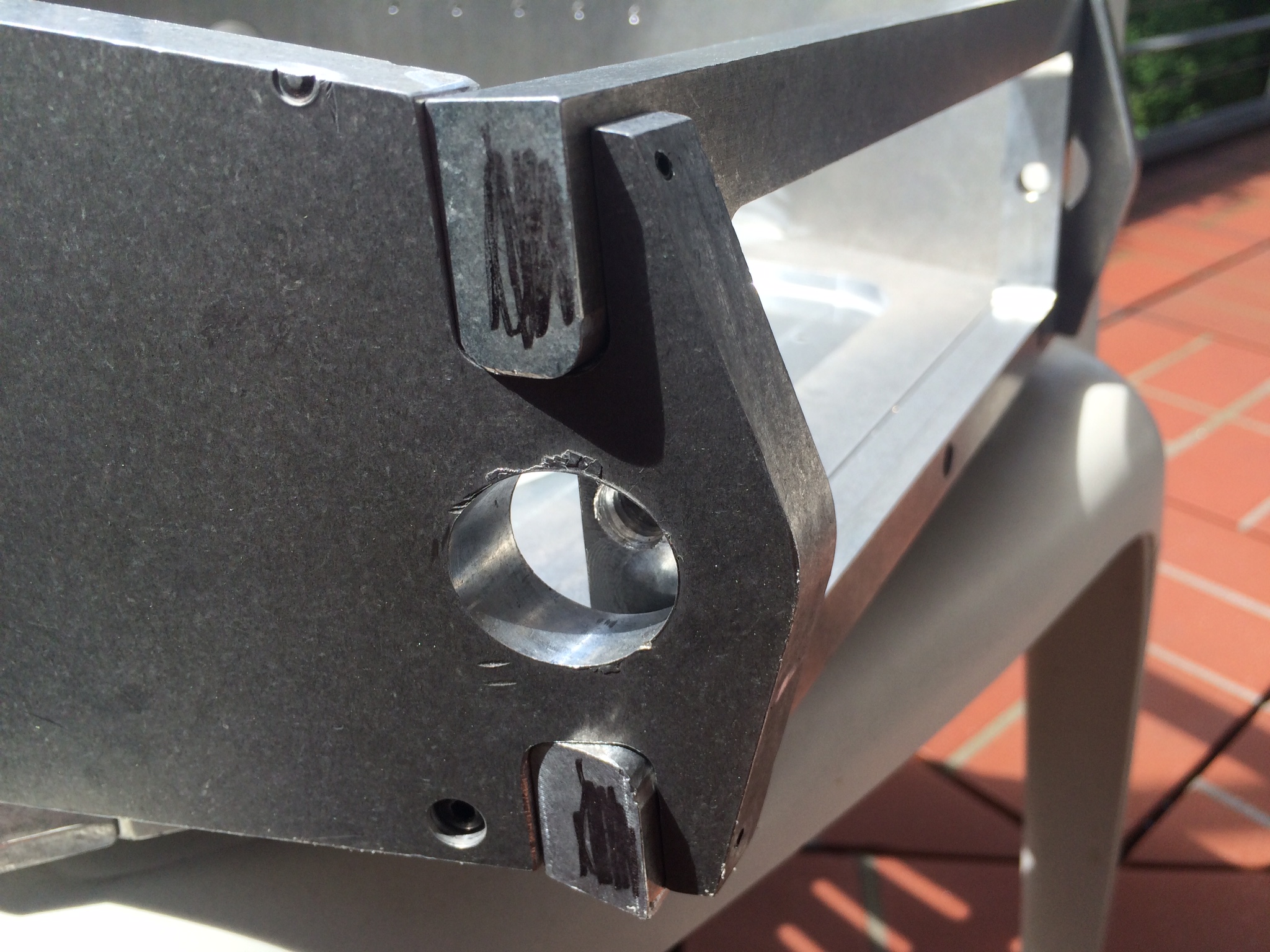

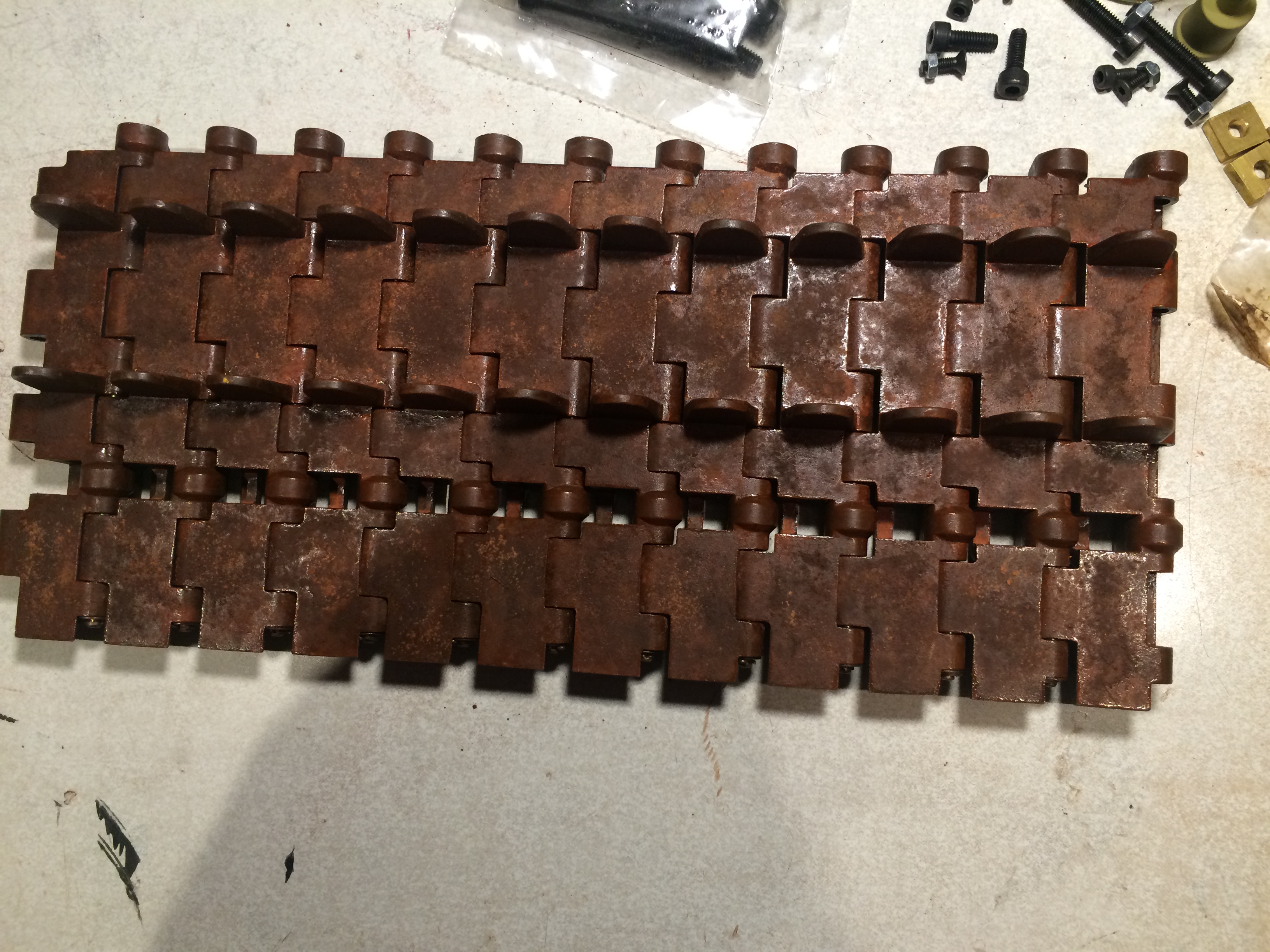

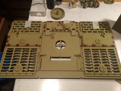

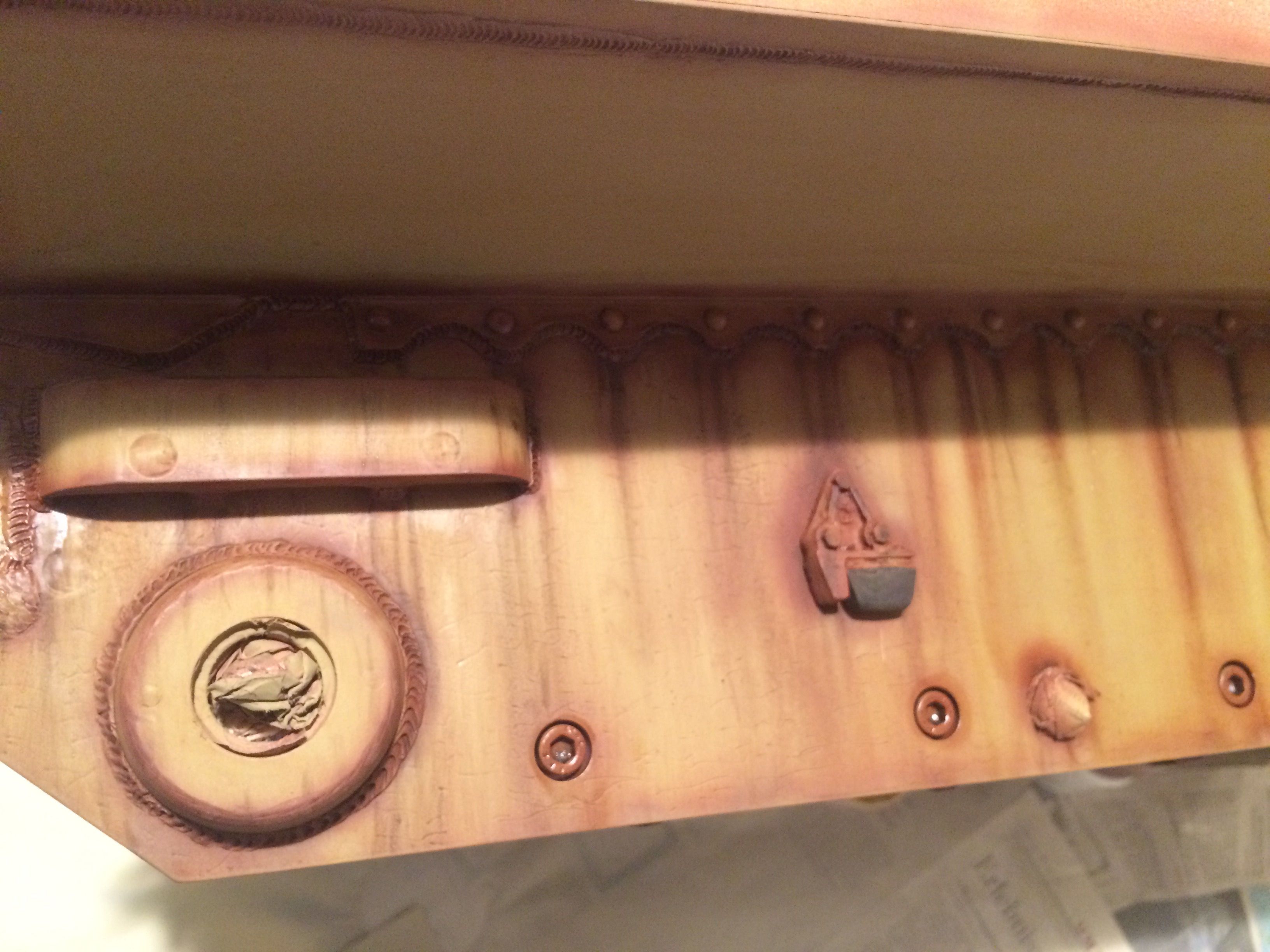

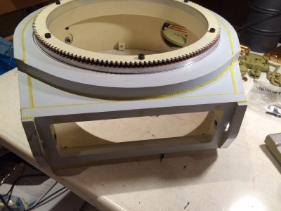

but here comes some pictures again.

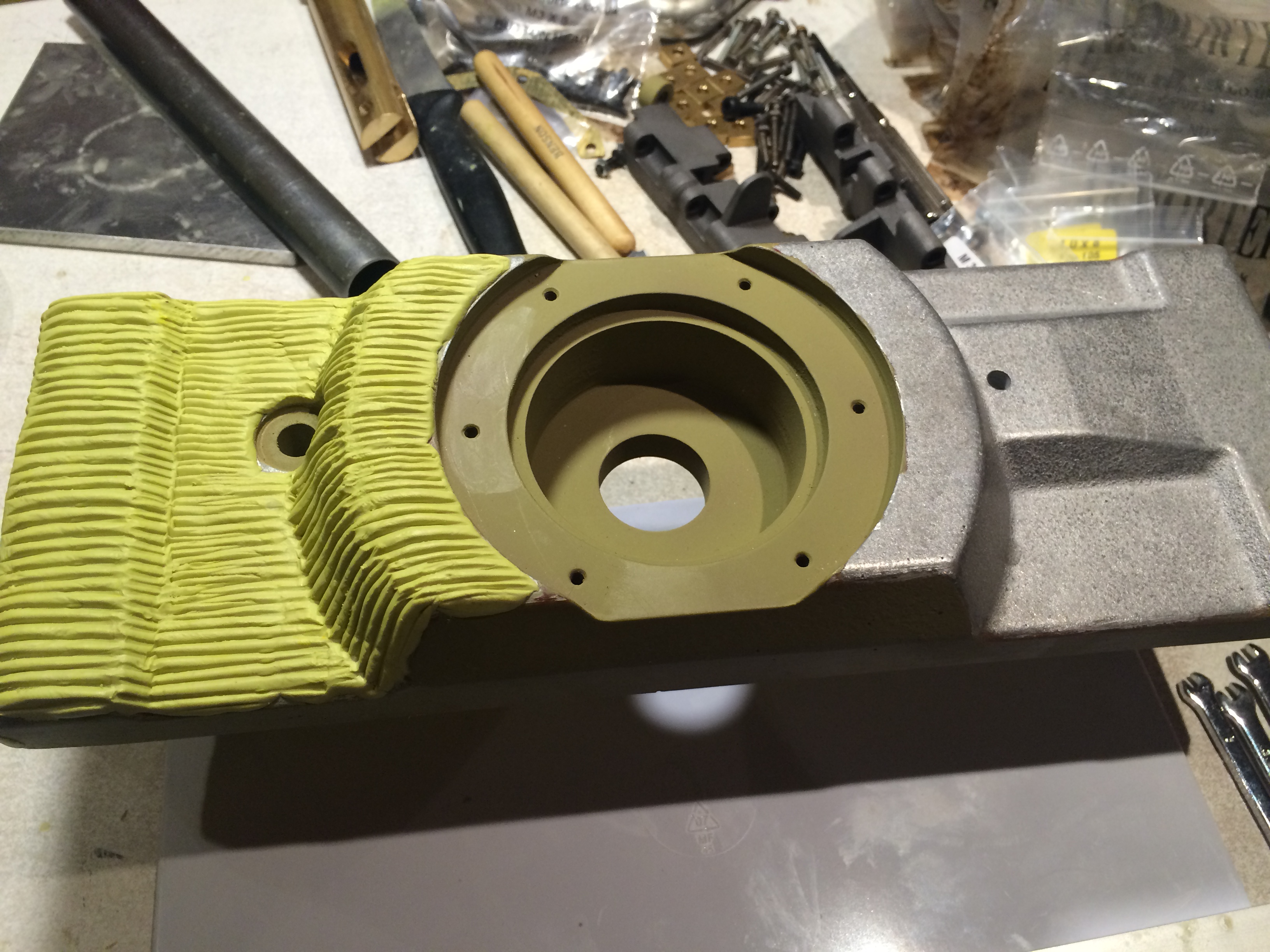

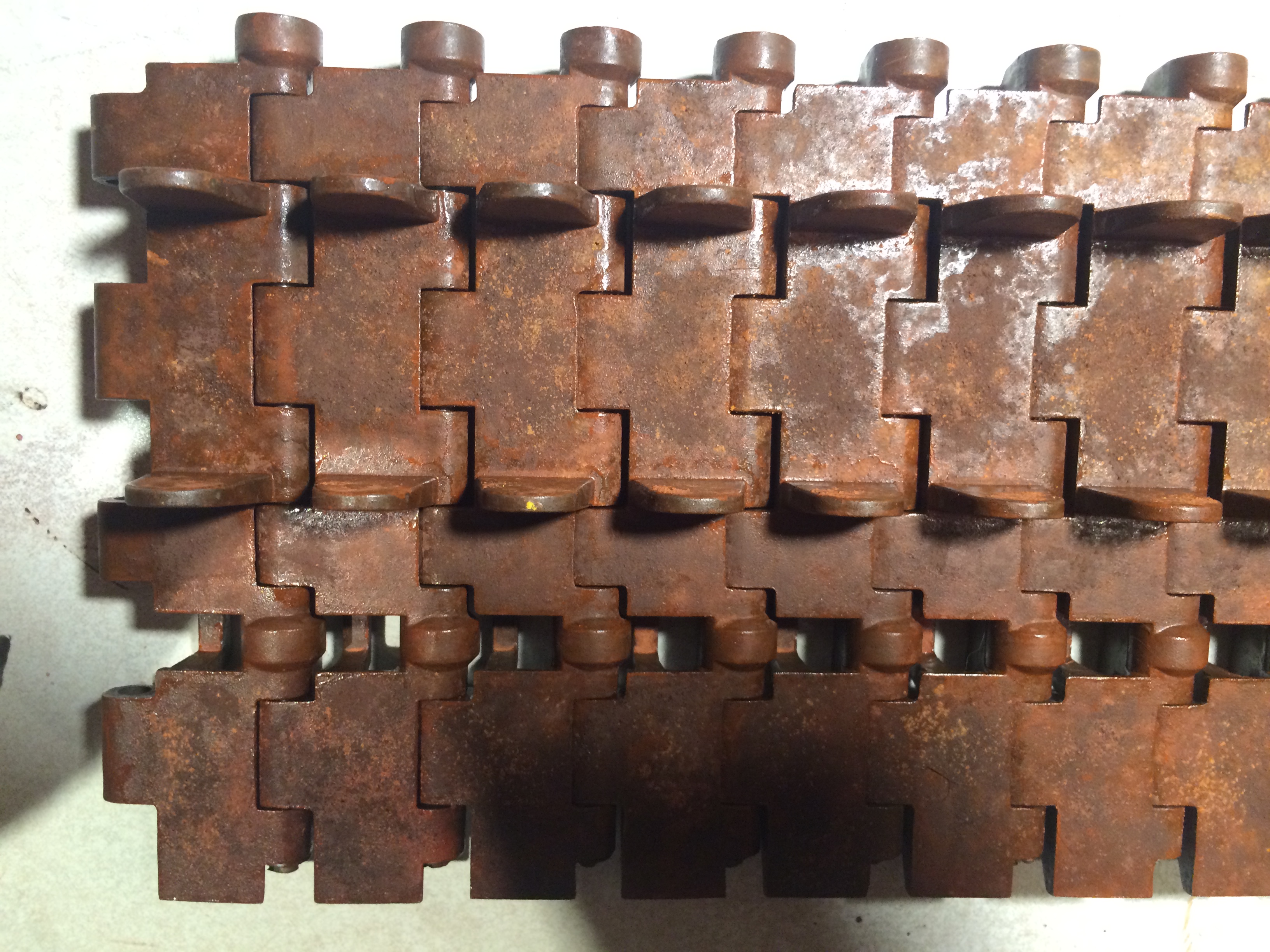

i start with the turret and the chain in front of.
Regards Martin

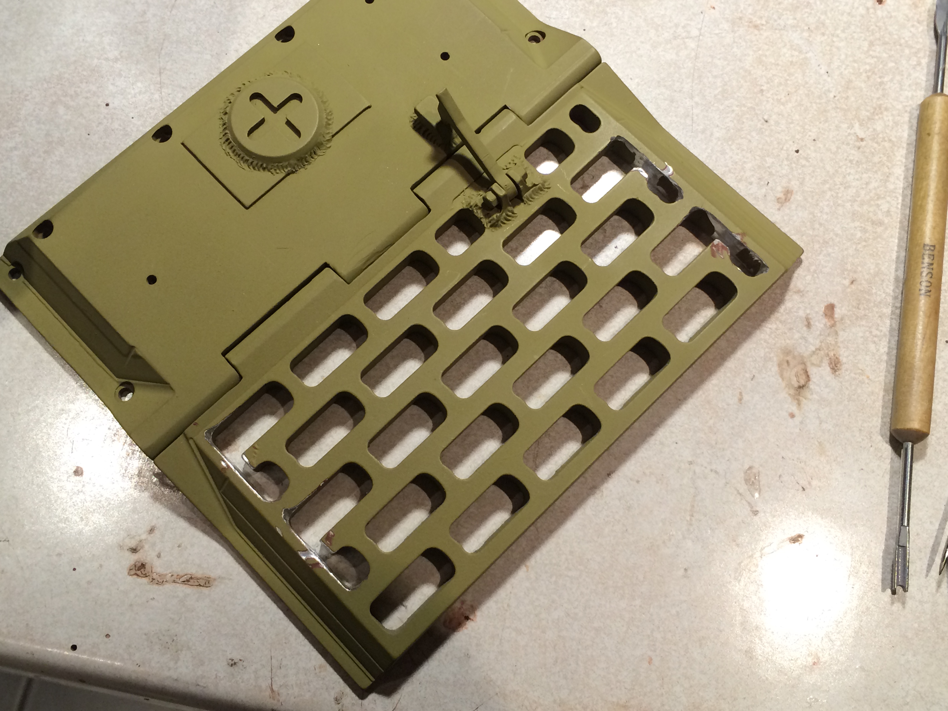

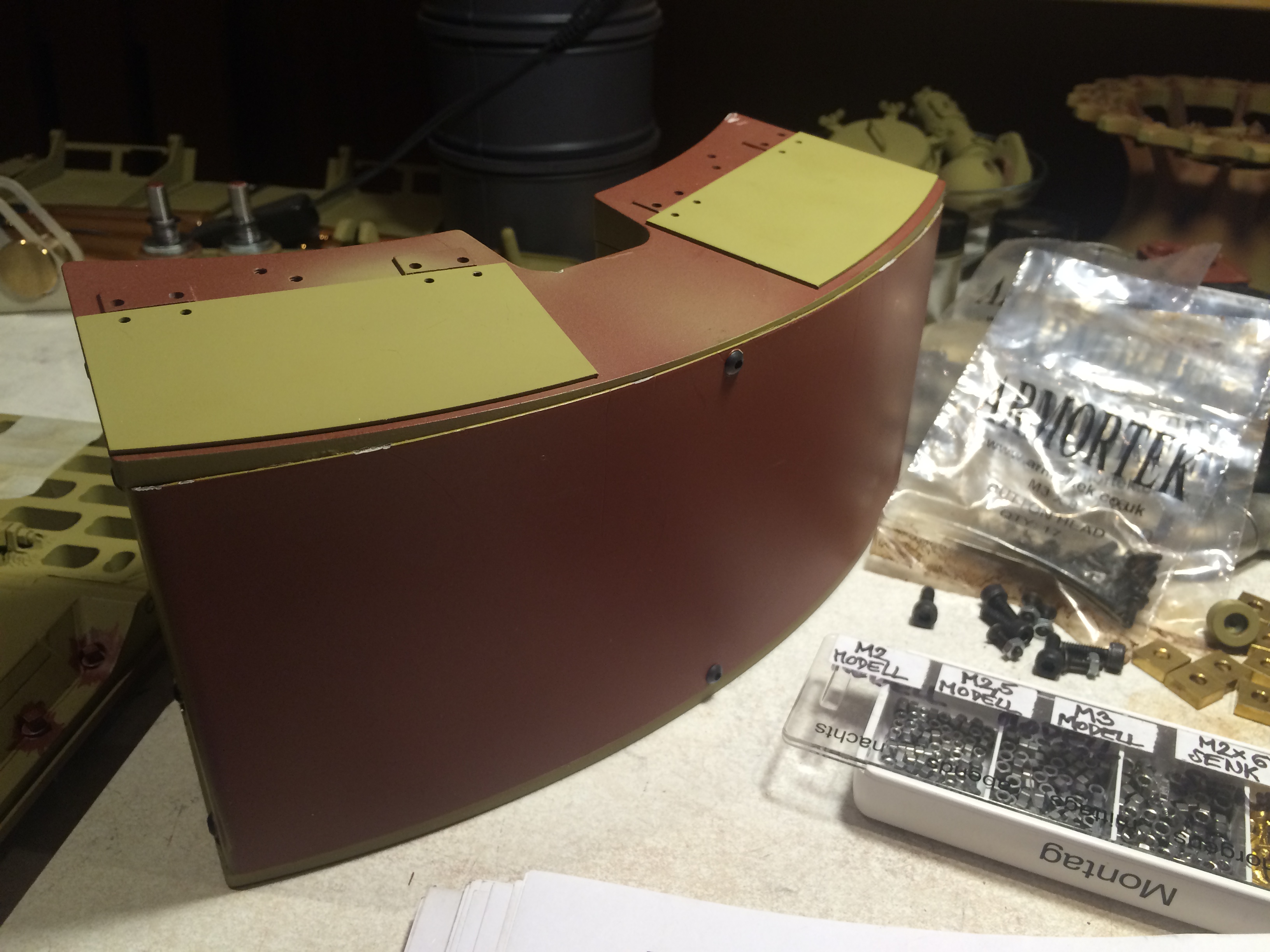

Post by Martin Hofmann »

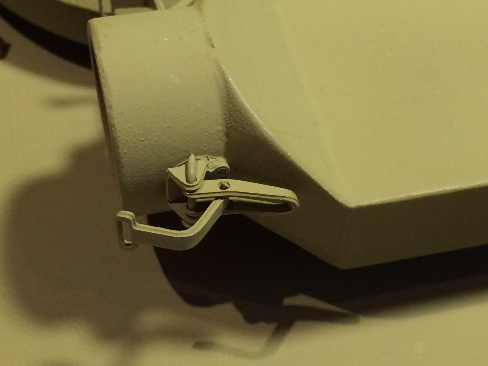

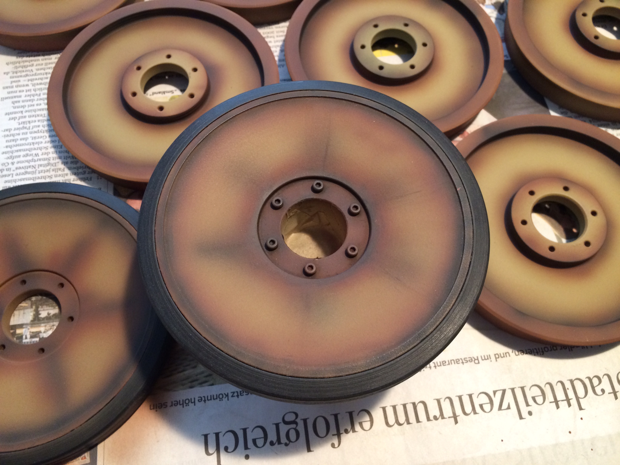

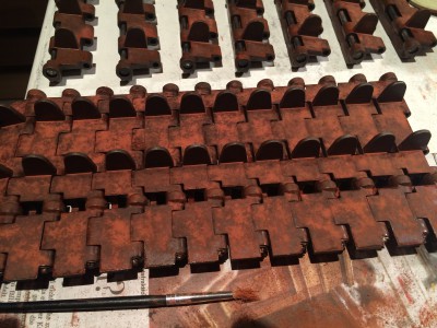

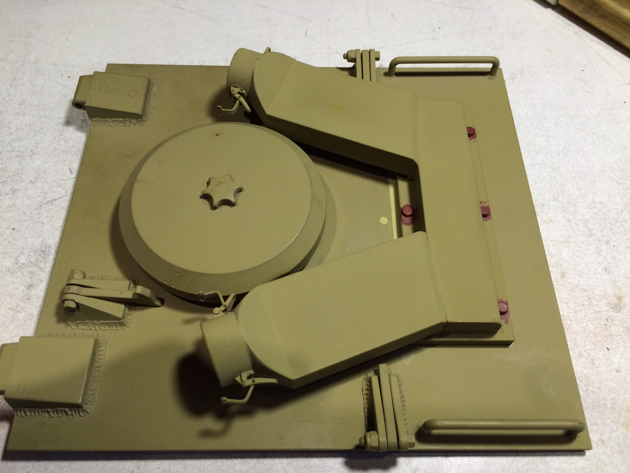

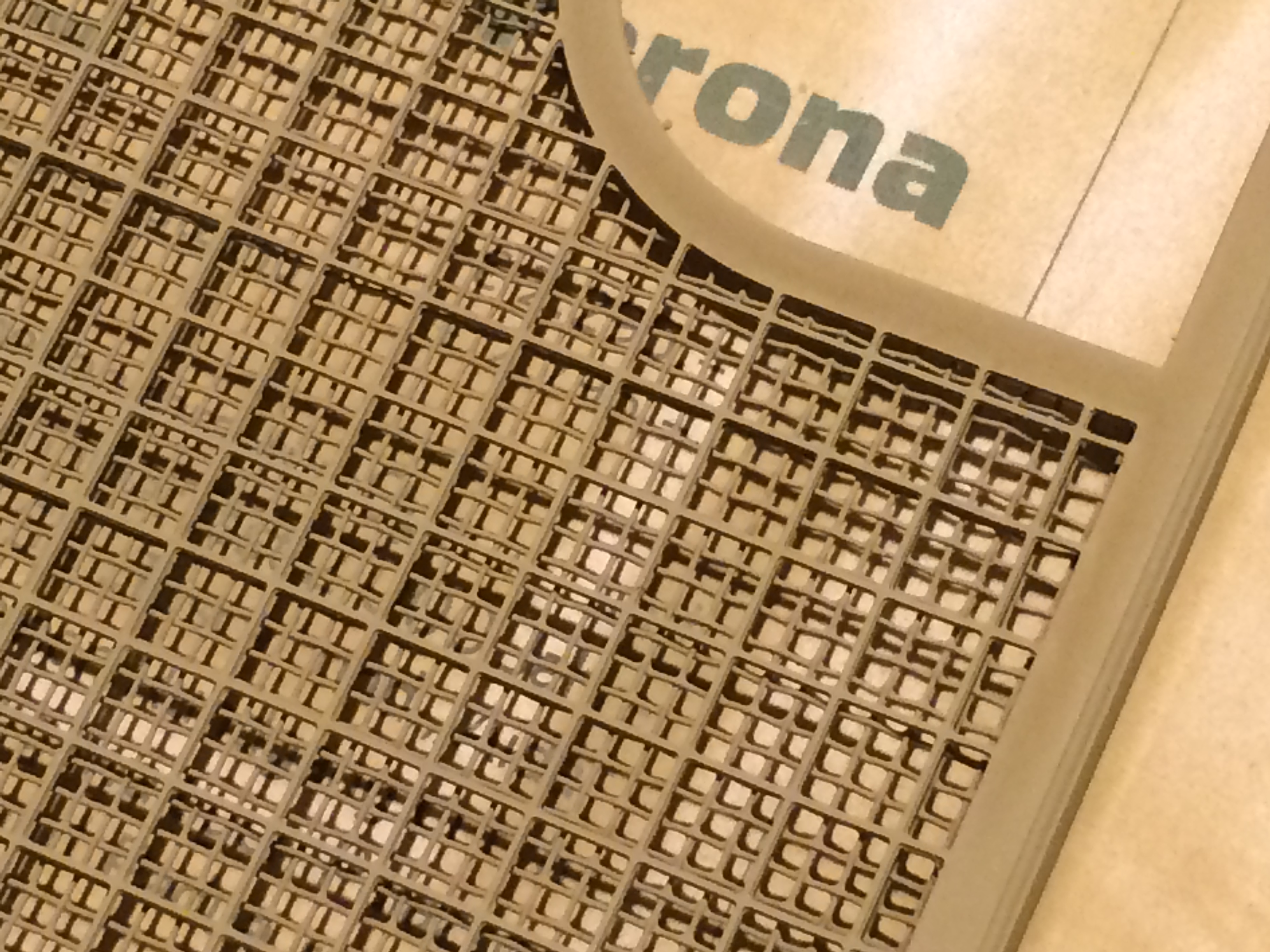

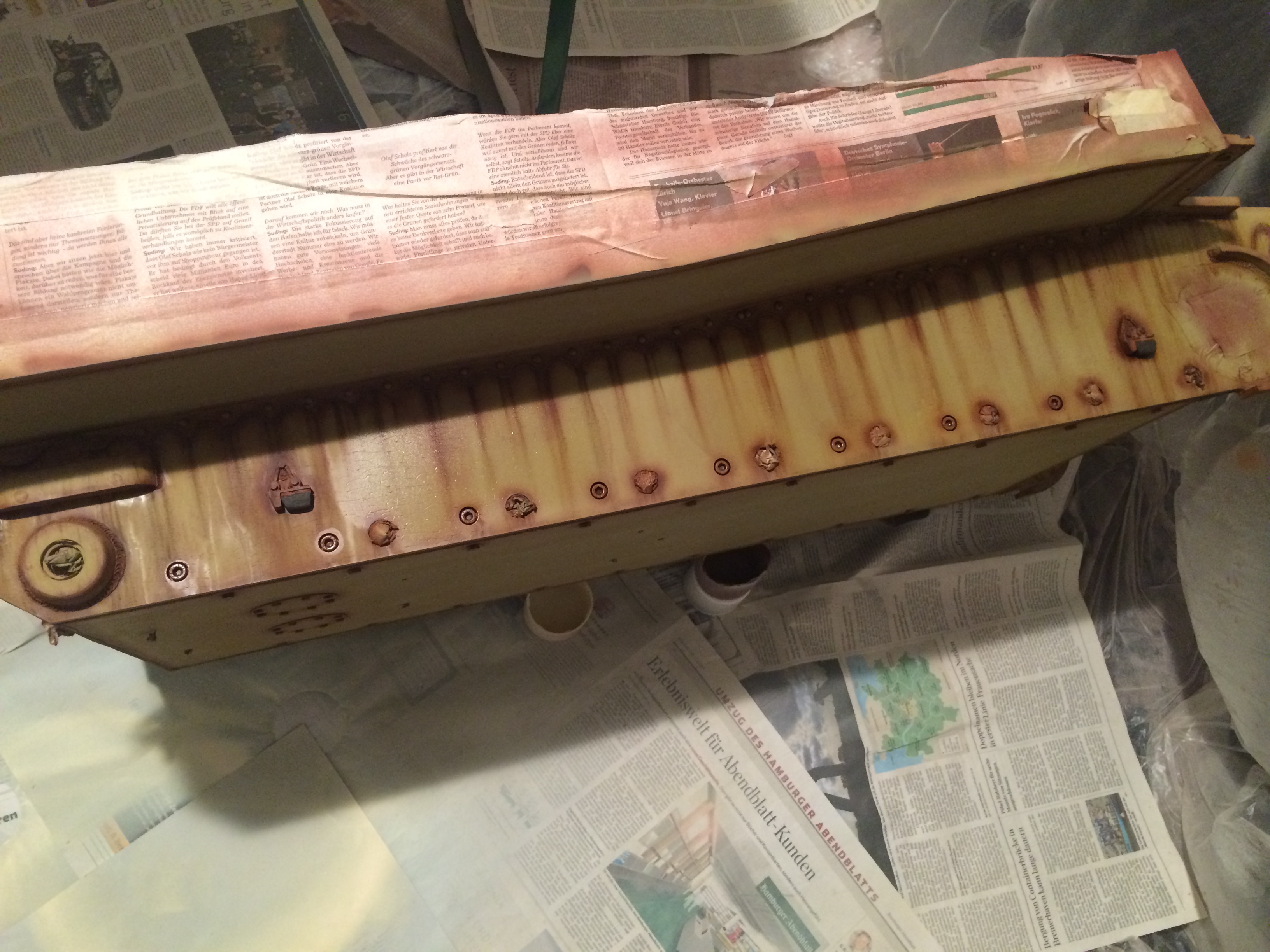

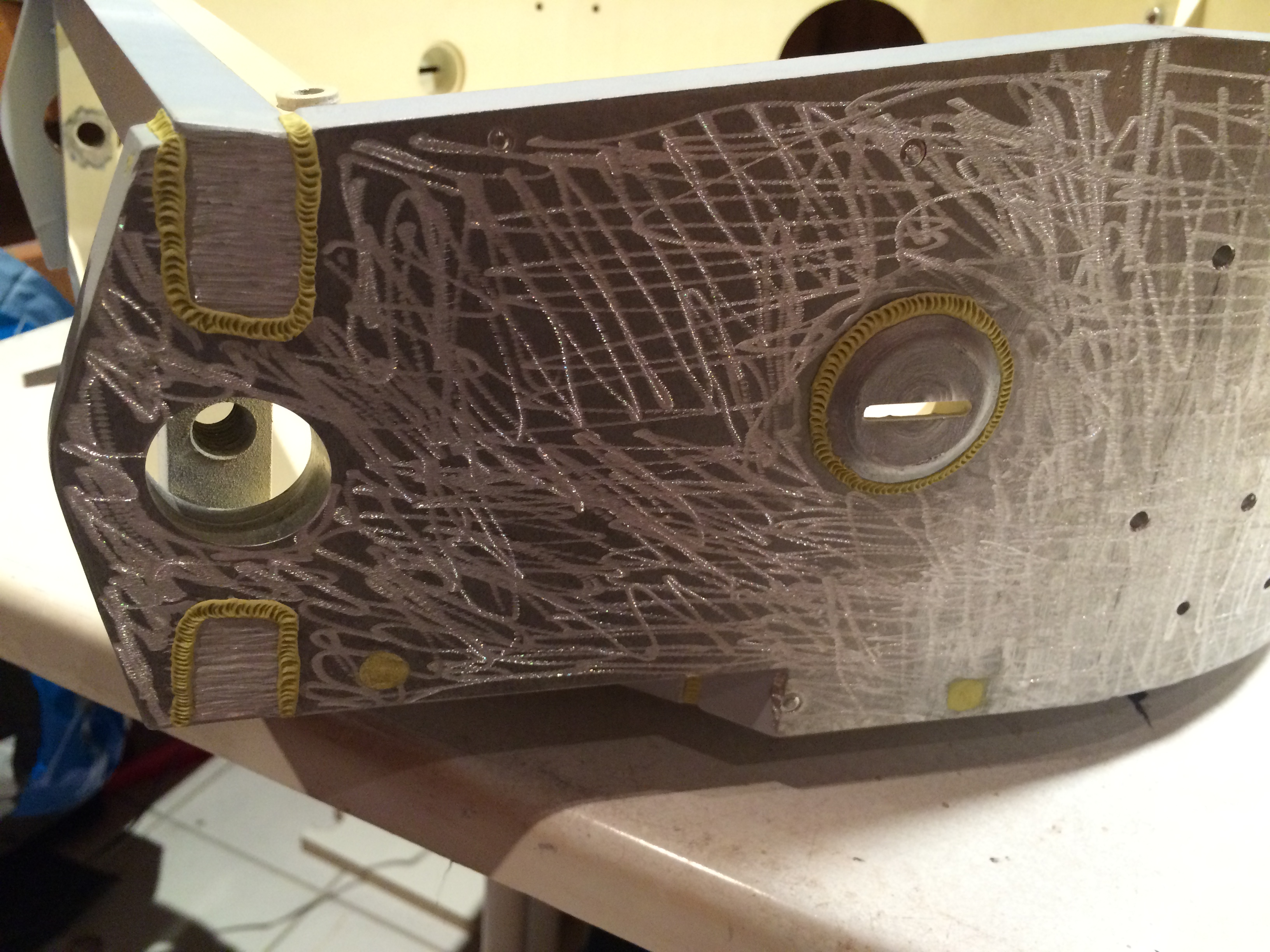

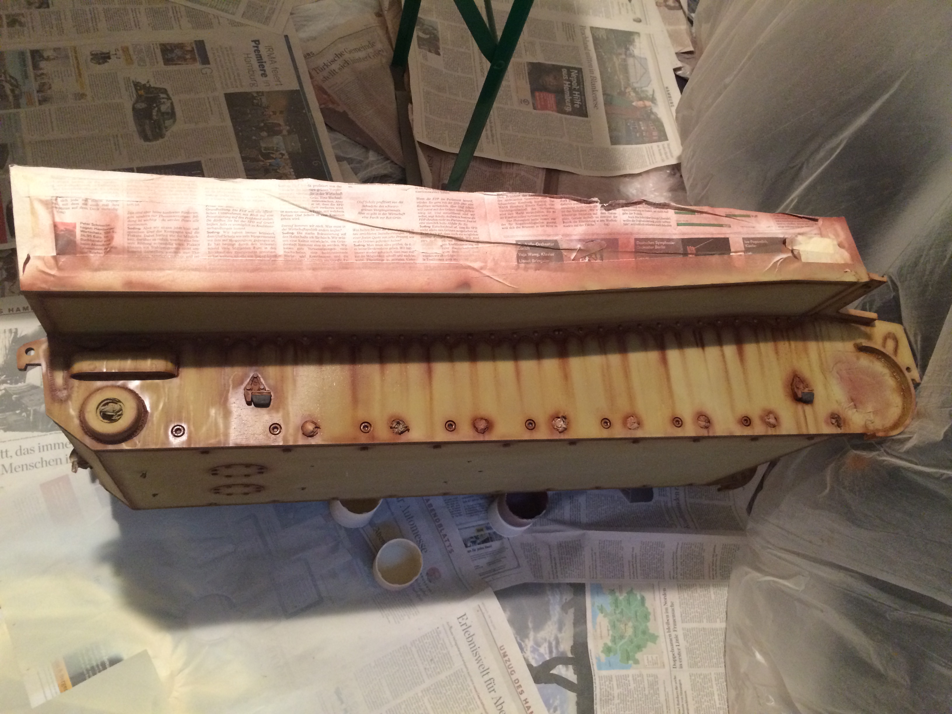

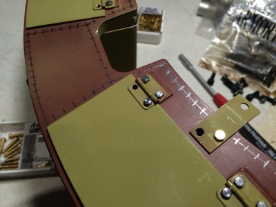

here comes the next photos of the turret and the hull.
i had painted it on the places where the road wheels are sitting later.
open the grid
open the grid
Regards Martin

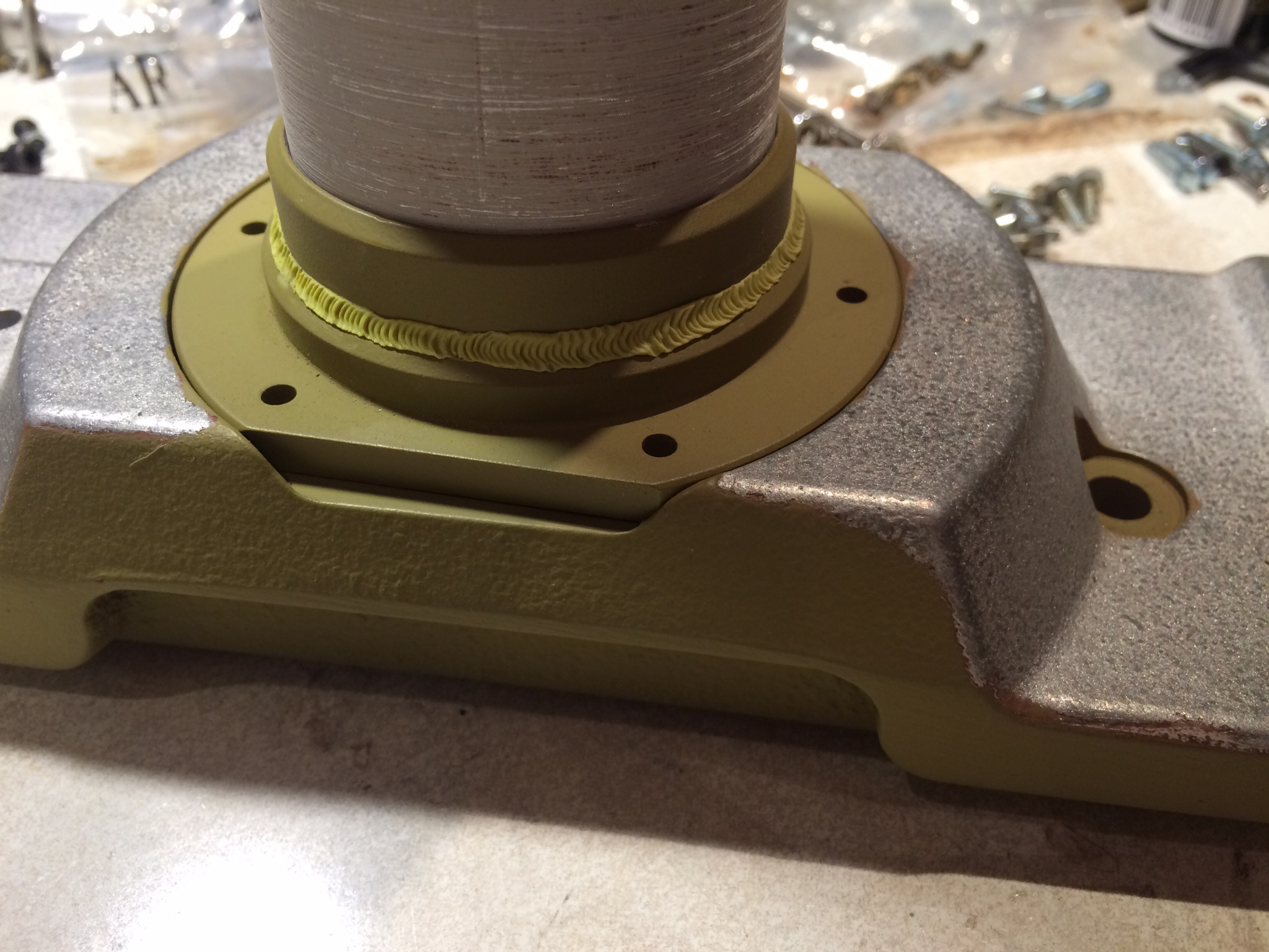

Post by Steve Stuart »

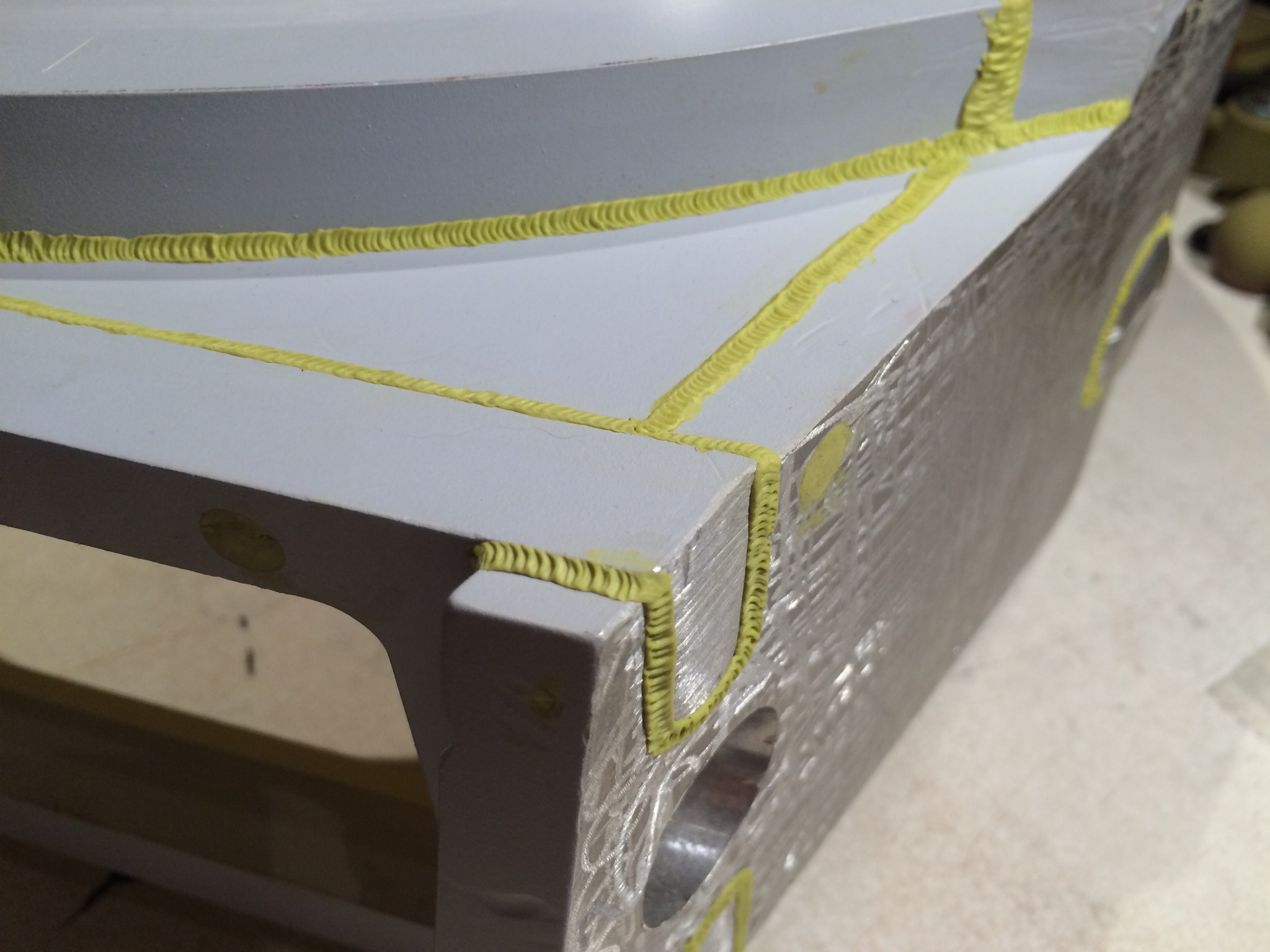

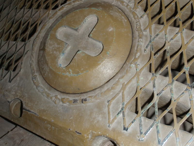

Martin, I may be wrong, and will stand to be corrected, but I believe that the 'Filler Caps' on the rear deck ought not to have weld lines as they are designed to unscrew. If I am right now's the time to unweld them! Steve
Paul Morris
Posts: 1559
Location: North Lancs
Been liked: 68 times
Re: Martins Tiger1
Post by Paul Morris »
Hi fellas.
Weld lines round the fuel caps :) we have had this one before eh Kent :lol: only joking.
Martin ... leave the welds alone.
Cheers Paul. :wink:

Hallo Steve,
Hello Paul,
I think the welds are ok because they don't weld the caps but the flange for the caps.
Regards Martin
Of the 3 Tiger I and a Sturmtiger I have inspected there is a weld line around the fuel and water filler caps, the Late model Tiger will be leaving Munster this year if it has not already done so if you have chance take as many pictures as you can, the Sturmtiger at Munster is based on an early model chassis but still has most of its original features on the engine deck.
Martin will this be a early production or a mid-production Tiger.

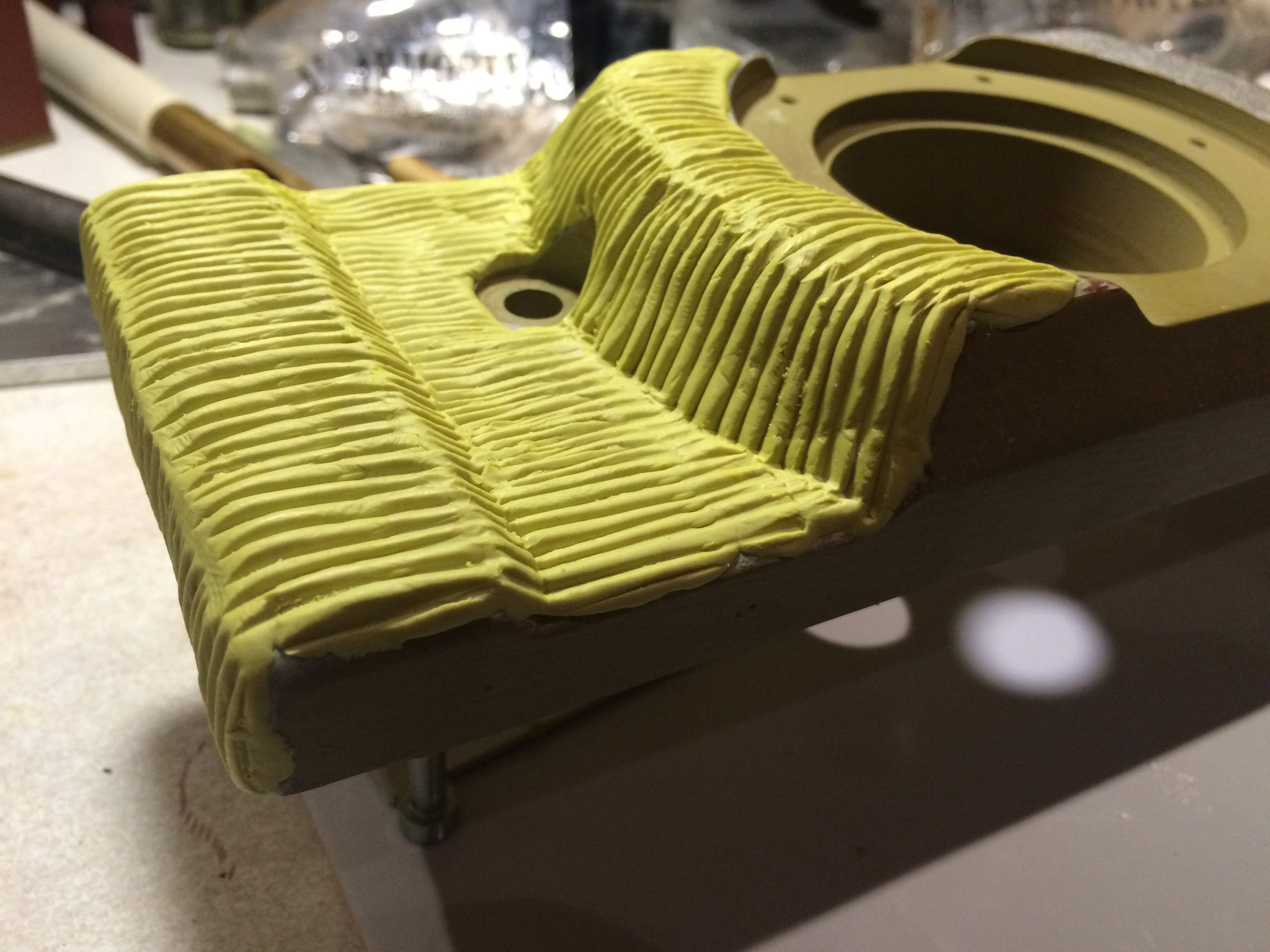

Hi Mark,
it is a mid production tiger.

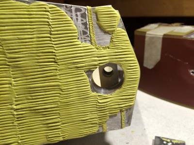

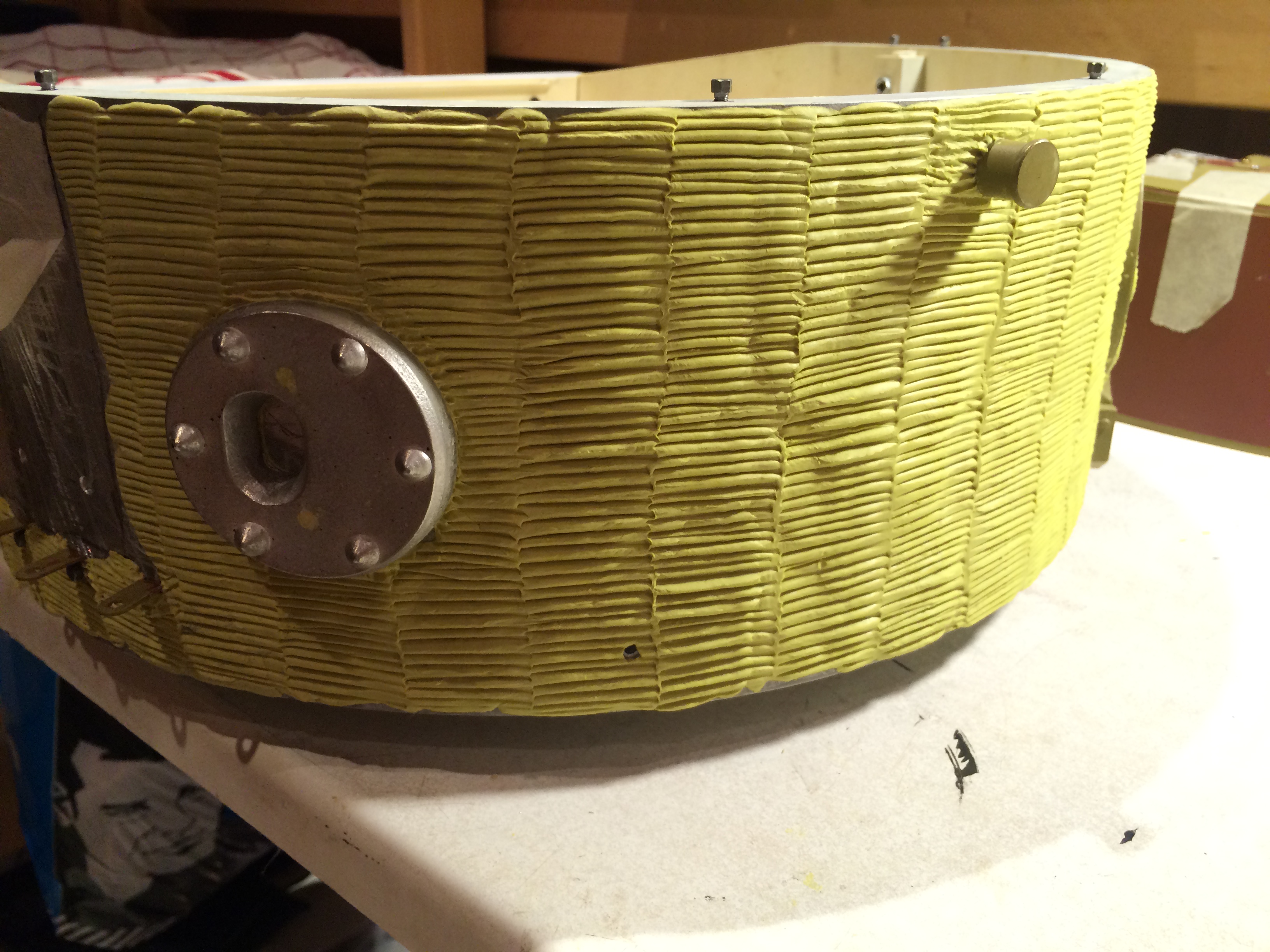

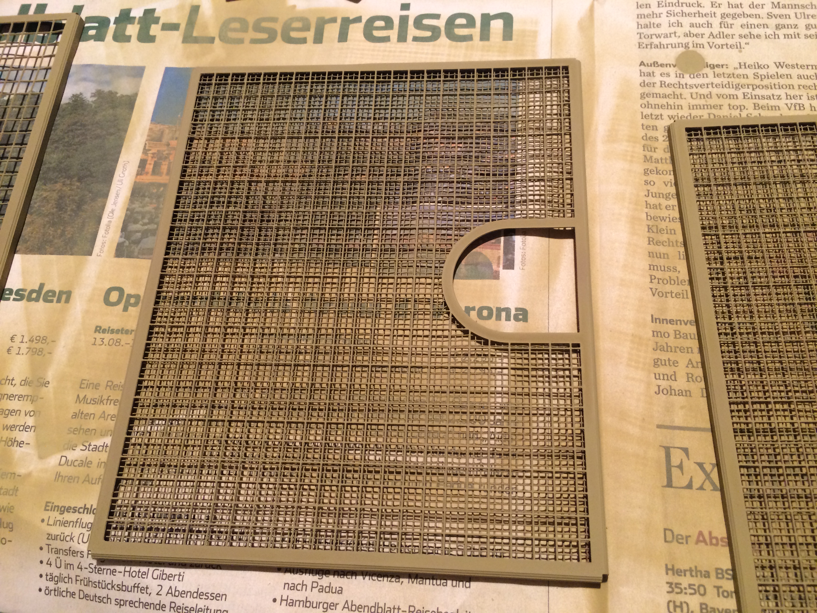

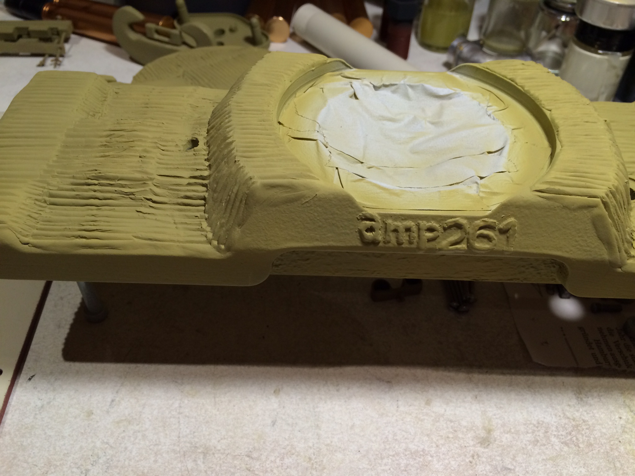

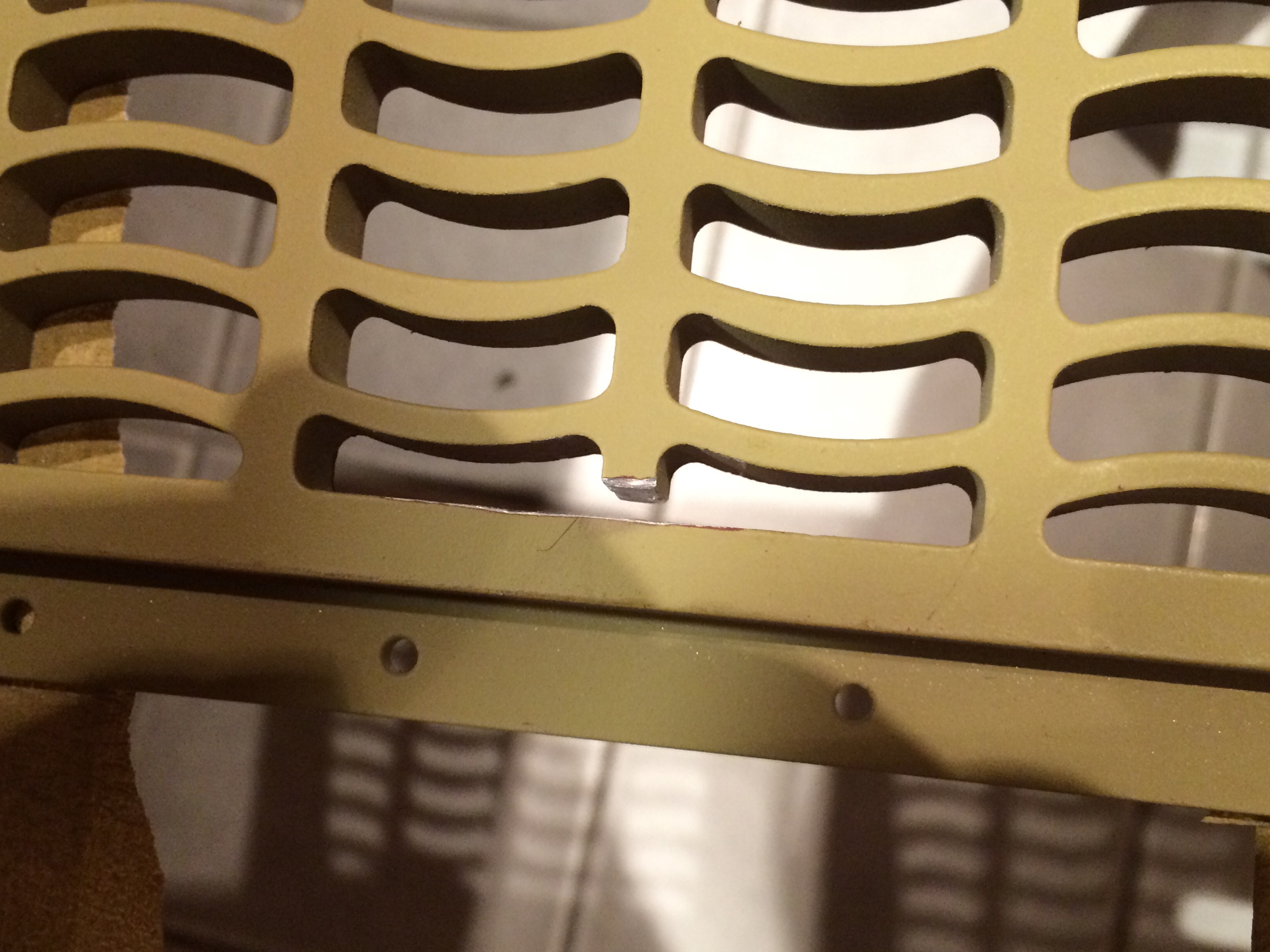

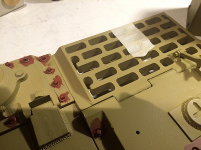

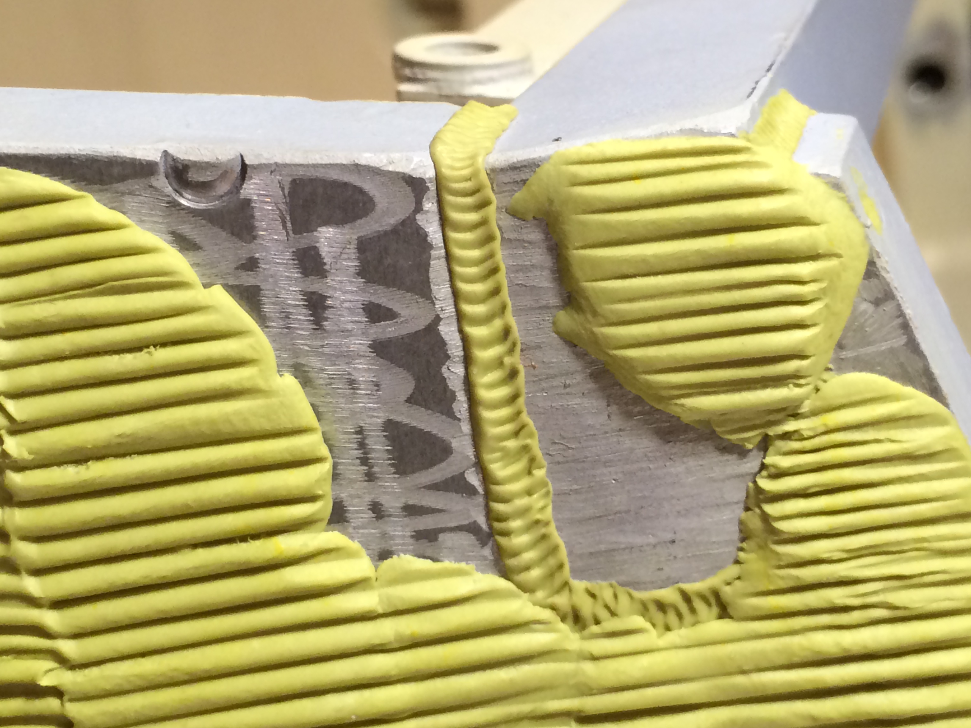

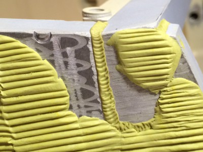

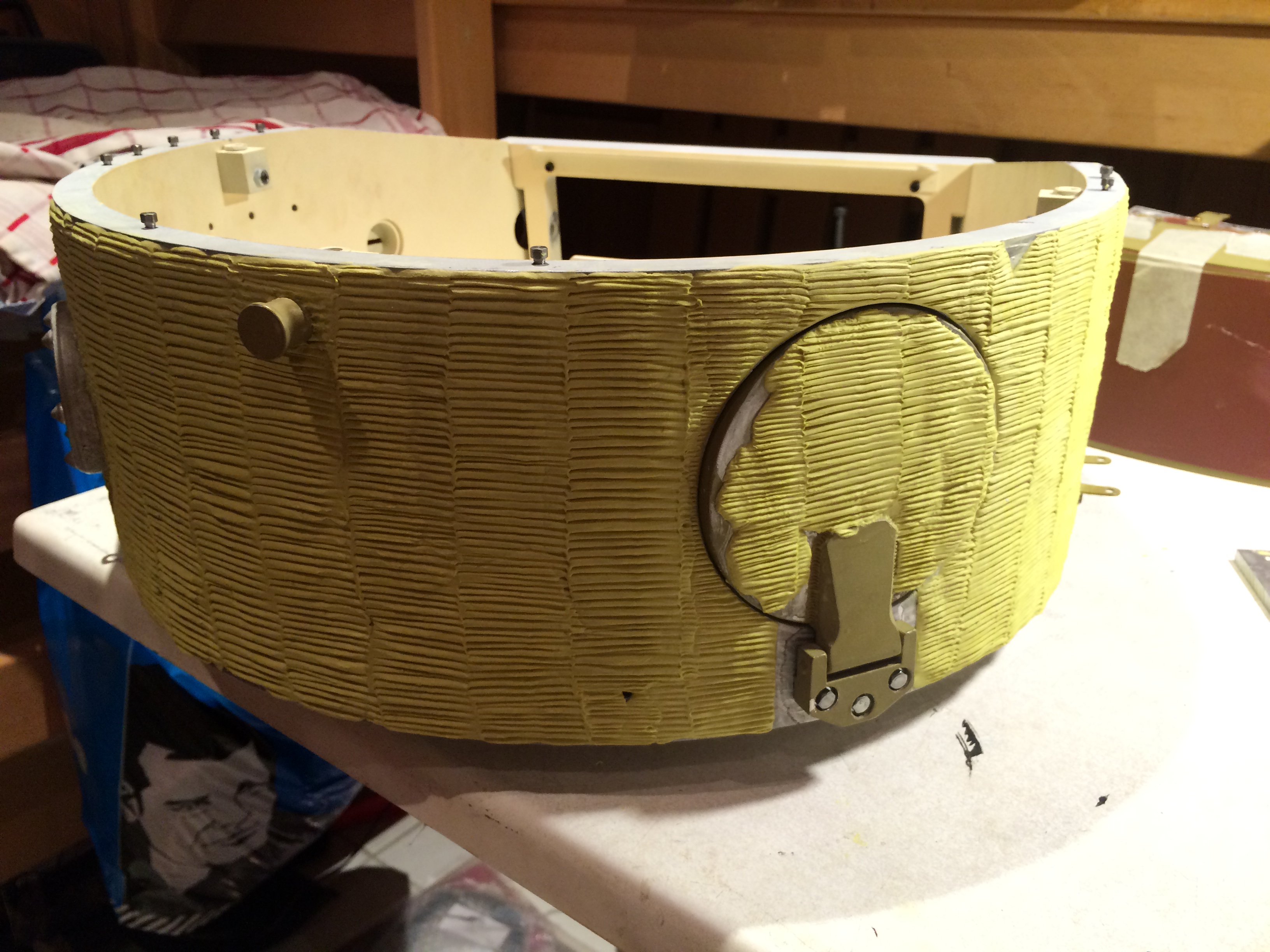

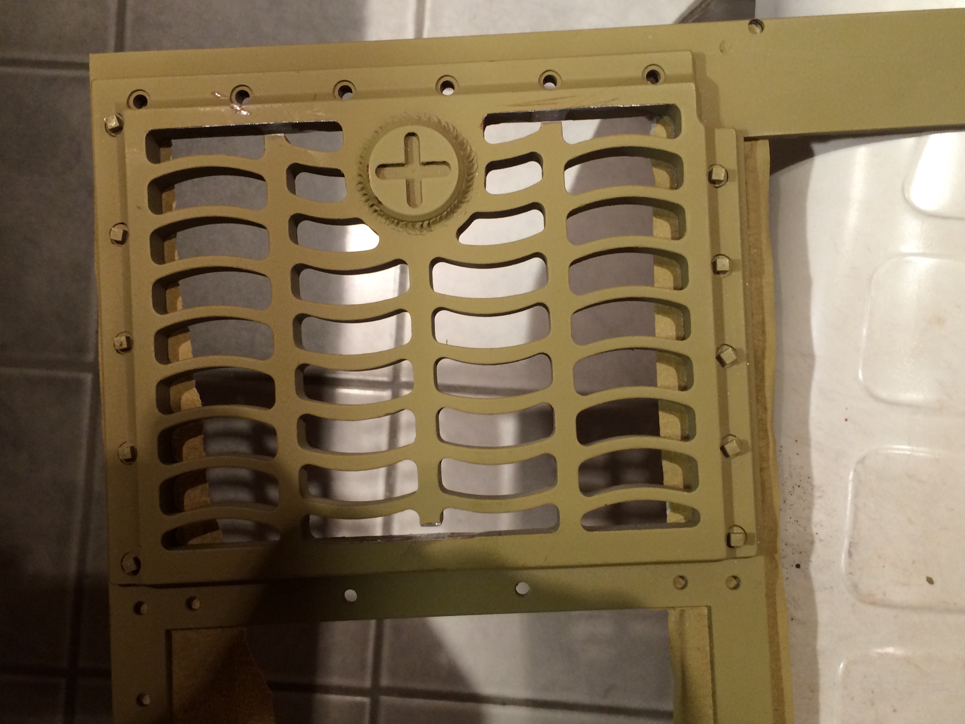

here the next pictures............
a fine mash under the coarse mash for intake grill

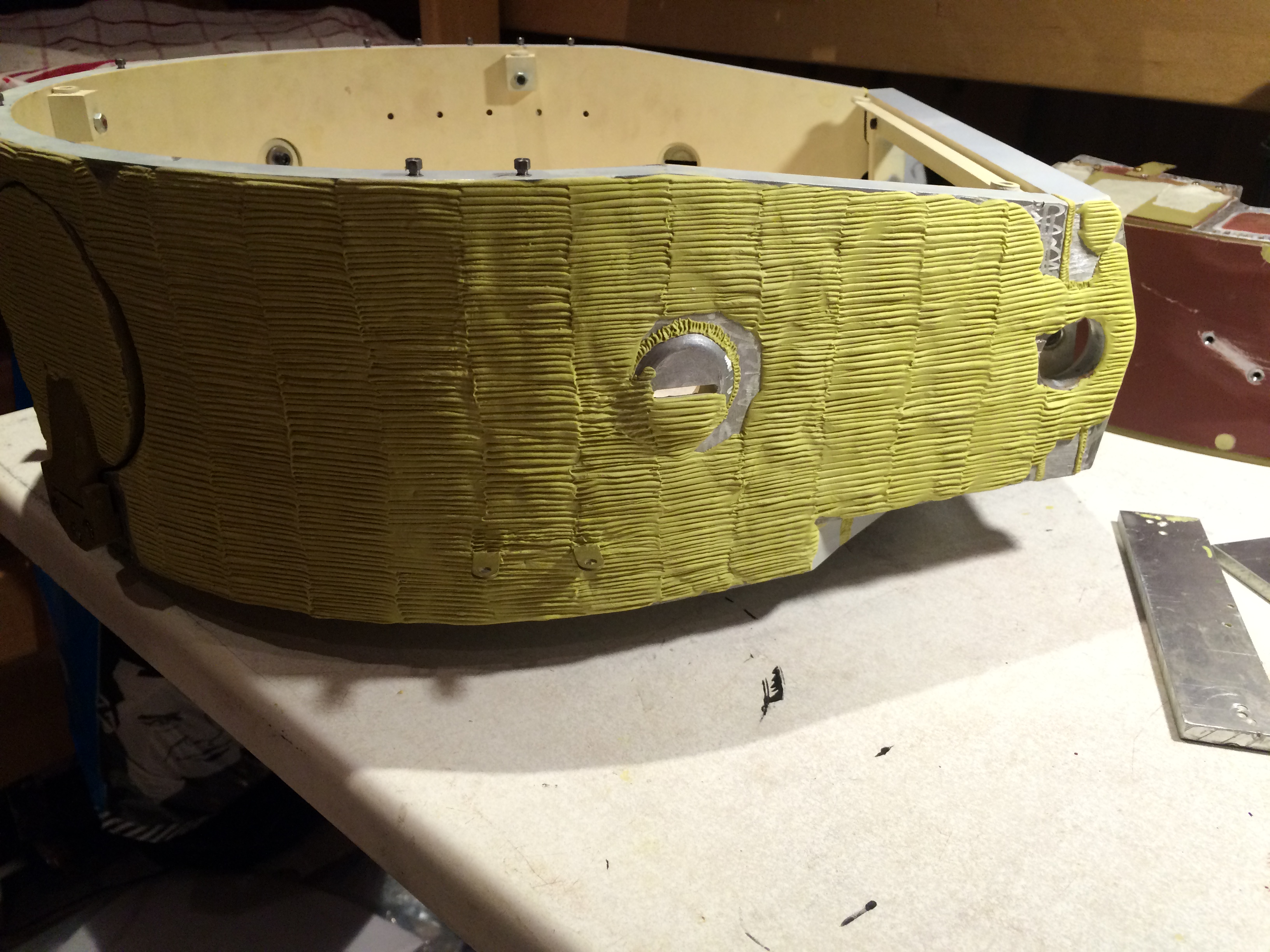

and the zimmerit starts on the turret
Regards Martin

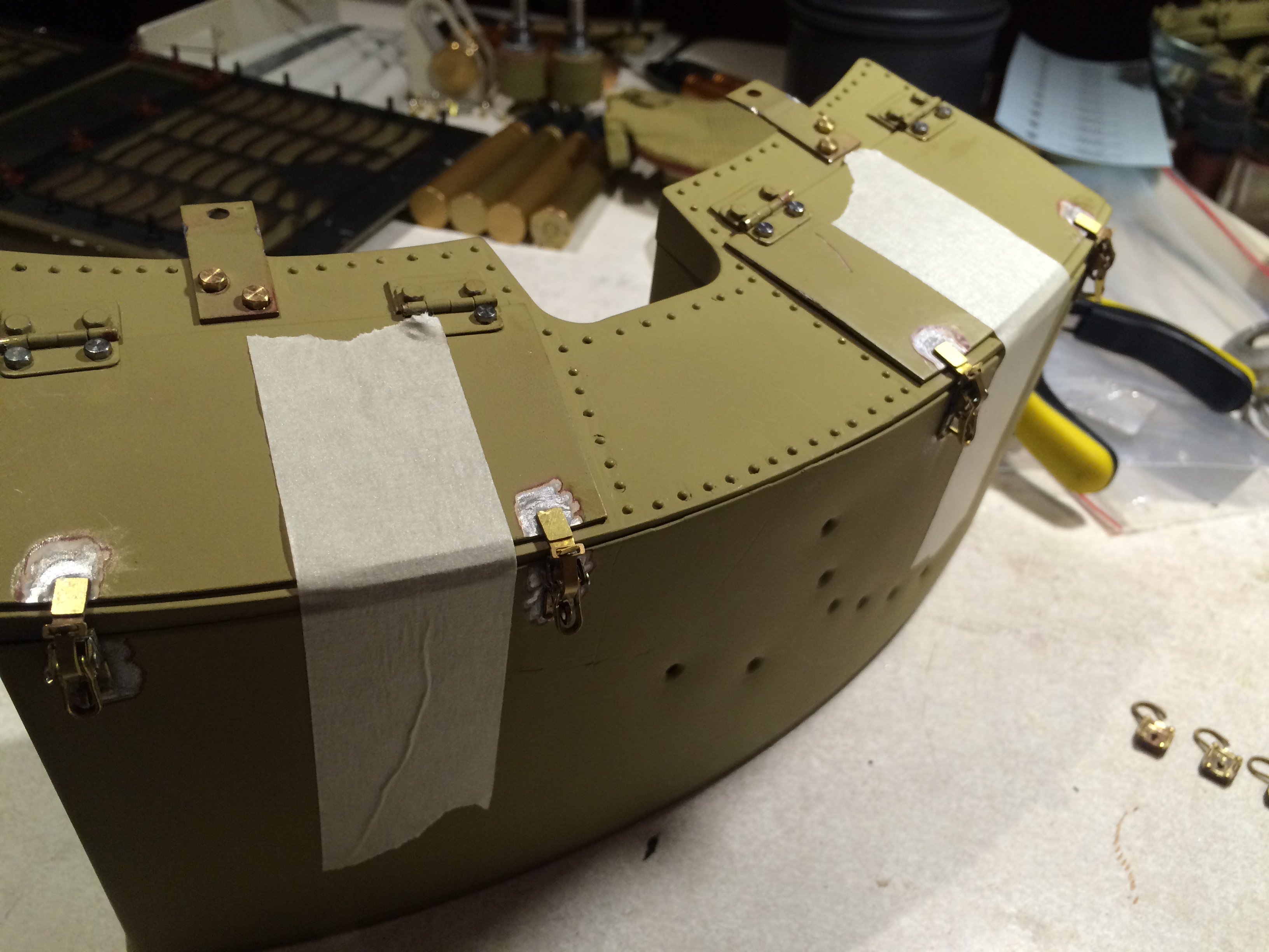

Re: Martins Tiger1

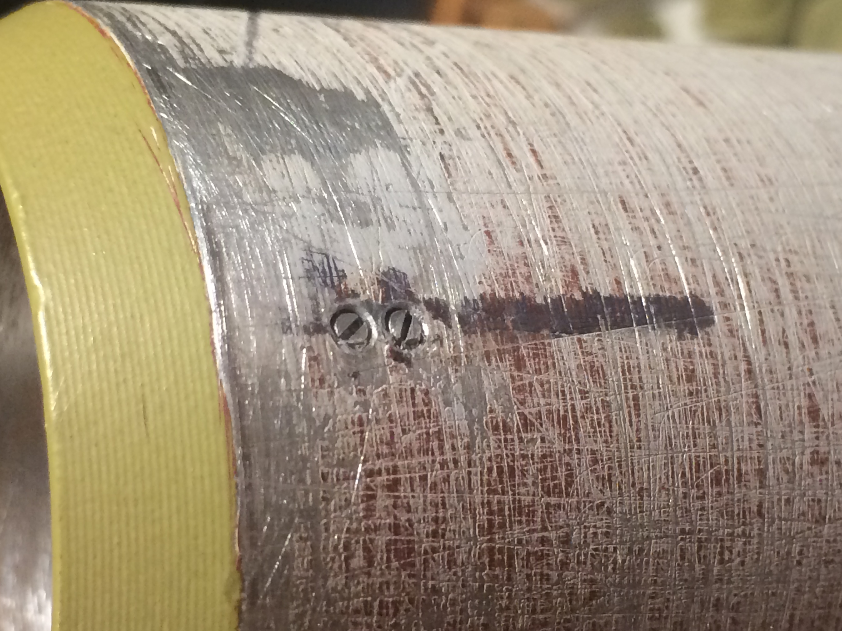

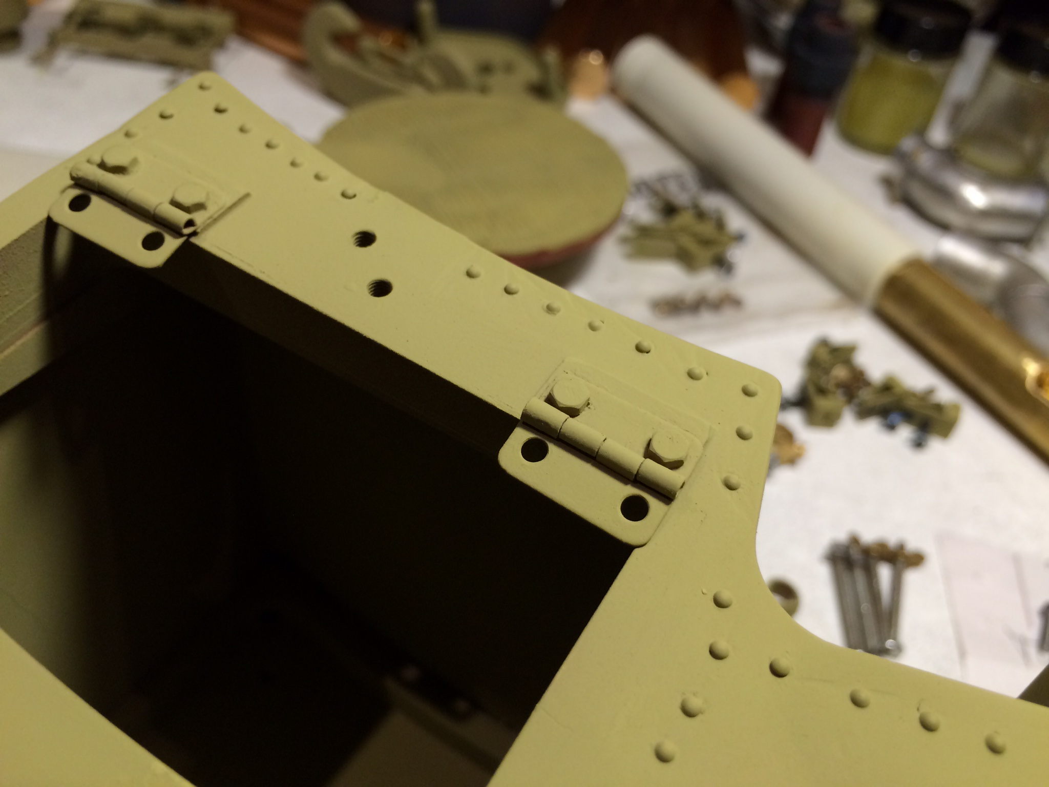

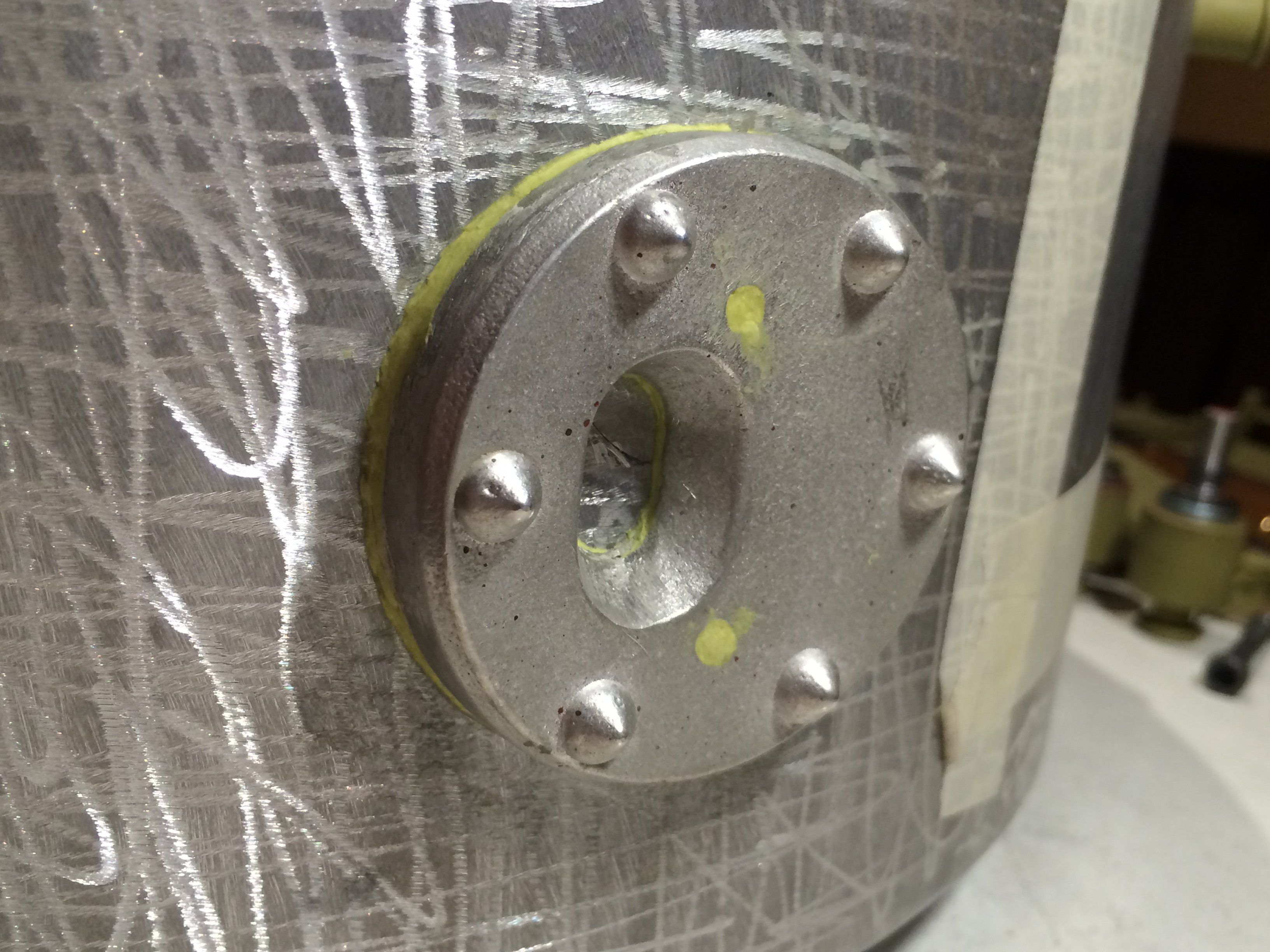

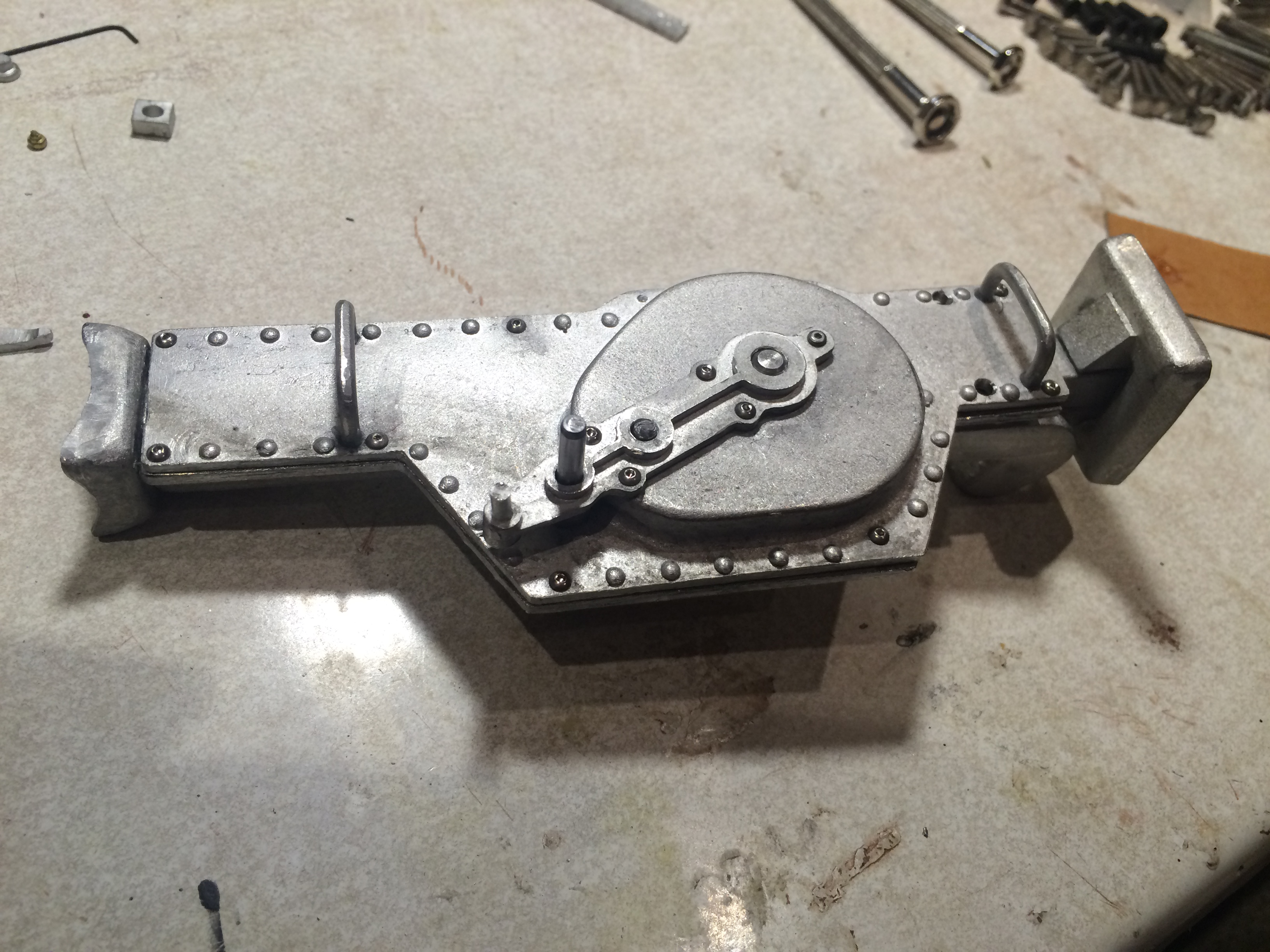

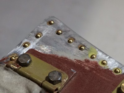

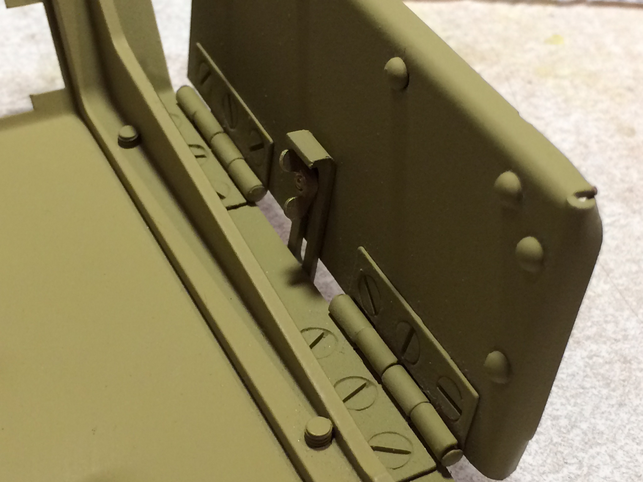

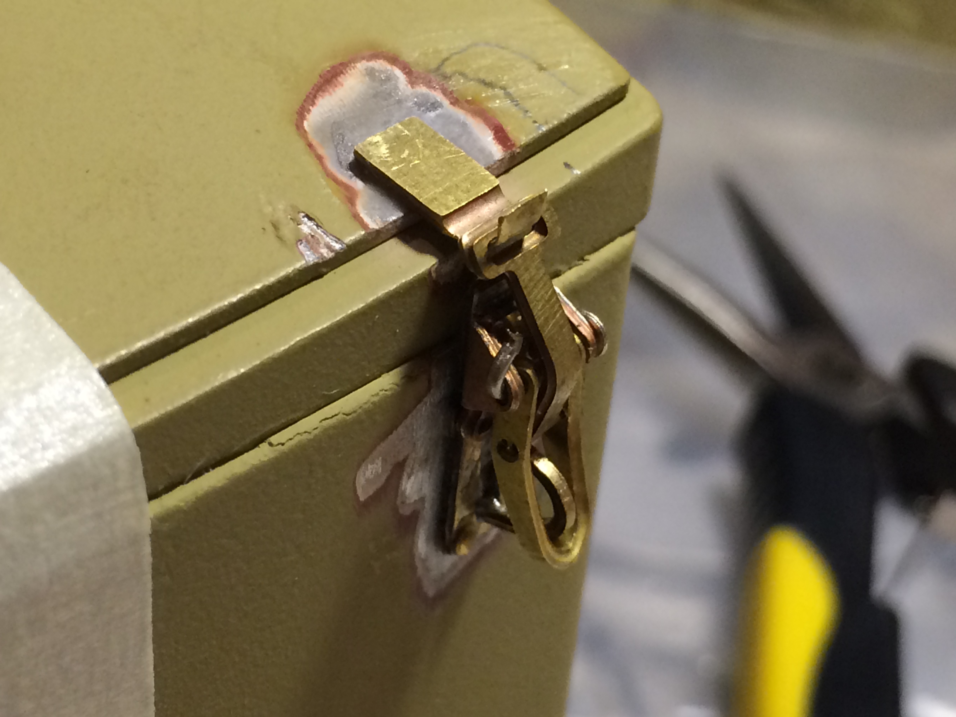

here are some more work on the bin with rivets ( the first are too big - so i drilled into the shaft of the rivets the new hole - 1,1 diameter ) so i think the diameter will be ok
Regards Martin

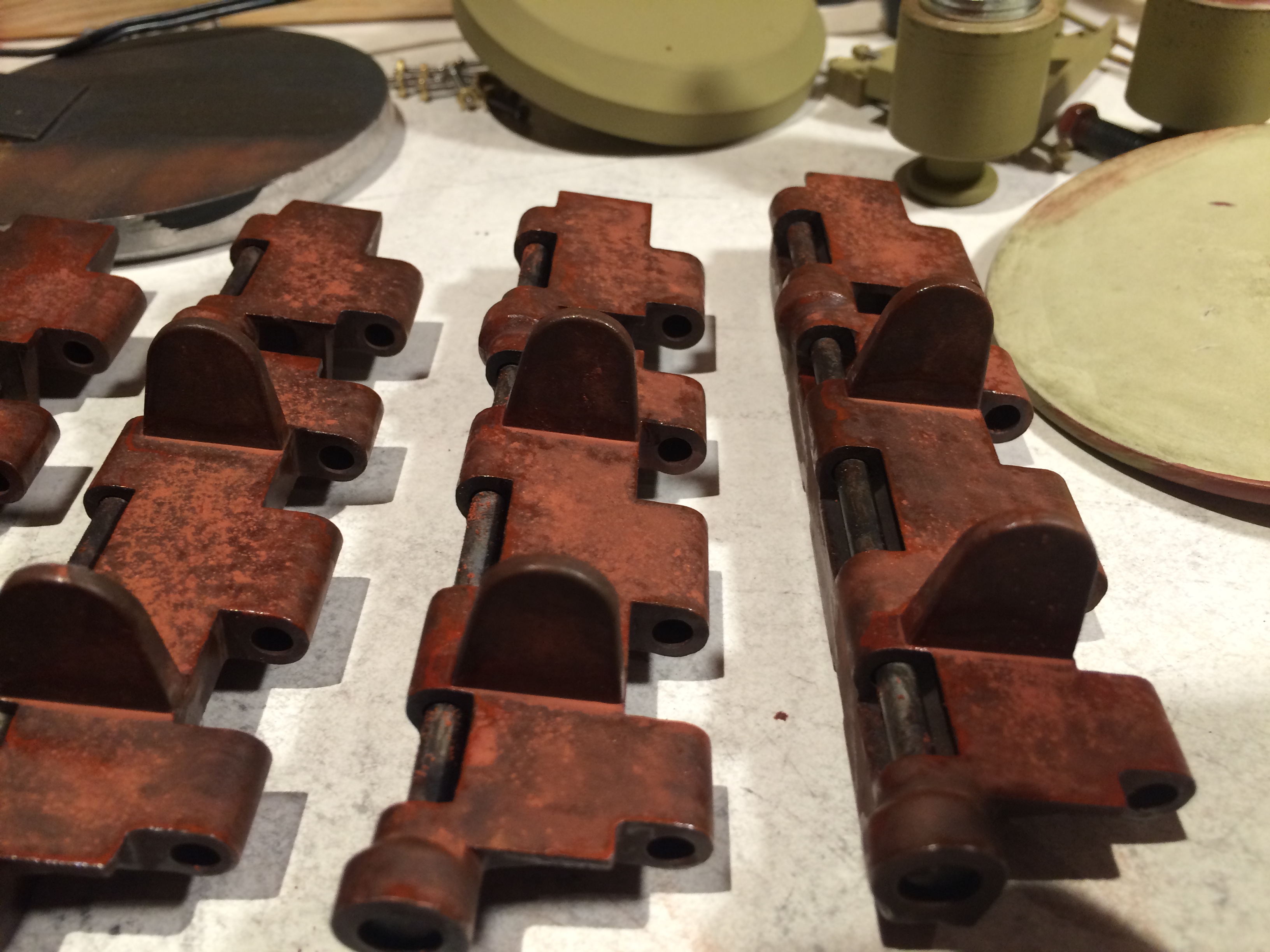

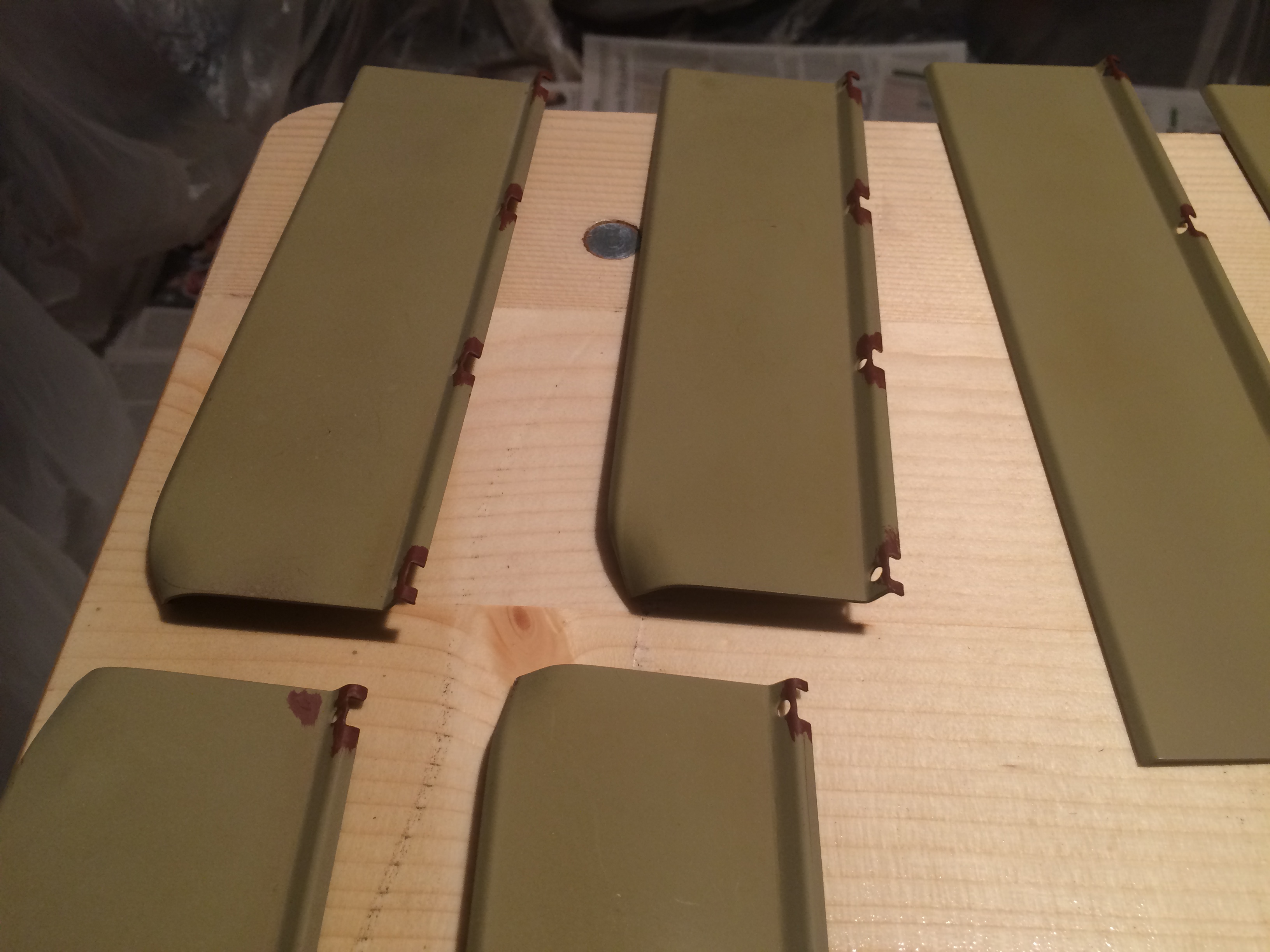

here are the next pictures about the mud guards and the feiffel filter
Regards Martin

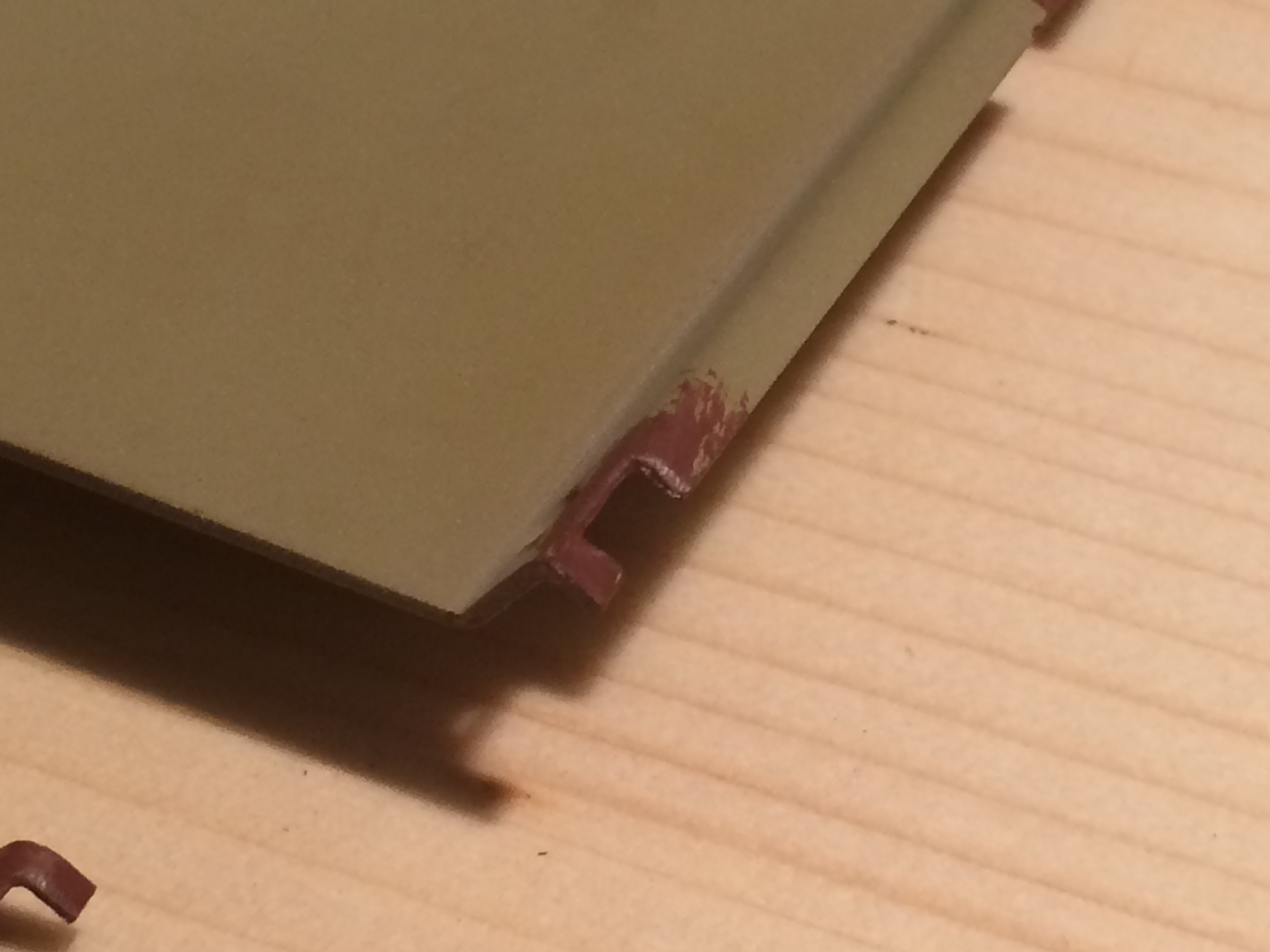

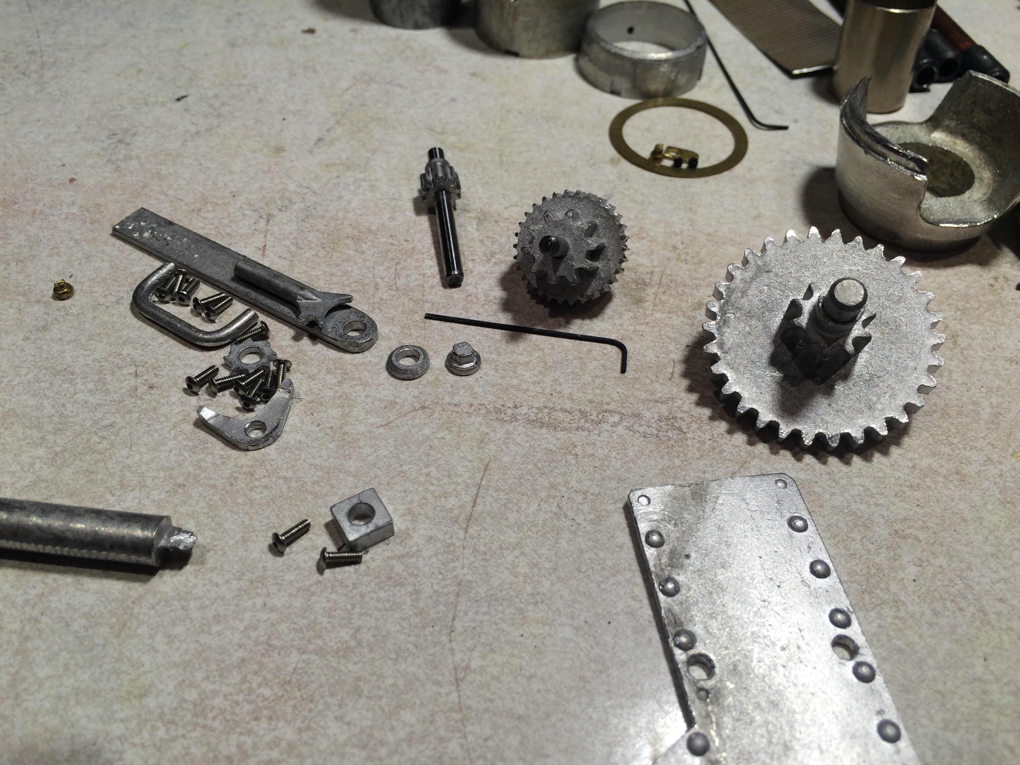

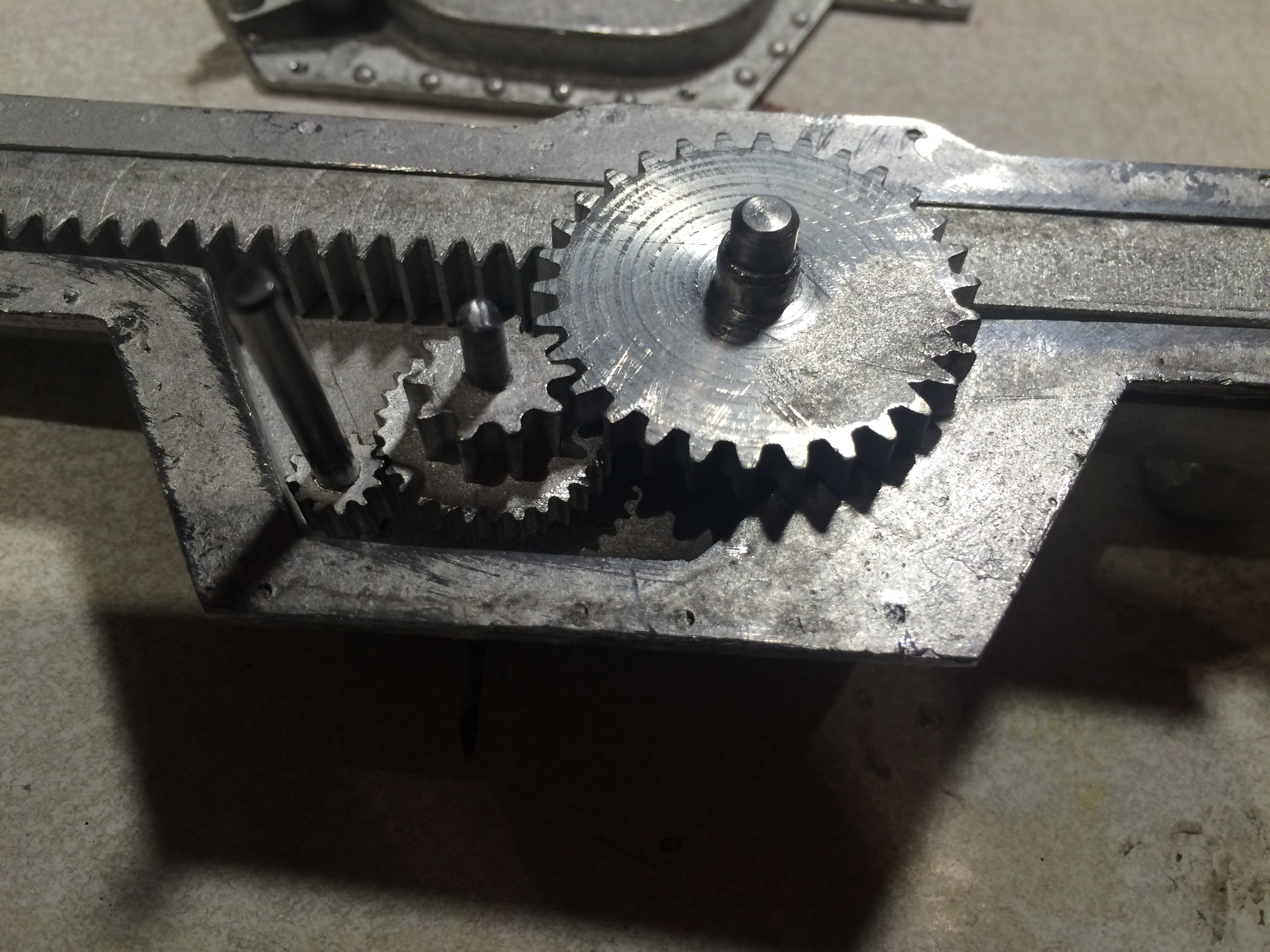

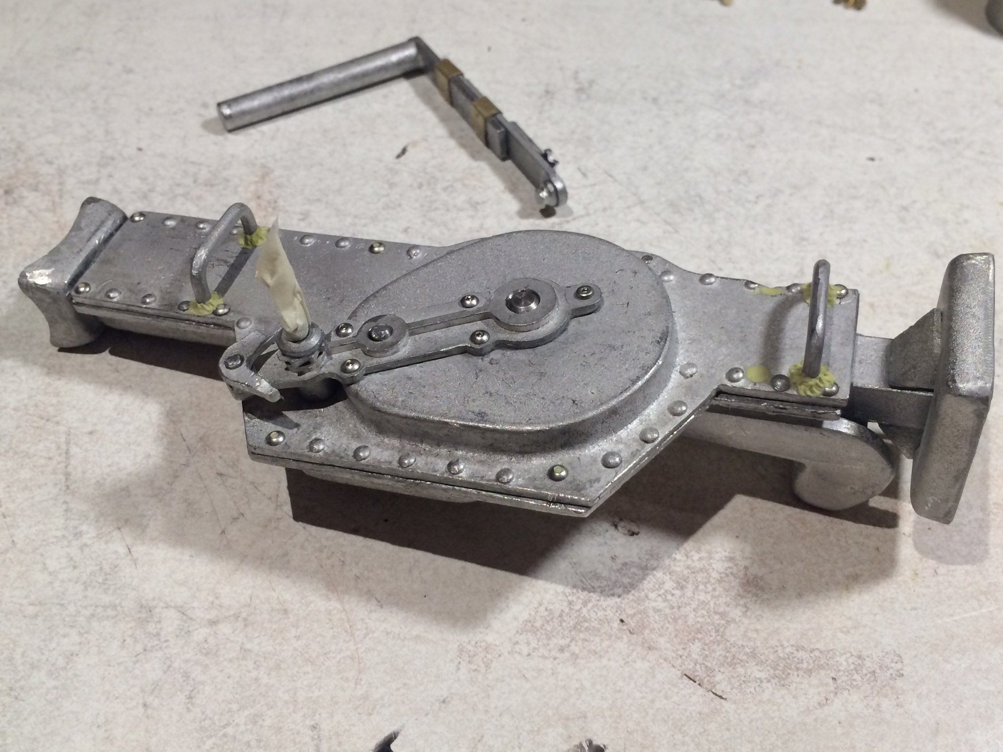

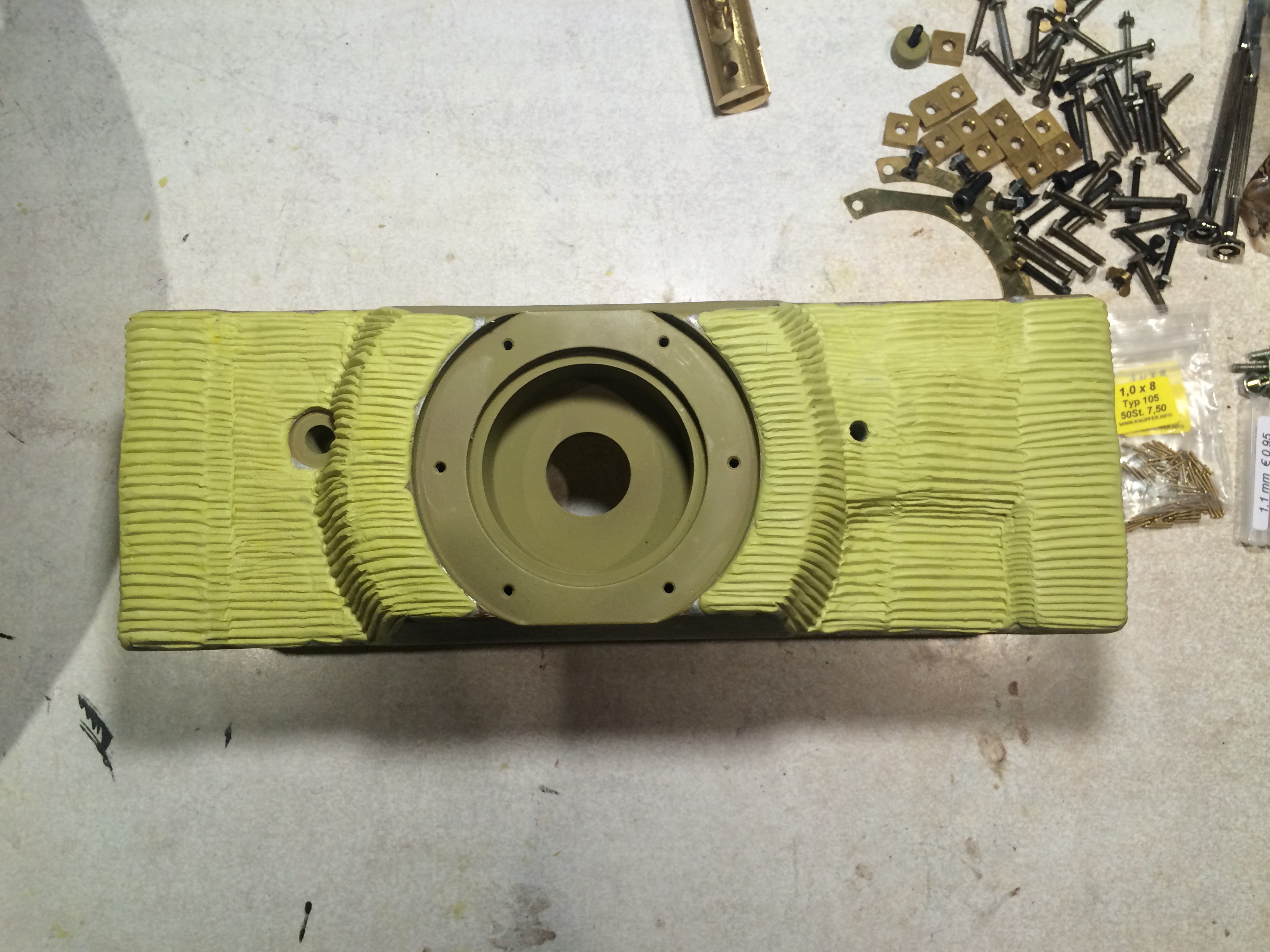

here are some details on the turret front and the 20 ton jack
Regards Martin
