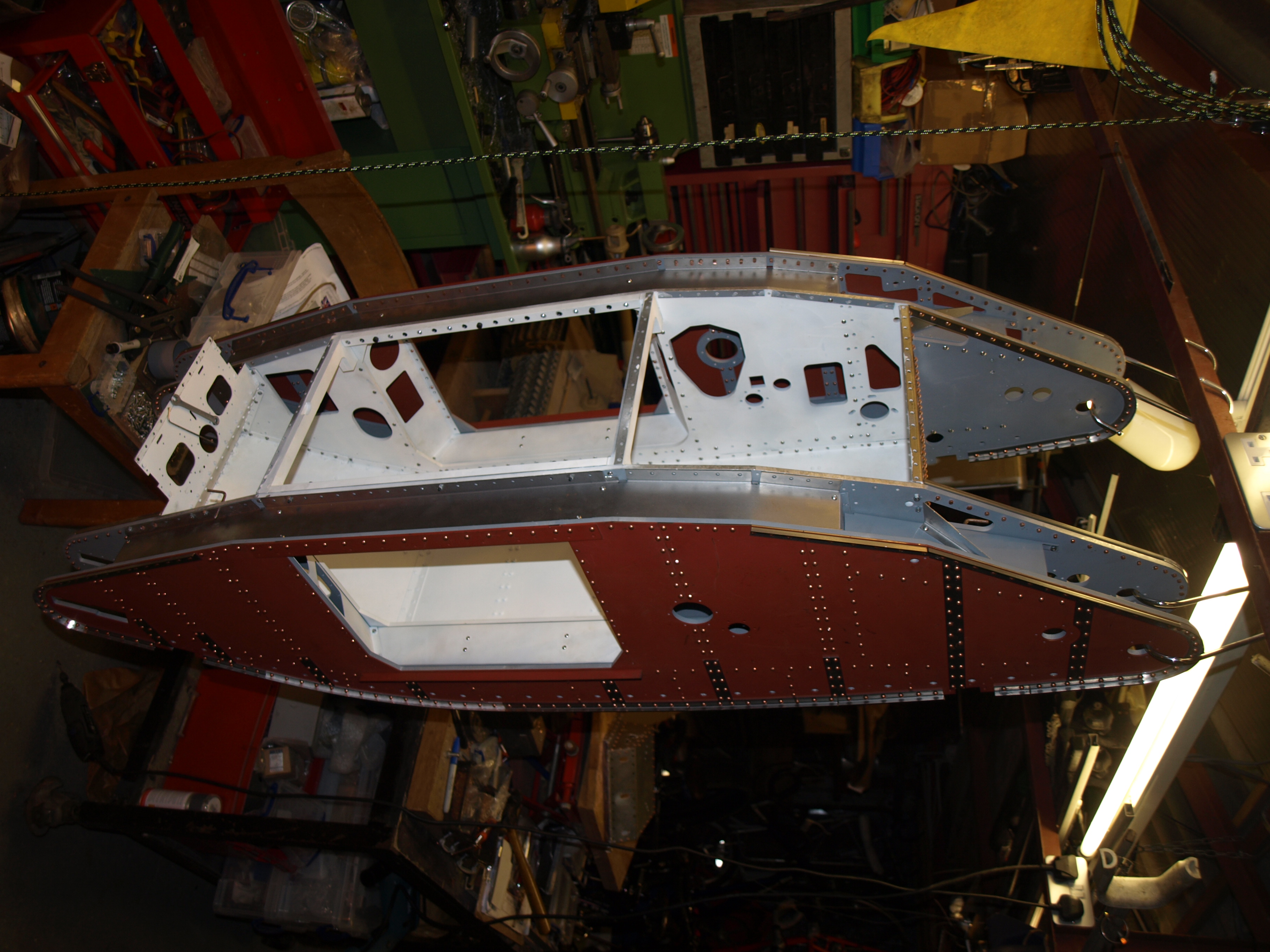

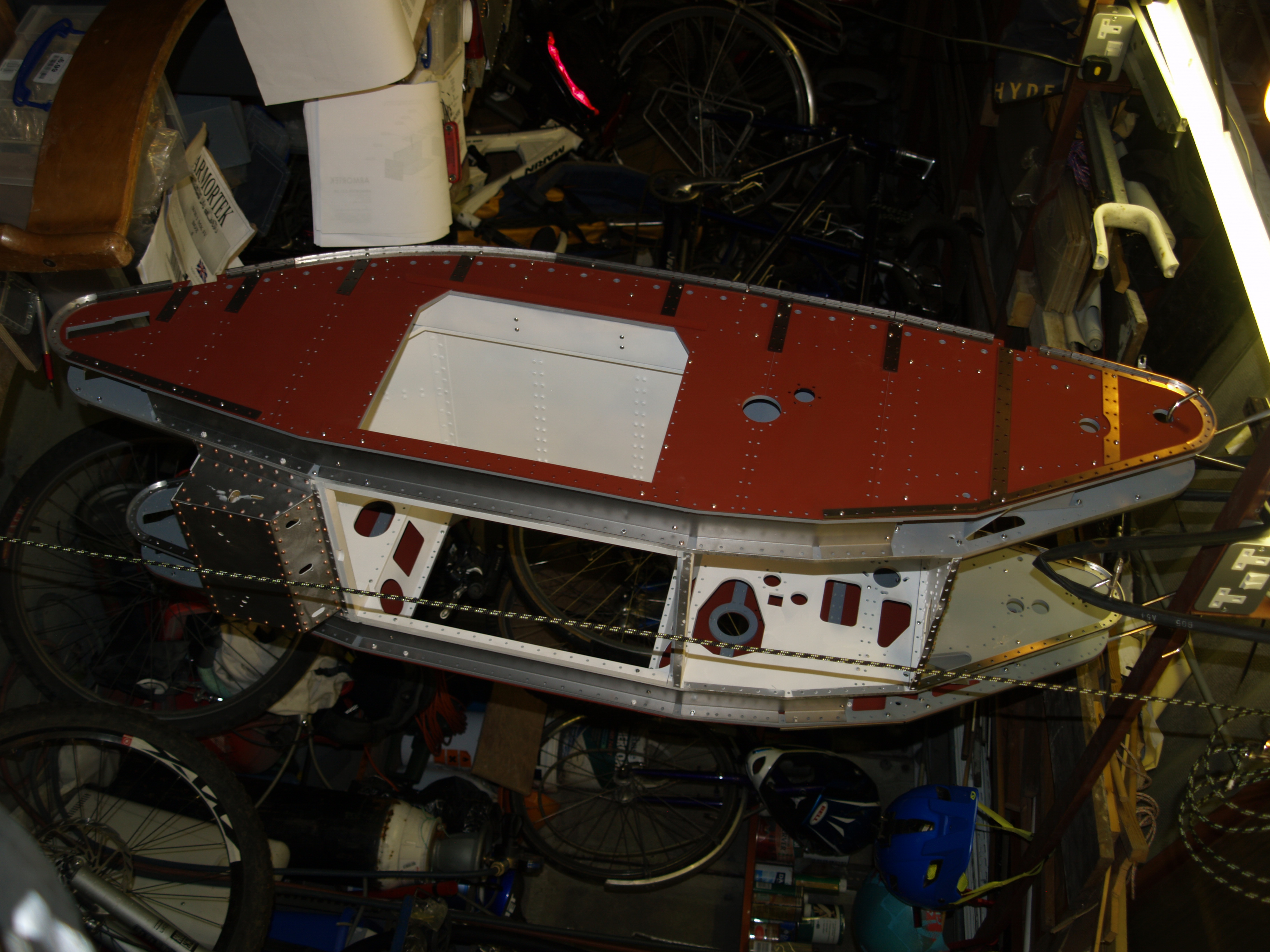

The Hull sides are now plated up and side angles attached all round.
Hull Bolt Up
Hull Bolt Up
Now this is done, the Garage is going to be subjected to a tidy up. Hull will be partially disassembled and the sides of the hull are going to be riveted as much as possible. But I will have to borrow a spare vice from work to rig up on the build trolley to allow for riveting.

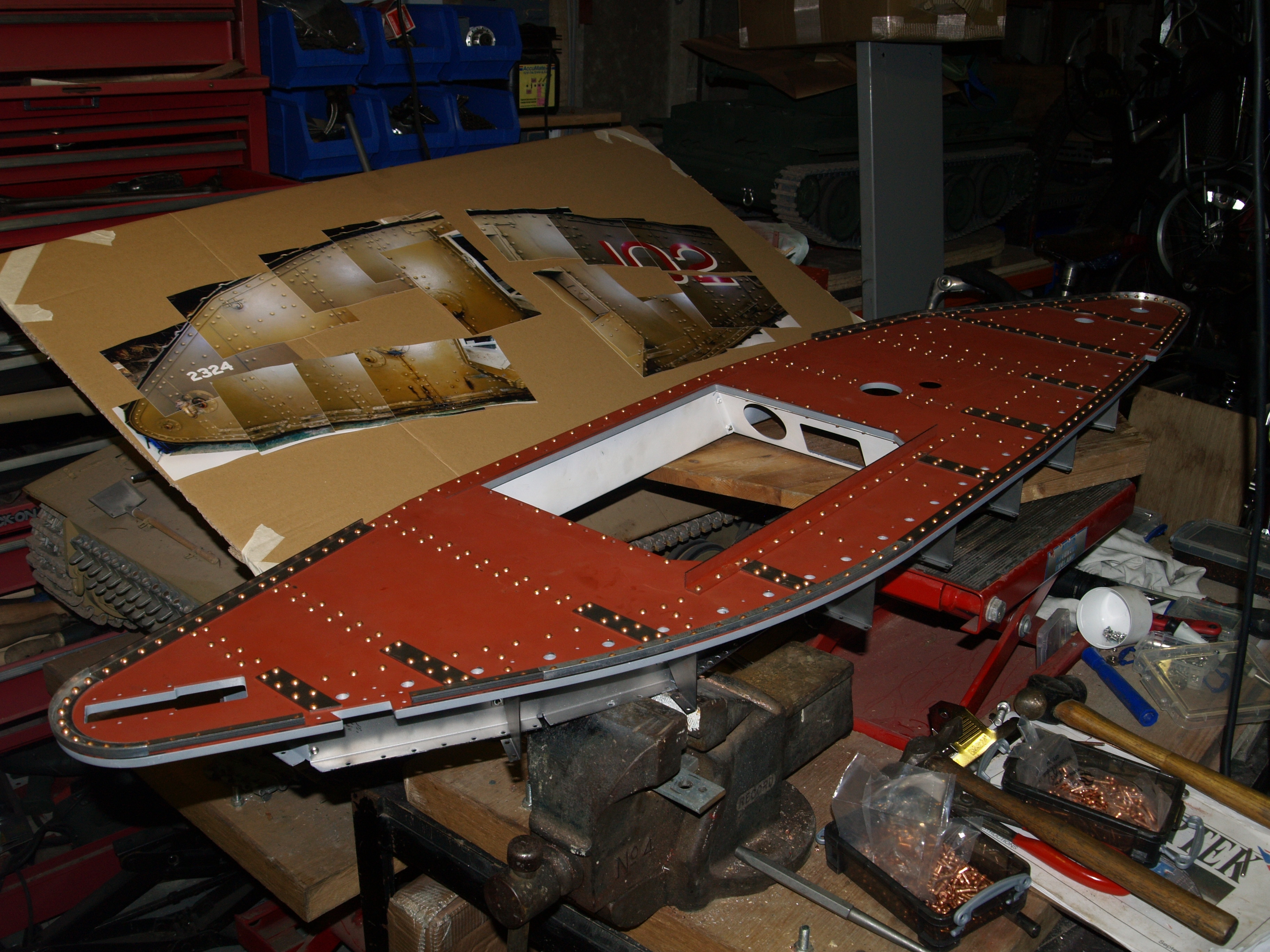

Rivet Pattern Collage
To help with the pattern of rivets and bolts I have made up a collage of photos, dead trendy art or what?
Hammering in rivets is going to take some time. :| I have realised that I need to a better sight of the roof to work out what is going on as most photos don't show much detail. So I will need to see if I can visit Bovington with some steps to get up higher.

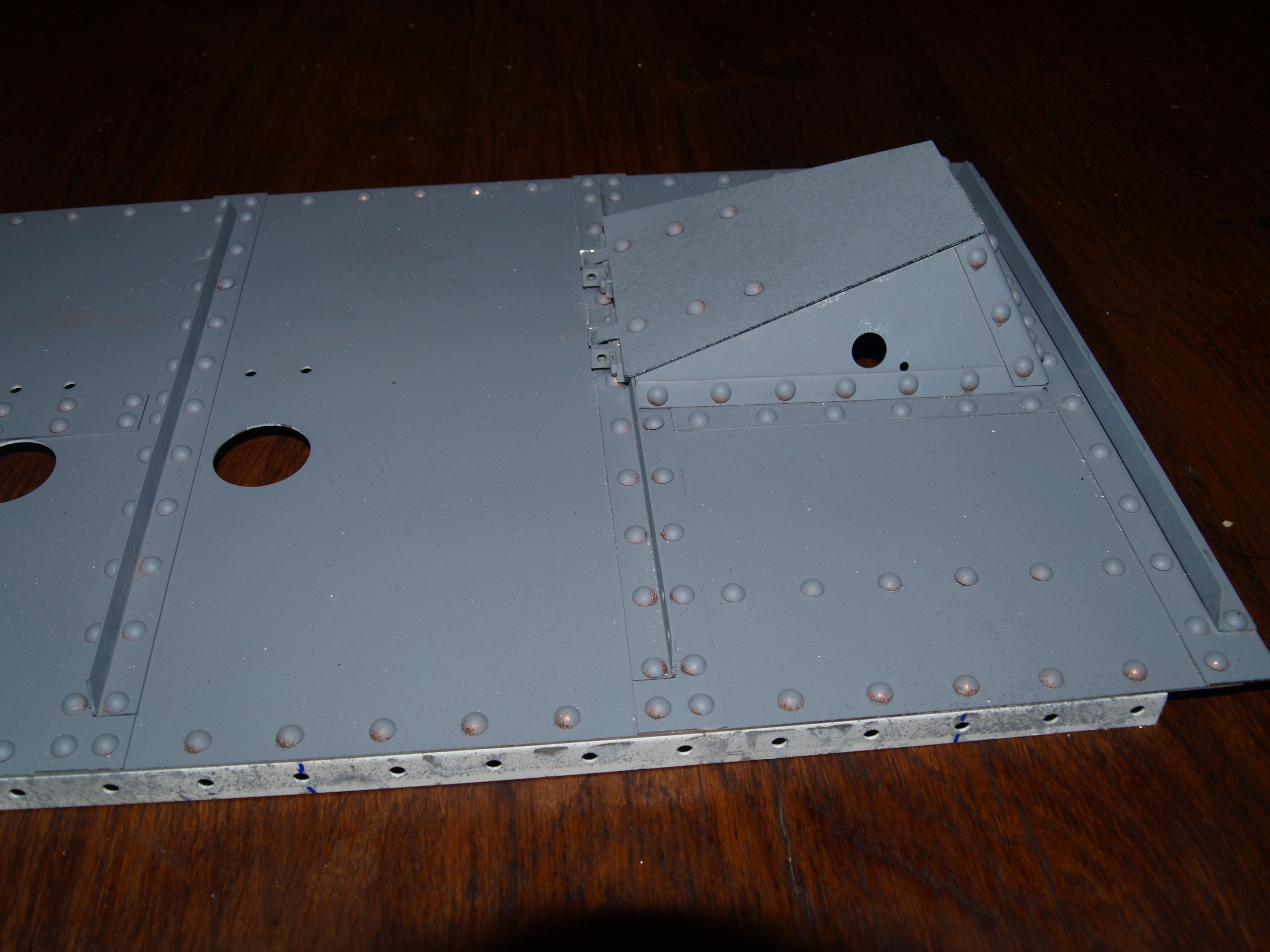

Good Evening Ray, and all other Mark IV Builders!

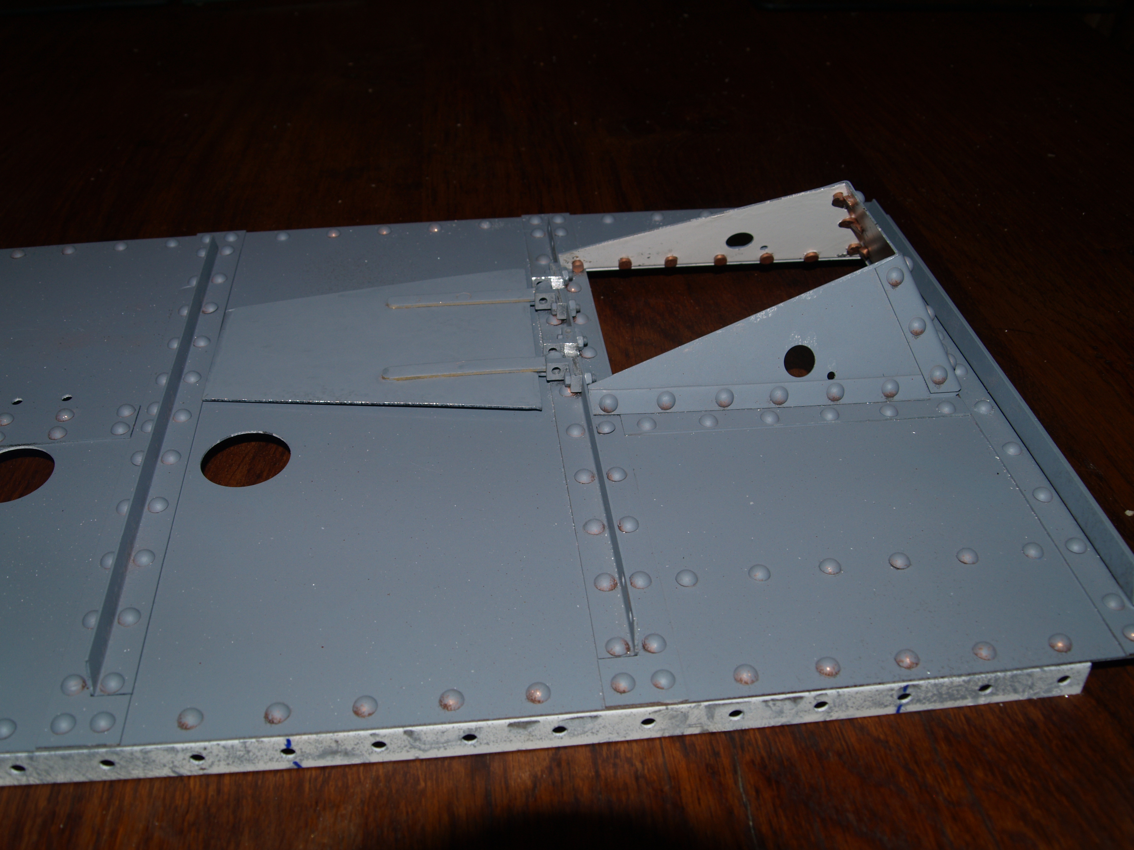

I have spent the last few days riveting the first Hull Side, I recommend red oxide priming as it doesn't show the blood :?, fingers get caught no matter what.
Pegging Plates
Pegging Plates
The 8mm bolts with shanks are used to peg the plates along with 'L' pegs that I have made out of 1/8" rod. This means that the rivets when inserted go cleanly through the layers of metal without catching as everything is correctly aligned.
Finished Plate
Finished Plate
One side after completing, although a couple of the rivets will need to be redone as they are not clean. There were three holes that needed drilling through along the top. That is where my collage helped to check the riveting pattern.

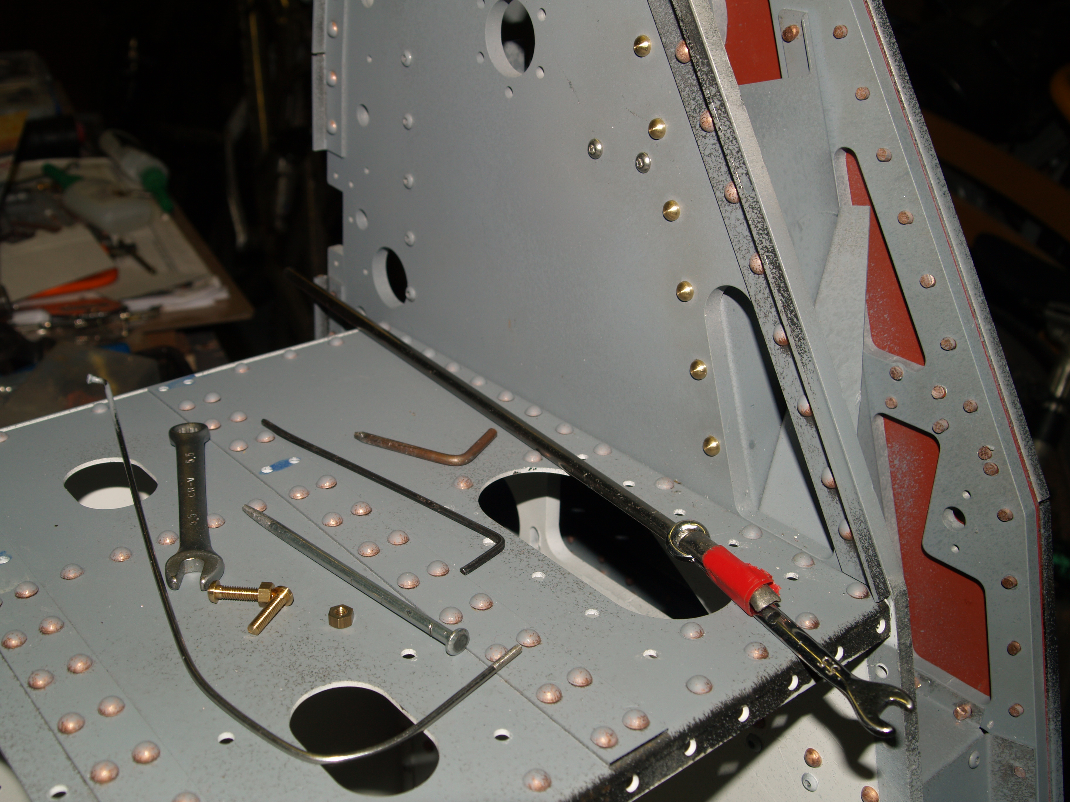

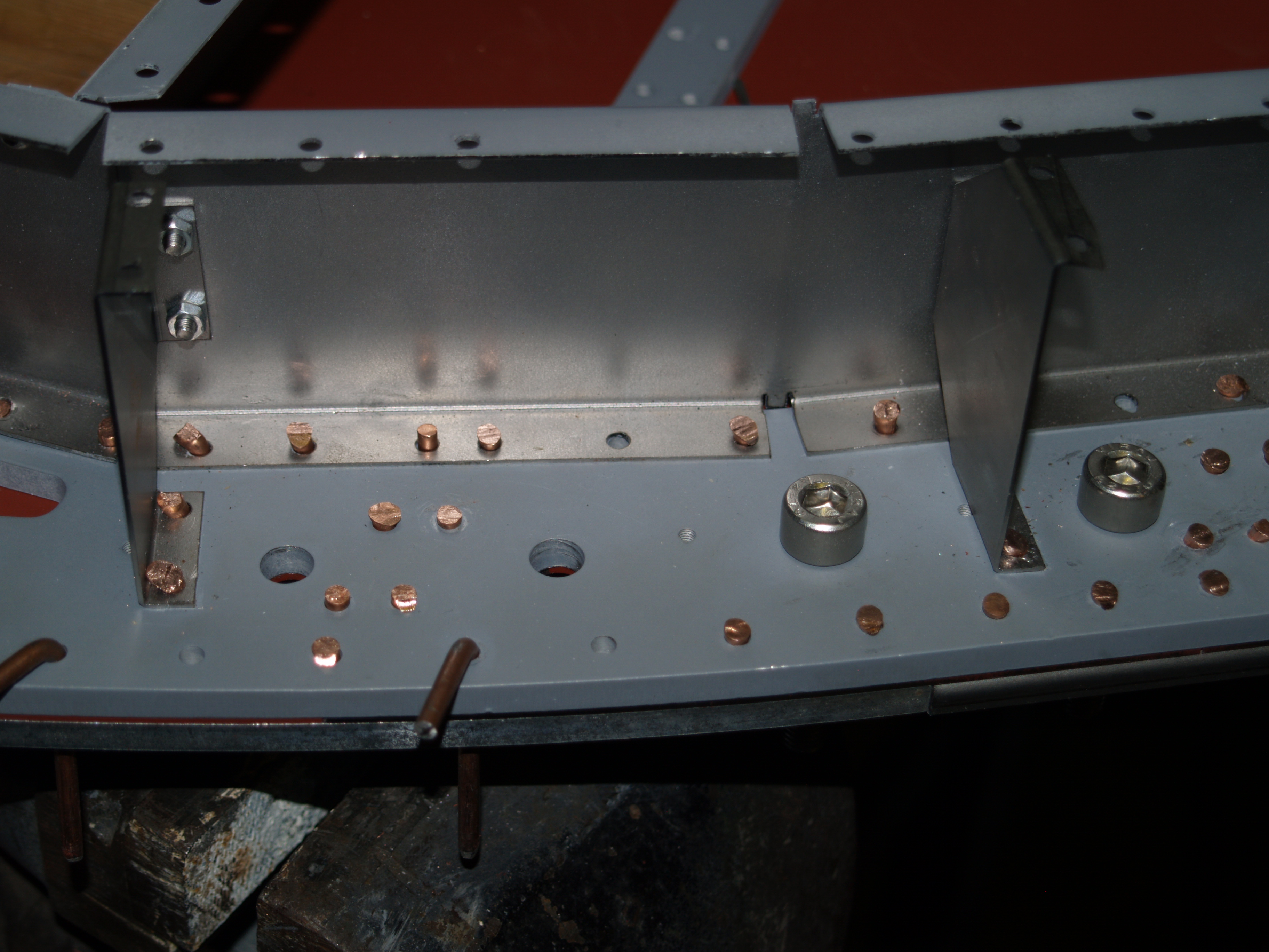

On another note, I have sussed getting nuts onto hidden/hard to get at bolts. Use a suitably bent bicycle spoke, push it through the hole, then thread the nut onto it, then slowly withdraw it leaving the bolt held in place against the hole with your finger tip. Next, simply screw the now aligned nut and bolt together. Voila!

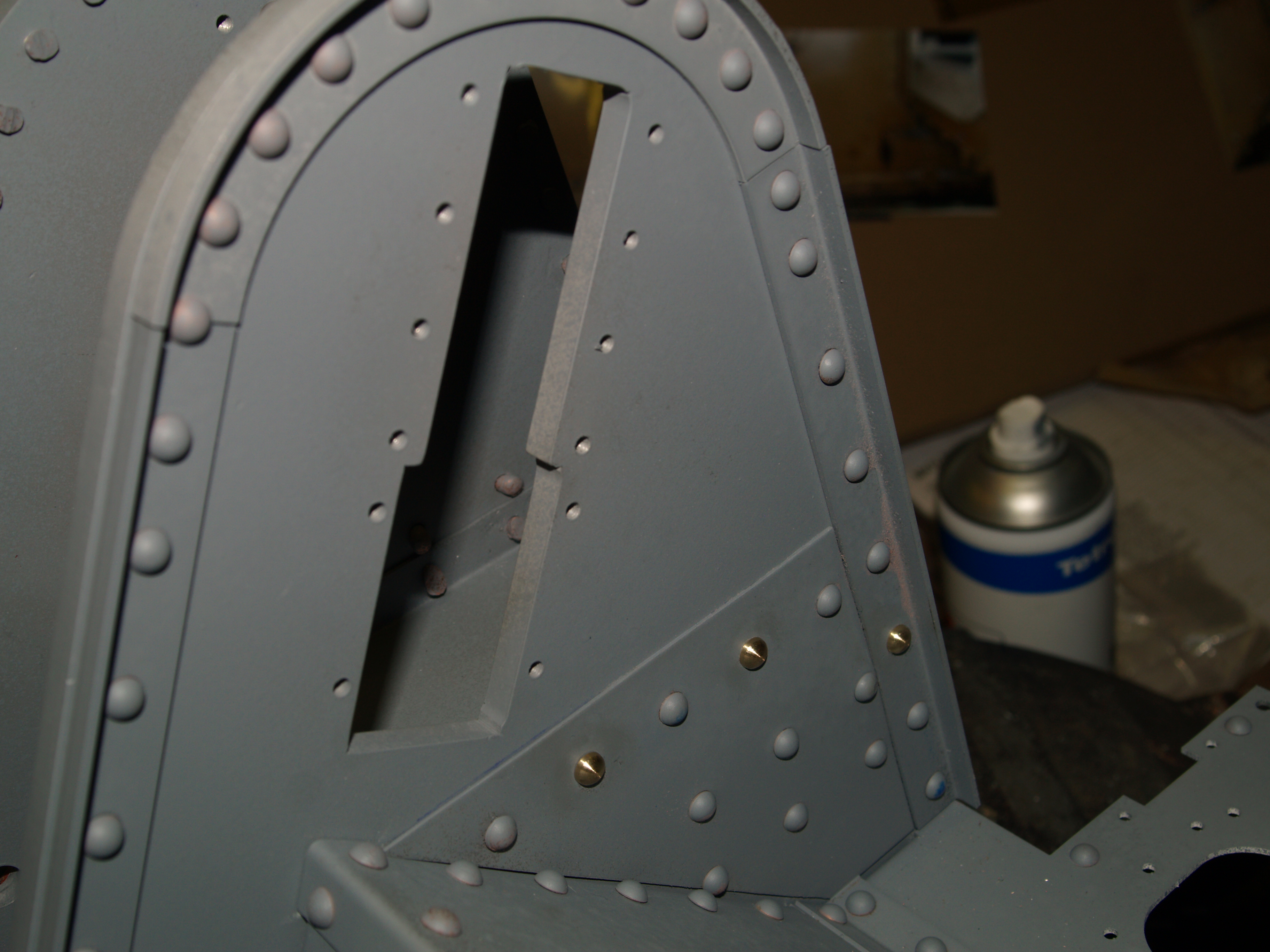

Round Headed, no slot 5BA Brass Bolts
Also in the photo is my steel 'podger' which is proving a Godsend in getting plates and fittings to line up so bolts go through.
Indistinguishable? very little difference?
Derek Atree put me onto the brass bolts- from EKP Supplies - and although they stand only slightly taller, they disappear into the back ground and are going to allow 'rivets' to be installed in places where a glued rivet would be no good as it will have no strength and will avoid using an Allen Headed Bolt. Plus where the hammered in rivet reveals that it has not gone in correctly and needs replacing the will substitute.

I have added some extra detail to the Rear House to replicate the angle around the bottom of it.
Rear House
Rear House
Also to the hatch, the hinges are riveted into place.
Hatch
Hatch
The photos I have taken give a sort of guide as to what needs to be there, but the detail is not enough to take it much further as there is little on what goes on top being available.
Now it is on with the Rollers and their fixings, 2mm nuts are going to be fiddly!

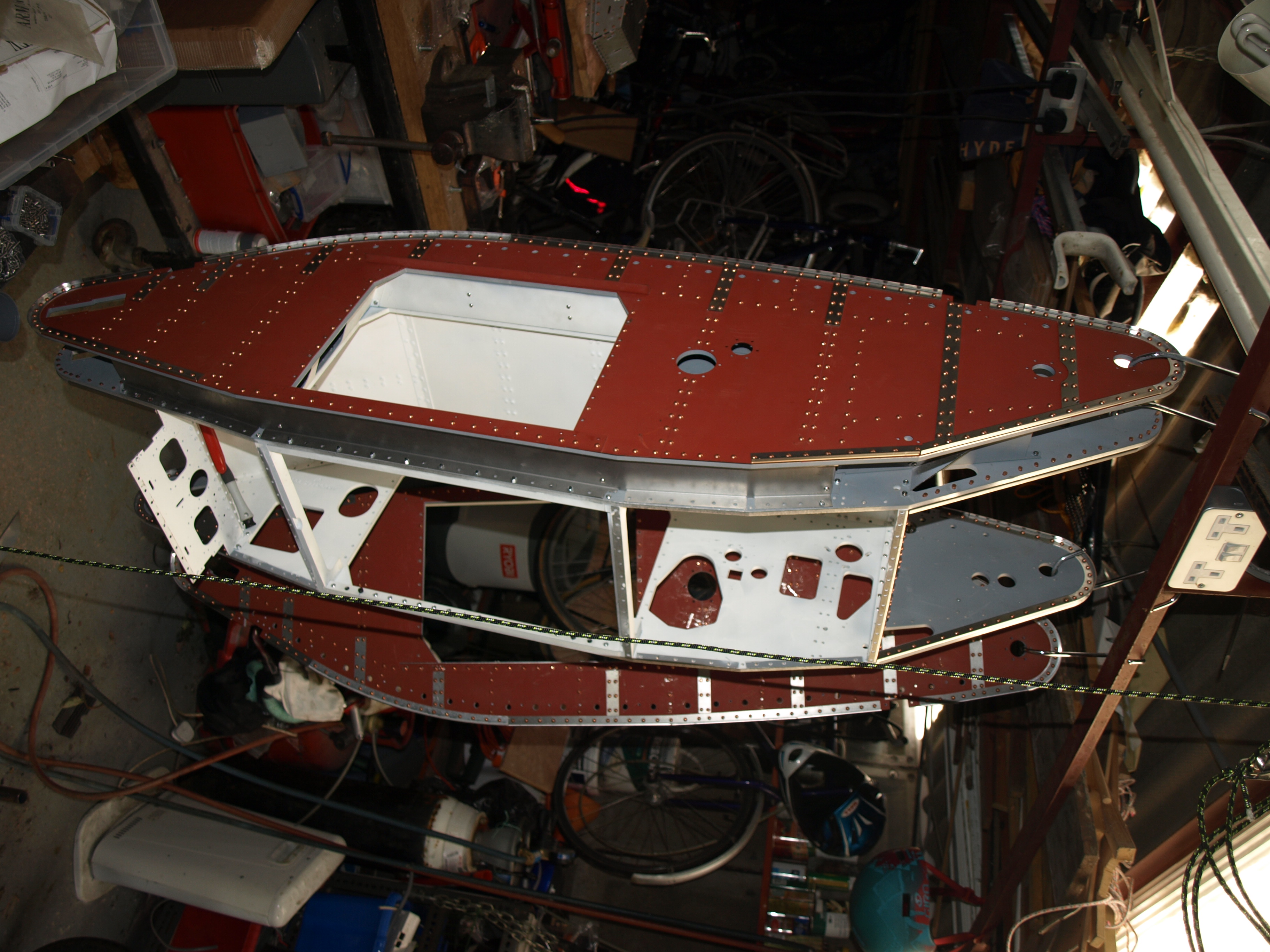

Hallelujah!
The Rollers are in and the Angles, U Bolts and Nuts installed! This in its way has been harder than the riveting as the 2mm Nuts have a propensity to come unscrewed at the slightest provocation before the U Bolts can be successfully hooked onto the ends of the Roller Axles.
Rollers and Angles
Rollers and Angles
Having got to the last of the angles I felt that I was getting into the rhythm. My strategy was to load the U Bolts on to the Angle with the Nuts caught on, having previously used the bare Angle to make sure that the slots in the Roller Axles were correctly positioned to accept the Angle. Then to carefully hook the U Bolts over the end of Axles, whilst simultaneously rolling the Angle up into the slots. This was the point that the Nuts unscrewed, meaning having to start again as it is not easy fitting the Nut on to an installed U Bolt. :evil: Once the Angle was located the 3mm Bolts were fitted keeping everything in place to allow the U Bolt Nuts to be tightened. :lol:
The Angles with eight U Bolts gave me the most grief, but thankfully Radio 6 keeps the brain from overload!

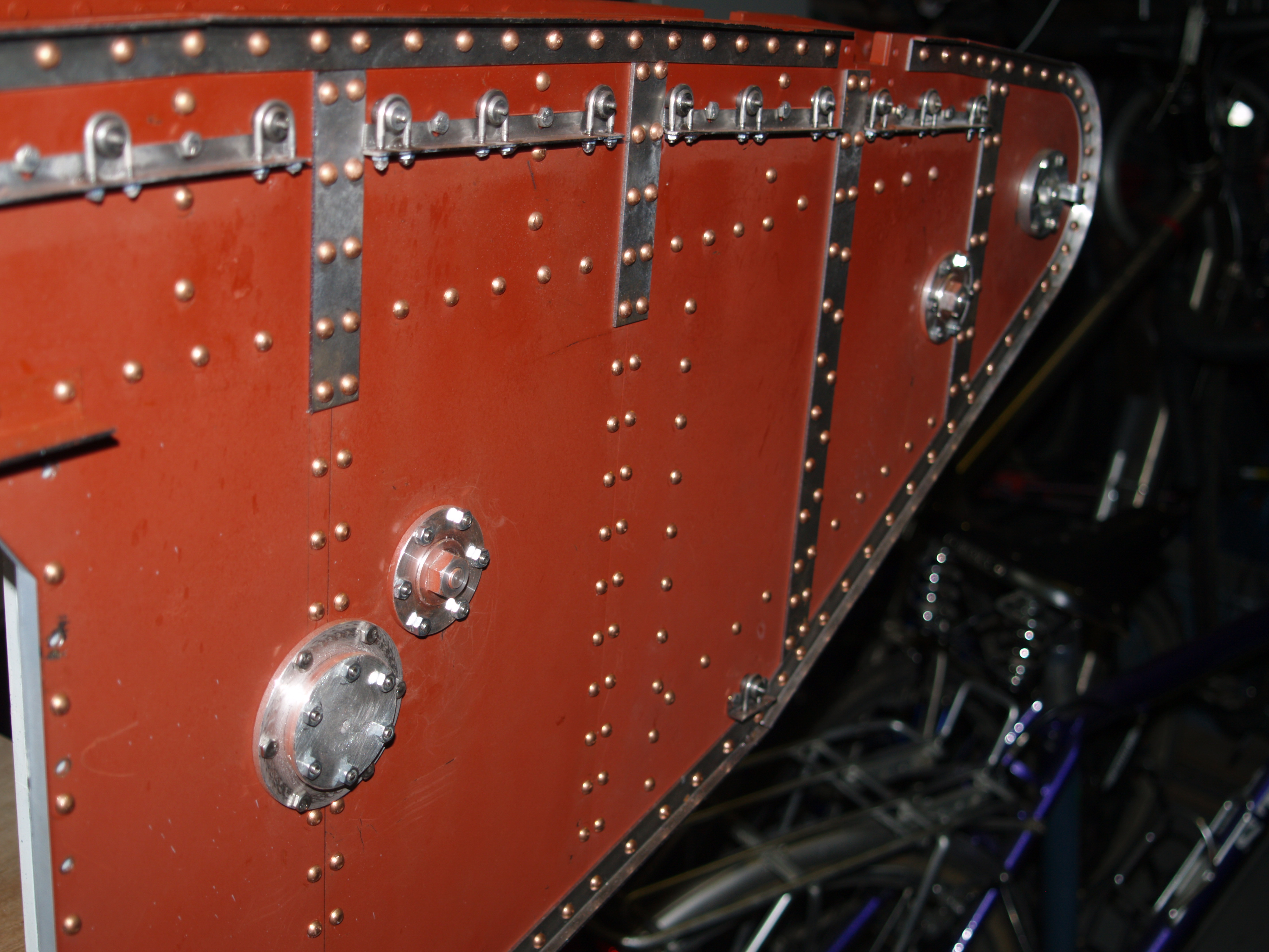

The covers illustrate the question of which way round the bolts go, in or out? Comparing different tanks and photos leads one to think that you have to find your own way. I have bolted most of the nuts on the outside as it is easier that way to fish the bolts into their holes from the inside.
Covers Installed
Covers Installed
The tank is now upside down for the fitting of the Rollers, it is now due to be right sided for building the Sponsons and then fitting them so they are demountable as in the real thing.
There are in estimation plenty of extra bolts that might be fitted to the Hull, but I counted the rivets, but have decided not to be a complete 'Nutter' 8)

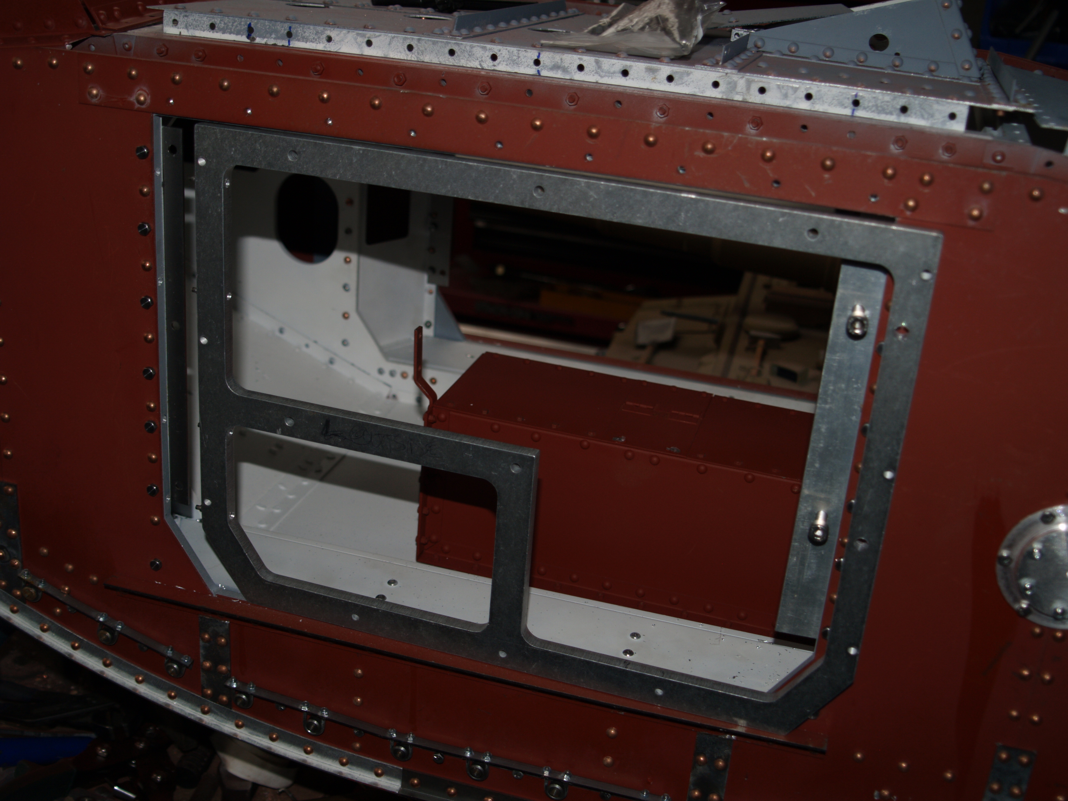

What with Christmas, the New Year and now Marmalade I have had time to think about how to easily demount the Sponsons.
Sponson Frame Overview

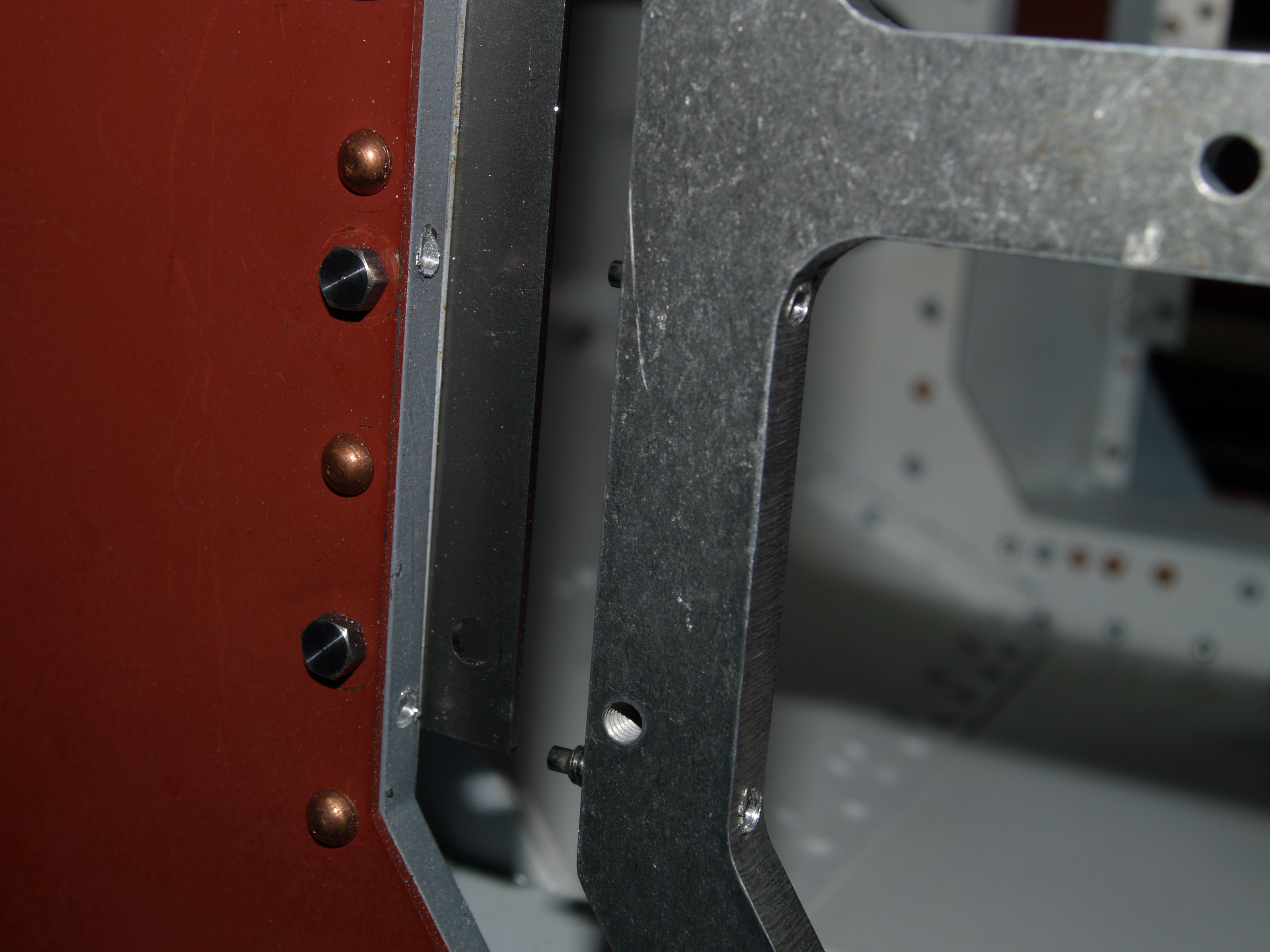

My solution is to have four '4mm Dog Grub Screws' on the forward edge of the Sponson Frame engaging into four holes on the edge of the Hull Plate To secure the rear of the Frame a new wider, thicker Fish Plate is fitted and Frame and the Fish plate is drilled and taped to take two 5mm Socket Headed Bolts.
Dog Grubs and Location Holes
These bolts are positioned so that a long Allen Key can reach in through the Rear Door of the Sponson so as to be able to simply detach the Sponson. The Dog Grubs can be adjusted with an Allen Key to solidly secure the Sponson. I certainly hope that this will be strong enough!
So now I can get on with the Riveting of the Sponsons :lol:
