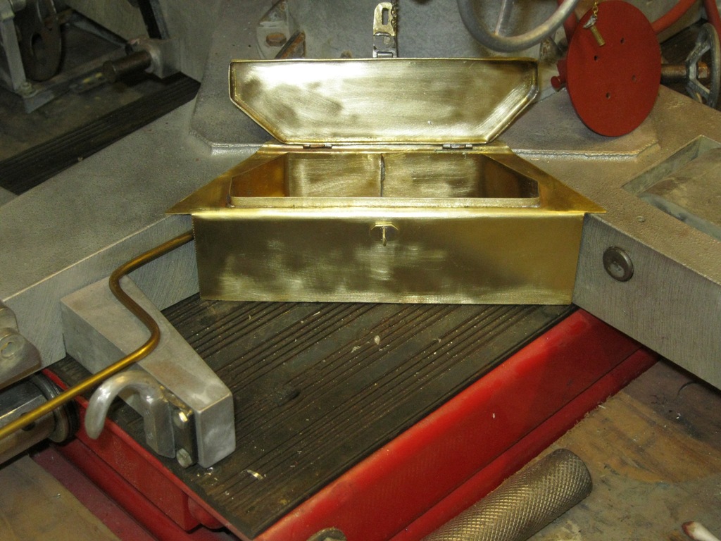

been busy with the tool chest for the flak and I am happy with the results.
I have also been making the electric cable pipes, but I cannot seem to get the connector right.

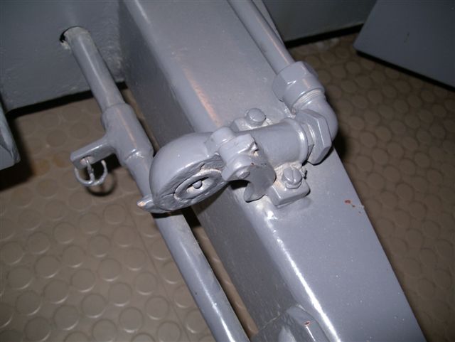

Uwe, you can only see bits of it until it is finished

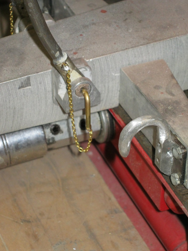

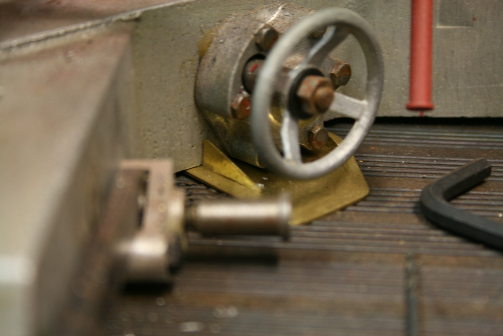

I have been working on the Gun travel lock spring/handle, some plates for the leveling adjuster wheels and the bogie hook's.
See if anyone spots whats wrong
Paul

Ok is that one of the pictures of the adjusting wheels is shown the wrong way round? (probably the real one?} Whats the prize?

If I read your post correctly you are half right you are correct it is the leveling wheels

To be honest I was trying to look further than that< thinking the wheel was too obvious

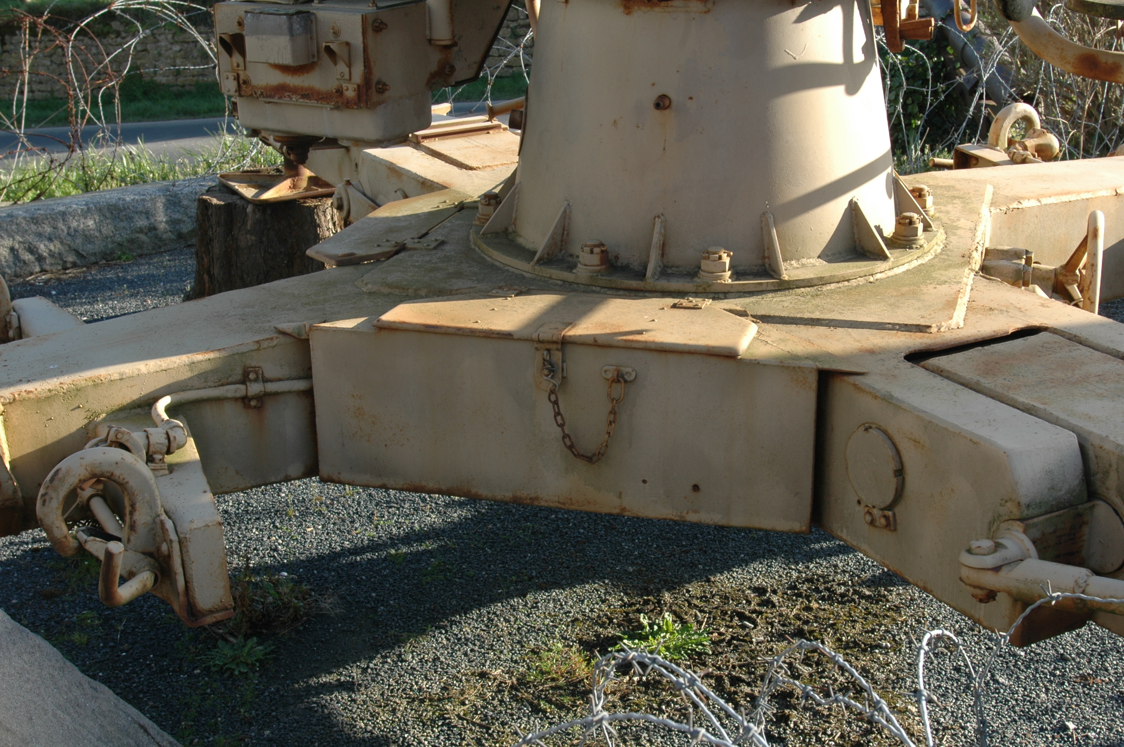

Hi Paul glad I didnt win! What is throwing me is that on your model the housing seems to be the right way round for the left hand wheel with the wheel on the left hand side of the housing. Your piccy of the real one shows the wheel on the opposite side with the housing back to front (if you see what i mean) Or does the real piccy show the the right hand side wheel? Cant see that this fits though. Not usually a detail freak as you know but my brain now hurts and I need to know!

To save you going into melt down the answer is, the wheel should be the right side of the housing and the housing should be closer to the left side

Ha I was half right then- thought it was the position of the wheel. What threw me was that the model I have has the wheel housings the same way as yours, but looking at various photos its clearly wrong. Presumably the housings can be switched round and I only get 1 day at Funny Girls.

I assume that there has been a simple exchange of the housings (lhs to rhs) for "mid cycle savings" The "direct-drive" is easier and cheaper, that's fact
Exchange the housings and add a 1:1 gear ratio and whe're home again (that is at least on my agenda)
Your chest and the lots of other "fiddly" details are looking absolutely brilliant
