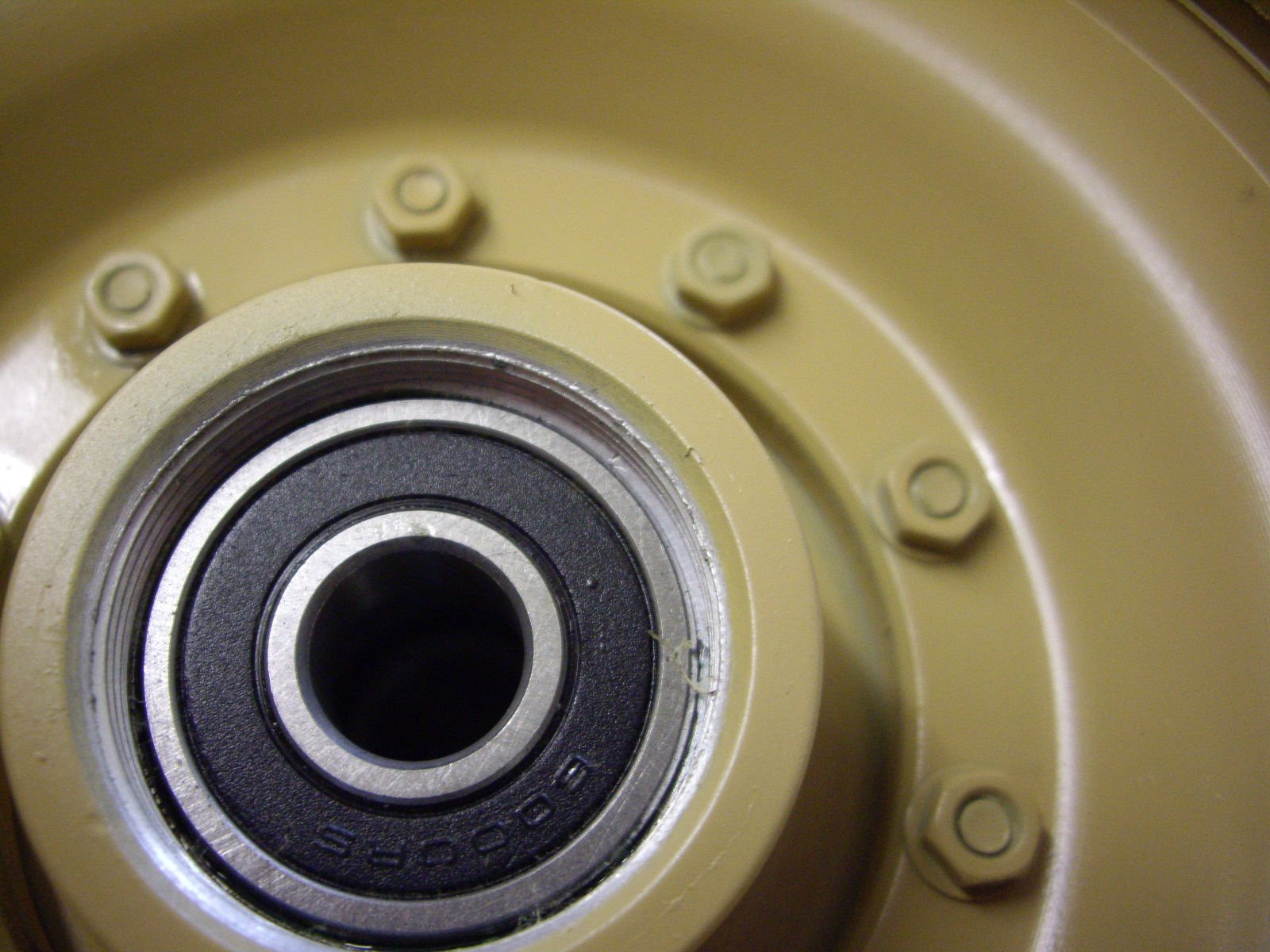

Re: Centurion #18
Hi Kevin,
Just took a snap of my wheel bolts as I could not remember the length I used.
There is a flat washer on the nut side and thread lock to keep them from coming loose.
You don't want masses of thread sticking out of the nut when tight so that's the measure for the right length of stud. I also took a pic of the idler bolts too with nyloc nuts fitted. Hope this helps, Mick

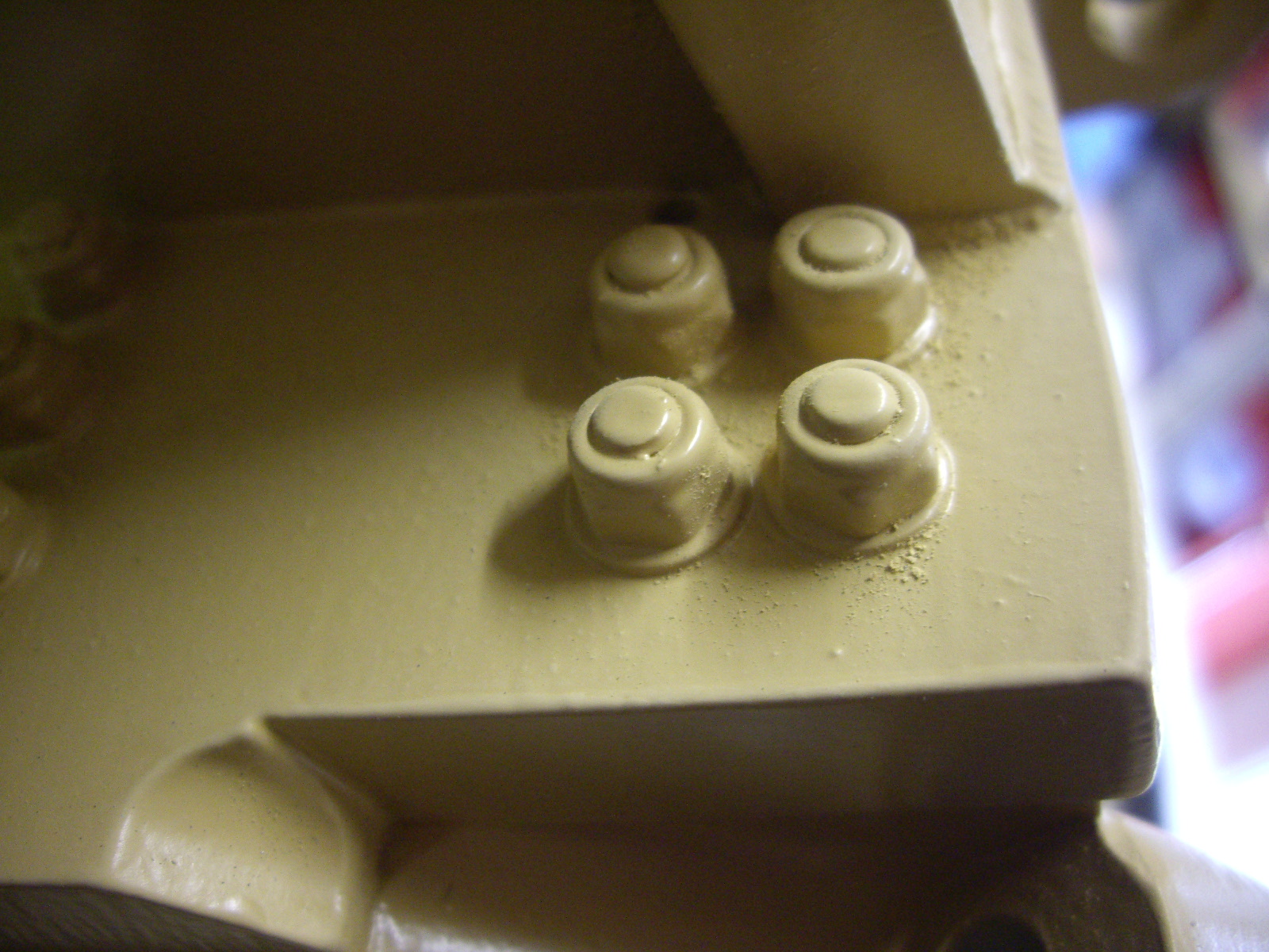

Re: Centurion #18
Sorry me again! Seem to have hit a snag.
Tried attaching idler bracket using M3x20 hex bolts as suggested but ran into a few issues. See picture:
right hand nut in middle row required a tiny bit of the side plate to be drilled, just enough so that the nut could get onto the bolt.
right hand nut in top row prevents the glacis plate from fitting properly
I could only find 12 M3x20 bolts.....and there are 18 holes!
Problems 1 & 2 are the same on the other (right hand) side of hull
What am I doing wrong?
Kevin
Kevin

Re: Centurion #18
Hi Kevin
The inner four holes at the top, the ones nearest the side plates, are tapped. You should use M3x16 or M6x12 hex head screws in these four positions, without nuts. This leaves 14 positions for the M3x20 hex heads, which were included with your kit. Let us know if you need some more.
