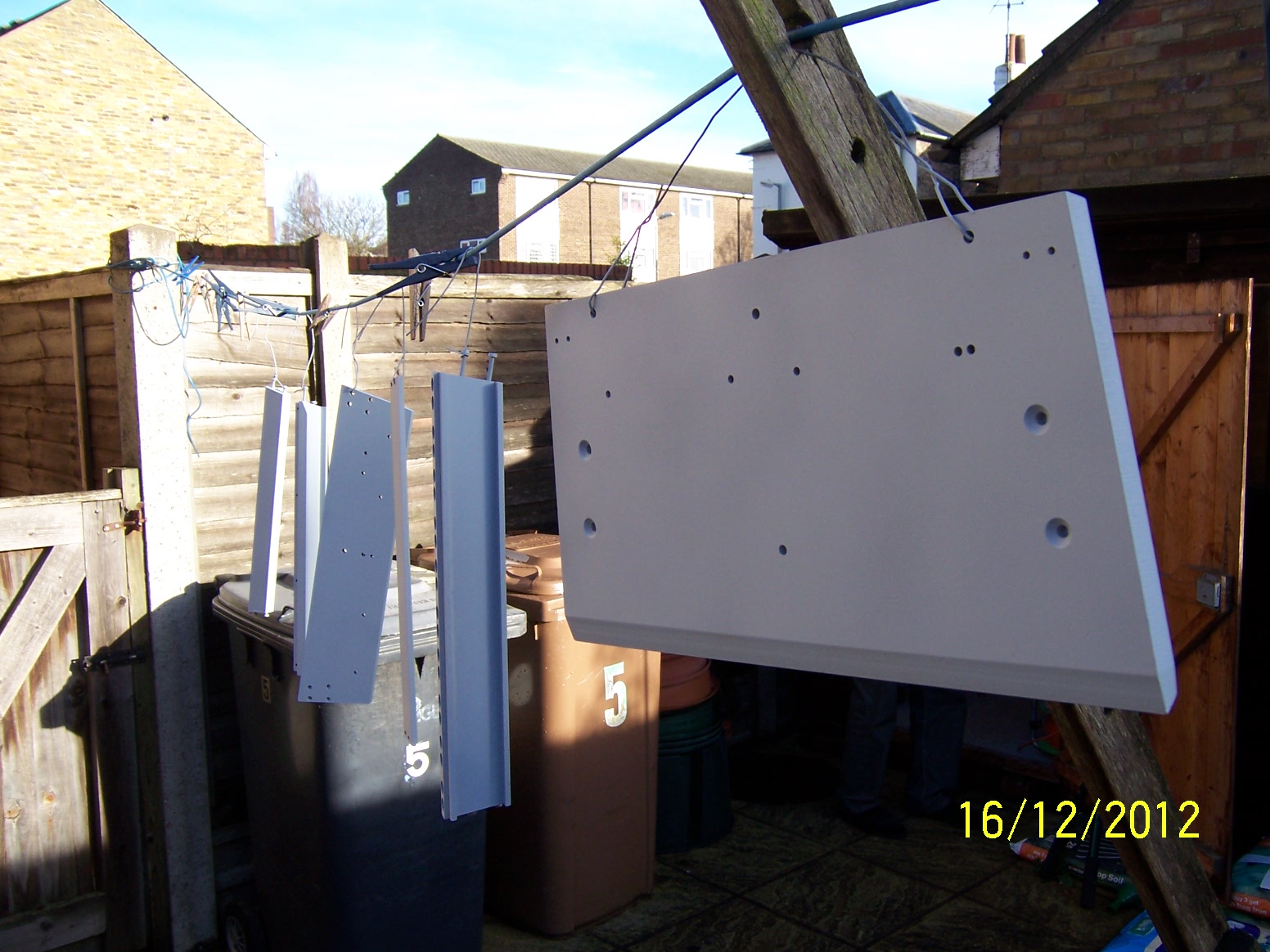

Finally acid etched the main hull parts.
Sunday laundry
Sunday laundry
Should get them together over Christmas.

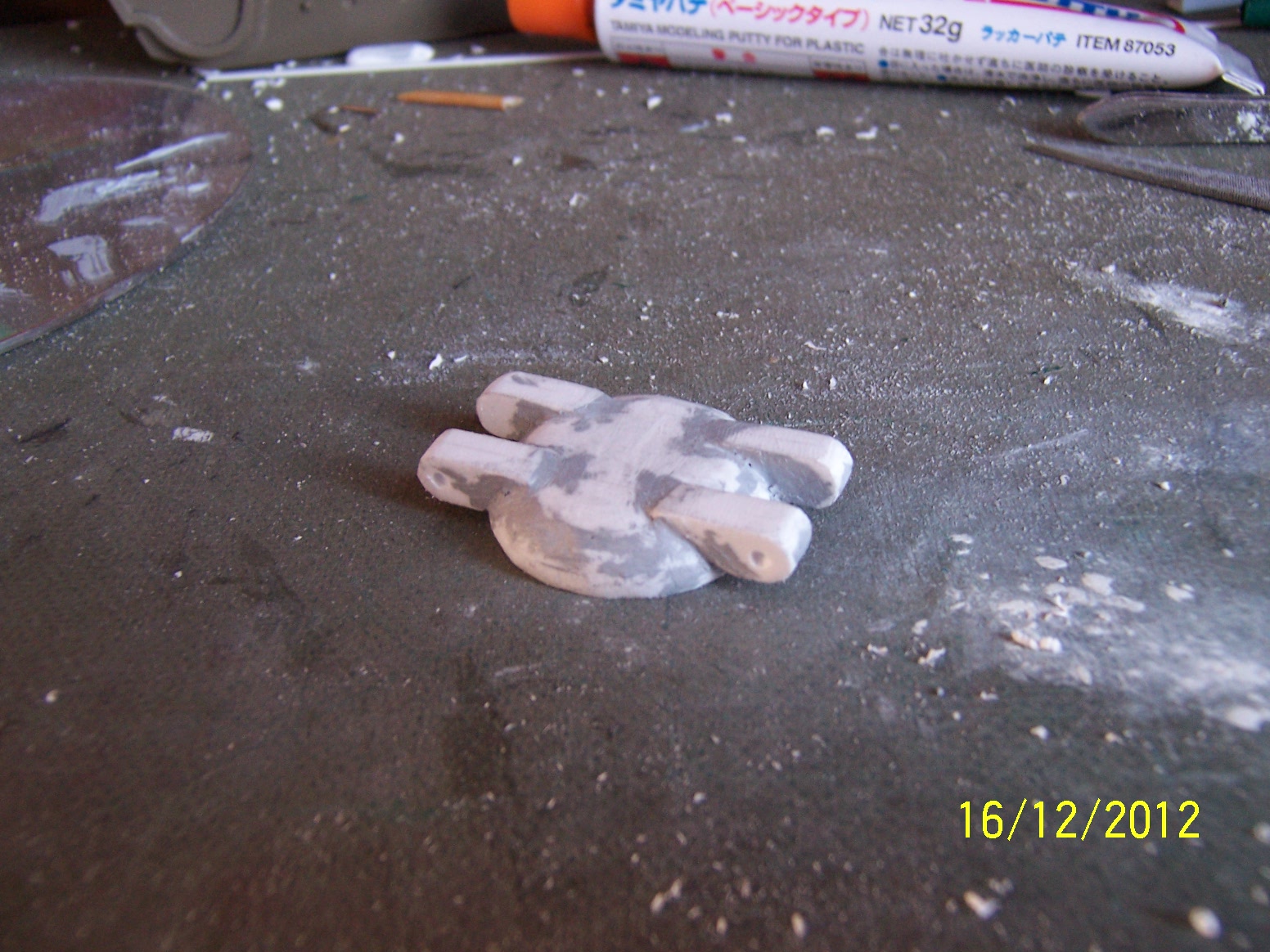

Here is the master filler cap:
The mess is from all the grinding :)
I may be getting closer to success with the casting, it seems to take much longer for the rubber to set than the 24 hours stated. The latest attempt is solid but sticky, I'll leave it another week.

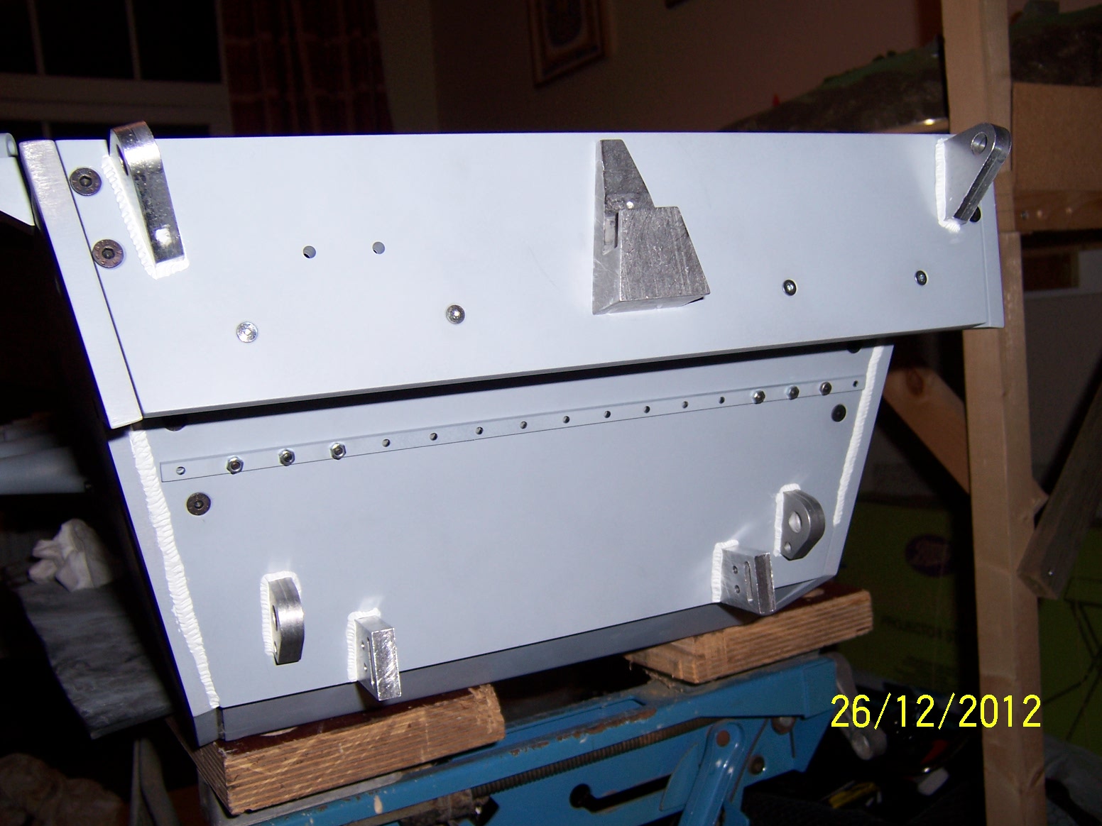

I hope everyone had a good Xmas,
This is a halfway holiday report :)

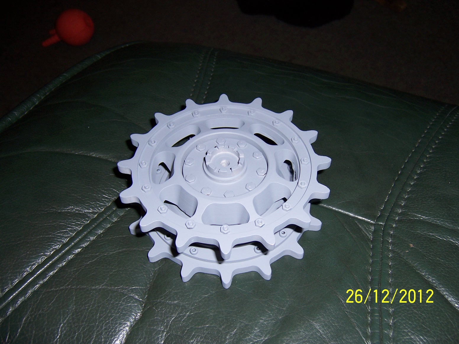

Drive wheel
Drive wheel
I created the missing bolt detail around the centre by glueing on spare nuts and filling the centres with Milliput.
Idler
Idler

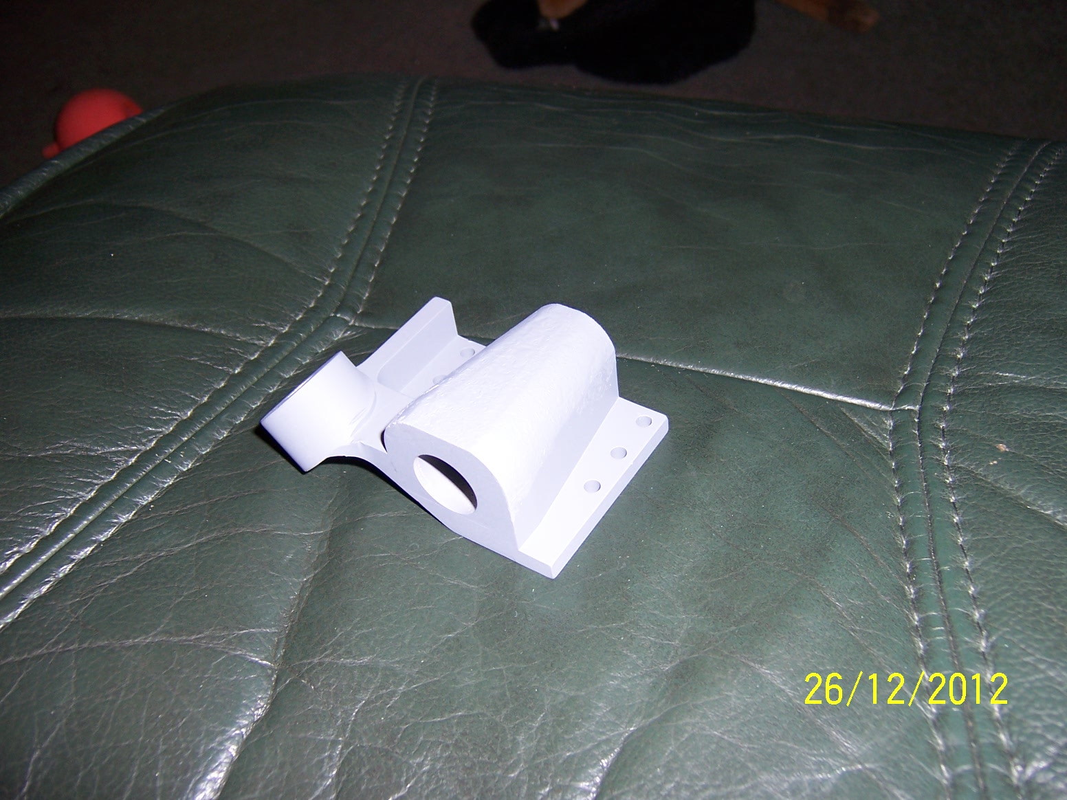

Idler mounts
Idler mounts
I'm not sure if it's that easy to see, but I created some cast texture with Tamiya putty on the idler mounts.

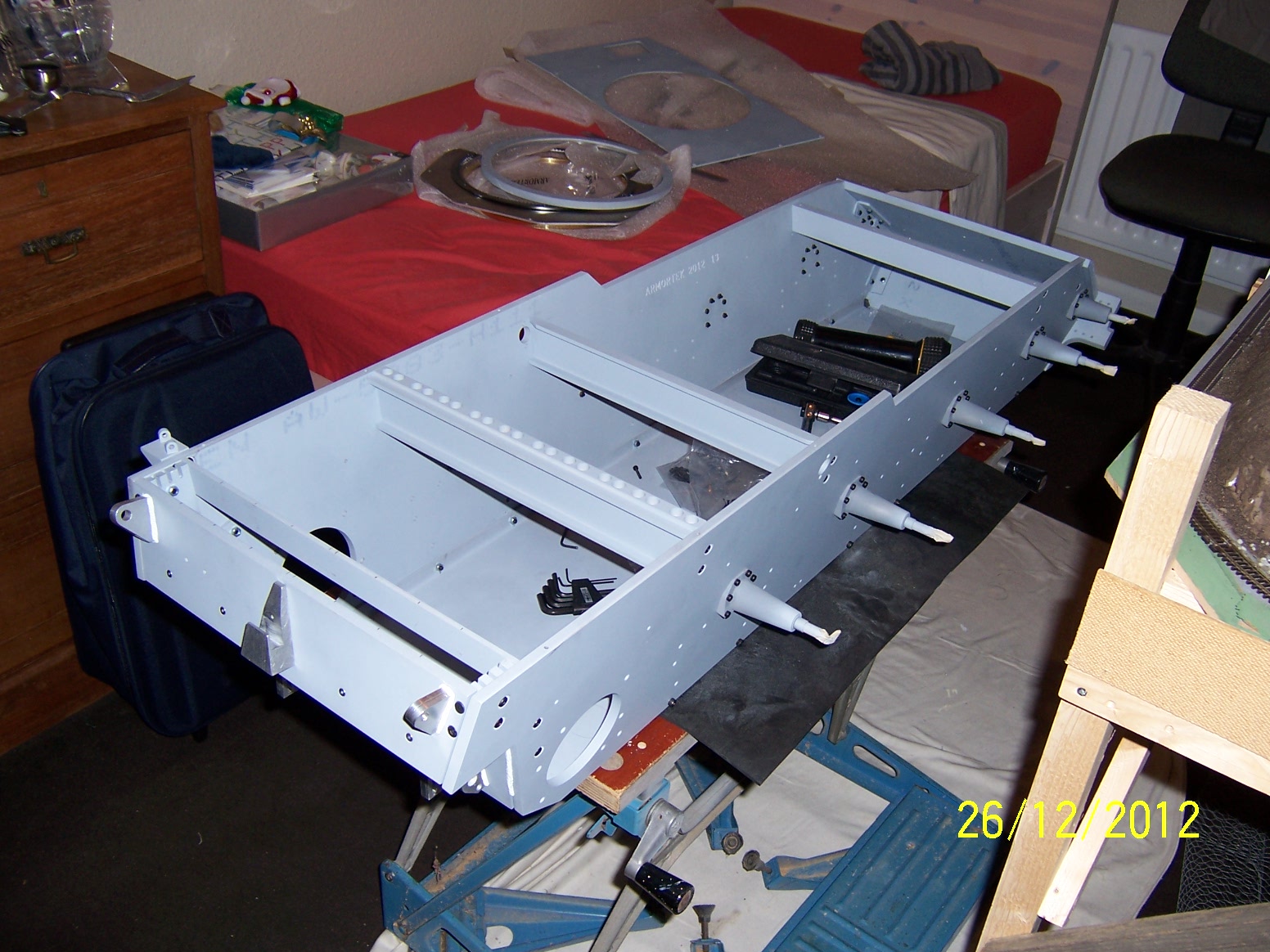

Here is the current state of the hull, roller houses attached and some rear parts fitted.
First welds added :oops:
Plenty more holiday left, hopefully a lot more progress before the return to work :)
Robin

I see you addressed the "missing" bolt detail from the drive sprocket. I used M3 bolts and nuts to achieve the same thing, the cap heads fitted inside the hub with no fouling the taper lock bush.

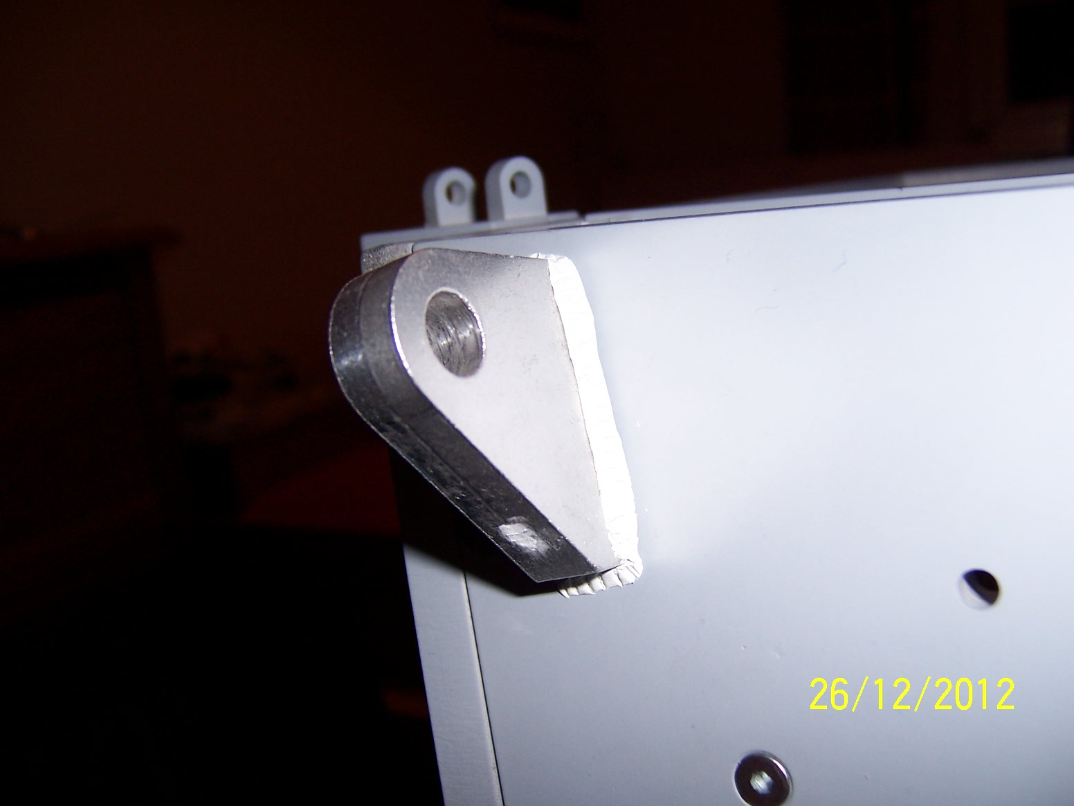

Hi, I have a quick question about the idler assembly, in the instructions it says the axle should be screwed fully and firmly home but I end up with a gap at the swing arm face which translates through to the spigot eye only having half the shaft inserted:
I'm worried this may affect wheel alignment.

Hi Paul,
I had the same result in my first fit, the axle needs relieving a little where the threaded portion butts up to the arm.
I did this in my lathe but you could manage it with a small file. The lack of a relieved area stops the axle screwing
Right home. Hope this helps, Mick
