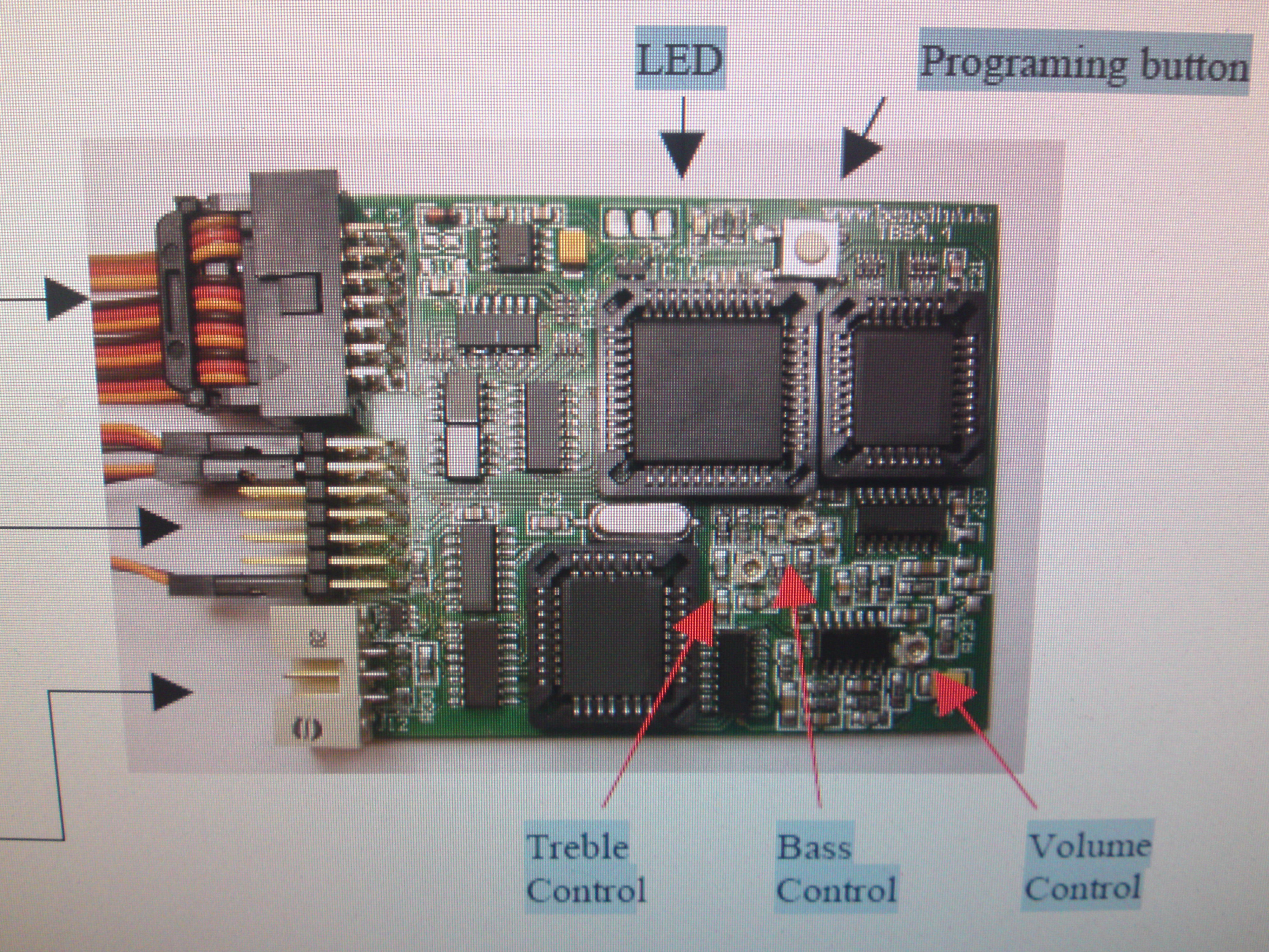

Yes today i switched them back around to the way they show in the manual. Get The pop in the beginning and the volume hiss but nothing else.

It good to see in your last video that the transmitter set up are ok. A few things that might help:
Go to benedinisound system home page http://www.benedini.de and do a printout of the manual for the soundcard. It has an english and german choice.
Read the pages from 1to 15 at least two times untill you are sure that the number of flashes on the led are right.
When you are doing a restart be sure all controlsticks are neutral and the toggle switch are in SENTER posison.
If this dont help out, futher help is possible. To be able to help out more a good steady No camera movment of the whole set up would be great.
Ragnar

Hey Ragner thanks for the reply.
I will check that site out thanks, And i will leave a link below of my board wile programming.
Thanks for all the input.
Steven Raison

hi steven
just looked at your video as was mentioned already the clunk you get is the just the power up sound when you press the reset button you should get three loud clicks and then all the sounds that is programed in the board as we see you not getting them.
i think your problem might be that you have lost your sounds program i had this happen to me with mine somehow i lost them when it was in transit i got in touch with thomas and sent it back and he reprogramed it ( mine is the older tbs5 board )i dont know if their are fail safe measures set in to stop this in the new boards thomas does look in on the forum from time to time maybe he might chime in

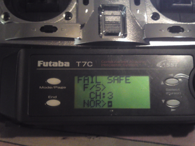

Hello all!
Have a Tiger 1 Late Production 2012-020
And Futaba 7c transmitter
I wonder if any more than I have experienced having problems with recoil servos and flash in the barrel constantly goes with engine noise. or suggestions on what it may be due. All suggestions are welcome.
I activate position 4 the recoil servos and flash reacts properly
The problem is in position 1 then starts recoil servos and flash too. If I'm in this mode activates position 4 (sound cannon) When recoil servos and lightning continues to react to the sound of the engine.
best regards
Stefan

Have you disabled the failsafe ? Maybe not the cause but there was a red notice to do this.
Dennis.
