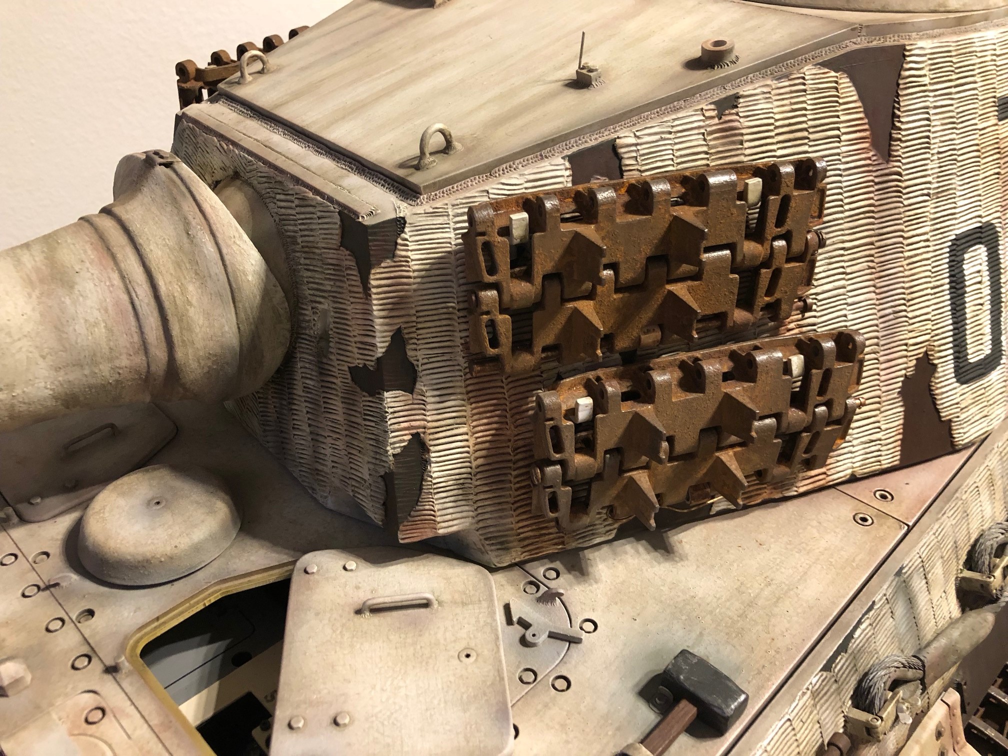

Nice to see some of Olaf's steel track links again. I also use them on three models (but not rusted artificial like these).

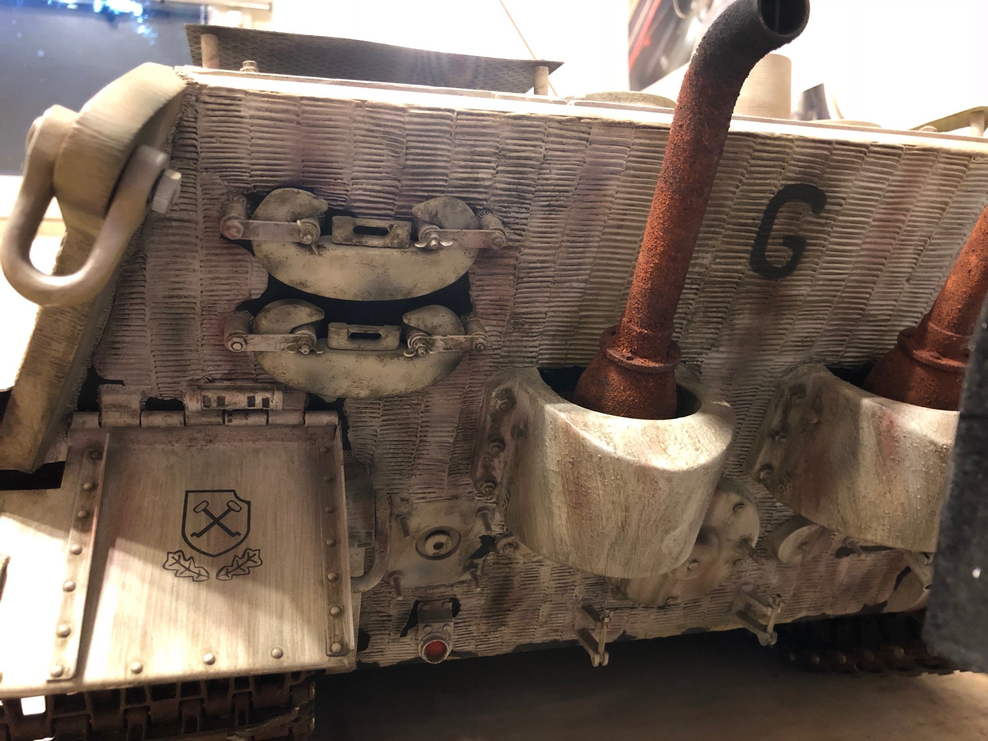

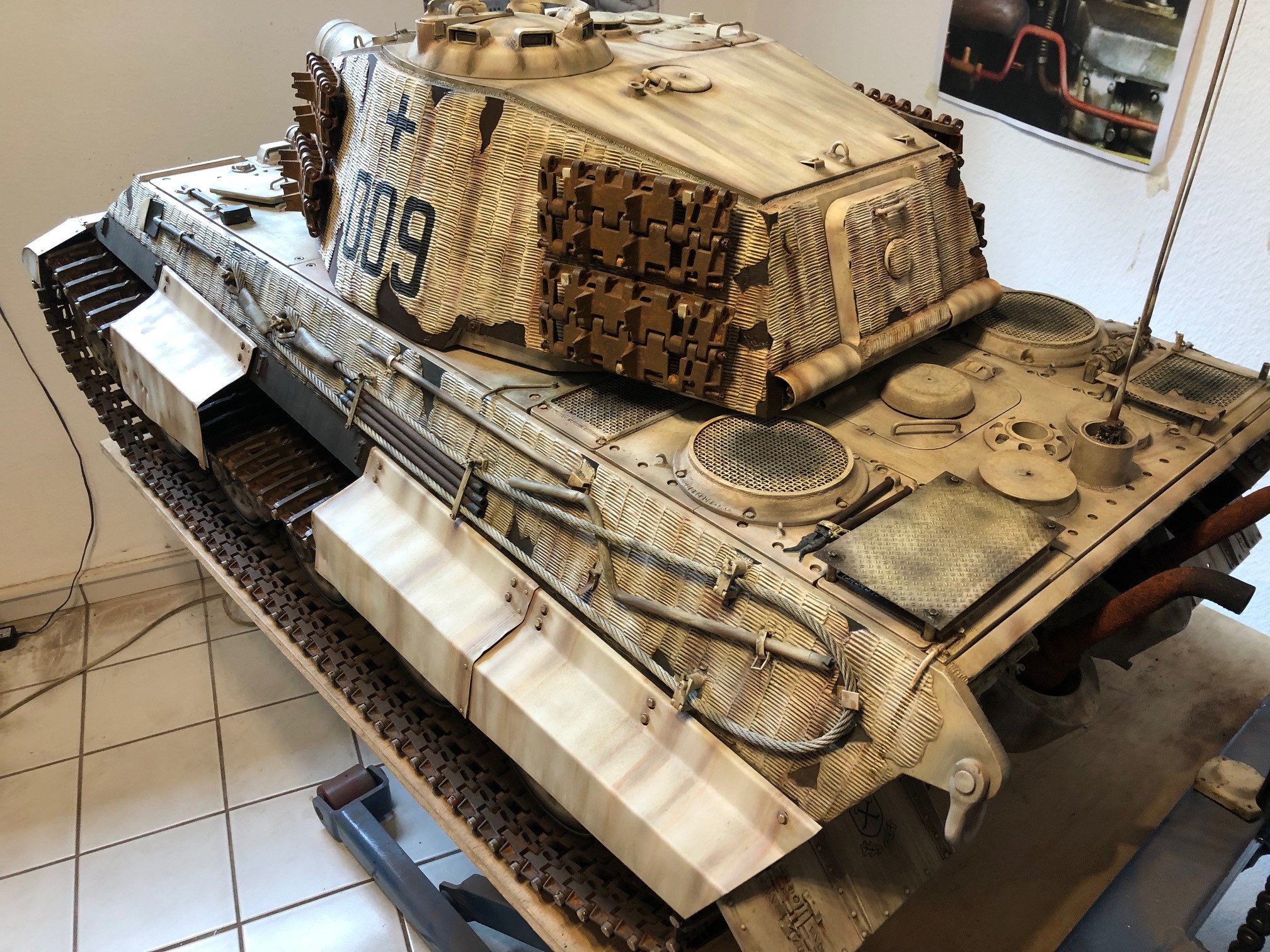

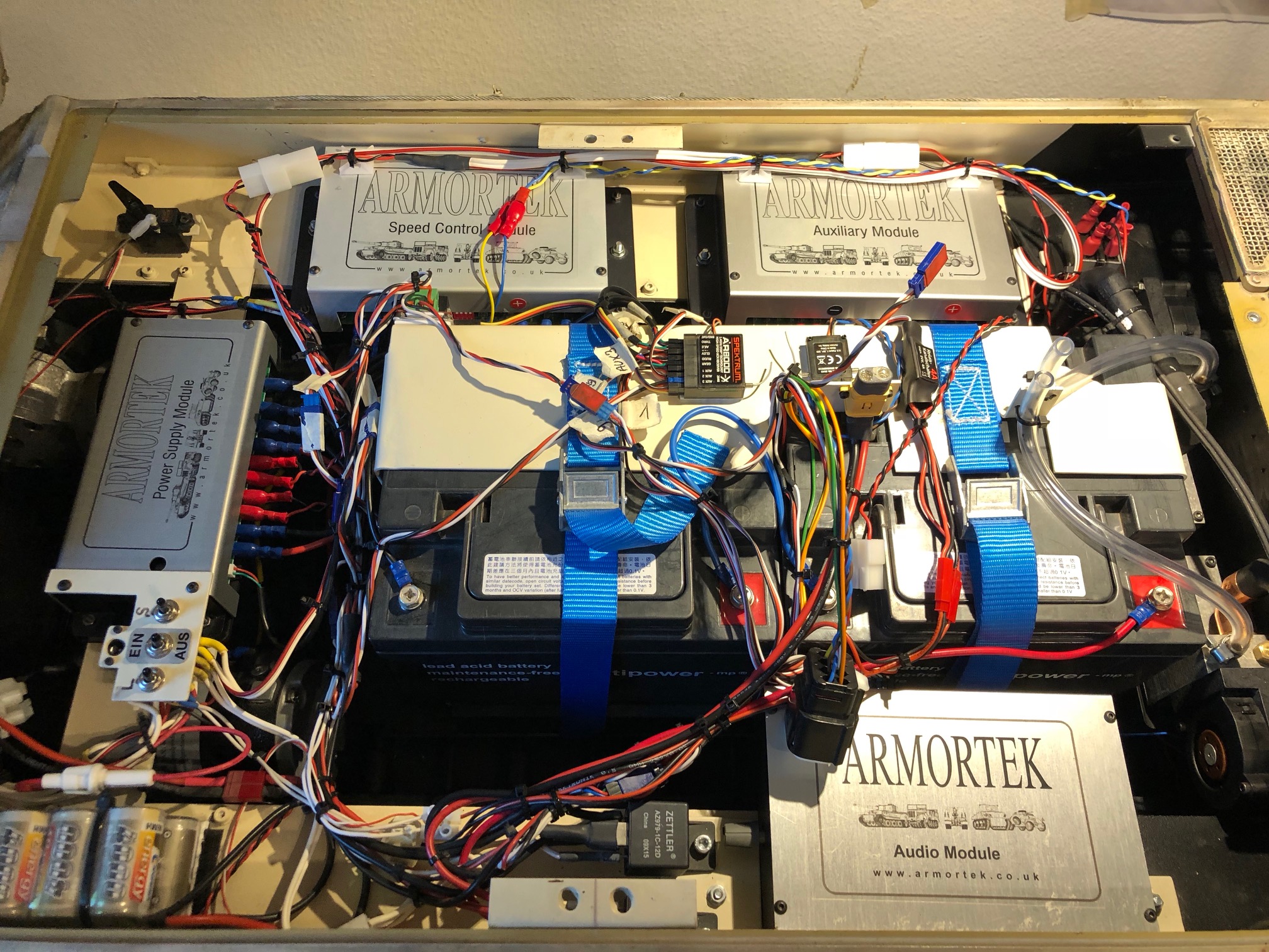

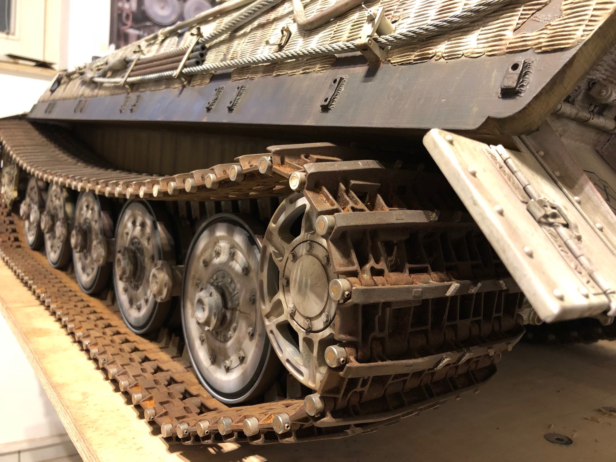

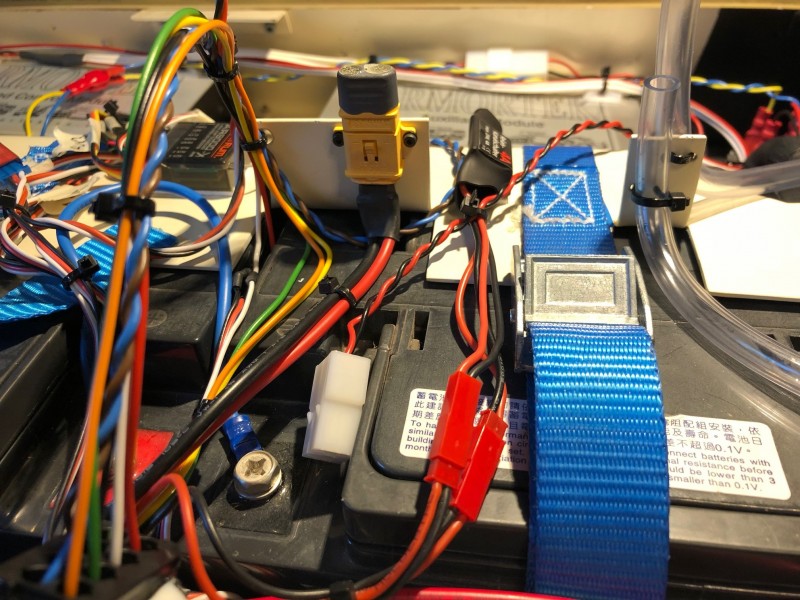

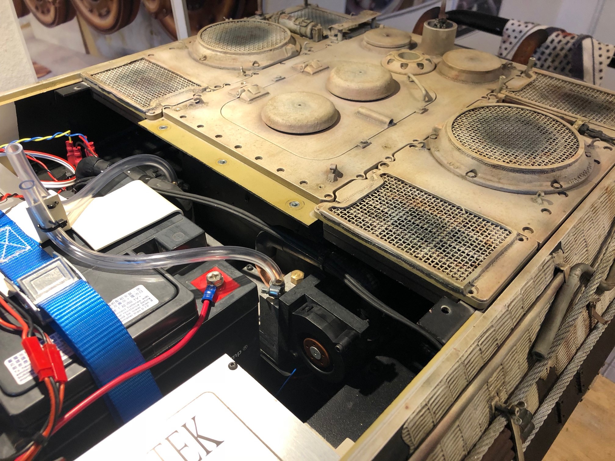

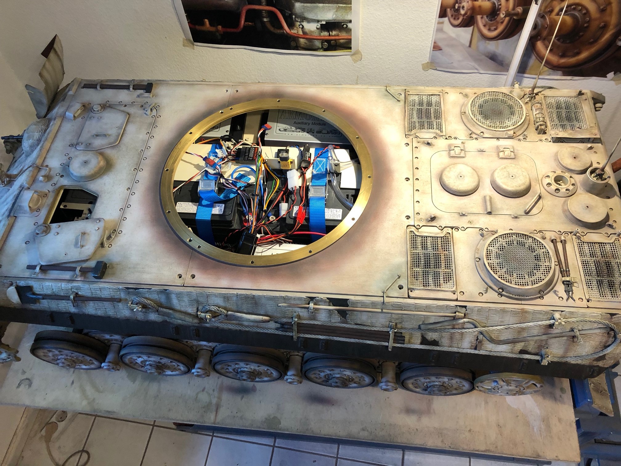

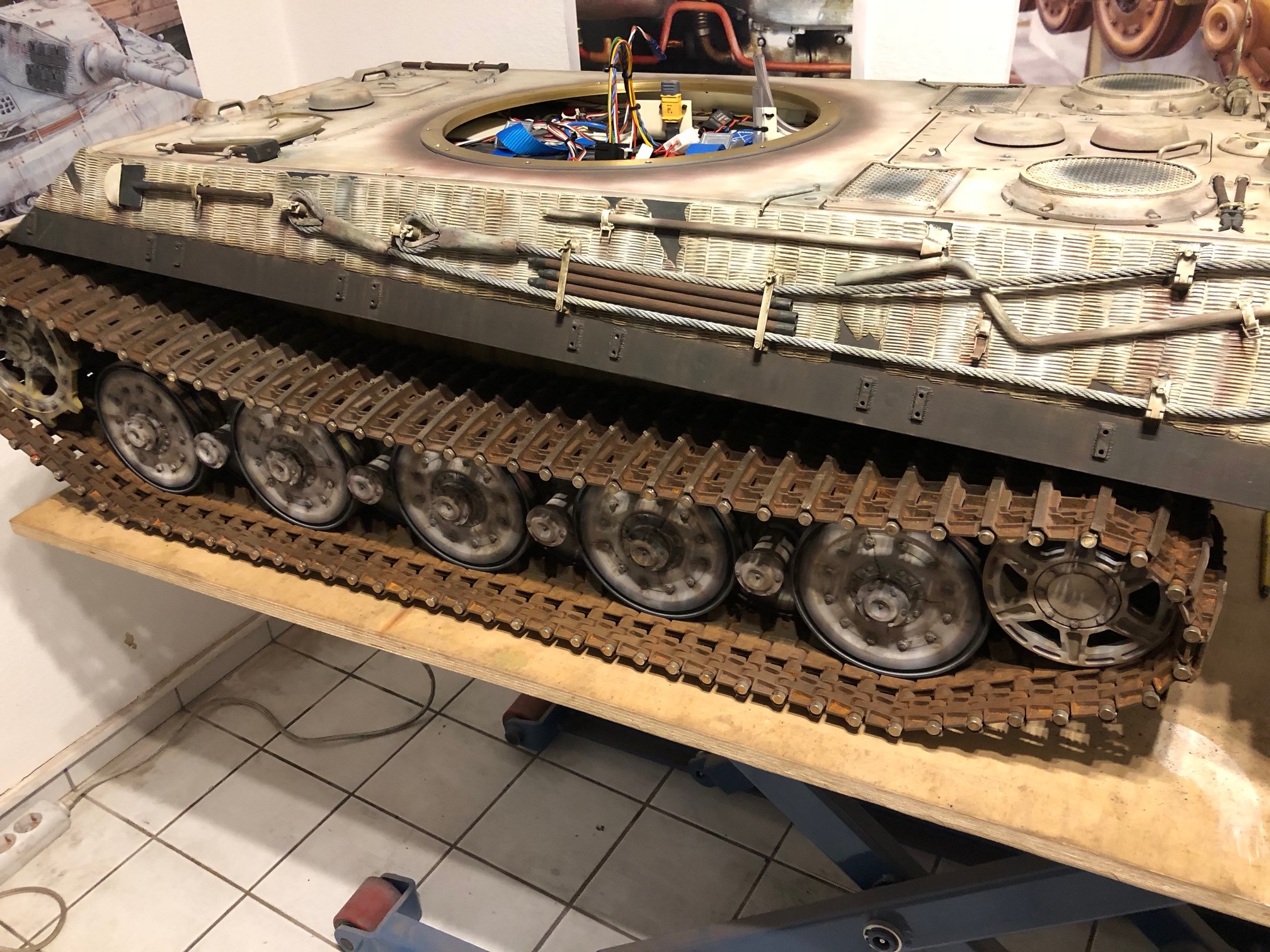

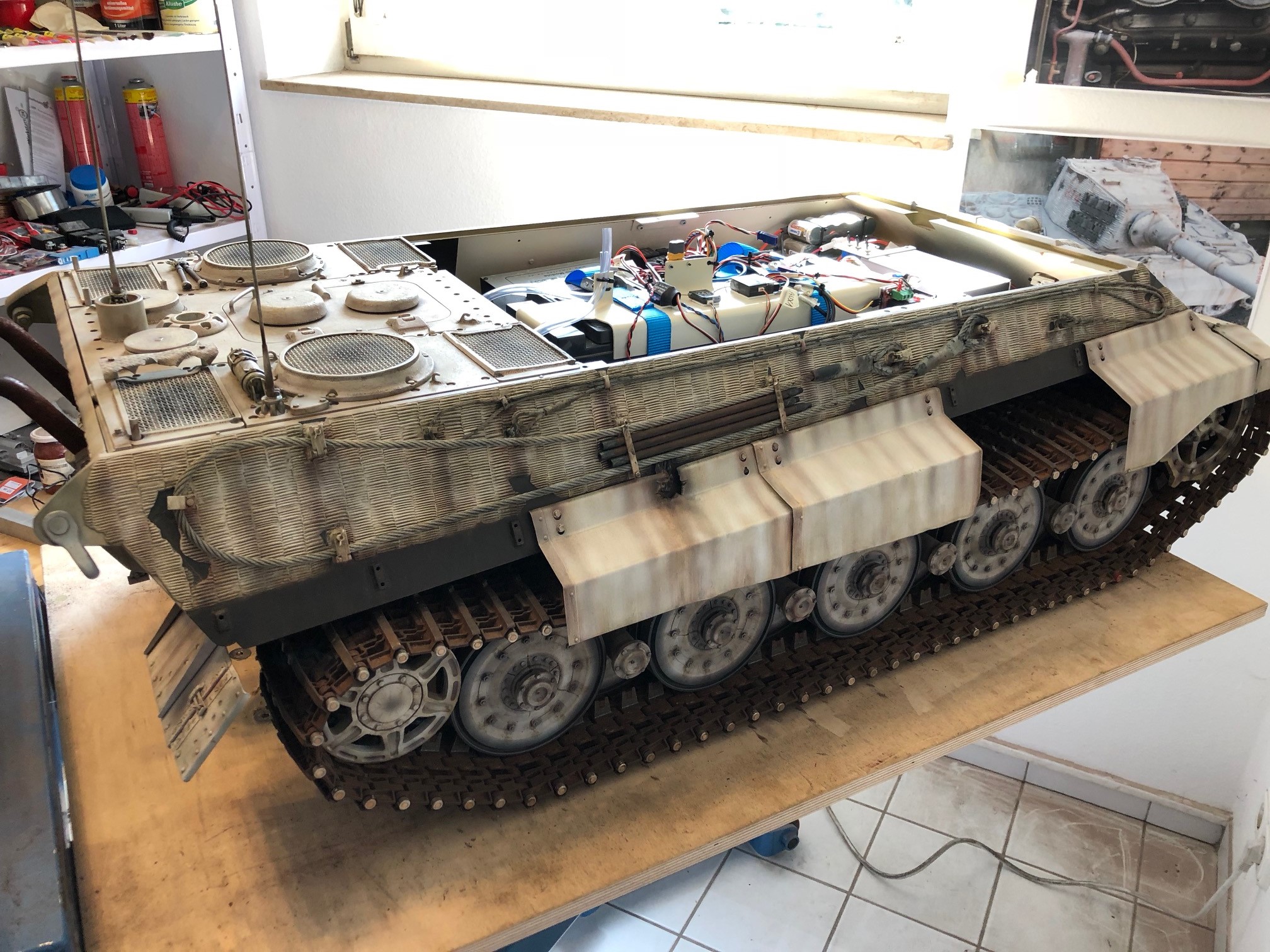

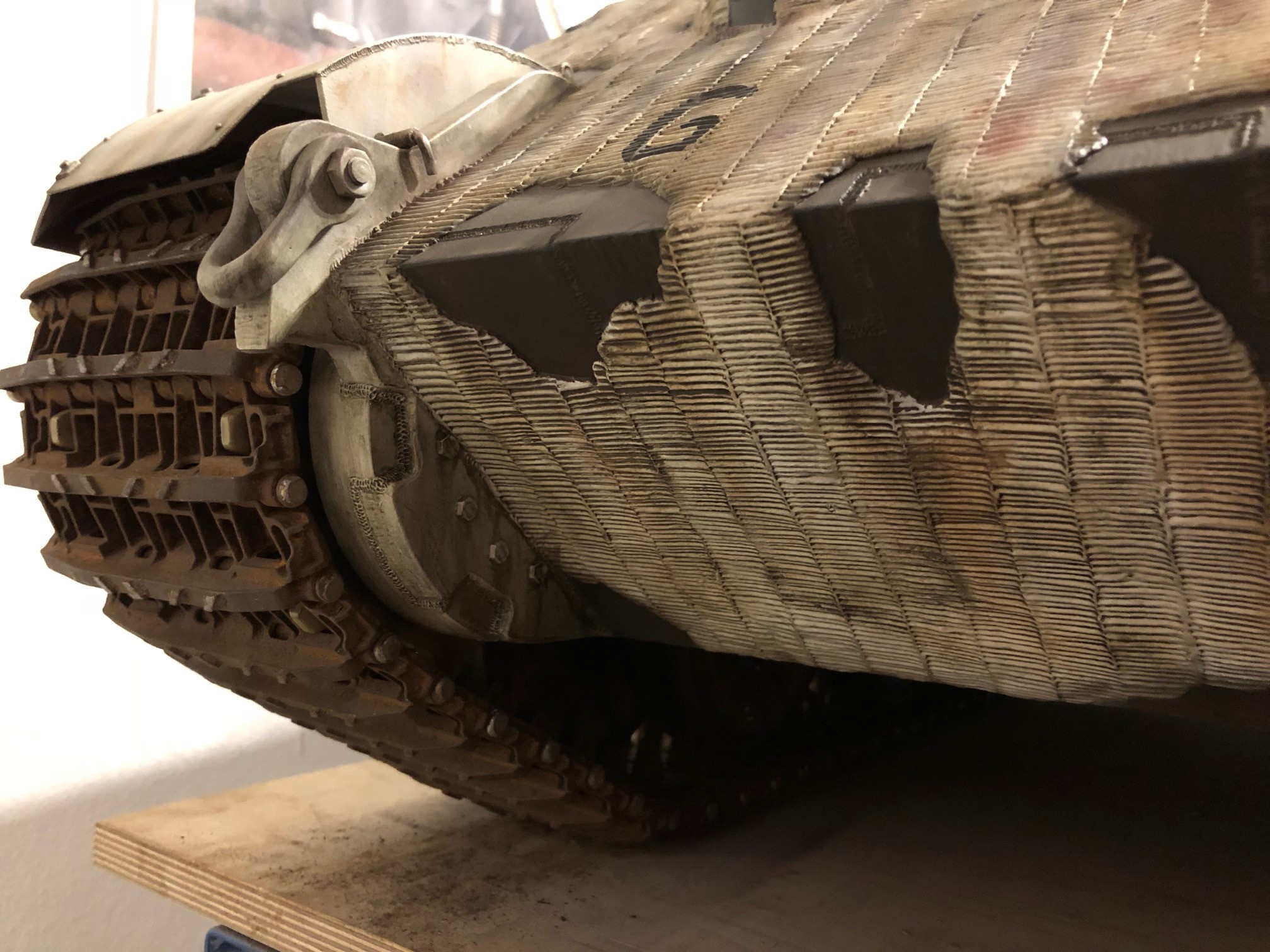

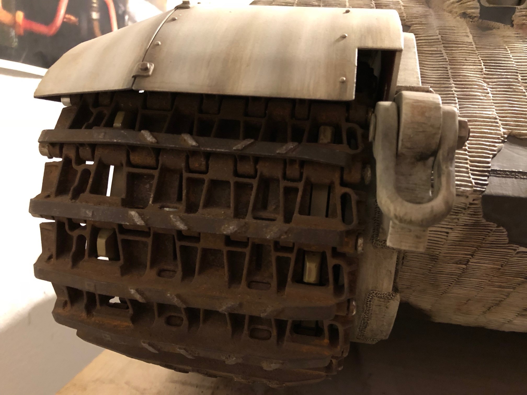

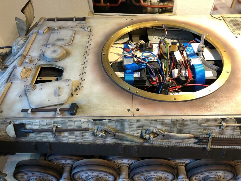

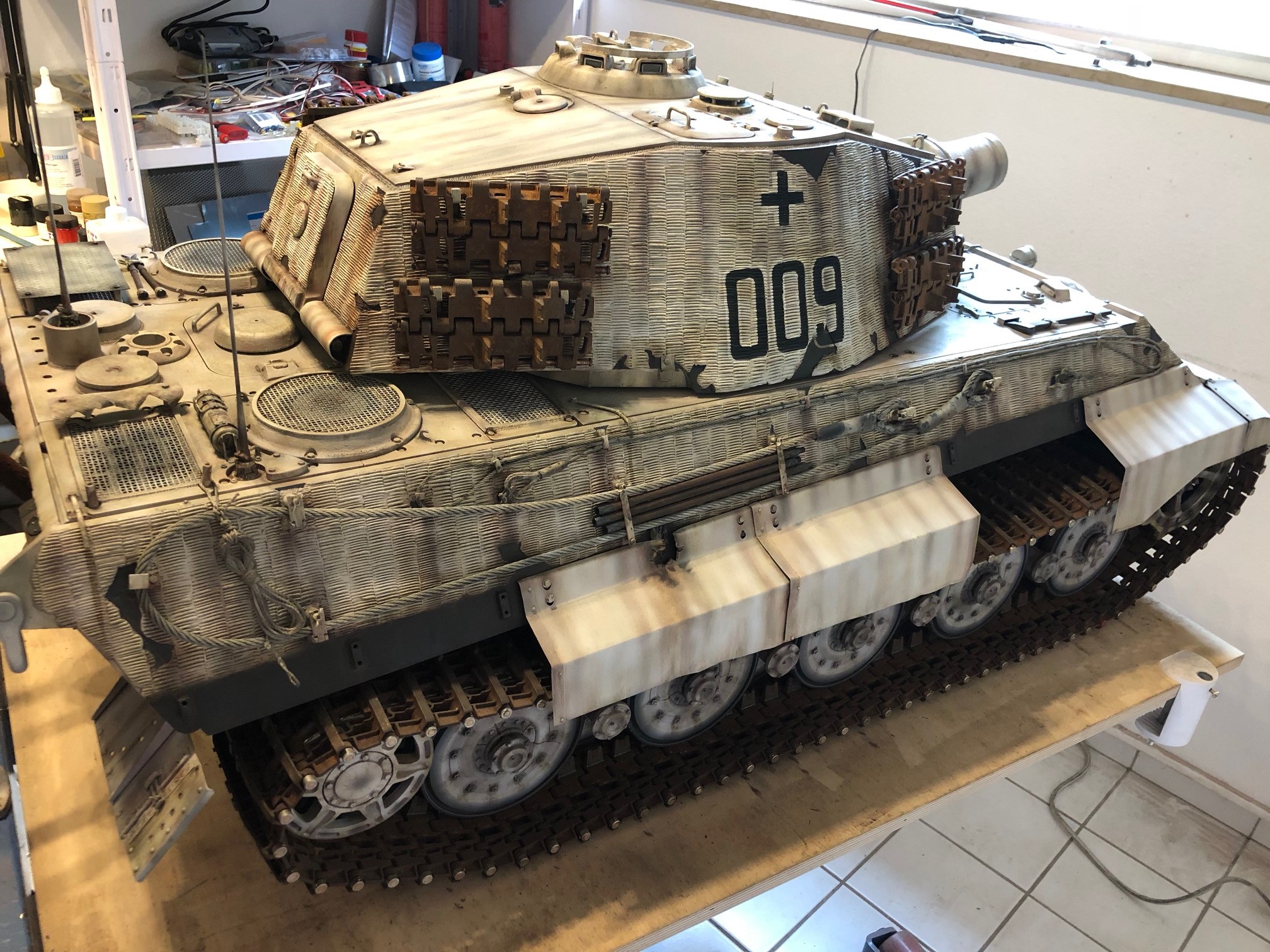

After some electric fights with the new radio and the receiver i was finished with all components in the hull.

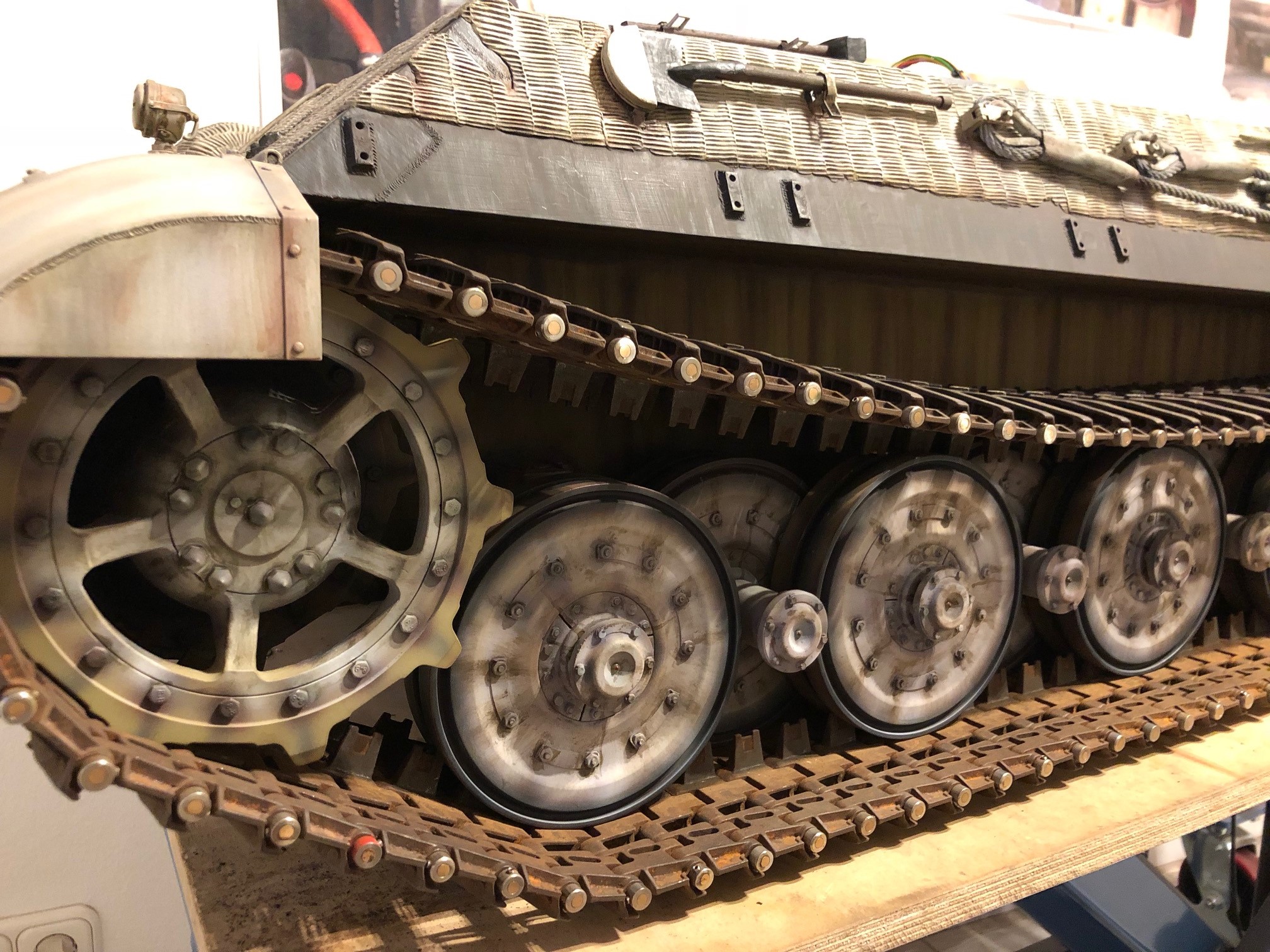

So i can mount the track to the king tiger the first time after 2 years of building. The tracks are steel and the rust is naturaly done with di water.
At the moment the swing arms are a little high, but that will change if the turret is on the hull and the first kilometer is gone.

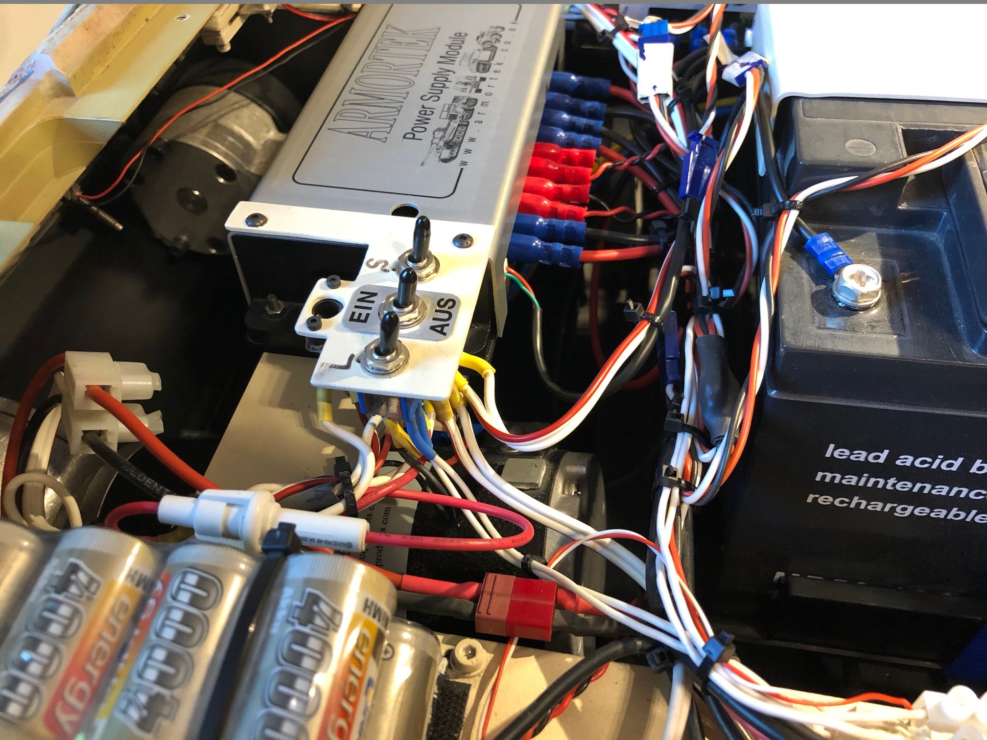

Hi Martin,
marvellous finishing, nice innerworks! But why you didn't use LiFes for such a magnificent specimen? Less weight and floor space requirement, more power and endurance!

Hi Gerhard,
hi Fabian,
thank you for the nice words.
Gerhard: the lead batteries are in - at the moment i bought the king tiger - so i didn't change it!
But first with the tracks on, a tank looks like a tank
hi Fabian,
Regards Martin

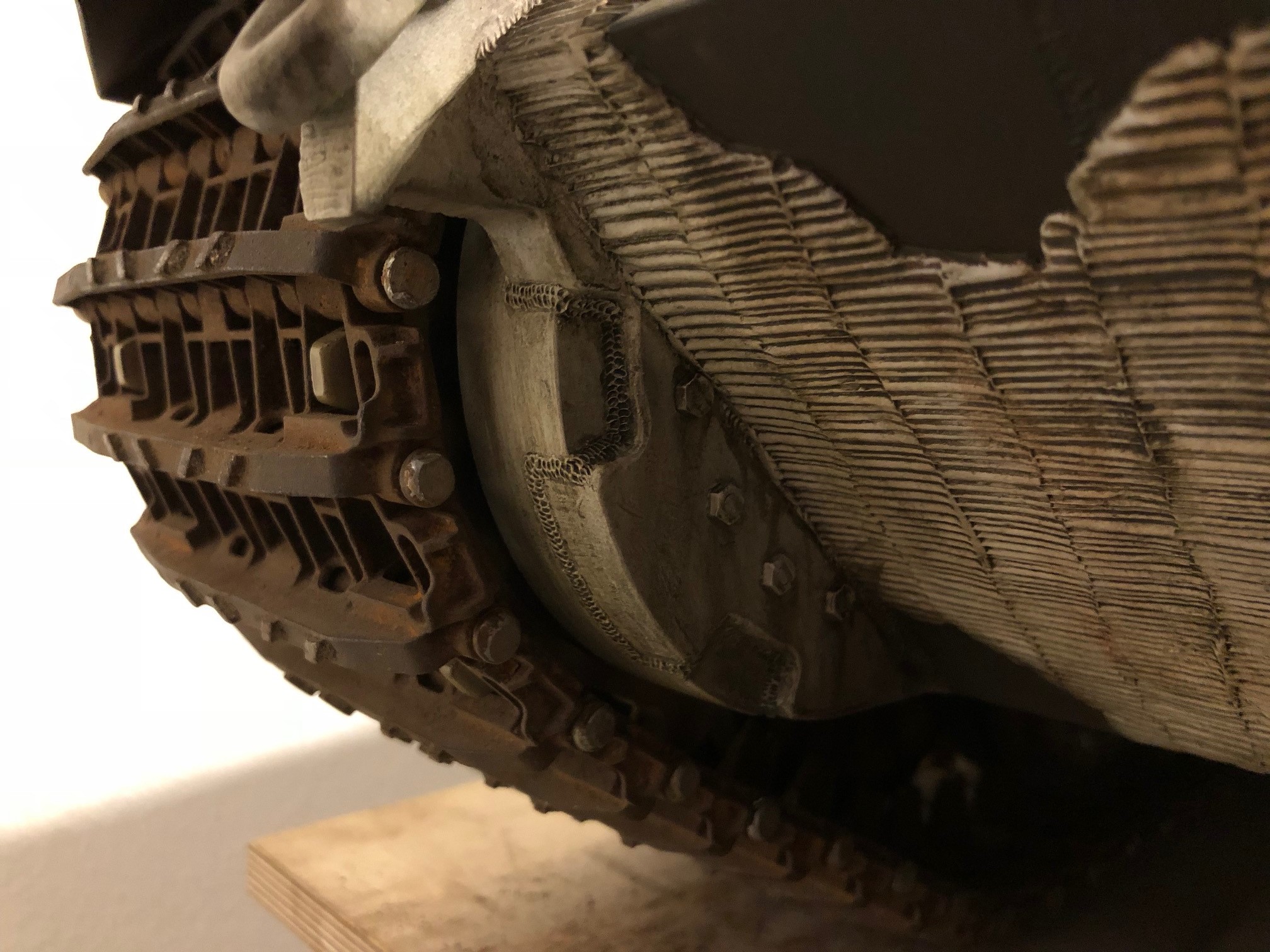

Hi Martin,
It looks good to combine the later type track with the 9-tooth sprocket wheel. Well done!

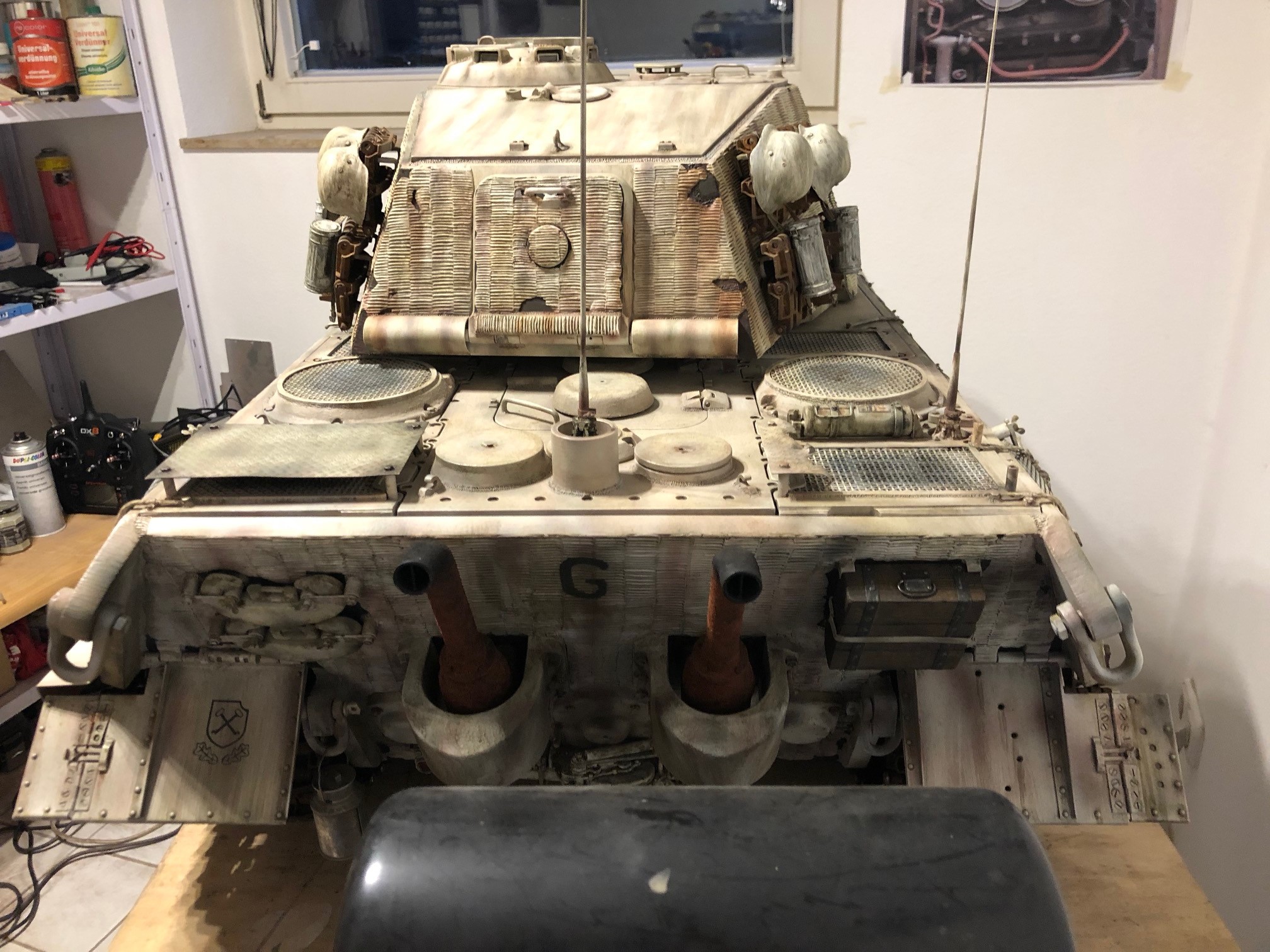

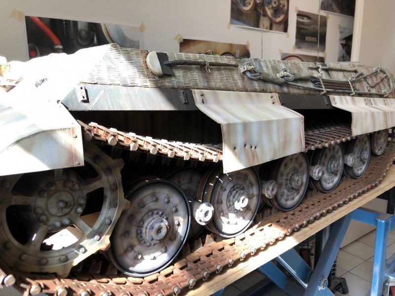

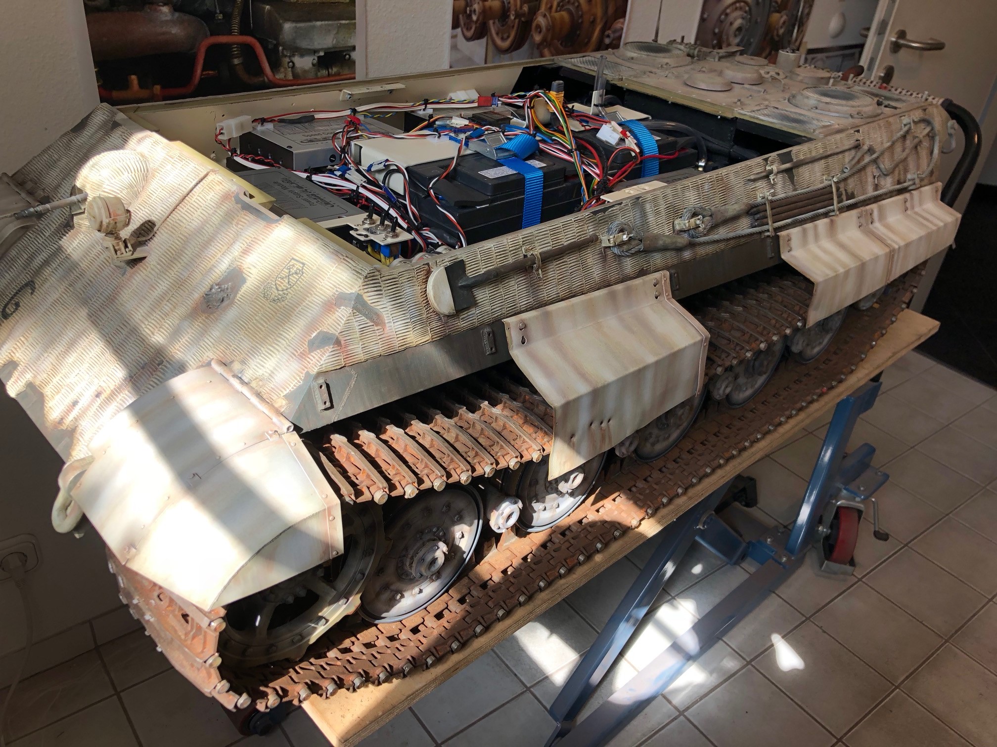

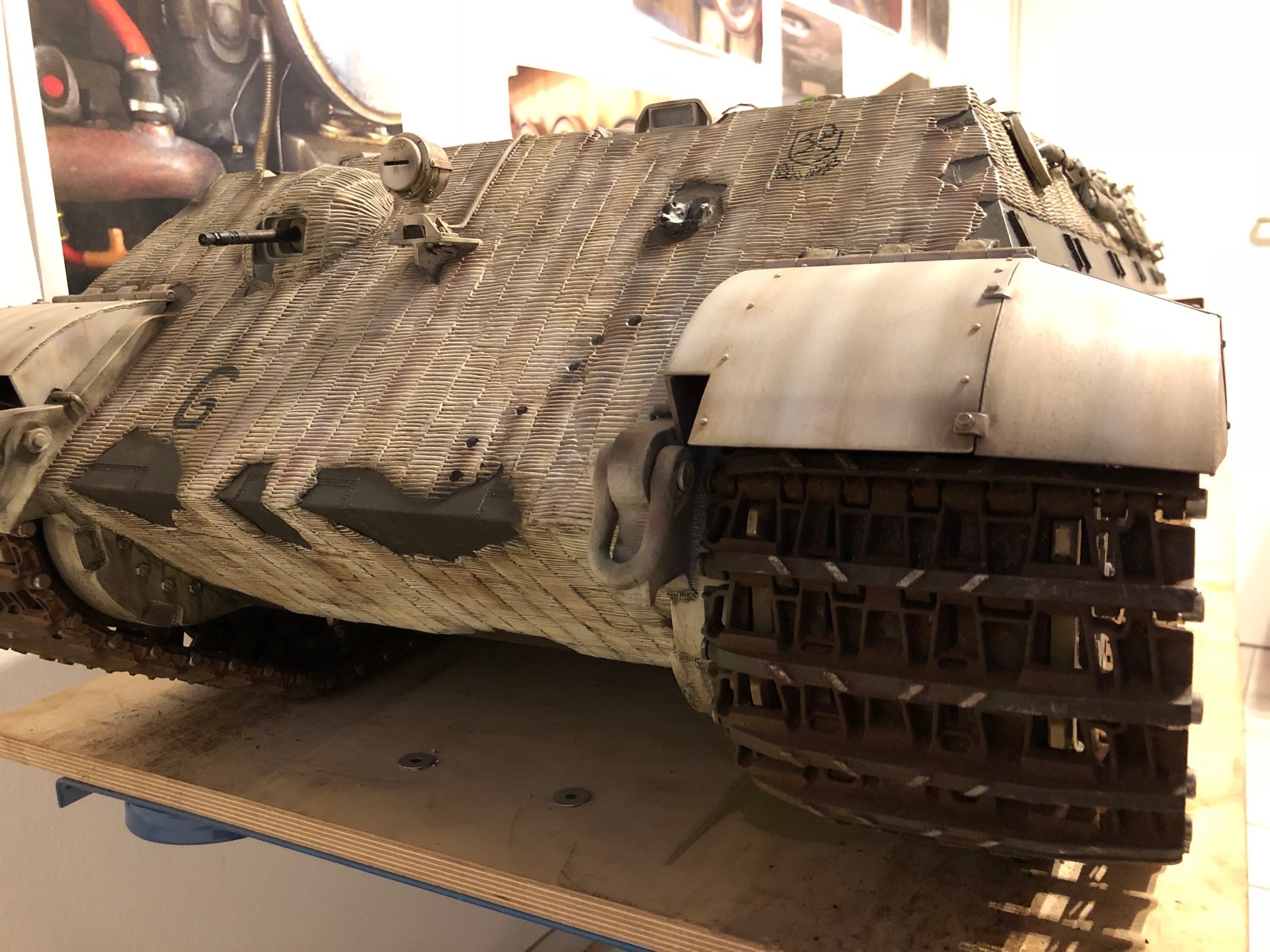

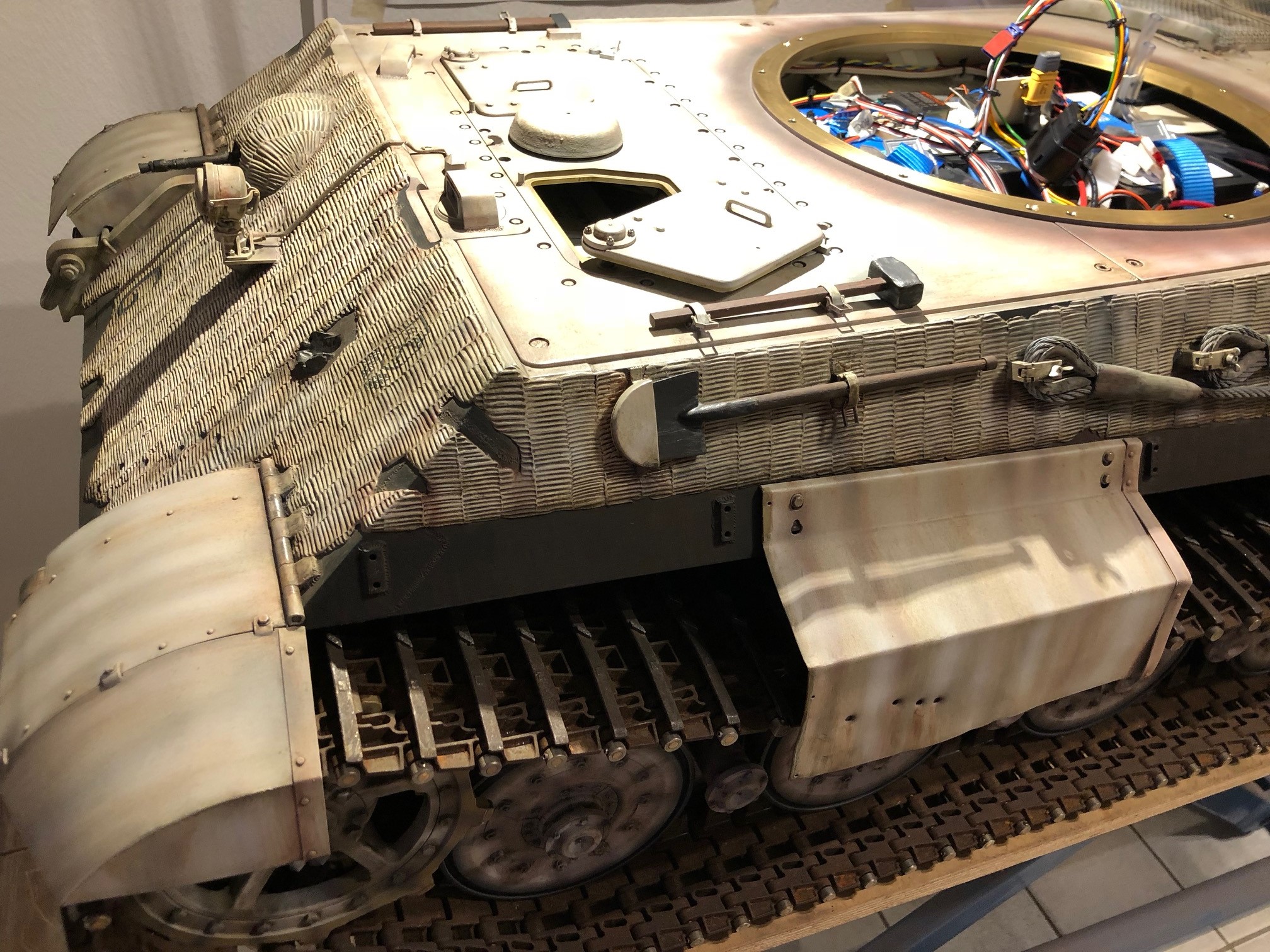

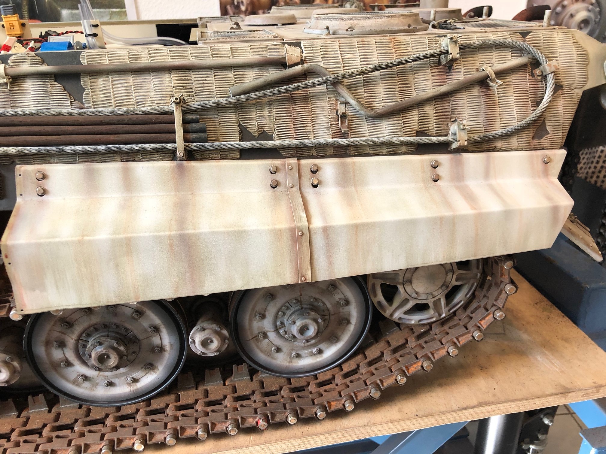

Here are the next photos of the hull with side skirts and the barrel mechanism.
It's time to get ready for Hausen am Bach
thank you for the comment. Yes i like it too.

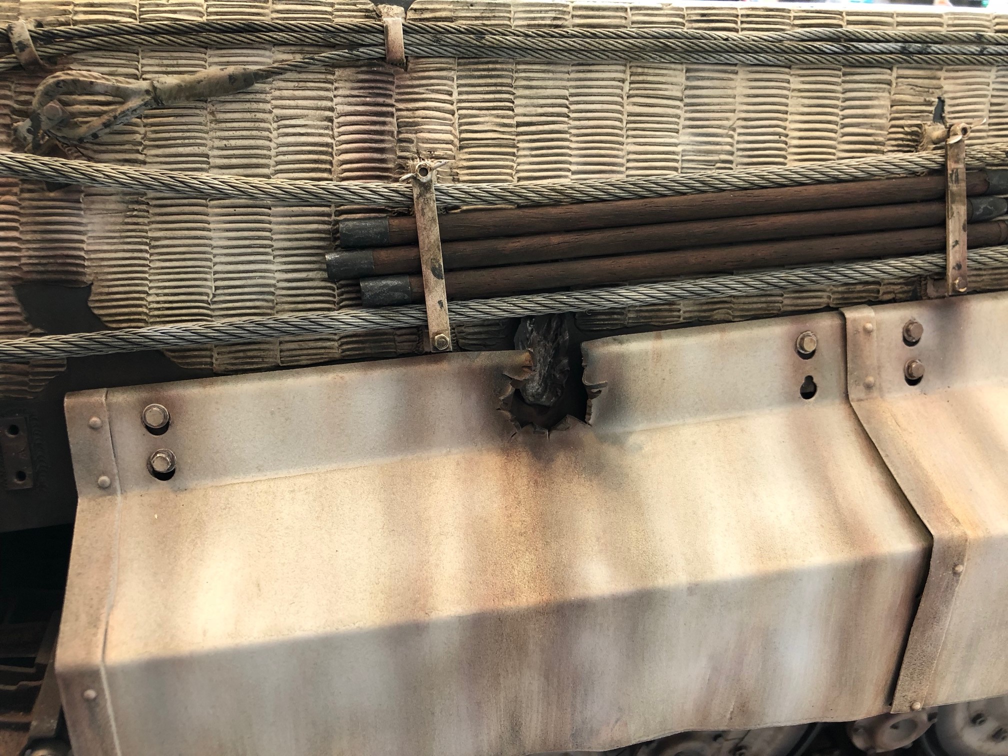

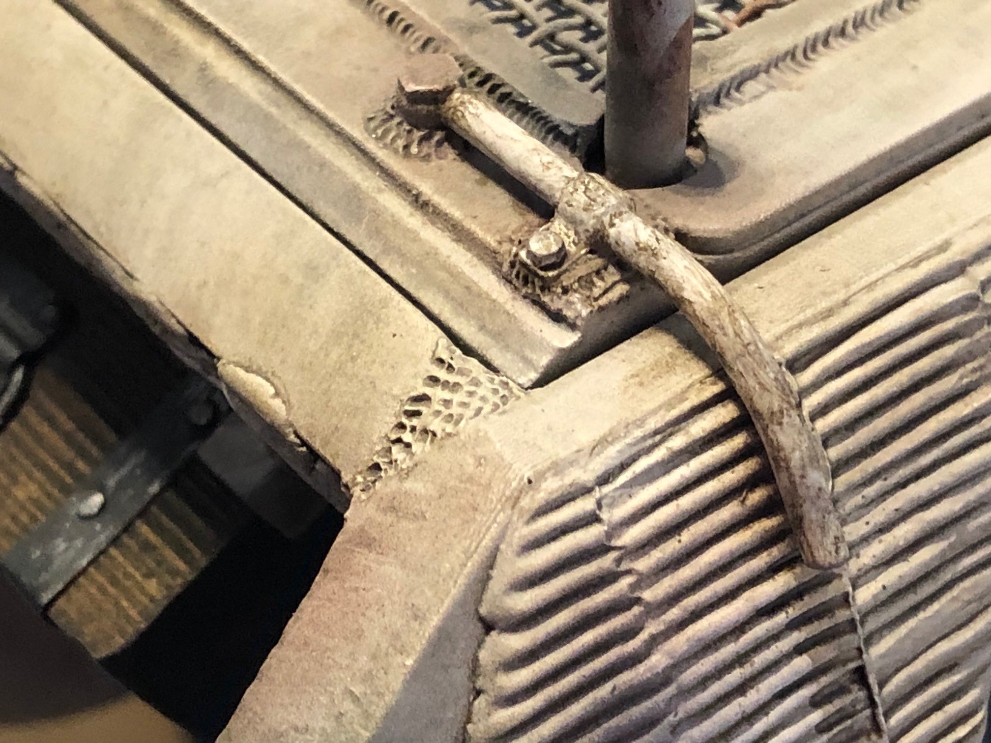

Here are the next photos of the progress which is coming near to the end........

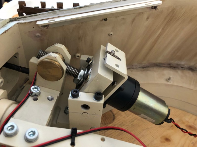

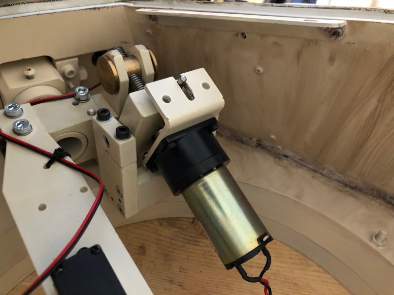

I am interested in your upgrade gun elevation mechanism. Is it the customed made or new Armortek's upgrade parts? Looks so good. Any motion film can be shared?
Lerh Chang
Thumb-up to your KT! It is really the first class model.
Lerh Chang
- Martin Hofmann
- Posts: 486
- Joined: Tue Jan 06, 2015 4:20 pm
- Location: Hamburg, Germany
- Has liked: 151 times
- Been liked: 2010 times
Re: Martin's King Tiger

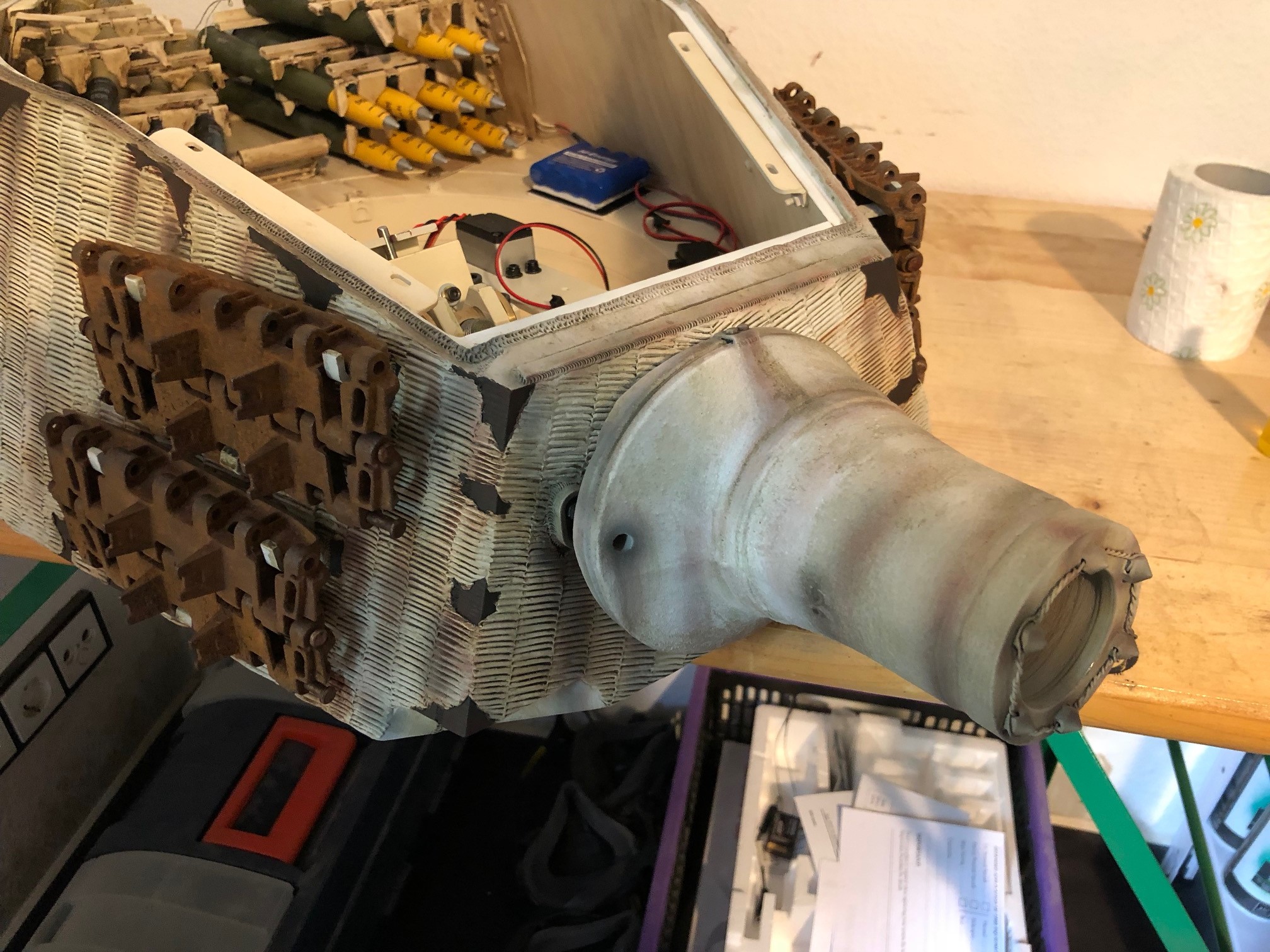

Hi Lerh,
thank you for the nice words, and sorry for not answering so long time, but i was in Hausen and after very busy.
The one and only origin part was made by Armortek is the round and the cover of brass in the left side of the photo.
The angle at the right side and the spindle are modified by me and all other parts are sratched built by me.
The trick is, that the motion of the gearmotor is connected with the spindle only and the angle is the torque support.
So you can't see any out-of-roundness during the rotational movement at the barrel. It is a very even movement.
I will try to make a video and take it to youtube.

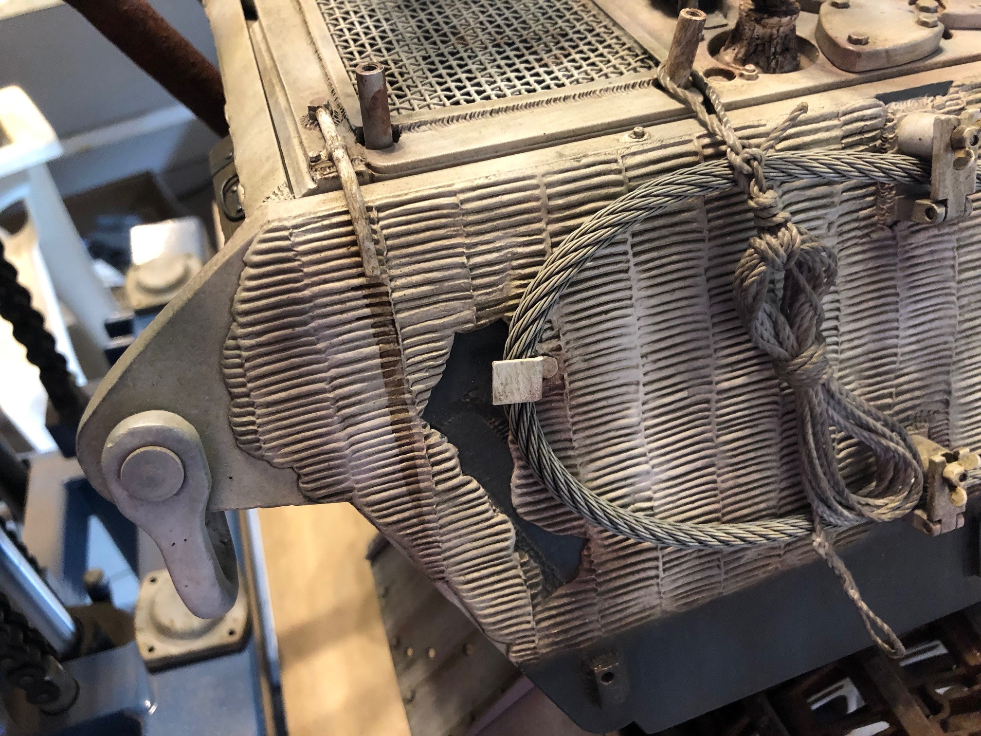

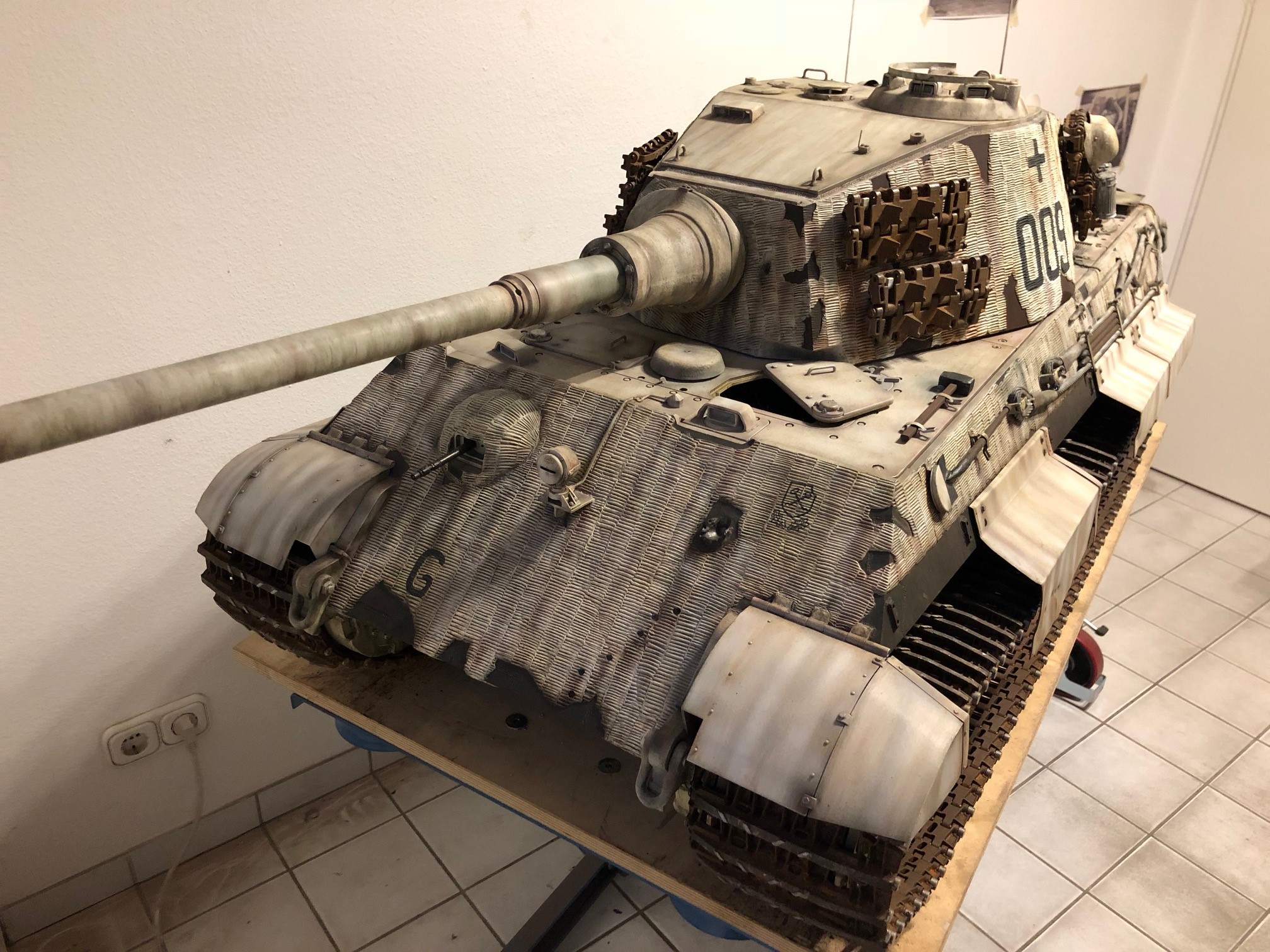

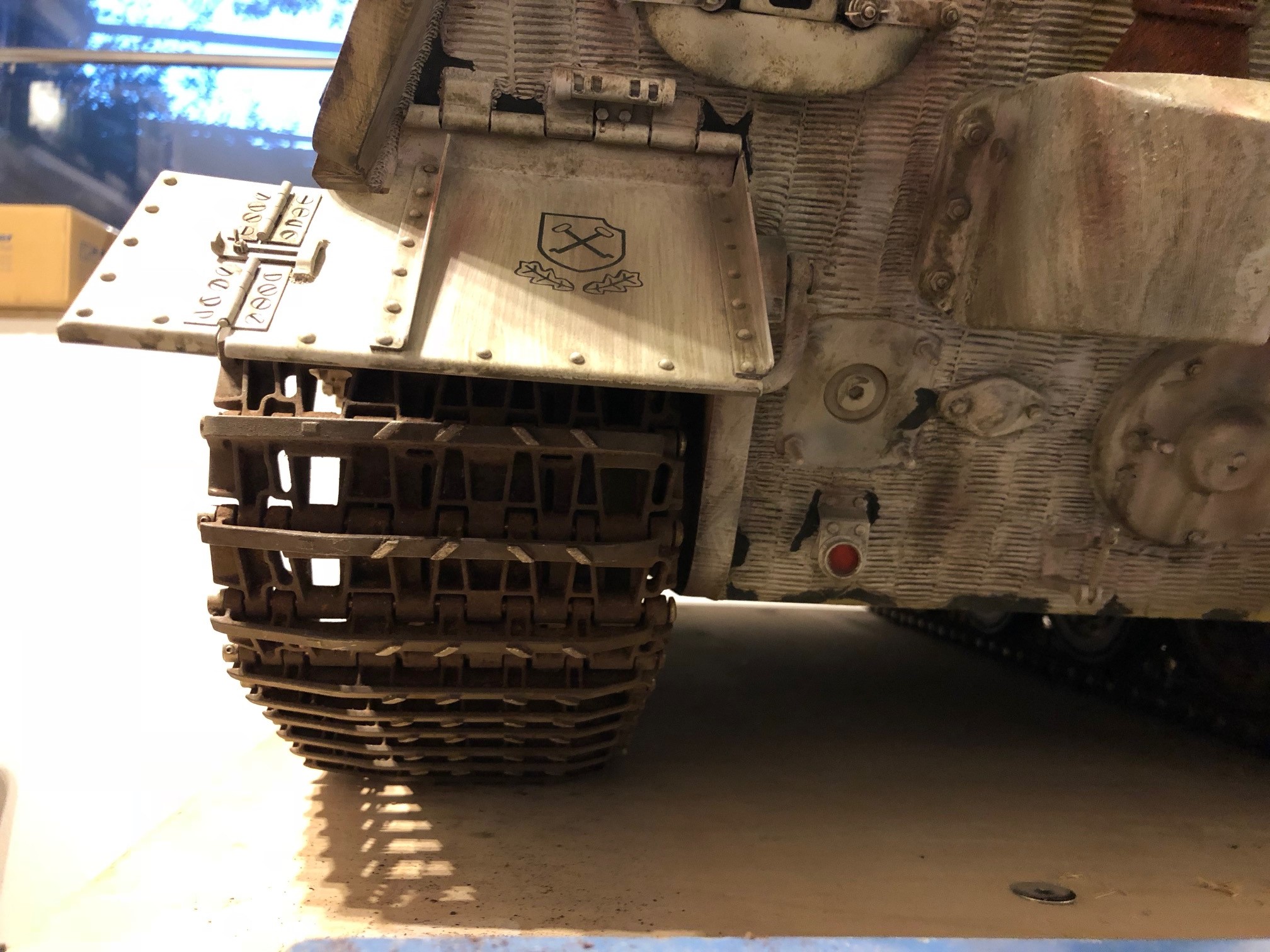

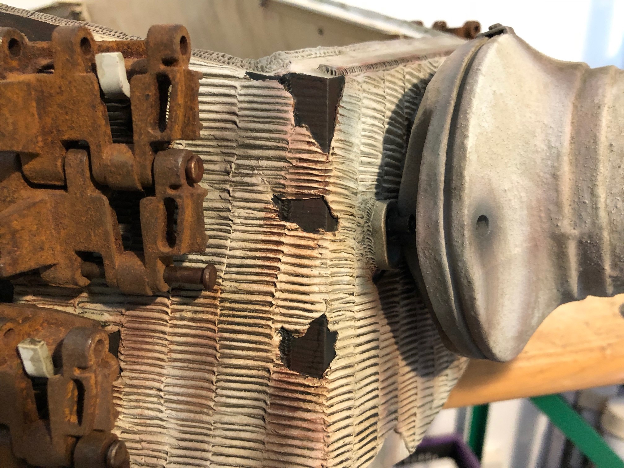

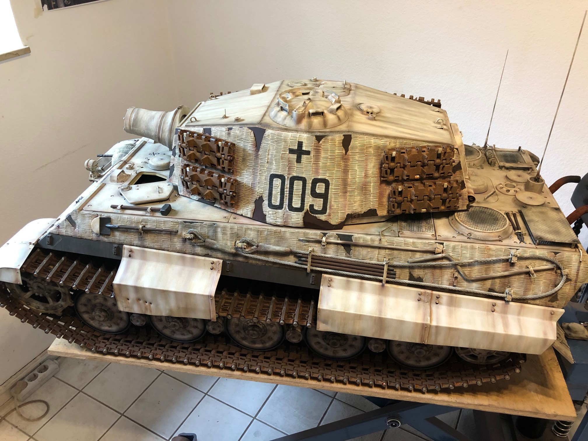

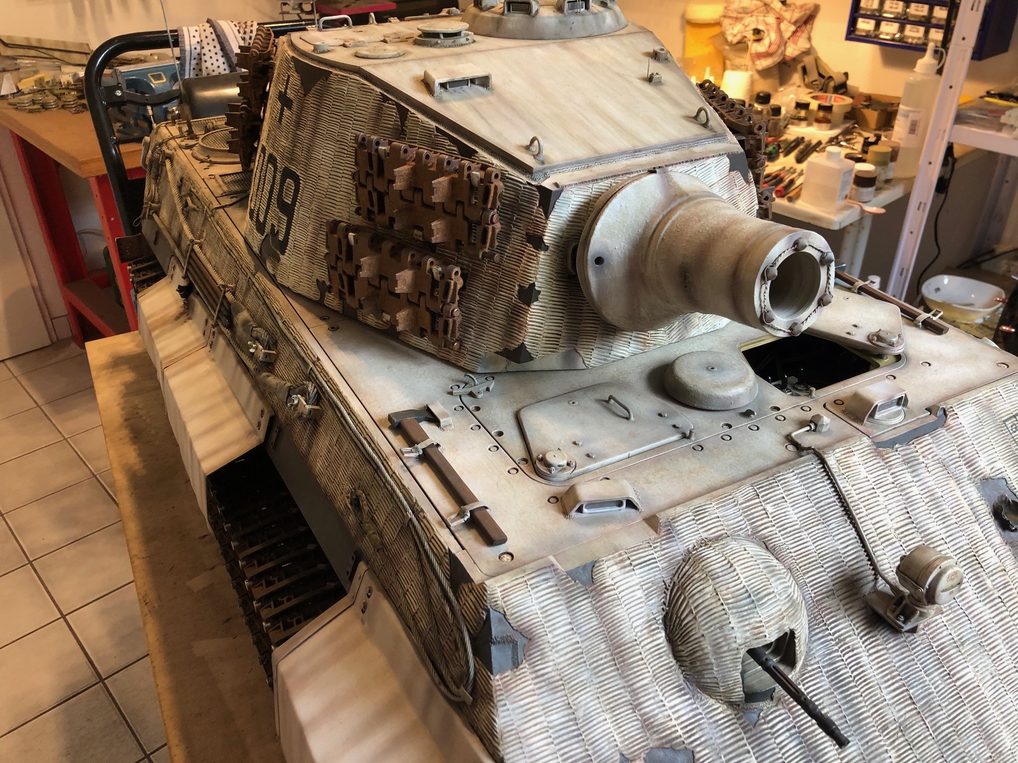

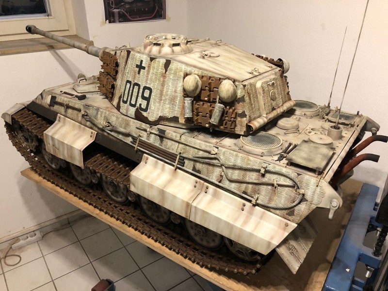

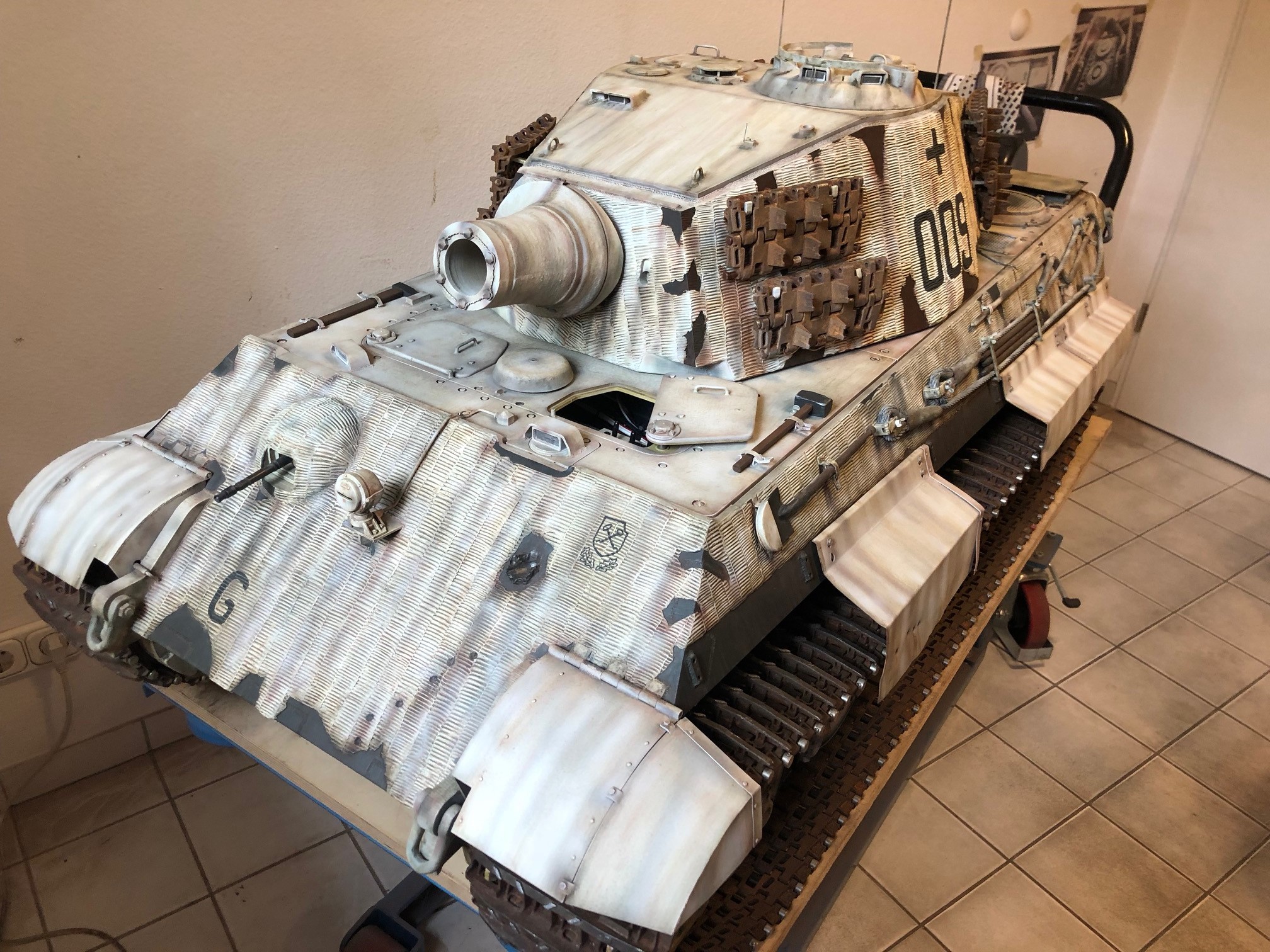

Here are some more photos of the finished Kingtiger.

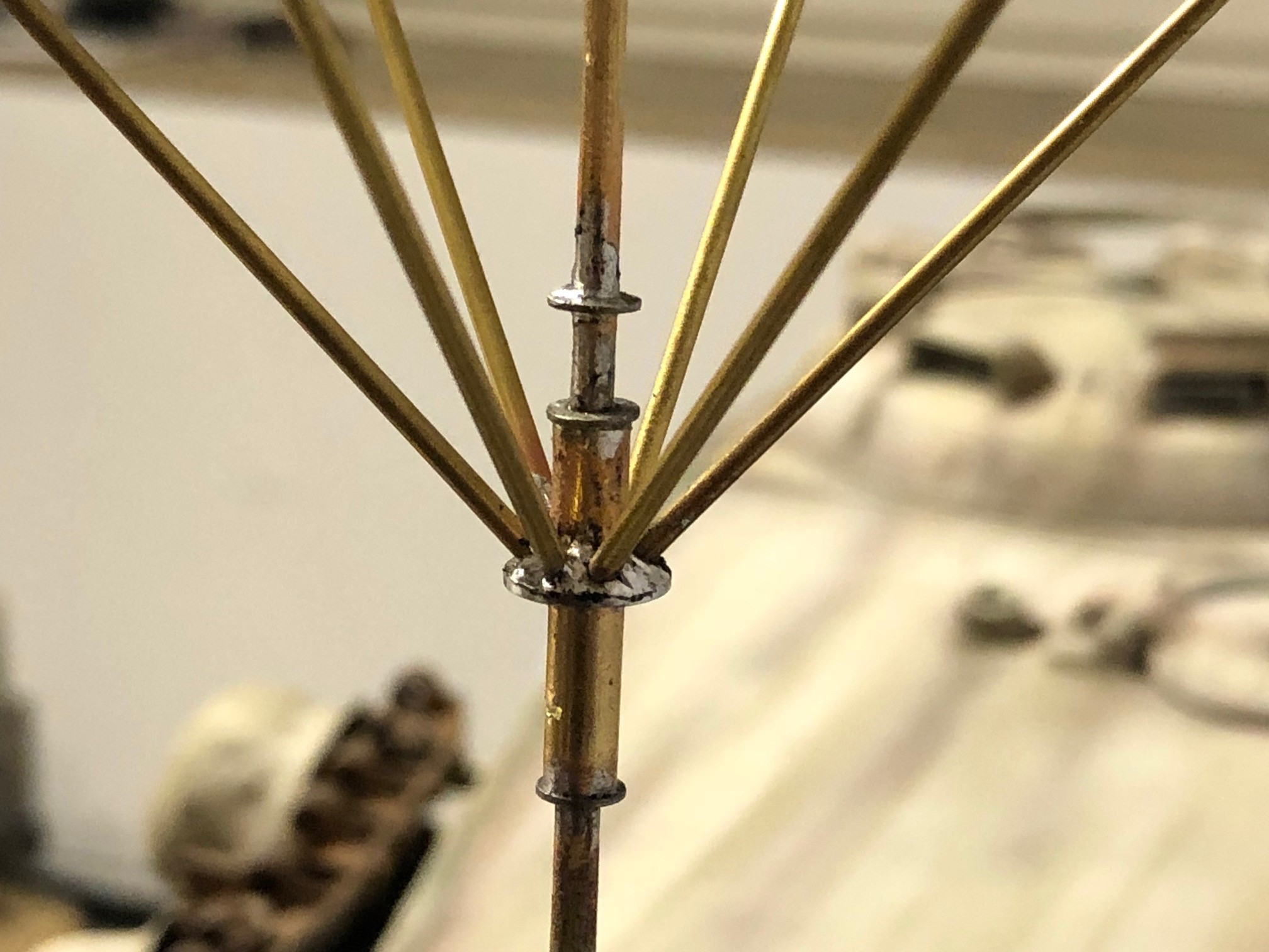

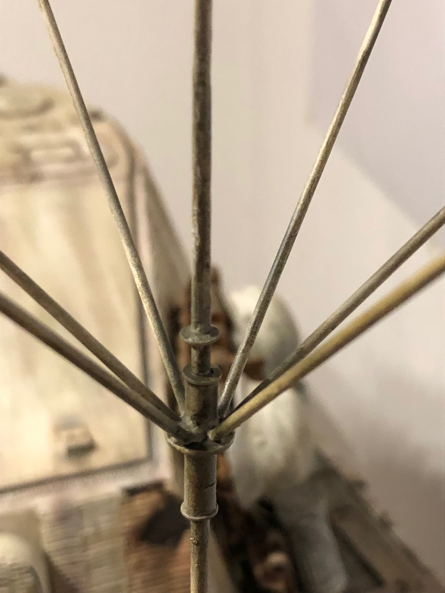

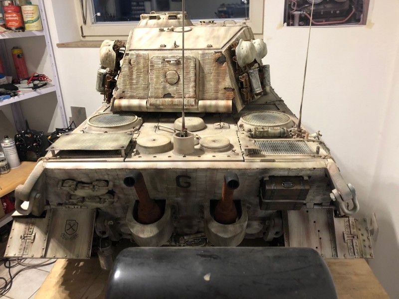

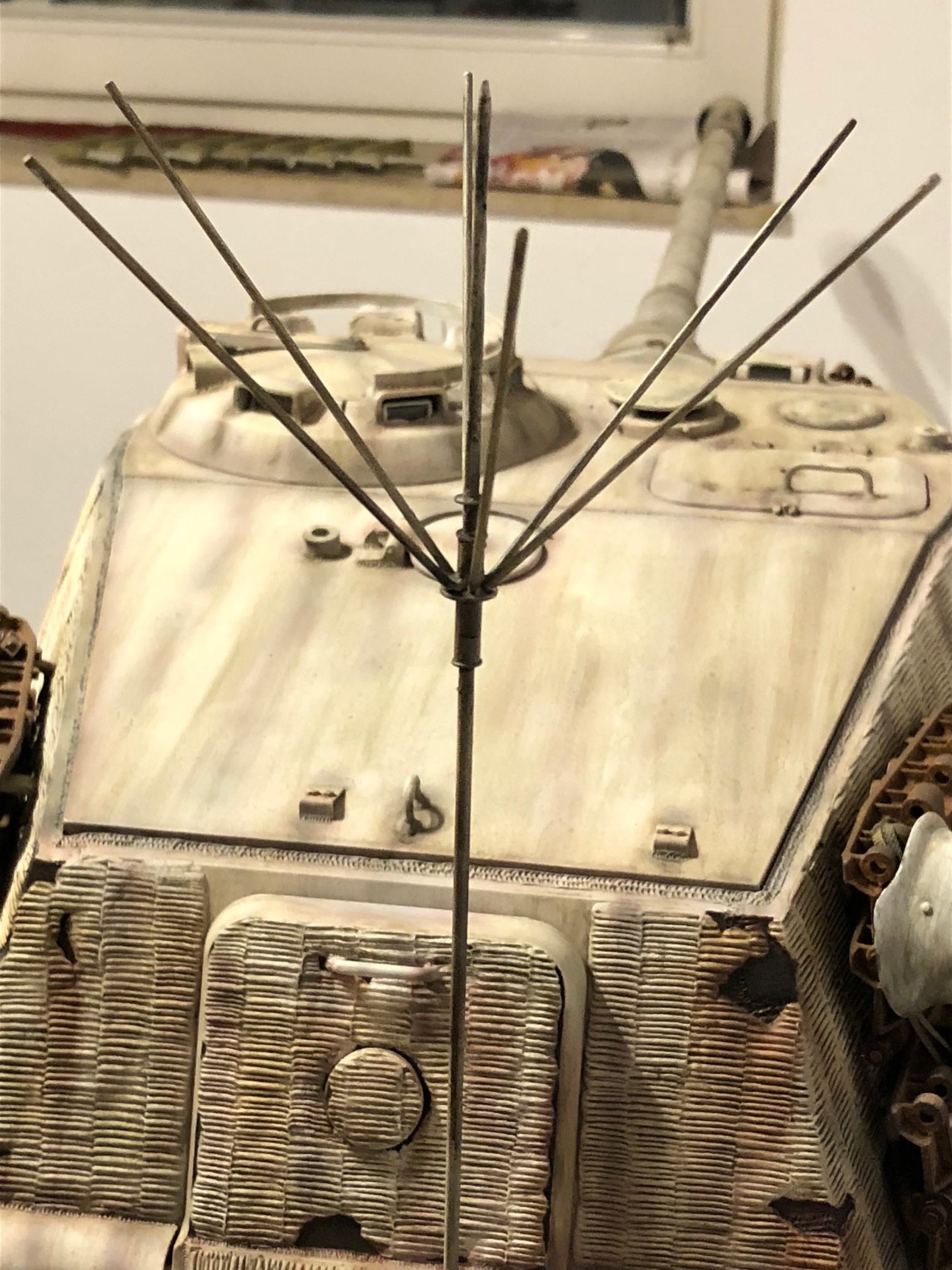

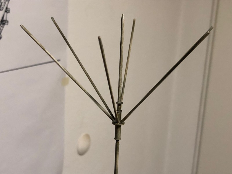

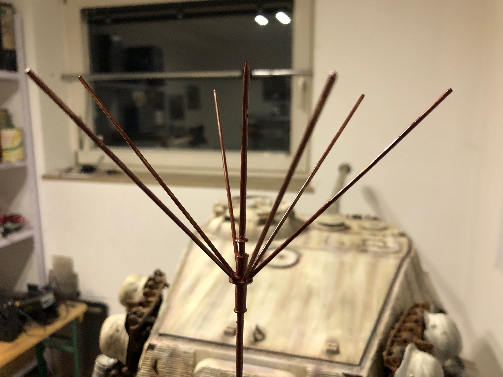

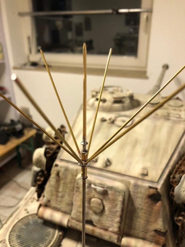

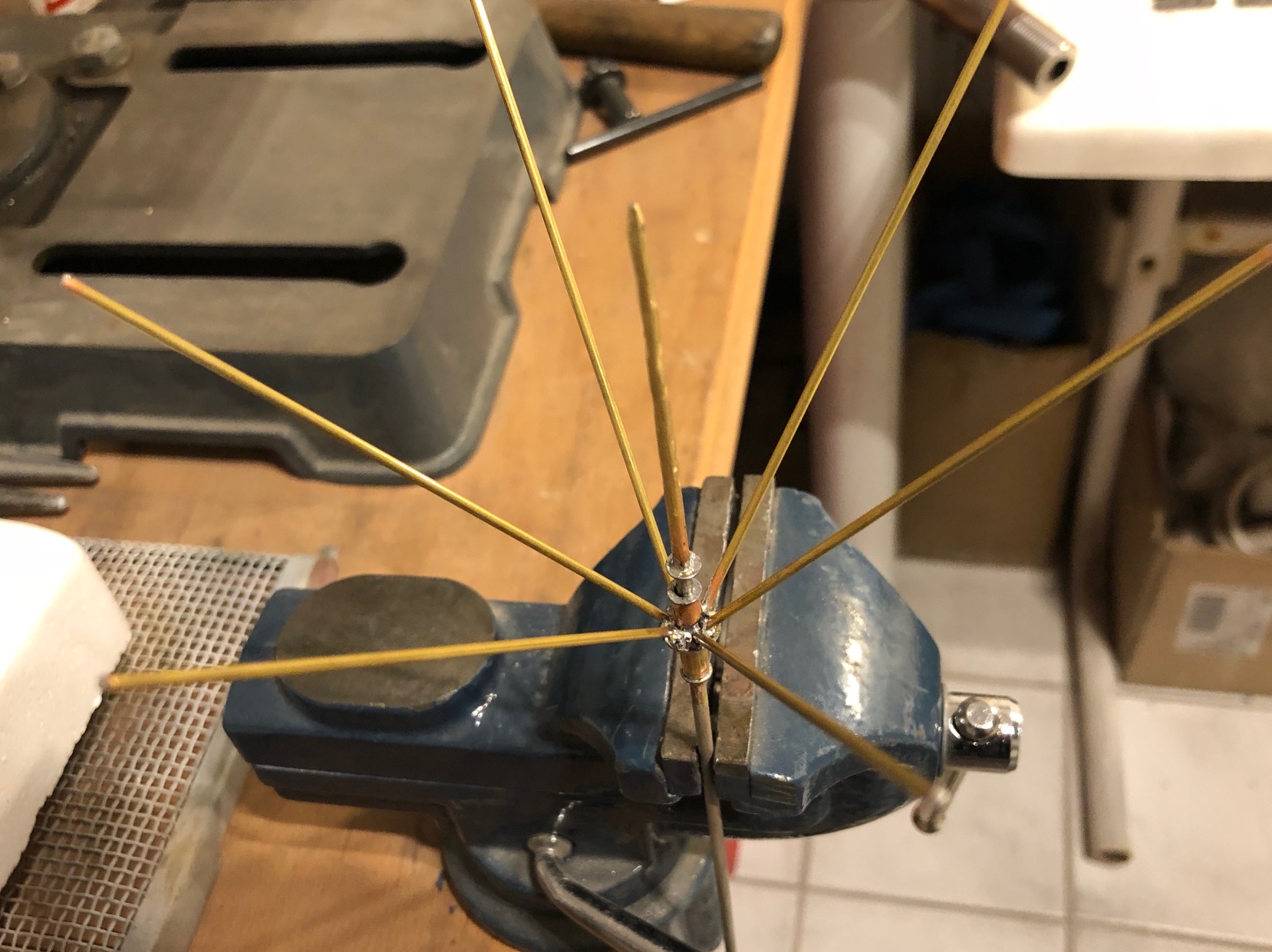

thanks for the compliments. One of the last things i have added was the "Sternantenne" because it is a Befehlspanzer.
hi Lerh,
