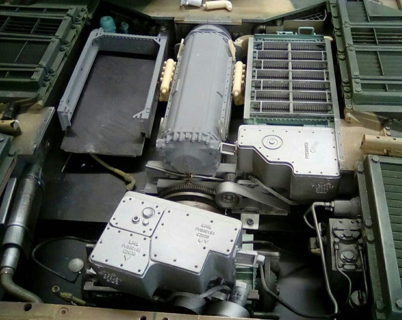

Boy it's warm in the workshop today, the engine is a tight fit but is starting to take shape. 8)
Extremely tight fit that radiator! I will soon be able to reposition that filler cap.
I have to build a slice of the air cleaner intake to fit in here.
The pulleys positions are a compromise but not that far out.
These have been a bit tricky.
Nice!y cast parts.
Nice!y cast parts.
The sun is so hot I can spray one side of a part and within seconds flip it over and spray the other side.

It makes your back hurt bent over the engine bay all day but it's coming on. 8)
As I said it is tight but it will fit with some fetling.
It's like a bomb has gone off in there.
Lots of parts t prep.
I'm using square stock for the exhaust pipe headers.
I tend to make lots of these sub units as it all needs to come apart or you would never be able to remove the false floor.

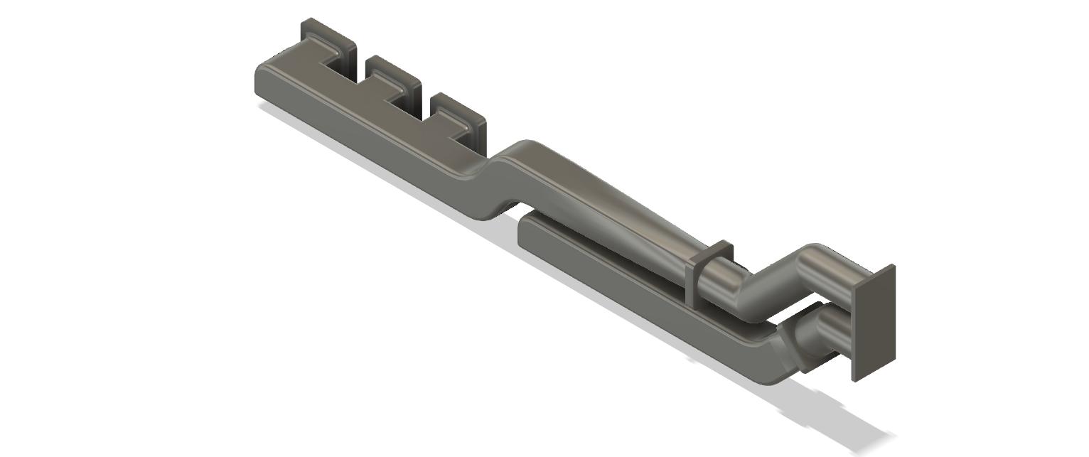

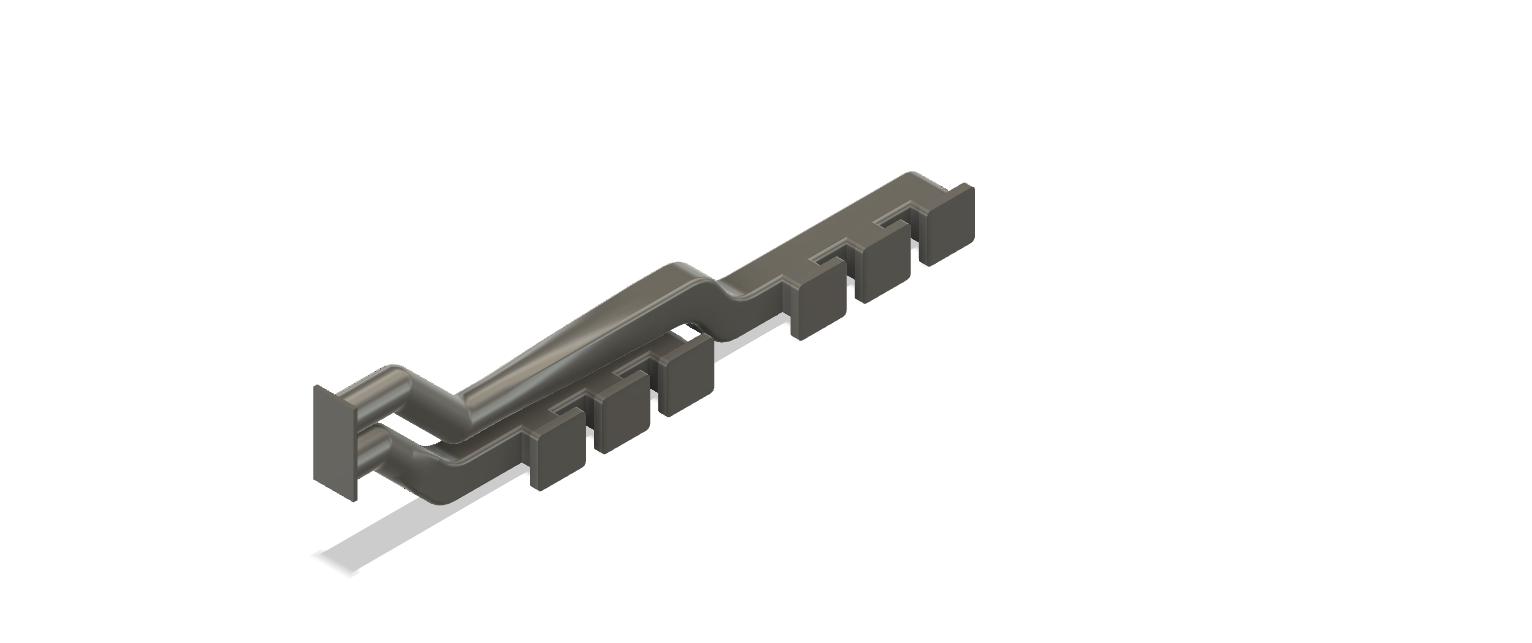

Phil
Is this OK for the exhaust manifold before I make a mirror copy for the other side?

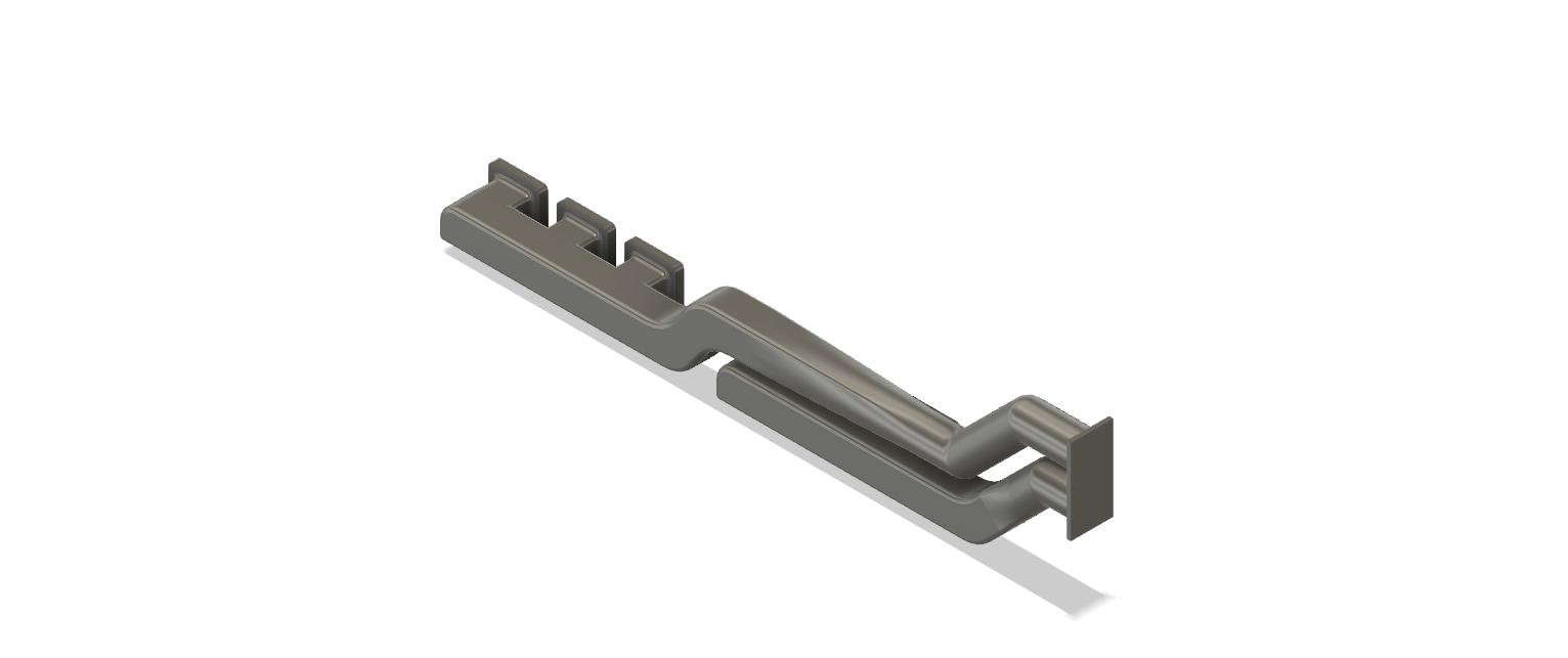

I made them with a smooth transition from square section to circular section. I sent you an image with the transition having a flange but it seemed to rough on the eye. If you really want it with the flange hopefully I can go back and add it.
I made the drawing as close as possible to your sketch but I have a gut feeling that there is something wrong.
Posts: 4281
Has liked: 2282 times
Been liked: 7196 times
Re: Chieftain build by Phil Woollard.
That looks very nice indeed, I did like the top flange as you can see it when you lift the radiator, and it breaks up the long run.
Let's give it a go! 8) I have another two hours on the blast deflection plate then that's all four quarters done, then I will print them out.
The only thing that might not be the same as the 1/1 is the outlet distances of each port, they look more equally spaced on this photo but that doesn't mean the headers followed the openings, they may have been angled?

How's this now?
Are you sure you have enough vertical space to fit it to Ivano's engine?
Posts: 4281
That look more interesting, I like it Yes plenty of room for that engine but there won't be a mm spare lol. 8)
