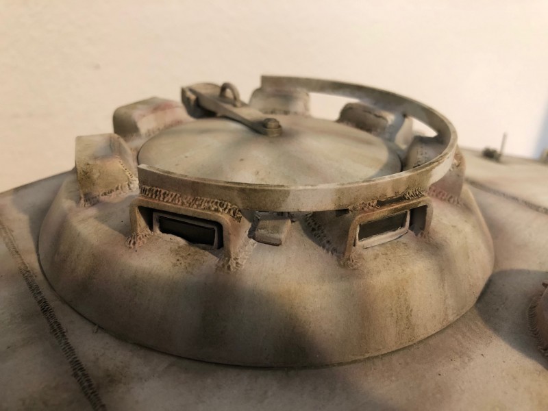

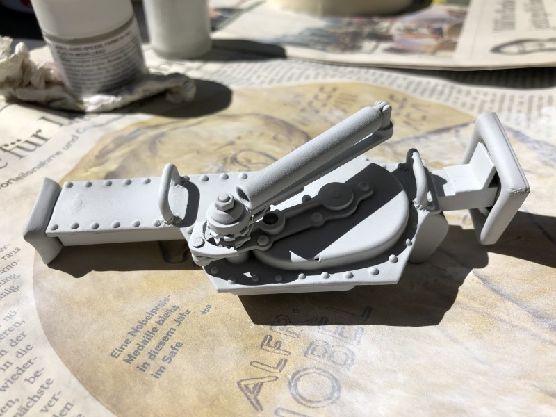

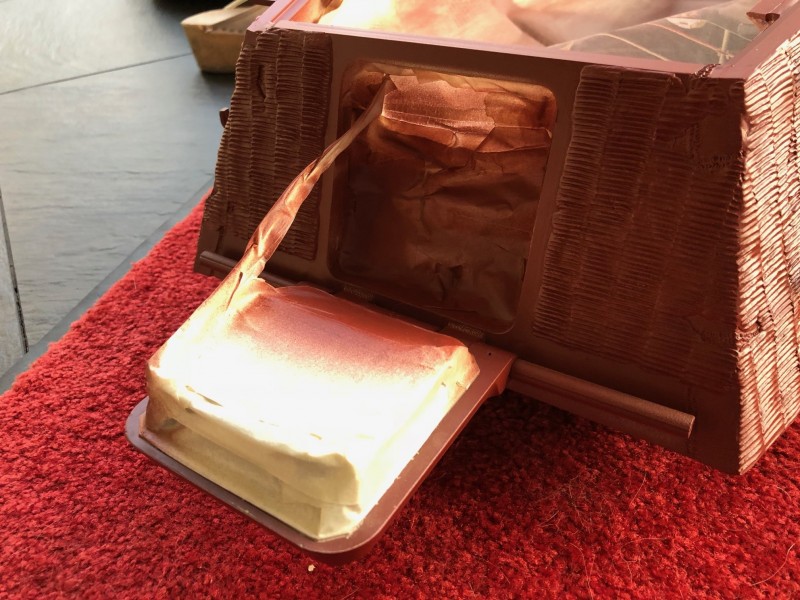

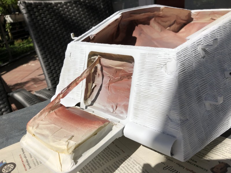

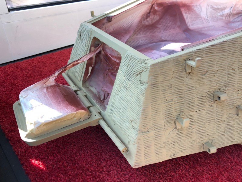

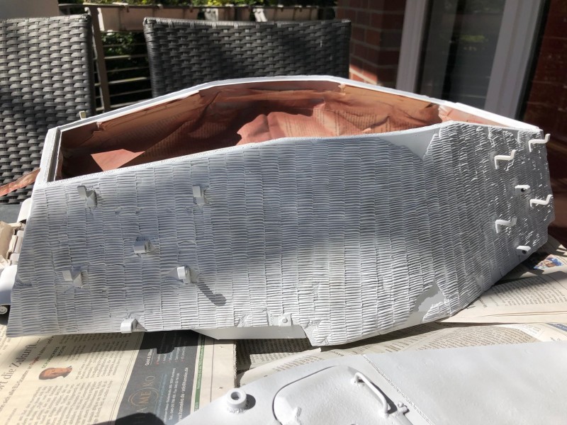

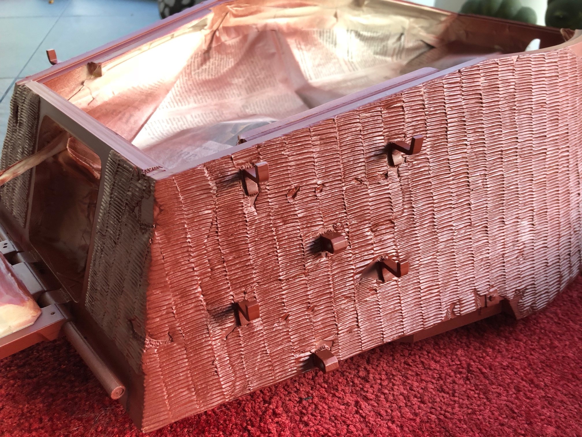

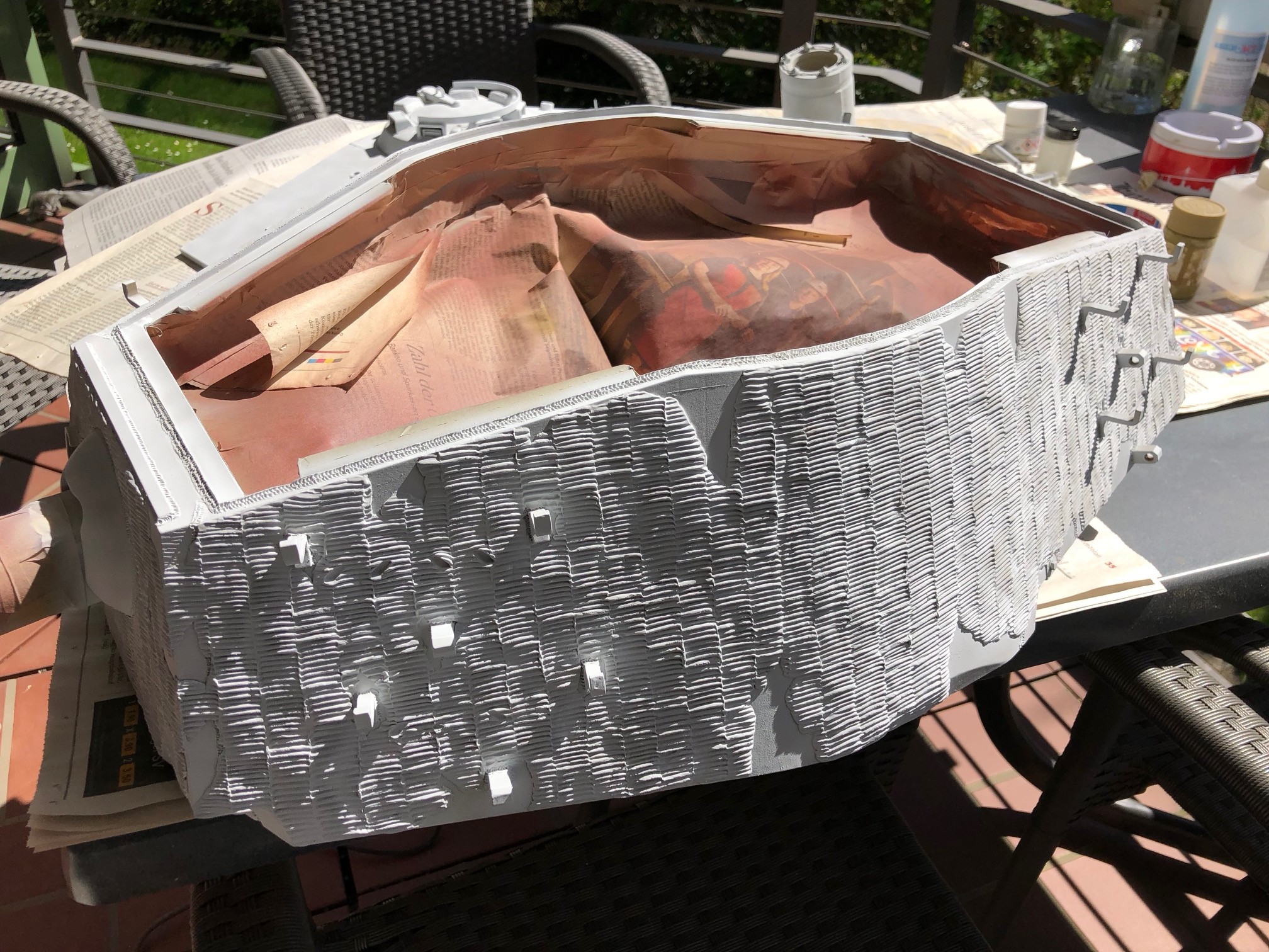

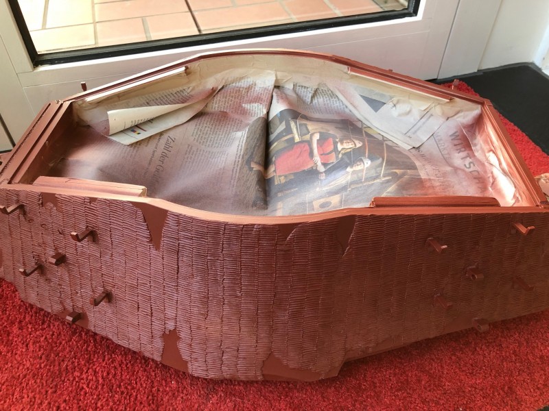

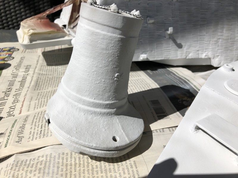

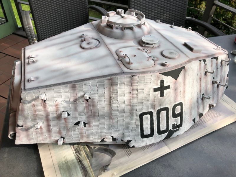

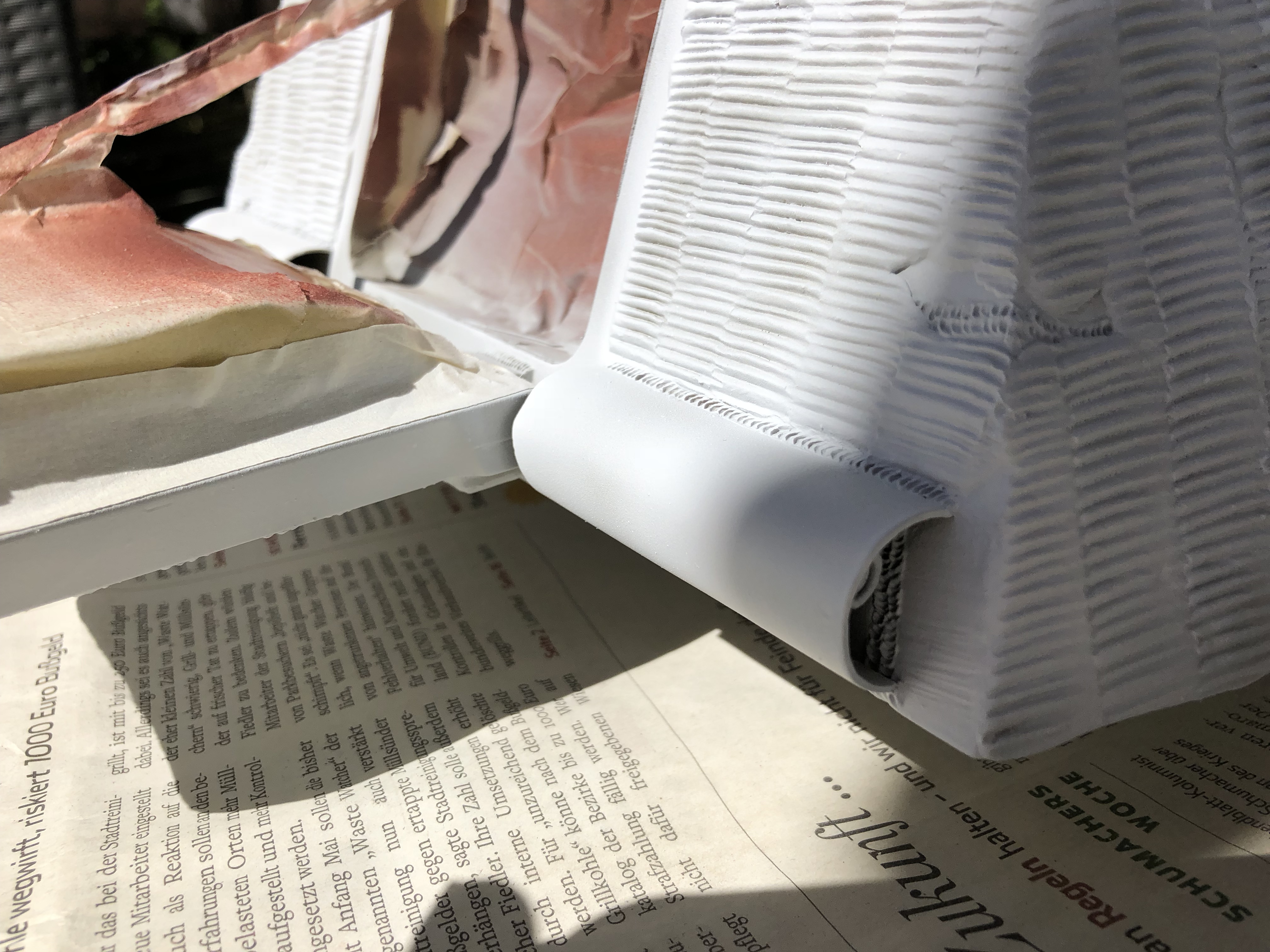

Here comes the next photos of the turret with priming and the first layers of painting.
Regards Martin

Martin Hofmann
Posts: 486
Location: Hamburg, Germany
Has liked: 151 times
Been liked: 2014 times
Re: Martin's King Tiger
Post by Martin Hofmann »
Hi Marco,

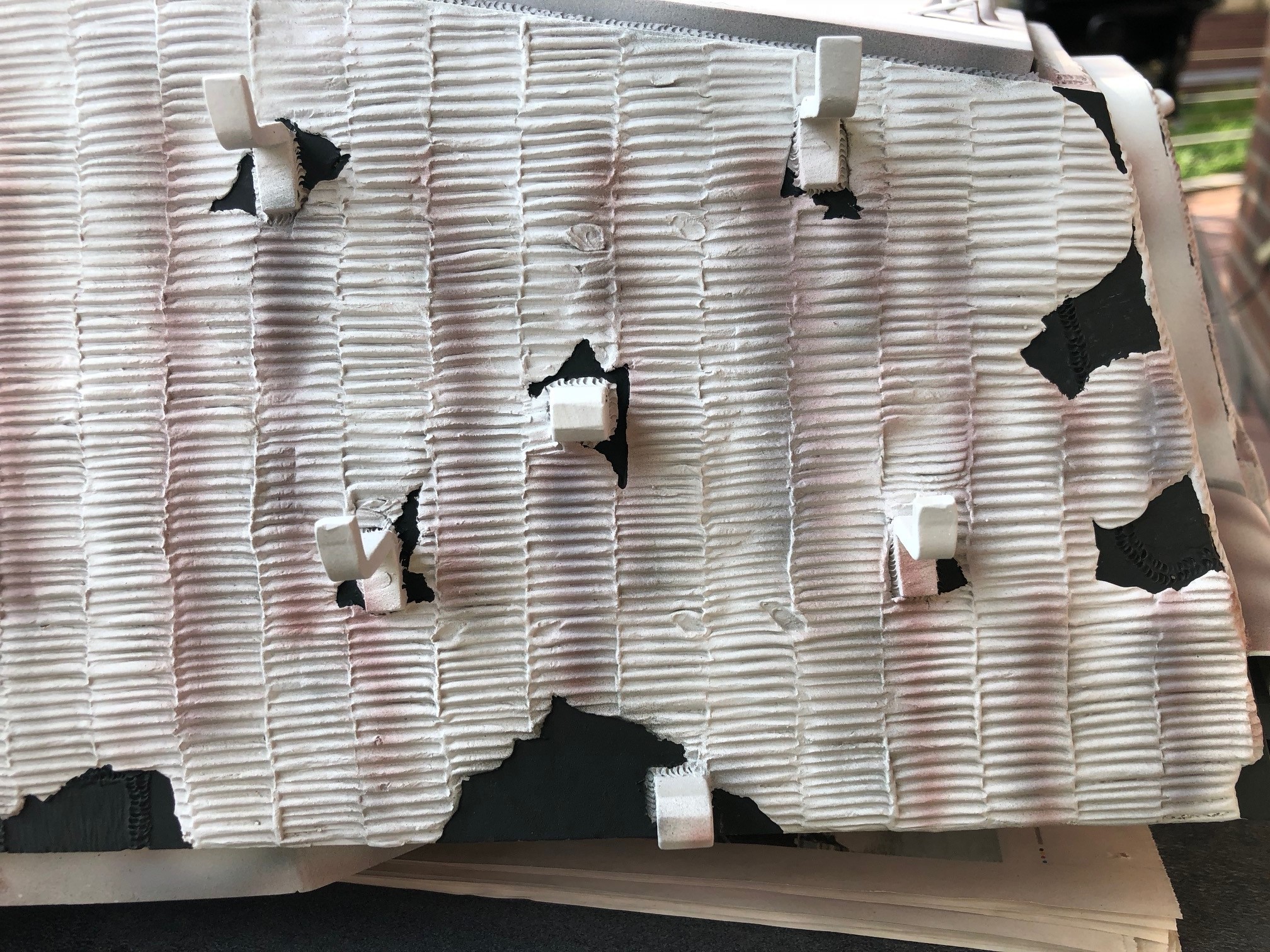

thank you for the nice words, but this is only the begin of a long way of painting and weathering and so on....

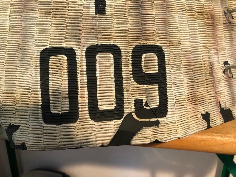

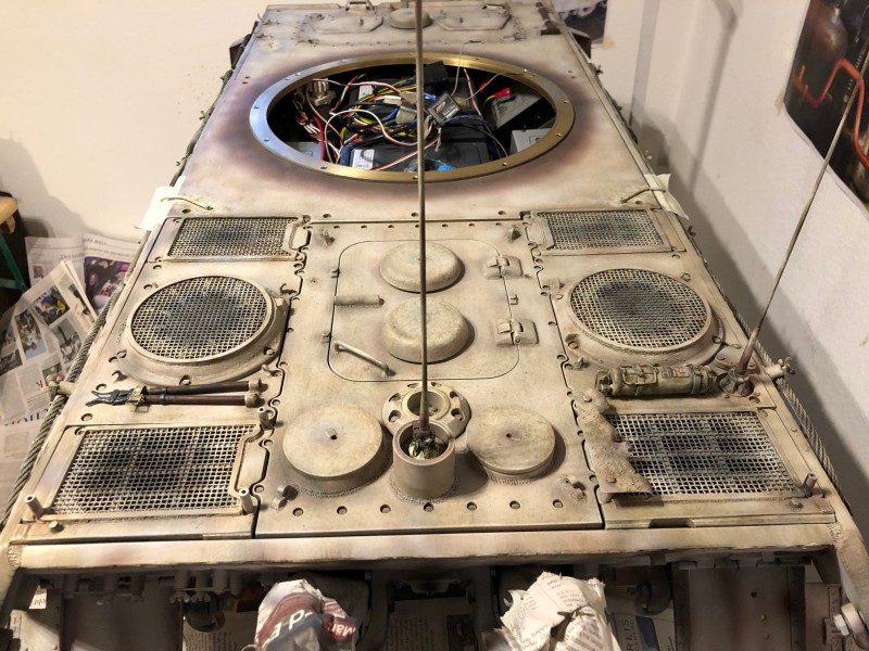

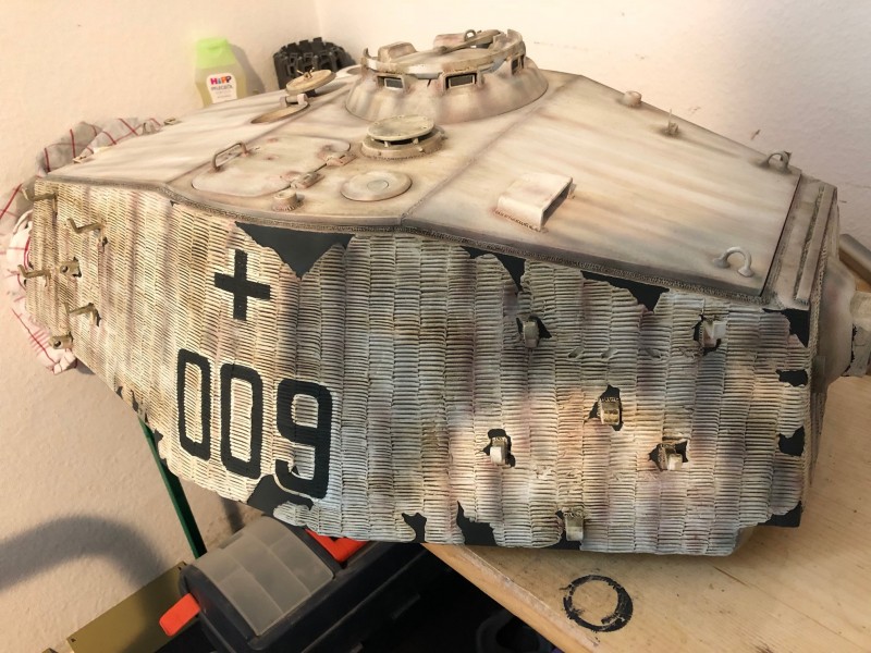

Here are the next photos of the turret with numbers.
Regards Martin

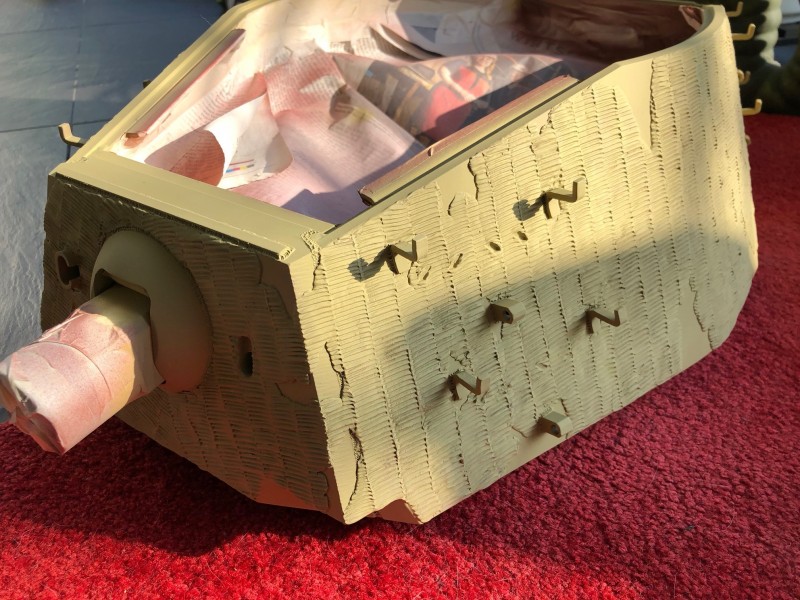

Hi Vince,

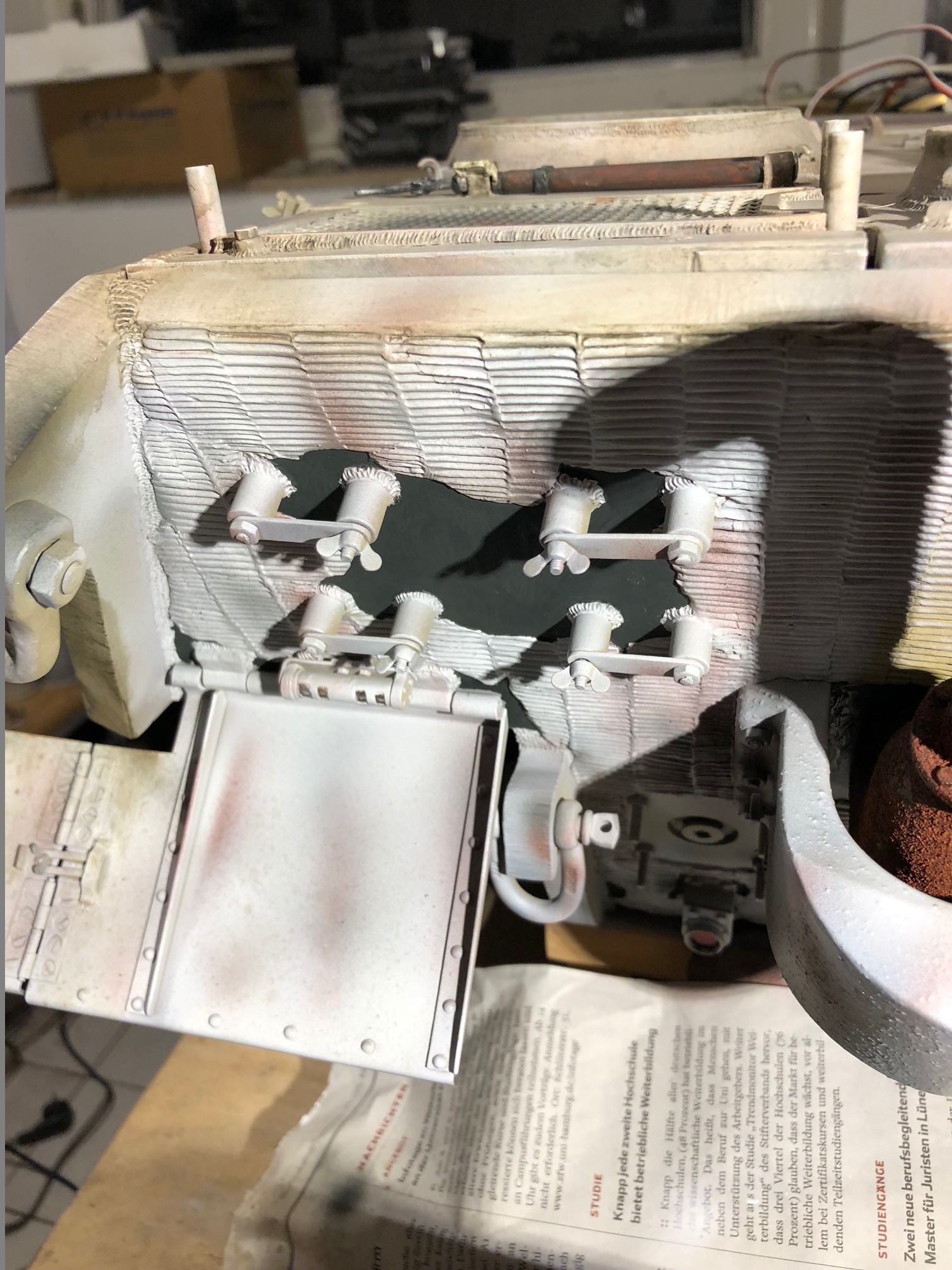

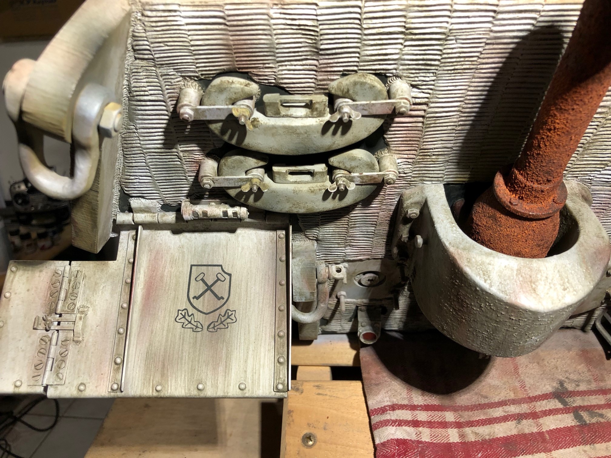

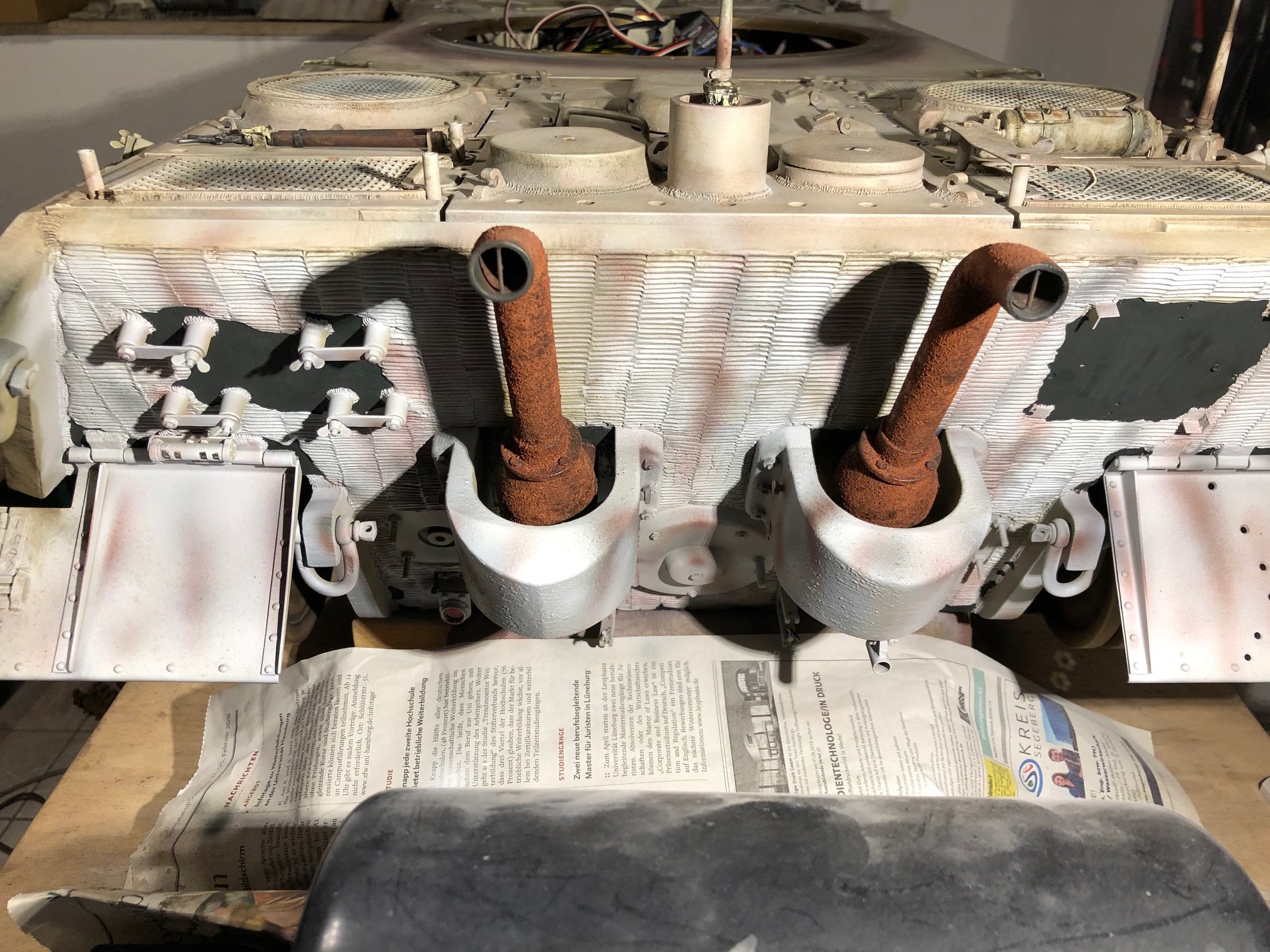

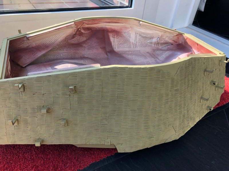

thank you for your compliments. Here comes the next photos of the hull with some weathering and rust at the exhaust pipes.
Regards Martin

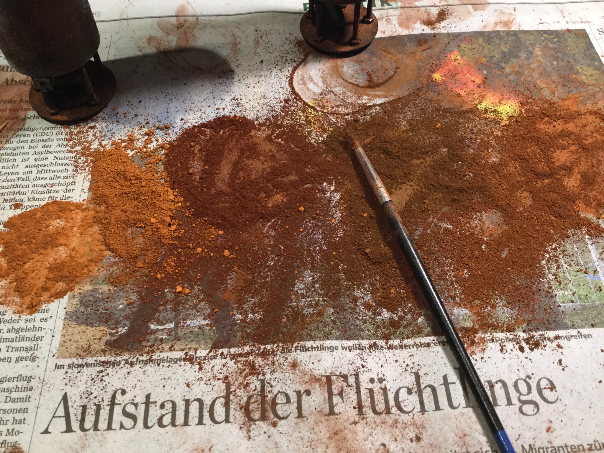

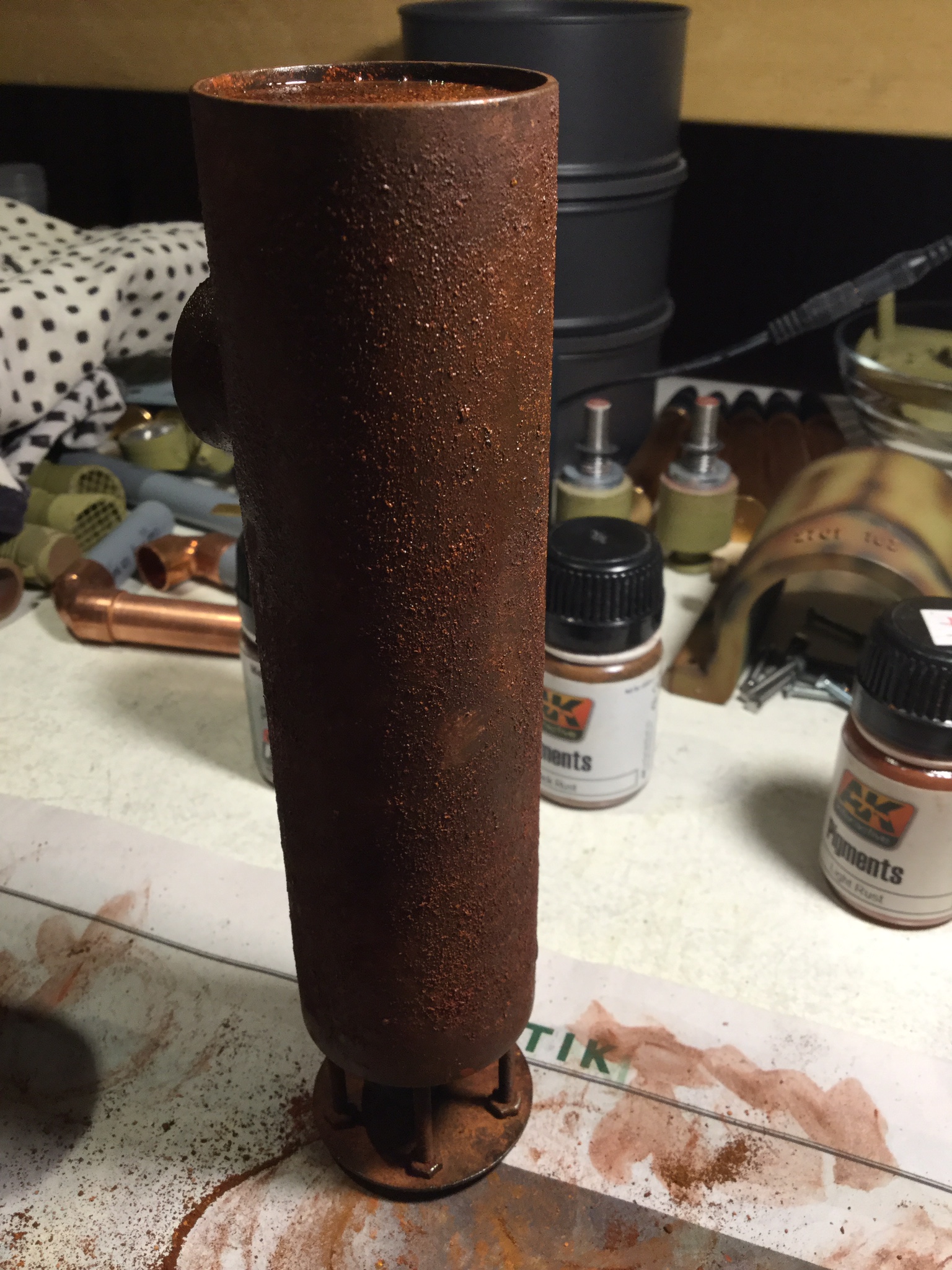

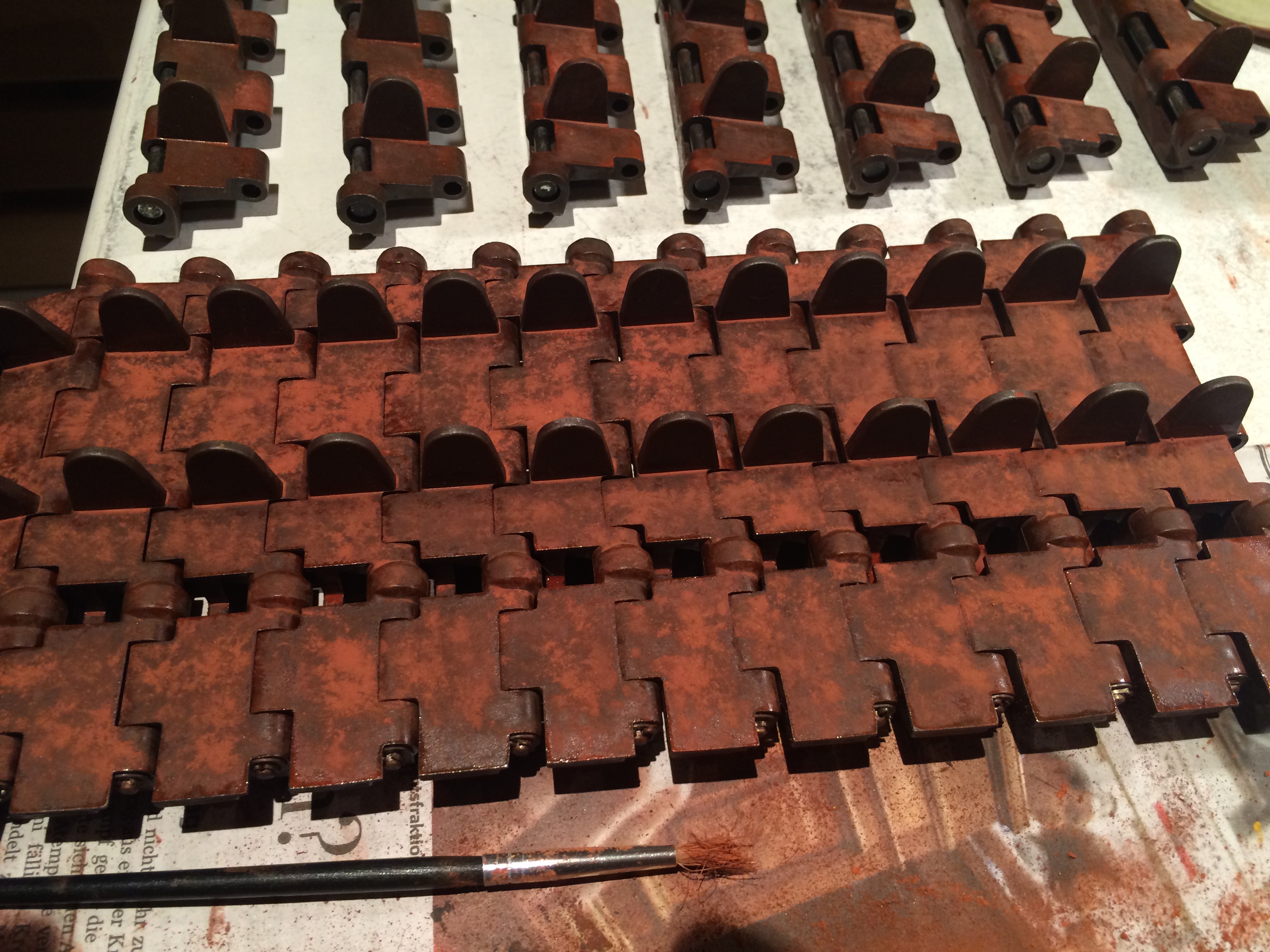

Love those exhausts! Care to share how you did it? :-)

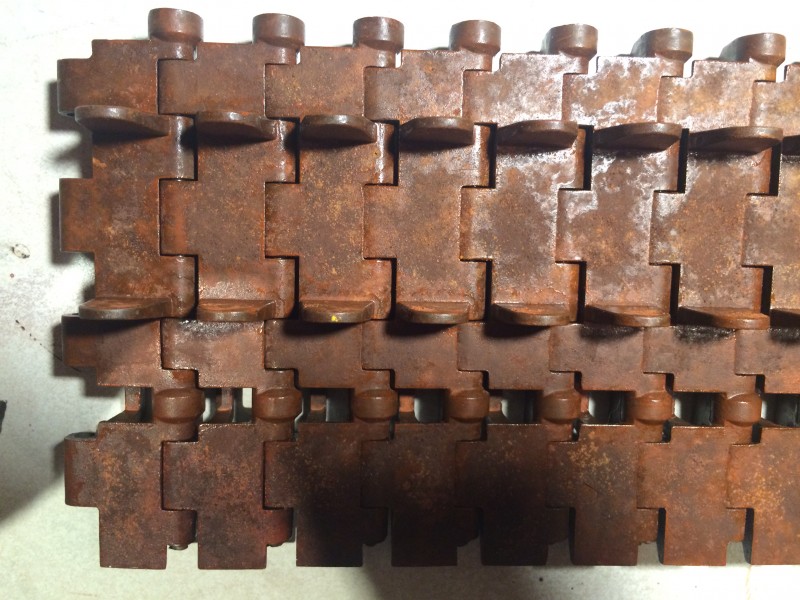

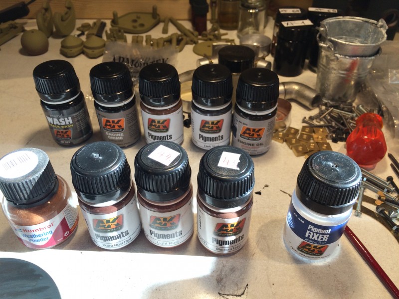

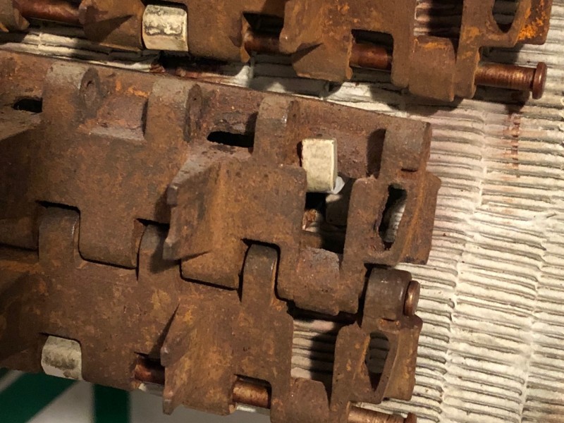

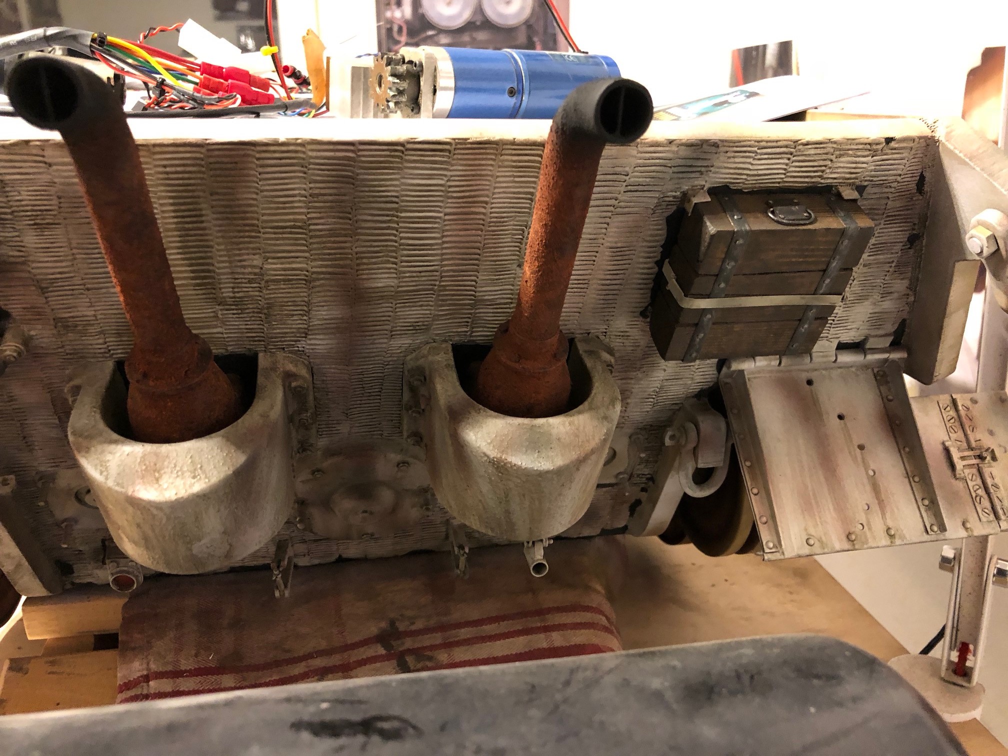

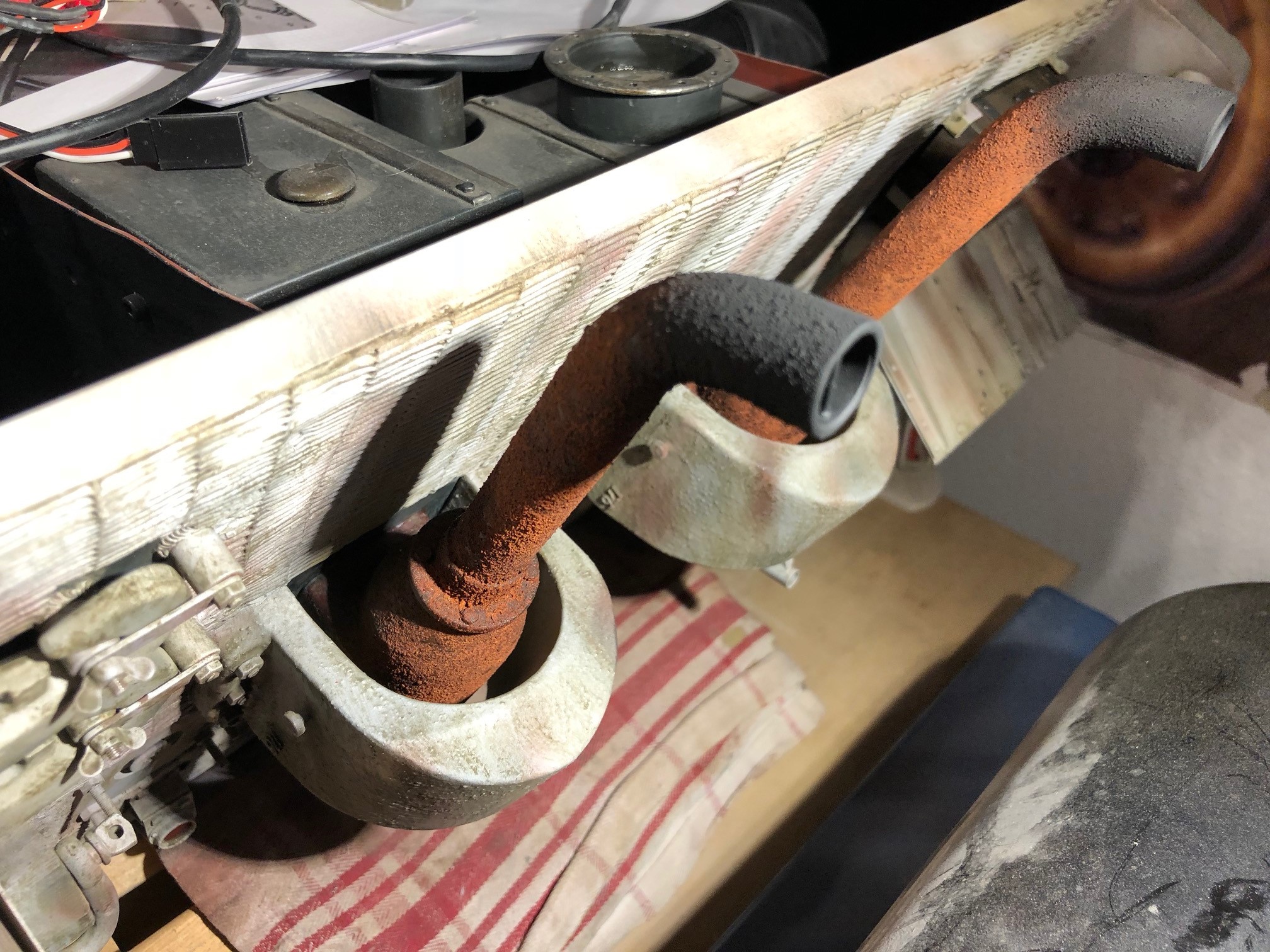

Hi Marco,

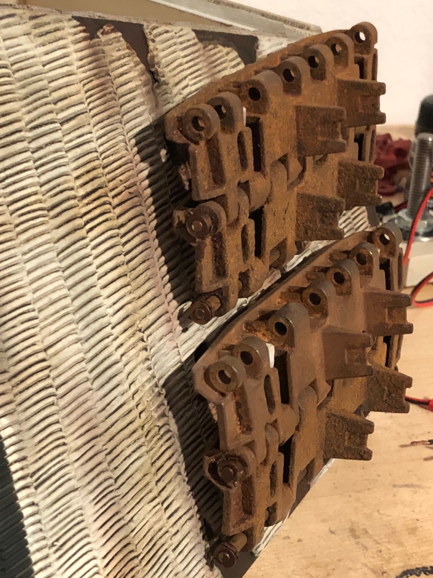

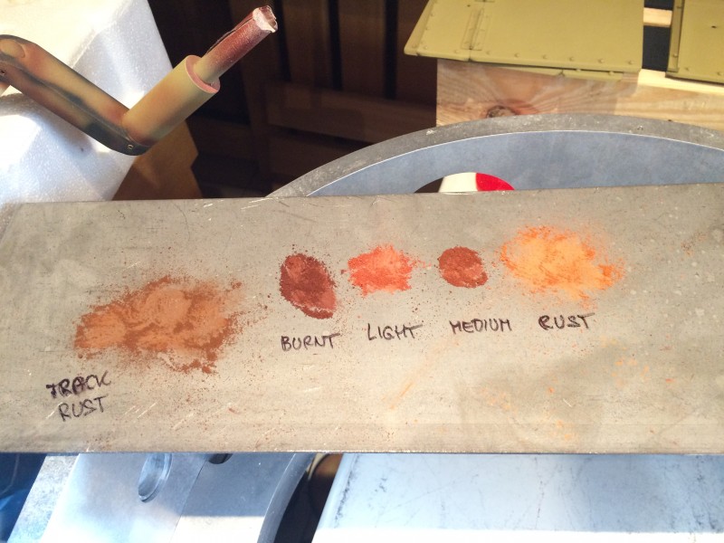

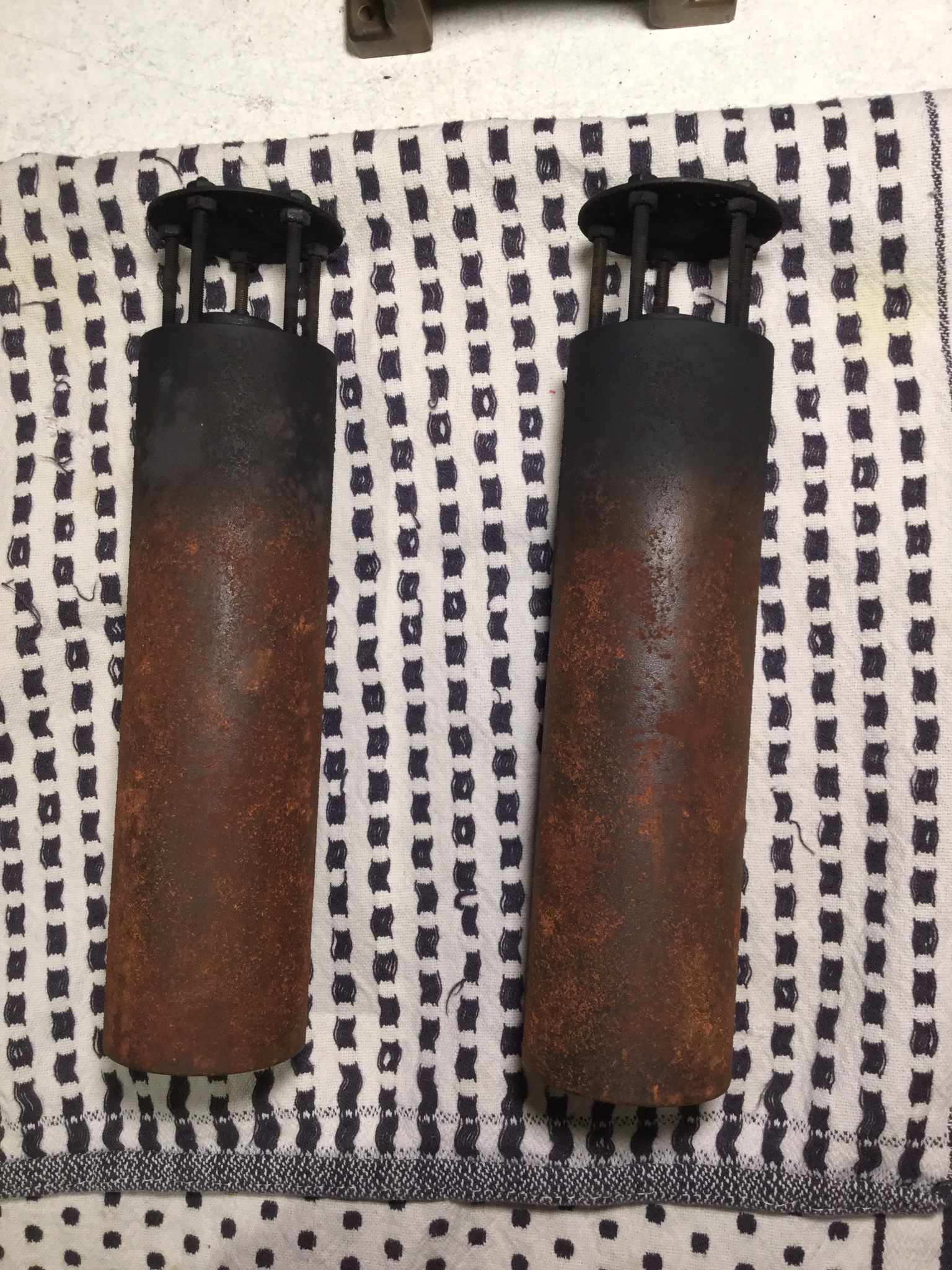

here are some photos of the tracks and the exhaust and the procedure of making the rust for my Tiger 1.
After using the different types of pigments you have to fix it with a so called "fixer". You have to do this with several layers.
Start with the dark pigments and after this take the brighter ones.
Afterwards the end of the exhausts are painted in flat black with air brush.
that is the result
that is the result
Regards Martin

Excellent, I'm pretty oke creating rust myself, actually it even is loads of fun! But the fixer is most likely what created that GREAT texture, thanks!

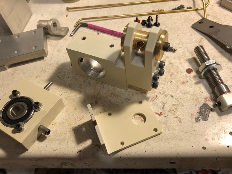

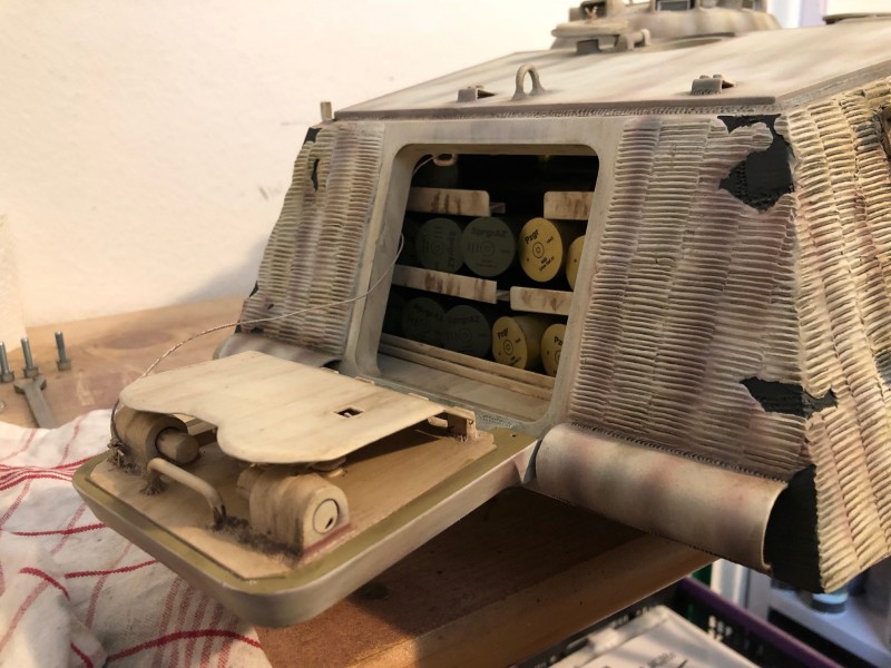

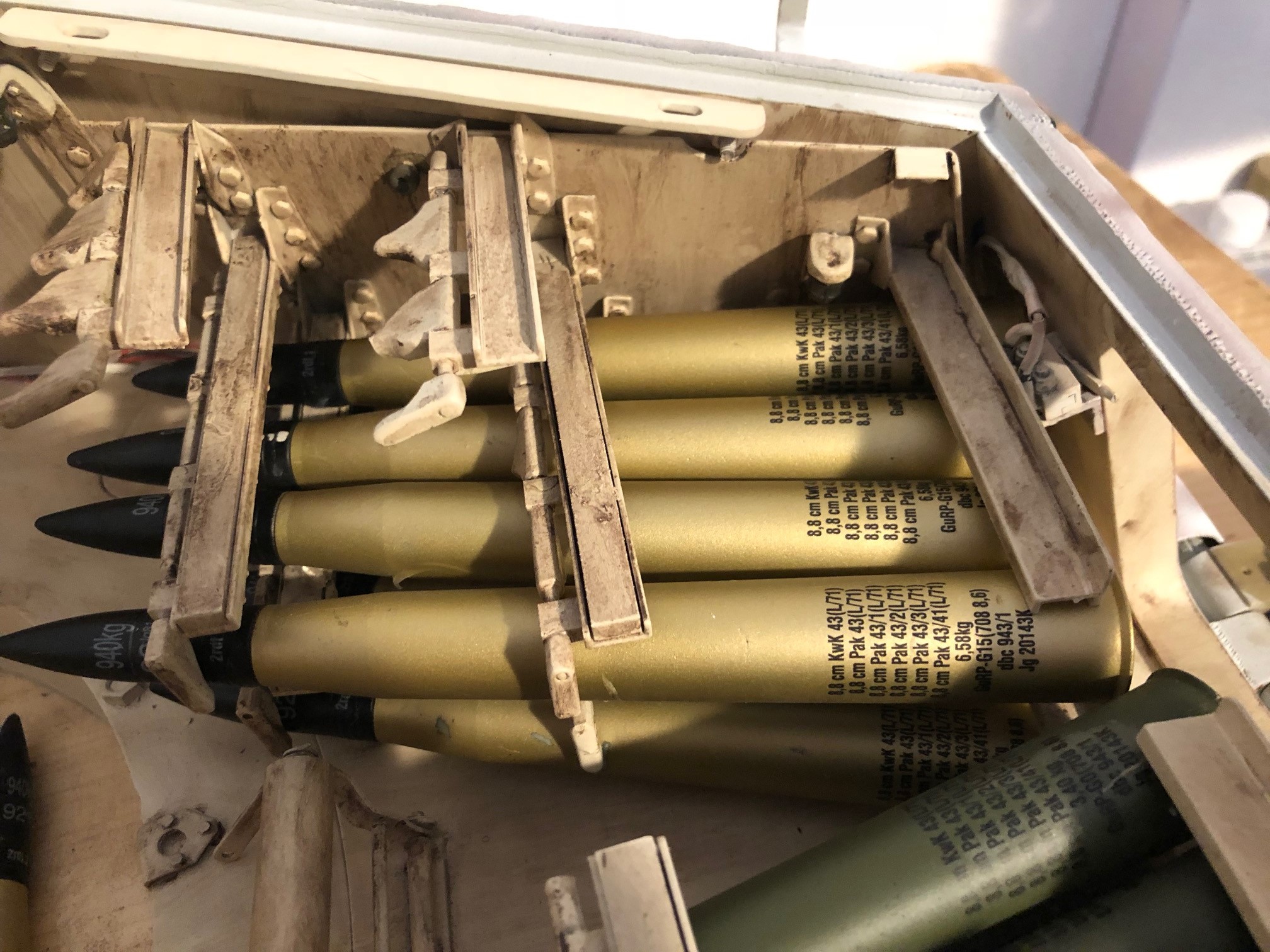

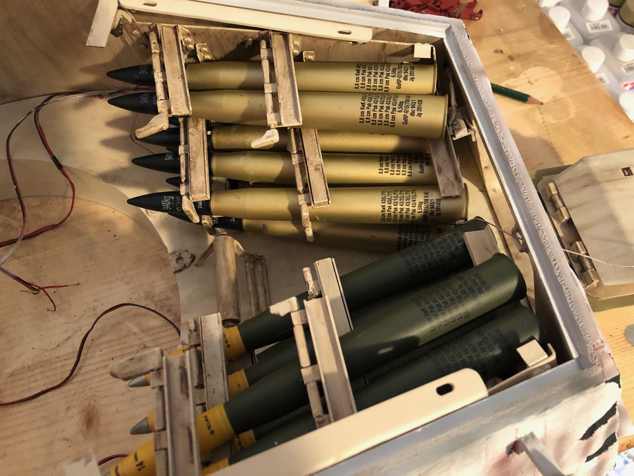

But coming back to the king tiger.

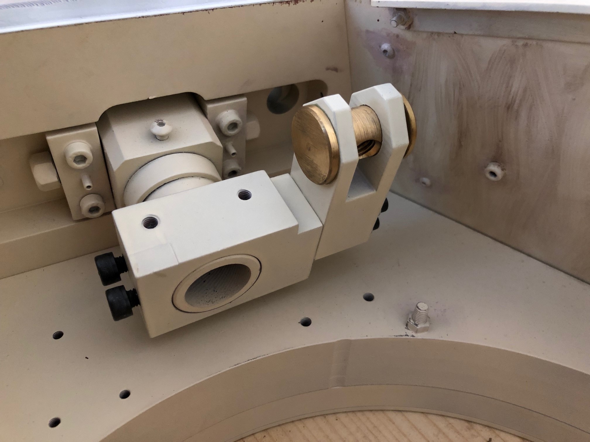

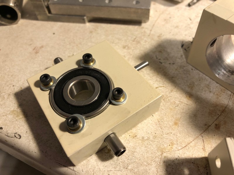

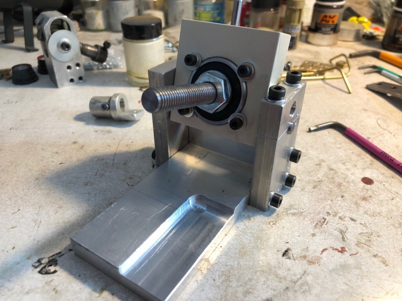

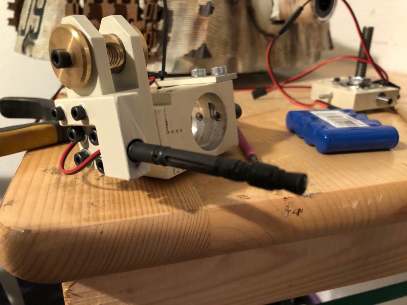

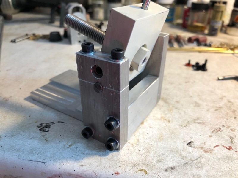

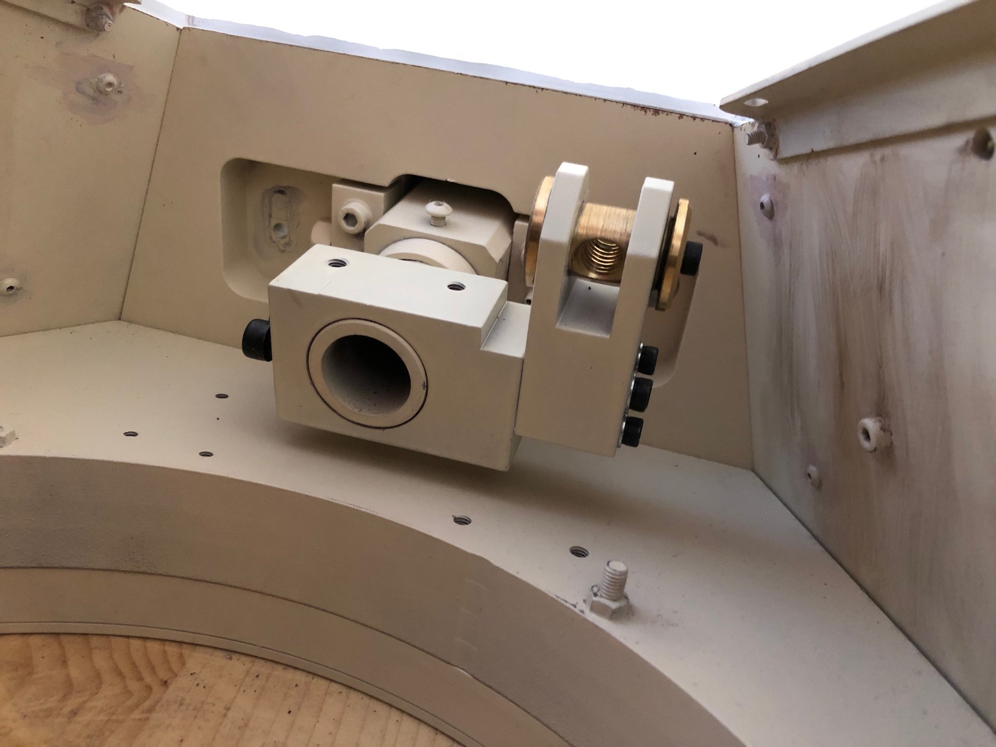

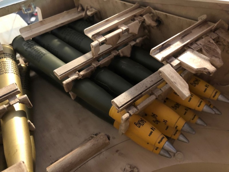

Here you can see the inner room of the turret full of grenades and the first photos of the new barrel adjustment.
Regards Martin
Christoffer Ahlfors
Posts: 702
Location: Stockholm, Sweden
Has liked: 749 times
Been liked: 360 times
Post by Christoffer Ahlfors »
The design looks familiar... :D
Rolf Mönke
Posts: 239
Location: Germany,Hamburg
Has liked: 86 times
Been liked: 176 times
Post by Rolf Mönke »
haben wir das Lager für das Kugellager doch zu flach ausgedreht?
Greetings from Hamburg
Rolf
bosswilli-hh@gmx.de
Martin Hofmann
Posts: 486
Hi Chris,
you are absolut right. That's the same construction like in the Tiger1.
Hallo Rolf,
die Lagertiefe ist genau richtig, weil die Schrauben mit den Scheiben das Lager festhalten müssen - obwohl es eingeklebt ist. Hier ist die ganze axiale Kraft die das Rohr ausübt aufzunehmen.
Here are some more photos of the new design.
Regards Martin

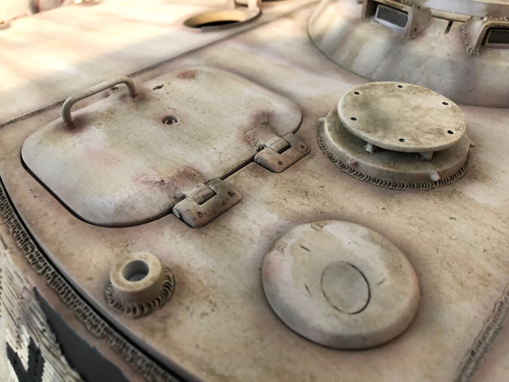

Martin Hofmann
Posts: 486

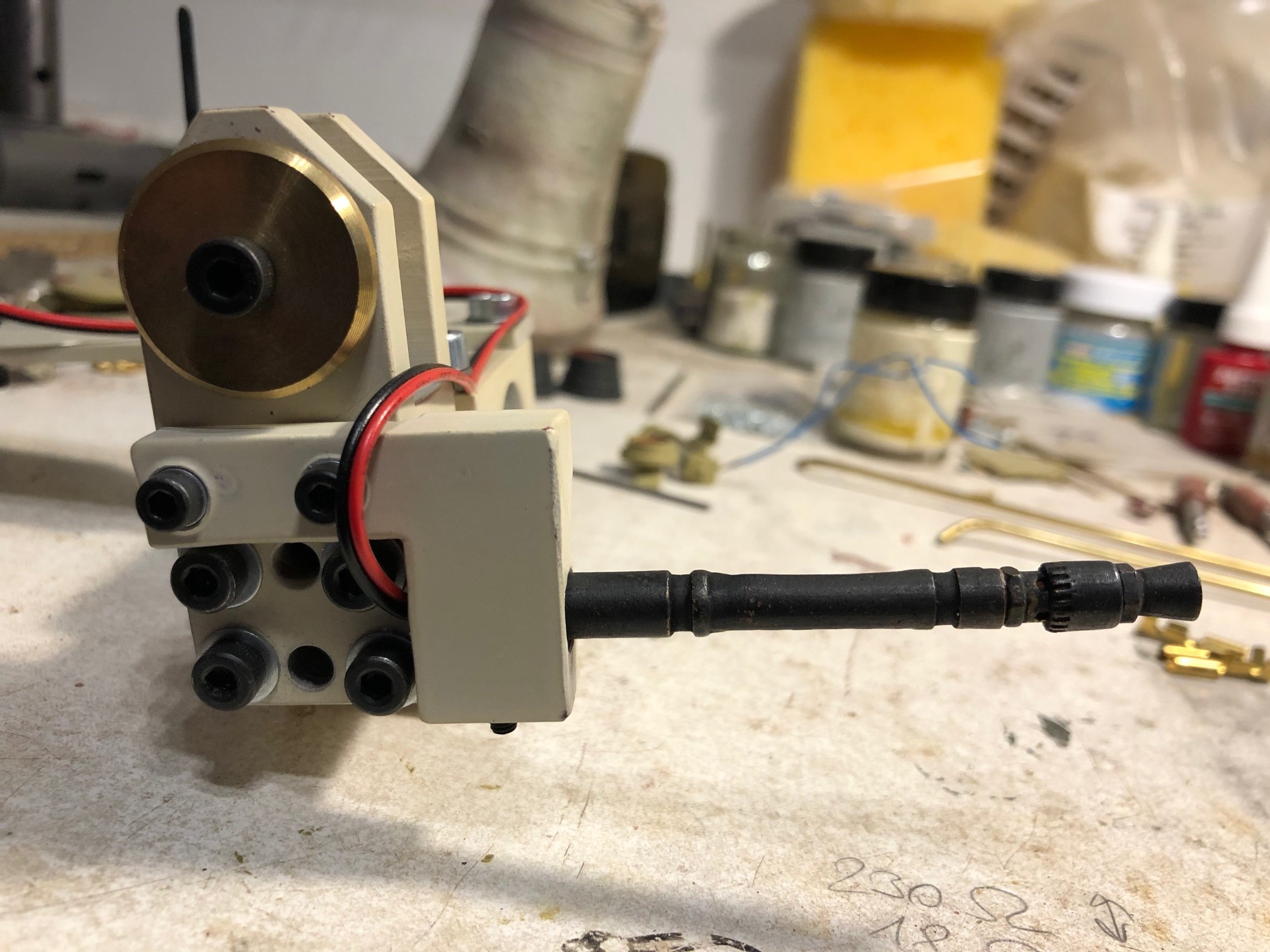

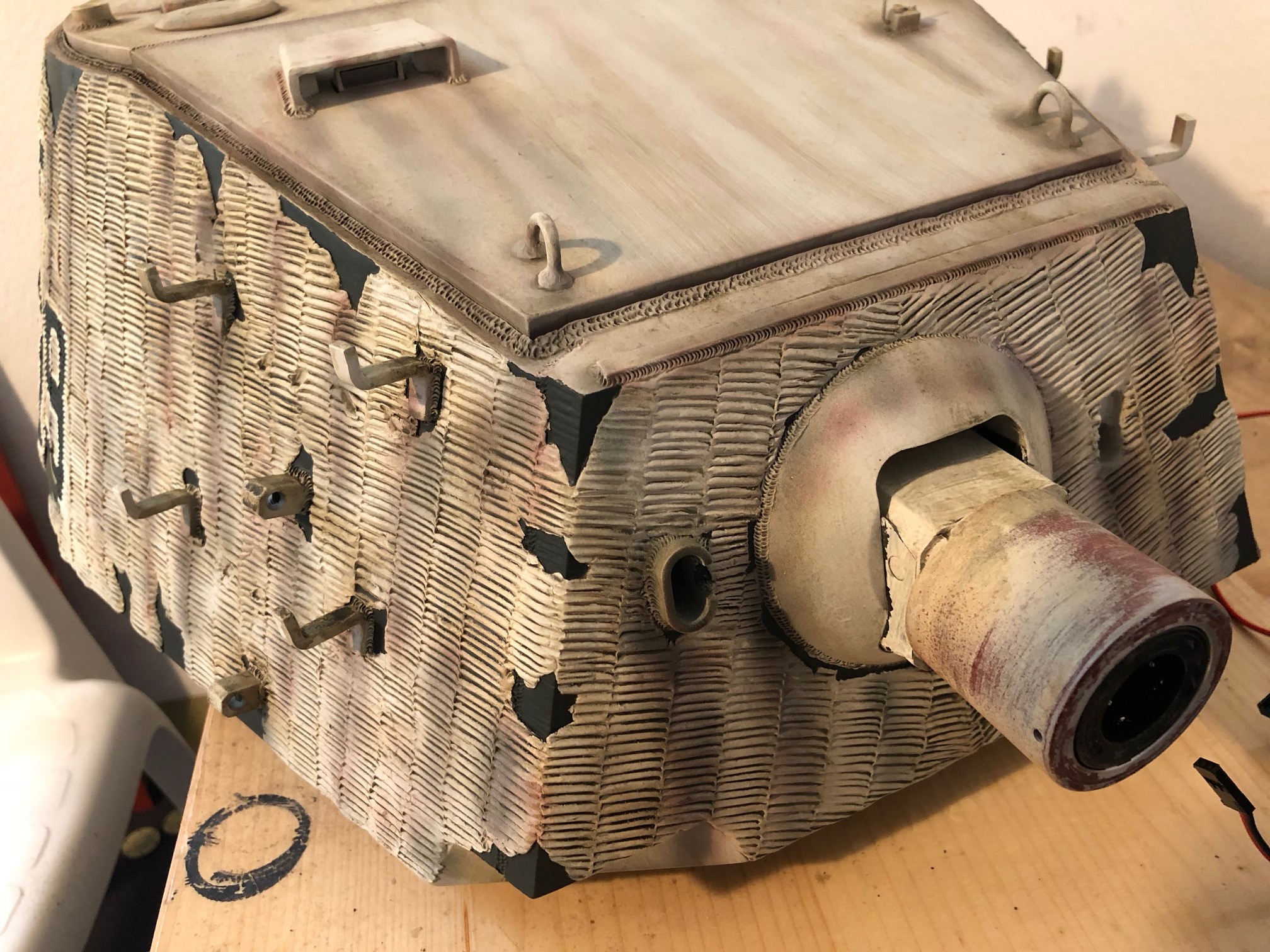

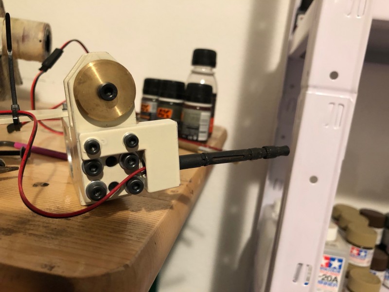

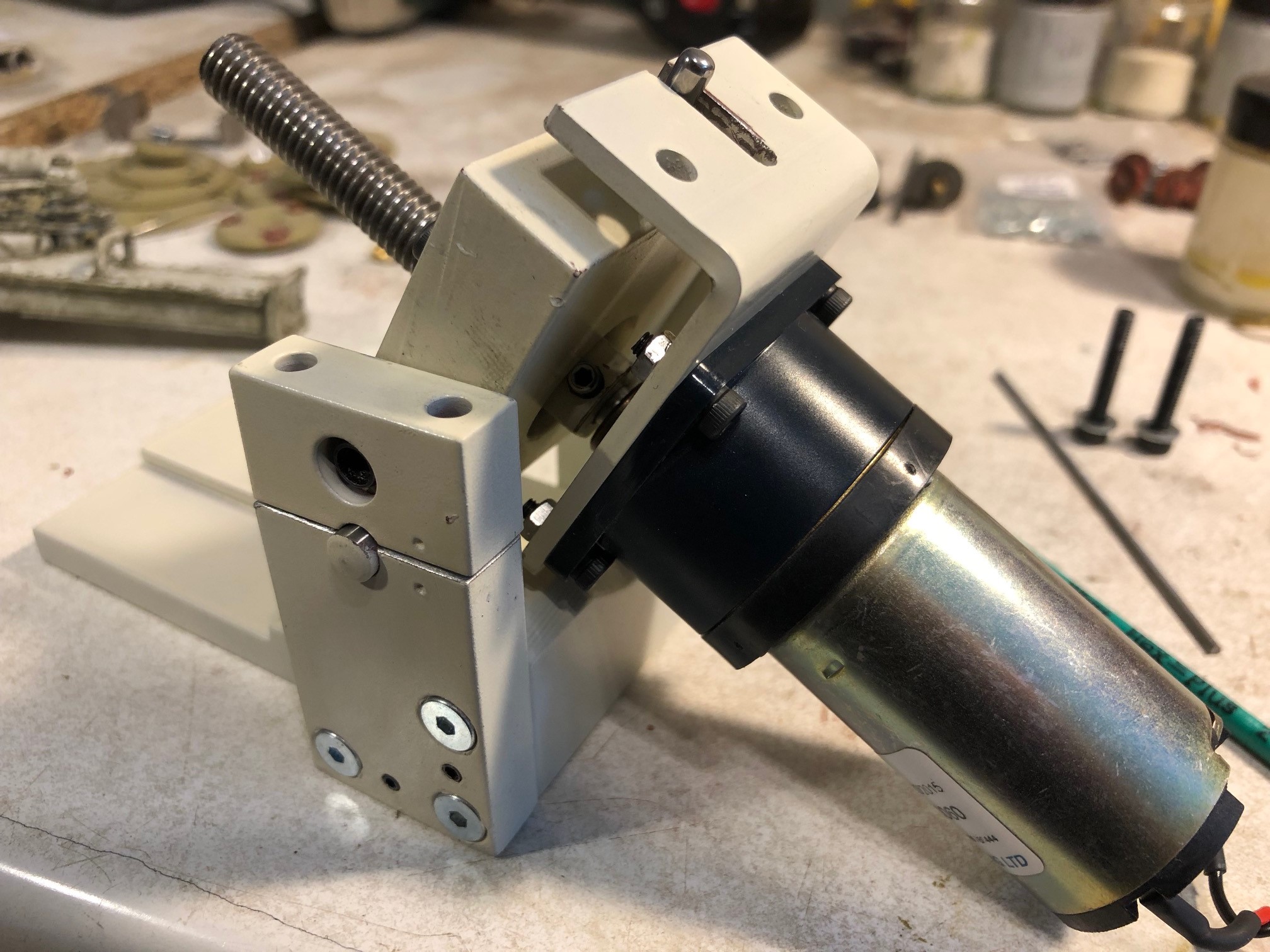

Long time ago, since the last update, but i had some problems with the final drive.
But here are the next photos of the barrel adjustment with paint and motor.
Also new is the turret with some weathering for the first time - more to come.....
Regards Martin
