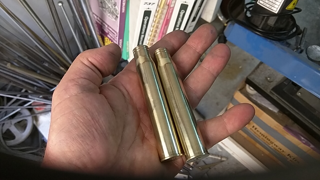

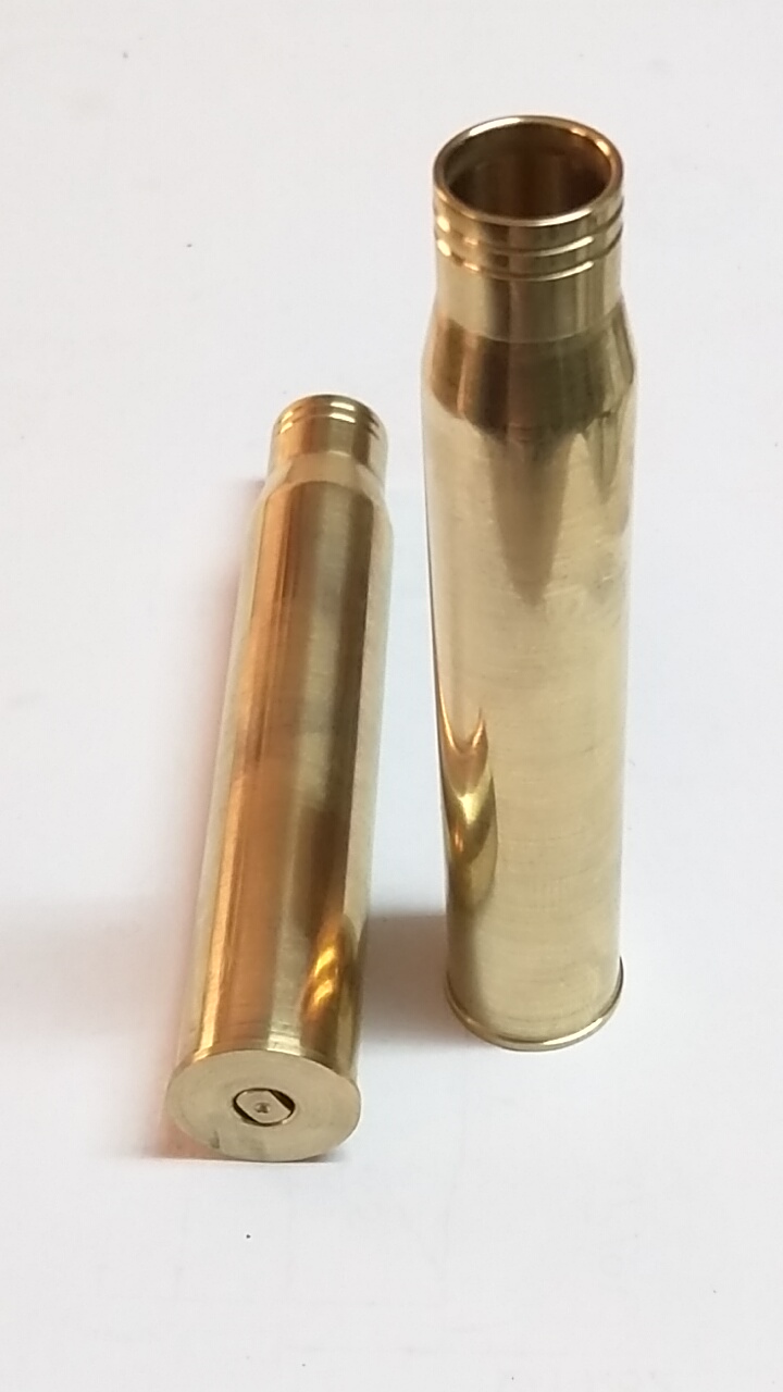

Decided to do two empty shell casings. At first I was going to make them with a resin 3D printer from a commercial printer, but then decided to do them myself in brass. The bottom rim should be 18.5mm for 1:6 scale so ideally I should use a 20mm brass round bar which I did not have. I have 22mm but considered it to be too wasteful. So instead used an 18mm round bar and reduced the other shell diameters by 0.5mm to keep the same aspect ratio.
Half way through the first one had a problem with the lathe motor which eventually I managed to fix also. Enjoyed doing them as it's been a long time since I did some machining.
At the moment they look too polished but the look should improve after the brass gets naturally tarnished.

They look good Vince, and half a millimeter?..........if you had said nothing who would have been able to tell?

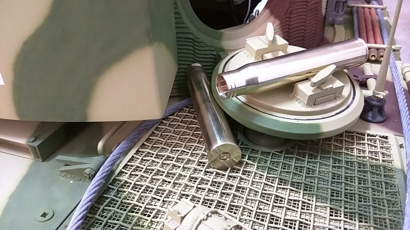

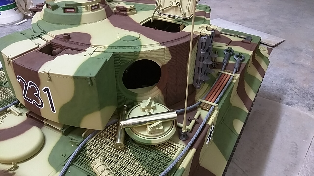

Absolutely beautiful!
Tarnished? There would not have been time for them to tarnish naturally from manufacture to their use at the front. But perhaps the temperature when firing tarnished them instantly? Perhaps any real tankie here can advise?
- Has liked: 792 times
They look beautiful Vince, as far as I am aware the tiger shell cases were in fact electro plated steel. Electro plated with a brass alloy.

very nice work you have done with the casings they look very good.
A bit of background on 88mm casings; pre-war these casings were indeed made from brass at the beginning of the war this quickly moved onto brass electroplated steel casings by mid war the casings were being released as parkerized steel and also lacquered plain steel. Throughout the war casings were recovered and returned to the factories to be re-charged and re-issued this means that a mixture of casings would have been issued and by 1944 brass casings would have been quite rare the majority would have been the parkerized and lacquered plain steel types.
Thanks Phil, Bob and Mark for the nice comments and also for that info about the shell casings.
I knew about the brass and also about the steel casings but did not know about the plated steel variant. Learnt something new.
p.s. Been looking at the King Tiger casings and they are bigger than the Tiger 1 casings.
