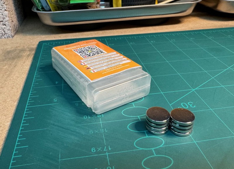

I have also started the hub caps for the road wheels and idlers with a light scuff up and check for bolt fit.
I have decided that some 14mm x 2mm magnets are going to be used to secure these to the road wheels rather than the recommended Loctite.
After checking to see if the plan is going to work these have been epoxied into the cap.

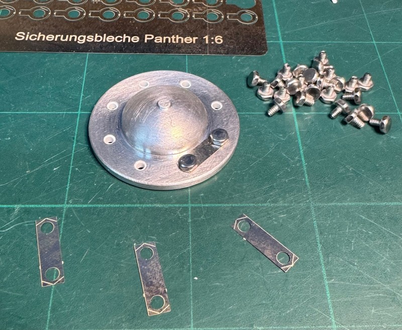

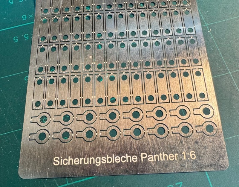

The PE nut locking plates for the roadwheel hubs have arrived from Germany.
It looks like I will have to use M2 bolts after all if I want to use them as the M2.5 dummy ones supplied with the kit are too big to be able to bend over the locking tabs.
So I've ordered M2 x 3mm Hex headed bolts from China.
While I wait the few weeks for them to arrive I have moved onto the Drive sprockets.
I'm using M2.5 Castle nuts on the outer face of the sprockets so have started clean up of these.

Malcolm.Plumb wrote:
Sat Oct 28, 2023 3:59 pm
I also wanted to know where to find that locking plate.
Also M2 nut does look better in terms of scale wise.
Great detail on your wheel part.!

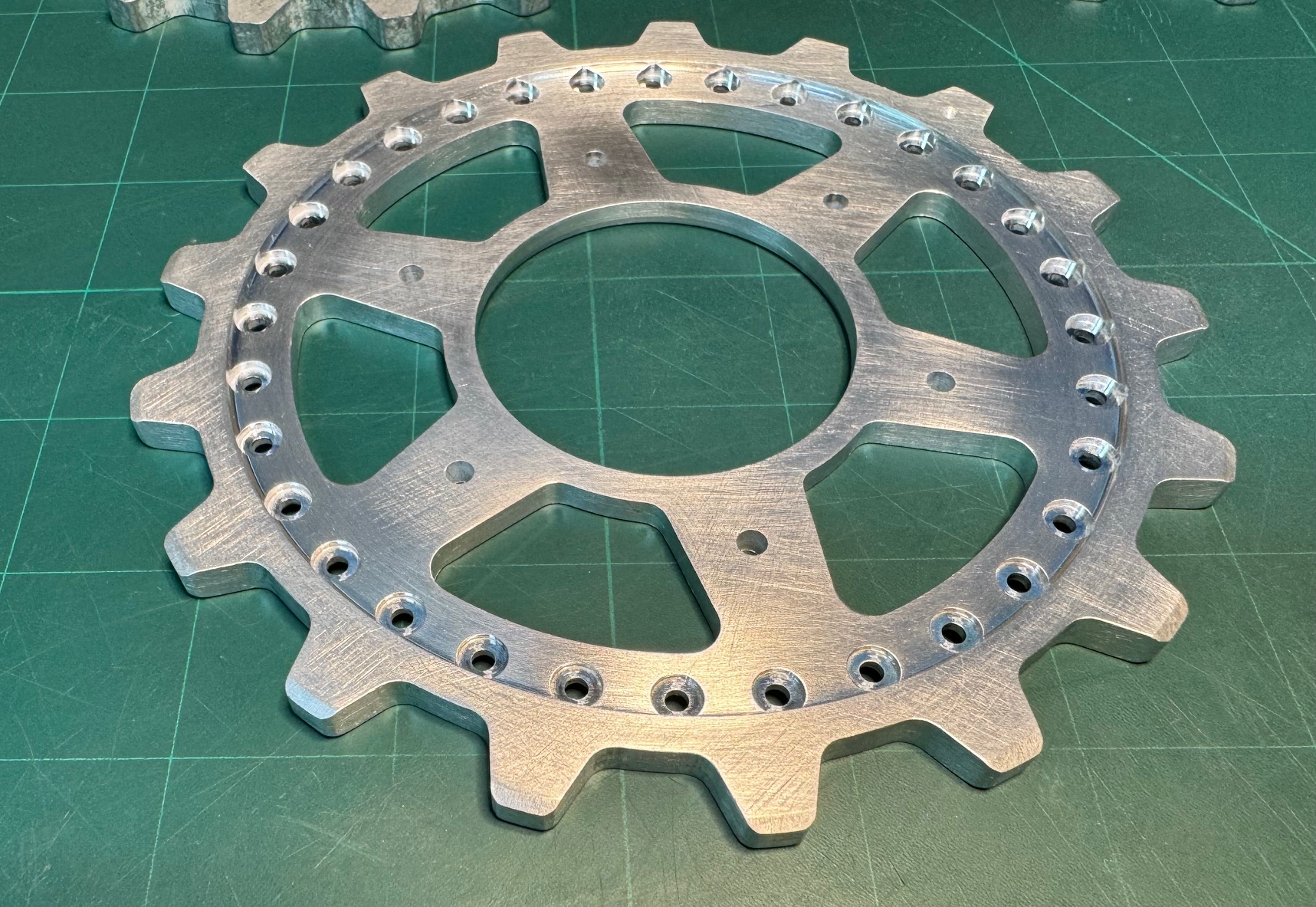

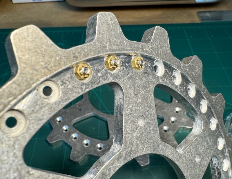

While I wait for all sorts of different replacement bolts to arrive I have started work on the drive sprockets to be ready.
Only a short time out on the build tonight but managed to get the holes on the rear of the outer sprocket counter sunk to take the M2.5 hex bolts that are going to be used along with the castle nuts.
Next up will be the chamfer on the drive teeth.
How much of a chamfer is recommended here? Just the top edge taken off with maybe 4 - 5mm?

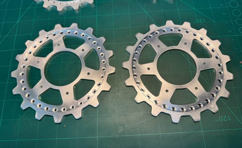

That's both outer sprockets sorted and ready for a light coat of primer and ring of bolts :)

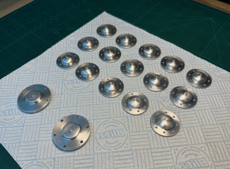

I have managed to have a few hours painting today and have finished the initial priming of the drive sprocket parts ready for assembly and also get the road wheel and drive sprocket hub caps painted with the top coat. :)

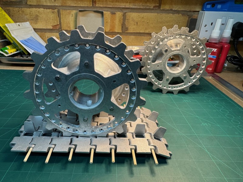

Assembly has just started on the drive sprockets with the outer ring of castle nuts completed.
The holes in the back of the sprocket have been countersunk to accept a proper bolt and newly purchased 6mm Hex bolts used to try to keep the amount of thread showing reduced.
Pretty pleased with how it turned out :D
