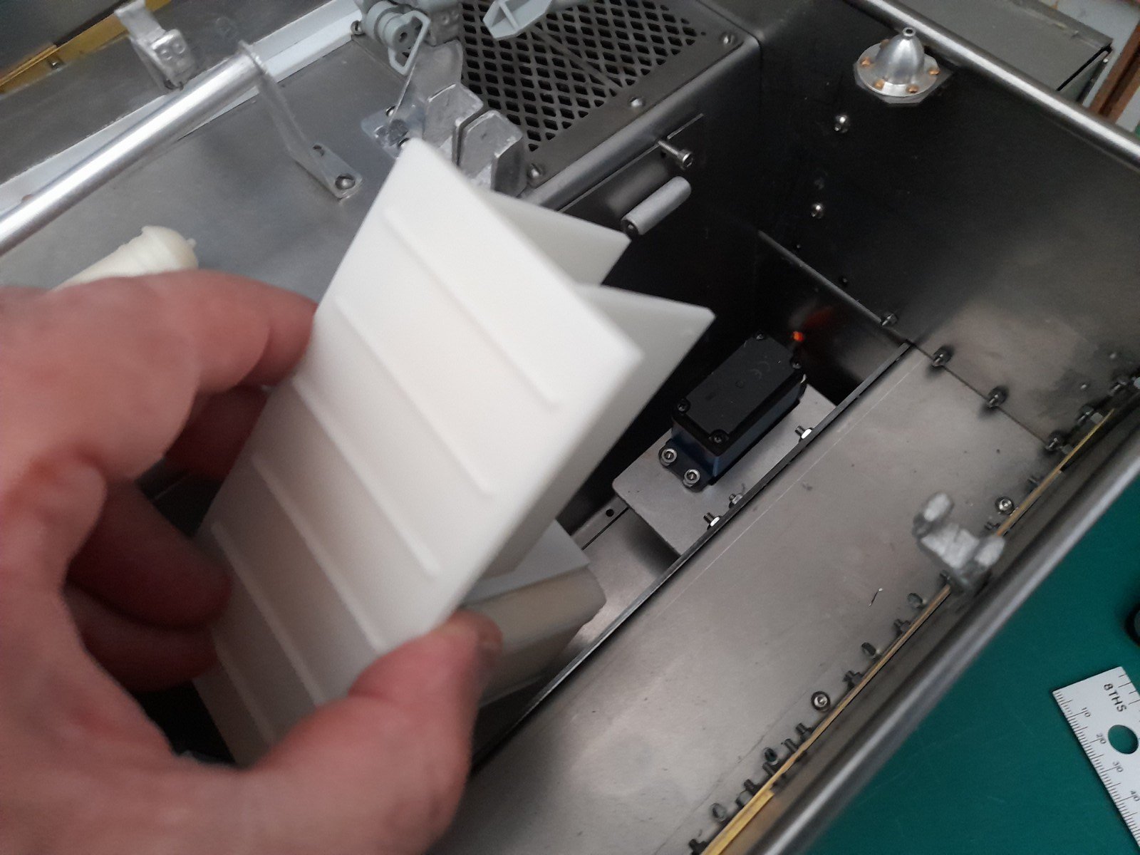

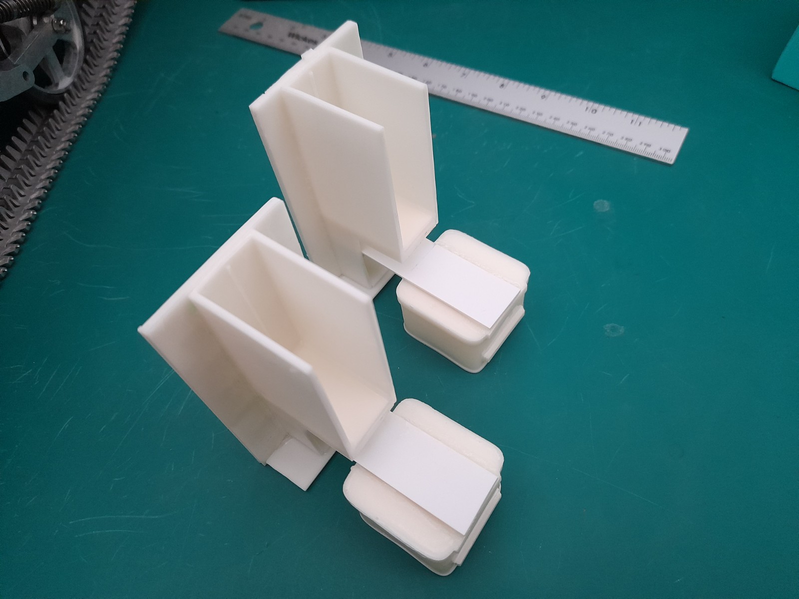

I've used a strip of 2mm plasticard to glue the fuel tank front to the bin assemblies so the whole lot just lifts on and off now to get to the braking servos. I've done something similar with the battery and No19 set so I can get it all in and out as a block.

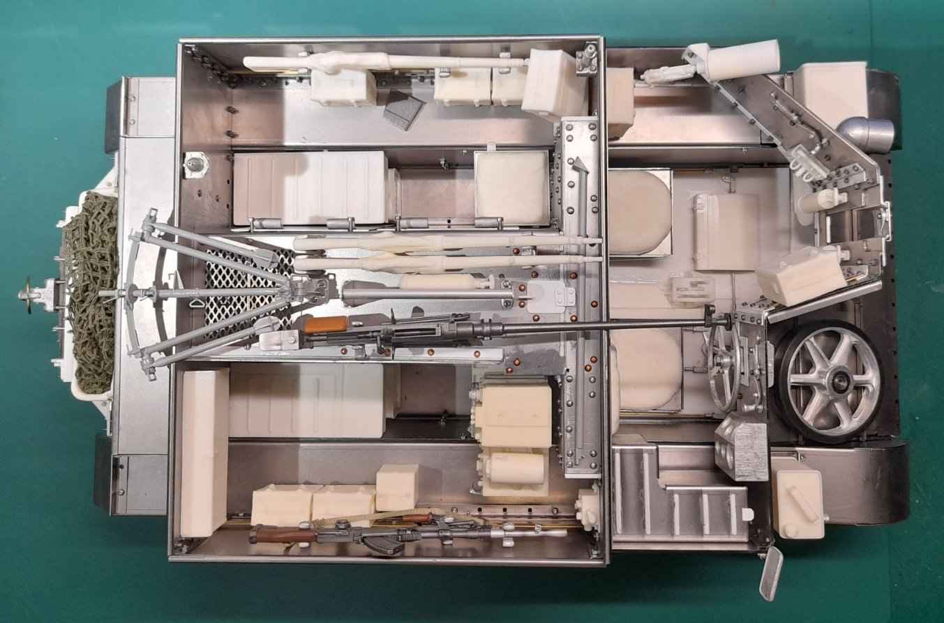

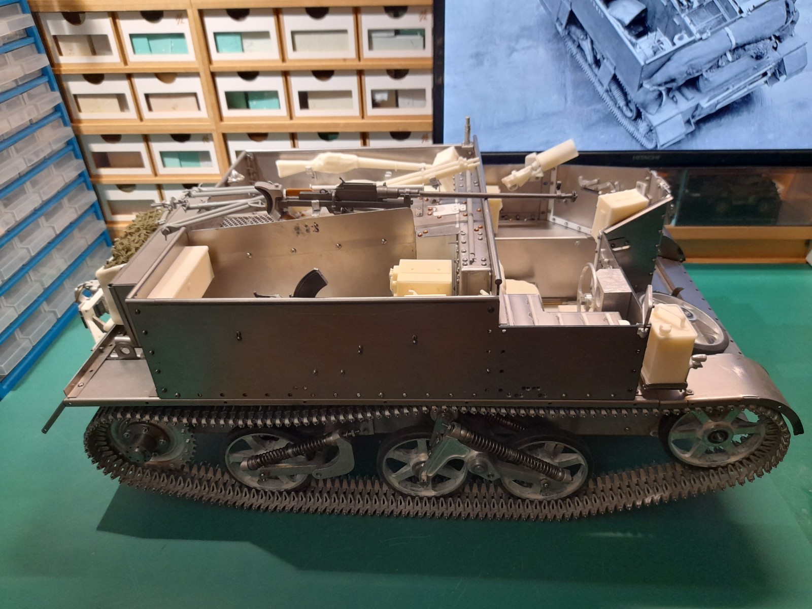

Most of the set now fitted, just need the final moulds (hopefully later this coming week) to finish the front floor and a few odd details.

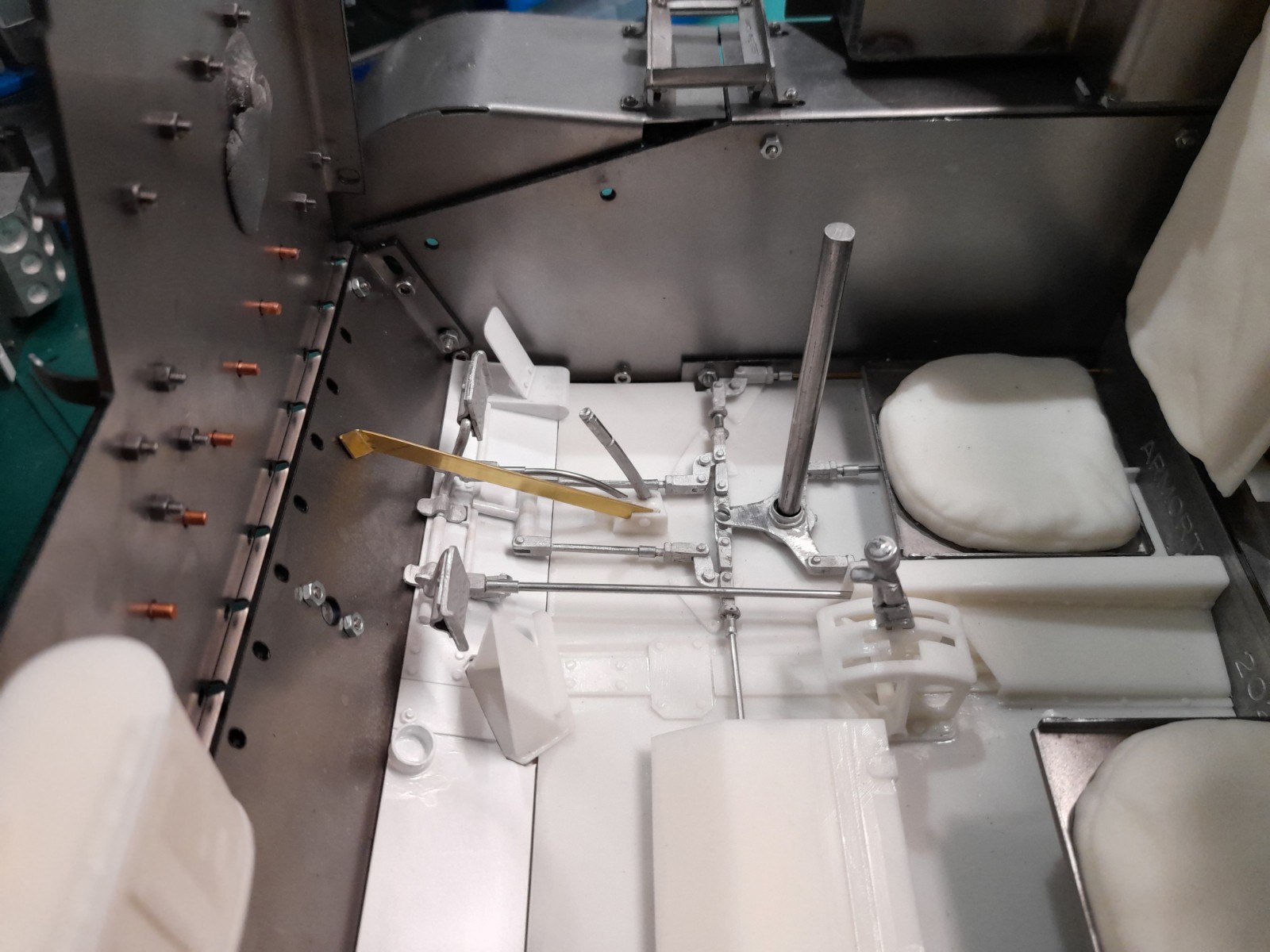

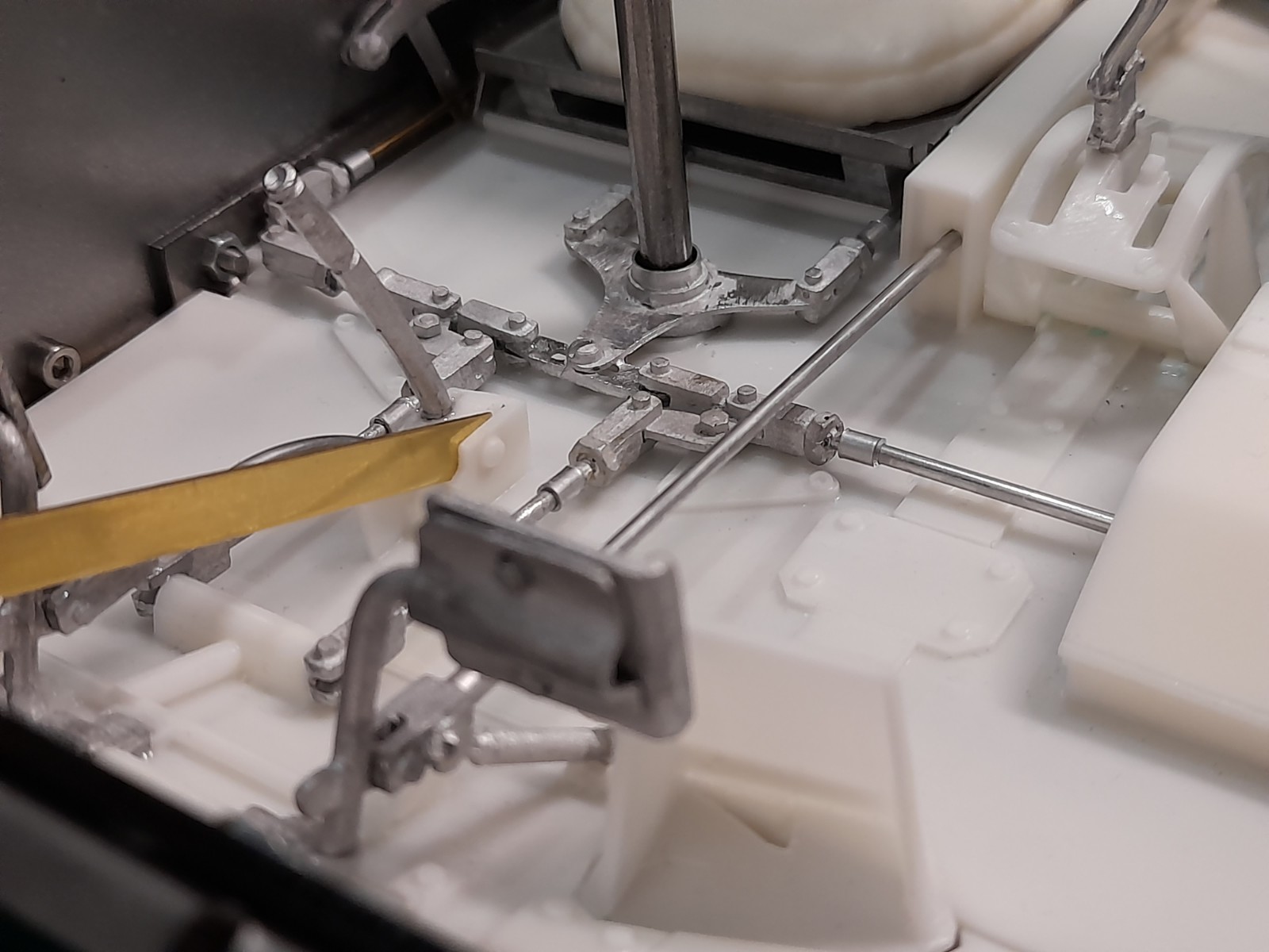

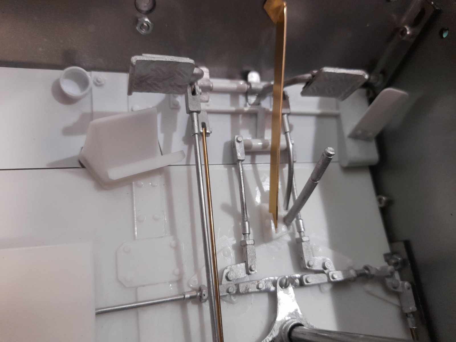

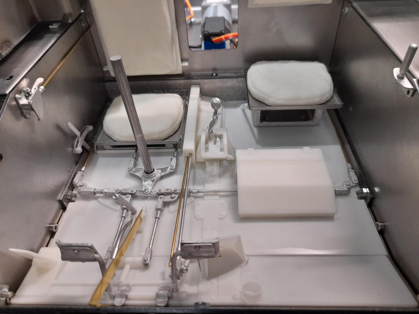

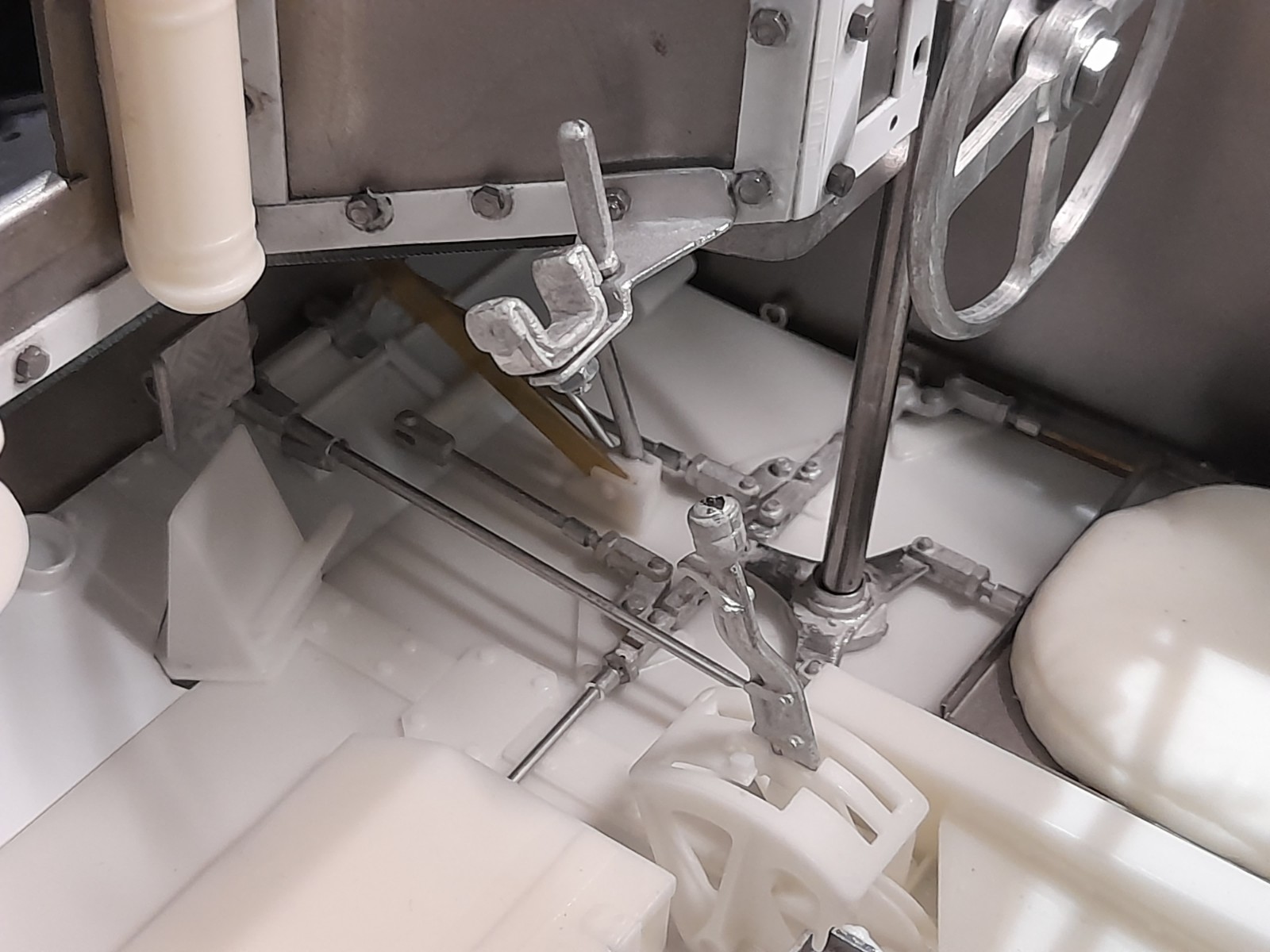

With the pedals etc. off mould No 3 cast today I have been able to finish the final bit of the floor plate. This is now sitting in freshly poured silicone. Mould No 4 has also just finished cooking

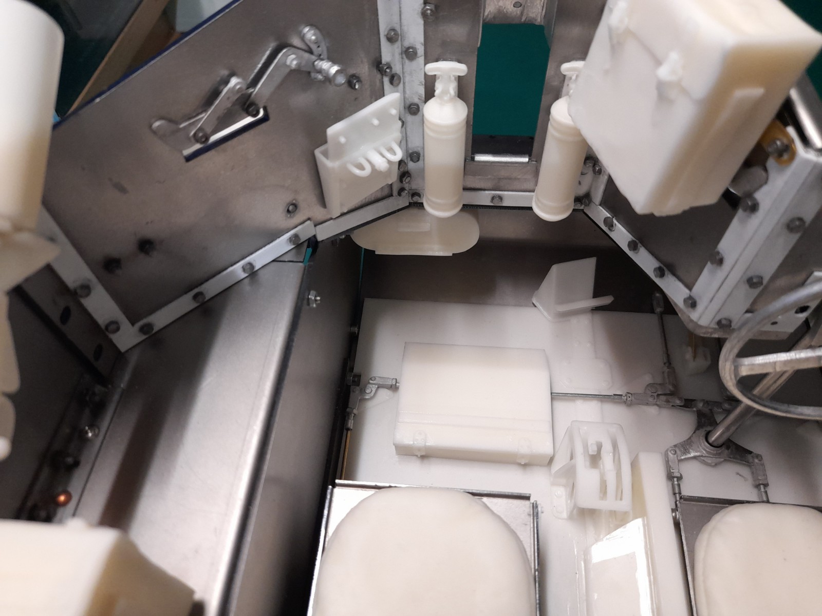

Re: Armorpax's Armortek UC - No.18

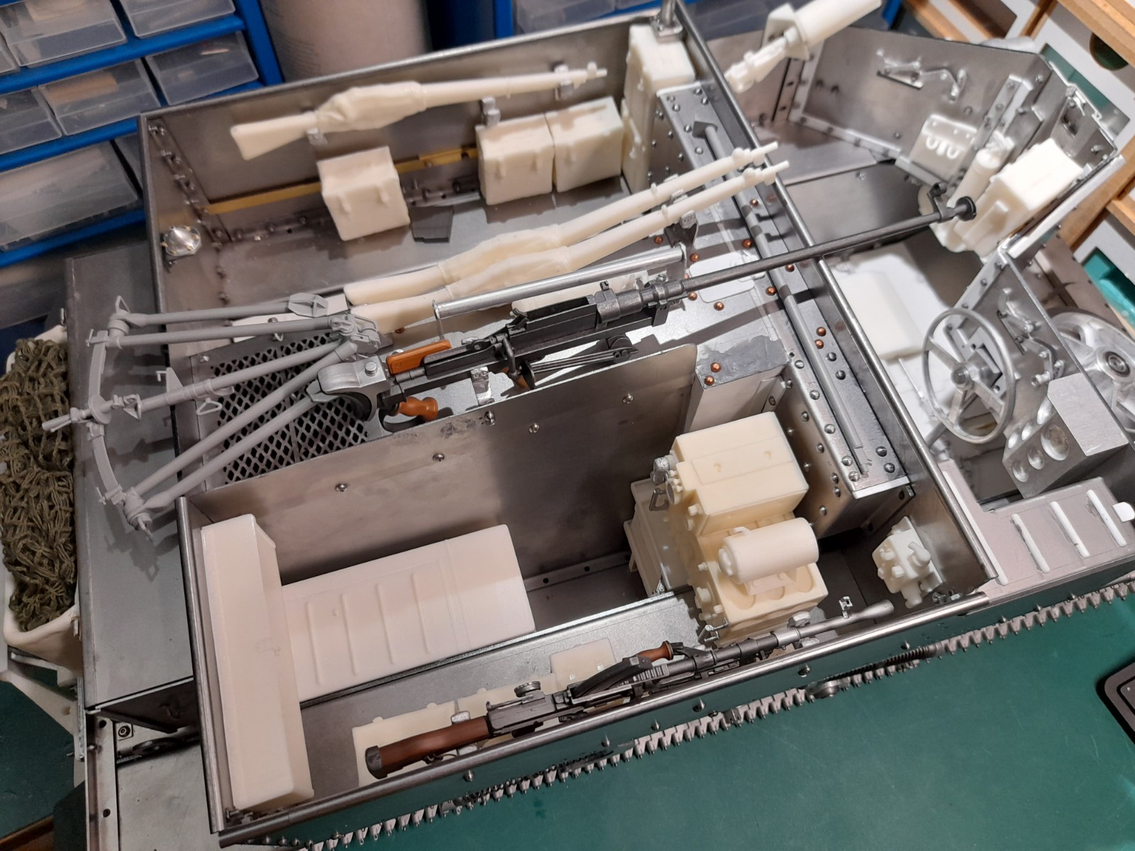

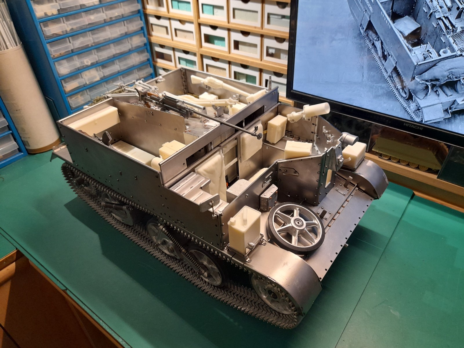

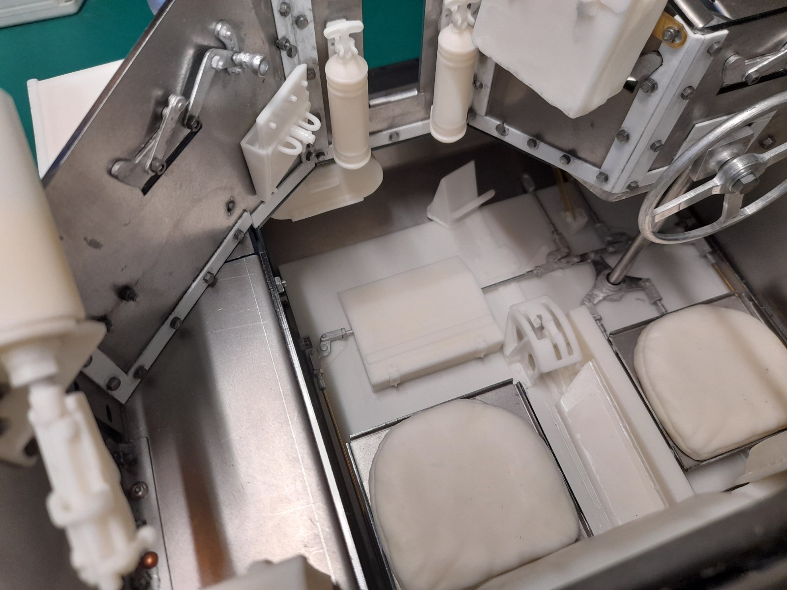

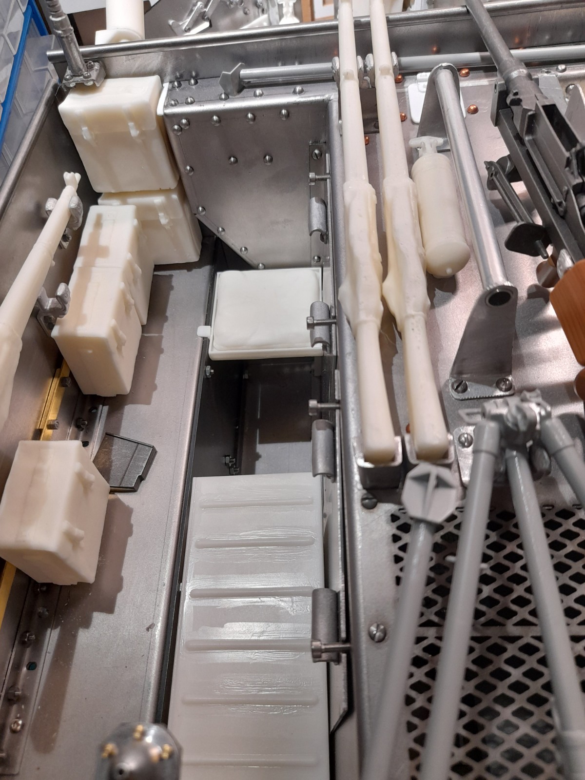

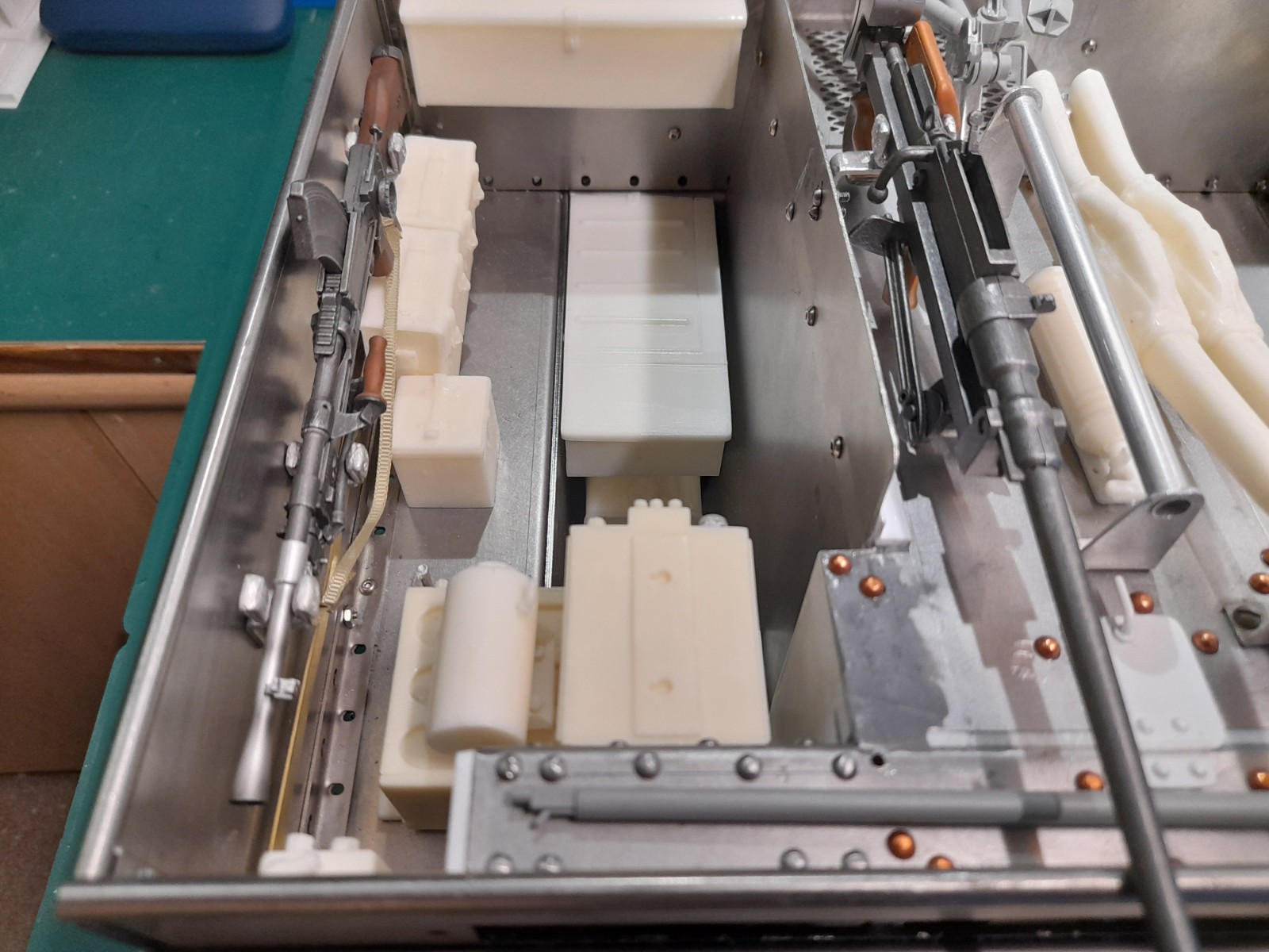

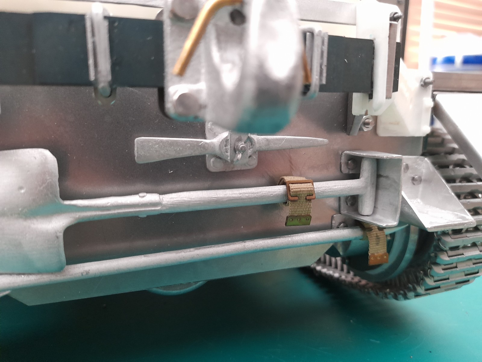

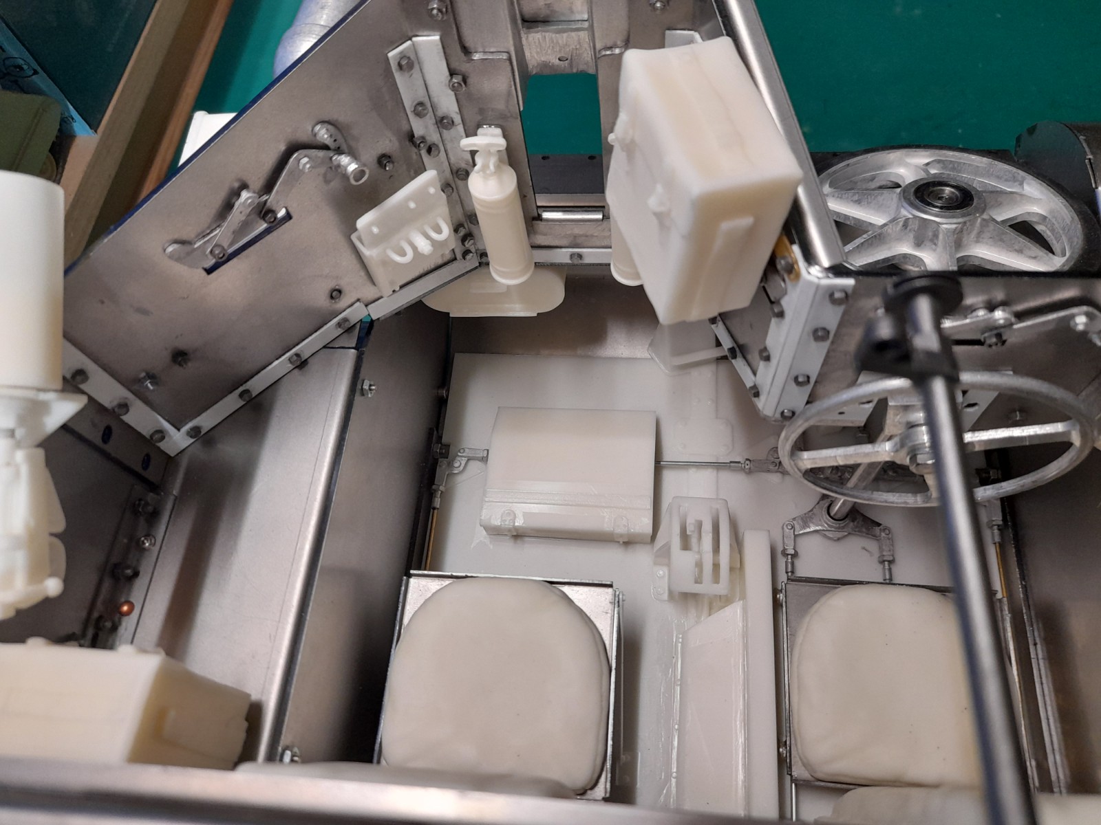

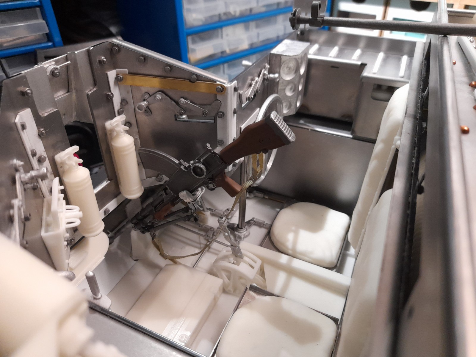

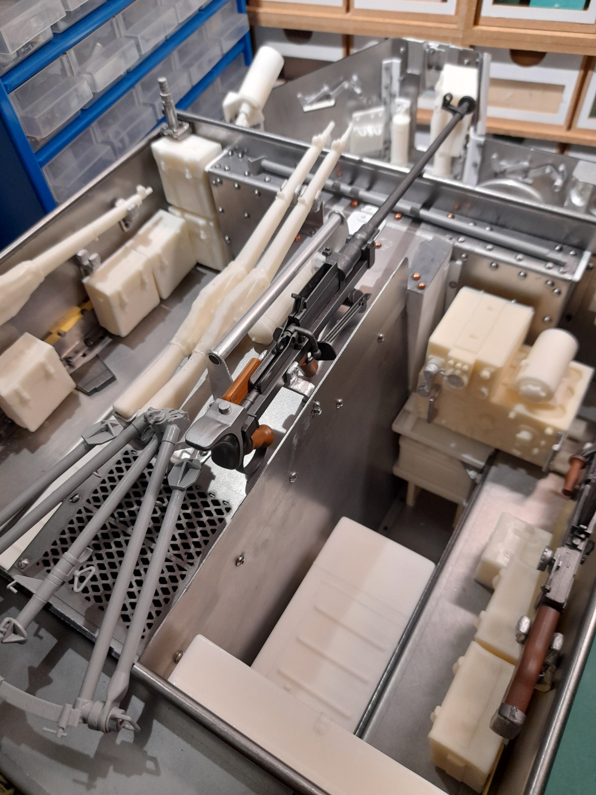

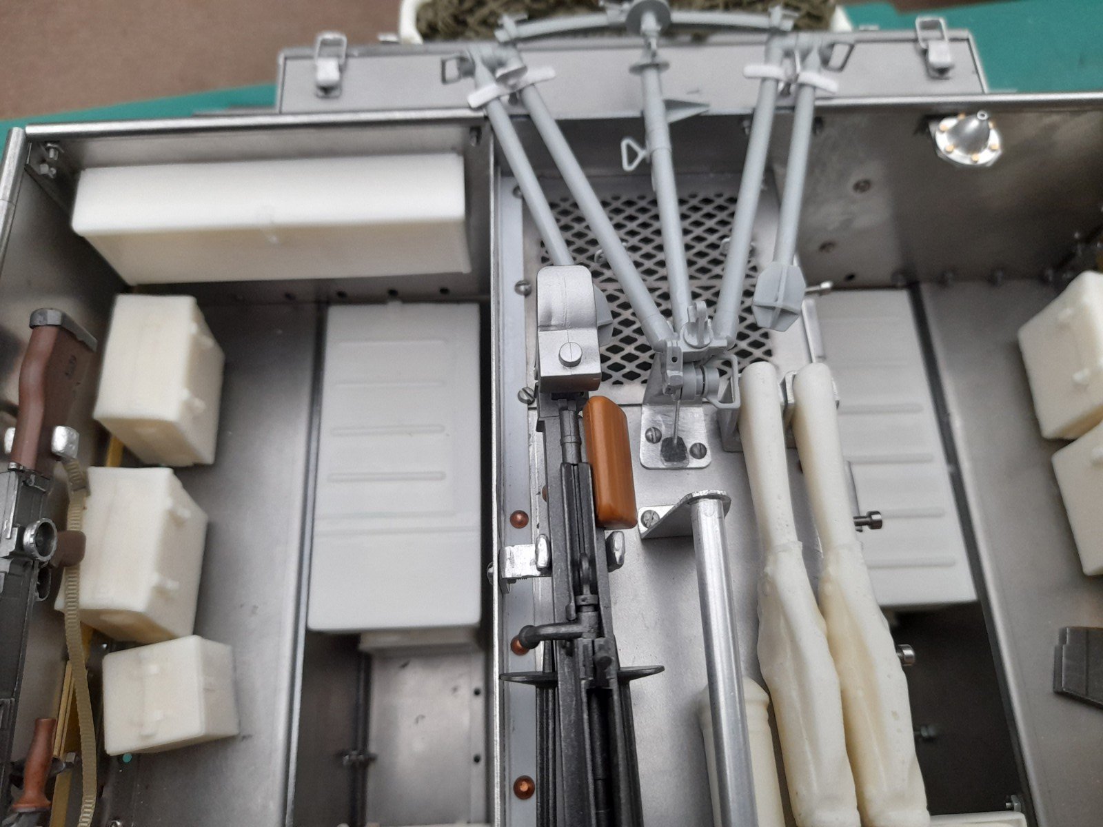

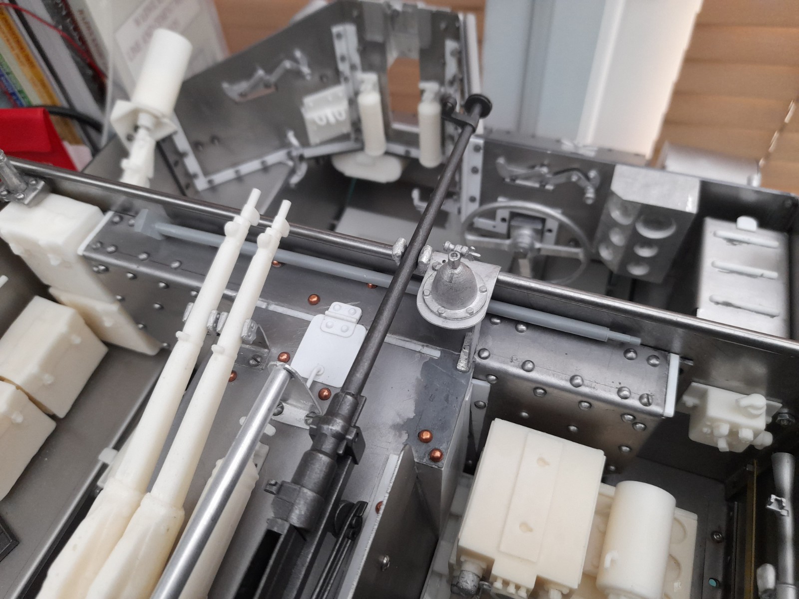

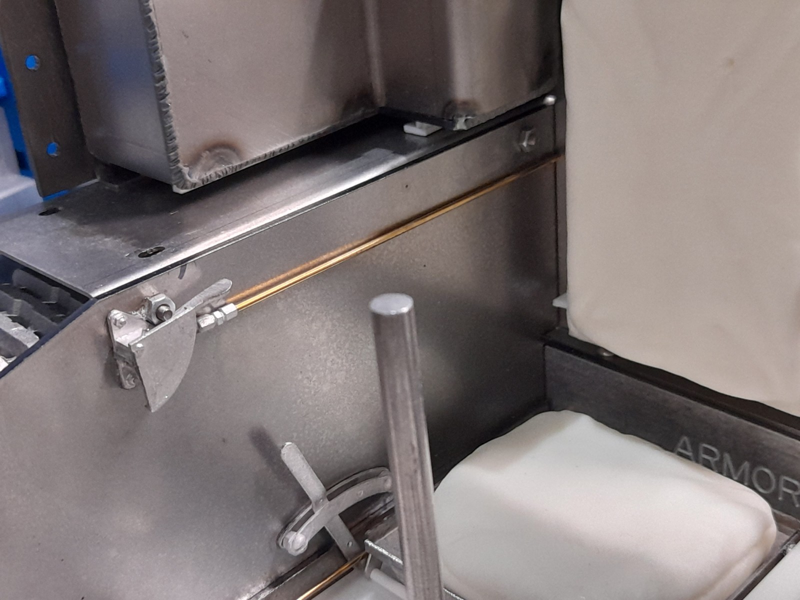

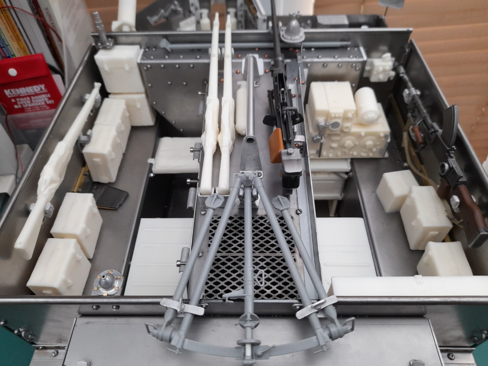

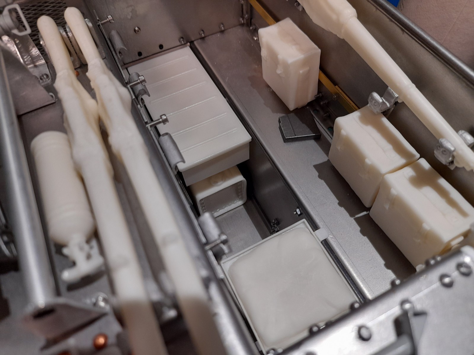

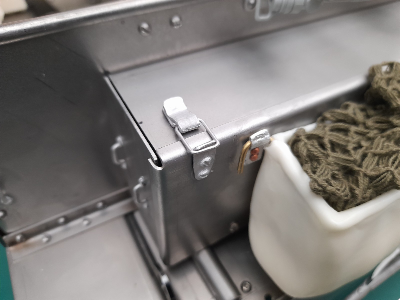

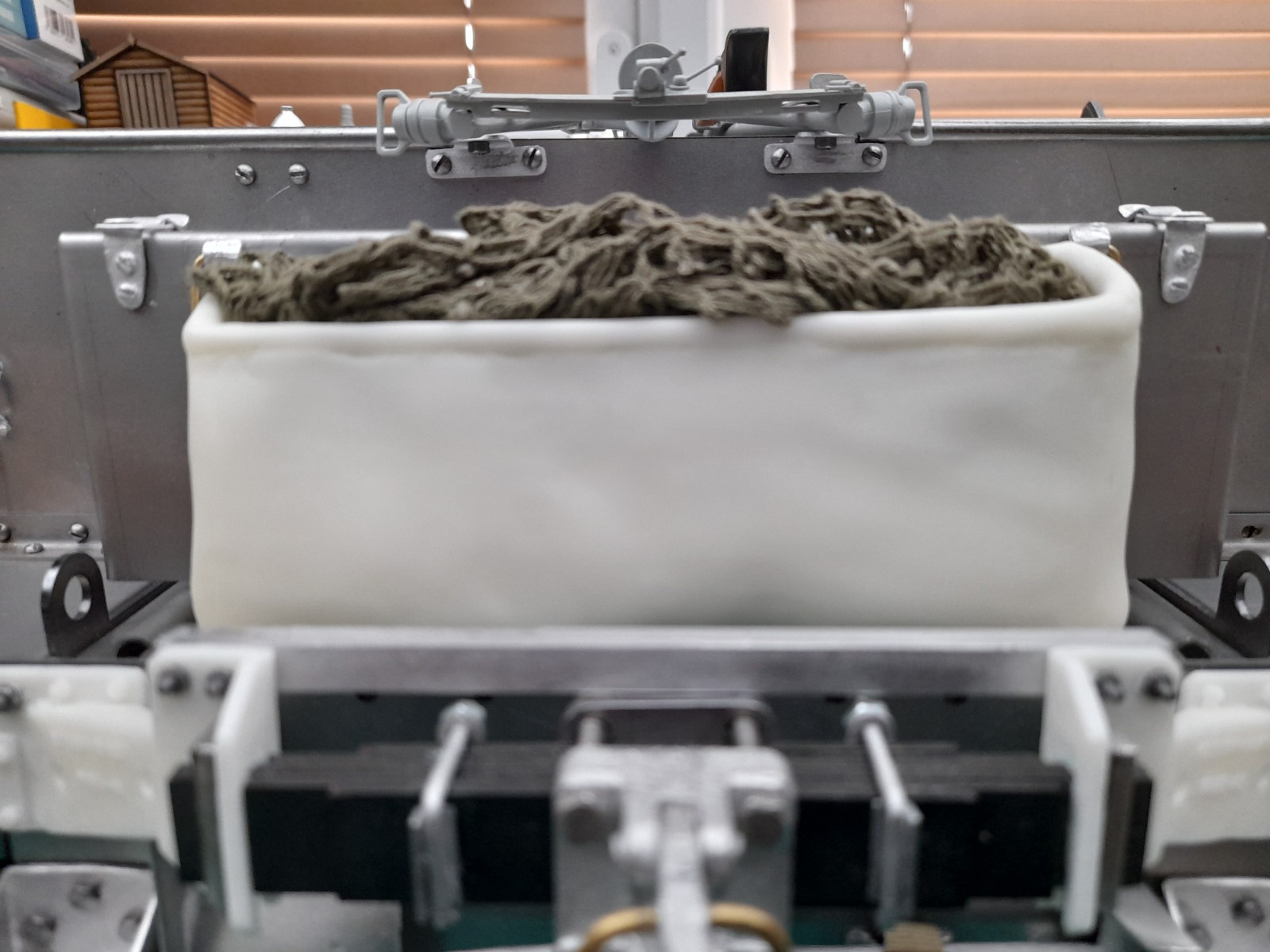

I have been casting all weekend so not got many of the new parts fitted to the Carrier. Here is what I have managed to add.

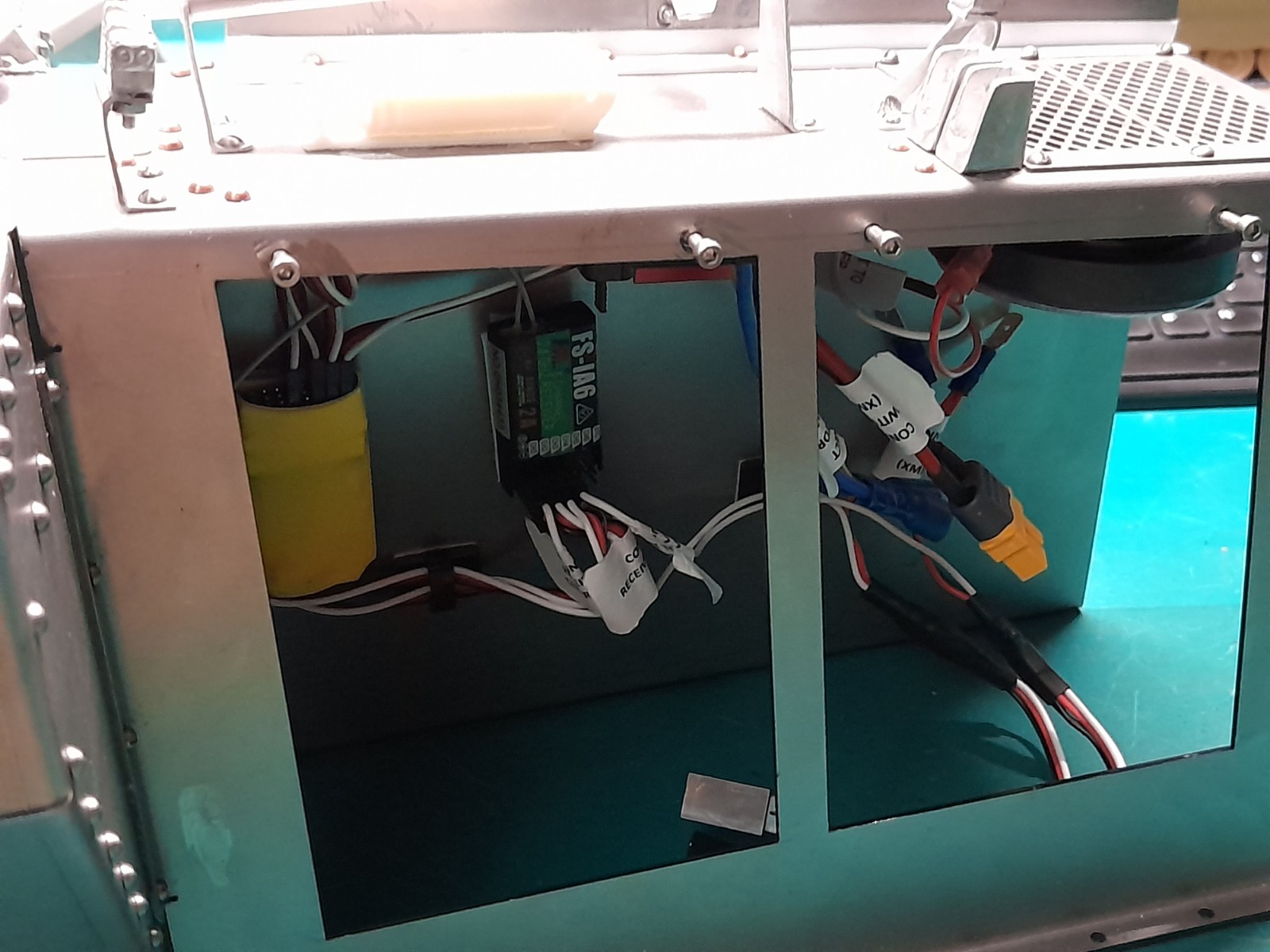

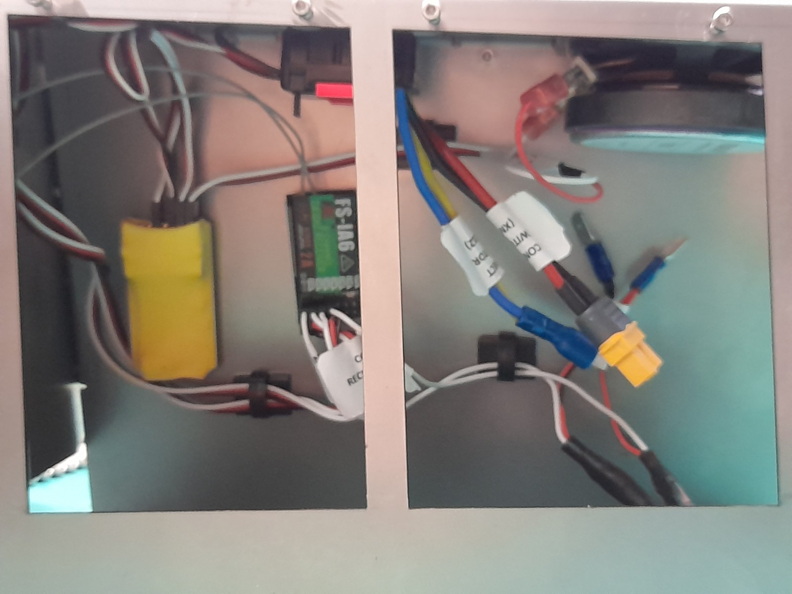

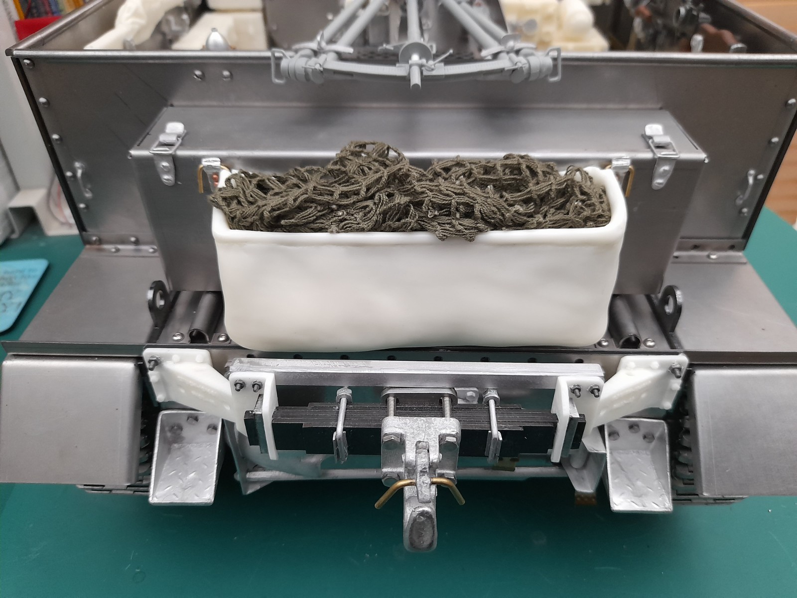

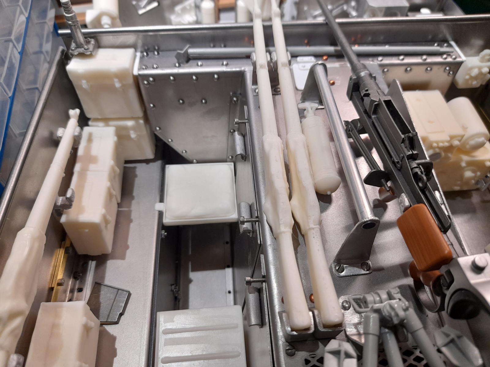

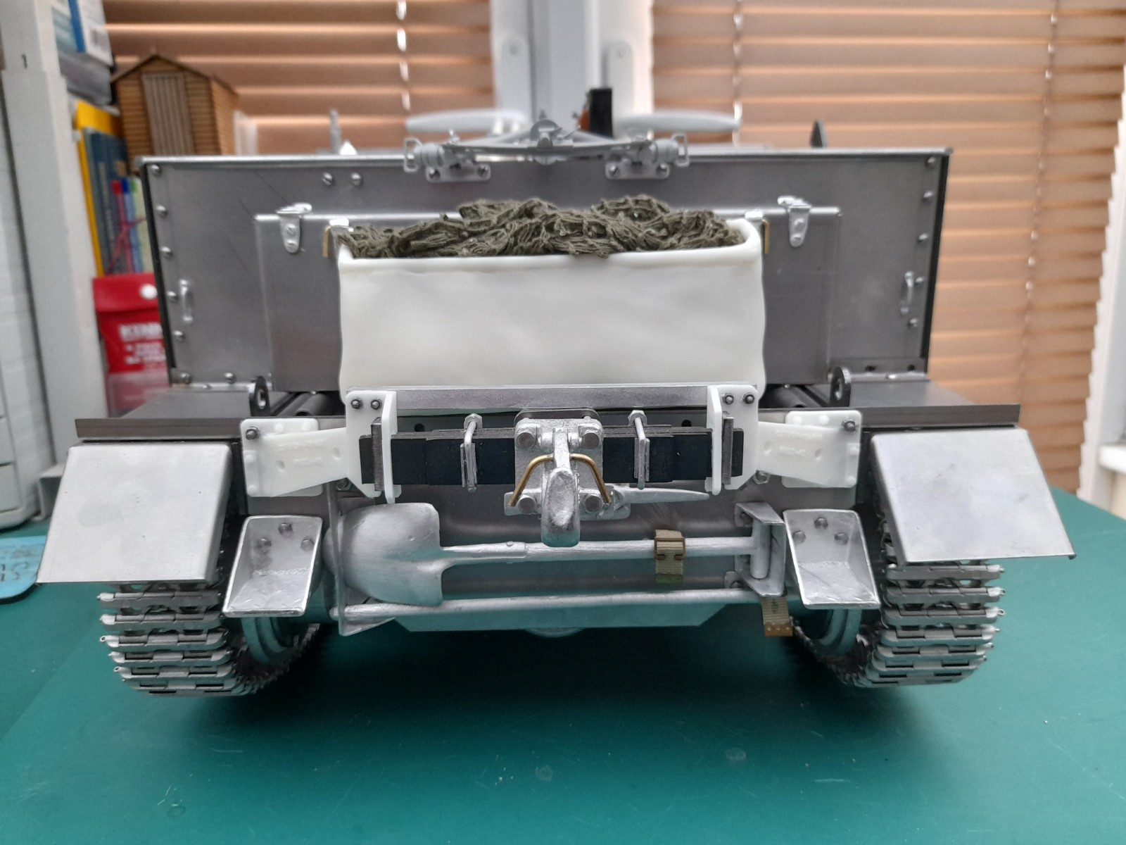

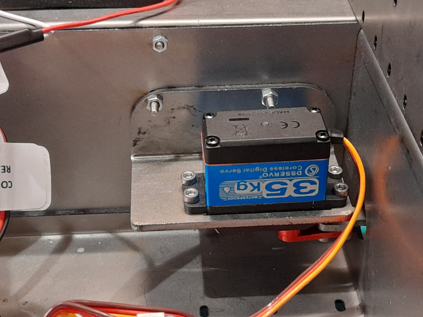

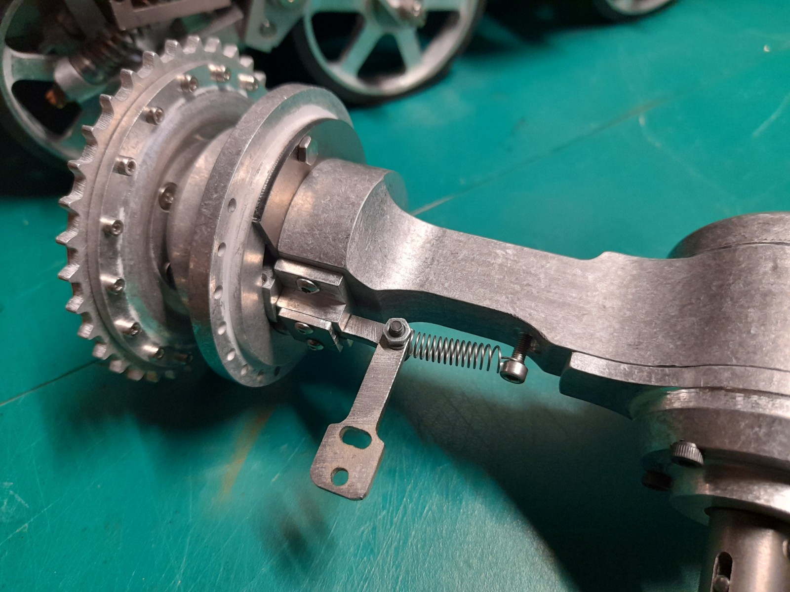

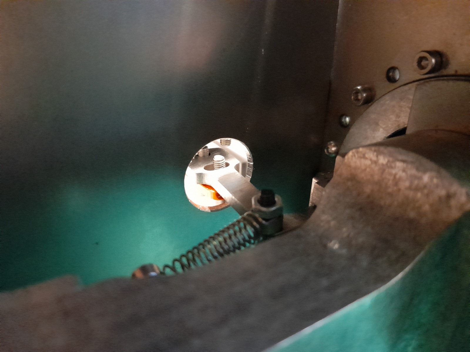

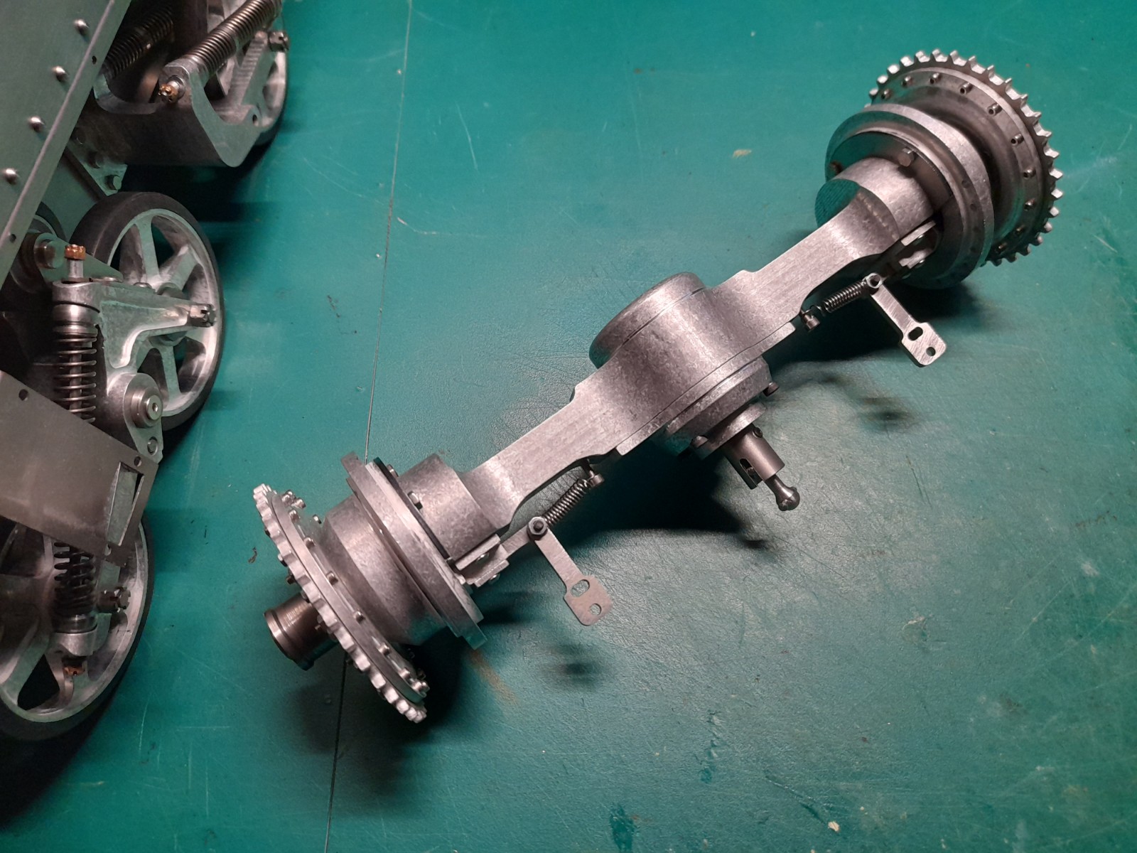

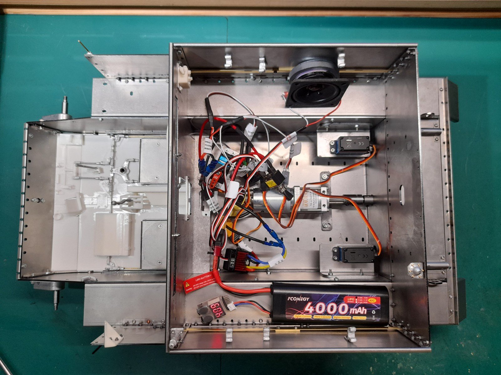

While waiting for more resin stocks I have managed a couple of evenings back on the carrier. Got the rear axle done, motion pack bench tested and installed. Ready for some track trials this weekend before I start fitting detail parts permanently and putting all the missing fixings in I skimped to get the body together quickly
With some of the issues raised on the forum I have made sure everthing slid smoothly with rounded edges etc. I also eased the edge of the axle housing and the outer edge of the brake pad so there were no square edges to catch. I am not sure for the instruction pics if the servo arm cap heads should have nuts fitted but as they screw into the arm I have just used them as pins and it all seems to work OK. Quick video below.

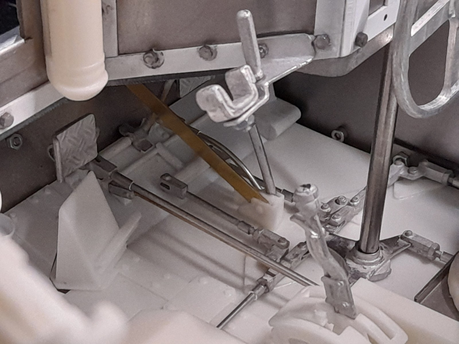

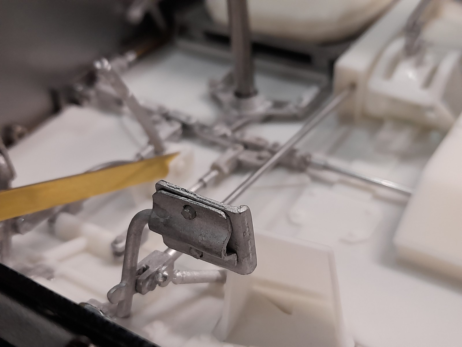

I have also now glued in the floor plates and added the rest of the detail to them.

Ran it this afternoon and all seems Ok but do need to take a couple of links out as tracks too slack. The brakes have stuck a couple of times but I just flick the brake off the other way. They seemed better after a bit of running so think they will bed in. Track slew is working and have on the throttle stick for fine control when driving straight. Only issue I am having is with the sound and the Flysky FS-16 transmitter. I have watched a number of YouTube vids on setting them up as the instructions leave quite a few significant gaps but do not have the aux setup option in the menu they all show? I currently have the sound running on the 4th stick channel which is a pain as often turn it off when braking and then it seems to lose connection till I turn everything off and back on again. Any RC experts out there got any ideas?
