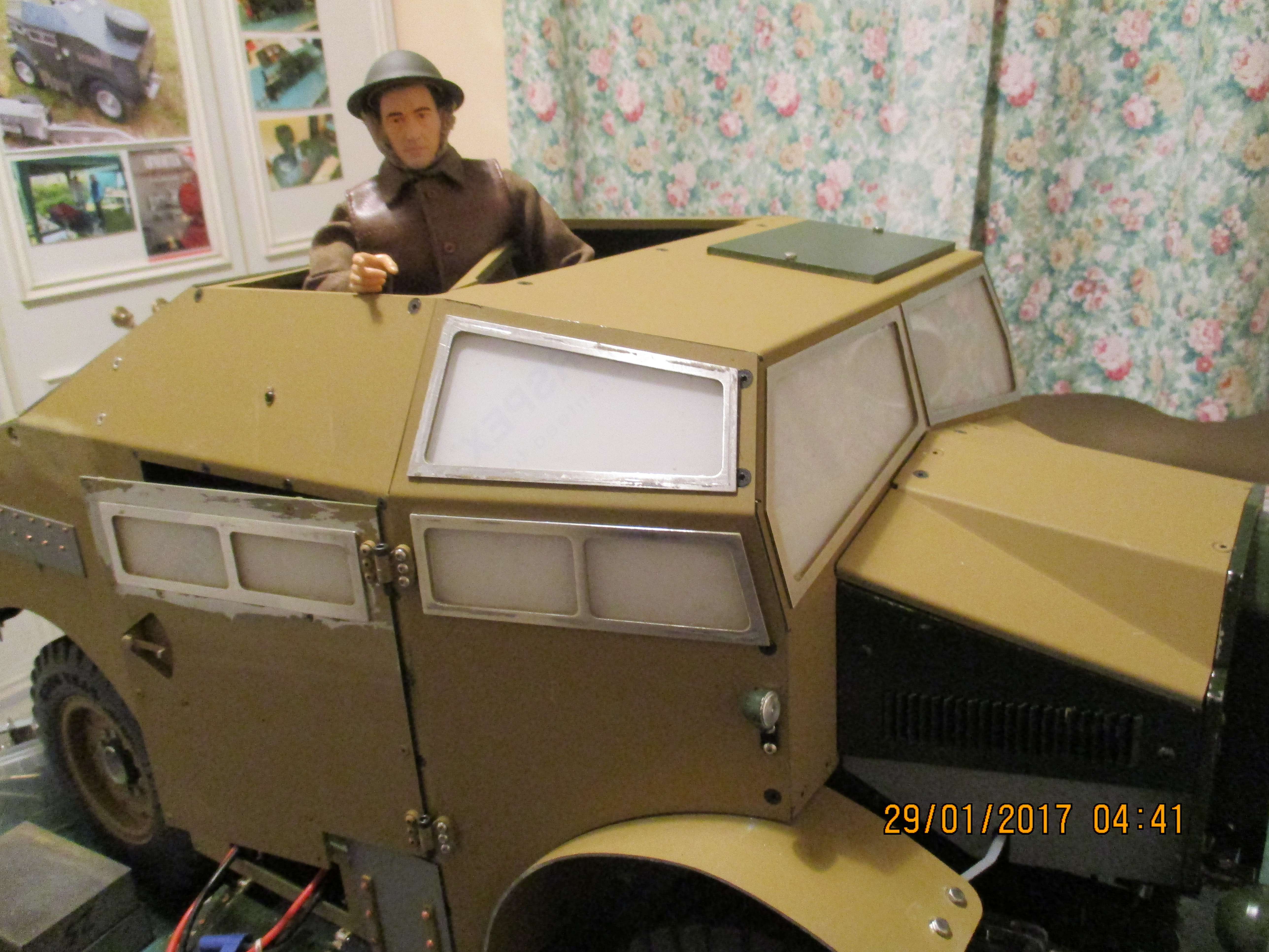

Hello everyone, a few domestic issues at the moment....managed to sneak into the workshop and fit the Quads windows....would you believe I managed to fit the first two window frames back to front....which of course did not look right. So, had a gander at the manual...and reversed them before the Araldite had set...phew :oops:

I know these photo's all look the same....I blame it on the tiny, tiny workshop, and guess what, a salty tear just dropped on my keyboard..... :cry:

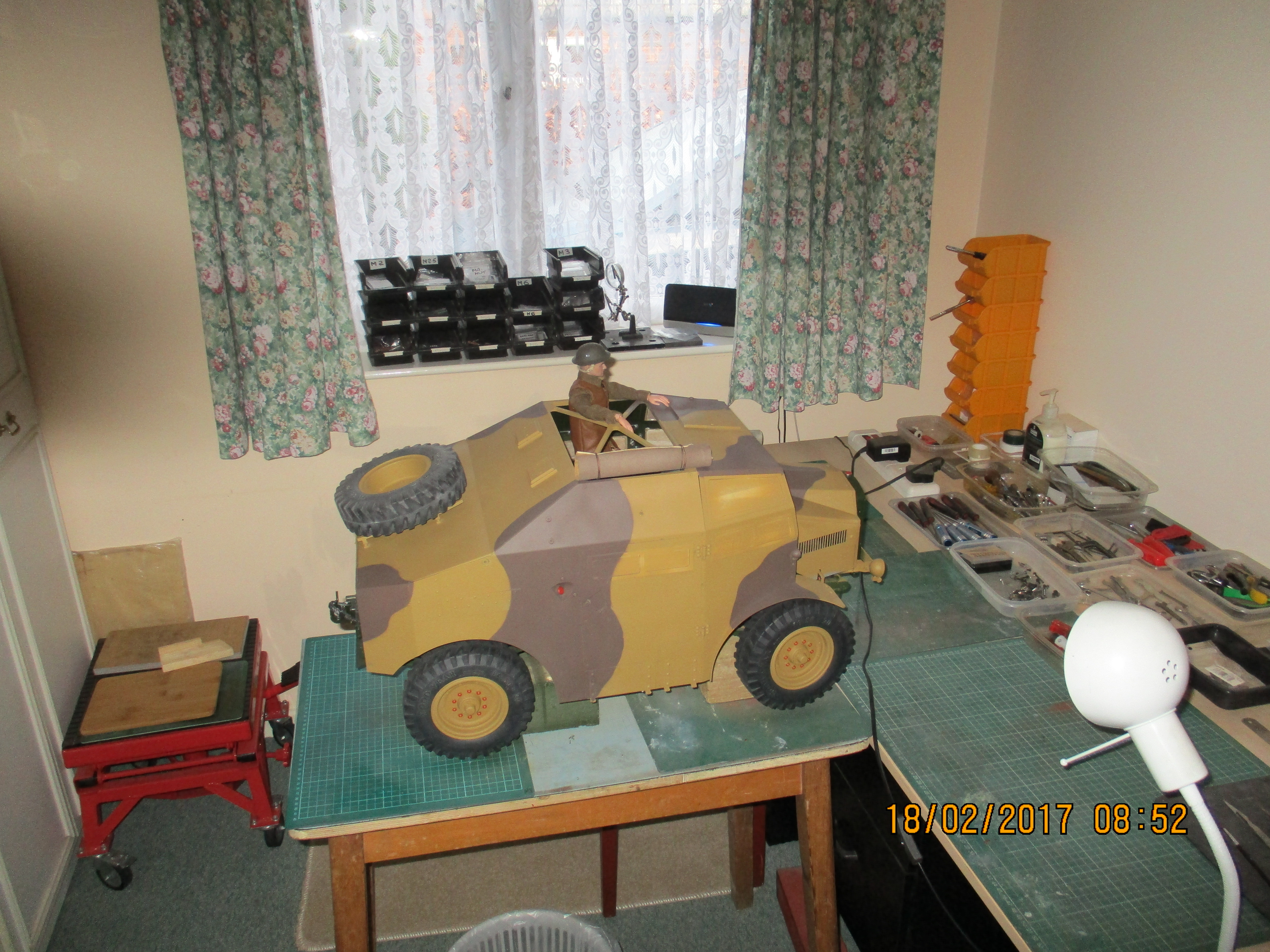

Hi Guys, :) made a start on the final paint camo finish. I have a set of 'decals' made up by Pyramid Models. The spray paint is applied in the dead of night, thereby avoiding a tongue wagging..... :roll:

The camo is applied using paper cut to shape....held down with 'bluetack'.....then spray painted with 400ml cans....Mick

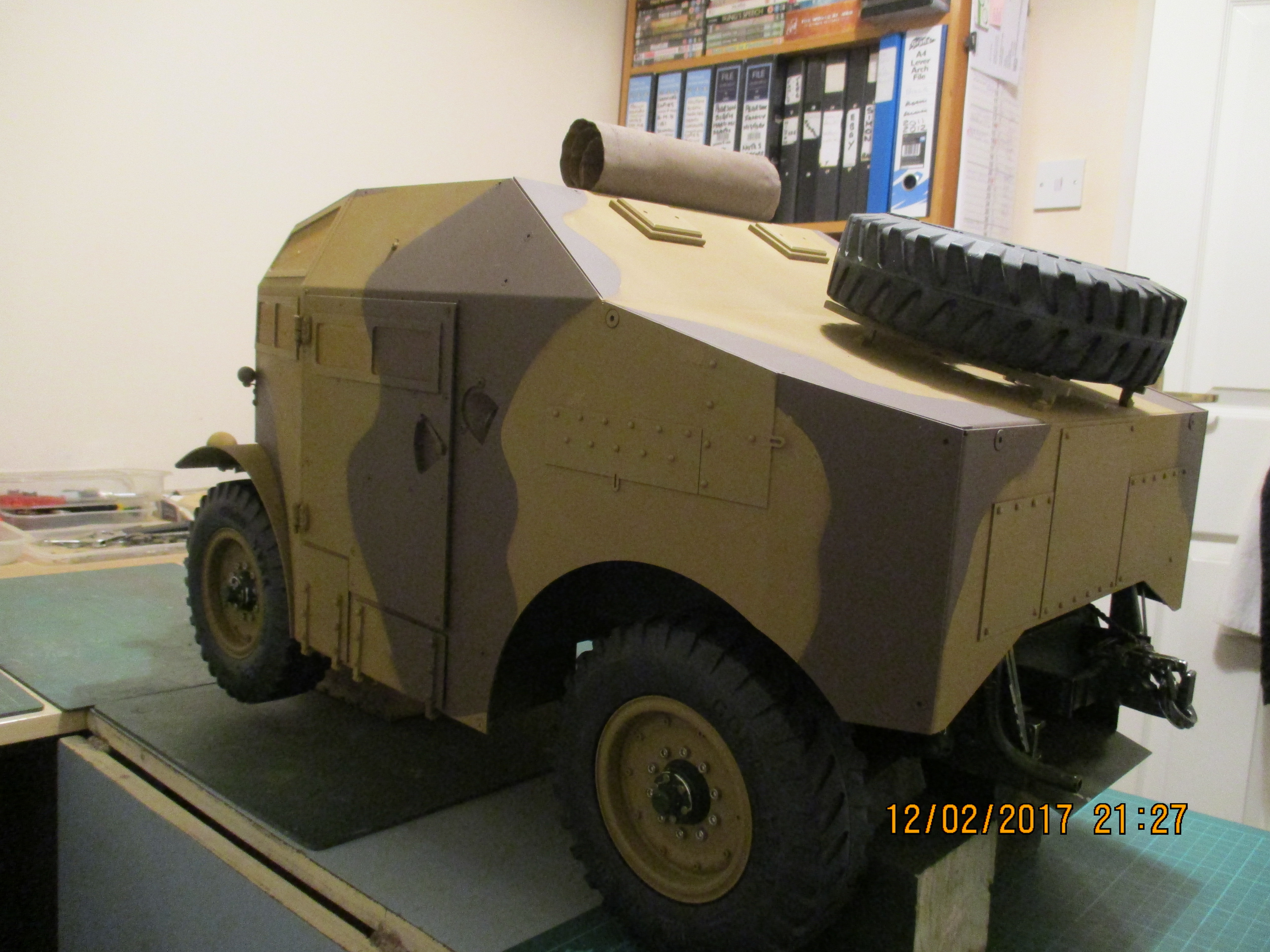

More progress over the weekend....it's a chunky little devil 8)

Nearly there, decals to apply etc,. This build was always a stop gap or filler until the next Armortek Tank. As always...a delight to build.....looking forward to following the many other 'Quad' builds, out there......Mick :D

Great paint job there Michael- really sets the model off. Have you used something to tone down the colours? If so care to share what you used?

Hello Peter, nothing very clever, I'm old school, using 400ml spray cans......light rub down with very fine emery cloth, this cuts the colour back. Go over with 'tack' cloth to remove any residue, then light spray with Citadel Purity Seal satin varnish. I will apply the decals, leave for 24hrs then a final coat of Citadel....Mick

Decals applied, that's about it for this build......all being well.....Mick
