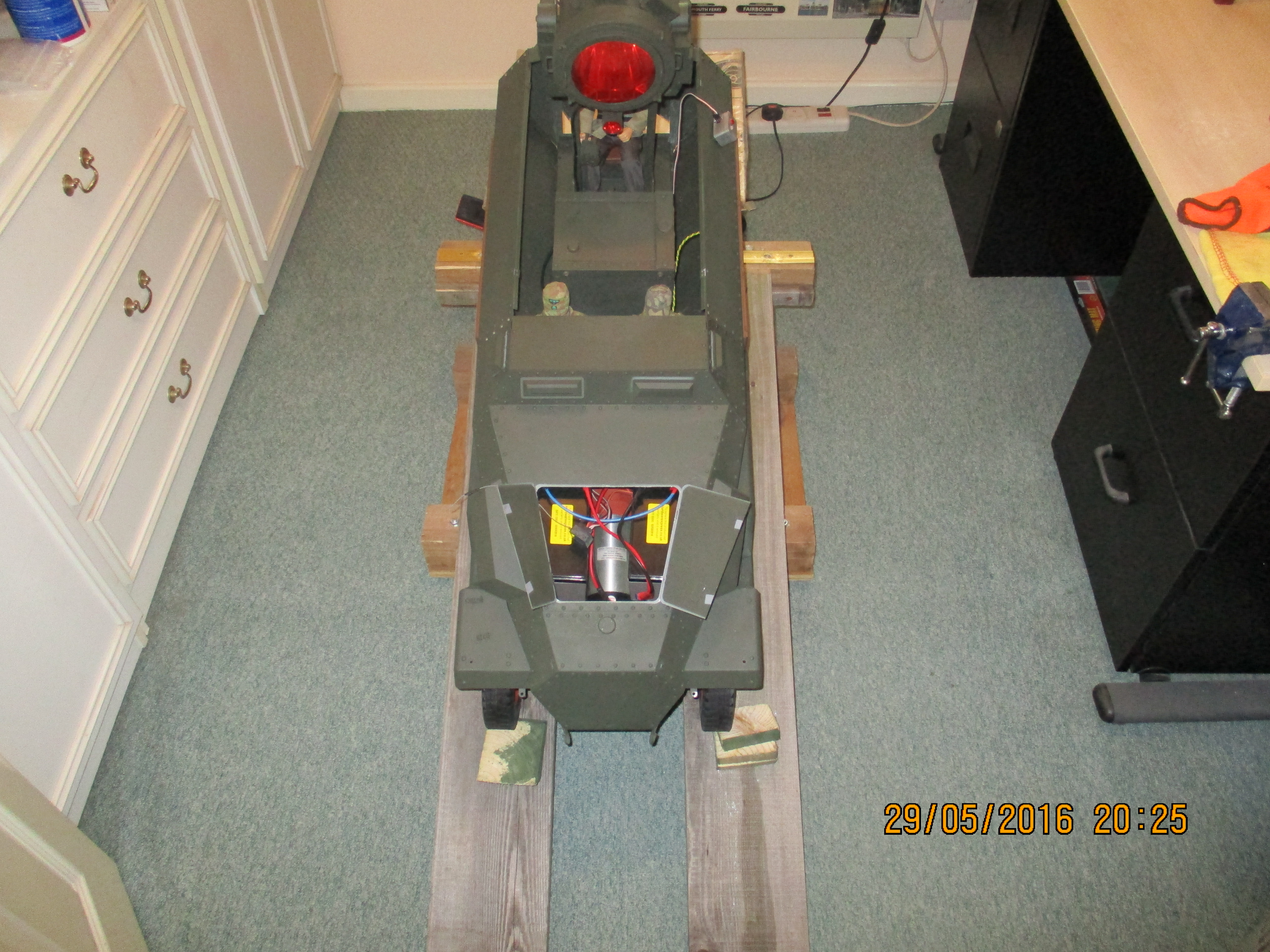

You can crimp a connector so its a very tight fit onto the terminal and then perhaps tape over to help secure. Can you turn the battery round so that if the wiring is disturbed the connector is not being pulled off. Alternatively you could drill through connector and terminal and secure with say a 2mm nut and bolt.
- Posts: 5133
- Has liked: 1490 times
- Been liked: 1697 times
Re: SdKfz 251 build
I certainly wouldn't solder to battery terminal as you don't know what the heat will be doing on the inside of the casing.
As Peter says, crushing the crimp connector slightly with a pair of pliers should make for a very tight fit. Don;t make it so tight as to damage the battery terminal when pushing it on.
Alternatively, you can buy sticky backed cable tie bases from Maplin:
http://www.maplin.co.uk/p/large-cable-t ... pack-sj15r
Attach one of these to the battery and cable tie the two battery leads to each other and the base. That should prevent all but the strongest tugs from removing the leads.

Alternatively re-consider your battery positioning and cable-routing so that there is some slack to absorb any vibration. If that is not possible, then extend the cables.
If you are having to put the cable under tension to get the spade connector on, then something is definitely wrong.
I would also only "crush" the connector as a temporary get-you-home fix. If it is not a secure fit on the spade then it should be replaced.

Hello and thank you for your replies, Peter Adrian and Mark. I have probably chosen the largest of batteries which means there is very little room at the front end.
I think the way forward will be to fit small nuts and bolts, as suggested. There are holes in the battery terminals. Thanks again lads.....Mick

Great build by the way Michael. One thing to bear in mind when using these standard 6.2 mm connectors is that quality varies considerably and sometimes they can be a very loose fit. There is nothing wrong with tweaking them to provide a tight fit - it isn't a bodge or get you home fix, merely expedient especially in hard to reach places (especially the connector underneath the motor on a KT
)Learning from experience I tend to test every one that I fit now.

Hello Peter, I have 'pinched' the connectors with pliers, these are now a tighter fit. I have also bound each connection with insulation tape, I think this will solve the problem. The batteries I purchased are a tight fit, leaving little room to manoeuvre. Thank you for your advice.

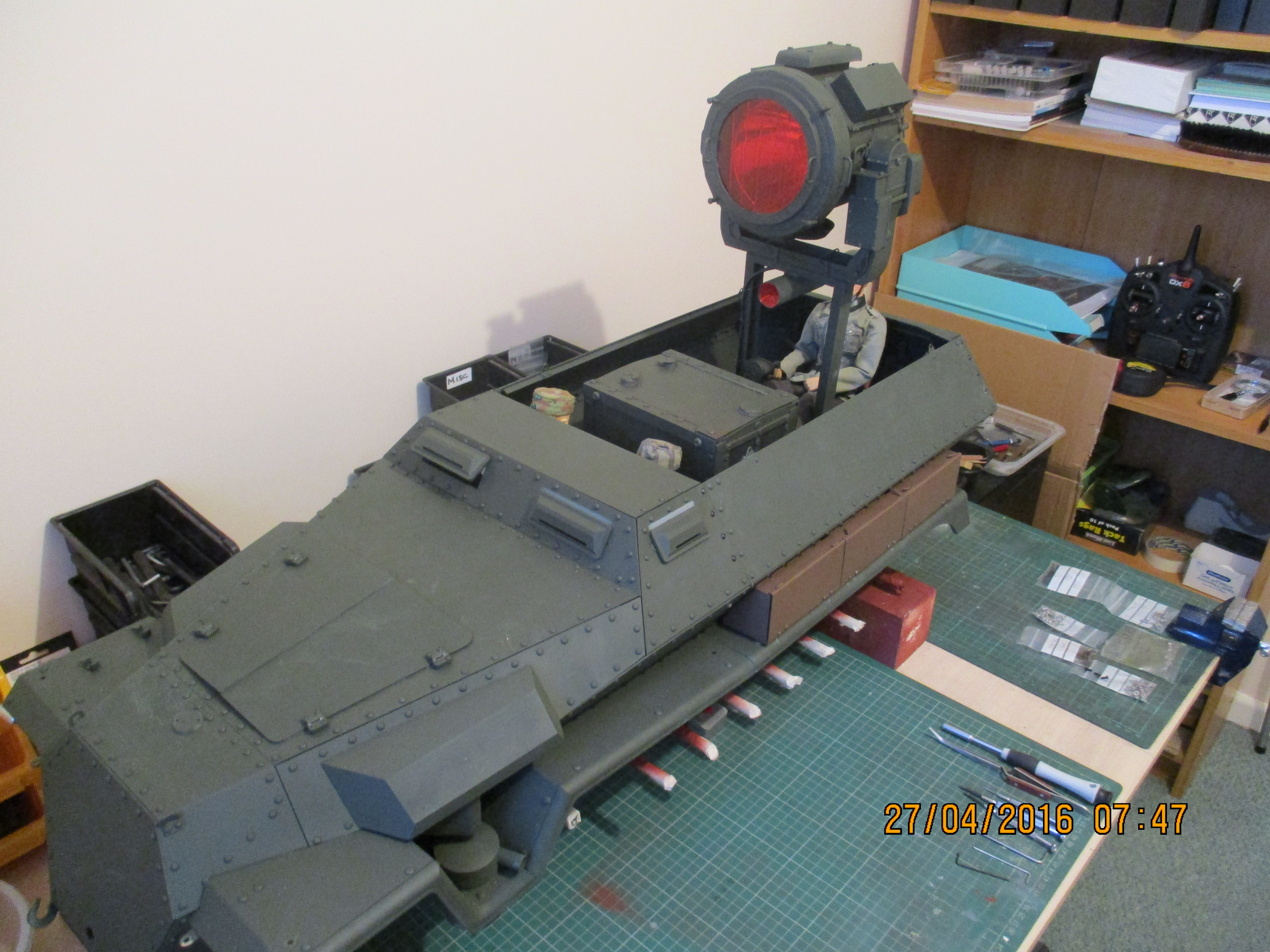

I have fitted the other side panel. I had some concern, as in the instructions these panels should be fitted loosely together, at first. No problem, the panel slid in place and I was able to locate the bolts easily, testament to the Armortek build quality......Mick

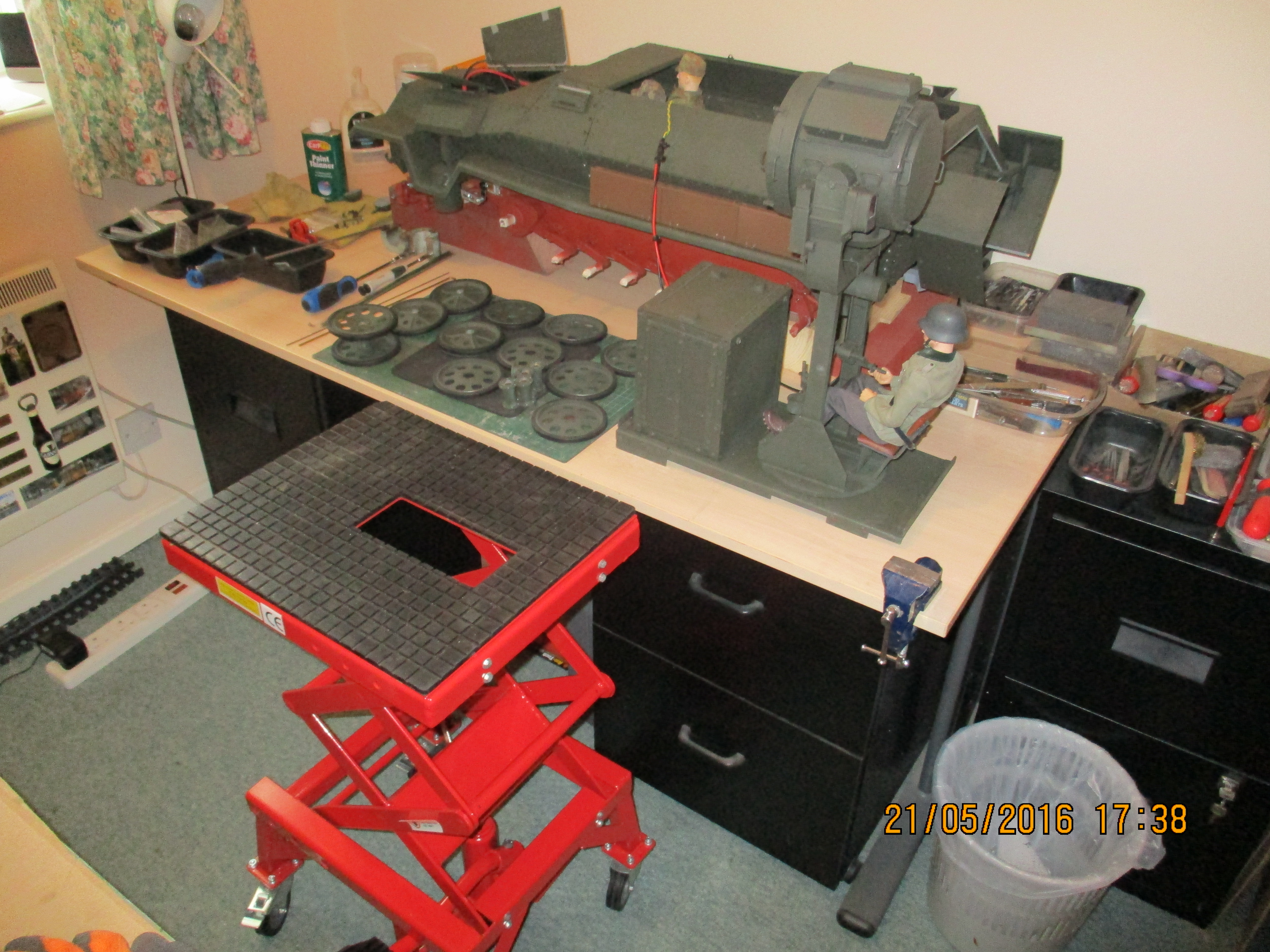

I thought I could manage the weight of the 251, how wrong I was so, I purchased a small motorcycle lift, to assist in lowering the 251 to the floor, useful addition and only a fraction of the size of a table lift......Mick

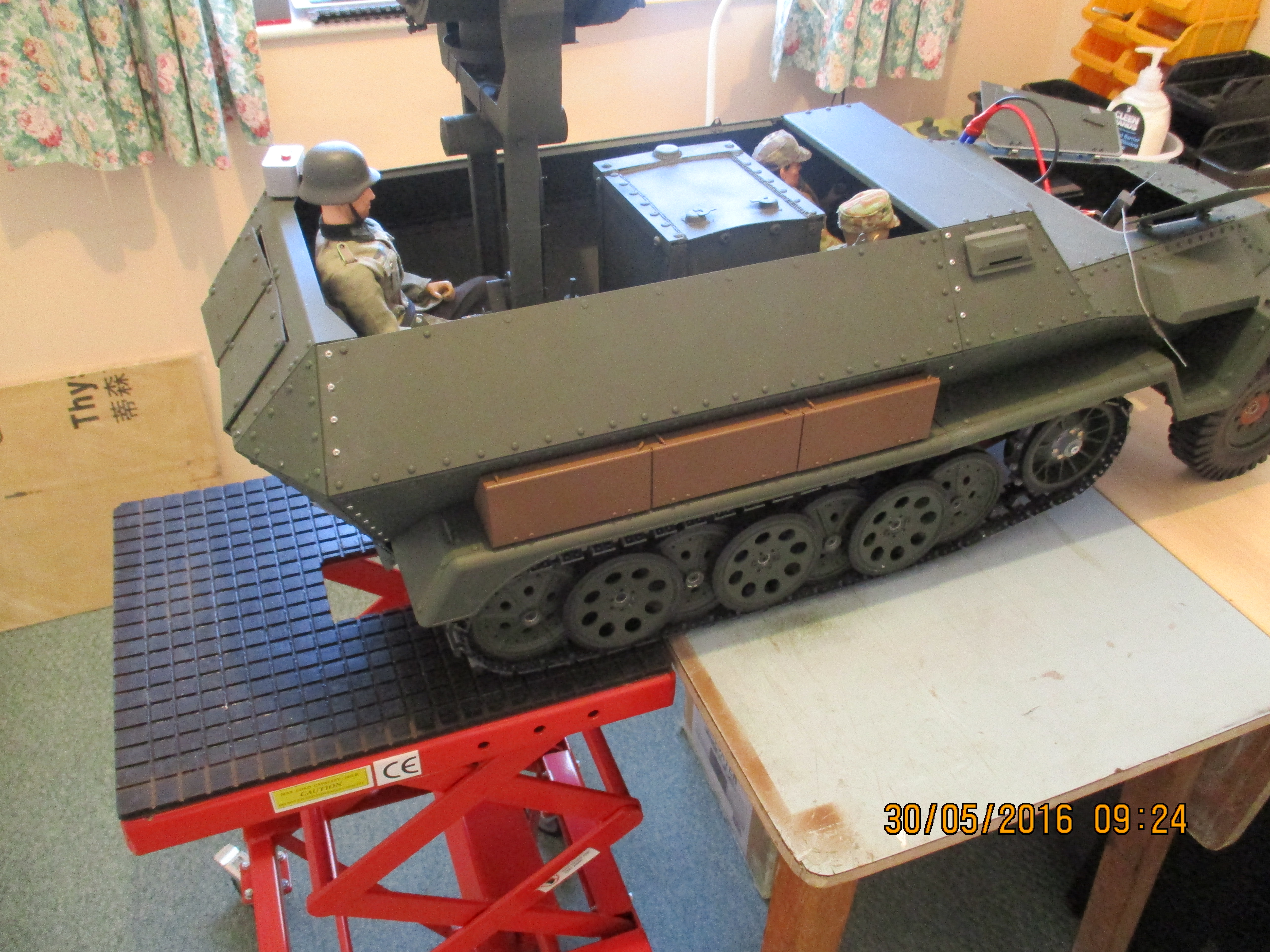

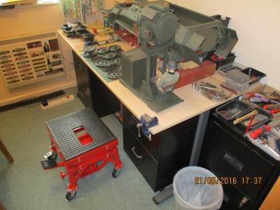

First set of wheels fitted, straight forward assembly. It takes a while to programme ones mind and pick up where I left off. I fitted the wheel covers first, then realised that the wheel is firstly secured to the axle....lots of M3x5s to be removed...
The track fitting is a doddle.......

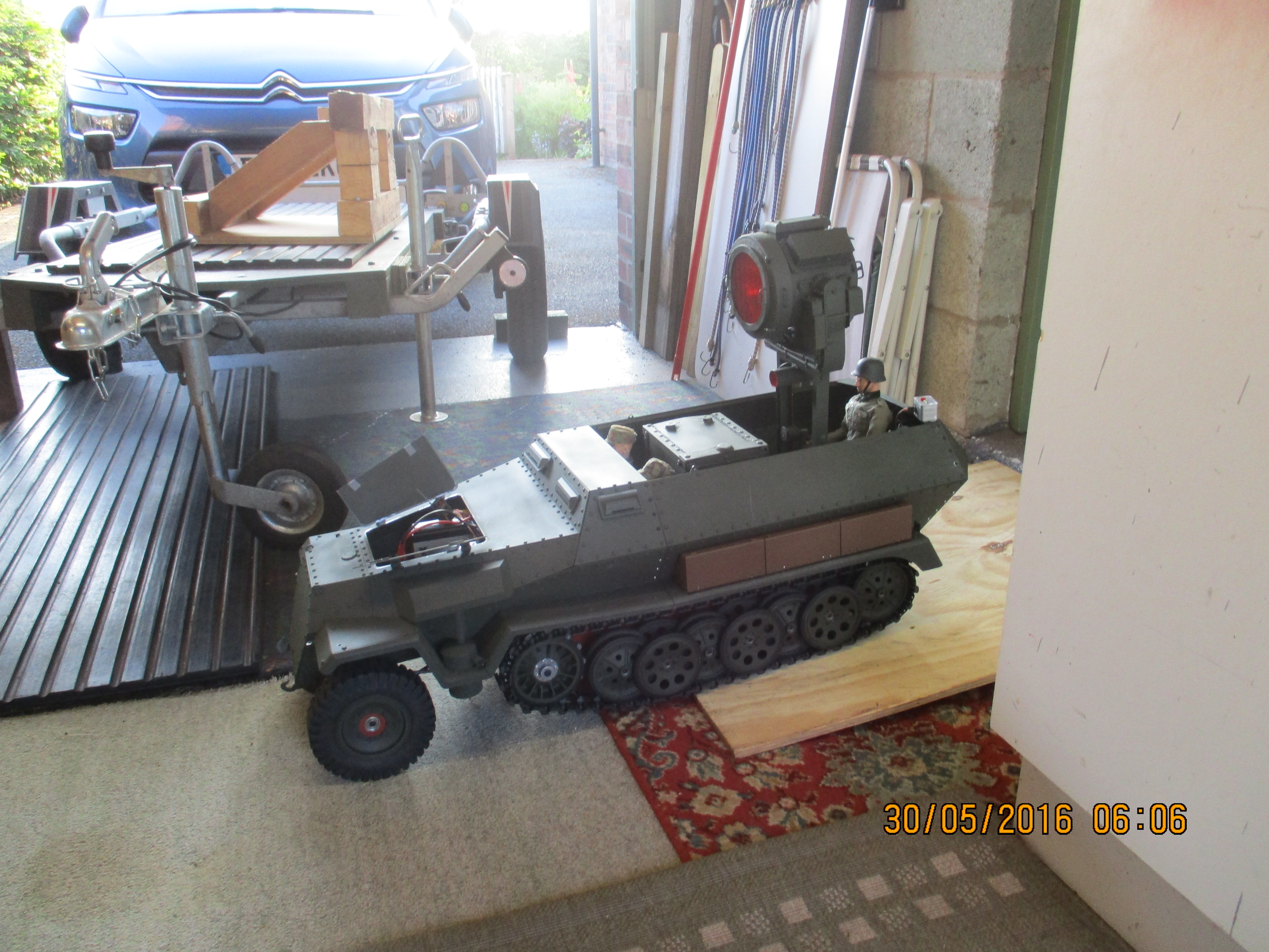

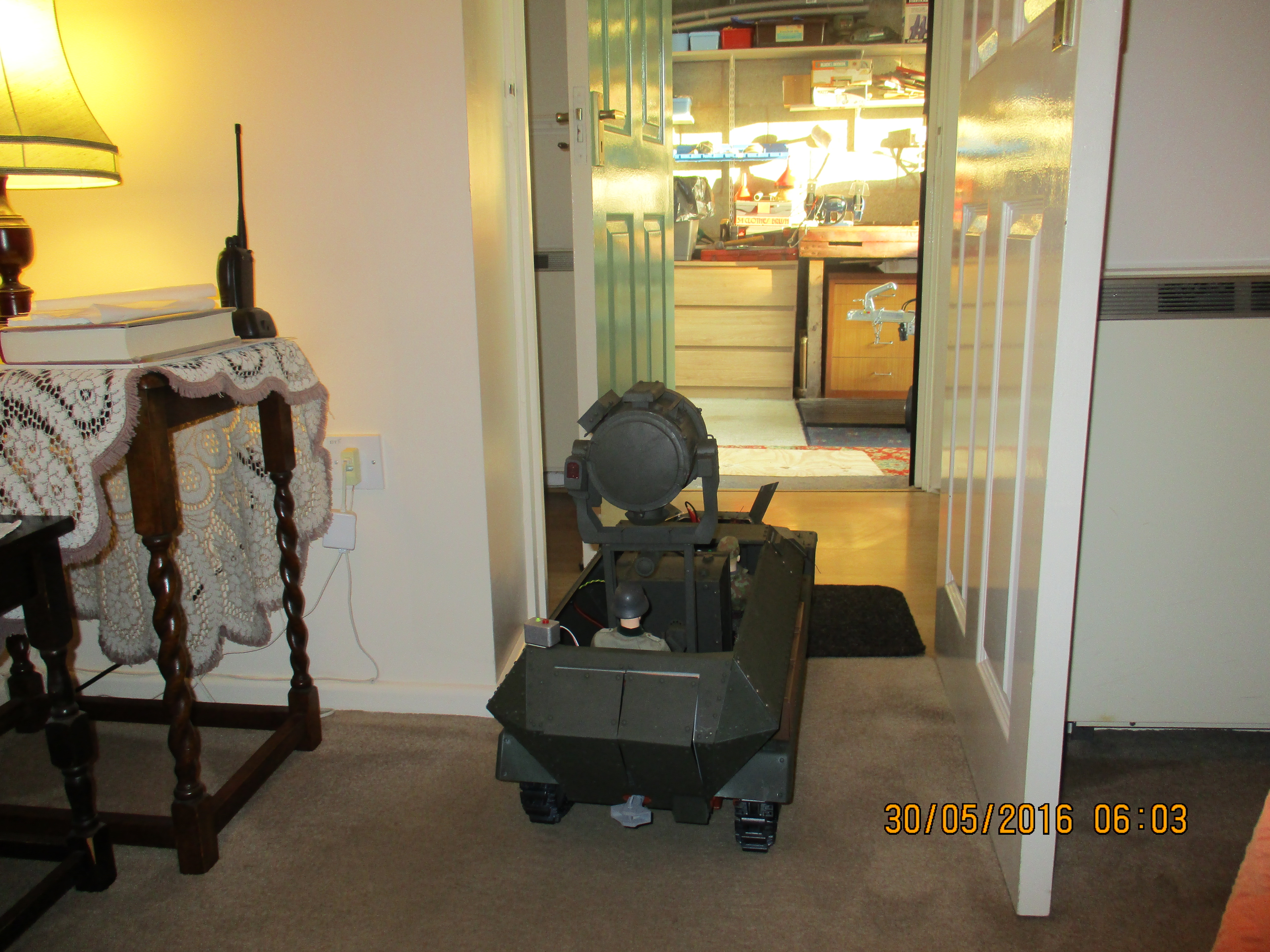

Following a relaxing day at Porthmadog, Monday was designated SdKfz on test..... 251 Day 1, objective, move the 251 to ground floor level, and test run.....
One hour later the 251 is now back on the workbench....steering needs adjustment.....otherwise well satisfied, later treat ourselves to lunch.
