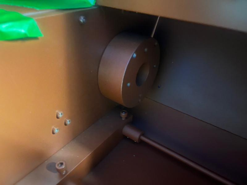

Hi Neil I'm not sure about the cap head bolts for the front mud guard hinges I can't remember what I did . I think they where bolted from
underneath and the thread was flush at the top other wise the guards won't pivot up . Dale

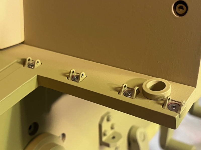

Thanks Dale, excellent pick up.... I needed 8 bolts and saw 8 that different from the rest.....wrong of course. Instructions say CSK and not CAP.
All fixed now

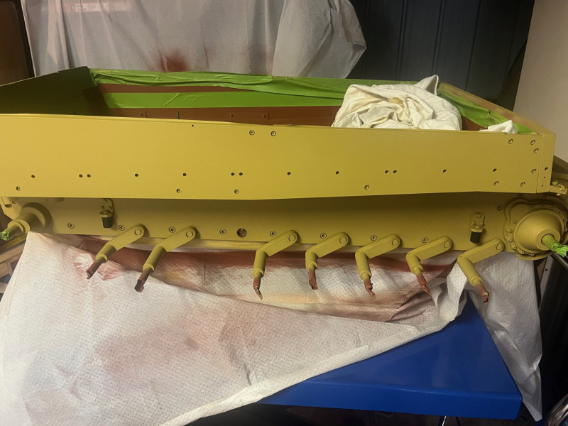

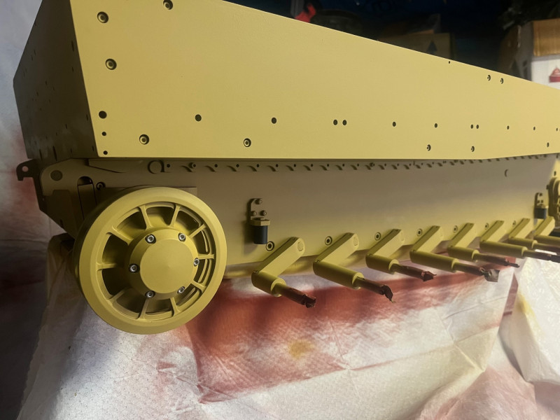

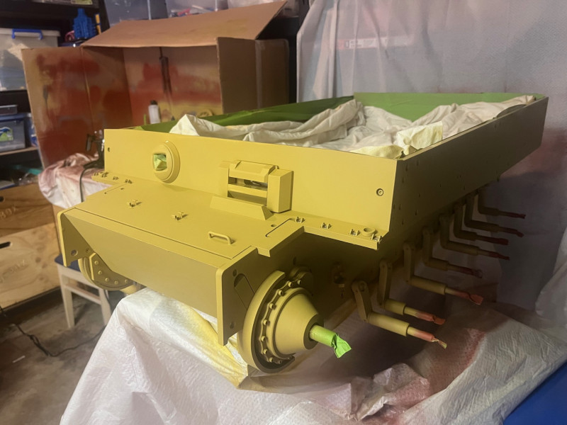

Finished the matt varnishing of most of the lower hull
This meant I could attach the idler arms

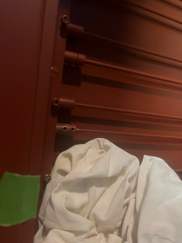

...and reallign all the suspension arms to 30 degrees. However, there was one that would not sit on the torsion bar. So I replaced the grubs....but it still wobbled a good 10 degrees. I was about to drill small holes in the torsion rod so the grubs could sit in them, but with the drill in hand I decided to switch the torsion rod around.....and this did the trick!
I intend to wait until my steel tracks arrive and I build them before I attach the drive sprockets & wheels, simply so that they all align.
Next job is probably to do all the rear plate detail

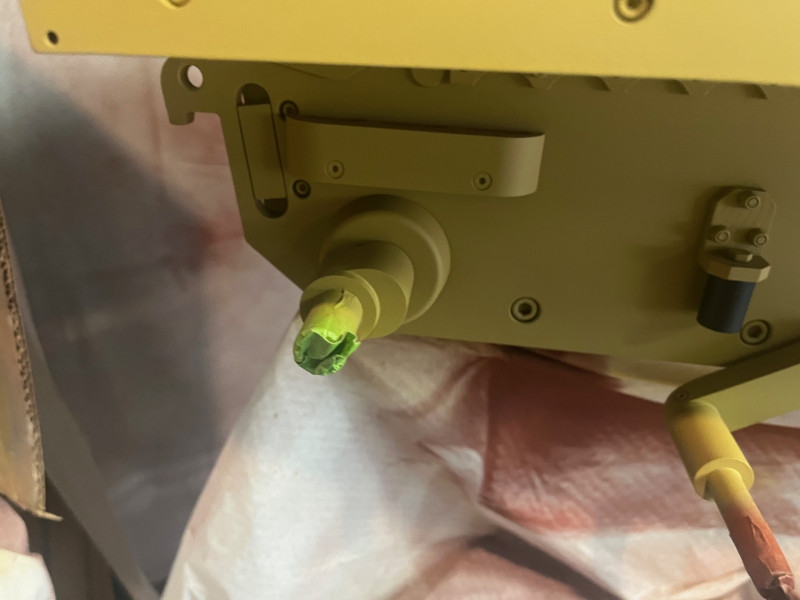

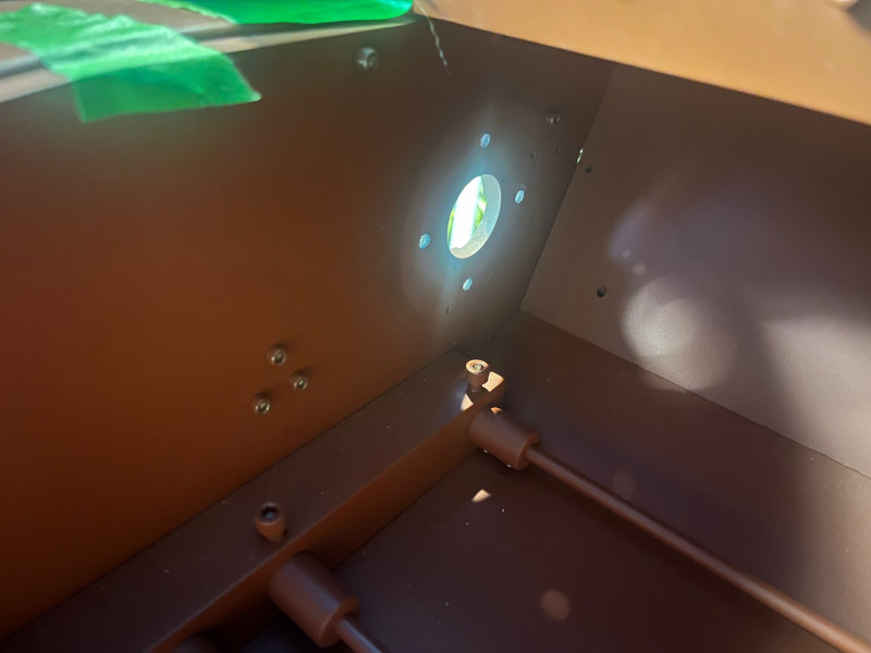

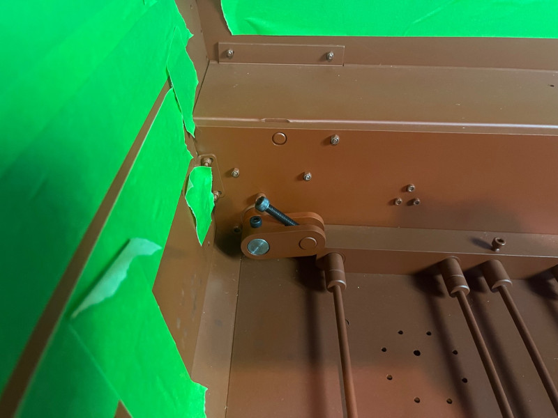

Got the idler wheels on with caps Something I realised last week when I was aligning the suspension arms..... I could not access the locking bolt on top of the fixed ends as the left drive mount was in place....and I couldnt get the drive mount off without taking the drive sprocket off. First world problems I know, but its annoying when I have to spend time fixing obvious mistakes I should have noticed.
Even though the drive mount is on page 1 of the instructions, it would be obvious to anyone making a 2021 Tiger that it would have to come off when originally placing the arms, but my options pack & the mount only arrived recently. Oh well, at least I didnt have to break the whole tank down to tighten that single locking bolt

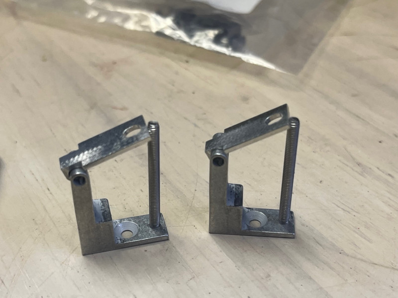

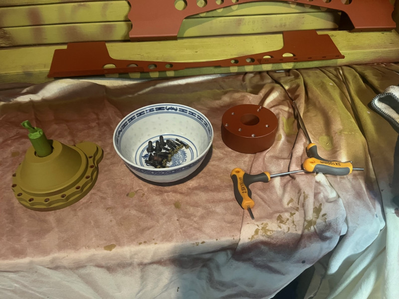

After putting all this back together I then moved onto preparing all of the rear plate detail parts. Filing parts with sharp edges and sanding/scratching all the other surfaces.
Will have to do something with these, though I don't know what yet, they clearly can't go on like this. I have a vice & a drill, wish me luck!

IMHO , in case of needing do it again in the future. Cut off necessary material of that LHS motor mount above this M6 cap screw , or simply to replace it with M6 hex head screw , before re-installing the LHS drive motor. So next time a L-shape M6 Allen wrench or spanner is enough to lock / unlock it. Learnt this from many Tiger 1 builders.

Regarding the hard to get at allen bolt,simply replace it with a hex bolt,and save all the frustration
that's what i did

Thanks for the great suggestions guys, and the compliment Chang. I want it to look nice (and be reasonably safe from corrosion) even if I won't use any filler until the end and I know it runs
I did think about bending an allen key, but not cutting one...a metal saw is a likely addition to the tool kit. A new bolt is an obvious solution that I admit I didn't think about.
The slot was what I was hoping to cut with a drill bit. A bit scary for me as I am not a skilled metal guy by any stretch of the imagination.

Pick up a Dremel or similar small motor tool with a cutting wheel. Makes short work of slotting those clamp plates and does so pretty safely and easily. And I am no metal worker either

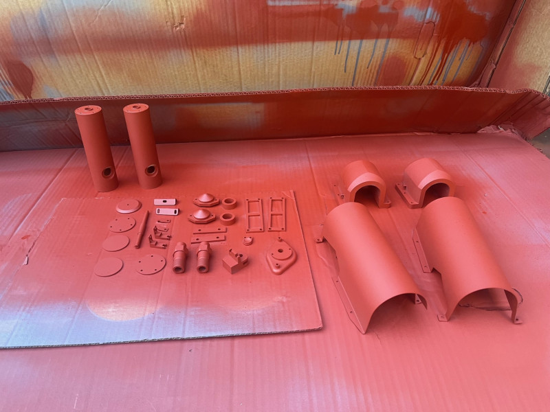

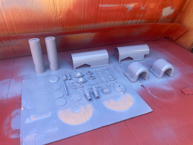

Did manage to sand all the remaining rear armour detail pieces and then get them coated (both sides!) with the etch primer & the red oxide primer. Will research the correct colours for each....up until now I could just paint everything in dunkelgelb,with the only exception being the machine gun barrel. I have rust effects and soot for the main exhaust parts....not sure on the rest yet. The internet awaits!

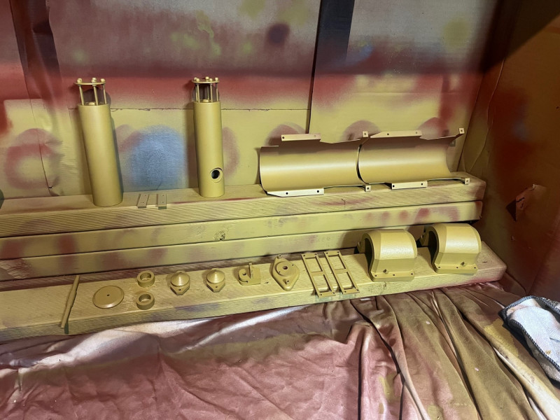

Re: Neil's early Tiger 1 (2023)
Spent last weekend doing more work to the shed...and getting yet more shelf rack space. It looks awesome, I have room for an entire tank in standard boxes
Started painting all the rear plate detail items..... long way to go of course, a lot of angles & coats to do
