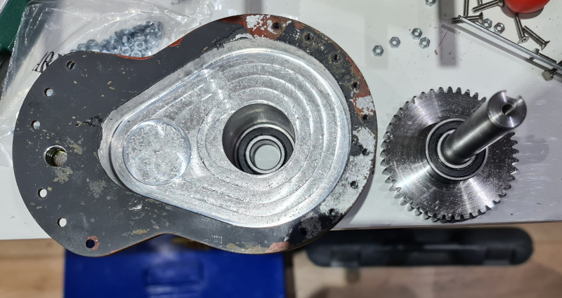

Hi,
I have fitted the sproket to the drive shaft and secured via taper lock bush, on my Panther G.
Setting the distance between the hull and inner face of sproket at the recommened 34mm, (with the drive shaft pulled out). There is some play on the shaft and this leads to the drive gear moving and scraping the hull side.
Any ideas how to stop this would be appericated.
Peter

The instructions call for the bearings to be loctited to the drive gear shaft (CH0212) and to the drive case (CH1208). This would prevent any movement of the shaft.
Looking at your picture, the marks seem to be from just the teeth, probably a burr from the hobbing process.
Running a file around them and giving them a slight chamfer may be all that's needed.
