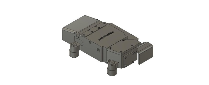

Finished the other side of the MRS.
Some more test printing next.

Very nice,, the only bit I can see that may need slight adjustment is the plate at the back end which should be below the level of the top plate.
Has liked: 794 times
Re: MRS 3D model
Steve do you mean the cover (marked with the arrow) has to be lower than the rest of the body? In that case by how much?
Thanks for the input.
Re: MRS 3D model
I see it now.
This better I guess.
Thanks again.

Steve Norris
Posts: 1231
Location: Manchester
Has liked: 8 times
Been liked: 701 times
Re: MRS 3D model
Post by Steve Norris »
Hi Vince
Looking better now.

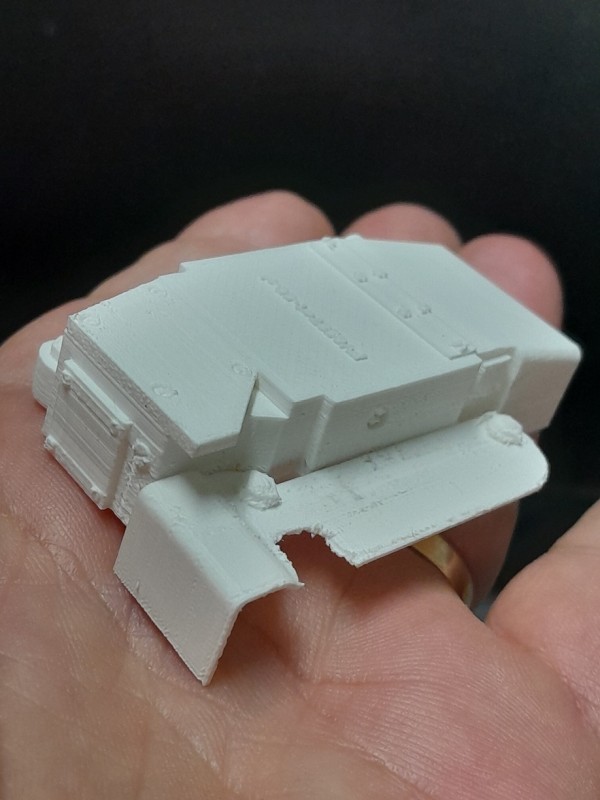

This is how today's print looks like. Did not bother with the spacers. The side cover was printed separately and glued to the main body.
Steve's modification is not shown here as I had already started the print. Maybe next time.
Today I found out that the top cover that Steve mentioned printed better in a vertical orientation.
Next, working on the front. As somebody said, "I have a clever plan". Let's see.
Steve Norris
Posts: 1231
Has liked: 8 times
Re: MRS 3D model
Vince,
That looks very good, a little bit of clean up is all that is required.
