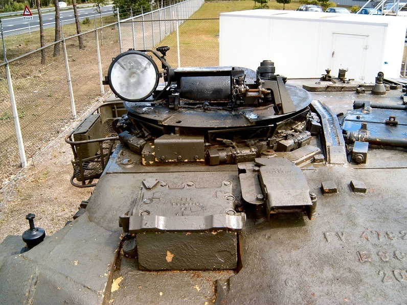

Charles posted some nice photos of this particular part (viewtopic.php?p=97551#p97551) and as I was in the mood of drawing it up I slowly started the process.
After roughly drawing the main body I decided to print it with an FDM printer so that I can put it next to my already printed gunner's sight (viewtopic.php?p=97612#p97612). Not impressed with the actual prints but it's better than nothing.
This is my progress so far:
One question I would like to ask. Can somebody suggest a casting number for the MRS body?

Re: MRS 3D model
I think it's wonderful Vince, quite beyond my scope, I don't know the first thing about 3d modeling, but I may know someone who could help.
Are the file sent via email? and what would be the cost?
It's very kind of you to spend time and energy constructing the sculptures for our models. 8)

If I recall correctly, the two screws arrowed would not be so clagged up with paint as you see now on museum tanks. I believe they were the 2 adjustment screws to move the MRS light source horizontally and in elevation, normally the job of the Instrument Technician in the Sqn Fitter Section and very rarely was any adjustment required. Adjustment was only usually required after a barrel change or if the MRS mirror at the end of the barrel had to be replaced, or if something had happened in the turret to move either of the elevation MRS alignment markers.

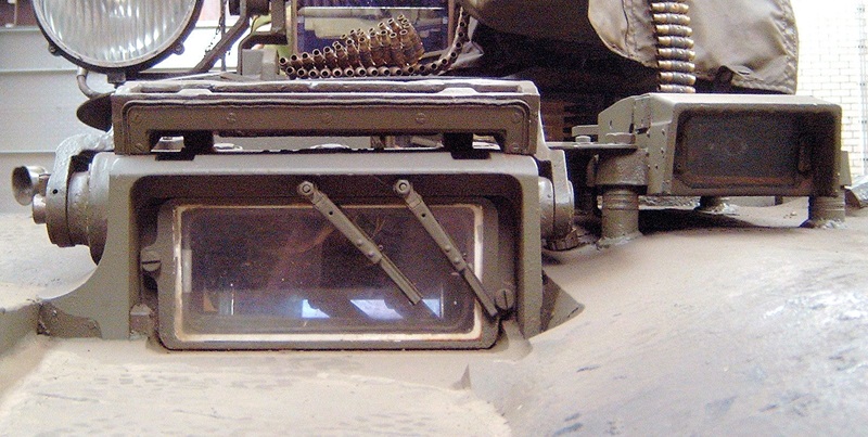

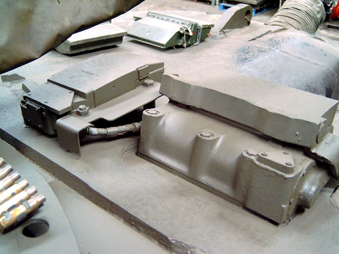

A few pictures, hope they help. :wink:
Has liked: 794 times
Re: MRS 3D model
Those photos are great. Just what I needed.

Which museum was this taken at and got it completely wrong ?
The MG ammunition was disintegrating link and the weapon seperated the rounds from the links during its firing cycle.
So underneath the wapon would be a pile of seperate spent rounds and links, and going into the weapon would be a belt of links and unfired rounds ( ie with bullets still on them and not just empty cases ).
Some bullets would have red tips identifying them as tracer rounds.
I only fixed the tanks and did not crew them, but my brother John or Stephen White, who both did, will be able to clarify what ratio the tanks were usually issued with and whether it should be every 5th round or a different number.
One caveat here, I do not know if it was general practice but in one squadron I directly supported, they would remove a number of the tracer rounds from the start of the belt and group them together towards the end of it. This would give a visual indication whilst firing that the belt was nearing its end.

John, my viewpoint is that museums should teach history accurately and not distort it or present something completely wrong.
I also did not want a fellow builder here who is not in the know to build his Chieftain commander´s MG as shown in the photo. It would have left that person open to ridicule from those in the know and reflected badly on Armortek when that person rightfully claimed that that was how it was shown on a photo on the Armortek web-site.
